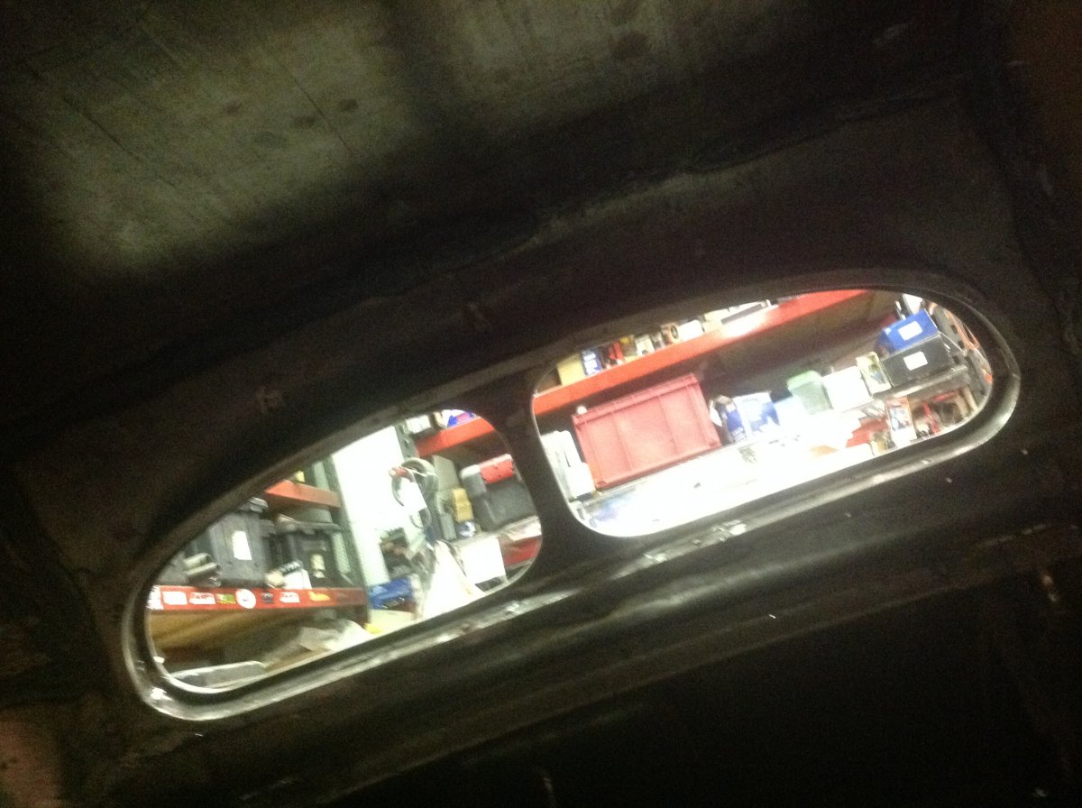

  2. That rear window looks familiar :)
    Bet I could put tha garnish to some use if you wanted to part with it

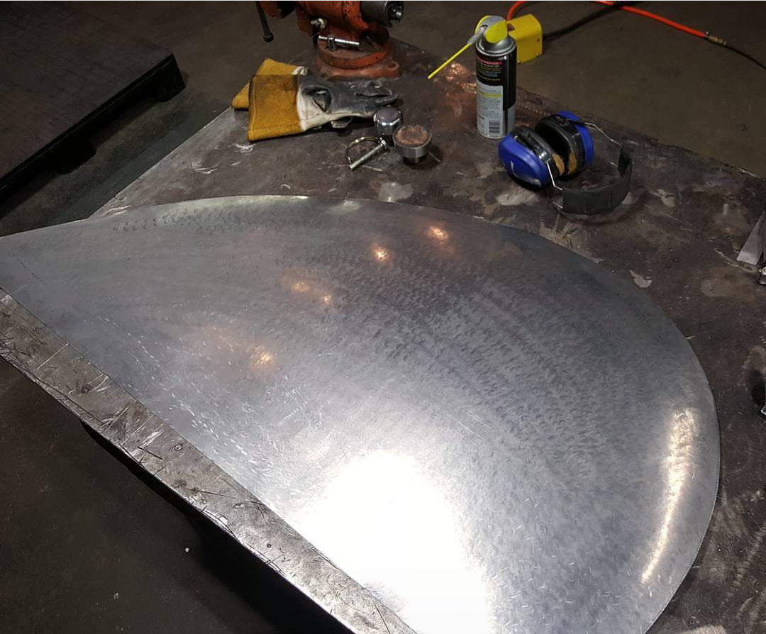

    my car was missing skirts so instead of spending $1500 on a used set that still needs work i figured id just make my own. I made these using my Sosa helve hammer with radius dies, hand flanged the edge and fine tuned the flange with a special tool i made using a planishing hammer. these still need final clean up 20180201_212019.png 20180201_212057.png

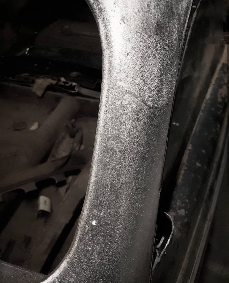

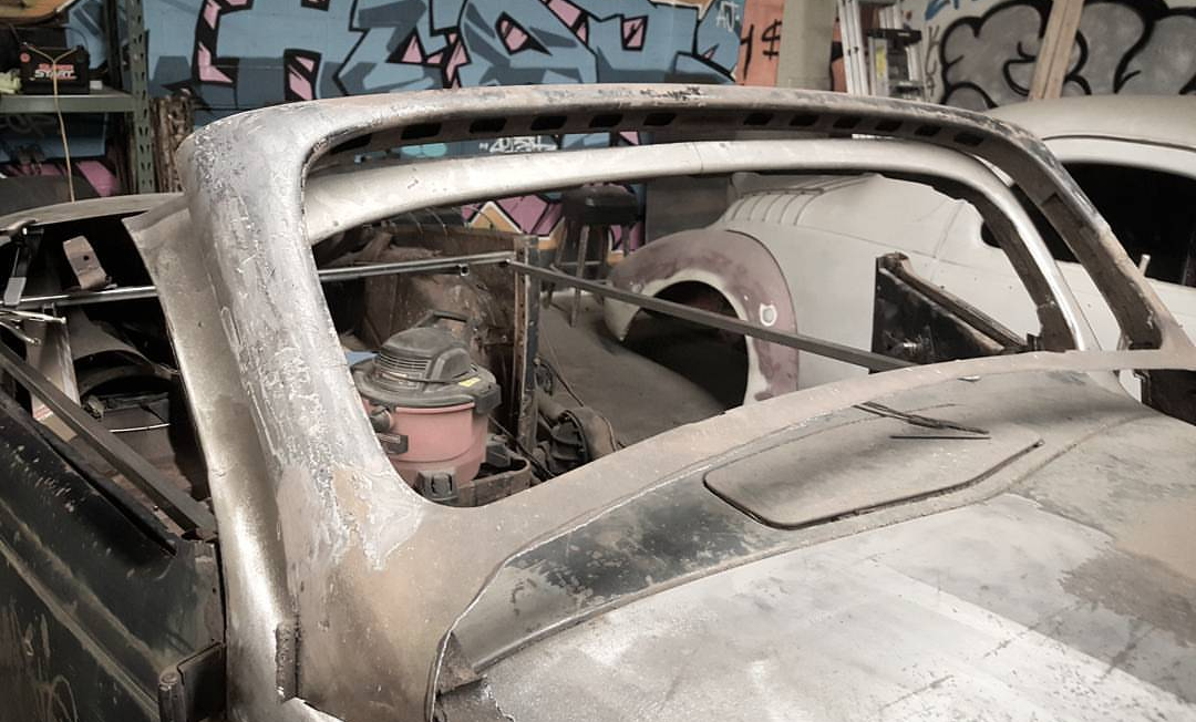

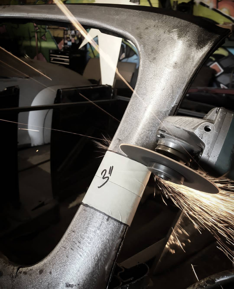

    i started cutting down the windshield section for the chop and prep to modify it to resemble the stock convertible pillars 20180129_212937.png 20180201_212415.png 20180129_213015.png

    after i did that work i was actually lucky enough to find a actual 38 zephyr convertible windshield section. Thats definitely not something i thought id ever locate. ill be installing this soon, trying to get the tail end of the car done so i can get into the quarters and doors. 20180201_210909.png

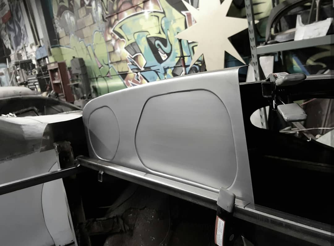

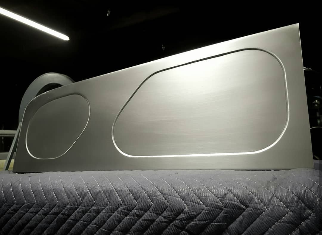

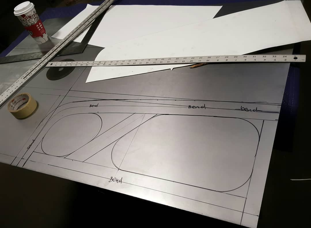

    Since i have the catwalk panels shaped out i should start making the facial structure panel that will be facing inside the cab area. The top curvature is the same curve as the panel, the idea is to flange the inside catwalk part and spot weld the flange like it would be stock to this so it doesn't disturb the paint job and the spot weld seam is hidden behind the top Again doing this in 2 pieces due to my bead roller only allowing me to go in 36". once the structure of the car is built and done i can oull out the bracing and set the panel in its place. Good chance i might do something different to look more factory. 20180201_212212.png 20180201_212232.png 20180201_212249.png

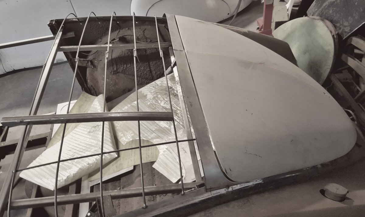

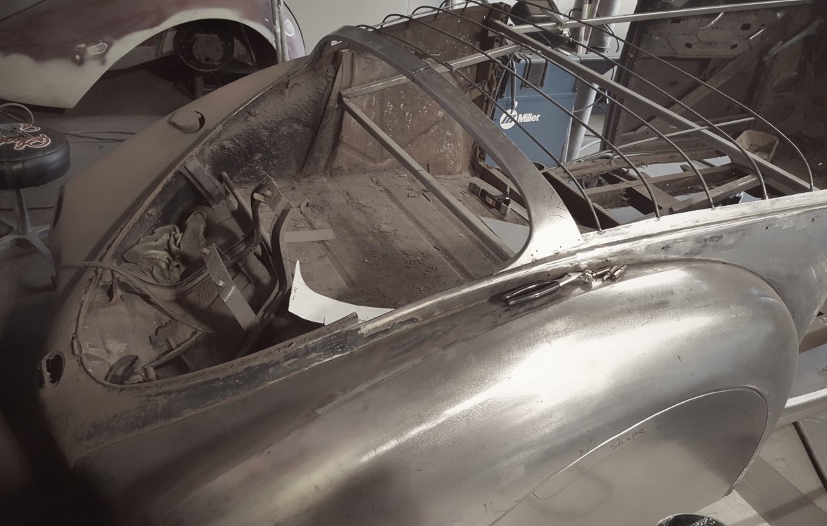

    today i was able to put a little time on the 38 and got the decklid panel opening at the top pinned and tack welded, cut back the fatness on the dr side catwalk panel and gapped the decklid to the catwalk. ill be tack welding this all together soon. IMG_20180202_160954_756.jpg 20180202_144250-01.jpeg 20180202_145029-01.jpeg

    When you finish the back deck will you have an opening trunk and if so how will you fabricate the inner structure to prevent the sheet metal from flexing or deforming when using the trunk lid?
  20. SKOTY CHOPS KUSTOMS
    Joined: Jan 9, 2007
    Posts: 797
    SKOTY CHOPS KUSTOMS
    from BAY AREA
    yes i will have a working deck lid, i will be building a complete inner structure under the sheet metal before i install it permanently.

    Thanks for showing us your work and inspiring us. I know that when I make parts, its common to get it wrong and I have to rework it. Are you able to get it right the first time or do you have to correct inaccuracies too?
  25. SKOTY CHOPS KUSTOMS
    Joined: Jan 9, 2007
    Posts: 797
    SKOTY CHOPS KUSTOMS
    from BAY AREA
    I make corrections when shaping the panels, the patterns I make are like GPS for me and make it a lot easier and allows me to know how much i need to put in a area and where to put it. Once I get really close to the shape I want I back off on the pressure and start cleaning up the panel, getting all the lows spots out and blending worked areas. That stuff is what takes the most time but I love doing it. I can say I have never really thrown away a panel but say like my skirts I made for this car the flange is off in a few spots and I will need to go back and correct that before I can say there done. Ideally I would have made a hammer form for that edge so it's would be perfect but I have not done so yet but I plan to.

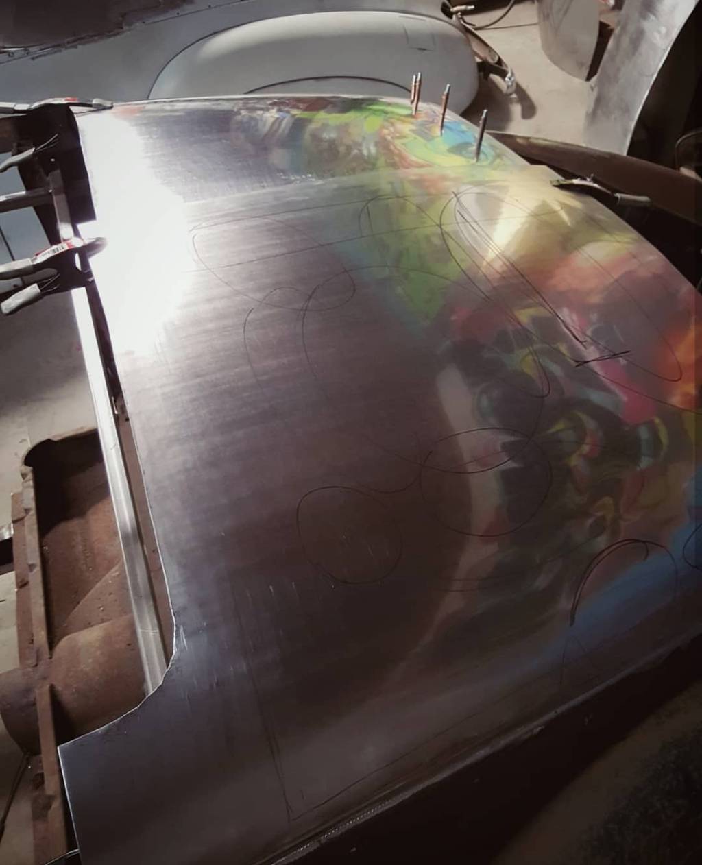

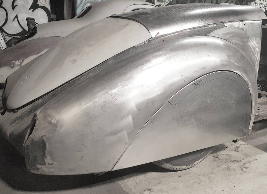

    Really looking foward to getting the details in the catwalk and making this panel all one piece. [​IMG]

    In this photo you can see all the spots I have circled, those are slightly low spots that either need to come up or need to be blended with the rest of the panel[​IMG]
