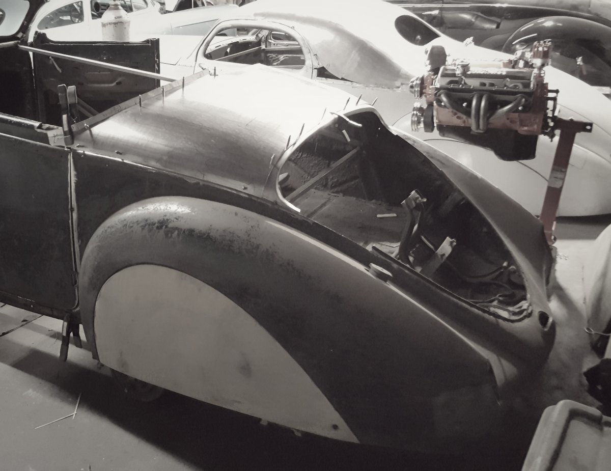

    20180206_205721-01.jpeg 20180206_210053-01.jpeg got to put in a few hours tonight, i trimmed back the upper portion of the catwalk panel to the stock opening of a 1938 zephyr convertible. i also added the mounting flange surface for the convertible top, once i get the pieces all fine tuned im going to weld it all together so its one big piece to install after i make my inner structure

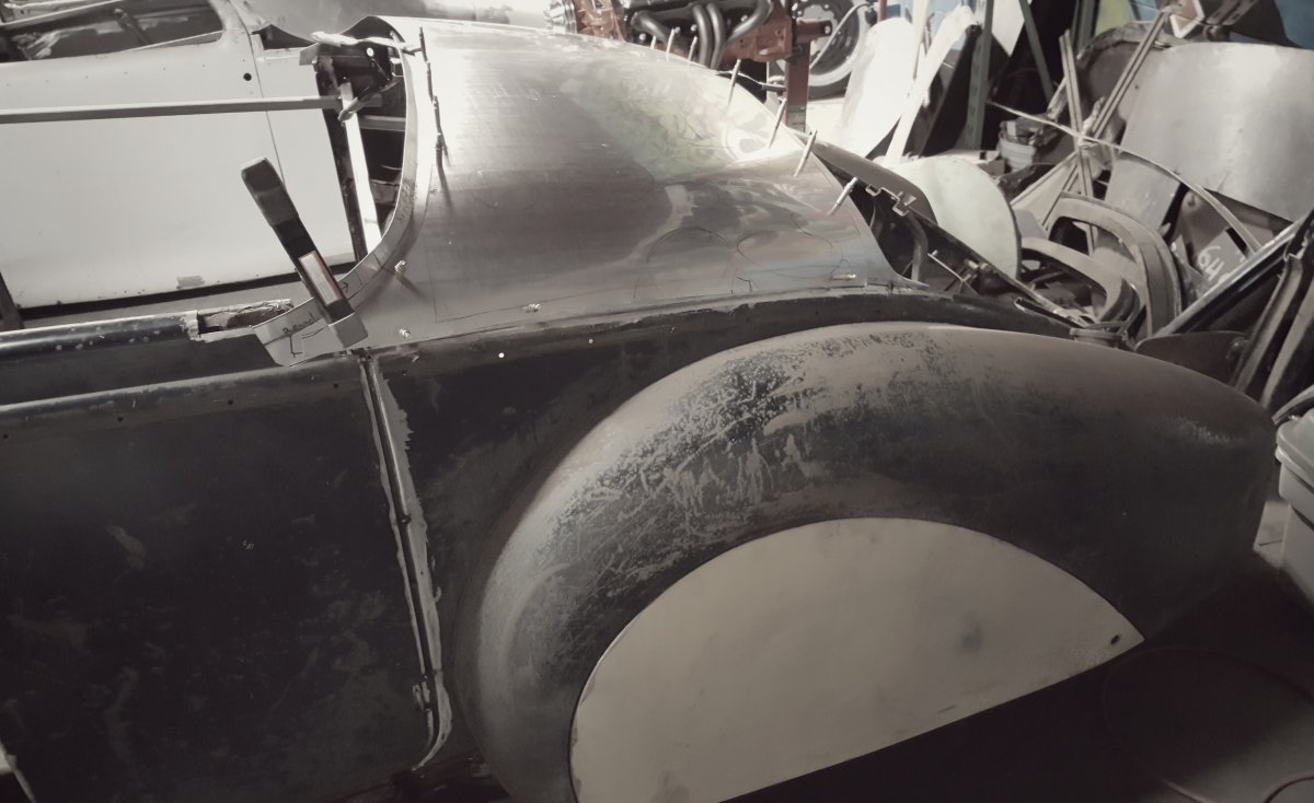

    I extended my catwalk 13" compared to the stock 1938 Zephyr panel which is the flexible shape pattern you see on top of the panels I made. I personally think the stock convertible top is to long and looks awkward. [​IMG]
