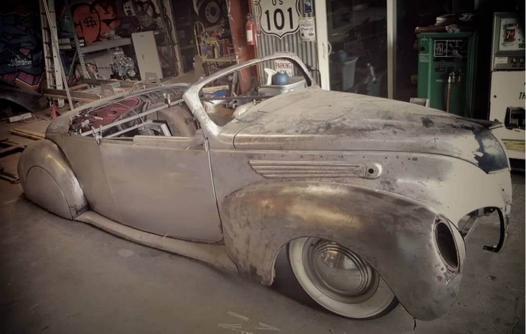

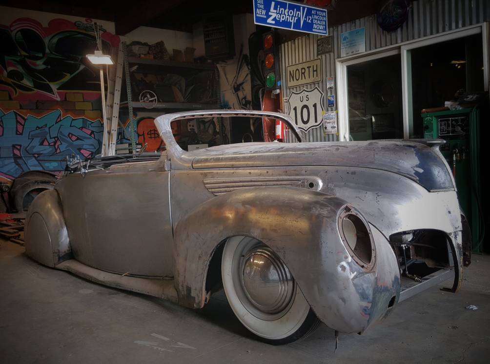

    Pretty cool, hung the fender and stoked to see this thing coming together. Soon enough everything will be locked in. [​IMG]
