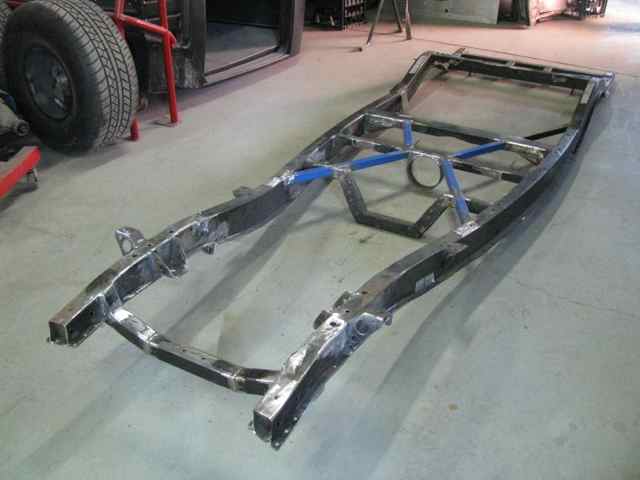

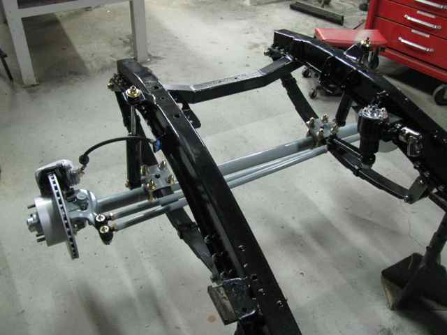

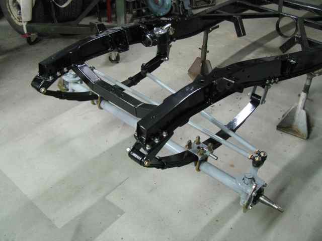

    Last major mod to the ch***is was a more substantial front crossmember to resist the loads of the new front spring arrangement. The original front member had been modified a lot and was still held in place by the bolts. The new one is two inch square heavy wall tube, welded and braced to the frame. I also include some threaded bungs for the radiator support panel.

  4. Fatbrosracing
    Joined: Jun 23, 2009
    Posts: 242
    Fatbrosracing
    from Australia
    Off to my mate "Red" the blaster, found a few minor things that needed more work/repairs. Painted the ch***is with POR-15, I have used this product before with brilliant results, this time, not so good. It had minor bubbling in the final finish, but it will be hard to see when the car is ***embled, so I'm not really worried.

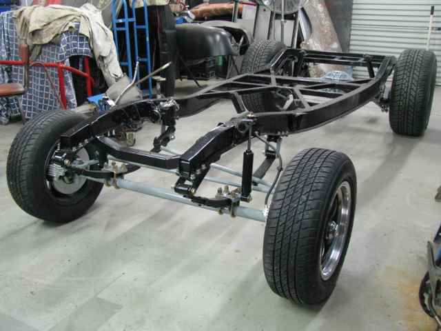

    Final ***embly of painted, plated, finished components is always good. You can see the results of your hours in the shed getting covered in ****. New disc rotors, bushes, and tie rod ends, rebuilt callipers with new hoses and pads.

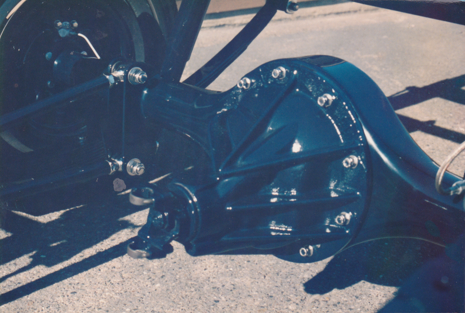

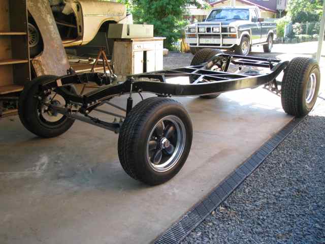

    Rear end is exactly the same as the previous build, 31 spline 9 inch with 4.56 gears and a locker. I rebuilt the callipers, new rotors, bearings and lines. A fresh coat of paint doesn't hurt either

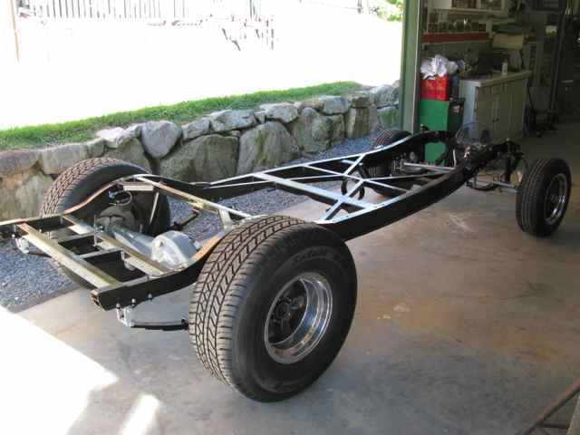

  7. Fatbrosracing
    Posts: 242
    Fatbrosracing
    from Australia
    The finished rolling ch***is.

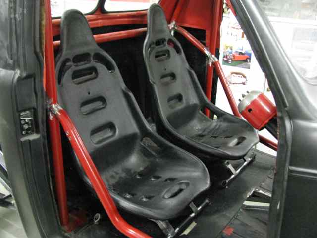

    Put the cab back on the ch***is and dummied in the roll bar to set up the new seats. These will be trimmed in the same red tuck n roll as the rest of the car.

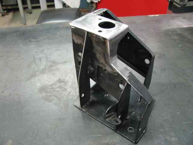

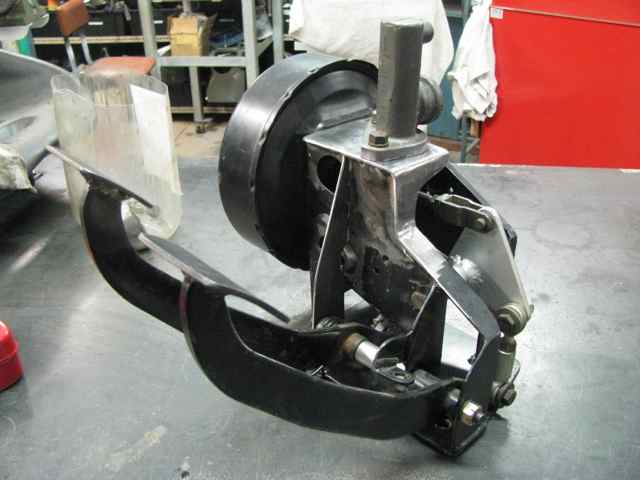

    I have lost interest in racing this car at the moment, so I'm going to fit a milder carburettored engine. To push the fun level up a notch a 4-speed will take the place of the glide. This required 2 alterations, a bigger hole in the floor for the shift, and a modification to the pedal box for a clutch set-up.
    I know the Vertical Gate shift isn't really g***er material, but I really miss rowing gears with this thing. I bought it new years ago and had it in my Monaro. I had to make a new mount to get it higher in the car and further back. It will still be a stretch, cause I'm on the wrong side of the car for this shifter.

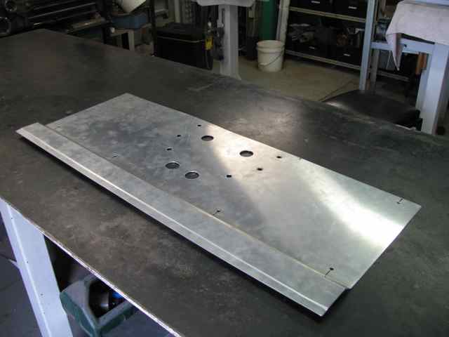

    from Australia

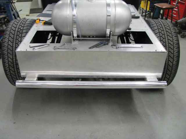

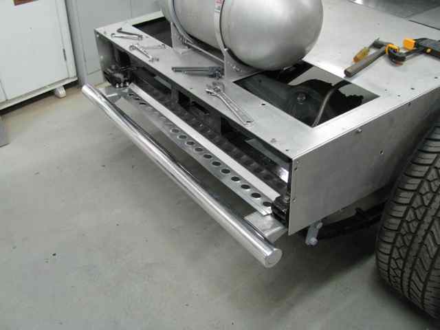

    I was going to make a new rear bumper, so I had to make a new rear panel and rear pan to suit. I made this from Aluminium sheet, the ch***is was drilled and tapped to hold it in place. The holes in the middle are for the fuel pumps, filters and lines.
    I put some holes along the rear to let out trapped air, and they look cool. I made some radius dies from cast metal photocopier optical flywheels ( I work for Xerox ) I made a small test piece first and they came up ok with some adjustments, so I continued with the rear pan.

    The new rear bar is made from 2 1/2 inch ally tube to mimic the push bars of the true g***ers. I've drilled and tapped holes and fitted stainless steel bolts from the inside and turned up some caps that are a interference fit in the ends. the brackets will probably be done in black, but they may get a polish, undecided at this stage.

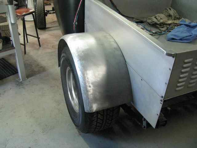

    Had to catch up on some projects for mates after our holiday, so the progress has been hit and miss at best. I did get to make a nice set of headers for a Flathead Caddy though.
    The rear fenders never really worked for me, I used them because I had them. I figured I could make them better looking. I cut the right angled edge off, annealed them, and with hammer and dolly work, formed them to a nicer shape.
    I am very much a novice at this type of work, so any advice / criticism welcomed.

  23. kelzweld
    Joined: Jul 25, 2007
    Posts: 295
    kelzweld
    I like the change to the fender lip. Looks good :)

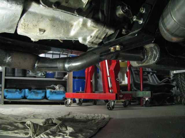

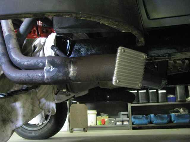

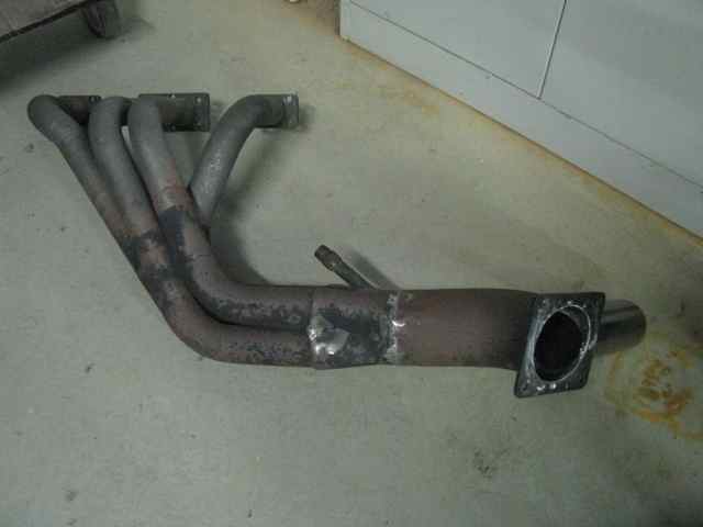

    I decided a change in the exhaust was required. The headers are the same ones I ran on the original blown engine, overkill for the aspo motor, but the new blown engine will need them.
    They used to just bend back under the rail, reduce from 4 inch to 3 and continue through the mufflers to the rear. If I wanted to run uncorked I had to remove the entire exhaust and I made some 4 inch dump pipes to go out under the running board.
    Now with no running board, I figured the cl***ic dump would be the go. This way the exhaust can stay intact and I'll just have to remove the block-off plates. I made the plates from aluminium, ball milled the face and rounded all the edges so they look cast, not billet.

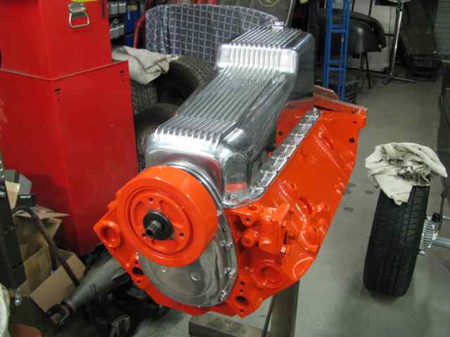

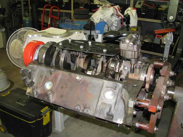

    Next on the "To Do" list was the new motor. Not exactly new, but the original blown motor's short block, repaired and freshened.
    This time it will be carbureted, so a lift in compression was required from the original 8.2:1.
    For the blower, it had flat-top pistons and large chambered heads, so this time I used a set of "Fuelies" to go with the old time feel and it's now at 10.3:1.
