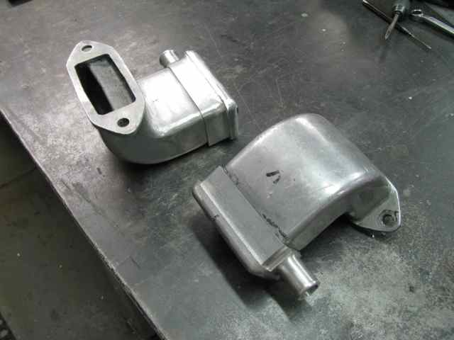

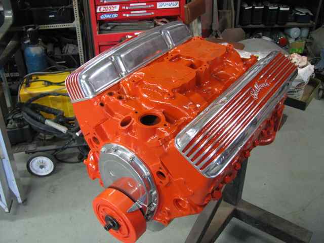

    I bought a set of early Edelbrock valve cover off Evil-bay, and they needed a tidy up.
    The casting on this set was quite rough so I cleaned them up with grinding stones, a split shaft with emery tape, and then a polish.

    After the polish I thought they were a bit bland, so I masked them up, hit them with some etch primer and some Chevy orange, the same as the engine.

    What's with all the holes in the valve covers? Is there a really large breather that covers all those holes?

    Yes they came with large right angle breathers, but the breather tops were damaged. I run a vac-u-pan system, so I need a breather that incorporates the fitting for the hose to the header collector.

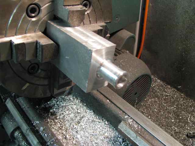

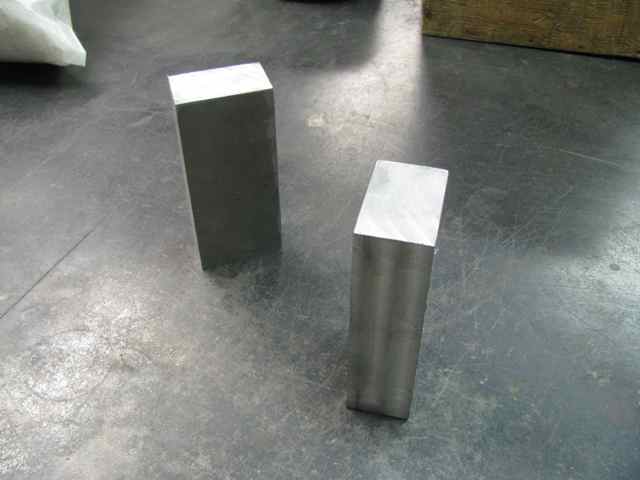

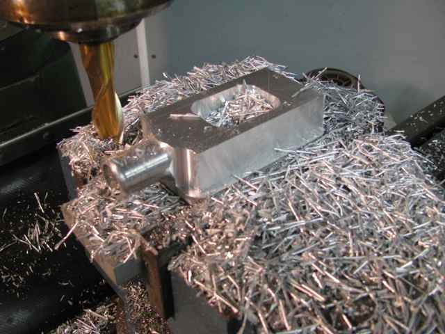

    Ok, so here is my solution to the breather to vacupan in the header. I used the original cast right angle parts, and made a new top that looks similar to the original cap. I started with some inch thick ally plate, cut to rough size on the band saw. Turned it in the lathe to make a tube on one end for the hose to the header.

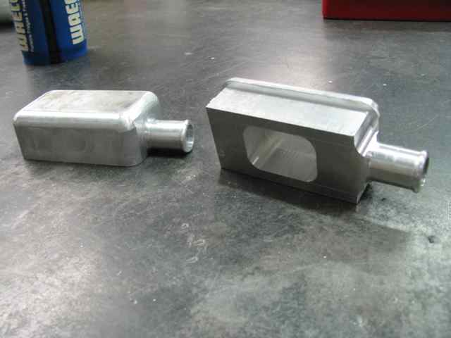

    I rounded the corners with a radius cutter in the mill.Then opened a pocket in the base to intersect the hole in the tube and narrowed the base leaving the top section the original size. This gave it the appearance of a cap, but it's sealed and can only breath through the tube.

    With the basic shape done, it was time to make it look more like a casting and less like it came off the mill. Shaping it to match the cast right angle pieces was done with a air grinder and a belt sanding attachment on the bench grinder. I drilled the holes to bolt the two together and gave the hole thing a polish. They ended up a slightly different colour, with the base being cast and the top billet, but I can live with that.

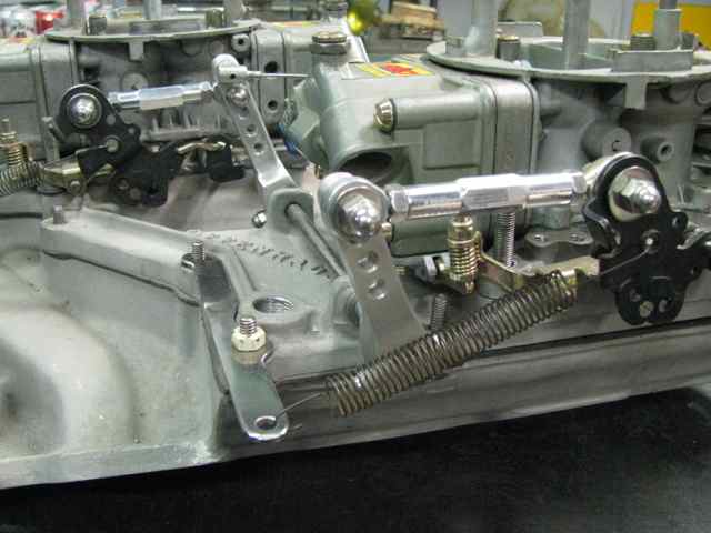

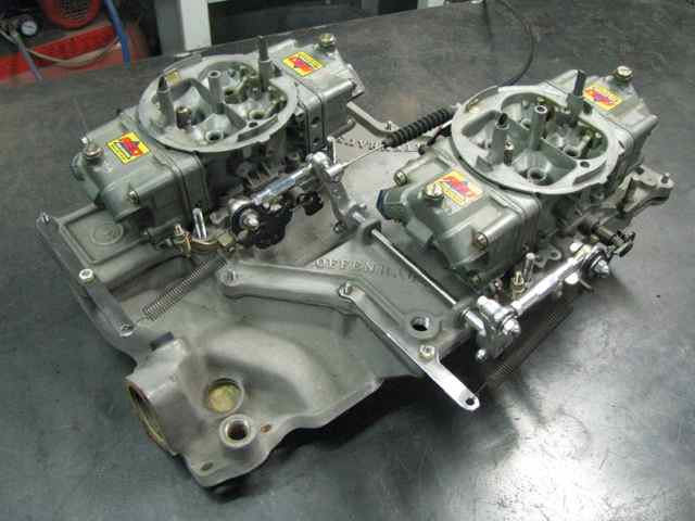

    Not much on the '39, had other things going on. Slight change of plans for the intake set-up. The dual quad set-up was cool, but this looks a bit more "G***ery" and the large plenum manifold should reduce any low end torque that might break the muncie if decide to get playful.
    The original shaft holes were an odd size, so I bushed them with br*** photocopier bushes. The shaft is stainless steel and I milled the arms from aluminium stock, then rounded all the edges to make them look cast. The links were made from round stock. The accelerator cable mount and return spring brackets are steel and I will plate them in gold to match the carb parts.

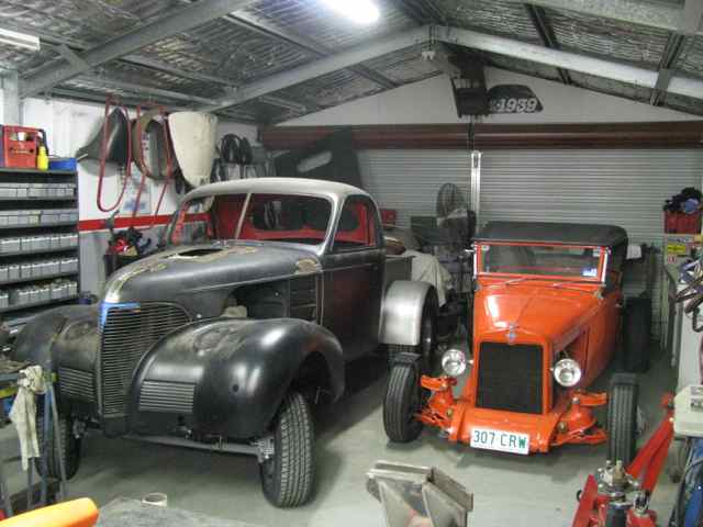

    It's a bit crowded in here

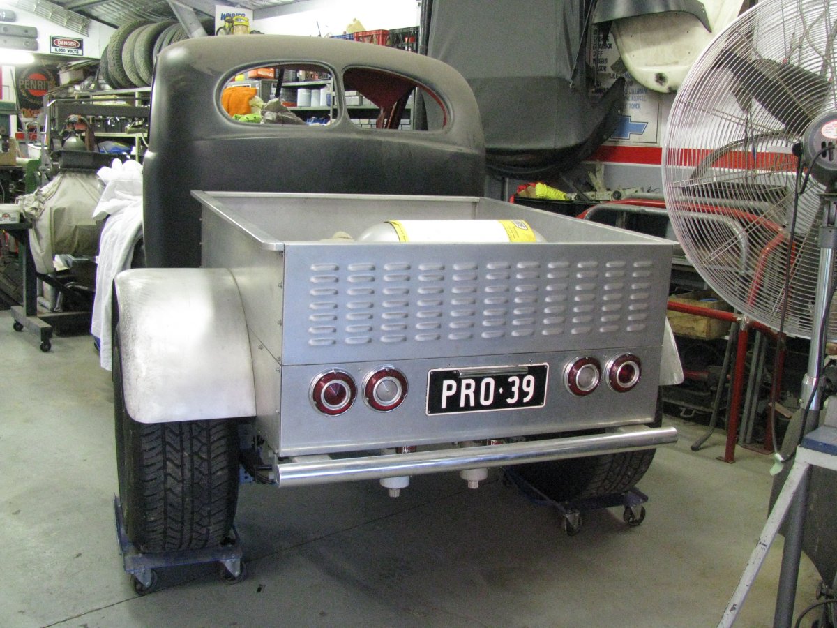

    New tail lights fitted

    Sweet truck man. Did you make the bed for it?

    Yes, it's just folded aluminium sheet, with filler pieces welded in the corners, but this time around I have put a bit more effort into making it fit together a lot better. I will also be painting it to match body this time.
