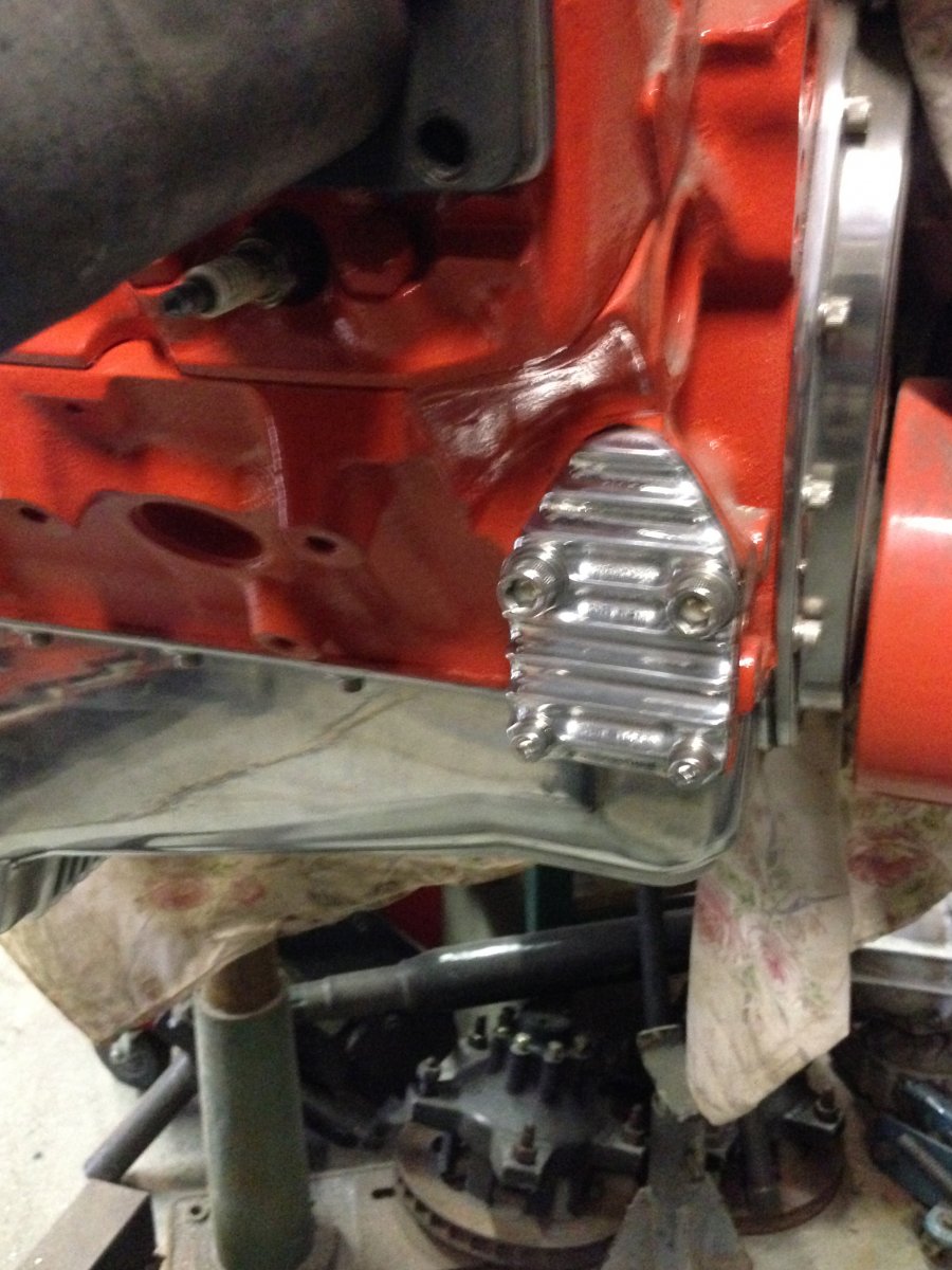

    I felt the fin spacing on the header block off plates was a bit too close together so I made some with the fins further apart. Made a finned fuel pump block off while I was going. IMG_2223.jpg

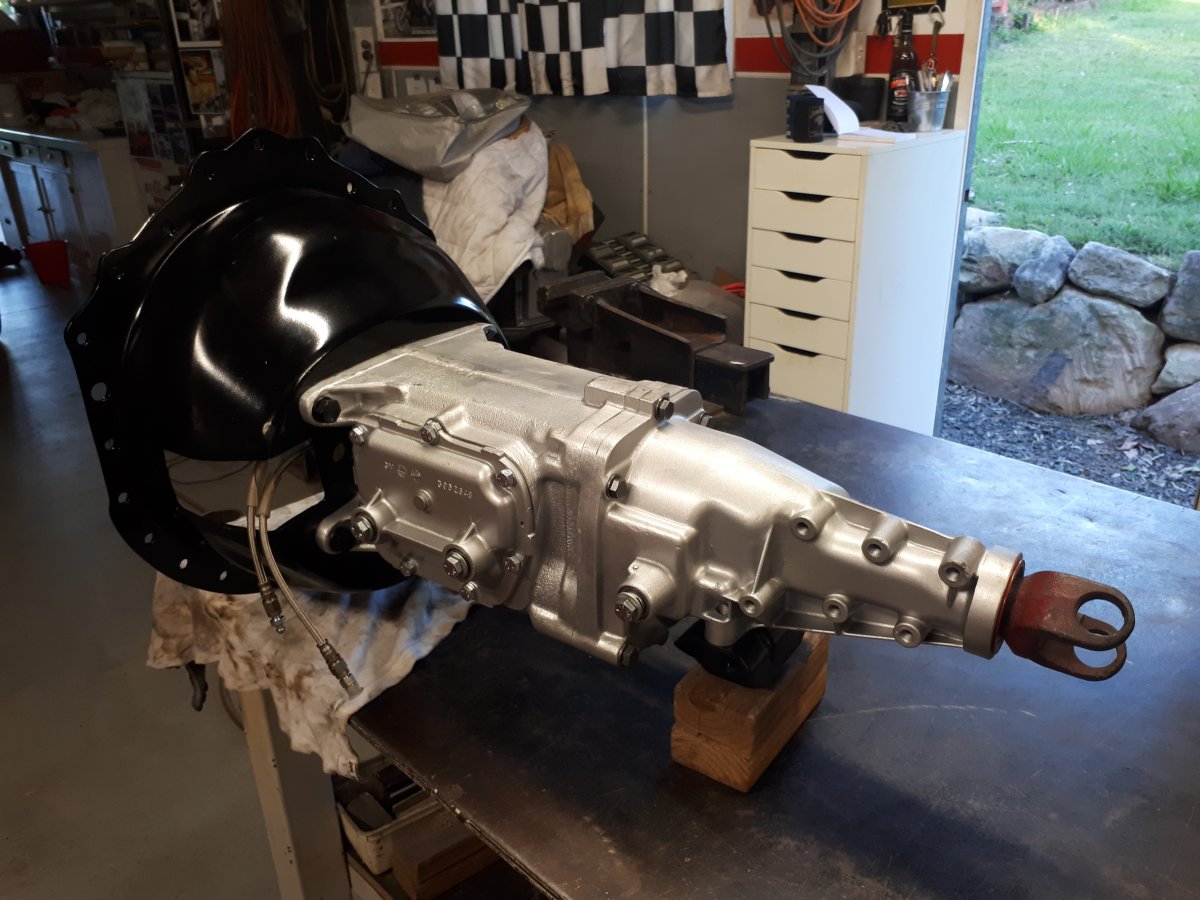

    Currently giving the Muncie a freshen IMG_2242.jpg IMG_2249.jpg IMG_2256.jpg

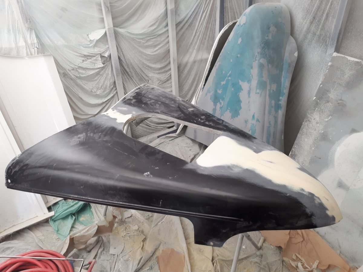

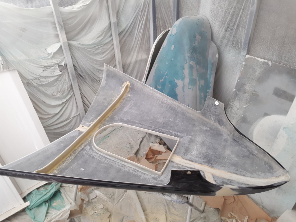

    Progress has been slow, my painter has a lot on, but there is only one car ahead of mine now. Got the moulds made and the individual bonnet halves made in gl***. We'll be fitting them up tomorrow to get the spacing to make it all one piece. IMG_2239.JPG IMG_2710.JPG IMG_2772.JPG IMG_2771.JPG

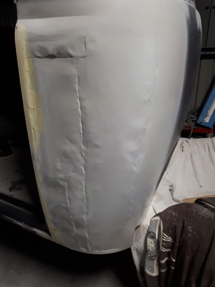

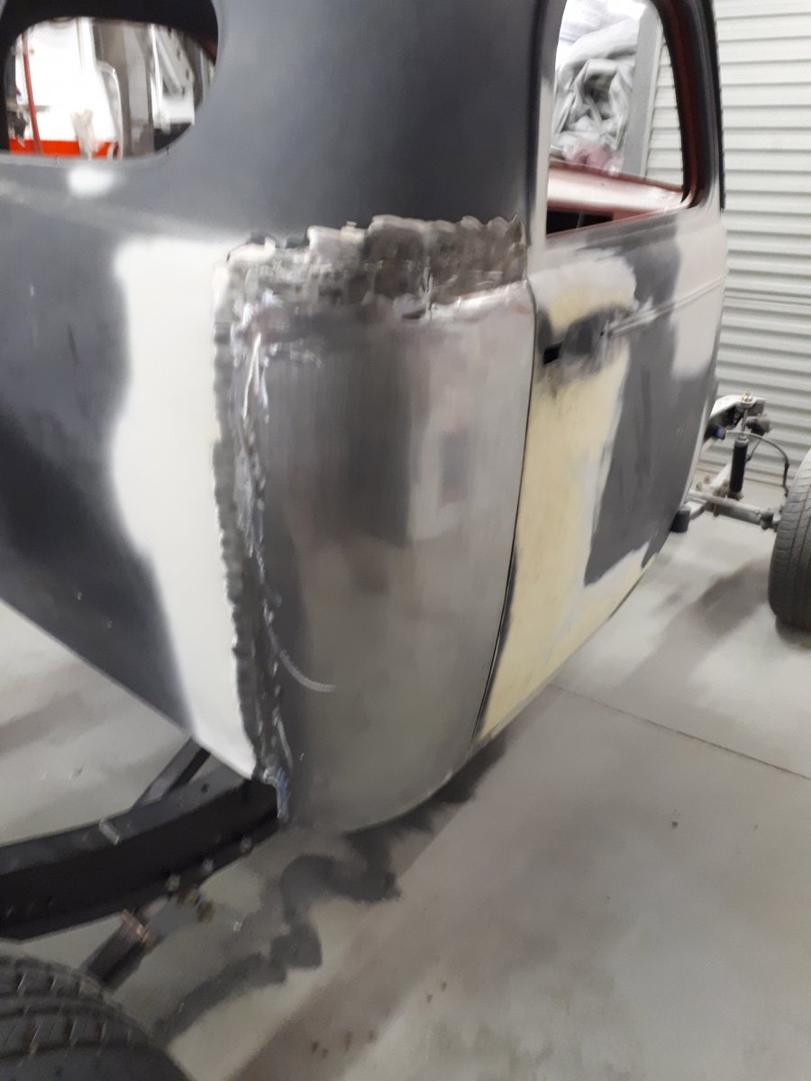

    Haven't posted for a while, because not much has happened with the project. Then it's finally my car's turn at the painters, when I get the call …."You might want to come and have a look at this" Now I know the body on this car isn't great, and in defence of the original builder, it was built from junk just to go racing and has survived this way for about 30 years. When I saw the rear corners of the cab, I couldn't leave it that way. 20170724_170730.jpg 20170724_170750.jpg
  18. Fatbrosracing
    Joined: Jun 23, 2009
    Posts: 242
    Fatbrosracing
    from Australia
    The offending corners were cut out and replaced. I am a very novice metal shaper, but I am happy with the result. There will still be filler involved, but not nearly as much as what was there. 20170805_144044.jpg 20170805_144050.jpg 20170805_173032.jpg 20170806_175115.jpg 20170811_174703.jpg 20170813_140822.jpg 20170813_140851.jpg 20170805_144044.jpg 20170805_144050.jpg 20170805_173032.jpg 20170806_175115.jpg 20170811_174703.jpg 20170813_140822.jpg 20170813_140851.jpg

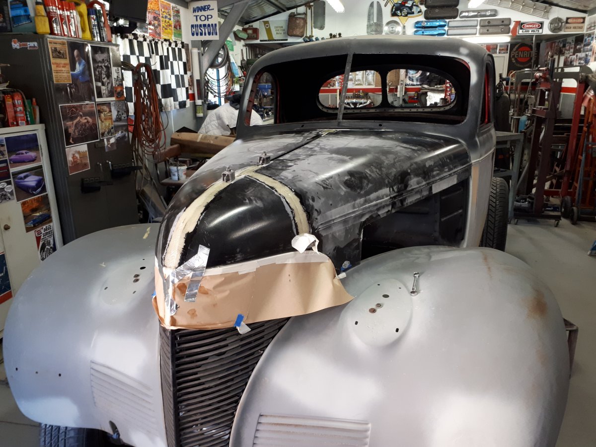

    While the car was back for the cab repairs, we fitted the 2 fibregl*** bonnet halves and made them into a one piece bonnet. 20170820_144006.jpg

    Bonnet is now fully gl***ed with structural rib and hole for scoop, and it's at the painter with the rest of the car.

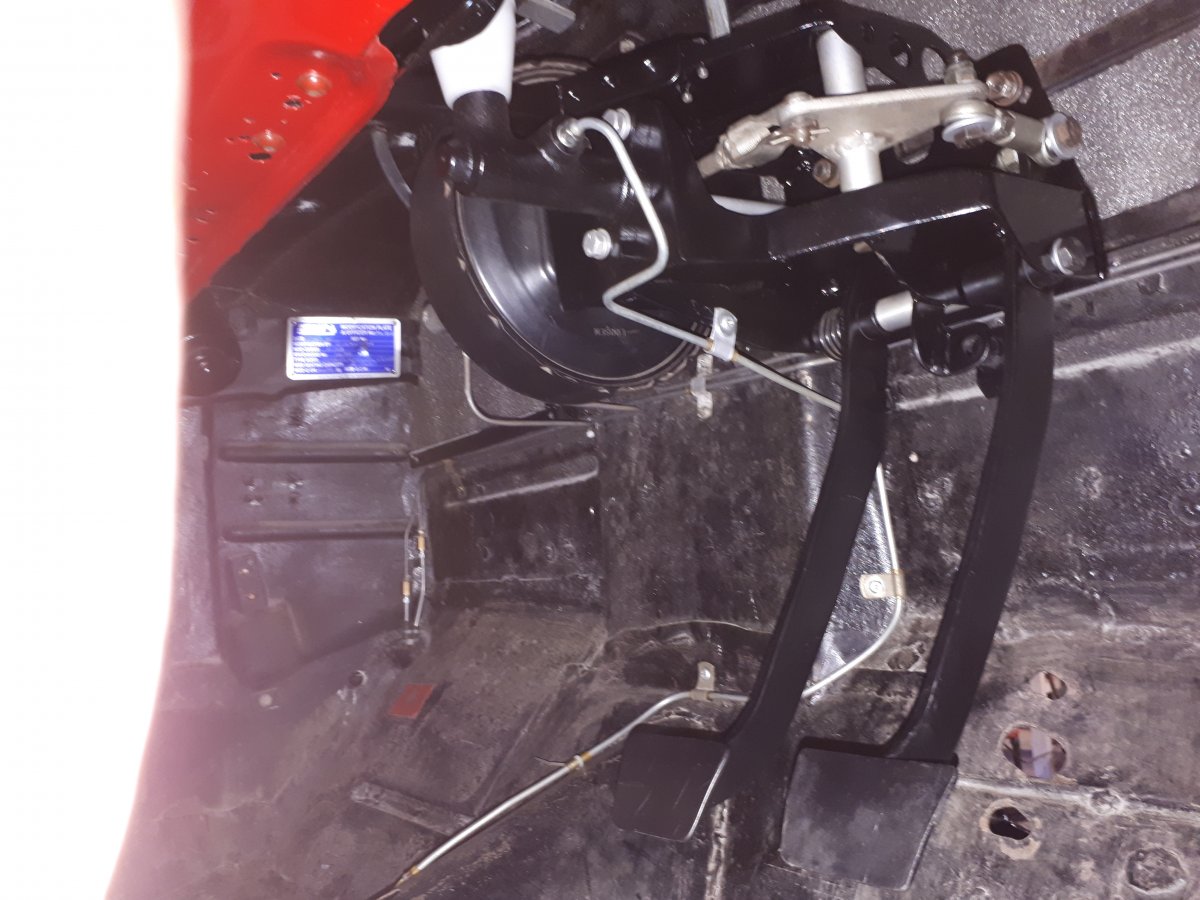

    Did some work under the dash. Wipers are in as are the brake and clutch master setup. 20171218_173943.jpg 20171218_174022.jpg

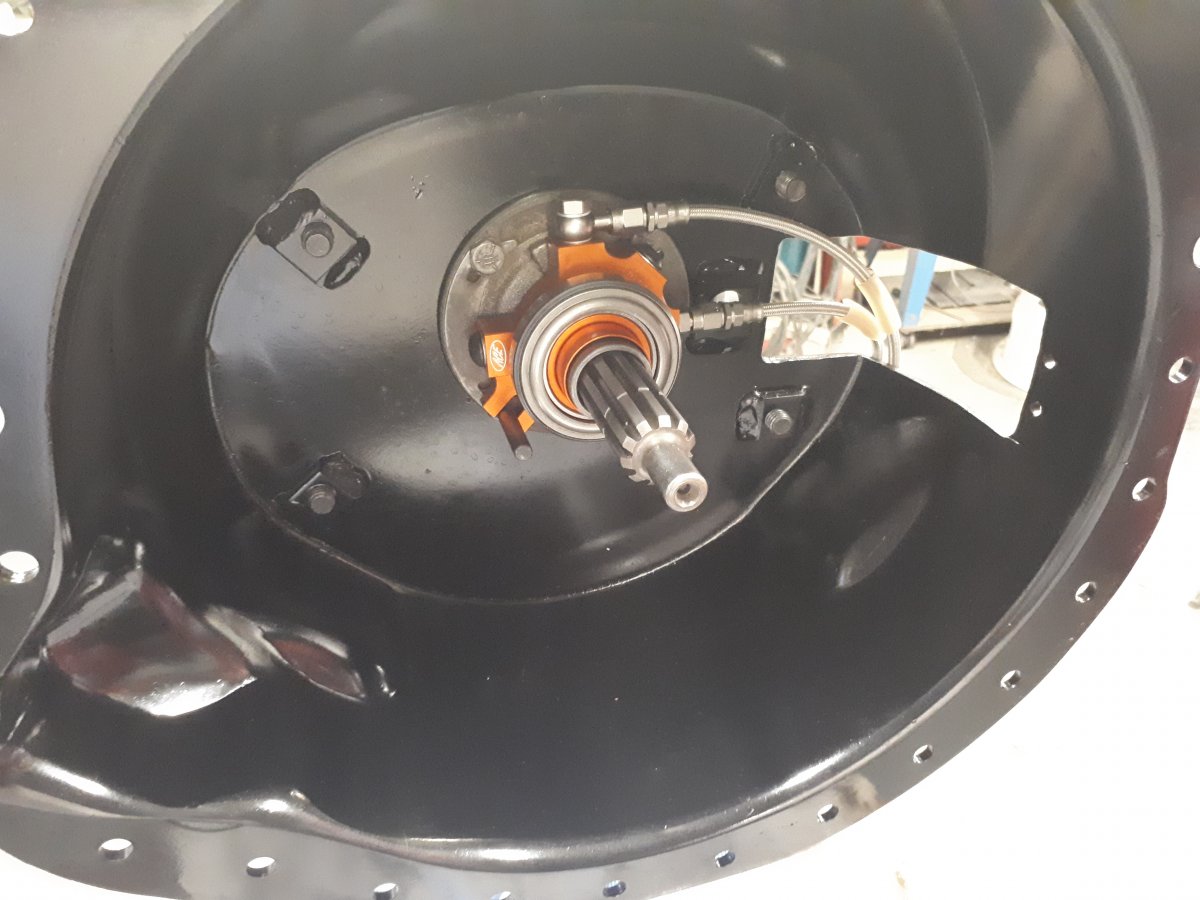

    Got a bit more done on the days off. Front and rear gl*** is fitted. Set up the hydraulic clutch release bearing and fitted the motor and gearbox to the ch***is. 20171212_180244.jpg 20171212_180254_001.jpg 20171224_163334.jpg 20171224_163323.jpg

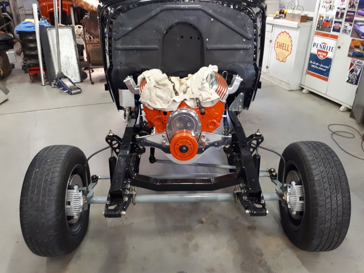

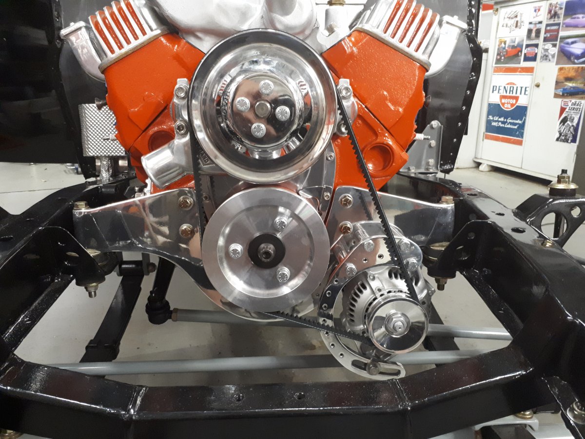

    Small block Chevys are easy right? Water pump wouldn't fit with timing cover, had to make spacers, top pulley fouled on the pump, another spacer, now too far forward, machine the back edge off the pulley, throw spacer away and modify water pump housing. Modify alternator housing and mount to get it all to line up. Not the hardest thing I've done by any means, but the simple stuff that should take an hour, ends up taking a day to do. Lucky I'm not paying an hourly rate for this. 20180103_213601.jpg 20180103_213613.jpg

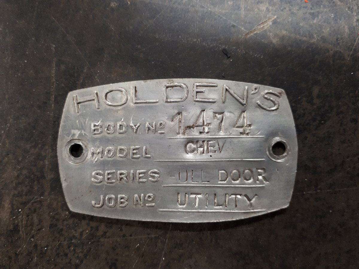

    Found the Original Body tag. The "FULL DOOR" had me wondering. Turns out, 20171229_194808.jpg they sold budget models with roadster style doors called a "HALF DOOR UTILITY"

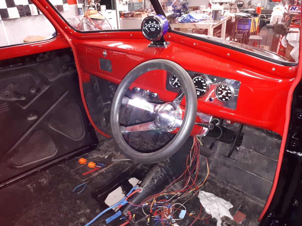

    Dash is done and the wiring is mostly finished and tested, kept the modern bits hidden. 20180115_215228.jpg 20180115_215238.jpg 20180115_215341.jpg 20180117_212319.jpg
