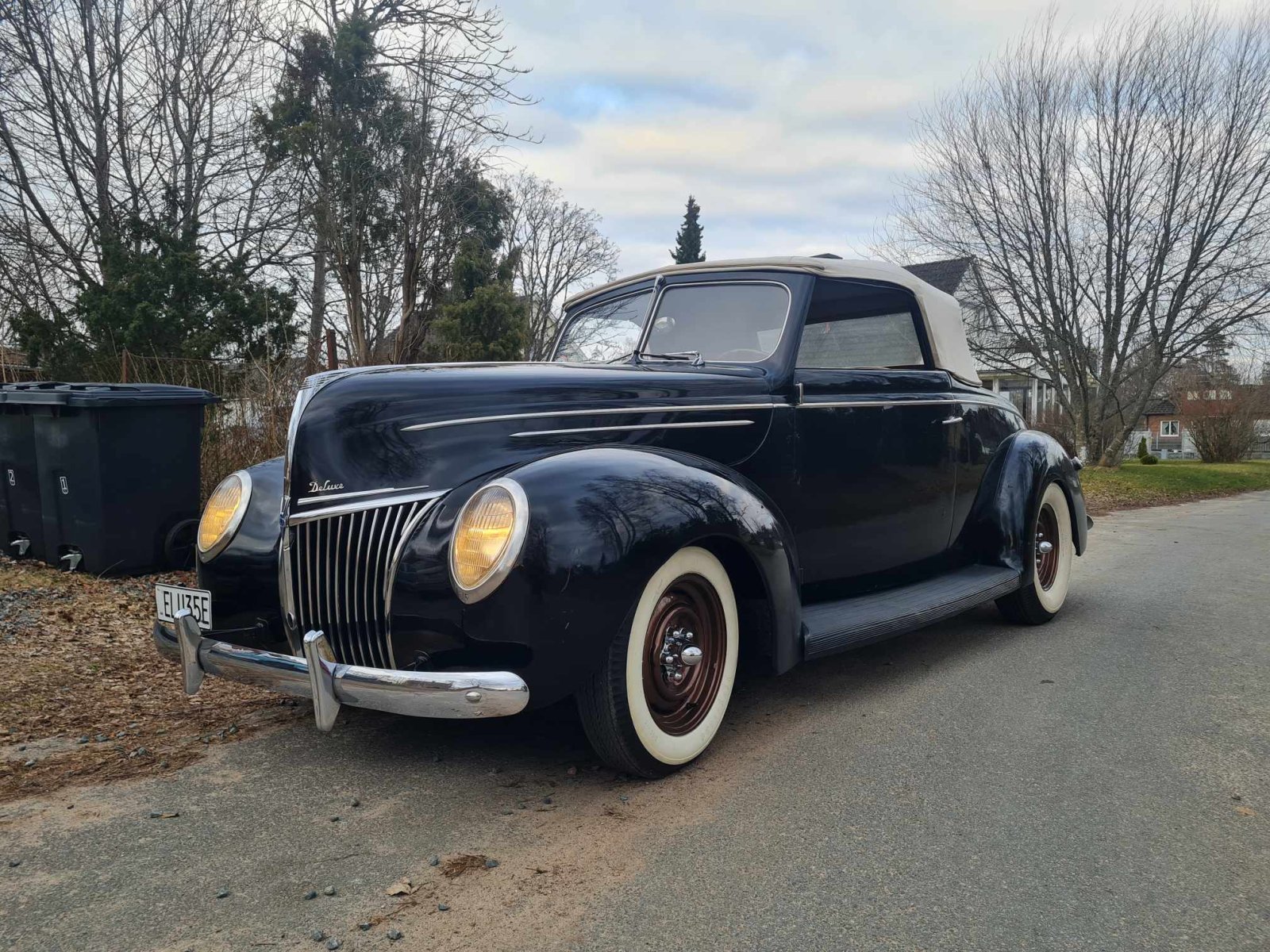

    So, this April i bought a 39 ford convertible.
    Ive had alot of old cars but not a real convertible so i made a deal on this one.
    The car was all "original" besides a dropped front axle, disc brakes in front and super slide leafsprings.
    Original 85hp flathead and stock trans/rear axle was all there.
    The car looks great in pics and were ready to drive but was a 70s "restoaration" with rivited floor/trunk and alot of bondo.

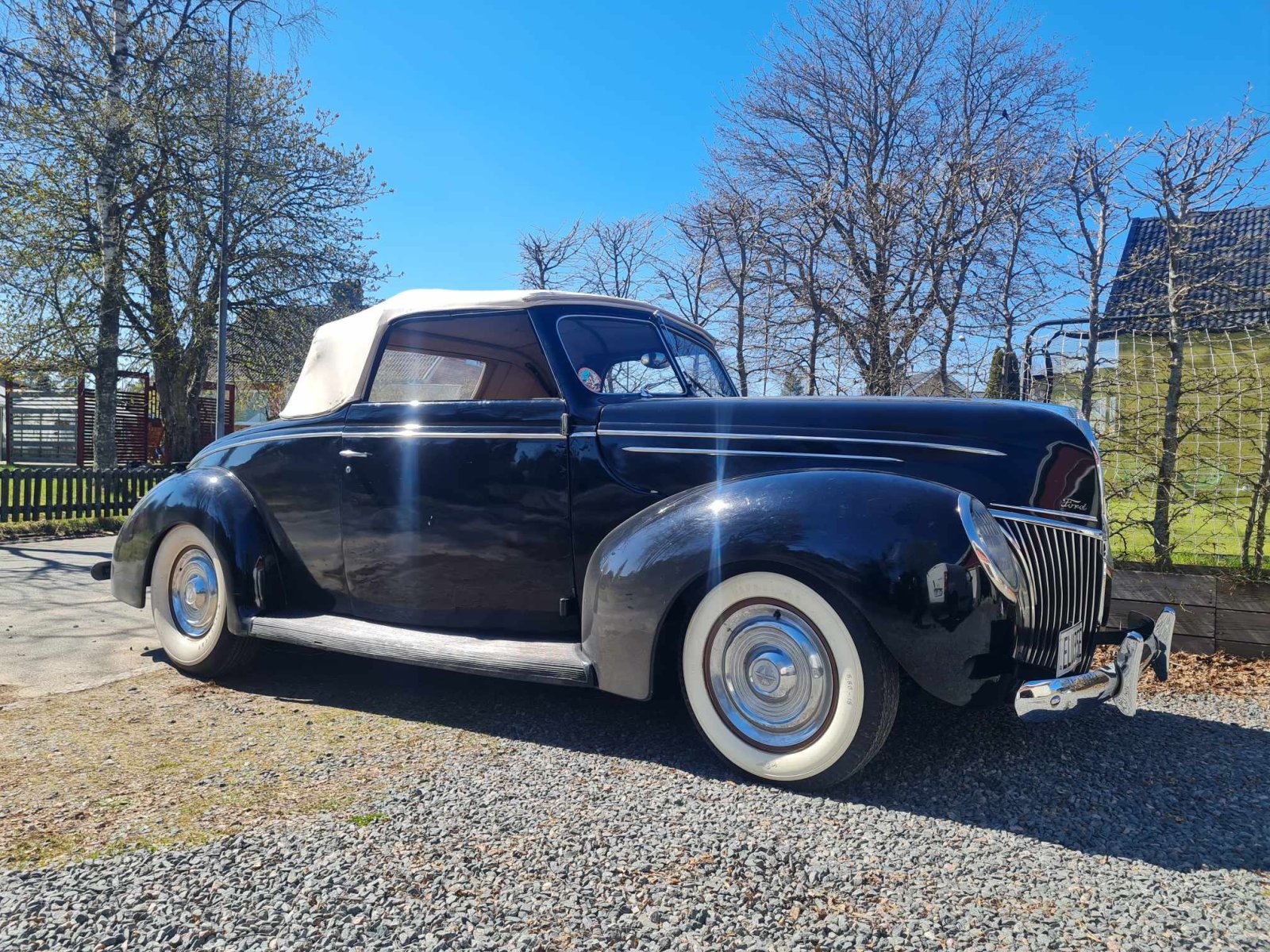

    At first i just wanted to drive the car, it ran great and smooth, got the spidercaps off and mounted some Oldsmobile caps.
    It had a mild hot-rod stance with 8,20 in the rear an 5,60 in front.

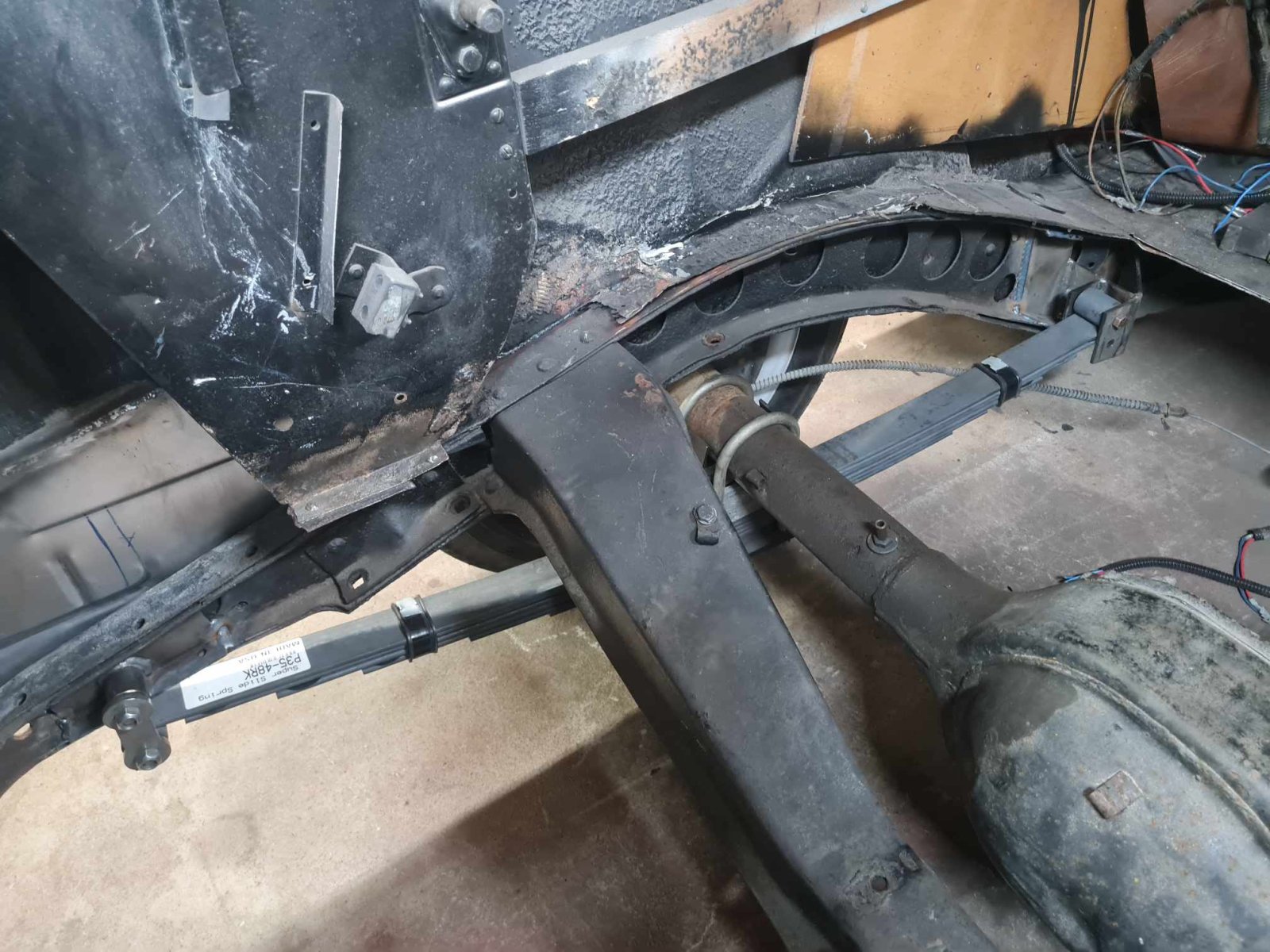

    Took the old rear axle out and everything that had to do with the original rear suspension.
    Bought a paralell leaf spring kit fron Posies, i think this is the only one with the front mounts on the inside of the frame witch makes it lower.
    I also mounted 2 inch lowering blocks i had layin around, these will probably be swapped for 4 inch blocks.
    The ford 8 that i got with the car was a litte to narrow so i might go for another wider one to get the wheels a bit further out.
    As you can se i also cut all of the trunk floor out, it was just rust and rivited plates.

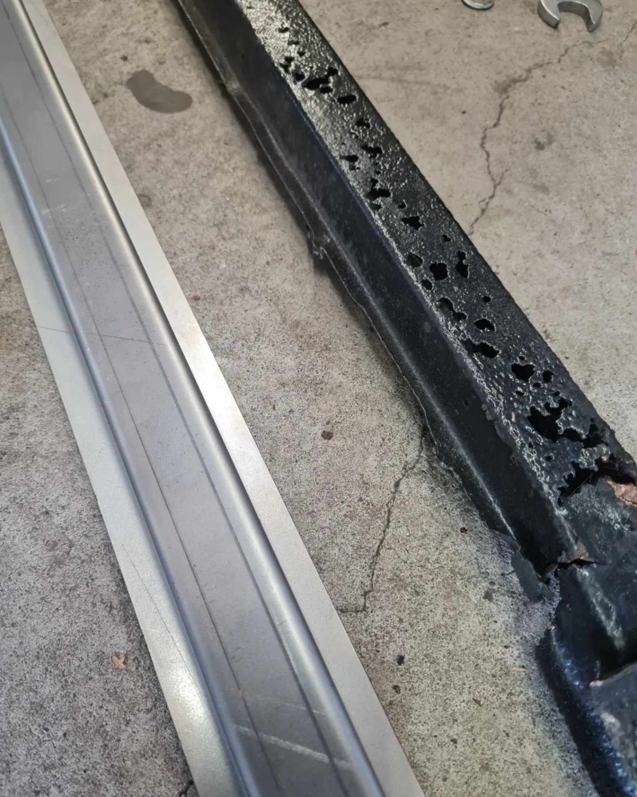

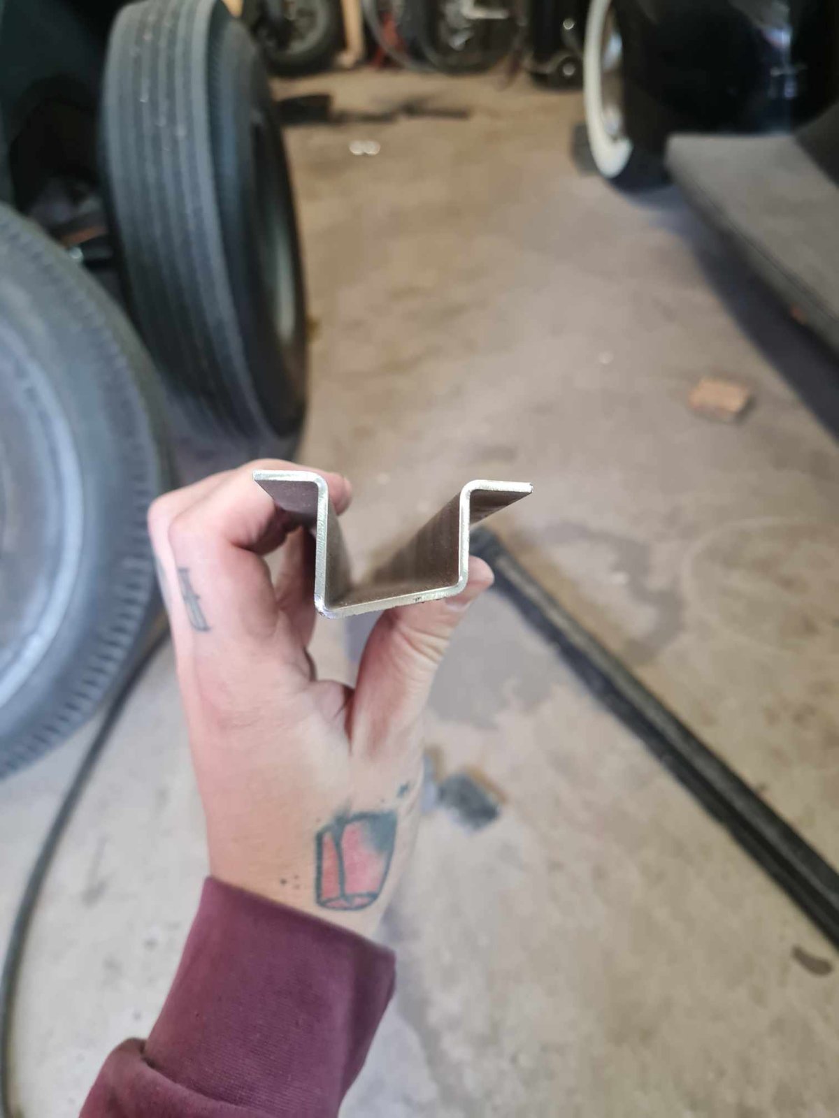

    The old trunk floor was still there under a big rivited plate (see pic) but it was totally rusted out and nothing could be saved.
    The original reinforcement that sits under the trunk floor and bolted to the frame was shot and the ends was cracked and the hole rear body was saggin about 1/2 inch.
    Made a new reinforcement in thicker material than original and bolted it in place.
    You can se the angle in the bottom of the reinforcement that follows the angle of the frame.
    Raised the rear body to the right location and welded the reinforcement to the inner fenders so the body got some support and strength. 377109018_327248586363950_3551586148503286271_n.jpg 377105123_1000289597946201_9099782932365055489_n.jpg 377107571_3530904997149573_8596596011993802459_n.jpg 377100738_700463145258382_4755980068643165467_n.jpg 377100817_3608641516085457_3895401829273517540_n.jpg

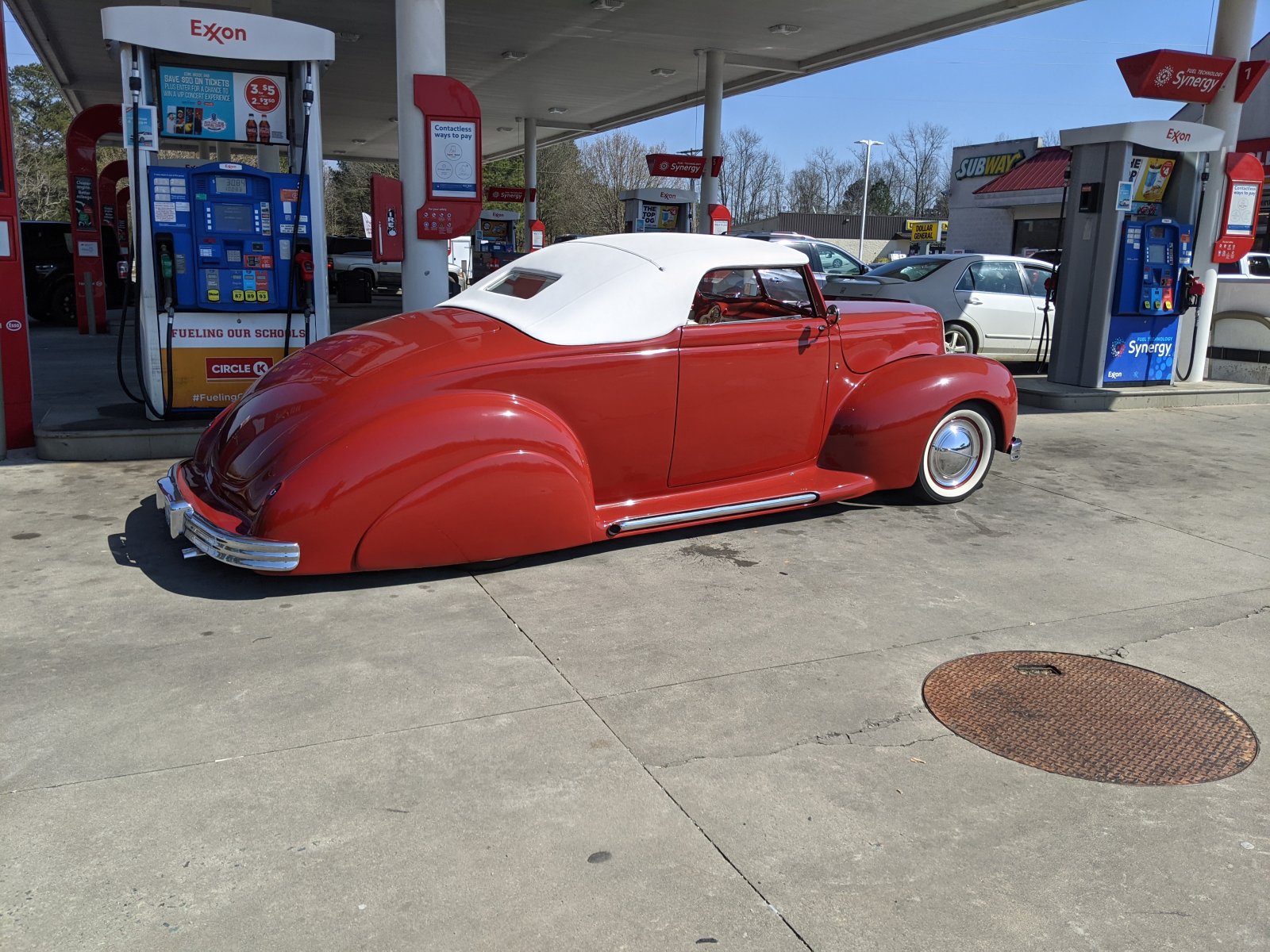

    Fantastic project. Not to many old school 39's around. PXL_20210310_190339777.jpg
