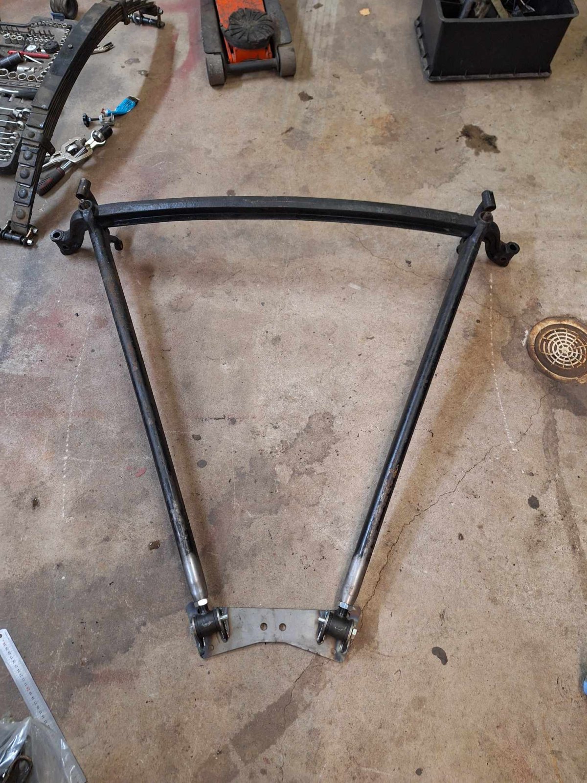

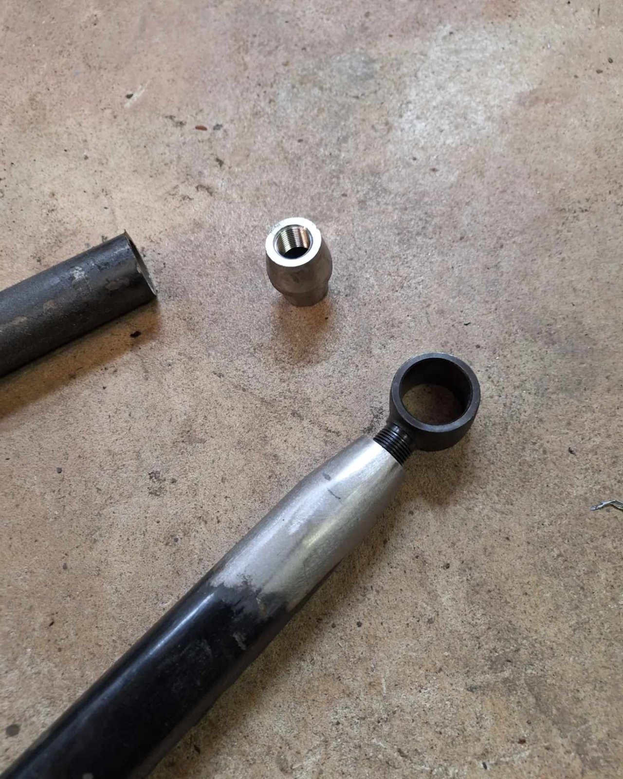

    Got the wishbone split and welded.
    Started to heat and get the shackle mounts in the right angle after the split but ran out of gas and could only do one side.
    Kinda hard to do this by yourself, would be nicer to have one guy heating and one bending.
    v-stag kapat.jpg v-stag svetsmutter.jpg v-stag färdigt.jpg inte böjd.jpg böjd rätt.jpg

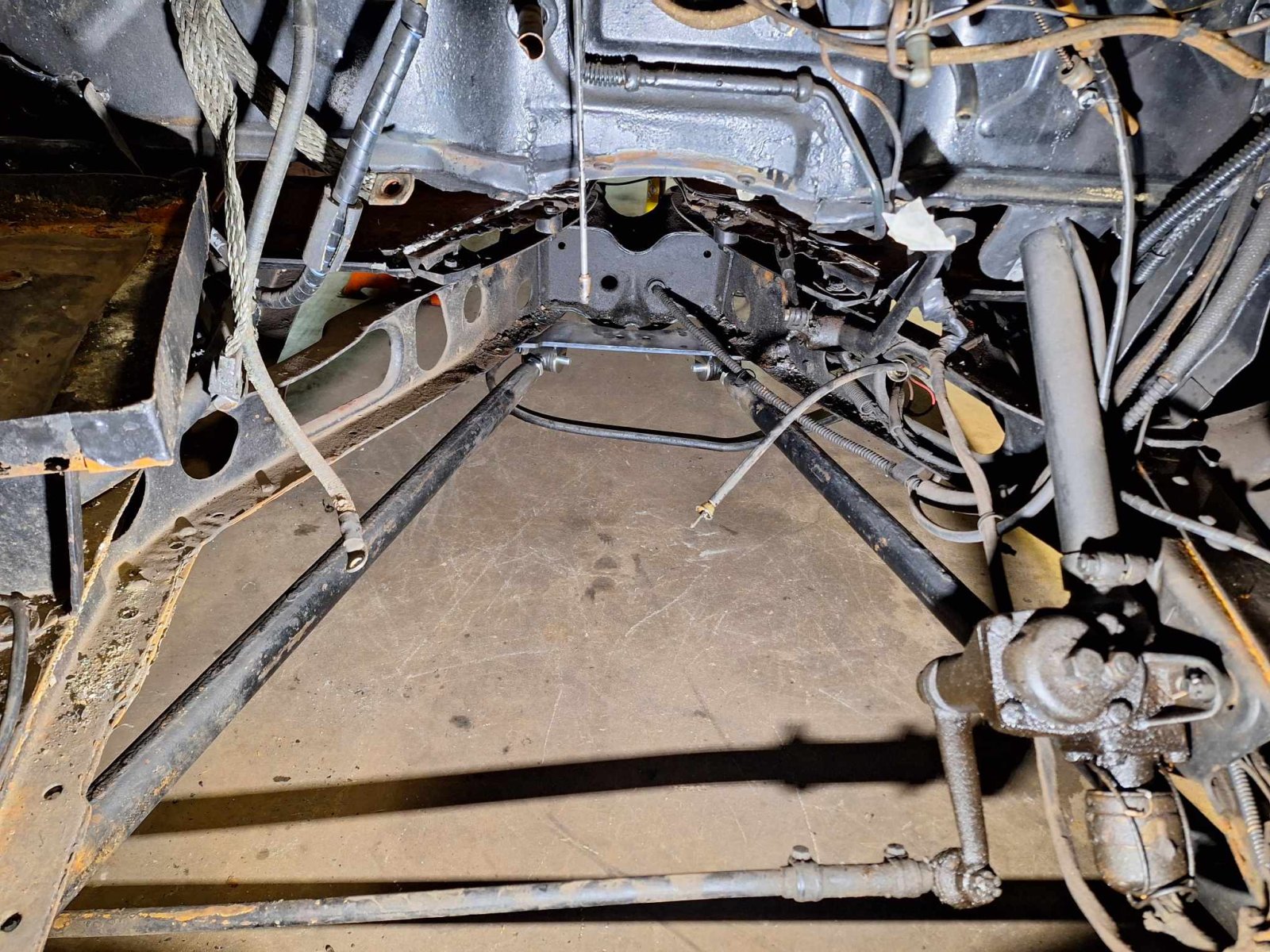

    Got the front end back on the car, the rear mount for the wishbones is not bolted to place yet. I want to test with engine/trans first to see where everything ends up. Also there is holes in the wishbone mount for a th350 transmission mount that i will use if i can.

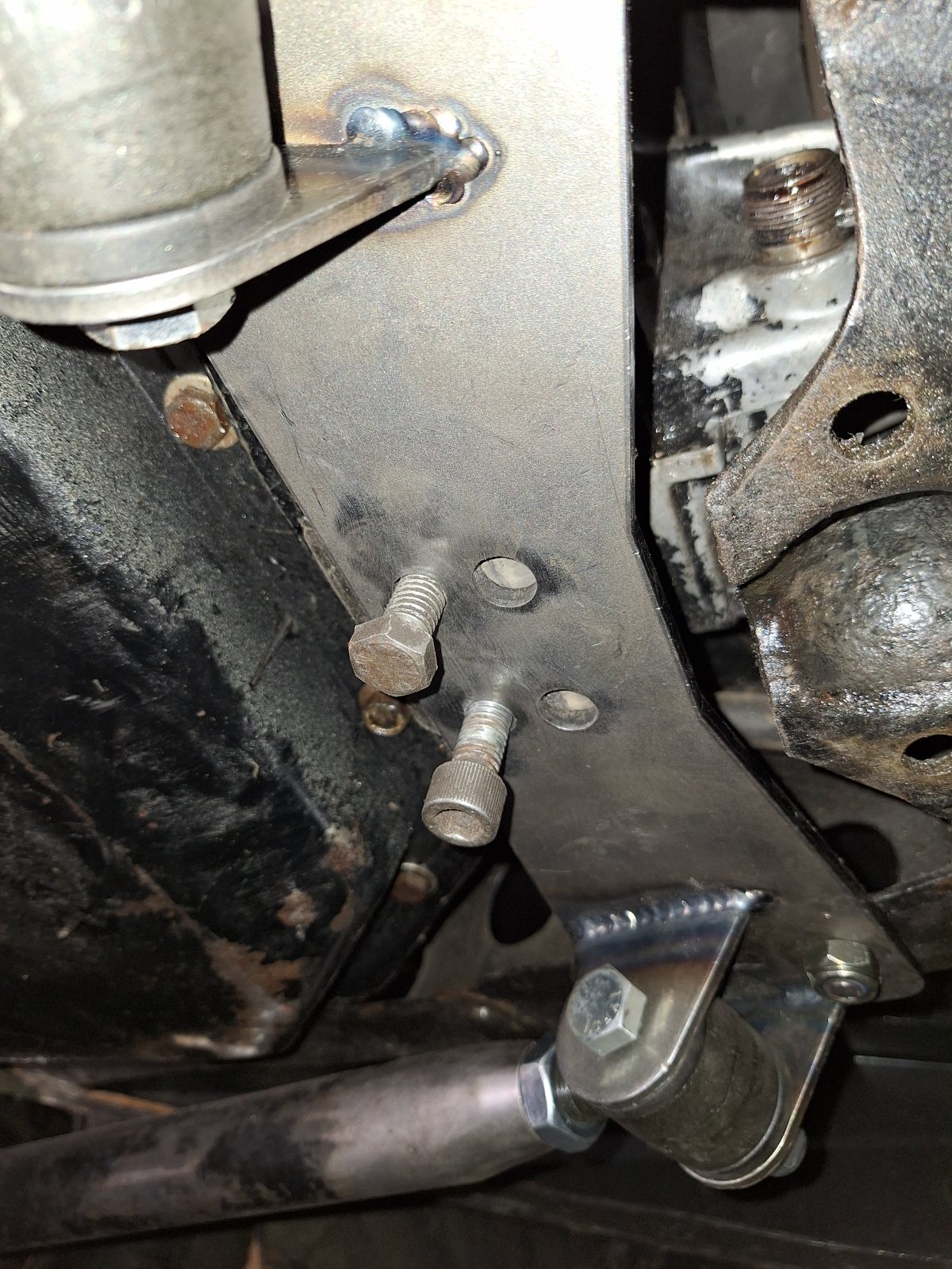

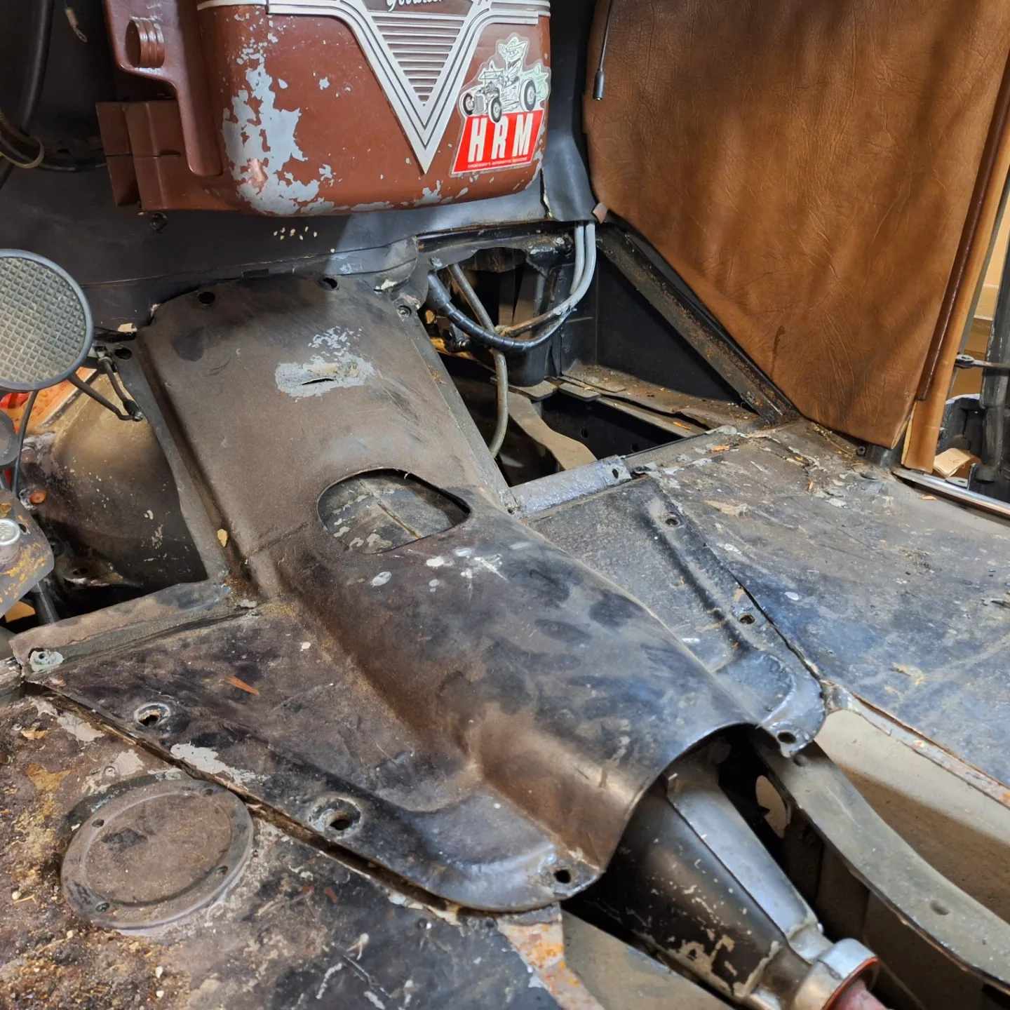

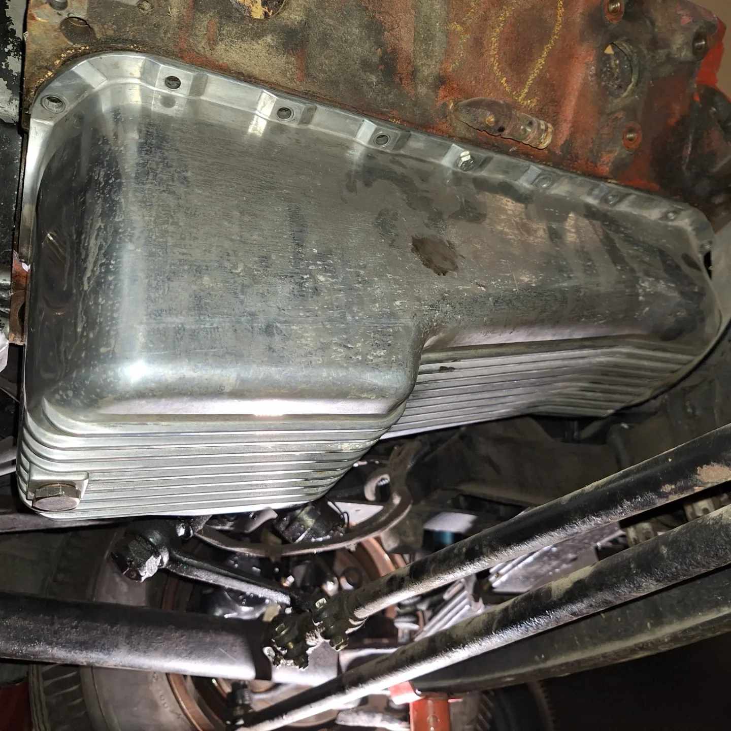

    I got a th350 delivered from a friend this weekend so i decided to bolt it to a empty 283 block and put it in the 39 just to test how it would fit.
    As i said before the wishbone mount had holes for a th350 trans mount that i wanted to use if i could.
    I had two types of front engine mounts, one old Hurst thar ive borrowed from a friend and one new aftermarket.
    Sadly the old Hurst mount hit the timing cover and needed a spacer between the block and mount and that made it to far away from the holes in the frame to use.
    Had to cut some in the center section of the frame to get clearance for the transmission but after that i got it bolted to the holes in the wishbone mount.
    Gladly the transmission dident hit the floor so i dont have to change the front floor or anything like that.
    The motor mount dident quite line up with the holes in the frame (yes its reversed) so im going to drill new holes for the transmission mount to move everyting a little bit towards the front.
    Also tested the oilpan for clearance, over all im pleased and dident have to much problems. motor utanför bil.jpg original kryss.jpg urkapat kryss.jpg golvplåt över lådan.jpg växellådsfäste.jpg oljetråg.jpg motorfäste framifrån.jpg Motorfäste offset.jpg

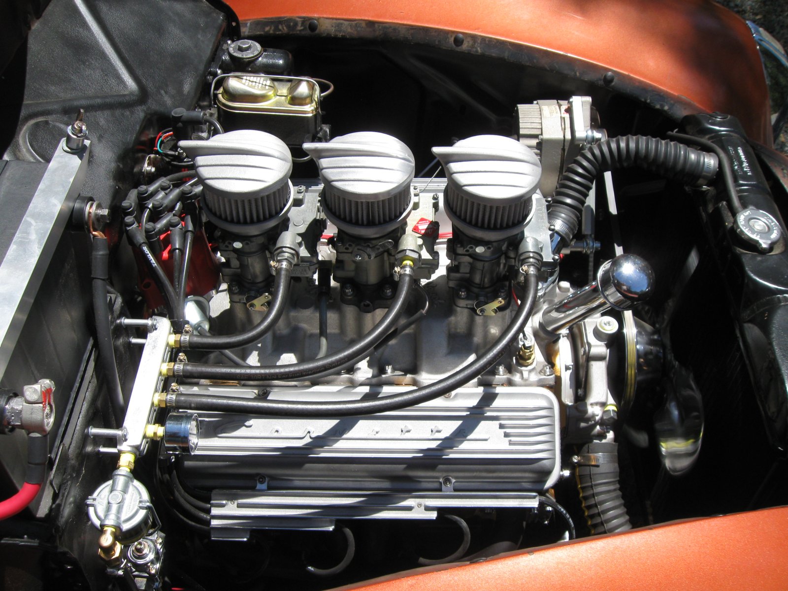

    The SBC fits well in the '39 engine bay, but it's a tad snug. Definitely check your clearance, Clarence! I put mine together without a shroud because I wanted to get it back together quickly... "I'll figure the shroud out later"... But it has never overheated as is, with the high volume water pump and 4 core copper radiator, so it is what it is. (Results may vary) Note the 4 blade fan... can't believe it works!!

    Small block chevy's were made for 39-40 fords :) and after almost 70 years of use in them I consider them traditional. A word of caution for you on that cast aluminum pan, If you are going to be running your car with low ground clearance you need to consider that they do not bend or dent when hit, but crack and leak at leak oil at the very least. I would consider a chrome plated steel oil pan if you need some shiny stuff under you car.
