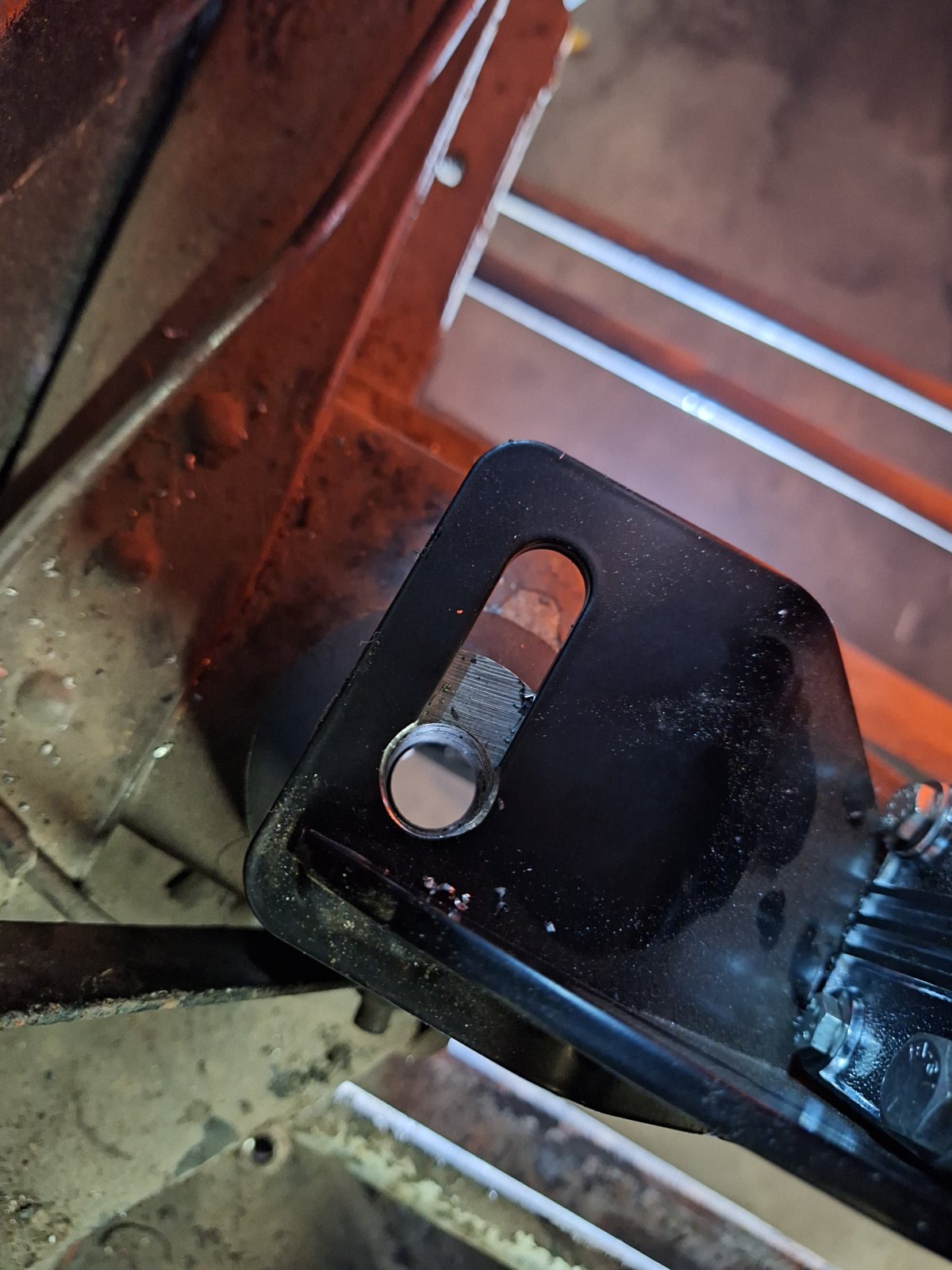

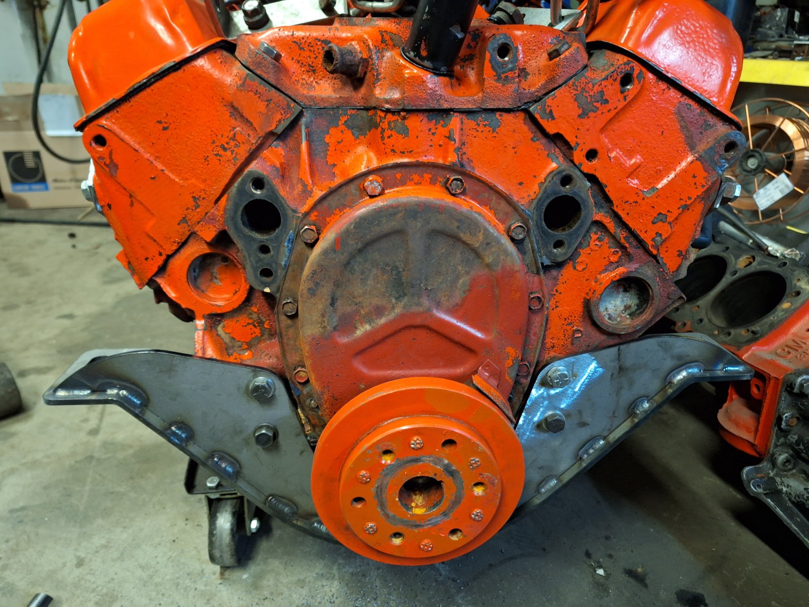

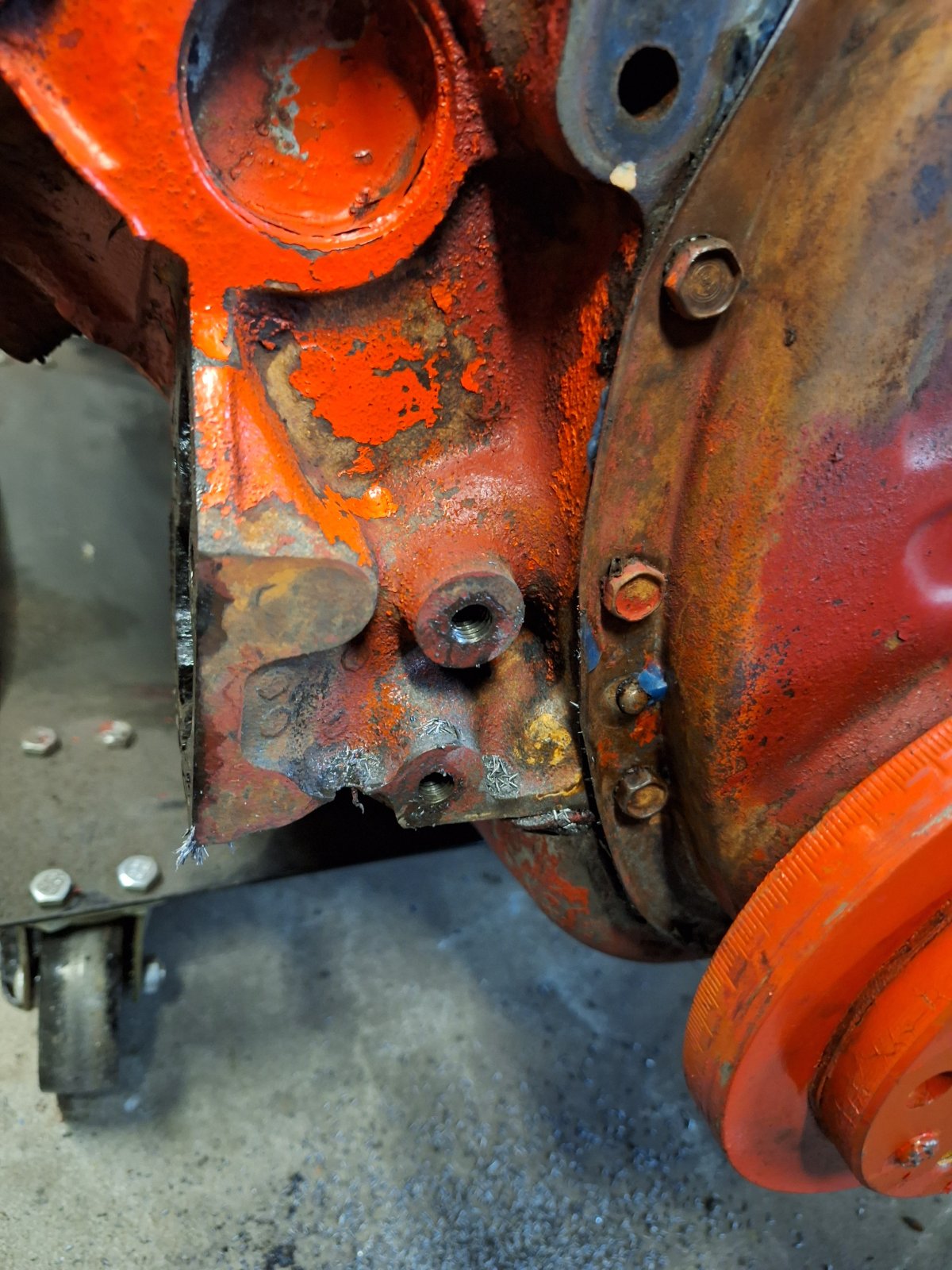

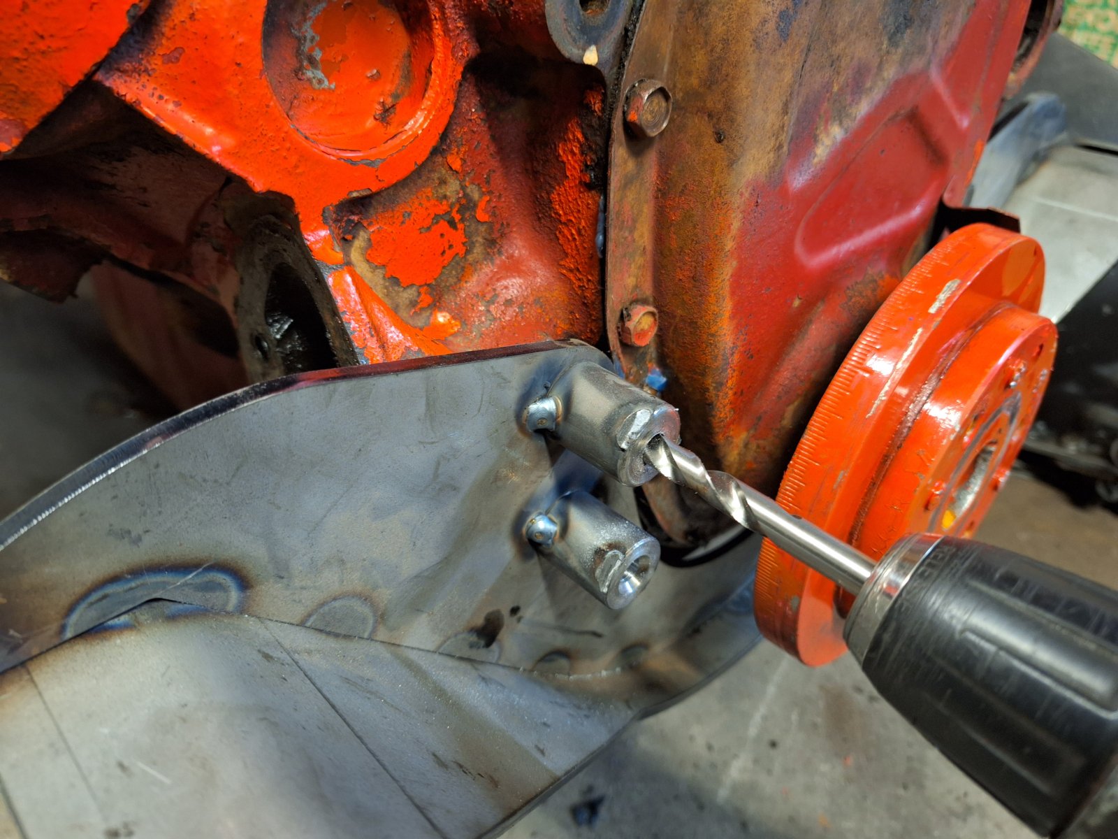

    My 283 was missing two of the holes for the front mount. This might seem like a small easy thing to fix but i hate to drill because i always get everything crooked and it have to go fast so im a measure once drill twice guy. This time was gladly not a **** up time and it came out good.

    The upper right side goes into the cavity behind, where the fuel pump push rod is. Did you clean the shavings out?

    Yeah i read that when i was searching for what thread the holes had (i got the metric system so im not so sure about inch) but thanks for the heads up. I will block the fuel pump off and took the push rod out, the original pump wont fit with the front engine mount.

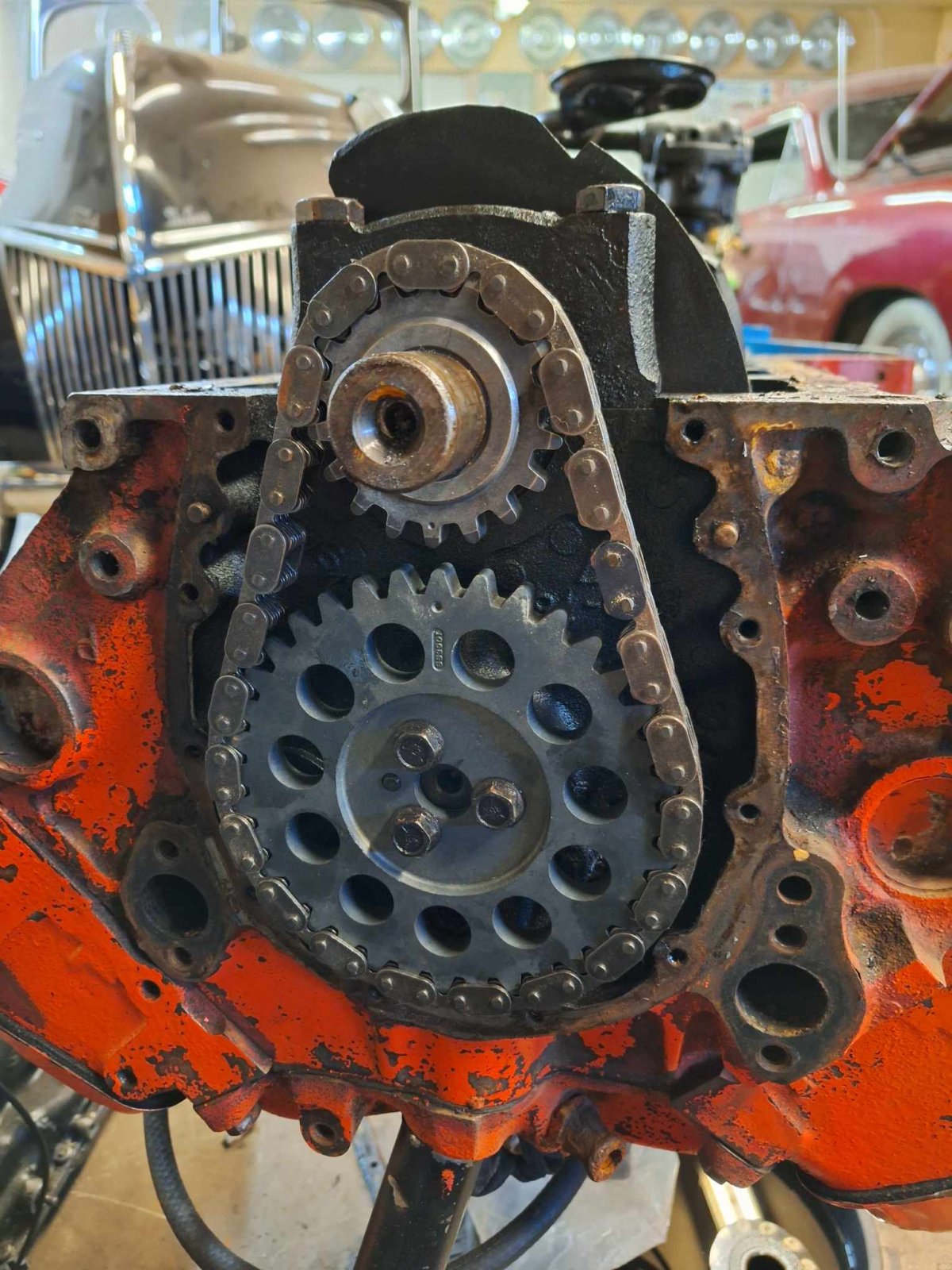

    Gettin the 283 ready and when i took the oilpan and timing chain cover off i found that one bolt for the front main bearing cap was missing :eek:
    This engine was running this summer, i dont have any high hopes now that ive seen that the bolt was missing but i just put a bolt in and hope for the best.
    Also changed the timing chain and some expansion plugs.
    It might work and it might not work, we will find out when i fire it up for the first time.

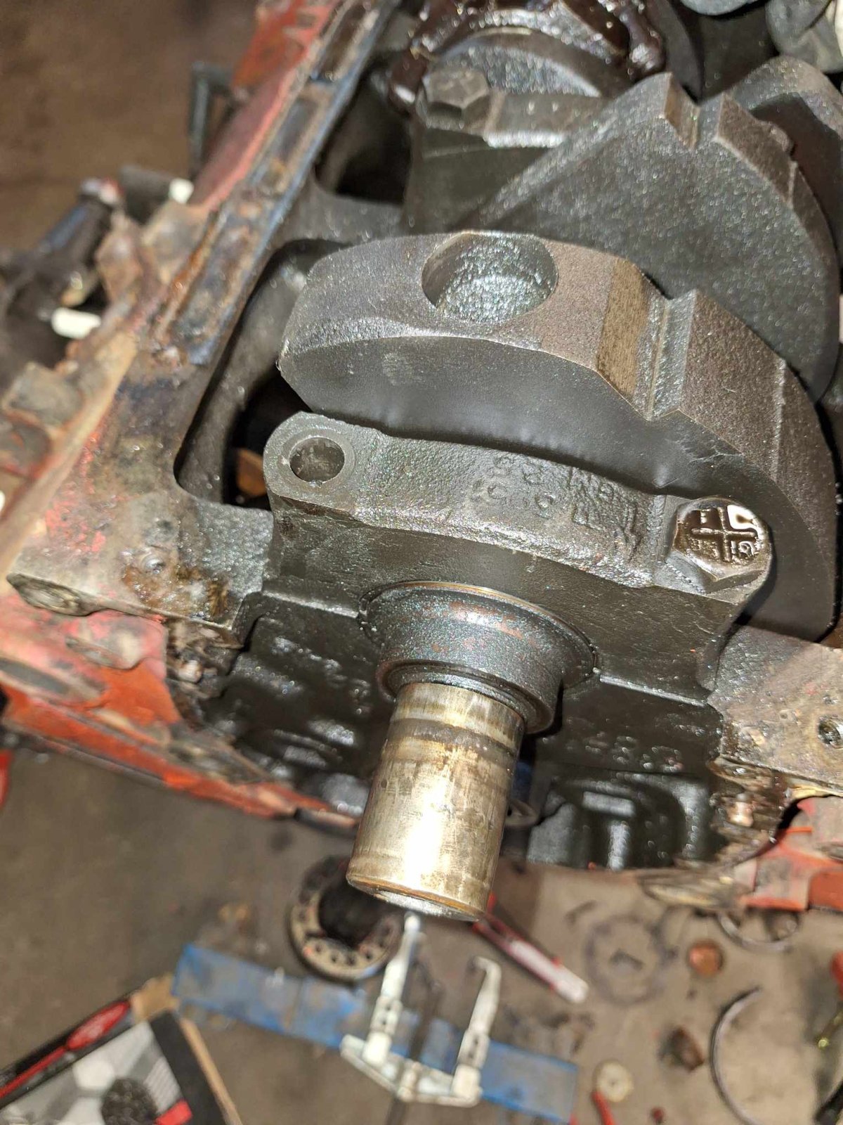

    Well i got the crank mains off and its shot, seems ive been ripped off.
    It ****s because its kinda hard to find a 283/327 here.

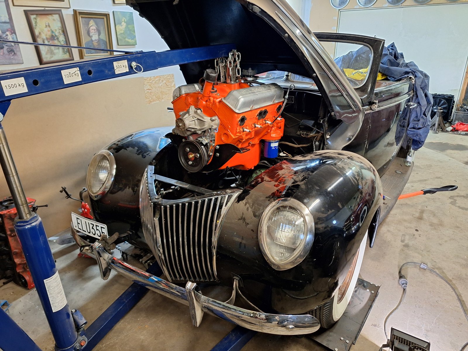

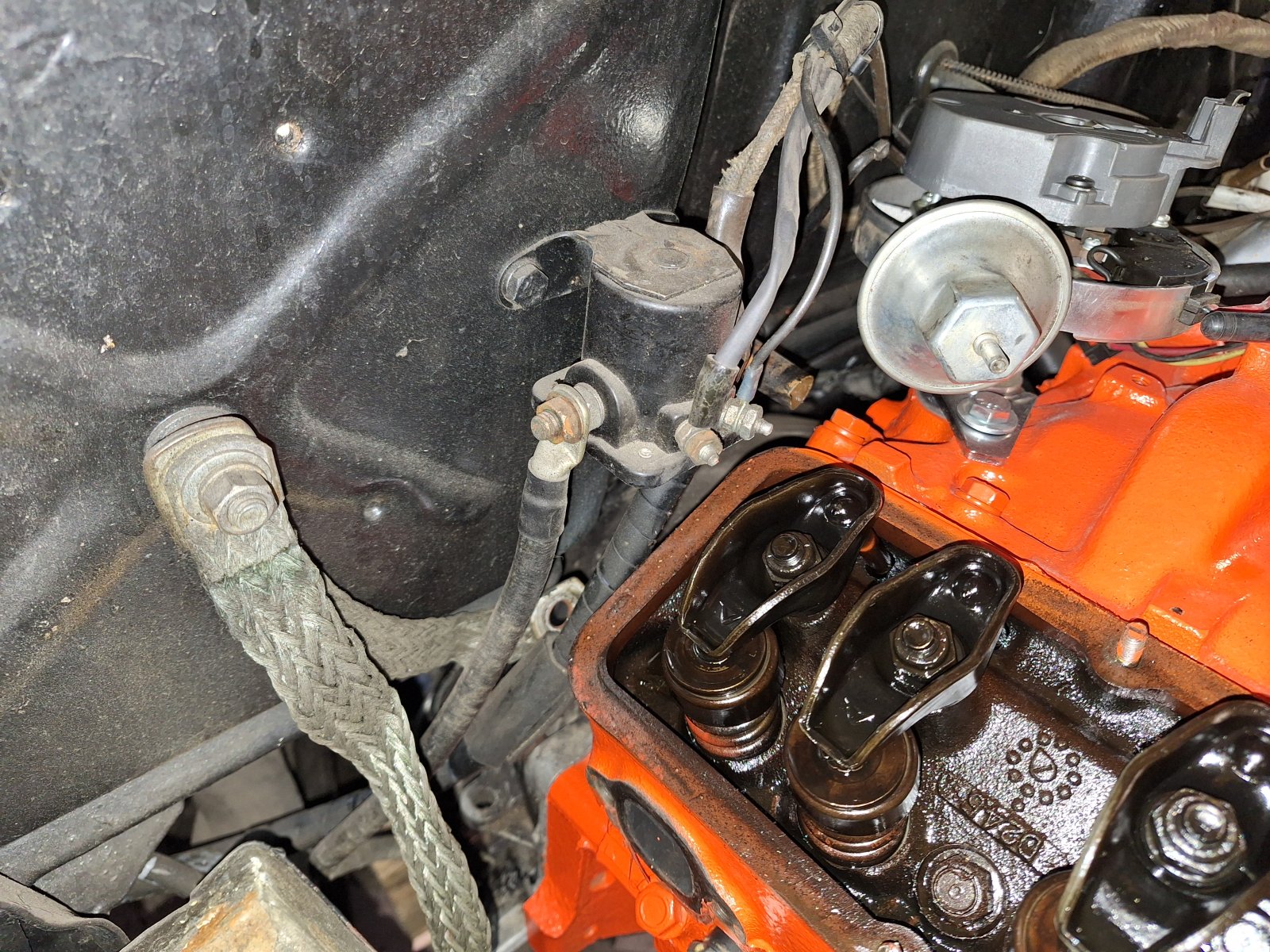

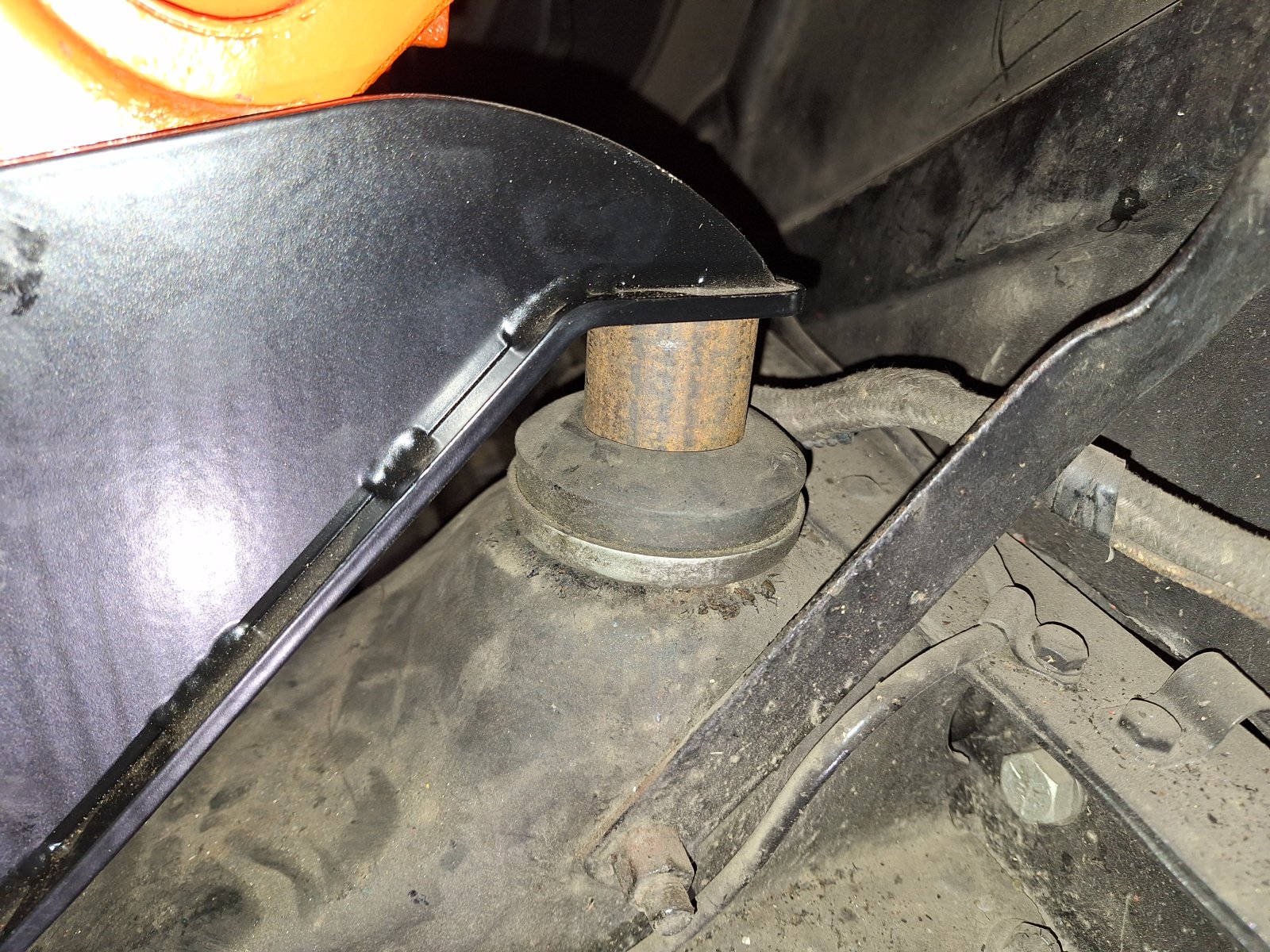

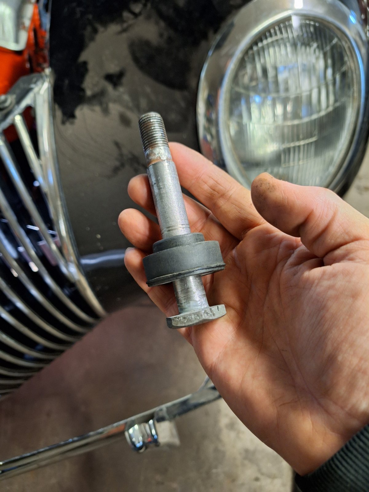

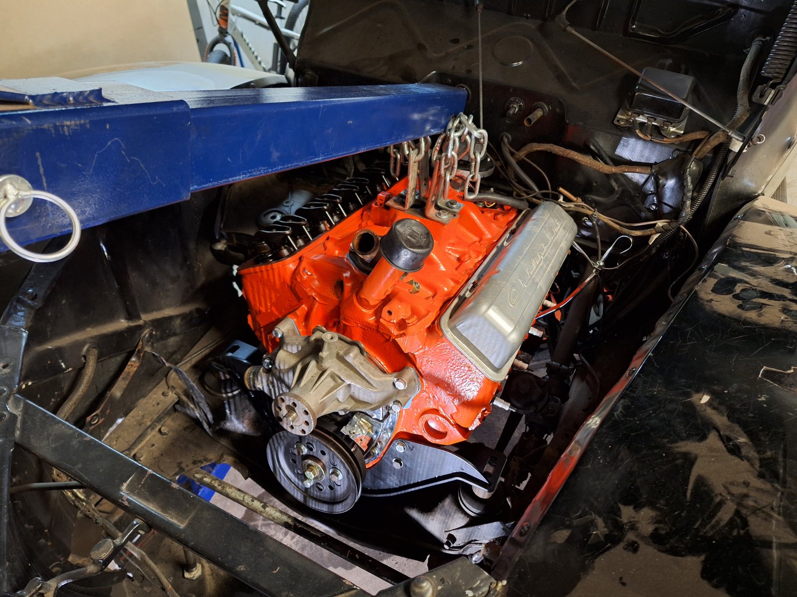

    Well got my hand on another 283, got it mounted and bolted in place.
    Did som spacers for the motor mounts to raise the engine a bit.
    The big bolts for the motor mounts are old rear shock mounts from a 49 Ford connected to the original bolt, had to drill the motor mount a little for the bigger bolts.
    The starter relay was hitting p***enger valve cover, other than that nothing was in the way and the relay is a easy fix. 20240213_125345.jpg 20240213_131009.jpg 20240213_131025.jpg 20240214_111552.jpg 20240214_111922.jpg 20240213_131038.jpg

    I had a similar issue w/the solenoid's position & so I moved it inside the cabin; cleaner firewall & not so easy for un-authorized hot wiring via some scoundrel.

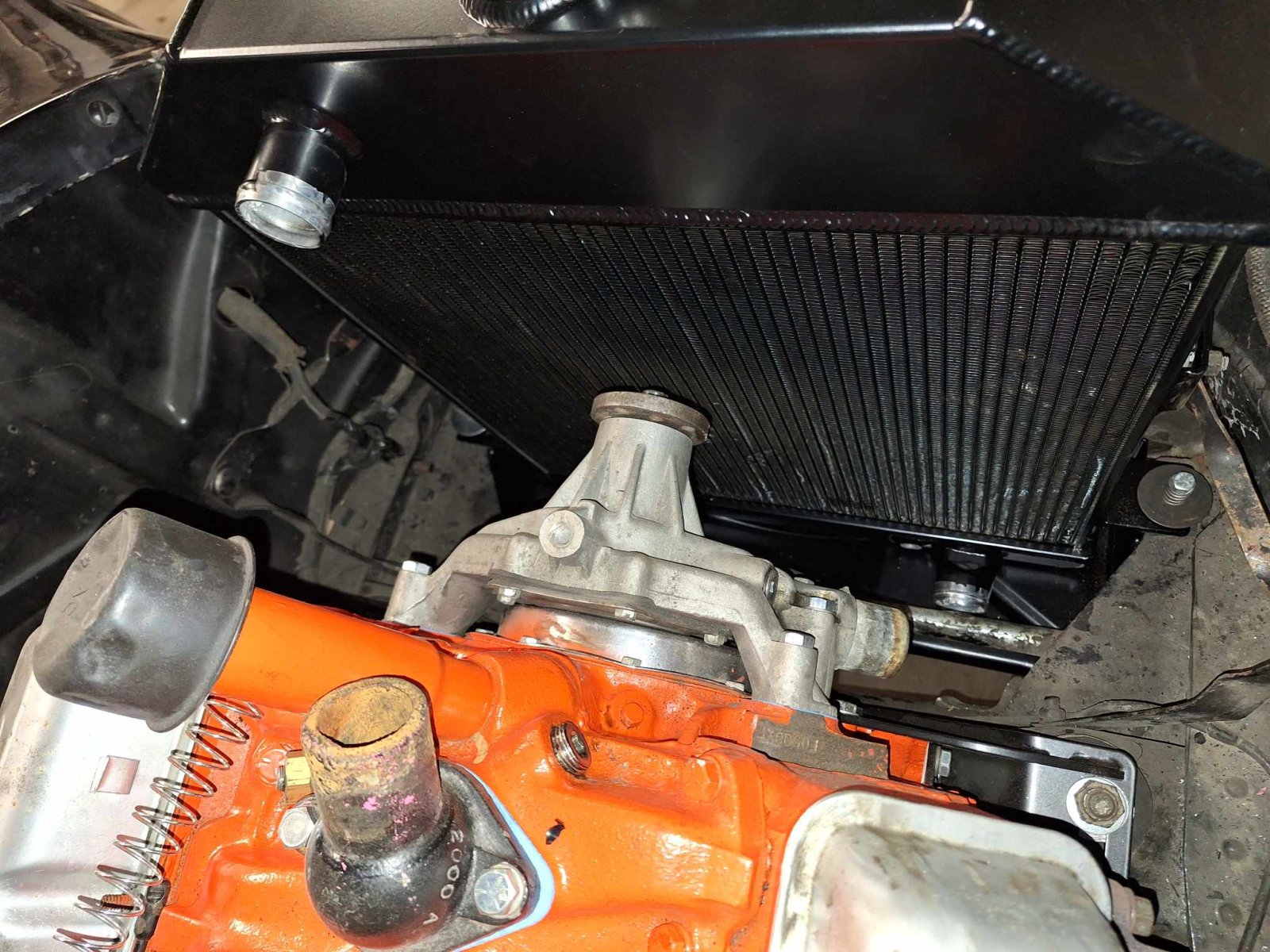

    Minor update, got the radiator/lower radiator pan and a pulley powdercoated.
    Now the radiator is in place and i have to find some fitting hoses.
    The original plan was to rebuild the original radiator but time and money got in the way so the easy solution was a new aluminum radiator.
    It kinda ****s with a modern radiator but it got better with some black paint and i still have the original radiator that will be rebuilt when time comes.

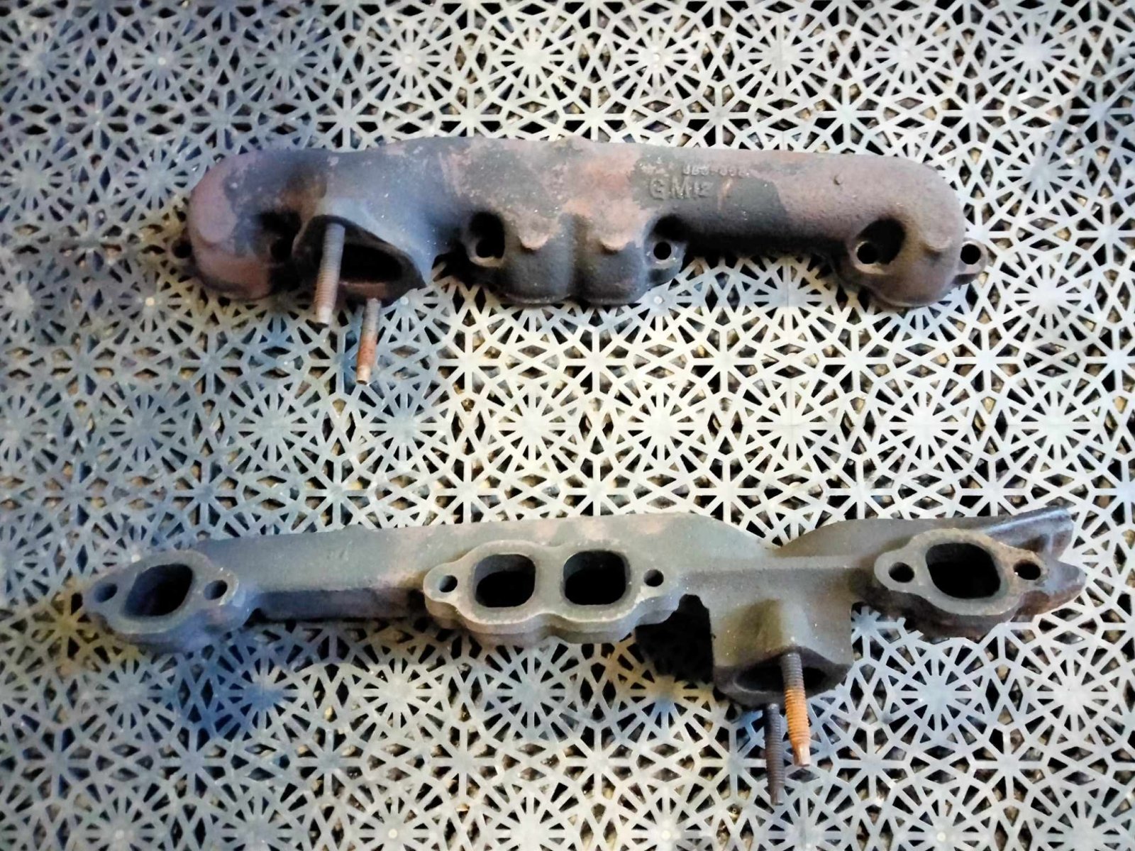

    Also got lycky and got a pair of 265 manifolds for a case of beer, needed those for clearence.
