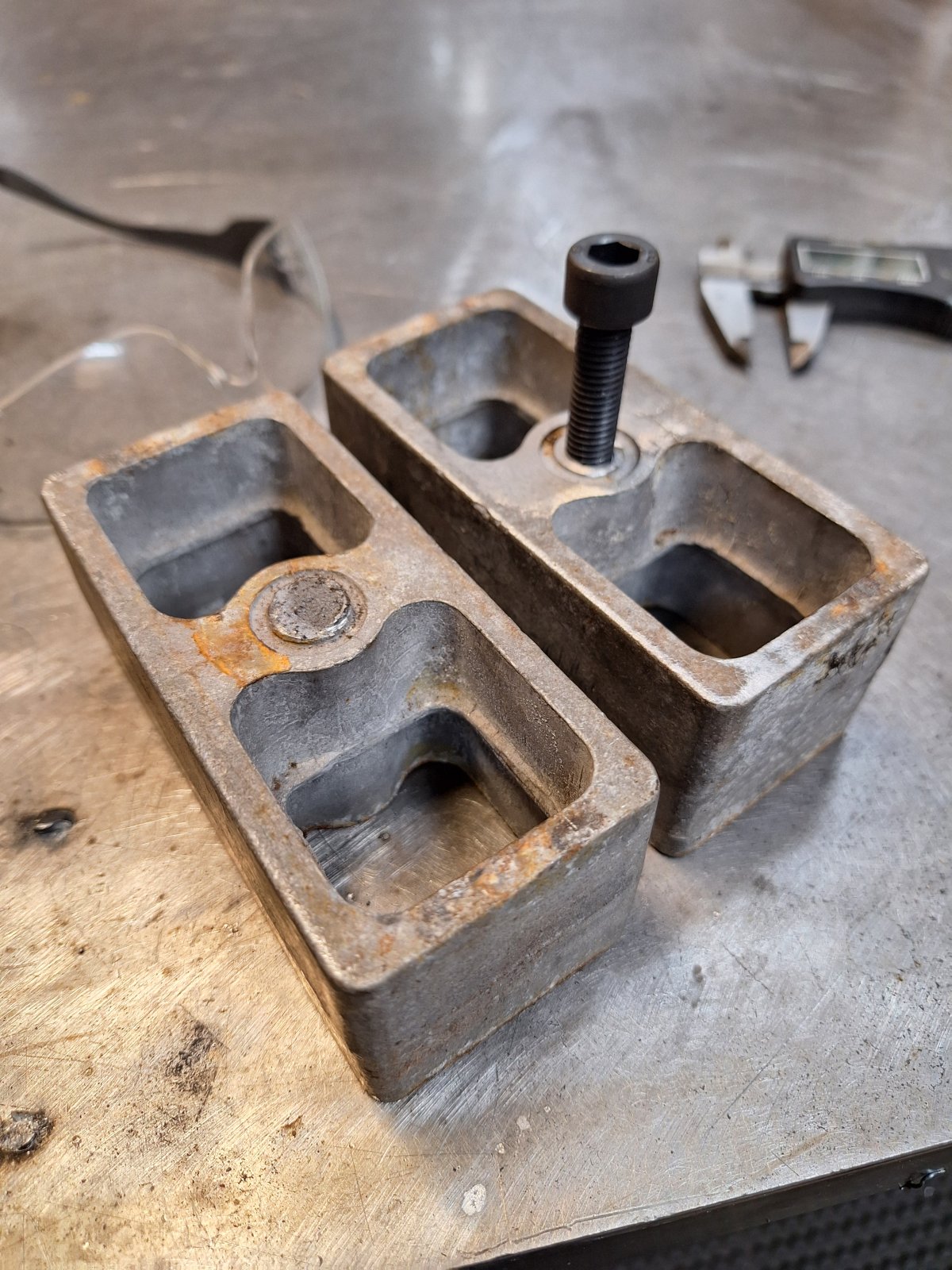

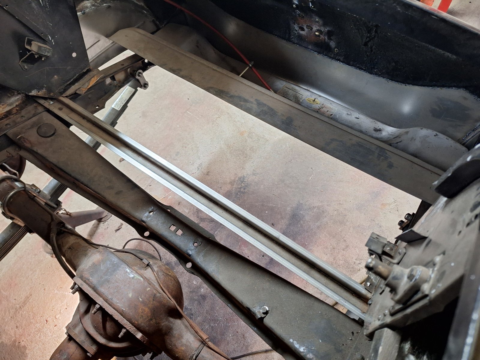

    Got the rear axle dialed in at the right angle and welded the mounts.
    Had a couple of old 2 inch lowering blocks with the steering tap broken of, some drilling and thread and cheap *** me could use them.
    Now the rear axle is bolted in place. 20240303_113728.jpg 20240303_115223.jpg 20240303_101759.jpg 20240303_130229.jpg

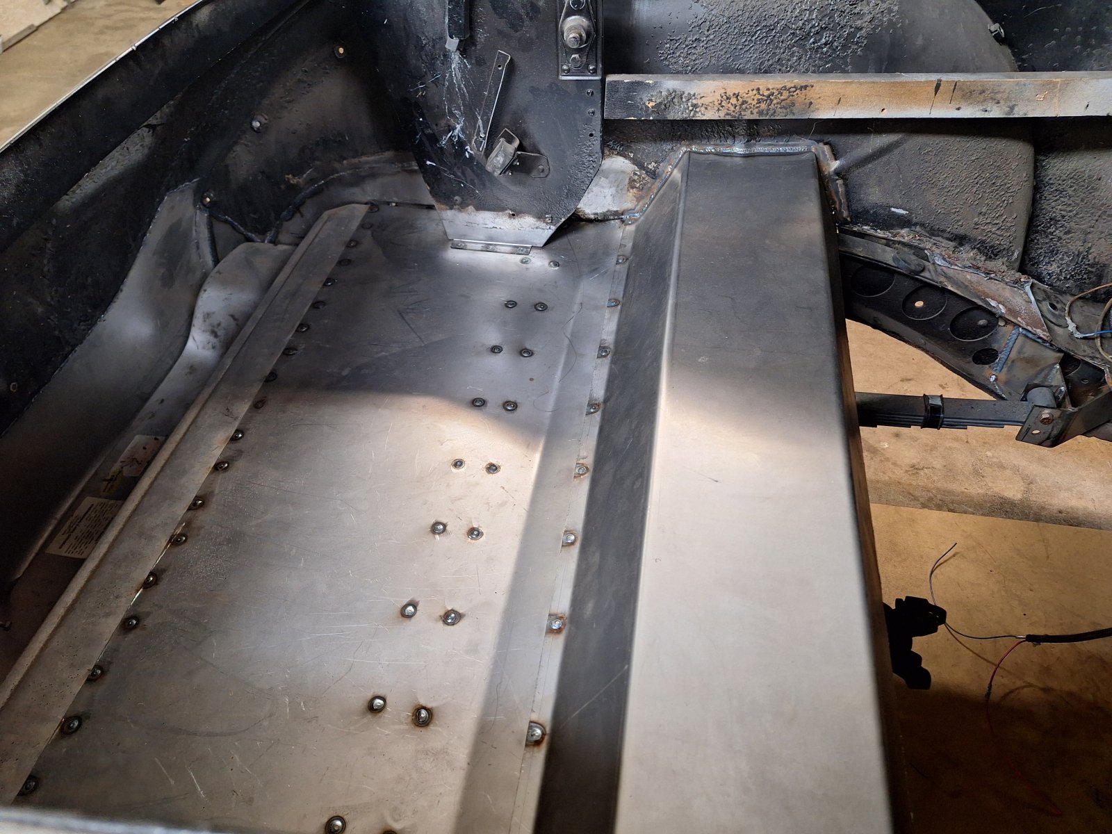

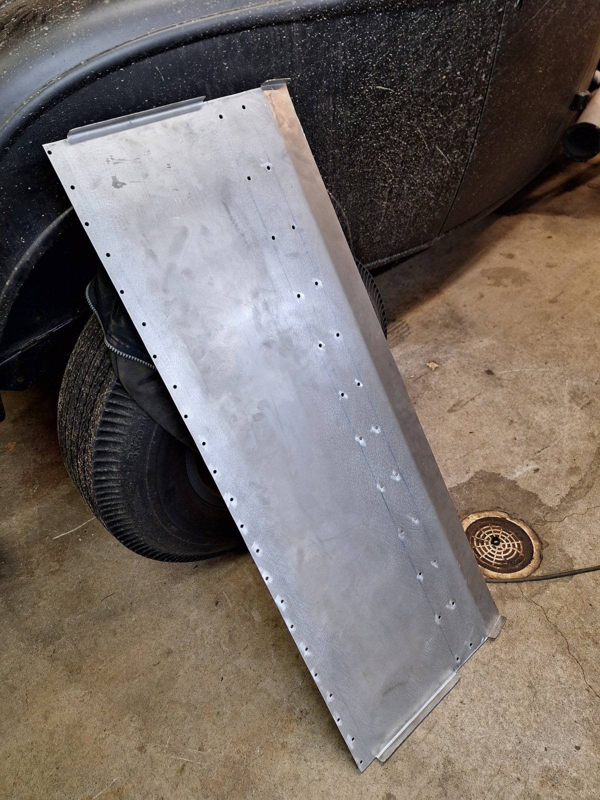

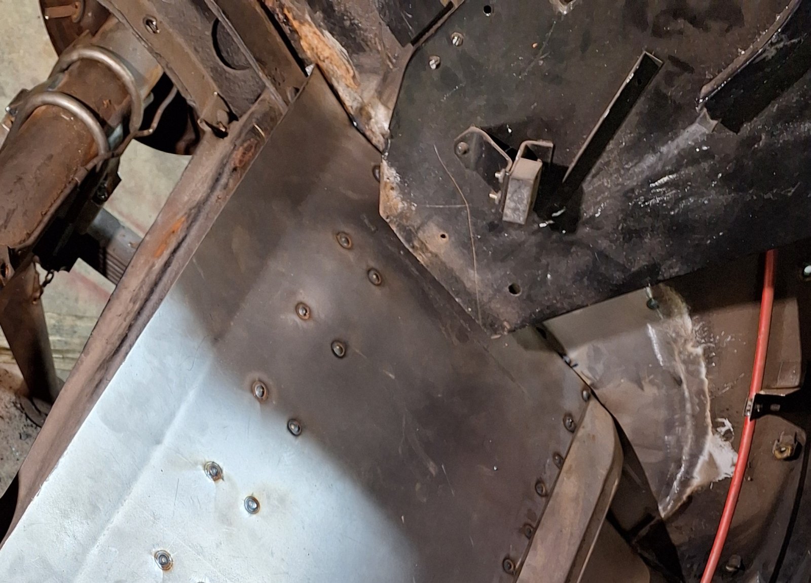

    Got some more of the trunk floor in.

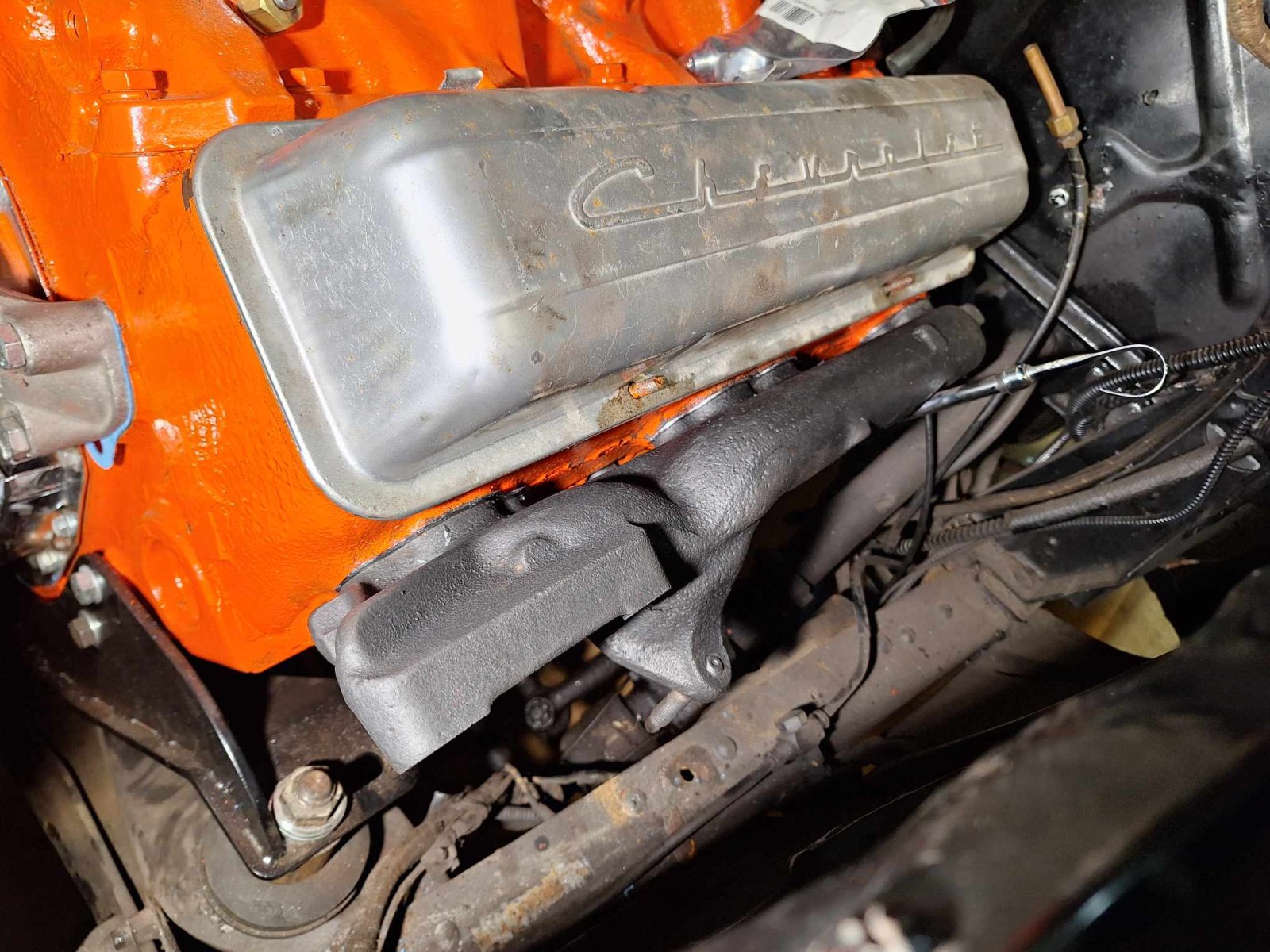

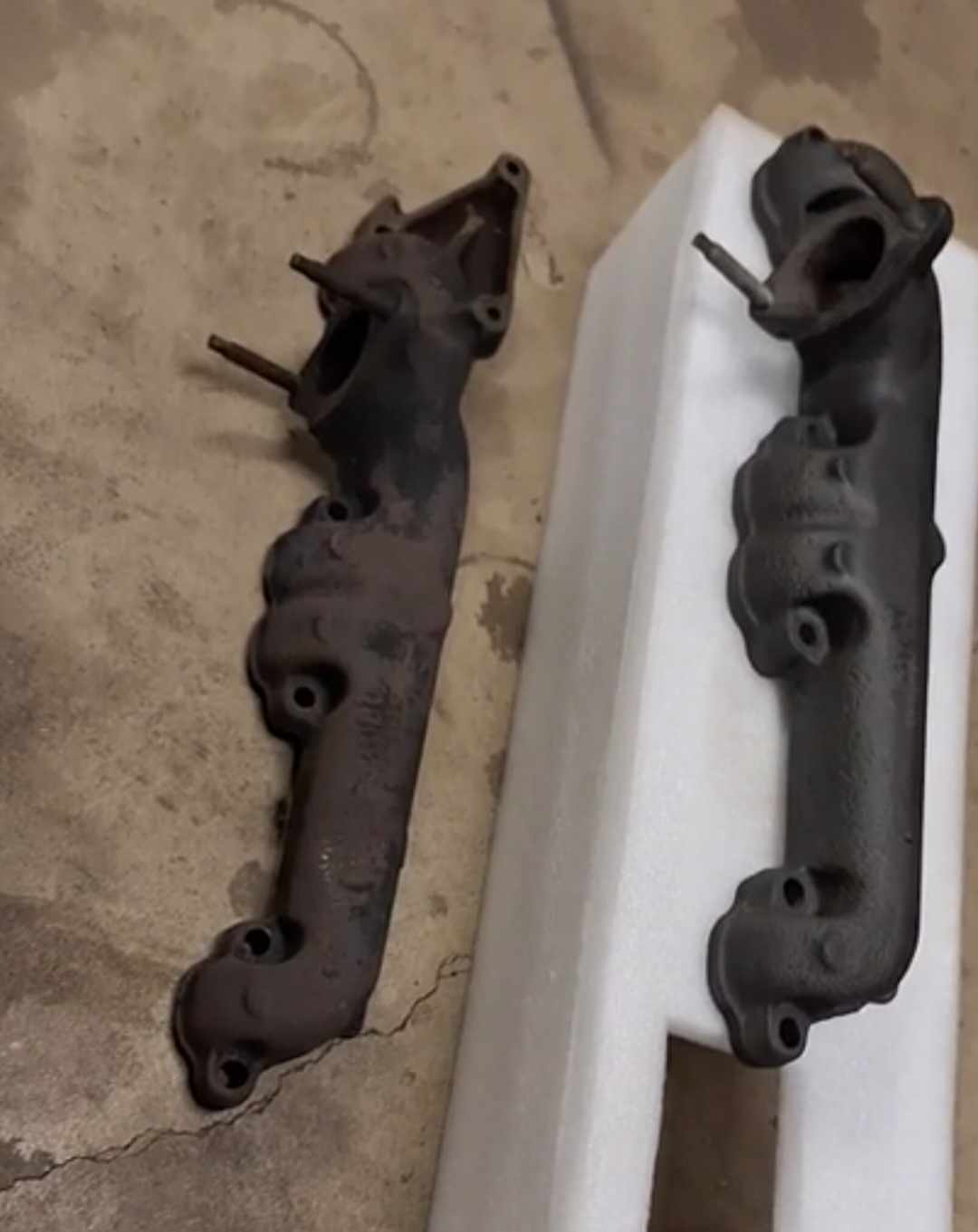

    Sandblasted the manifolds and put on some stove polish, also made flanges for the exhaust system.
    Its gettin closer and closer to first start up. grenrör.jpg grenrör fläns.jpg grenrör monterat1.jpg grenrör monterat.jpg

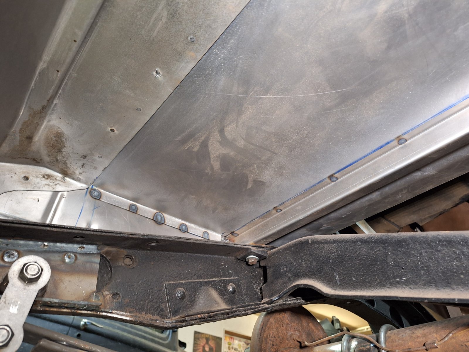

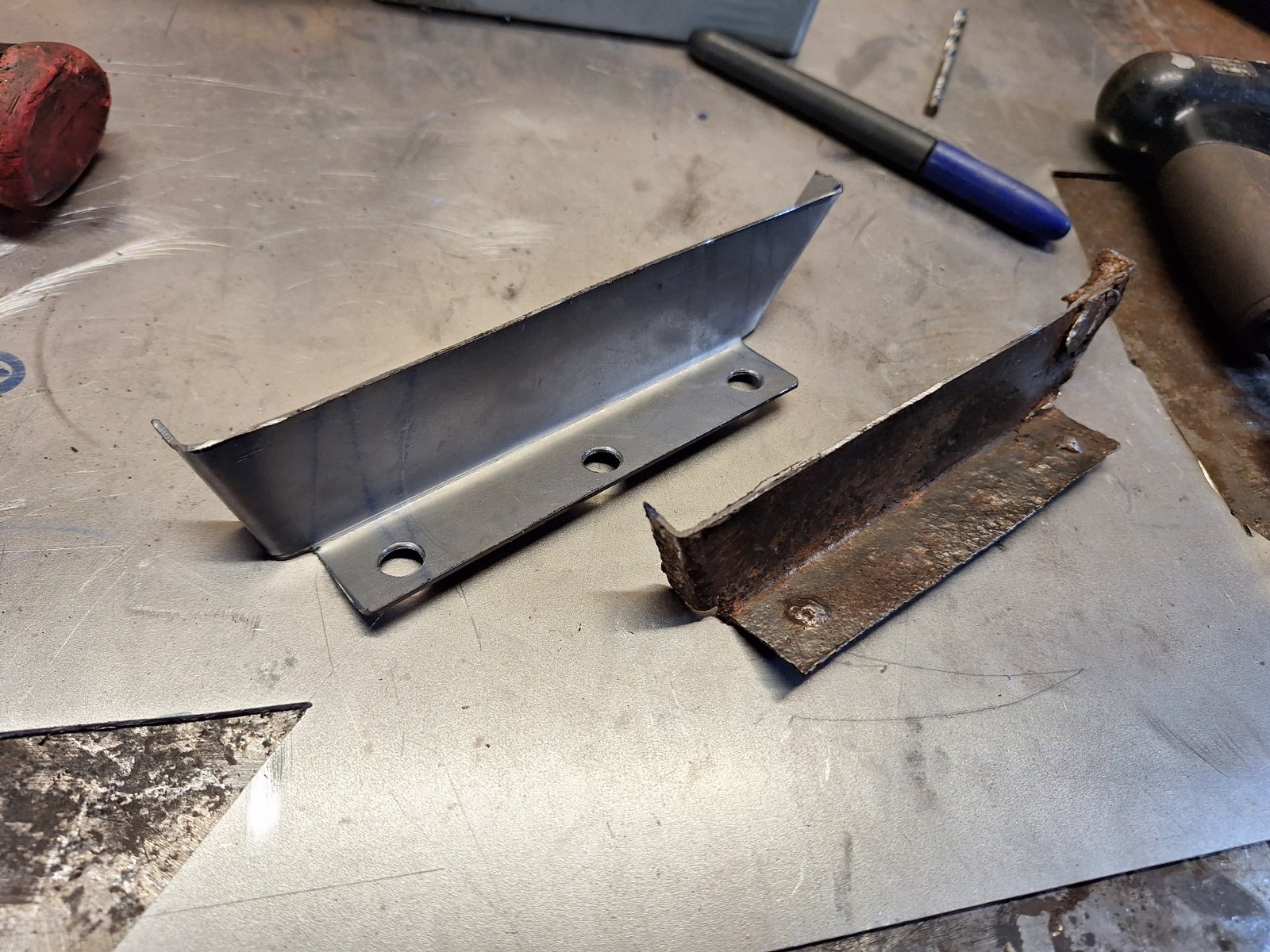

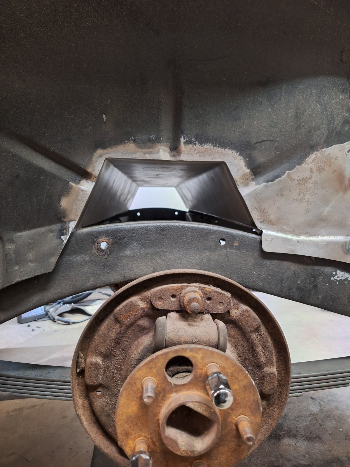

    Som rust repair, bottom of the trunk reinforcments/trunk mounts on both sides got done. 20240309_165941.jpg 20240309_095953.jpg 20240309_132659.jpg .

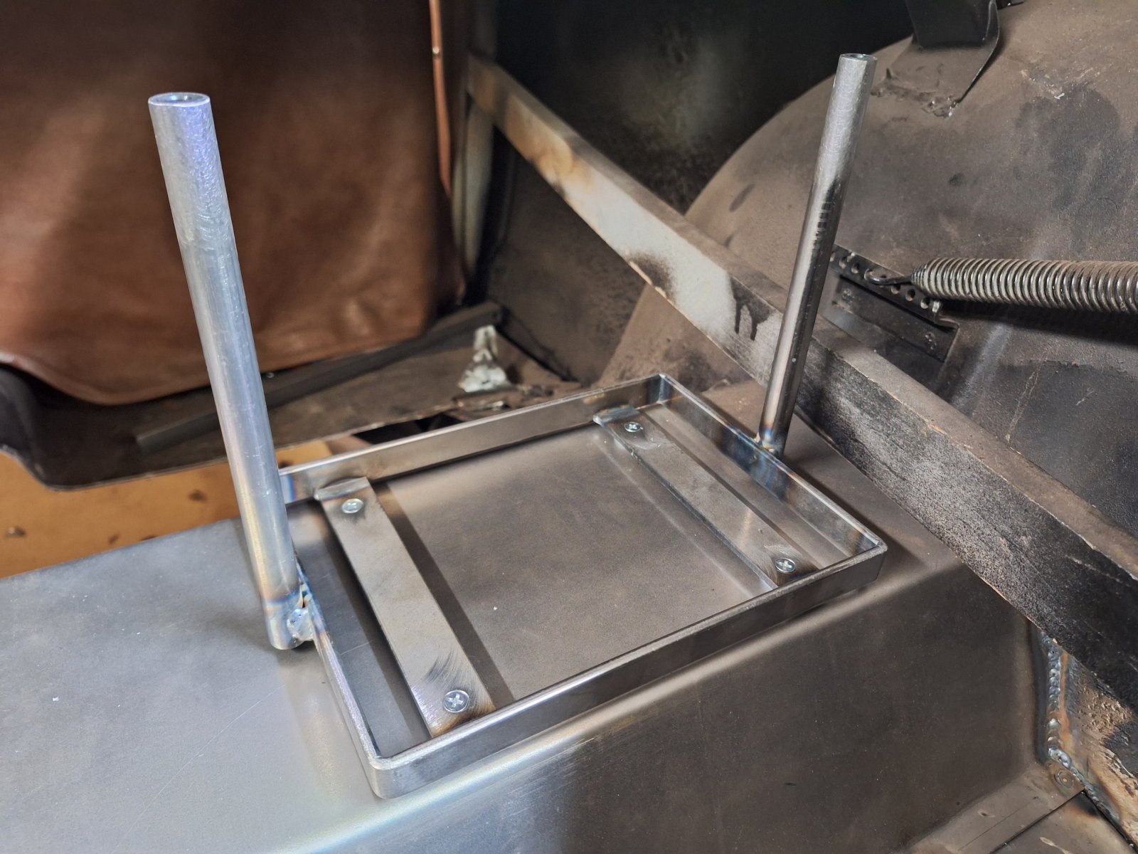

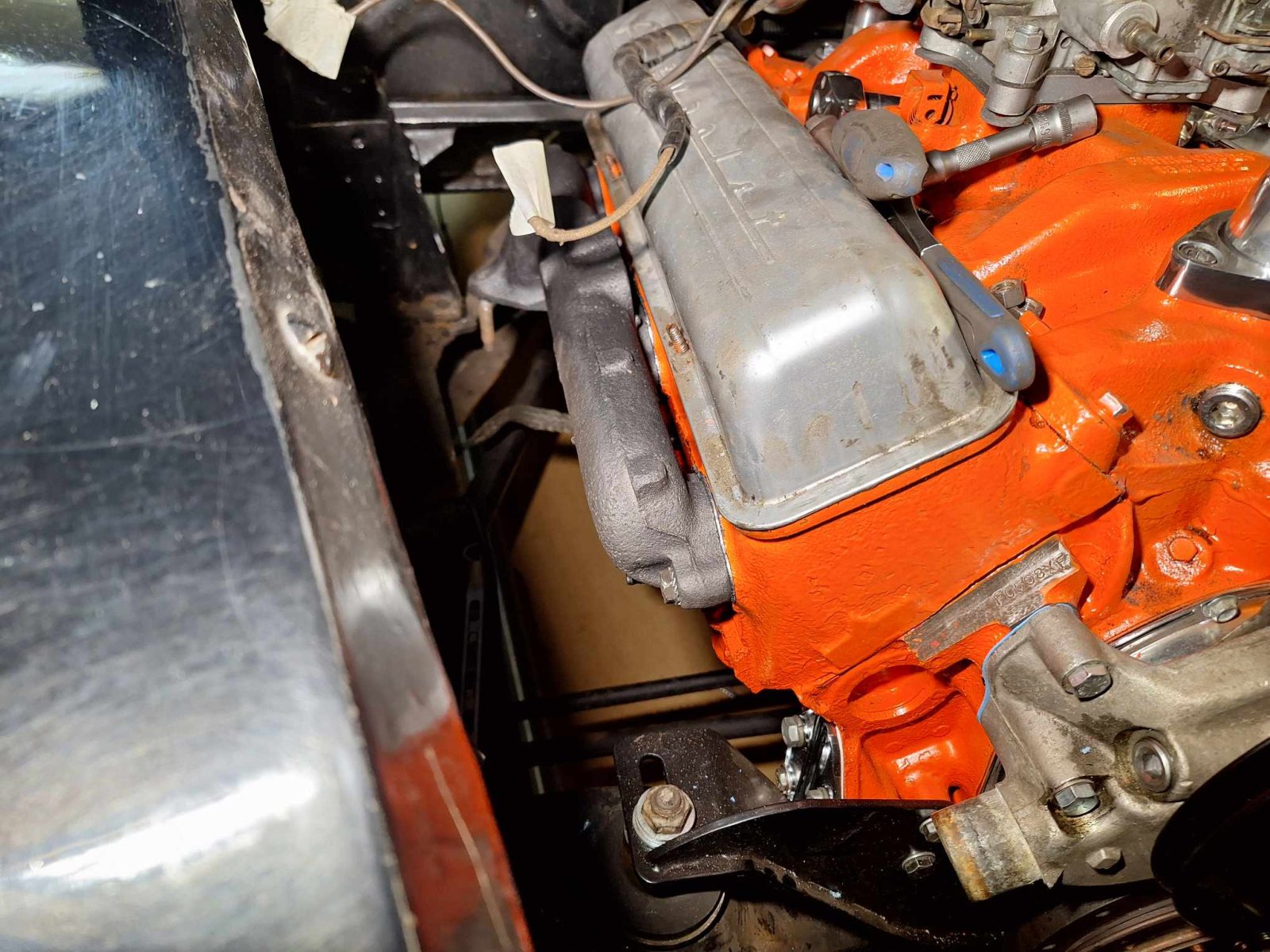

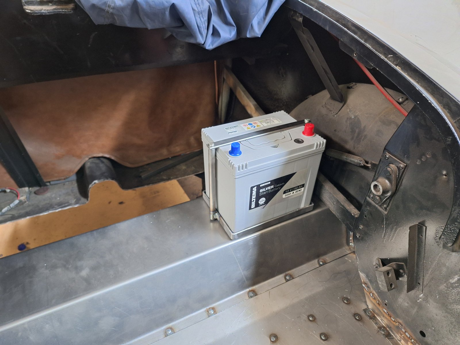

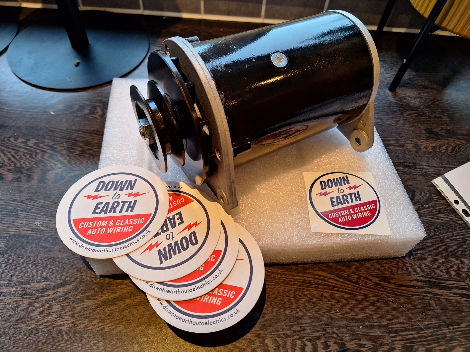

    Some progress, got the gas tank mounted and a fuel pump/fuel lines.
    Also made a battery box that i mounted in the trunk instead of the engine bay that was to tight.
    Bought a new generator from https://downtoearthautoelectrics.co.uk/
    These are 12V internally regulated with only two wires.
    Made a bracket to fit the original mounting holes on the 265 manifold.
    I had about 25 different fan belts layin around and guess what, non of them fit... 20240313_164434.jpg 20240315_195240.jpg 20240315_193700.jpg 20240315_195217.jpg

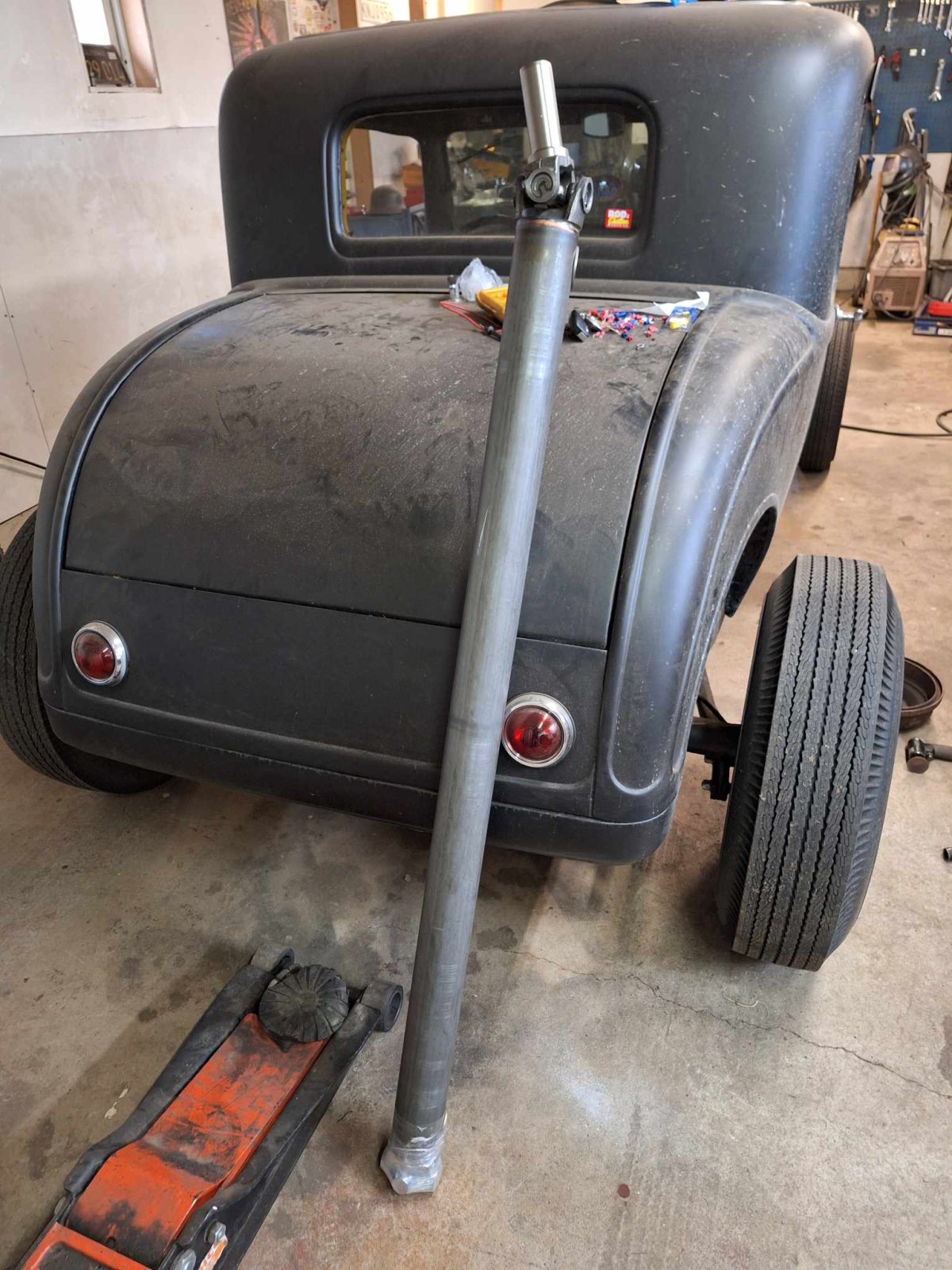

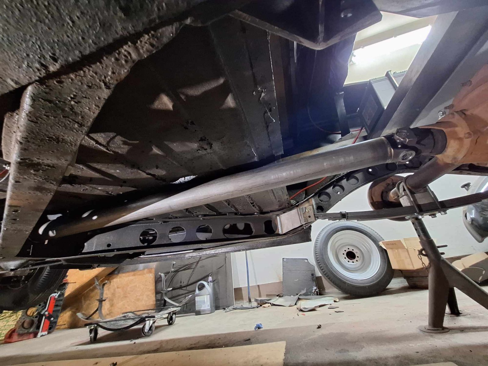

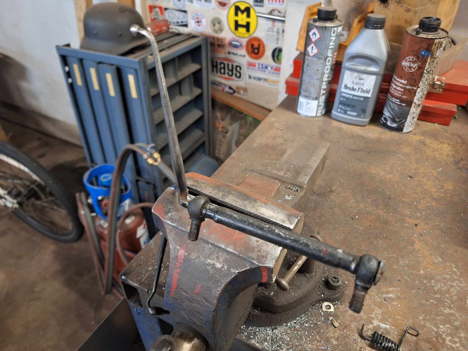

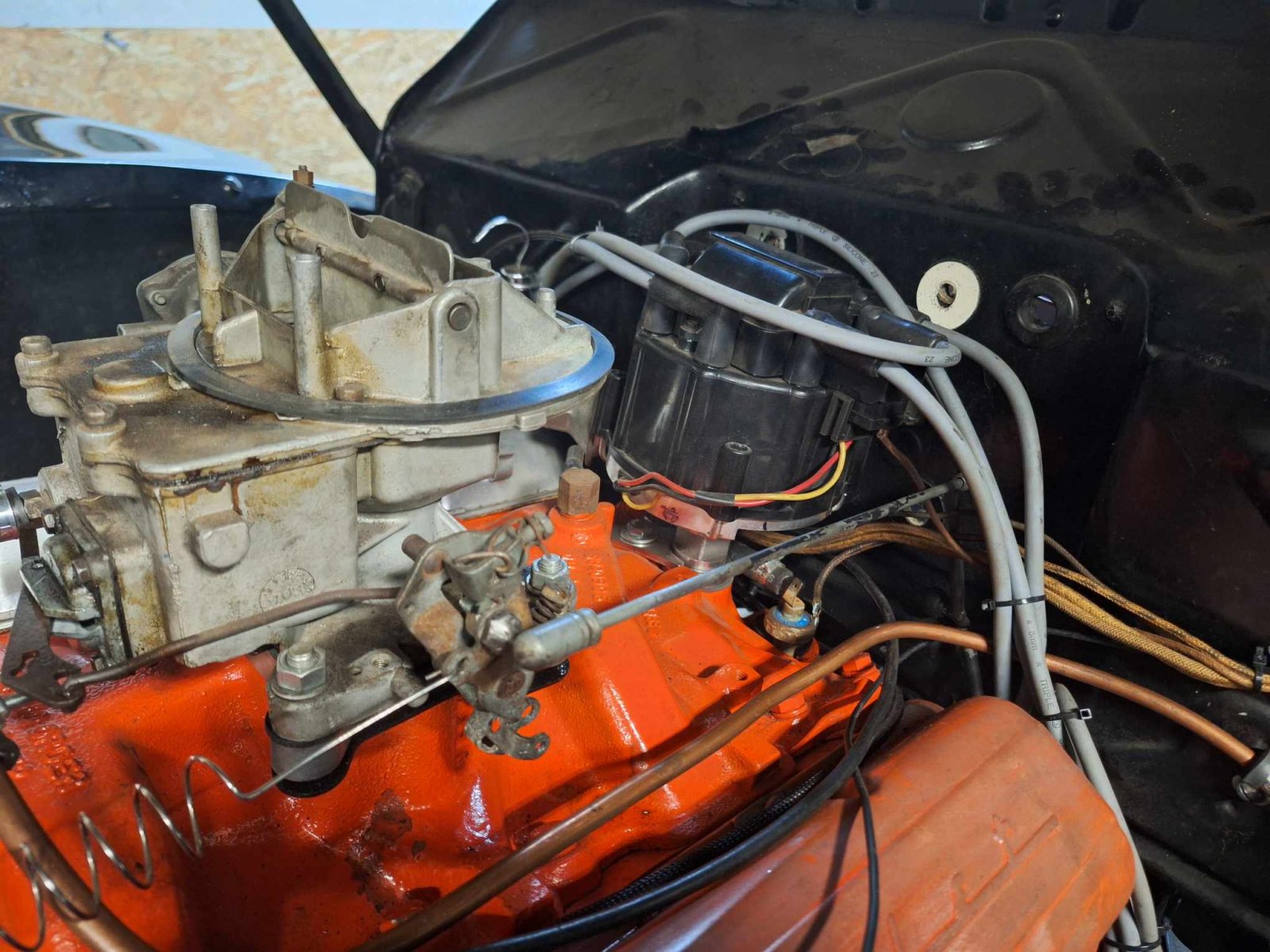

    Got the gas pedal hooked up, used the original parts but moved the linkage to the drivers side.
    Also got my new driveshaft and mounted it.
    Connected the starter and generator so i can start the car with the original push ****on and also got it charging.
    gasstag original.jpg gasstag.jpg gasstag fugge.jpg kardan.jpg kardan monterad.jpg

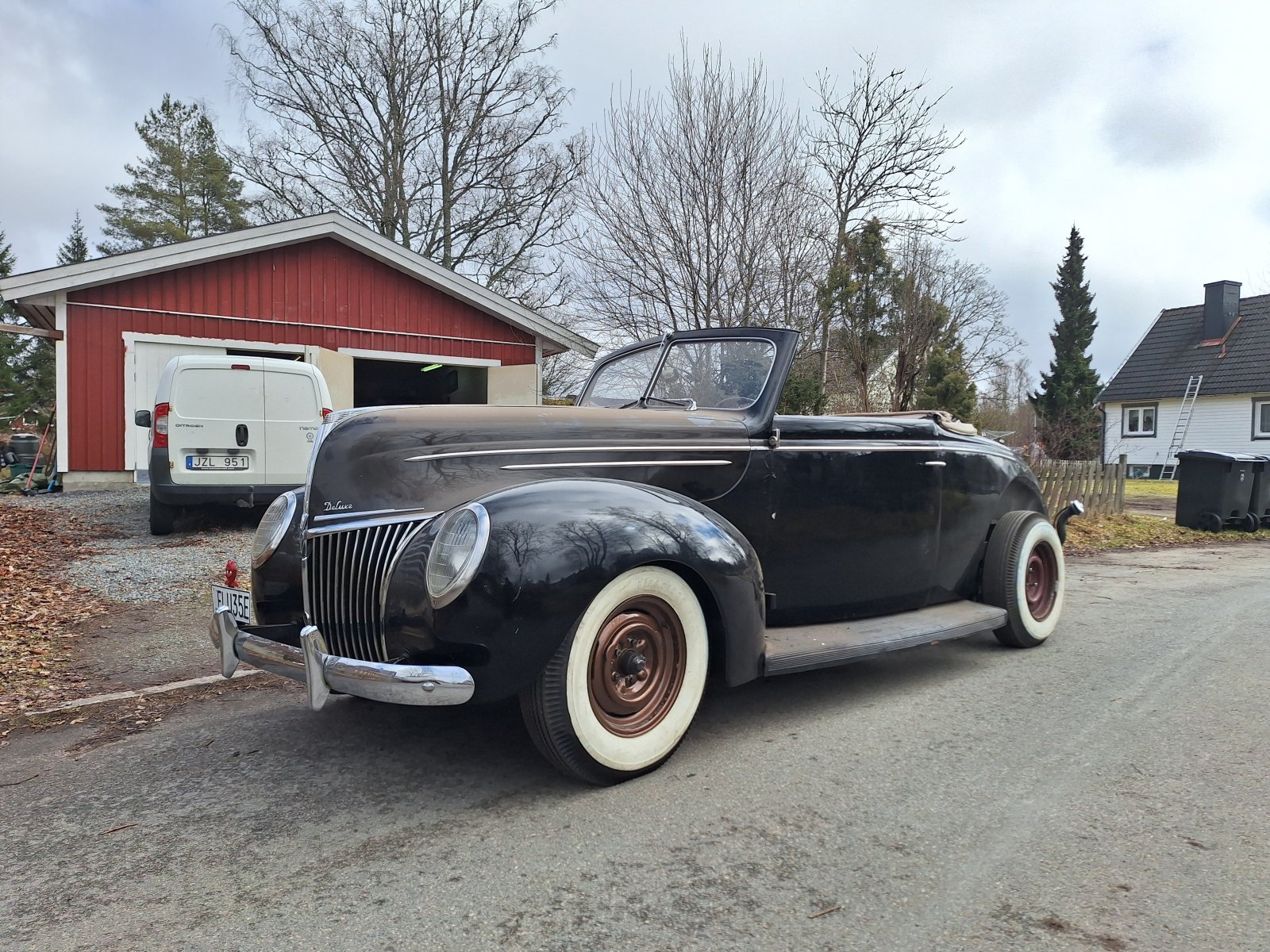

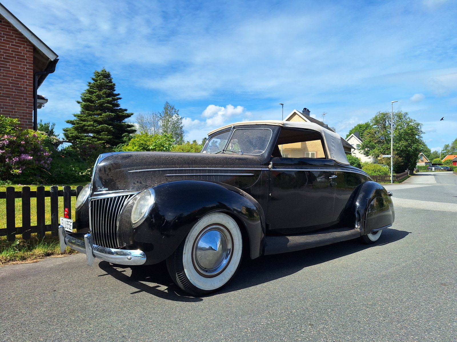

    Well the 39 is now a driver, i havent updated alot here but i just bolted on the fenders and made a exhaust system and alot of small stuff to get it driving.
    Still alot of stuff to do and it looks way better in photos than in real life. 453723347_3664298723880133_6835404887068384924_n.jpg 453883045_3664298677213471_2191439132512094907_n.jpg 453656332_3664298653880140_966954989511958178_n.jpg
