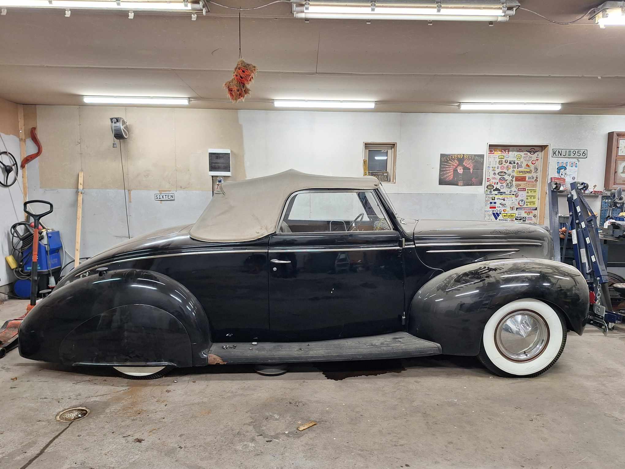

    Made a pair of 4-inch blocks and mounted them to see if there were enough clearence, everything seems fine so now i will start vith boxing the inside of the kickup.
    This is how it sits now.

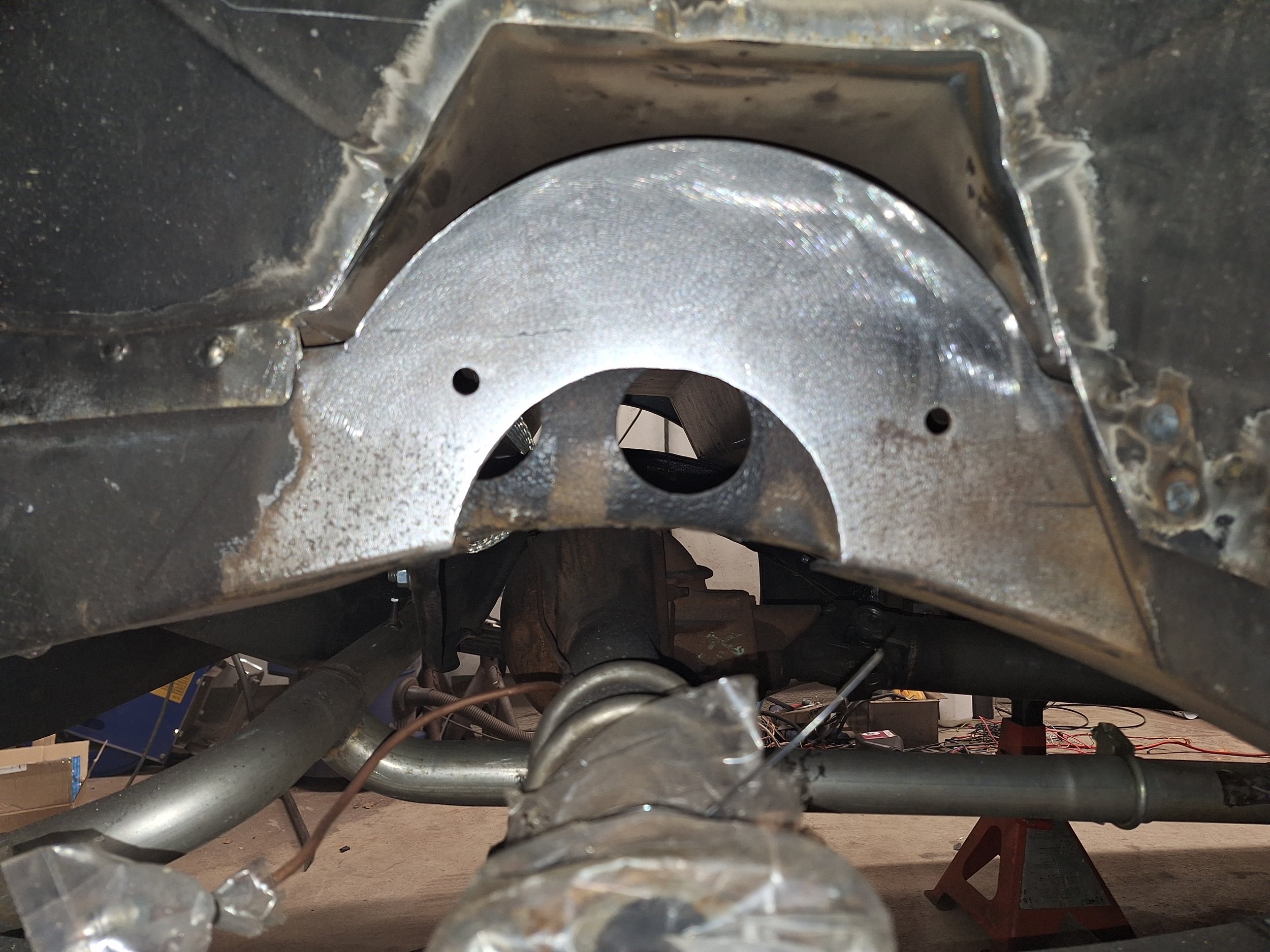

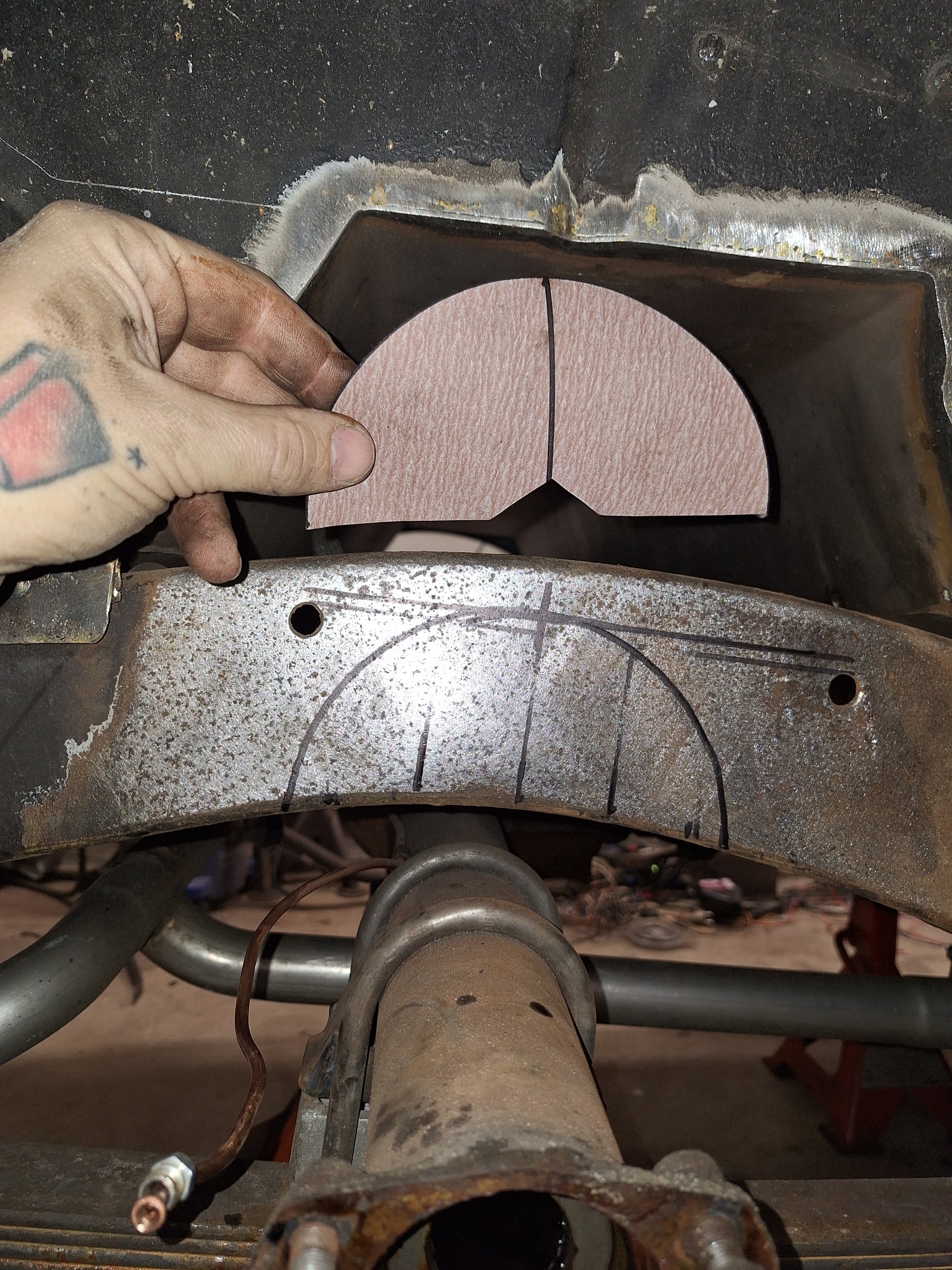

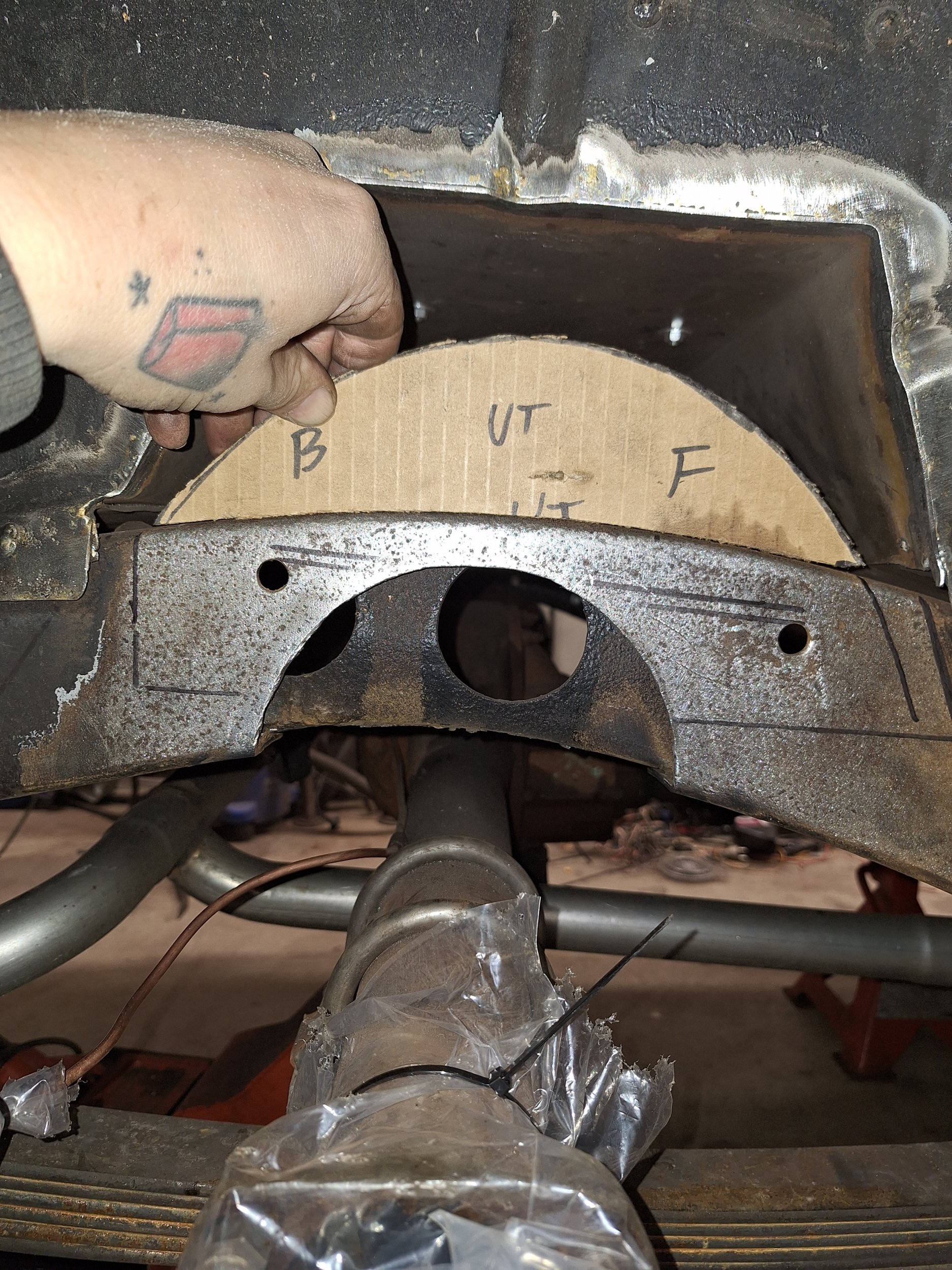

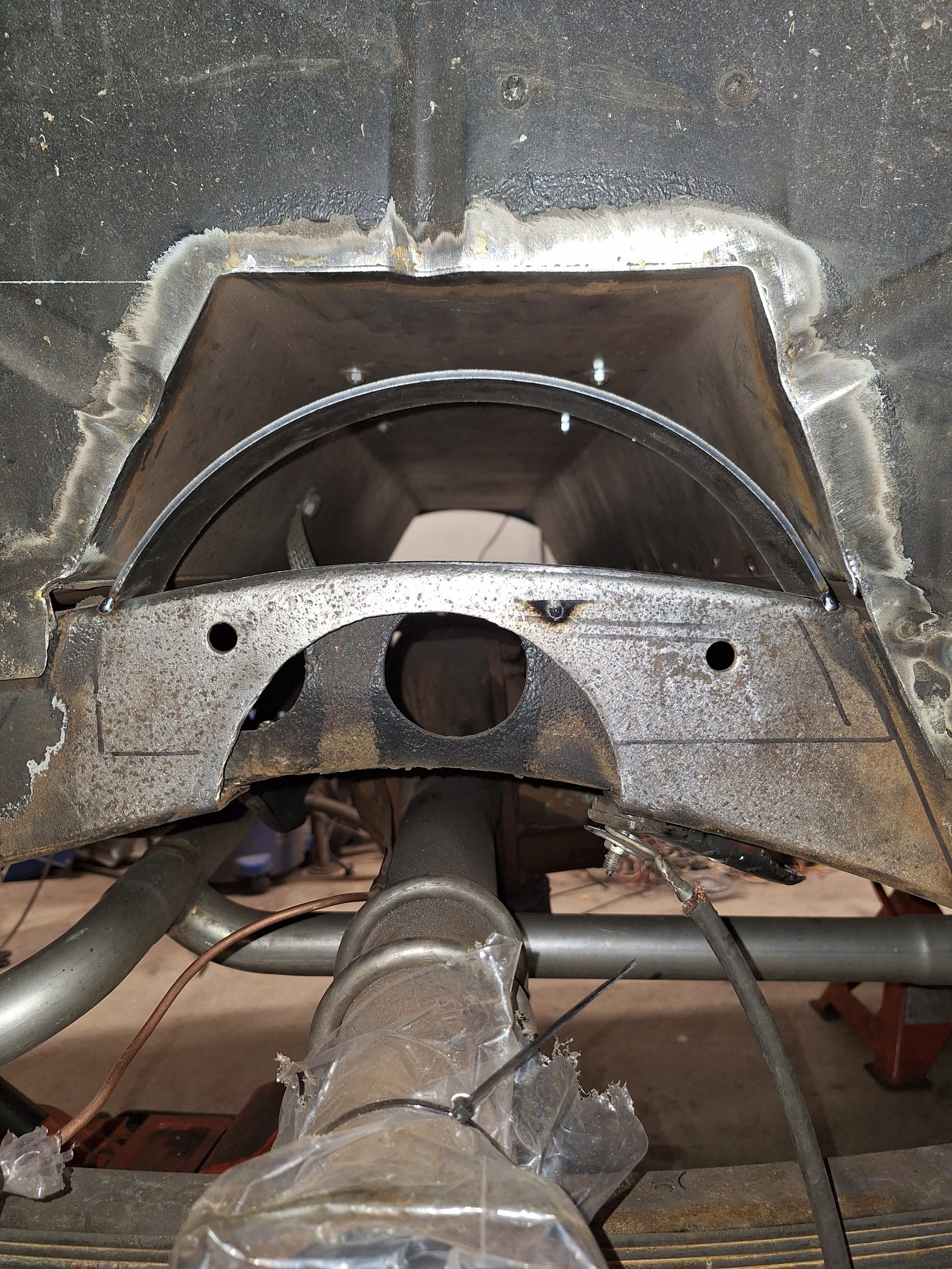

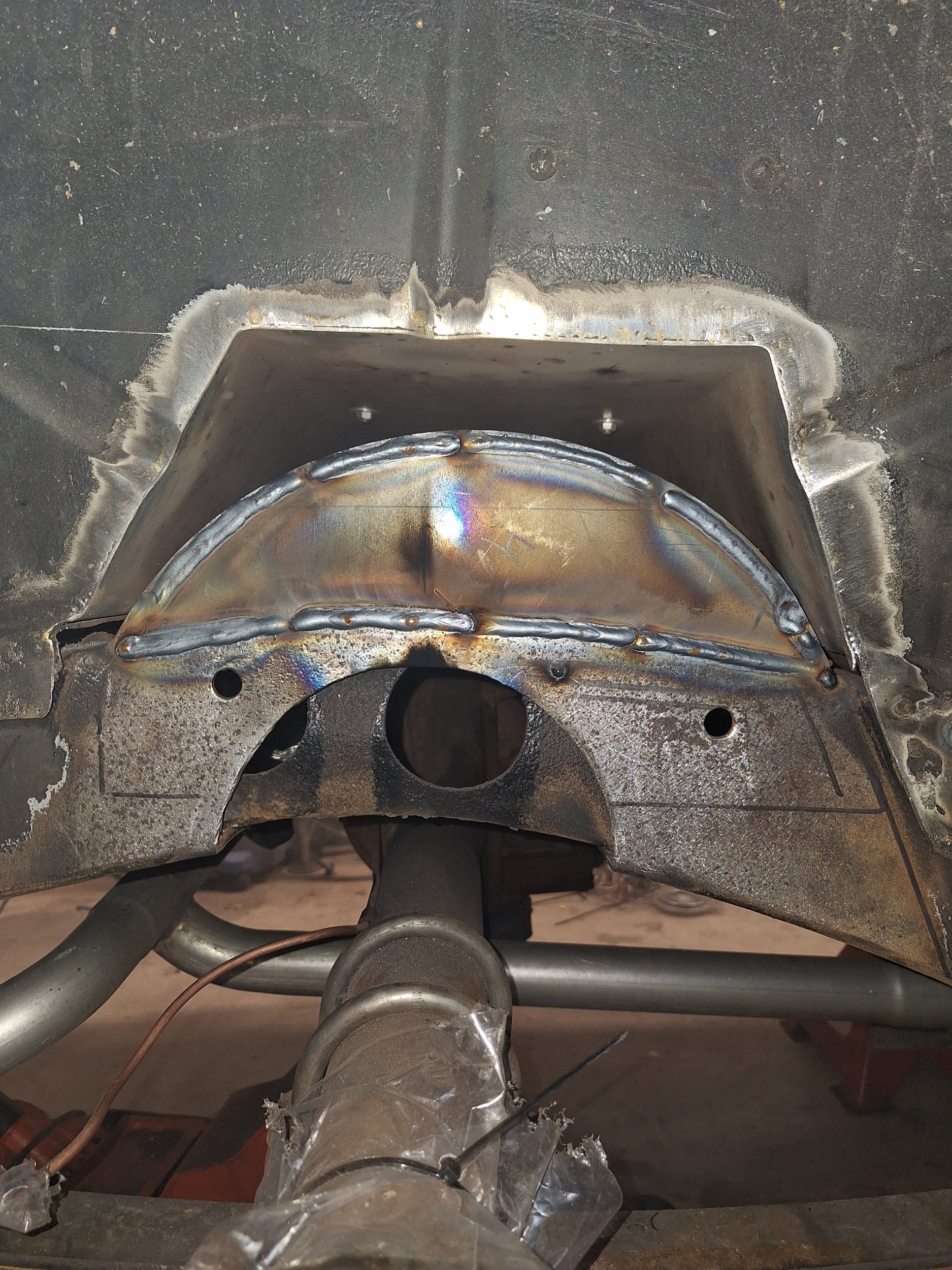

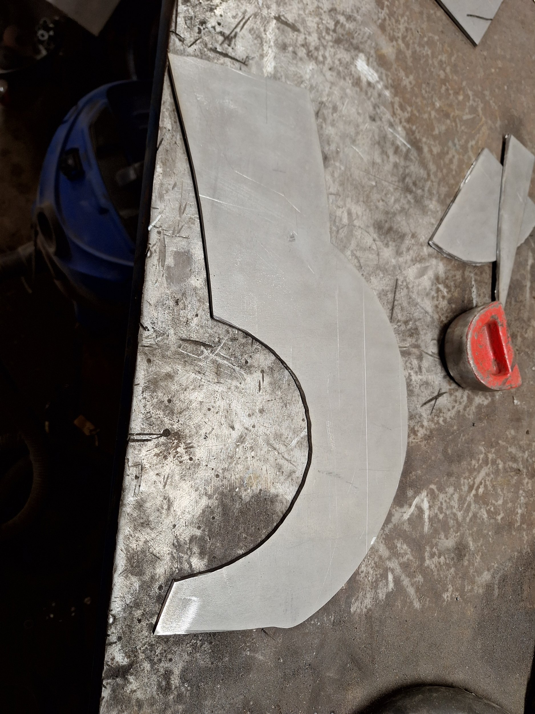

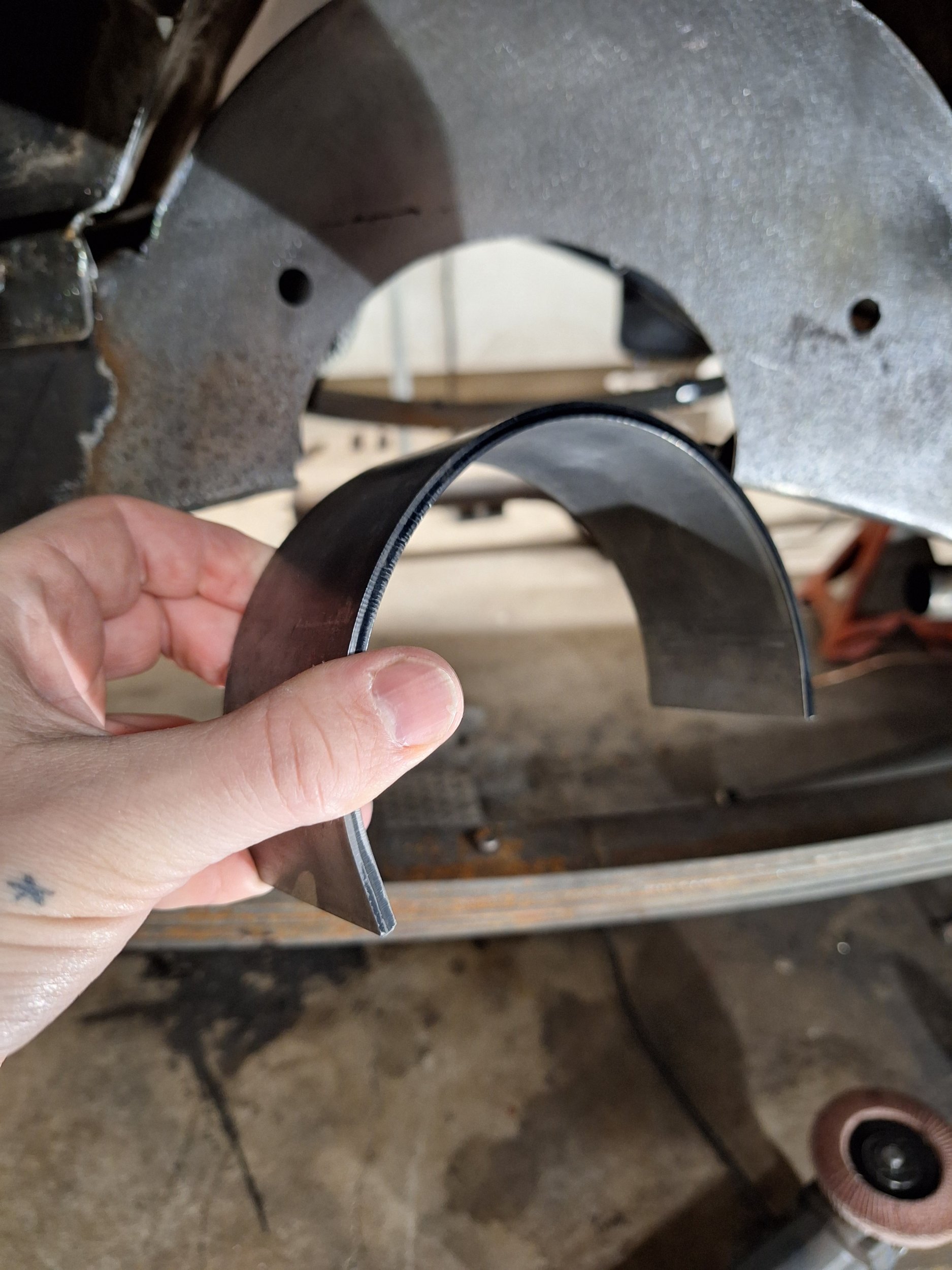

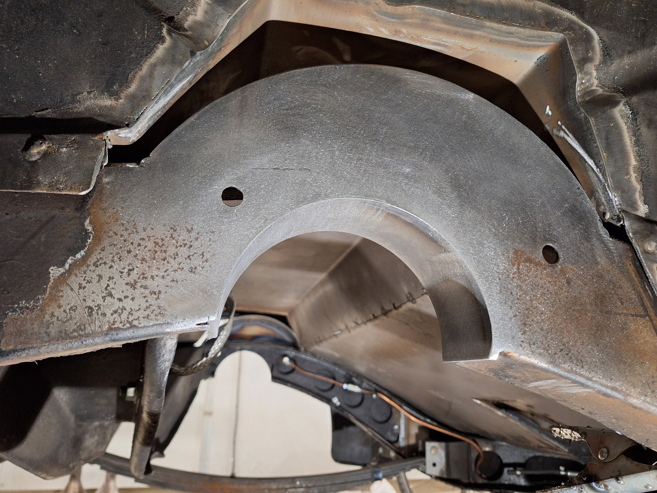

    Continued on the p***enger side kickup reinforcment, rolled some thick plates for the inner structure.
    Also made a inside boxplate, will weld it in place later today. 20250118_110600.jpg 20250118_112627.jpg 20250118_123553.jpg 20250118_123502.jpg
    Stogy, hfh, Shadow Creek and 12 others like this.

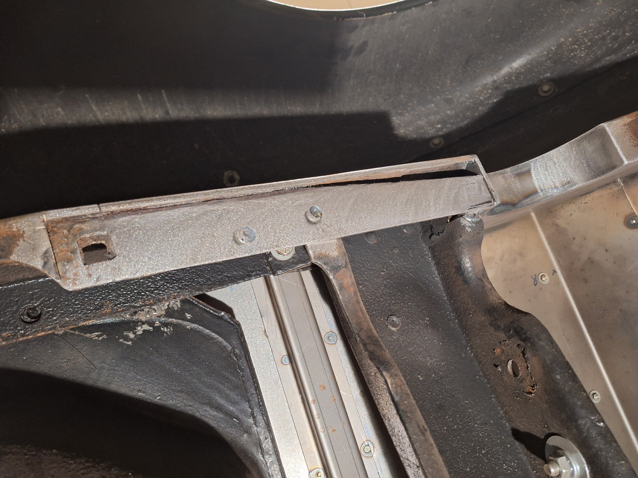

    Got the p***enger side done today, did some repairs to the rear part of the frame that had alot of rust between the outer and inner frame pieces. Made the inner piece first and plug welded it to the old leaf spring beam where the old rivit were.
    The new outer frame piece was also plug welded in four places to the inner piece.
    Also welded the inside boxing plate.
    20250125_141807.jpg 20250125_141827.jpg 20250125_153407.jpg 20250125_181701.jpg 20250125_181750.jpg 20250125_181707.jpg 20250125_181733.jpg
    Outback, Stogy, simplestone and 3 others like this.
