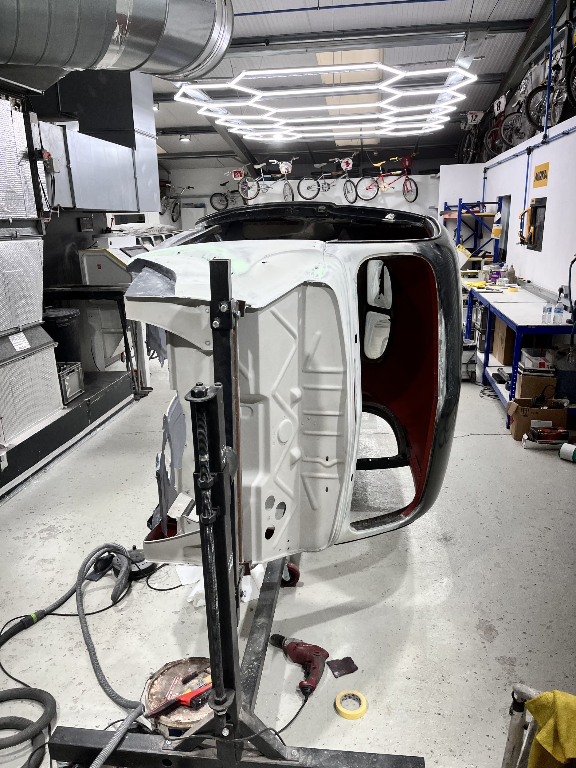

    Looking good Sam. Im finally at a similar stage myself, body on rotisserie and at a friends body shop. He's letting me do all the prep there and he'll be doing the paint thing. It wont be a shiny show stopper like yours, i'm keeping the 'patina', only because I want to drive it more that I want a shiny car :) (its been 20 years, i think thats long enough) We're doing the inside in raptor and possibly a heat barrier spray on top, underneath will be shiny black, so that I can keep it clean and not have dirt grab in there. I'll update my build thread soon.

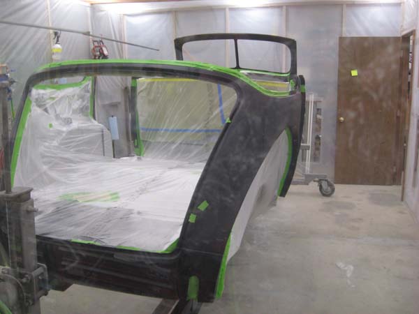

    Progress! finally the car is all one color! It always seems like flat gray primed cars look pretty smooth, until you really look close... After another couple of days of sanding masking and cleaning we were able to apply the 2K primer and a couple of coats high build today. We start sanding with 400 grit tomorrow.

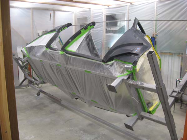

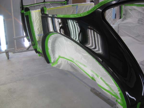

    We took a a couple of weeks off for the Christmas Holidays but have been busy sanding and sanding fixing imperfections etc. for a while now so it was fun to be able to put some colonial white ( Wimbledon white) on the firewall today. This was a single stage Matrix paint. The rest of the body is also ready for paint. Hopefully the black and clear will be on before the weekend.
    It looks a little yellow to me.... But should look good with the black car.

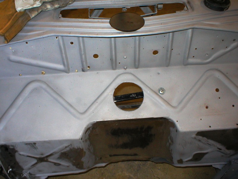

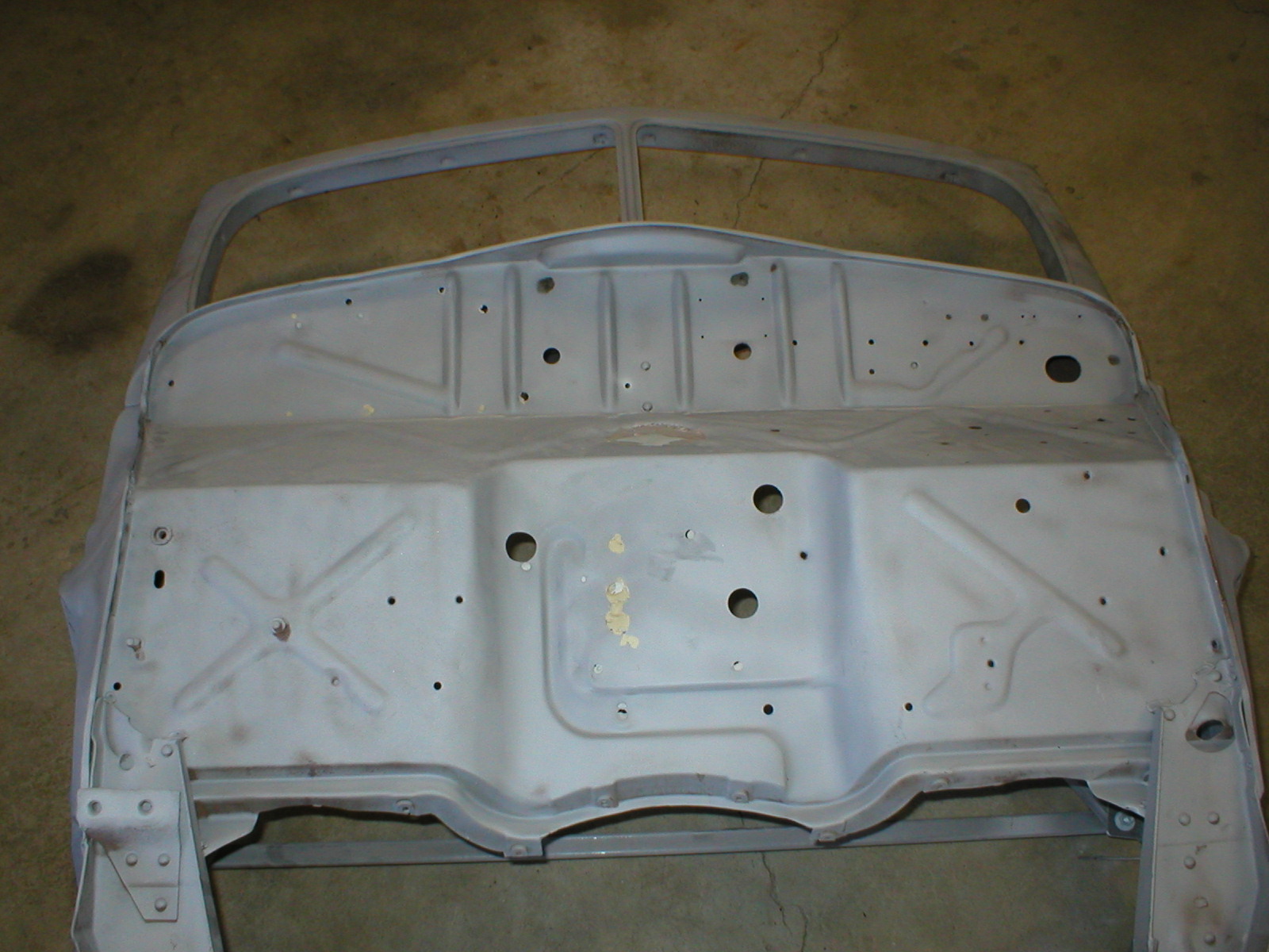

    I think it is a good improvement over what we started with many years ago. This was the first piece I started with on the car.
    The car had one of those manifold exhaust heaters in it so this jagged hole had to be filled . I also replaced the firewall behind the distributor with some 16 ga. There were just too many holes and some brass in the that area so I deemed it easier to replace the whole section.

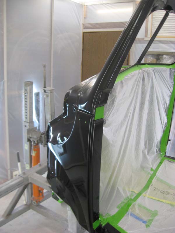

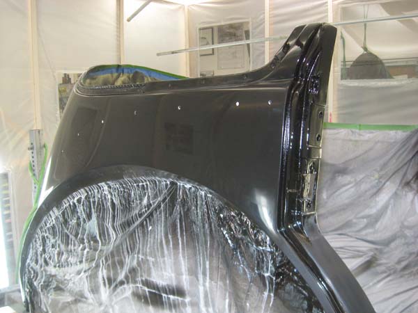

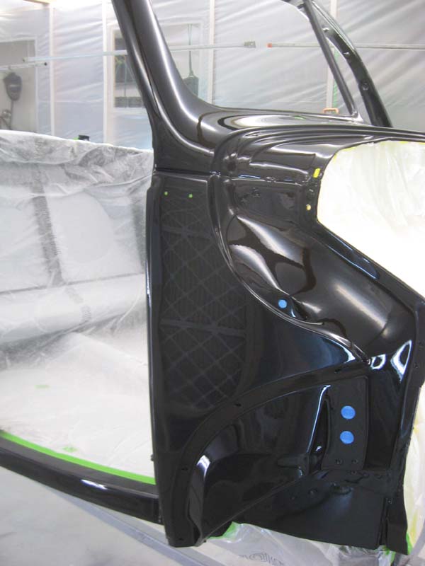

    So black it is! We started painting the black today. As I feared the black exposed some body work that is not up to my standards so we will have to make some adjustments. Don did the spraying today. He did a pretty darn good job! we had a couple of runs in the sealer primer which were able to fix. We also have some orange peel in the base coat. We expected that but now have to decide if the 5 coats of clear will cover that up well enough to make it disapear after color sanding.
    This was a long day in the shop to get just this far. If we are lucky we can patch up the
    quarter panel and move on to clear tomorrow. The booth is working great! The furnace
    is keeping up with the cold air we have to allow in to the shop to keep the air clear. We are
    maintaining 70-75 degrees in the booth. I think all of the lights also help heat the booth.

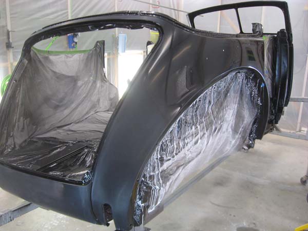

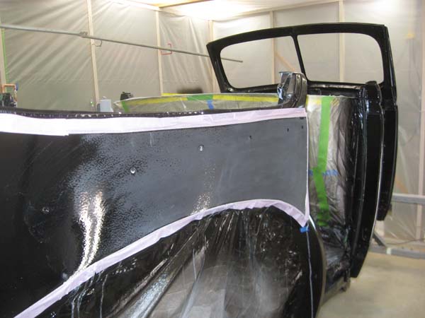

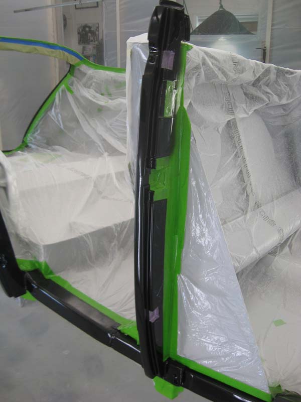

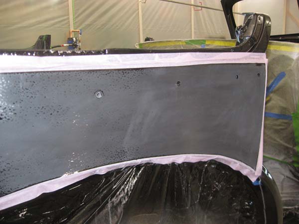

    So as I was saying we are amateurs. I also said we had a lot of orange peel. You can see that in the first three photos.
    We spent about two weeks hand sanding the body with 1500,2000 and 3000 sand paper. We eventually got it smooth enough for buffing but had burnt through to primer in a few places.
    I buffed this section out by hand to see if I could be encouraged enough to continue sanding.
    It looked good enough to provide just enough encouragement to get us to soldier on.
    Our paperwork on this clear says that we had to prep the surface with 1000 grit paper.
    So after getting it super smooth with 2000 we sanded the whole car again with 1000 grit.
    After many hours of tedious sanding it was decided all of the masking would have to
    be redone since the paint had hardened on the tape and was peeling off. The plastic had
    also collected quite a bit of dust.That little project took a couple of shop days.
    Last week we prepped the back side of a stop sign and some other scrap metal for paint
    and used them to practice our paint technique. we invited a skilled painter friend to come
    over and give us some painting tips and watched a bunch of U tube videos. This was
    all helpful and the paint samples came out great. So today I patched up the bare spots with
    with some base coat using my air brush in the morning. Don applied the clear coat with
    his newly acquired skills with really good results!
    The B pillars came out great this time! ( no sanding required)
    We got some runs on the passenger side quarter but the drivers side came out very smooth.
    The cowl looks great also. We wont have to sand the jambs or hood seal areas.
    We put just two coats of clear on today.So overall a good day in the shop. We will let this
    paint cure for a couple of days, and then get back on that cut and buff routine.
