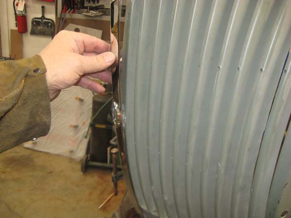

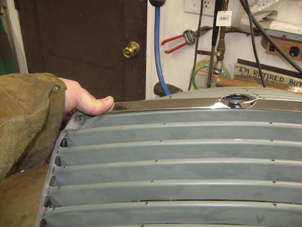

    After doing the small pieces I decided to take a look at my grill. I had paid a bunch of money for this grill about a decade ago. It looked pretty nice when I bought it so I paid way too much for it as usual.
    I decided I better see if the center trim would fit. Of course it did not.
    All three of the stainless trim sockets were flattened and or messed up in one way or another.

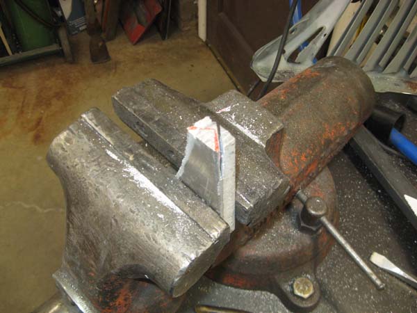

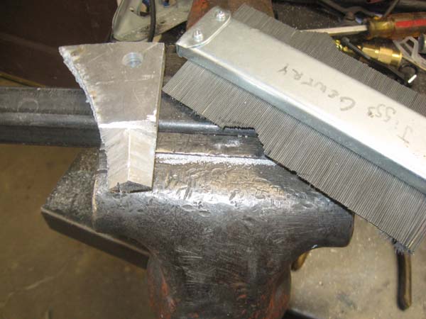

    I decided to make little dolly to help recover the proper shape for the center slot.
    It did help. we used a little heat and various tools to get the slot usable.
    Eventually we got the trim piece to lay down to contour most of the way.
    This last bit at the top is easily pushed into place.
    The two side piece sockets were almost flattened. We eventually were able to get them
    to contour also.

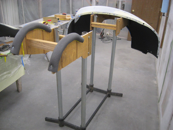

    The rear fenders are ready for pant. We put the fenders on this jig made from a steel saw horse
    and some square tube. I t worked okay but Don wanted more space between the fenders so
    he could get the spray gun in behind the fender so he could paint the rounded edge of the
    wheel well.
    So we rebuilt the jig to spread them out about 12" This should work well.

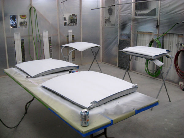

    It took us a few attempts to get the hood as smooth as the customer (me) was happy with
    the surface finish. This pic of the hood was taken after the second coat of high
    build primer was block sanded off.
    This hood was almost as rough as the rest of the car. Much patience was needed to get it right.
    The black paint will reveal all. I feel like block sanding is like putting developing a photo.
    I always have this great anticipation when I start sanding hoping that it will all be gray this time....
    With the top of the hood ready for paint we moved on to the inside of the hood today. There
    is some disagreement between Don and I about how smooth this inside needs to be. But the
    customer is always right. Right? We Applied 2k and then a few coats of high build. It will get as
    much attention as is needed to make it presentable. I can't back off now on the quality of build
    I am trying to achieve.

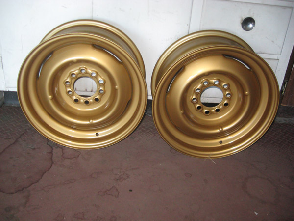

    I painted the new Gennie 15x6 wheels with Duplicolor DE 1604 Universal Gold.
    I cleared them with some Rust-oleum 2X Ultracover Gloss Clear. In this picture the
    wheels appear to be different shades. I just think it is the way the light shines on them.

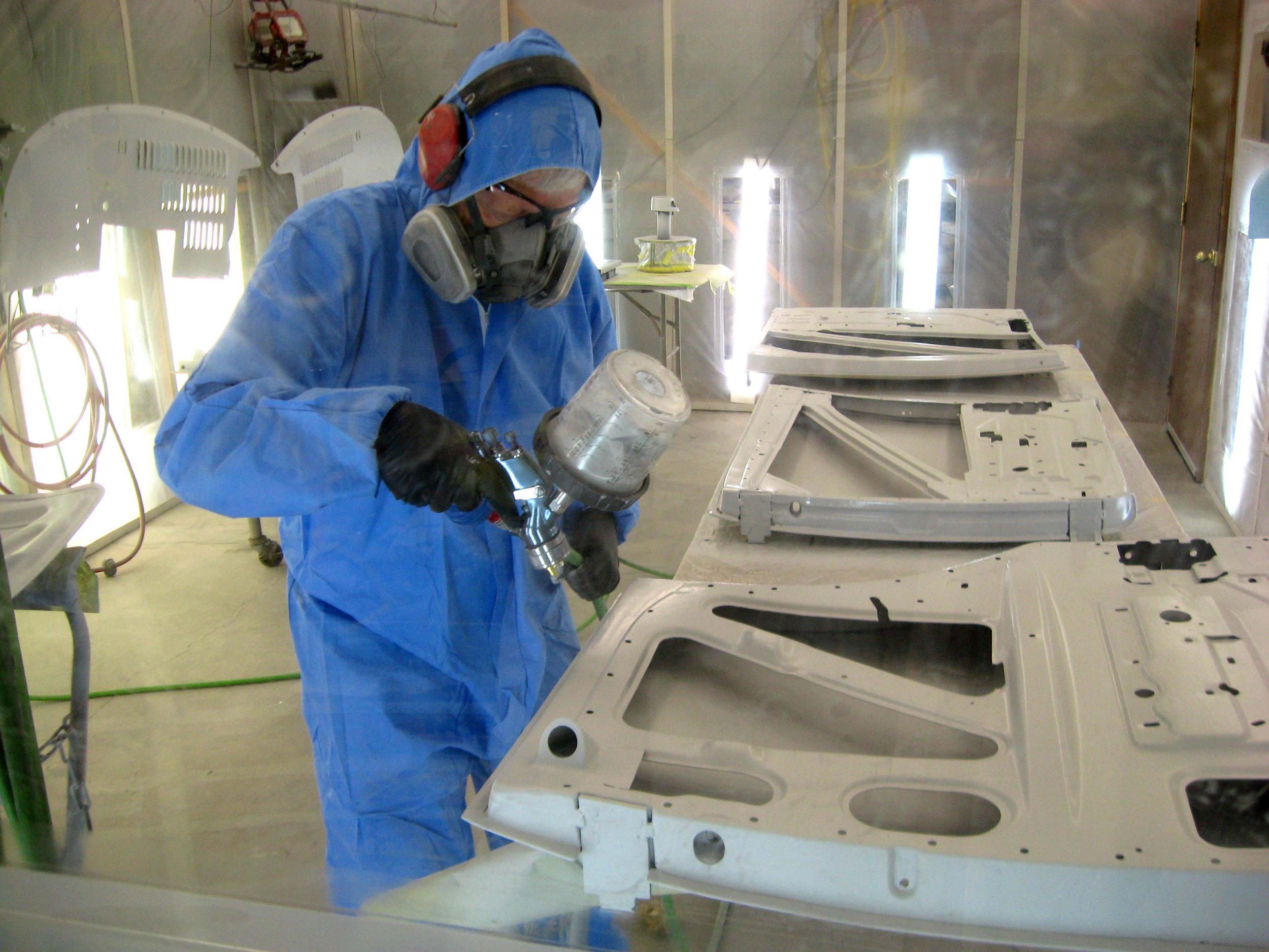

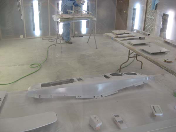

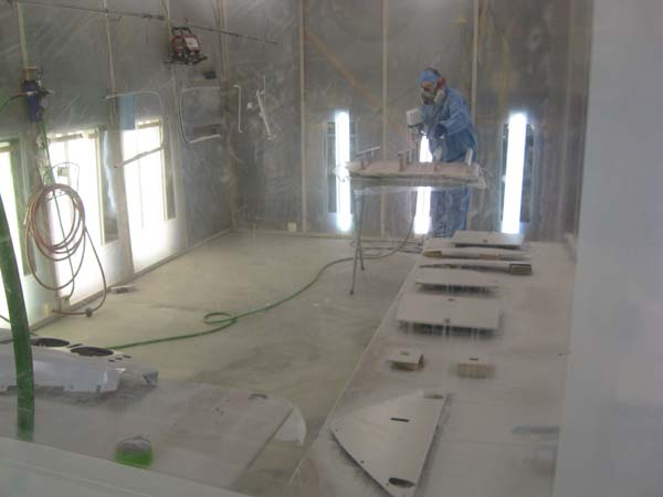

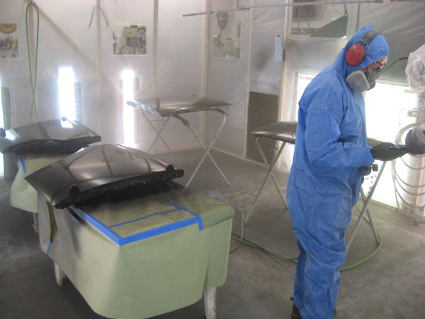

    We got some more painting done. This is some of Don's best work with the spray gun! We think we are still getting too much clear atomized in the air. The booth filtration system works fine for all of the other paint products we use , but the high volume of clear coming out of the gun fills the air and empties my wallet.
    Those brand new rear fenders didn't require much work but the hood was definitely
    a challenge. These parts should cut and buff pretty quick after we let the paint season
    awhile. Just front fenders and the grill left to paint now.

    So next up is the front fenders.
    I have had this strange rack minus the wood out in the shed for a few years thinking
    it might be useful during this phase of the project. These front fenders are very hard to
    work on without something like this fixture to support them. So after painting the inside
    of the fenders with undercoater we put our thinking caps on and came up with this
    fixture. It works great.

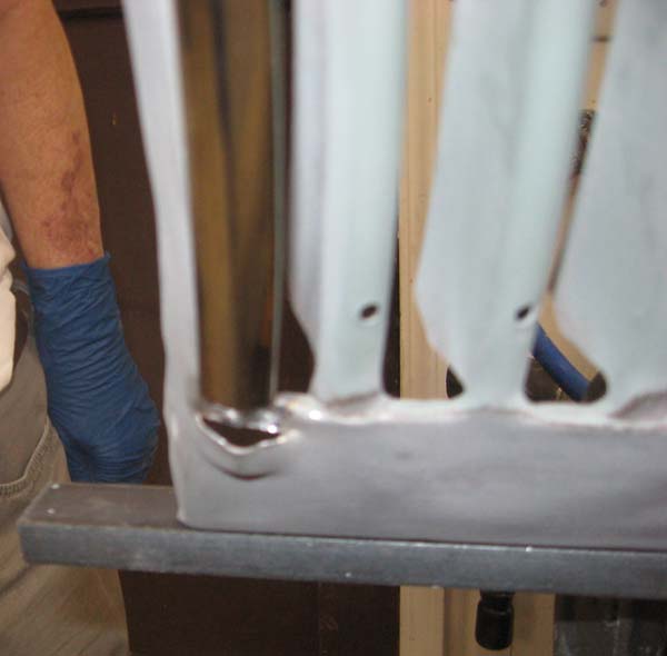

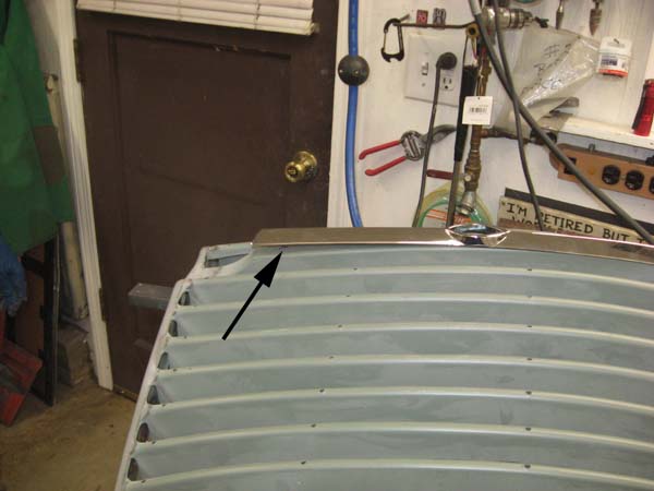

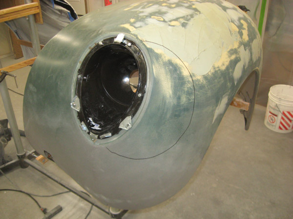

    I decided I should try the Bob Drake head light buckets in and see how the stainless
    headlight rims fit.
    I am glad I checked. There was a low spot big enough to throw a screw driver though.
    We also noticed that there is too much of this to rim showing so she needs an eye lid lift also.

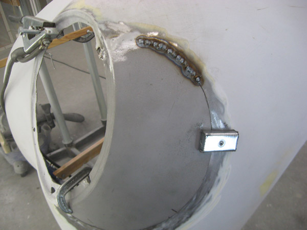

    This fender had been worked on quite a bit before I bought it years ago. It was fairly
    lumpy already but we worked on it for a couple of days. It was work hardened when
    we started and proved impossible (with our limited skills) get the metal to move where
    we needed it to.
    We tried annealing it but just got worse.

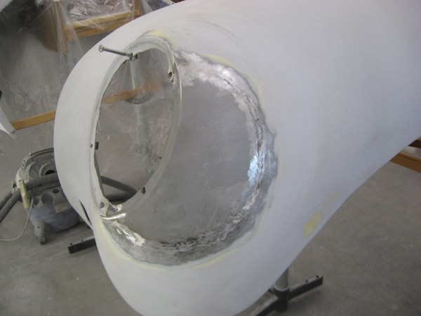

    So what to do? I had a couple of 40 fenders in the attic just in case of some unforeseen
    incident. This isn't exactly the unforeseen incident I was thinking of though.
    Some of you should know that 39 Deluxe fenders are a little different from 40's
    between the headlight and the grill. I chose to sacrifice this forty fender to save a 39 fender
    My logic is that they are making forty fenders but not 39's
    I cut the patch panel large enough to replace all of the lumpy segments of the 39 fender.
    I cut the fender out about 1 1/2 inches smaller than the patch panel.
    I laid the patch over the fender and initialy just cut out the metal at the top and bottom.
    I planned to cut the fender away as I moved down the arc.
    That didn't work very well so I ended up cutting all of the metal out from behind the
    patch panel and carefully tacked welded the pieces together.
    This was a nerve racking process. I tried the hammer welding technique but was not impressed with the results.
    Well it's in there. Just a little bondo required.
