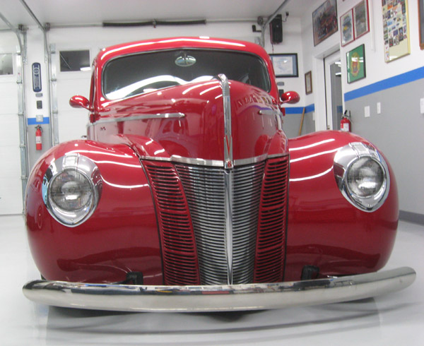

  1. That curve is about what mine is like.
  2. A wealthy guy's big deal tub
    A cool tub no comparison, cool is cool

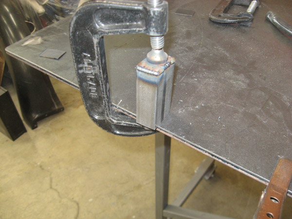

    This week we have been working on the toolbox. I call this toolbox 2.0 since my first toolbox looked good but did not fit. I should have waited until these corners and new tail pan were installed. Well all of the effort was not lost as I learned some things while building Tool Box 1.0.
    We started out by making some supports that attach to the inner fenderwells and

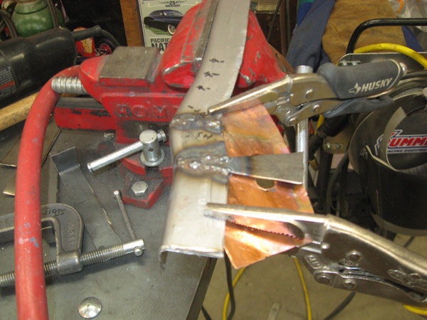

    will support the sides of the tool box.Shown here is a trick I learned on the HAMB.
    If you leave a piece like this pie cut piece of metal here the extra metal acts as a heat sink
    during the welding process.
    The shrinker stretcher was useful for parts of this but cutting and welding were required
    for the areas we eventually welded.

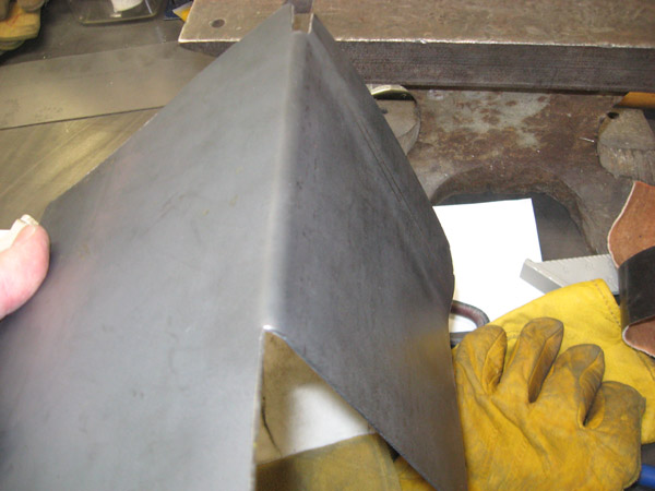

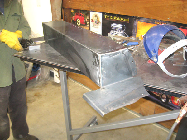

    We started out making cardboard templates for the corners of the tool box.
    Those side brackets shown at the beginning of this post are attached to the quarter
    panel and supporting this corner piece. the steel piece the torpedo level is on in this
    picture will be replaced with a flat piece which is the reason for the spacers I will show
    later in this post.
    Transferred the pattern to some 16 gauge.
    The sides had to split the tailpan to body interface.
    Like everything else on these cars nothing was at 90 degree angles so the compound shape
    had to be carefully bent to match. Not an easy thing to do in 16 gauge. The HF Break
    we have is able to bend these small sections 16 gauge.
    After several trips between the sanders and benders we had a good fit.

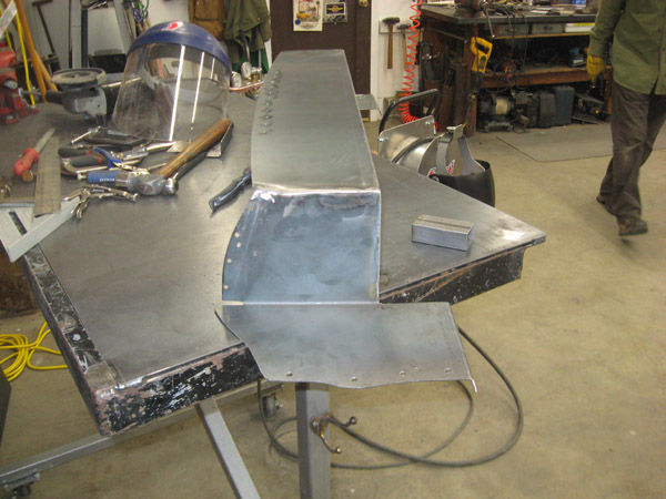

    When I bought the steel sheet I had them bend the 90 in one end of the sheet. I think
    it cost me 30 bucks for the bend and one cut on the 4x8 sheet. It was worth it to have
    a nice 90 end to start with.
    The bottom piece was cut in a curve matching the tail pans curve pretty close.
    Test fitting
    Welding on the bench
    I welded both sides of the joint and metal finished the underside.
    Holes are predrilled for for plug welds
    We changed up the design a little from 1.0
    I found some 1x1 1/2" tube it's a little thinner than I wanted so I made some end caps
    for extra strength.
    Welded them on and should also help keep the spacer keep from collecting dirt in the
    open space.
    They go here . We hope to weld the pan in tomorrow so I hopefully will be posting
    the rest of this project soon.

    In place of the top piece that had a 1 inch drop we decided to make a flat top piece.
    We ran the ends through the bead roller to offset the flange below the end pieces
    of the tool box. The 3 holes are for plug welds.
    Those offsets in the top piece allowed us to weld the top plate flush with the end
    pieces . This 4 foot level allowed us keep the very flexible 16 gauge 3 inch wide piece
    flat for fitment and welding.
    Just another view. You can never have too many clamps!
    At this point I had applied several hundred spot welds over a few hours on the back side
    of this top piece. You can see the penetration of the welds. You can also see the offset
    in the top at the interface.
    I spent an evening out the shop doing all of theses welds. I think it was around 1 AM
    when I finished. I had to do other projects in between each run of about 12 spot welds.
    I allowed the steel to cool to touch to try to keep the metal from warping from heat.
    It worked!
    The bottom weld was not metal finished.
    The top weld was metal finished as shown here. I really like this new welding bench.
    We made up some tabs that will help support what I call the back valance. We will wait
    to weld this valance on until we are sure we do not have to take the floor out for the wheel
    tub project.
    After several test fits and adjustments. (welding does change things in strange places.)
    the toolbox was welded in. The trunk latch support fits great. We won't weld it in yet.
    You can see the plug welds along the tail pan here. The holes were drilled to 5/16 inch.
    The flanges that attach to the tail pan required just a few hammer blows to tighten them
    up tail pan.

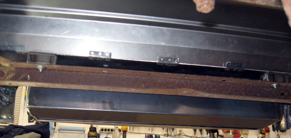

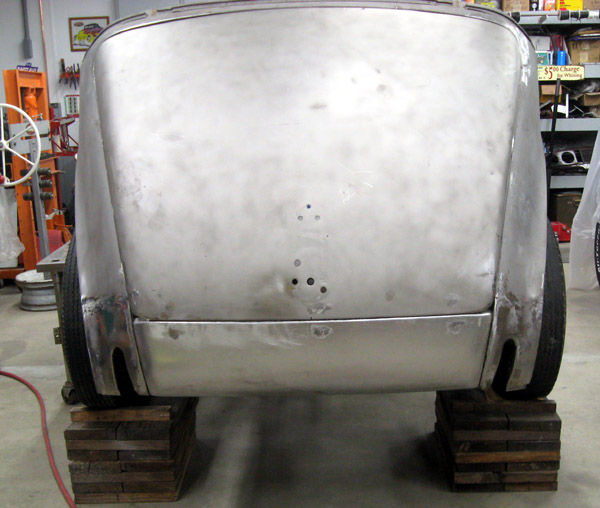

    Bottom view
    You can see that there is plenty of clearance between the tool box and the frame.
    You can also see the unfinished bottom of the body corner we installed last week.
    We will finish that feature when we get the body on the rotisserie.

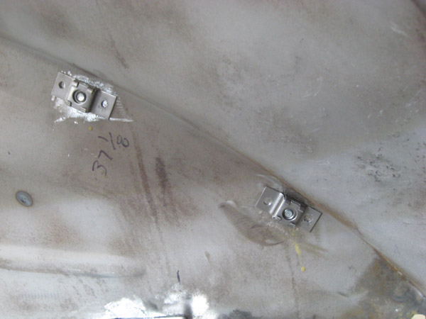

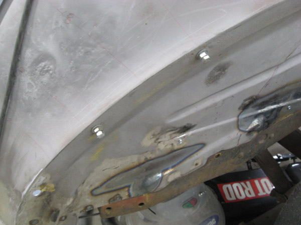

    All of my fender capture nuts were missing on this body. I bought these #3145-C 5/16 x 24
    cage nuts from Bob Drake. They look to be much sturdier than the original Ford cages.
    The scissors are pointing to flange that protrudes through the body. This required me to
    drill the hole in the body out a little larger to accommodate the flange. I kind of like the
    flange because it helps to center the nut assembly during installation. I also had
    to sand the flange down a little because it stuck out too far into the hole which may have
    made it difficult to mount the fenders later on. They also come without holes for plug
    welds I used to secure them to the body, so I had to drill those out to about 5/16"
    They are simple to install. I just ran a 5/16 x28 bolt with a washer and a second nut
    used to limit the depth of the bolt on the nut ( to prevent getting any weld berrys on
    the bolt) Tighten it up and do a plug weld.
    I will be doing some more of these later I only went as far as the back seat support so far. Most of the metal that supports the fender forward of that support will be replaced soon and then I can install the rest of the capture nuts.

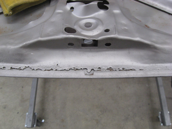

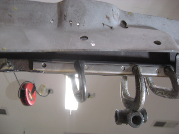

    So here we go on the top seal rail . As shown before it was riddled with bronze and small
    patches of steel strip with a lot of rust holes in between.
    You can see below that we tried grinding some of the brass away to see if we could
    live with that and just bondo and paint it. That is just not the way I like to do things
    so all of this junk was eventually cut out and replaced in small sections.
    Typically we cut the old metal out to within about 3/16 inch from the 90 degree bend.
    This was done to allow for a nice clean edge after welding.
    A simple 90 degree bend was made and then bent to the compound contour of the body.
    Note we left that piece of metal that supports the bottom of the channel. I had to use
    the copper in several places during the welding process. It was used as a support and
    a heat sink.

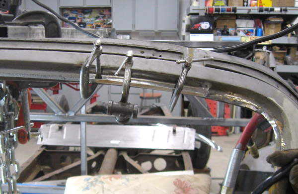

    Since we welded in just a 90 degree bend we were able to finish the first weld before
    Welding on the second 90.
    Second 90 degree segment clamped for welding.

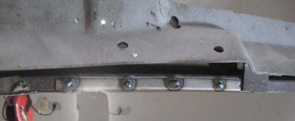

    5 1/6 holes were drilled for plug welds on the bottom side of this flange.
    This old man has to be comfortable to weld while on his back so this simple platform
    was rigged up. Worked great . I had it in and out of there several times during this project.
    Plug welds

    For this center section we just replaced the back of the seal. You never have too many clamps.
    This section was plug welded from the bottom

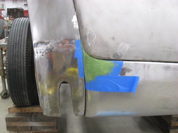

    We are still struggling with compound curves. We have use this technique before to get
    around a very tight bend. Too much welding required to finish it though.
    So we decided to just cut the bottom out. When we were satisfied with the curve we would
    make a flat bottom piece and weld it in.
    Welding and finishing this piece at the bench allowed for easy access and clean results
    which we would have had trouble doing on the car.
    The drivers side corner was the longest one we did.
    That weld took a long time to do. Not pretty but will finish out well.
    That's all of the pics I could do on this post. More later.

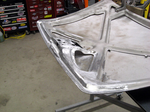

    This week we worked on The bottom of the trunk lid.
    Trying to work on this lid is like trying to do surgery on a turtle while it's on it's back
    so I jigged it up and clamped it to the welding table.
    Here is the starting point. I found it interesting that the inner structure was rotted away
    but the skin was actually pretty sound.
    We started with the long pieces first. Were able to just slightly bend the outer skin folded
    flange up just a little bit to release what was left of the inner skin under the flange. This
    allowed me to gently hammer the damaged material out of the slot.
    The dremel and several other picking tools were used to clean the remains of the rusty
    metal left under the flange.
    Eastwood rust converter was applied to seal the remaining rust in this area.
    The converter turns the rust black.We left the center structure in place to support
    the inner structure.

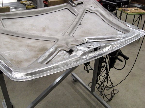

    The patches were bent from 18 ga. metal. Like all of the body pieces so far that look
    kind of flat when you first look at them but all require some tweaking on the shrinker
    stretcher.
    It was time to get these corners out of the way so we could slide those new pieces and
    the dremmel tool into the slot.
    I am not a fan of Fords square (sharp) trunk corners so I marked a gentle curve off
    with a french curve gizmo and started cutting.
    As you can see it is not much of a cut.
    That left a nice opening for the tools and parts to be slid through.
    I put a sheet metal screw into the corner piece so I could pull this piece into place for
    trial fits and clamping.
    This corners had to be made from three pieces.Don used a plannishing hammer to shape
    this corner.
    This is how I bent the flange back down. I used the copper to keep from dinging up the
    outer skin. Hammer and dolly just seemed to bounce off of the flange without closing the
    gap.
    They PO must of had a lot of trouble getting the old latch out of the trunk lid judging by
    the damage here. I decided the best way to fix it was to cut it out reshape it on the bench
    and weld it back in.
    Latch area repaired. I discovered that I did not have a latch for this trunk lid recently.
    I think I have a stock latch coming from Alaska soon for a replacement though.
    You can see new piece cut and fit below the latch here too.
    Lots of clamps as usual. This piece was added to mimic the folded over outer skin.
    Just some of the tools used to do this project.
    All cleaned up and ready for a skim coat of filler. This project went pretty well. It took the
    better part of a week but worth the effort.

    We didn't get much done the last couple of days. One of my buddies had his Forty that he just bought in California dropped off here for winter storage. So we had to move some things around and play with the new car a little before getting back on the project.
    She's kind OT for this forum so this is all I can show you of my new room mate. She is
    sitting right behind me as type this. It will probably be here until May or June of 2021.
    Too bad there is snow and deicer on the roads. Can't play with it much but it is fun to
    look at. Do you think it's low enough? No it is not on air ride.
    After showing the Forty to all my neighbors that saw it dropped off yesterday we had a
    a little time to install the trunk lid on the car and start the next project.
    We got the lid lined up pretty good.

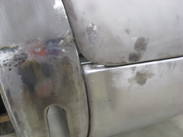

    You can see the gap left by rounding off the corner and the incomplete and what think
    was incorrectly formed EMS tail pan.
    I applied some masking tape to keep the sheet metal kind of clean and then applied some
    modeling clay . After a few minutes of carving I was pretty happy with the shape and
    confident that we can cut and shape some sheet metal to duplicate this shape. Not sure
    yet how we will copy this contour but I think I will start with making some cardboard
    templates. That's it for today. Thanks for watching.
