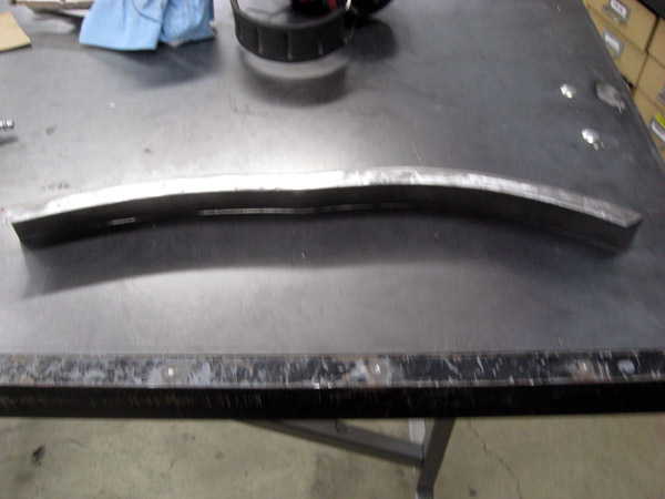

    This portion of rocker was not included in the *****in kit so we had to build it from
    scratch.
    The shrinker stretcher was put to good use here but for some bends we had to cut and patch.
    The end result is this wavy piece.
    I decided to add some width to the rocker where it interfaces with the motor mount.
    It all came out alright and is plenty stout. The floor no longer wiggles.

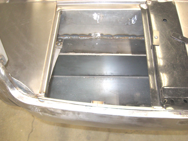

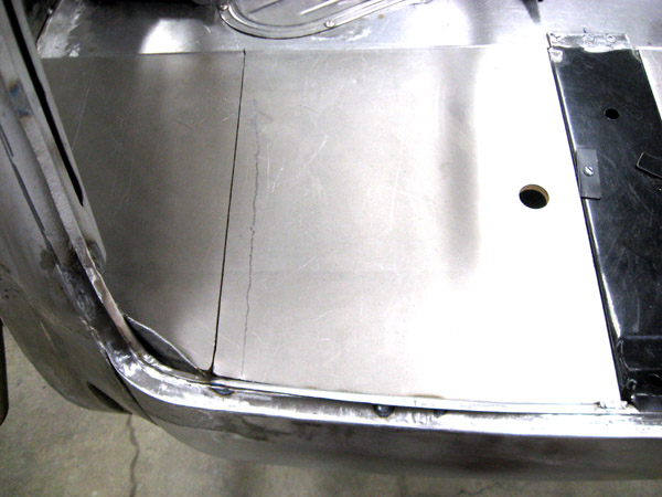

    Finally finished welding in the tool box.
    I thought it would be a good time try in the gas tank. It is a stainless tank from Bob Drake
    that I bought several years ago. It has provision for the fuel sender unit and an internal
    fuel pump. I really don't like having to work in a small hole while trying to install and service
    these items so I designed a good sized cover for the access cover.
    After careful measuring we marked and cut the hole....
    Turned out we measured off the wrong side of the tank.... So a do over was required.
    We missed it by 2 2/2"!
    I was able to weld the piece back in without distortion.
    After cutting out the opening in the correct location I made some tabs out of 1/8"strap.
    I drilled and tapped them for 10-24 screws and plug welded them to the floor.
    The cover was made from 18 ga. steel
    Cover fits pretty good . I wil replace the current screws with flat head screws later on.

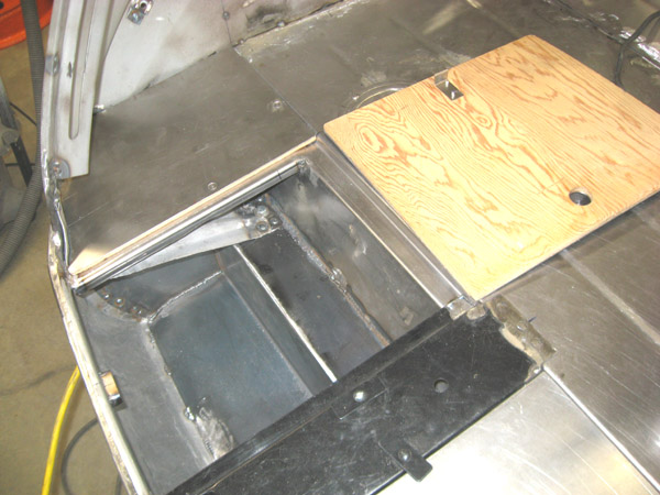

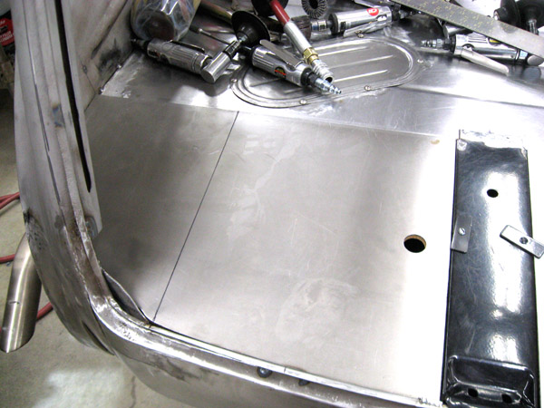

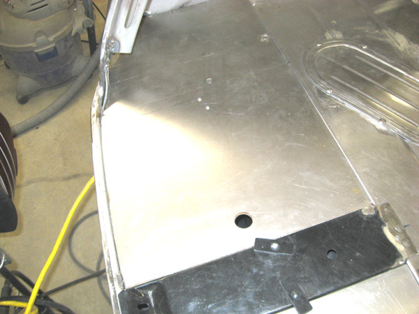

    It's time to make some tool box covers. Ford made these from wood. I have found that
    when you put a knee on them that they break. So I decided to add some 18 gauge steel to
    mine.
    I roughed up the steel with the flap wheel.
    I applied some 3M adhesive to both sides.
    Carefully lined them up before putting them together. Once the two sides make contact
    they will not slide . I got lucky and they lined up pretty close.
    I thought the covers need some extra support so I made these little braces out of 18 ga.
    They work well.
    Put some one inch finger holes in the covers and made another one of those cover hold
    downs. Ford only supplied one of the hold downs. I have always wondered why they
    only supplied the one. Well now I can put my fat old knee on the boards when crawling
    into that trunk over the rest of the build and not worry about breaking the board.

    I like your little support tabs, I was contemplating exactly that yesterday afternoon! And today's task will be cutting the new access hole for the tank sender etc. I know my cover will not be that fancy though.:rolleyes:
    The 39 guy likes this.

    Thanks, Sam...for the 'heads-up confession' on cutting access on the wrong side...
    You then illustrated the method of re-welding one cover back on. Very smooth, great lesson.
    Bonded wood/steel covers make this a true improvement in trunk area.
    So much attention to detail. I'm 'glued' to this thread!

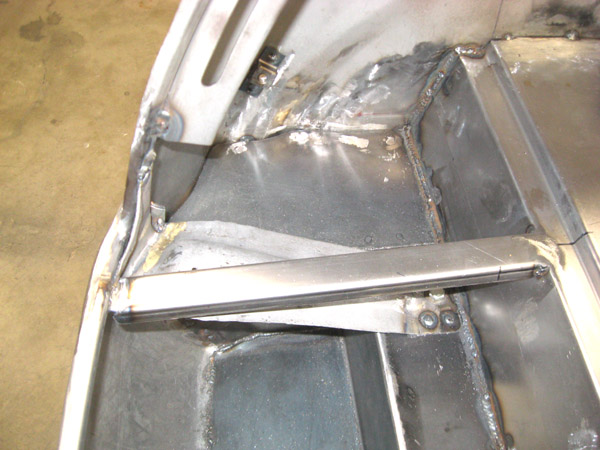

    After working on my Buddy's 40 sedan I decided that it would be wise to cut these big
    panels into smaller segments. That outer edge is usually partially covered with interior
    Panels making it hard to get the tool box panel out.
    So I cut it with a 4 1/2' cut off wheel
    I had this piece I cut off of one of the floor panels to use for a brace.
    After some t******* and fitting I welded in the brace.
    The outside piece needed to be secured so I drilled and tapped for two 10x32 thread
    stainless flat head screws in each panel. This still allows for the outside panel to be
    removed easily for access to the corners of the tool box.

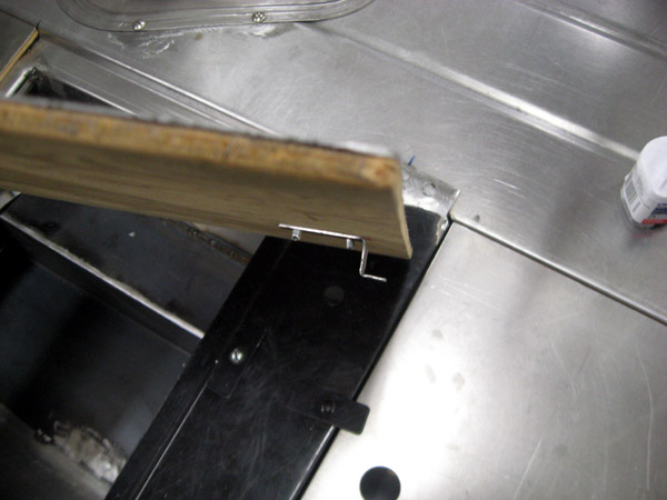

    I also felt the main panels needed a way to keep the cover down on the outside edge.
    The hook made from 18 Ga.
    Finally done with this little project.
