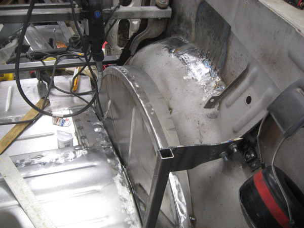

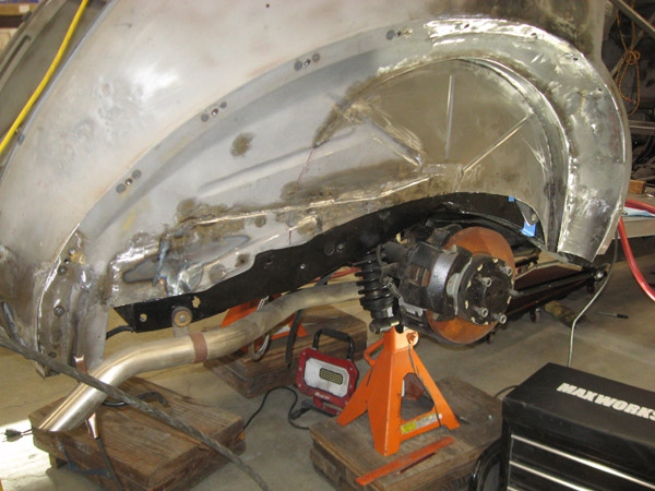

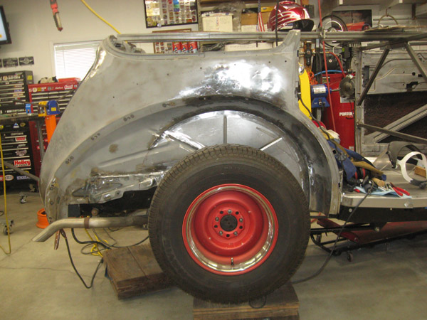

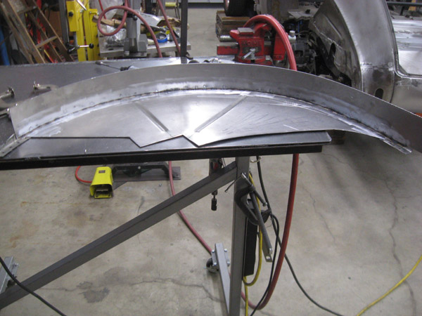

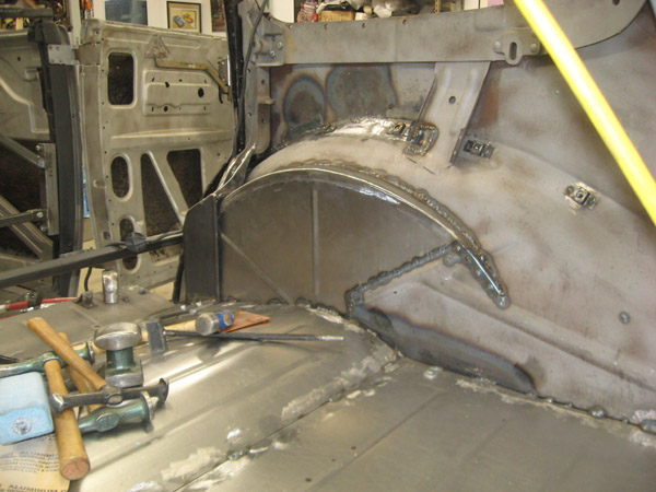

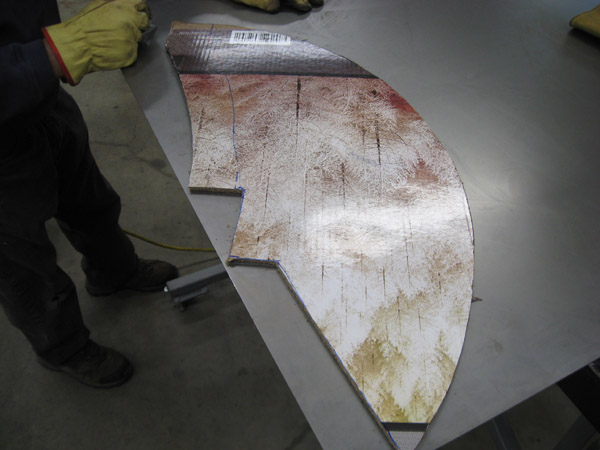

    It's time for some mini wheel tubs. I installed tubs like this in my 40 ford coupe a few years ago. They have worked out fine, so I thought I would install some on the convertible sedan. I think the Tub will have a lower ride height than the coupe and will also be hauling p***engers in that comfy back seat which would result in tire rub if I don't make this modification.
    After some careful measuring I made a rigid cardboard template.
    Then used it to lay out cut out for the wheel well.
    The cardboard template was also used to make the new wheel tub panel.

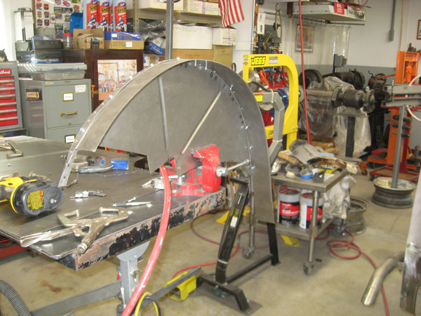

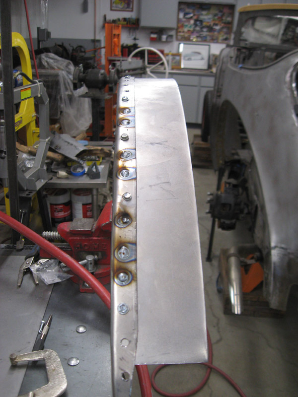

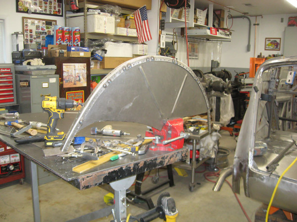

    After laying out some strengthening ribs we first ran the panel through the English wheel.
    We stretched the panel on the opposite side of the 18 gauge panel that we were to bead roll.
    Doingthis first keeps the panel from warping too much when bead rolled. It came out pretty flat.

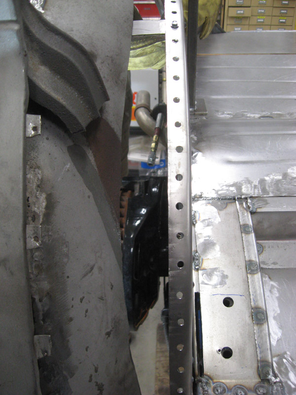

    Some 18 gauge flat stock was bent 90 degrees and then contoured to match the contour
    of the wheel tub. The plug weld holes were drilled first.

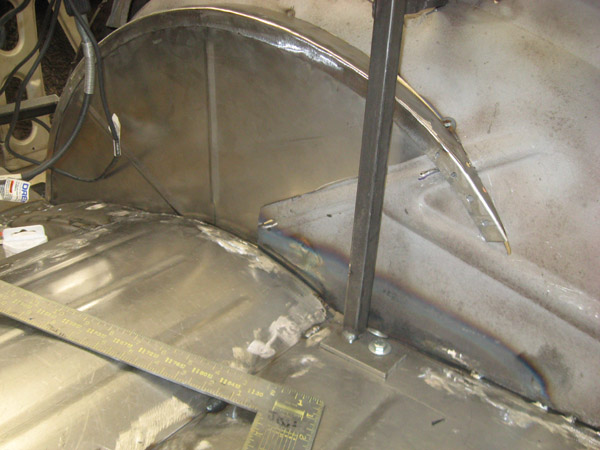

    Test fitting to establish the width of the tub top.

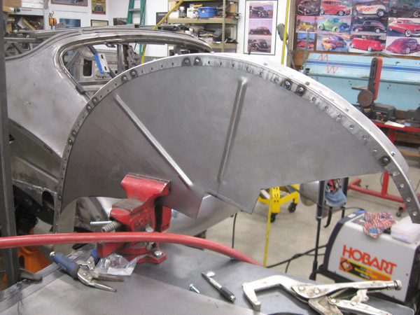

    Self tapping sheet metal screws were used to rough in the top piece for welding.
    Lots of plug welds.
    Plenty of plug welds. Remarkably this panel did not warp from the welding.

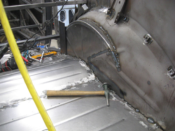

    Metal finished the welds. with a flap disc.
    Tacked in. Notice the excess top metal which was trimmed off with a cut off wheel
    before final welding.
    I ran a full bead along the inside before cutting the excess off of the top of the tub.
    Then I ran a full bead along the outside edge before metal finishing.
    Done!
    That heavy steel brace is a subject for another post.

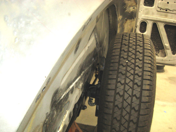

    Looks like I will have ample clearance for the wheels.

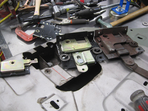

    Door Latch Project:

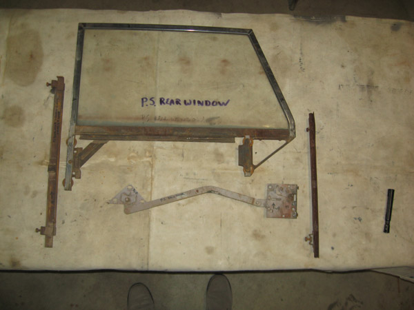

    While we were working on the doors I decided to see if I could solve my missing door latch problem.
    I suppose my drivers side rear door latch, window ,window channels window regulator were misplaced when the door was stripped down for a a new door skin many years ago . When the car changed hands someone forgot to throw these parts into the car. It was a costly mistake (for me).
    I have looked for years for these parts with not much success. I was able to find a new door latch ***embly O1A-6621800/1 and inside door handle ***embly 81A-732412/3-NA from Bob Drake. They make full ***emblies for some cars and trucks but not for convertible sedans. So that makes for another project.

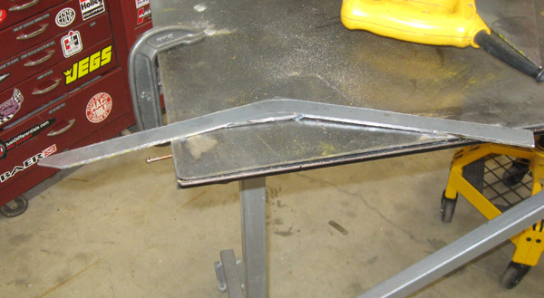

    The new latch on the left comes with a lock mechanism which I cut off. You can see
    that the latches are not built exactly the same as the original unit on the right. What a surprise!
    In order to get the new latch to fit the door I had to cut the bottom of the door latch recess out at
    the red line and make the indentation for the latch a 1/2 in wider.
    A C clamp was used with a bridging piece of sheet metal to hold the new piece in place
    for welding.
    A piece of sheet was bent and welded into hole.
    Latch fits now.

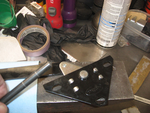

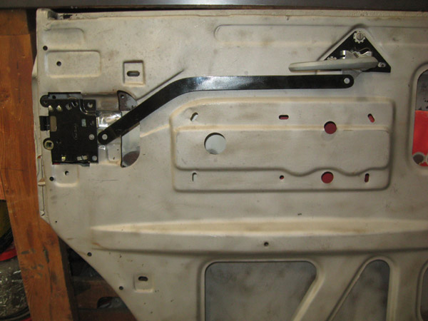

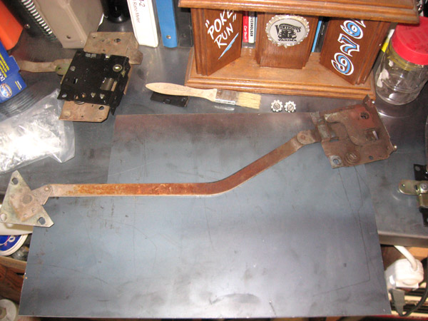

    This link arm is not provided so a mirror image of the link had to be made.I had some
    1/8" sheet in stock so I traced the shape of the link arm onto the sheet and cut it out.
    I used the sawsall for most of this cut and the 4 1/2" flap wheel to shape the corners.
    A little work with the vise and hammer formed the ends.

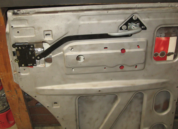

    The handle ***embly comes with this rivet and washer.
    I used this centering punch start the rivet forming. I also used regular punch in the rivet
    shaping process. The rivet worked well. I checked the catalog but could not find these
    sold separately. If any of you know of a source please let me know.
    A little paint on the link arm and the ***embly installed easily and works well.

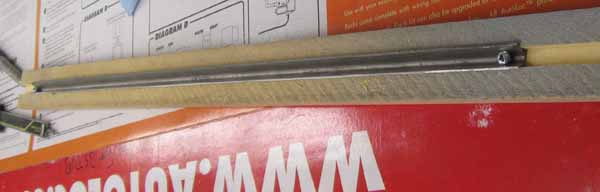

    I will be using electric power window in these back doors so I don't need a window regulator.
    I have located a window but it is for the opposite side. I am in the process of modifying
    that now. We also need window guide channels for this door. They are not made either.
    At least I have not been able to find them in the last 18 years. That's all subject matter for
    some future posts .

  16. I used 40 Ford 4 Dr rear door latch and handle ***ys and changed the length of the link arms/ pull strap, used them on front and rear doors. Worked real good.

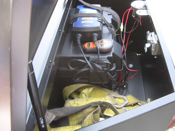

    Trailer stuff: Got a little carried away here. Installed a maintainer in the box and installed
    a volt gauge. When I get ready take the trailer out I can verify voltage by pushing the
    momentary switch to check the lighted gauge.

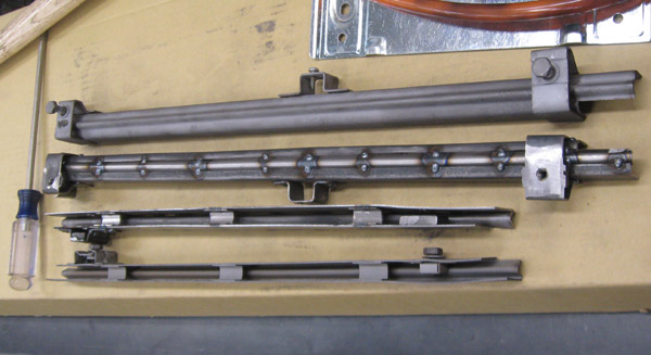

    We also helped get a couple of cars started for the first time. That's always fun! Otherwise
    we spent some time working on the power window conversion for the rear doors of the CS.
    Here is all of the stuff that was missing from the drivers side rear door. The task is to
    make mirror image parts to replace them. The door latch has already been done. Now
    it's time for the window.
    Apparently ford made at least two different types of window frames over the years. I
    could not use the one in the foreground.
    So the roller ***embly in the foreground here is the one that had to be reversed for my
    DS door.
    The roller ***embly is still in decent shape but I did replace the springs.
    Bob Drake does offer a kit to replace this mechanism. 01a-6622218-K The Drake kit uses
    plastic or HDP wheels. We chose to reuse the stock stuff ( steel wheels) except the springs
    on one door while we used the plastic wheels on the other.
    I decided to cut this roller bracket off here and flip it 180 degrees and weld it back on.
    The old sawsall was used to cut the roller mount off

    So this next project was an interesting one. Once again the reason for doing the project was that we did not have the parts but wanted maintain the original windows. This project has a little kicker at the end. The project took us a at least two weeks to do not counting all of time spent figuring out how to do it and trying some forming with some dies and a hydraulic press (didn't work). If we had a pull max it would have been fairly easy......
    After a lot of measuring we decided to make the roller guides from several pieces.
    The runner was bent on the sheet metal break.
    After jigging the parts several small welds were applied.
    The guides were then ground down to the needed dimension.
    All of the attachment points were fabricated and welded to the runner.
    That same mirror image element of this project was a problem some times but we worked
    through it.
    The other runner presented similar opportunities to tax our imagination.
    I cut a groove in this piece of wood with a router at the depth we needed for the
    wheel runner. Don ground he steel down to the wood to give us the runner channel
    depth.
    I cut another piece of wood at the width we needed for this guide and clamped the three
    pieces for welding.
    I decided to keep the welding to a minimum to avoid warping.
    More challenging to fabricate attachment brackets were fabricated and attached.
    Here is the comparison of the original equipment to the fabricated parts.
    So here is the kicker to this story. After painting and installing these fabricated parts which
    worked well by the way, I shocked to find some original runners in a box while looking for
    something else. As I think I mentioned earlier I had purchased a full set of windows many
    years ago. Some how I had forgotten about these parts ( senile me). So I had to tell Don.
    Of course I asked him not to kill before I told him...... So we decided to put the original
    Ford parts in the door. So if any one needs a set of window roller guides for the p***enger
    side rear door of a CS, I have a st I am willing to part with.
    So why did I share this process? Well we put so much time into the project that I thought
    we should share it. maybe it will help someone else build something similar. It's getting late
    here so that's all for today.
