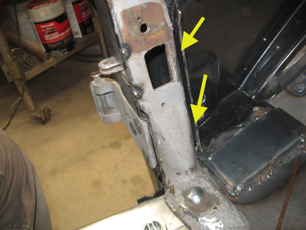

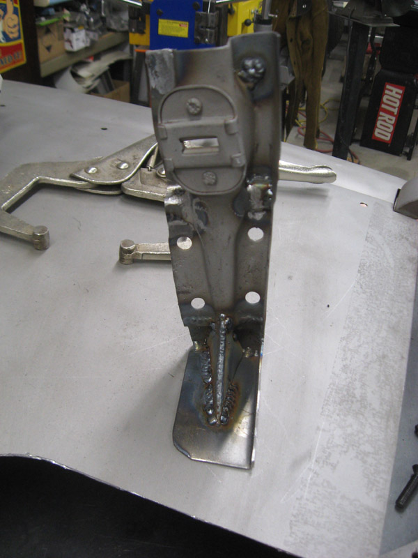

    More br*** had to go so I could plug weld the support bracket.
    You can see it was br*** all the way through.
    Filled in the holes I made earlier and started welding the 5 pieces we fabricated to connect
    the jamb to the bottom of the door.
    Made a triangulated brace to strengthen the 90 degree corner.
    These pieces were tacked together inside the door frame before removing it for final
    welding.
    Finished

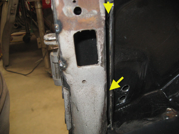

    I used the sheet metal screws to clamp the corner bracket in place.
    Trial fit on the car again. Fits good, ready to weld.
    You can see the small patch installed top right.
    I removed the screws one at a time and replaced them with plug welds.
    Bottom
    Metal finished.
    There, another sub project finished. One more project to go before we can put that

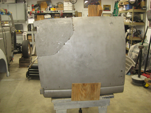

    Well we made some progress on the door skin today.
    I showed you the donor skin a couple of posts ago. This area was folded in about a 1/2"
    It was easy to flatten out but it had some cracks that needed welding.
    I actually did finish this weld . I didn't get carried away though. A little bondo will finish
    off.

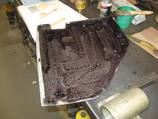

    We treated the back side with the Eastwood rust converter.
    I painted the inside with some Rustoleum last night.

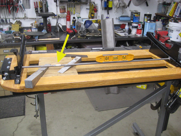

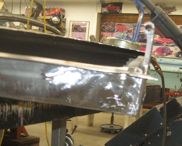

    Well I couldn't put it off anymore so started tacking the patch in today.
    We tried to weld the patch in with the door laying flat. That didn't work because the door
    skin kept sagging and accessing both sides of the weld joint was difficult. So we made a jig
    to hold the door vertical. This allowed us old men to easily reach both sides of door for
    hammer welding.
    Don is working the hammer and dolly and I am welding. I don't know how anyone can
    do the welding and hammering by themselves........ . In this picture it looks like the weld
    area is low but it really isn't. Hopefully we can finish this weld tomorrow.

    I am certain we will be able to use the door but I sure don't like the shrinkage we are seeing. We are moving slowly. The tacks are showing a heat ring of less than 1/2 inch . We are hammering on dolly while the weld is still slightly red. It is pretty frustrating. Tomorrow we are going to try welding on the inside of the door to finish the weld. Maybe that will take some of the dip out of the seam.............
    40LUV and loudbang like this.
  6. alchemy
    Joined: Sep 27, 2002
    Posts: 22,774
    alchemy
    As you know, every weld shrinks the metal. And a MIG weld is hard, so it's tough to smack it and give it a bit of stretch back. If it really won't shape up in certain spots, you could take your torch tip and heat just the weld up to red hot again to soften it, and smack it then. The heat should soften it make it more malleable, and maybe it won't crack. I only do straightening on sheetmetal after I have ground the bead down fairly flat with the edge of a cutoff wheel.
    I don't think welding the other side will make much difference.
    joel, Weedburner 40, loudbang and 3 others like this.

    Alchemy, you were right. It made no difference to weld on the other side. We eventually got the metal to acceptable level of finish to cover it with a skim coat of bondo.... I will show some of the technique in todays post.
    Thank you gentlemen!
    It's been a busy month. we moved onto gapping the doors and a few other sub projects. Lets start with drivers door.
    We used the stud welder to do some shrinking of the weld . We spent a lot of tome chasing
    the oil canning that occurred as the weld cooled. The door looked like it had the measles by
    the time we were done. We got some help from Mike the painter too. In the end I would say
    I am not happy with the finish but it will clean up with skim coat of bondo. It does look much
    better than what we started with.

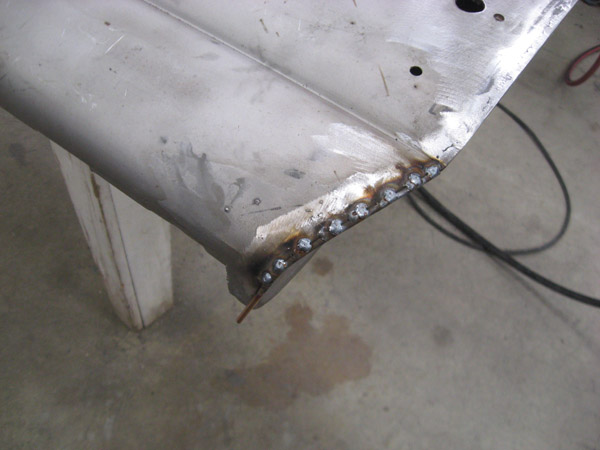

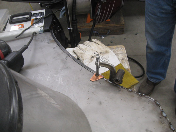

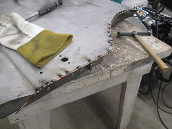

    We moved on to tightening up the door gap. 1/8" welding rod was used to close the gap.
    Getting it tacked on is a challenge.
    The top of the door required two pieces of rod to close up a huge gap.
    A couple of hundred spot welds later the top side is welded on.
    Looking at the back side after some initial grinding you can see the second piece of rod.
    You can see the back side of the door is shown before welding.
    Finished.
    The gaps a lot tighter now. We use a paint stick to set the gap. It is about .111" thick.

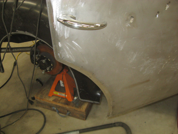

    Time for a little back door work.

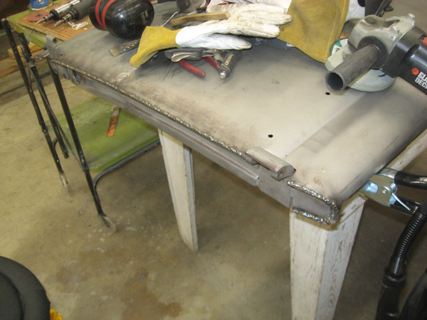

    Try as we might this is the best fit of the rear door and quarter panel we could get.
    The fit was the worst at the bottom.
    More 1/8 " rod. It is interesting how easy this rod is to bend around a corner when it is
    warm from spot welding.
    We decided to use some 16 ga. steel for the largest part of the gap. It matches the thickness
    of the folded over door skin pretty well. I saw this trick on a TV show called Iron Resurrection.
    Rather than use a larger piece of flat steel sheet we cut off a narrow piece and shaped it on the
    shrinker stretcher.
    The metal strip changed shape as it was tacked down a little plier work brought it back to
    the shape of the door.
    Now to connect the spots. A lot of time was given between welds to keep from
    overheating.
    After a couple of days work it came out pretty well.
    I am glad that is done.

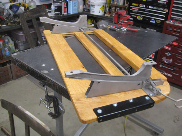

    As with all things on this car I took this system apart a long time ago ( and took no pictures) so I had this pile of parts to sort through and figure out how they went together.

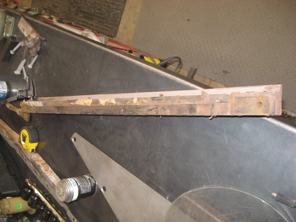

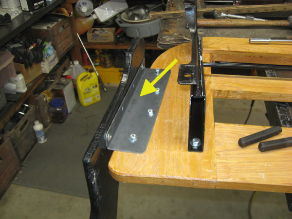

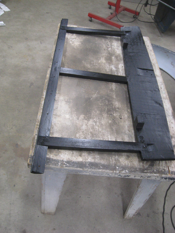

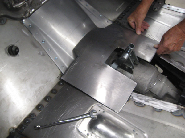

    First item was the forward facing brace for the B pillar. The bottom foot of these supports
    was pretty rusty so we made some new ones.
    Far as I can tell these only had one bolt that went through the floor and frame.
    Boy that looks ugly... I didn't get a pic of this piece smoothed out.
    The bolts for this are carriage type so I drilled out a 5/16" hole and then filed it to square
    with that little square file. Didn't take too long to file it.

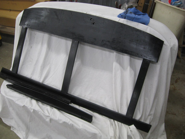

    The vertical section has 4 bolts that go through the wood spacer into the steel B Pillar.

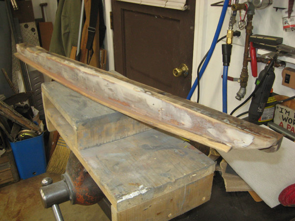

    The wood adapters are an interesting piece. Well built and sturdy. Fortunately they held
    up pretty well. They did suffer some damage from the dis***embly process. They also
    had a lot of tacks in them because they attach upholstery to them.
    I must have used a chisel to take the tin off of this thing. Made some pretty big divets.
    Working with the epoxy putty was like working bondo. It took two or three applications
    to fill the damaged areas.
    I chose to fill the holes and repair the ripped out sections with epoxy fillers.
    I used PC Woody for most of the repairs. the Gorilla 5 minute epoxy was used where the
    ends were split. I have never seen this 5 minute stuff set up in less that 30 minutes!I usually
    give it overnight to cure. It doe appear to shrink some.

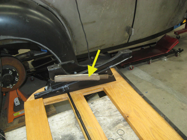

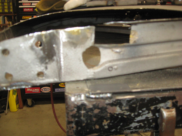

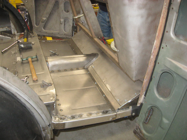

    So once the wood pieces were repaired we could move onto the steel structure.
    The toe board (That's what I call it anyway) was in need of repair in several places.

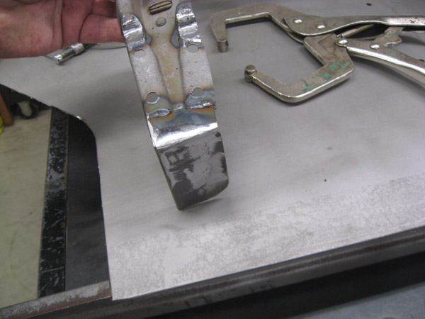

    I made a pattern up for this foot brace support.
    Don was able to fab up a couple of new pieces for this that are extremely accurate.
    Pretty healthy dent here. The holes are from the steel road signs the PO attached to
    this piece to connect to even more road signs that made up the floor.
    Managed to beat that dent out .
    I missed a few photo opportunities during this rebuild process. So we will have to settle
    for a few shots of the ***embly just screwed and clamped together.
    There is another steel sheet that will be tacked or screwed across the wood center support.
    The foot of the toe board was replaced with a 20 gauge piece. It was offset where it interfaces
    with the original piece of the toe board. That way the repair should not show through
    the insulation and carpet.

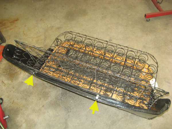

    I have four seat heaters for this car but I would like to have something to warm my legs
    and feet. We are currently ***embling the front seat ***embly so we can put the seat in
    and determine how much room we have to make that heater happen.

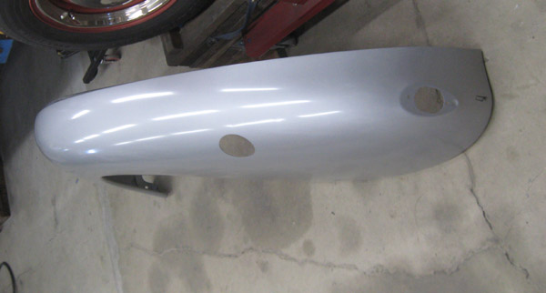

    The big news for this week is the arrival of my brand new rear fenders that I purchased from Dennis Carpenter last week after years of consideration. The fenders I had were pretty lumpy, Repairable? Yes but I decided to take the easy way out this time. They are very expensive and the shipping from the East Coast to West Coast was outrageous!
    I was very concerned about the packaging of the fenders considering the expense and fragility
    of the sheet metal parts. I was ***ured that they were well packaged and placed on a pallet.
    So after 10 days in route the finally arrived. The driver went to the front of the trailer and
    tried to move the box and pallet toward the tail gate. Since the box was no longer strapped to the
    the pallet this was difficult . Since he knew I was watching him he abandoned the pallet and moved
    the boxes easily to the end of the trailer by hand. Despite the clear marking on the boxes they had
    removed the boxes from the pallet so they could put them on top of other freight. Fortunately
    there was no damage to the fenders:)
    You should always inspect sheet metal parts before you let the driver leave. When I told him I was
    going to inspect the contents he said he had to take a picture first. Fortunately I did not have to file
    a claim despite them not following the instructions for handling. My son tells me the drivers have
    to honor your wish to inspect the freight. My driver was very cooperative.
    The fenders are painted with a silver coating . One is quite shinny and smooth, the other less so.
    So far the only flaw I see is two small dents just above the gas cap hole. You can't see
    them in this picture and they will be easy to fix and some marks from the cardboard
    packaging. I was not impressed with the protective packaging they used but the parts
    got here in one piece.
    I hope to try them on this week and will let you know how they fit.

    I have been busy with a lot of other things lately but I'll post a little today. I decided to restore the front seat awhile back. As with most things on the car I didn't take any pictures when I tore it down for storage many years ago. Fortunately I did bag and tag the parts and order what parts I could.
    I enjoy learning about Fords methods of building this car. These side panels were interesting.
    The wood and steel were in pretty bad shape but construction methods are there allowing
    me to put it together correctly and maybe help the upholstery guy out in the futrure.

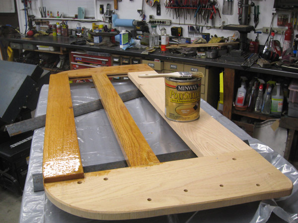

    The seat back wasn't in too bad of shape. I did replace most of the T nuts.
    The top edge center tac area was pretty chewed up so I rebuilt it with PC Woody .
    After some bead blasting of the steel parts I did a test fit on the old base.
    Minwax poly was used on the wood parts.
    The seat bottom also needed new T Nuts.
    A test fit of the seat runners on the new base indicated that new base had the mounting holes
    for the bases closer together that the original base (figures). This caused the slide mechanism
    to bind.So the shaft that joins the two sidestogether had to be shortened.
    I cut the shaft in half and then shortened it about 3/16". I found this spacer/coupling in
    the parts bin and it fit perfectly. Drilled some plug weld holes in it.
    It was a little tricky getting the shaft straight enough for welding but these aluminum
    wedges did the trick.
    Works now.

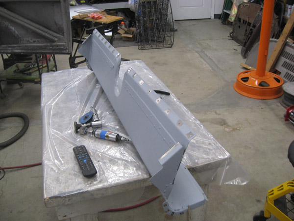

    More on the seat project.
    Had to make this piece twice. the first time we copied the rusty parts that came with the seat.
    We could not get the formed steel piece that goes between the seat base and the seat back
    to fit. So we had to make them a little taller the second time.
    Test fit
    After a test fit in the car to determine where to drill the holes for mounting and where
    to cut out the steel panel for for seat belts.

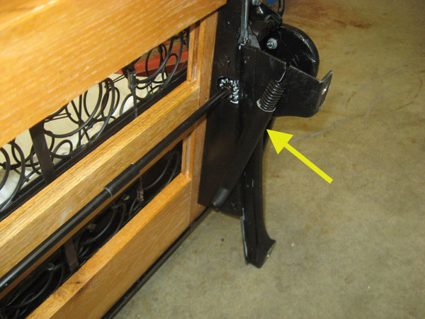

    After a lot of searching and giving up that search I finally stumbled across the retracting
    springs.
    I also found these needle bearing gizmos(right arrow). we were wondering why the seat
    didn't slide very well before we found these . Works great now.
    One of my friends wife sewed up some new sheaths for the springs. made this little
    tool from welding rod to stretch the springs.
    The needle bearings run on these 1/4" pins
    I saw a notch seat back . I decided Ford must have hung the back rest spring there so I
    bent some hanger brackets from 18 gauge steel.
    Since Ford didn't offer seat belts back in the day we had to figure out where to make some
    holes for them. I folded over the top and bottom edged to make a smooth surface for the belts
    to p*** through. I think I will use some plastic edging material on the sides.
    I bought these springs along time ago through Mac's (I think)
    So there we go the seat is basically finished.

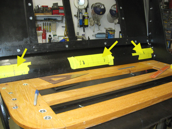

    Hello! It's been a busy summer here but we have made some progress on the project.
    There was still some work to be done on the B pillar ***embly.
    The wood back had some cracks and a lot of holes from the tacks
    Had to bad but still needed some repair.
    The holes were filled with epoxy fillers and glues and after lots of s****ing and sanding
    The wood parts were painted with rustolueum semi gloss black .
    I installed T nuts where the grab rope attaches. They just had wood screws in there before
    but I didn't want to have those screws pull out when my overweight old self pulls on that
    rope to get out of that deep back seat.
    Since the toe board covers the floor here and will be hard to paint some epoxy primer
    on the floor before we installed the ***embly.
    This repaired toe board had to be welded in place.
    So here it is all installed. Simple tac's attach the sheet metal parts to wood pieces. I was
    surprised at how sturdy this ***embly was once installed. This car which used to wag
    like a dogs tail is really solid now.

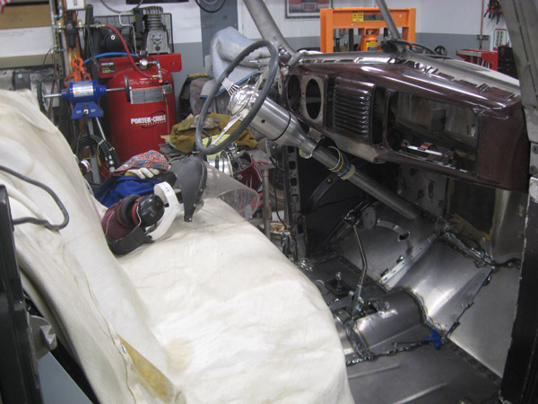

    So it was time to test fit the seat and see how my body was going to fit in this car.
    I discovered that the seat in this car is narrower than in my 40 coupe. The combination
    of the B pillar supports and the plywood seat side supports narrows down the actual room
    available for large carc***. Then there is the leg room.... It little shorter than my forty coupe.
    With the seat all the way back I think I will be comfortable enough.

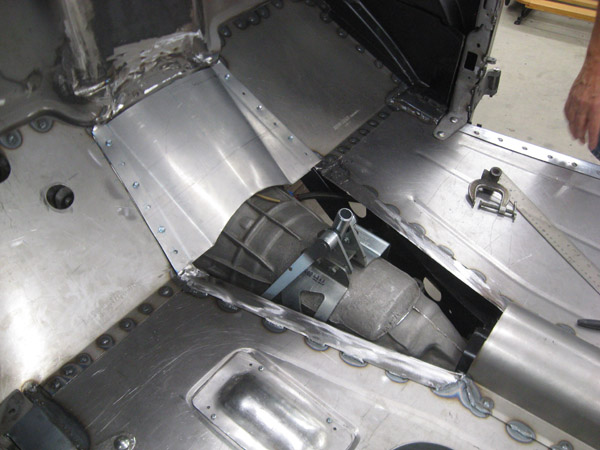

    The other thing that came up when I put that seat in there is that my size 14 foot did
    not fit between the brake pedal and the flywheel/transmission cover I was so proud of.
    So it had to go.
    We cut it back to here.
    You can see that we really didn't need anywhere near the clearance we had for the transmission.
    So back to fabricating. Notice the high tech shaping tool (coffee can filled with concrete).
    We flattened out the drive shaft tunnel.
    It took three pieces to make the change. A lot of work and not as pretty as the cover
    it replaces but more functional for this application.
    This picture is jumping ahead a little but you can see the flange we added to the top
    of the new trans cover. Now this cover pretty much looks just like a stock 39 Ford
    transmission cover. The best part is my size 14 now fits and the pedal position is very
    comfortable.

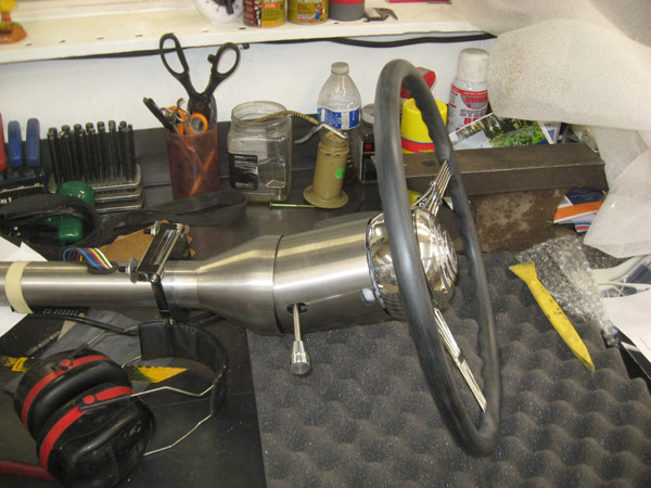

    The banjo steering wheel I ordered from Jullionos finally came in after a long wait. It
    was worth it the wait. It is a beautiful piece.

    While we were working in this A pillar area I decided to fill this gap between the new cowl
    and the original A pillar.
    rather than hammer the **** out of this piece or apply a lot of heat I decided to add
    some welding rod and fill it.
    The results are good. Should be plenty strong. I also put some weld on the A pillar foot.
