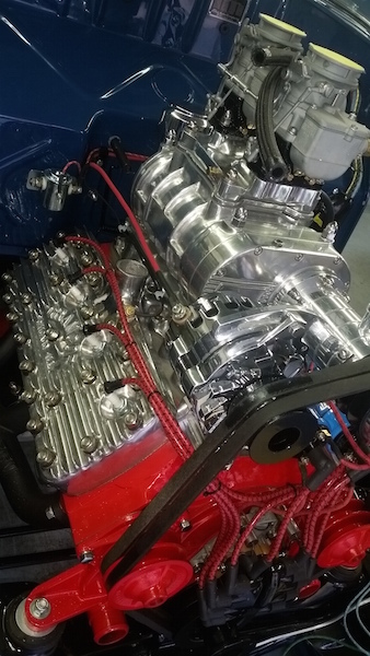

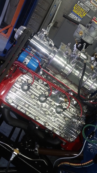

  1. Here are some pics of the project that I have been working on the last year or so. I hope to have it finished soon and drive it to California to see some of you guys! :) 20170703_140358.jpg 20170703_140408.jpg 20170706_114843.jpg 20170706_114917.jpg 20170706_114934.jpg 20170706_153841.jpg 20170706_153855.jpg 20170706_153906.jpg 20170706_153918.jpg P1010002.JPG

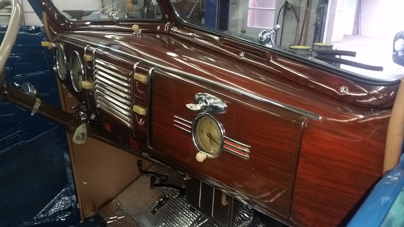

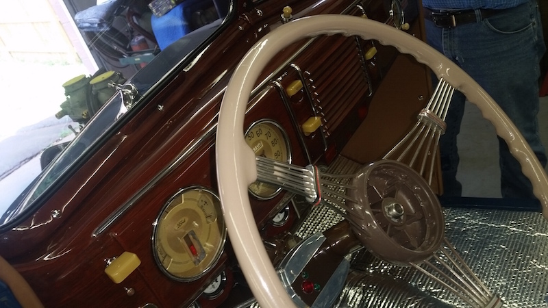

    Beautiful car. What is the extra dash knob on the left side of the speedo for?

  23. The knob on the left side of the dash is the Headlight switch.

    Lots of fine Fords have been built over the years in this garage but this one has got to be one of the best. Love those Grancor heads. Congratulations on a spectacular build.
  25. The knob on the left side of the speedo is the headlight switch.I don't use the bail at the end of the column. I just run the horn wire thru there. When I wire the car I use fuses and relays on the horn headlight and fuel pump. Also the original ignition switch has a relay to control it to take the load off the switch, it just acts as a trigger.

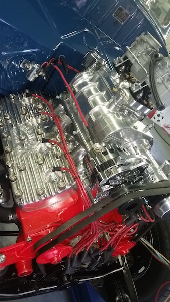

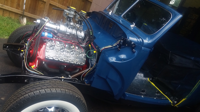

    I just hope there's enough contact/wrap on the blower pulley. Prob. ok at low revs.
  29. I am using the original columbia valve that bolts to the steering box. The blower wrap will work thats the reason for double belts. Boost will only be 6 pounds . If it does not and you can't see it in the picture I have machined a idle pulley with bearings I will install. Will have to change the belt length.
