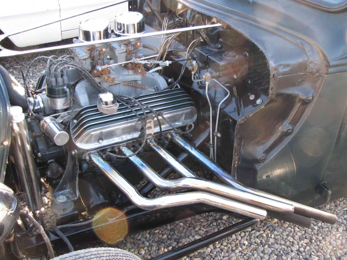

    I'd be more inclined to hide a SBF. They may run good, but they are not a good looking engine, and shoehorning them into an early Ford always looks a bit Rube Goldberg to me.
    Here's a SBF in what looks like a 39 Ford truck. I don't mean to demean the guys truck, but it's not an especially good looking engine, is it? Well, I guess these things are subjective, beauty is in the eye of the beholder after all.
    Anyway, I took the pics yesterday Bob, to post them here for you. Hope they help.
