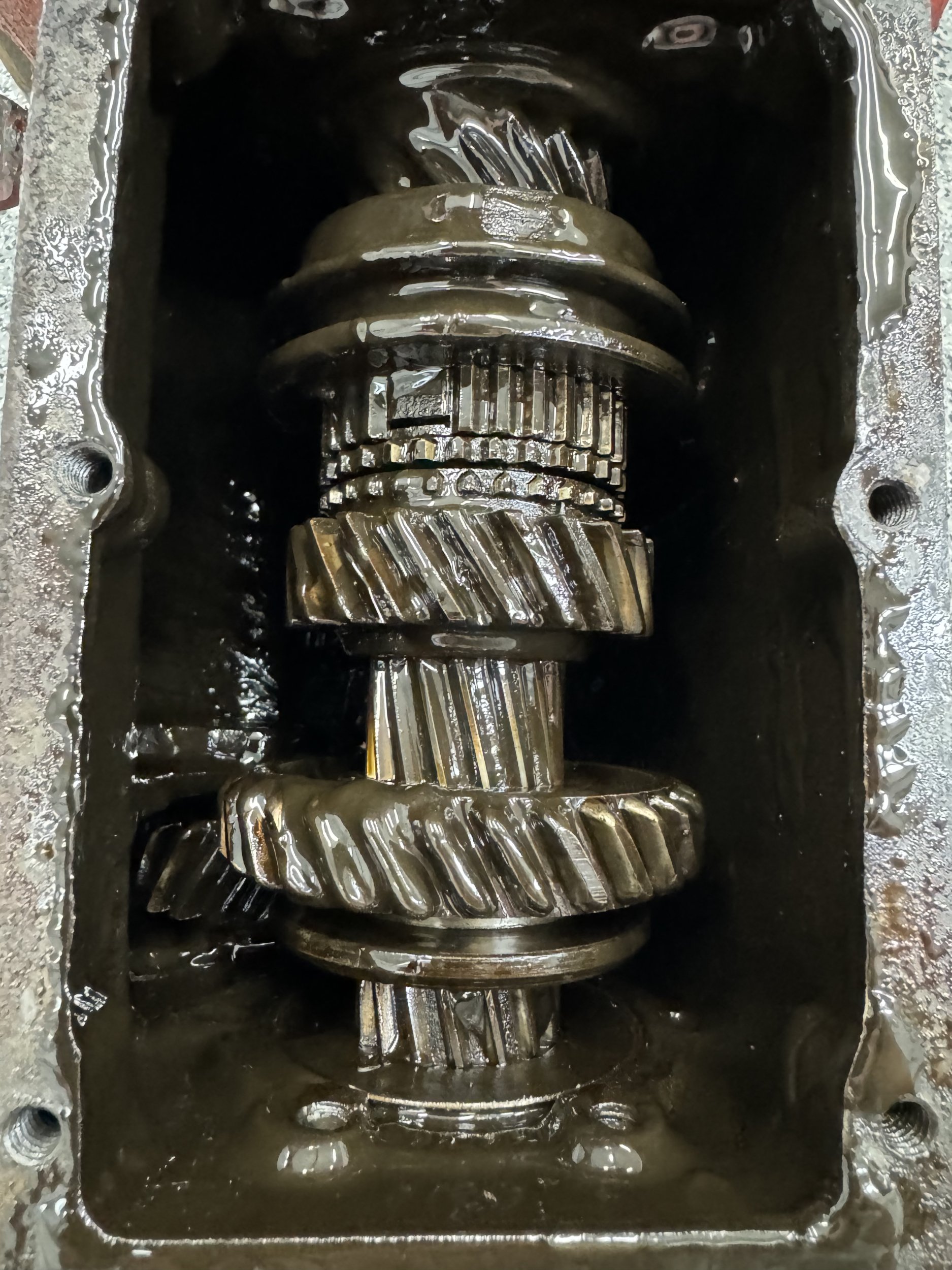

    I have a set of gears that’s in a 78-7006 case. Only have a single synchronizer and not a match for anything on line

    shift it into neutral? it's in high gear right now. This is the late 30s transmission, according to van pelt

    Squirrel is correct…..it’s a typical 1939 style ge****t with the late type synchro ***embly. The one in the first photo is shifted into high gear. The one in the second photo is in the neutral position. It’s almost impossible to determine which ratio ge****t is there (from the photo) but that can be determined by counting the gear teeth.
