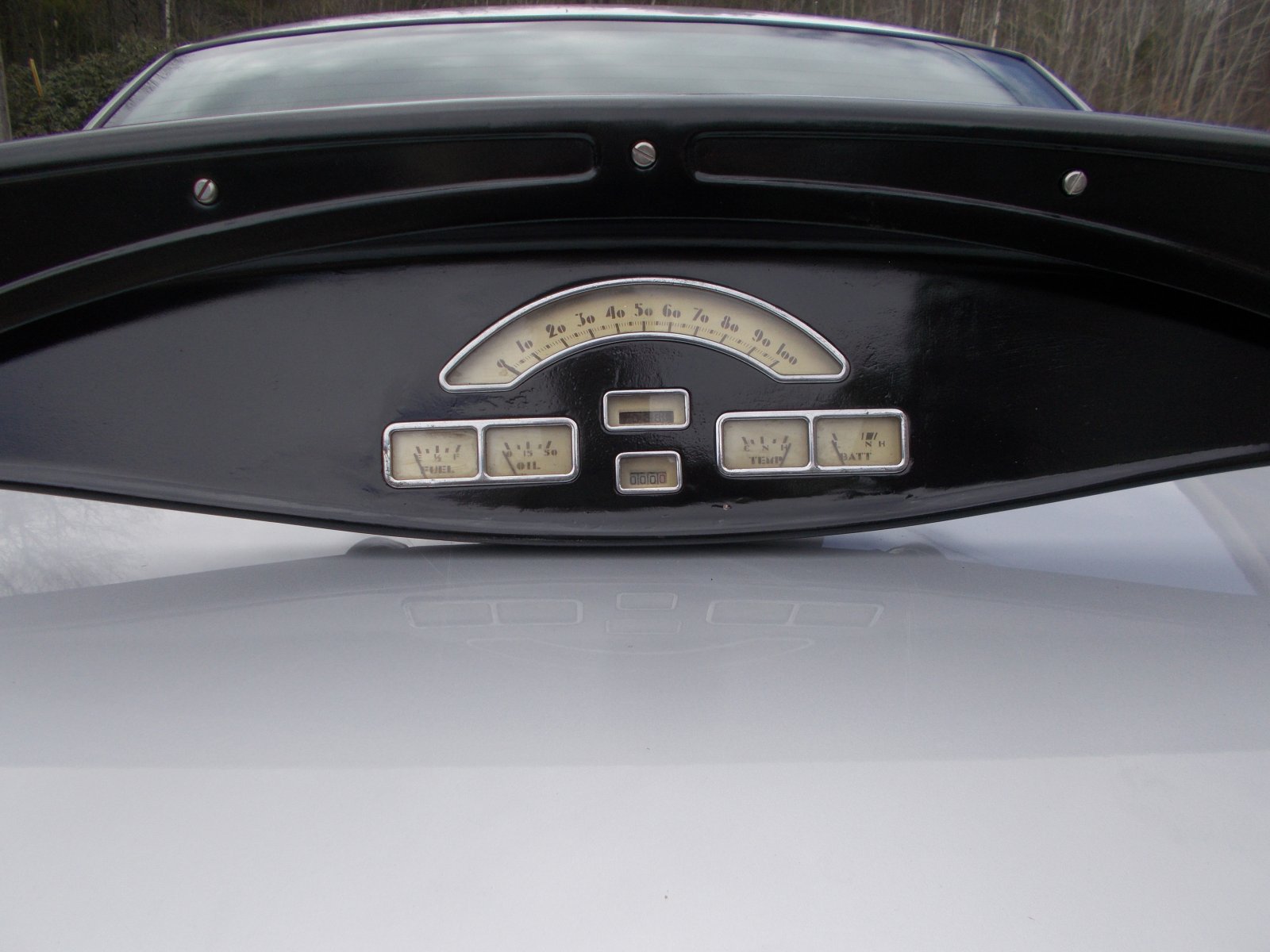

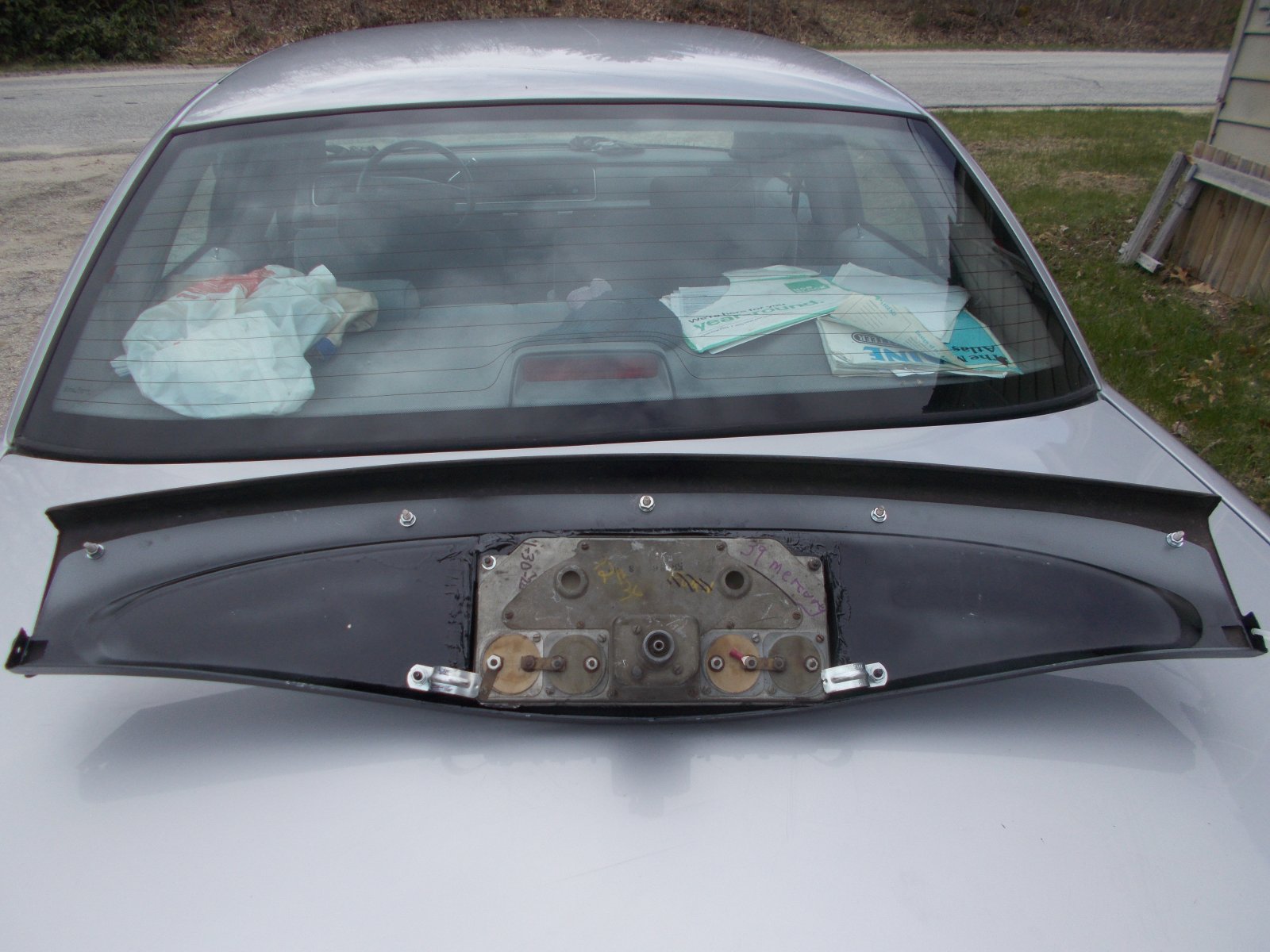

    welded a couple 1/4"-20's to the back side of the dash face...
    they will help press the bottom half of the cluster against the dash, the gauge holes will hold the cluster up...
    almost useless coat of bondo on the dash face... not good at spreading mud...
    got a pretty good dash rail from a buddy, step drilled the "starter ****on" hole out to 1/2", welded a 1/4" flat washer into the hole...
    engine grey then covered with cheapo black paint as a test...
    new computer not set up for pix yet...
    pix ?,,,

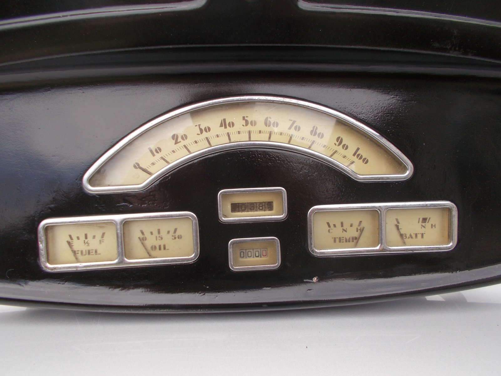

    trying the new computer... mikie likes it ! ... well the dash not computer.

    Looks awesome @sloppy jalopies...you did a great job on that...that's a fair bit of critical cuts and fitting to get that cluster into that panel...

    DSCN8188.JPG stogy,
    after re-reading you latest comment i think that you think i cut the cluster face holes...
    i did not, i cut down the stock merc cover panel and welded it into the A dash.face...

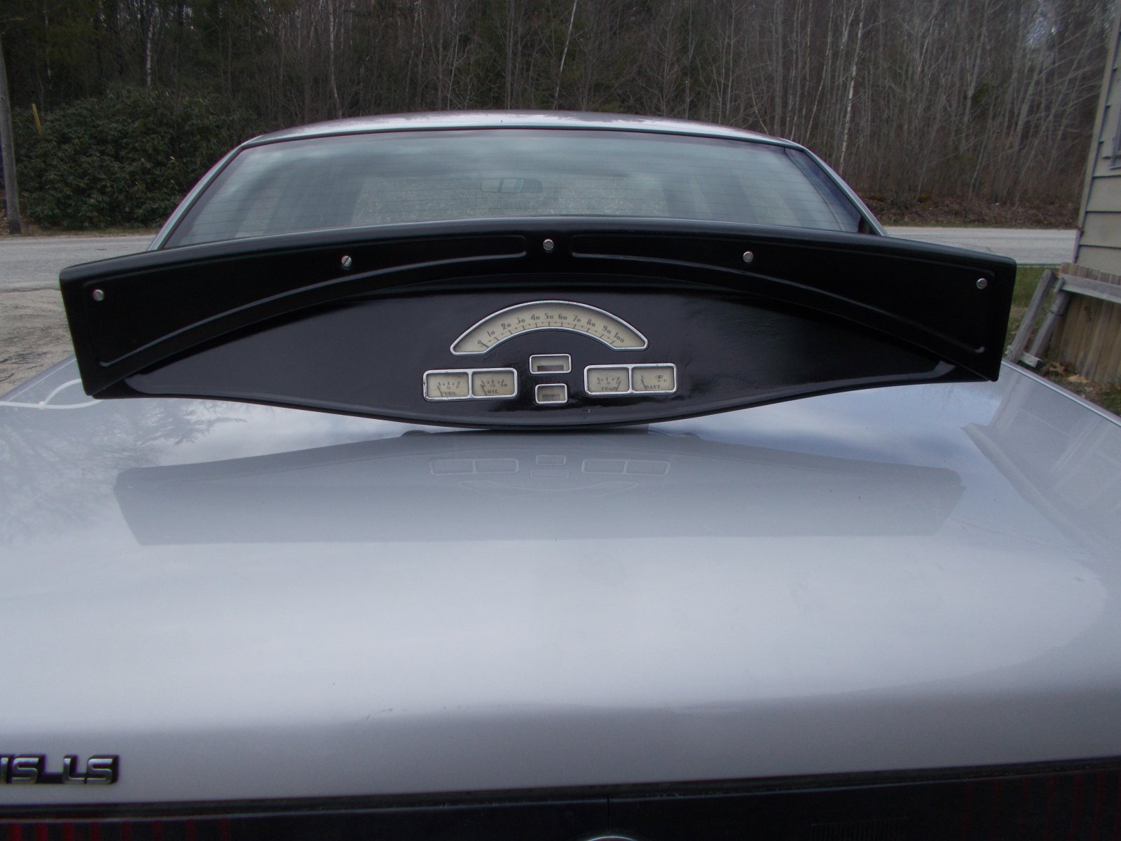

  14. sloppy jalopies
    Joined: Jun 29, 2015
    Posts: 5,256
    sloppy jalopies
    going to put this one up for sale if my new computer will let me do anything...

    50s cat,
    i can see why... yours looks great,
    wish i had seen yours first, as i would have moved my cluster slightly higher...
    who knew...
