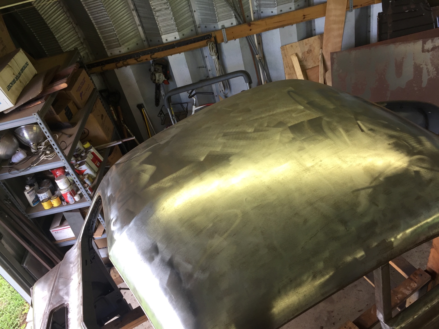

    Anyway, as I said earlier, I decided to strip the body manually and this was the weekend to do it. I started by cutting off the drip rails as the p***enger side was almost rotted off anyway.
    I used aircraft stripper followed by wire brush, wire wheel on the electric grinder, and final clean up with my new Eastwood contour sander to remove the surface rust.

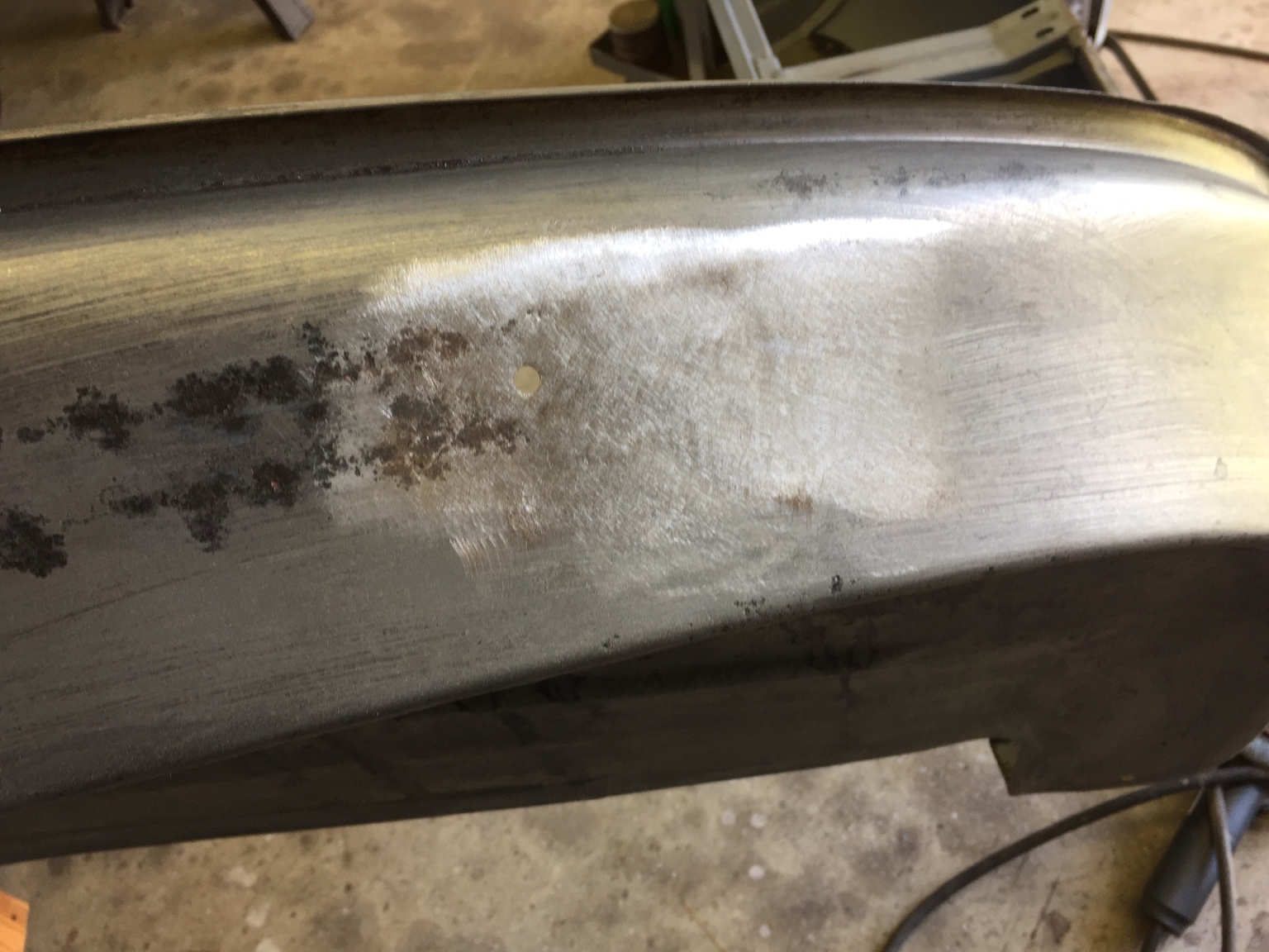

    Took the day off and got a chance to patch the last few rusted areas on the body. There was rust through where the trim ends on both sides. One side was actually just badly pitted so I put in a small patch as well.
    Other side

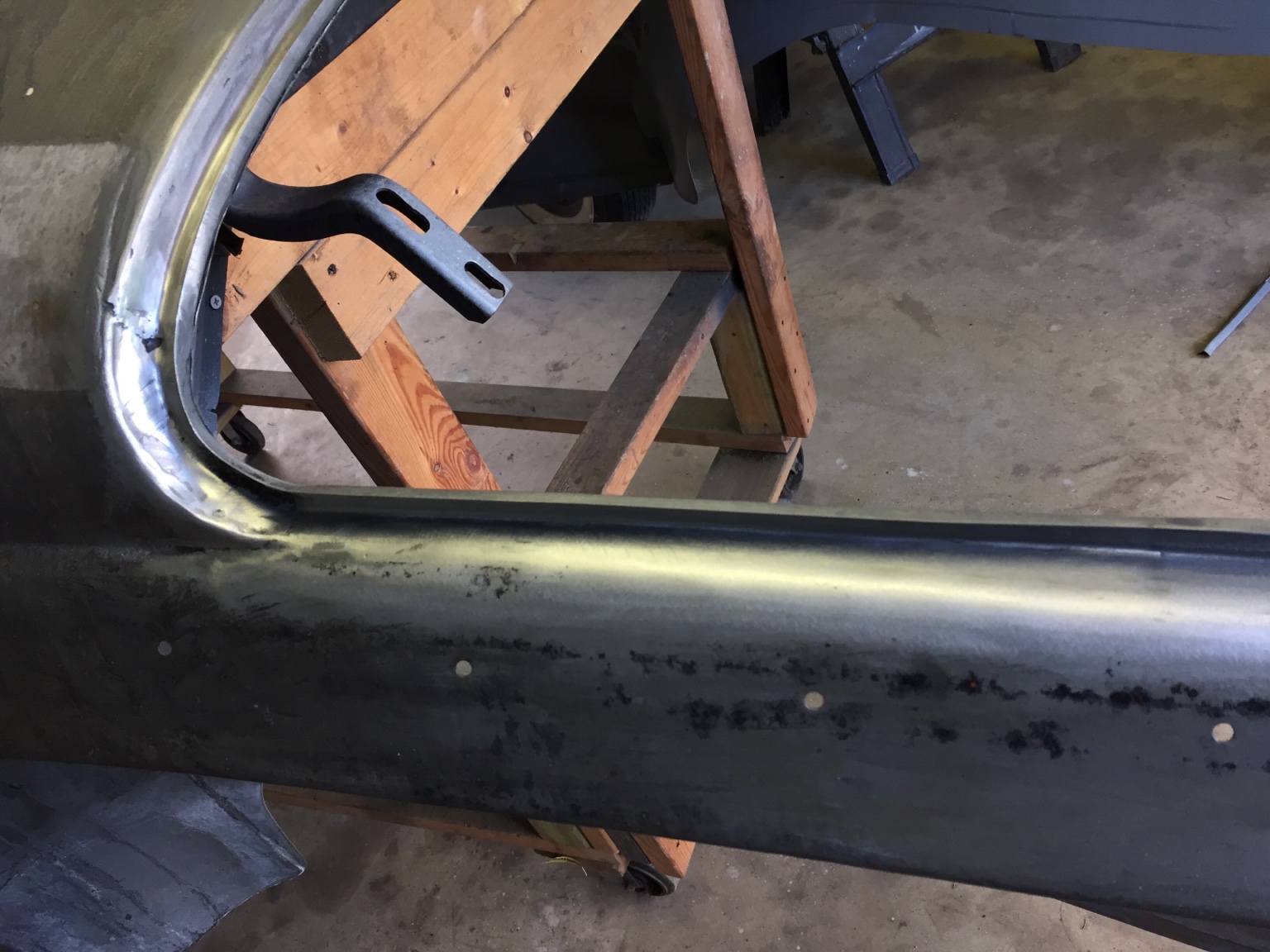

    Moving on the the wheel well. The blasting uncovered a few holes where the body is braced on the inside.
    Pretty trivial, really....

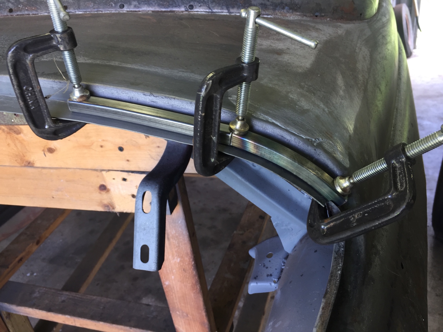

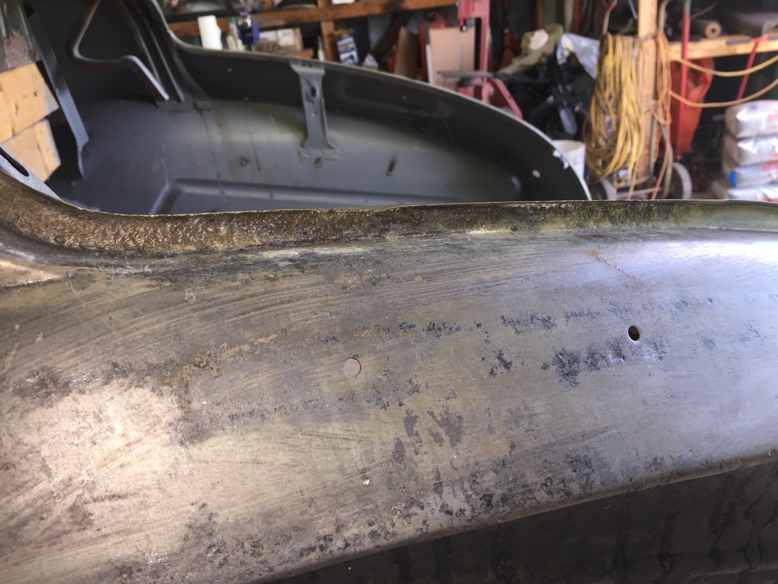

    On to the trunk gutter. This is something new and I tossed around a few idea how to tackle it. The problem is that the gutter is curved in both planes and it is hard to weld in place or finish if it is fully shaped as a u-channel before it is welded in place. Here is what I'm working with...
    I am not trying to replace the whole piece at once, but break it down in 4 sections to make it more manageable.

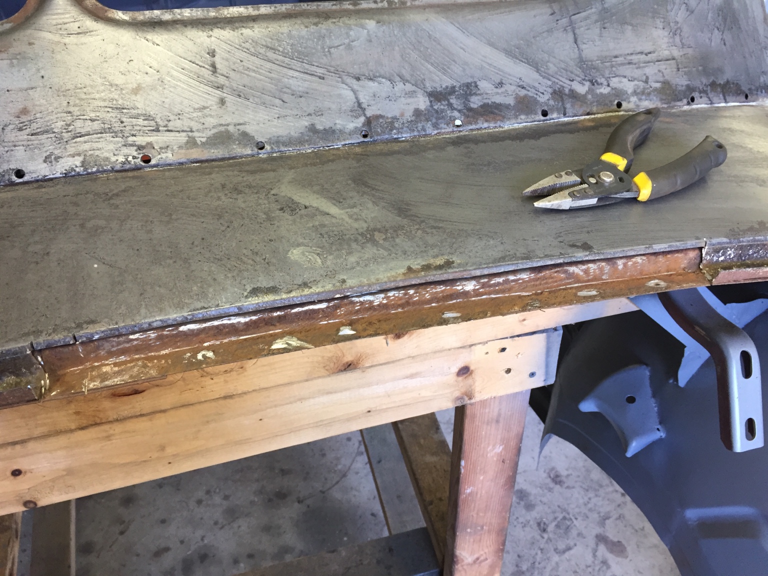

    First, cutting out the rotted section. The spot welds are on the bottom and are visible from the underside after running the grinder over the metal. I'm just using the cut off wheel to grind through from the inside of the channel and peel it back like opening a tuna can.
    A little clean up and Ospho treatment will take care of this

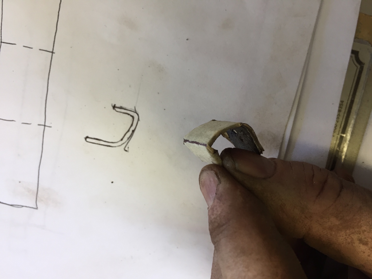

    Before I started I cut out a small section to make a template
    I used masking tape and pen lines at the middle of the corners get the flat dimensions. With the tape on the outside, I know I probably have the dimension a little on the long side.
    I used the brake to make the first bend. Adjusting the plate of the brake about 1/8" away from the actual edge results in the rounded corner like the original. As predicted I had to shorten the 15mm dimension to 13.5 mm to be able to fit the piece.
    The catwalk moved up almost 1/8" in the middle when I cut the gutter out. I'm glad I only did a short section. "Aim small, miss small!"
    I used the contour gage to compare the profile has not changed by comparing both sides.
    What I don't show is that I used the pneumatic punch to make new holes for the plug welds in the inner structure about 2" apart, then welded the new angle piece in place from the bottom.
    Working with an angle piece let's me adjust the curvature in both planes at will by using the shrinker and stretcher. This would not have been possible if I had shaped the channel into its finished u-shape!
    Here is the angle piece welded in place
    The idea is to use the square 1/2" tube as a backer and hammer the edge over until vertical. But first I will replace the entire length of gutter.

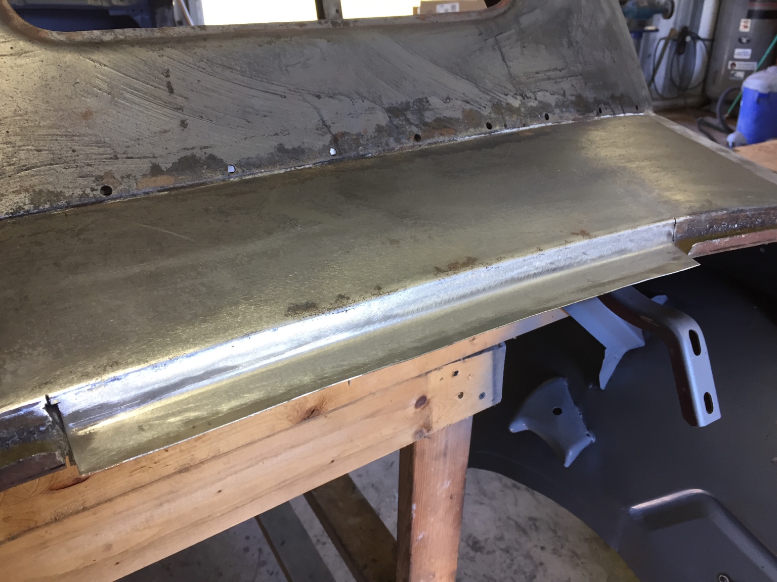

    I bent a few short sections and made a square connector piece to align the individual sections. Bending the tube to confirm over a longer length is tedious and does not work well because a square tube only bends parallel to the sides, but the flange is angled in relation to the curvature.
    I used a dolly to slowly bend the edge. It has to be a gradual transition else the metal will be stretched. Repositioning of the clamps is required to get to all spots.
    Last step was to scribe the final height of the lip and grind off excess. Really happy how this turned out.

    A trick which made the job easier was to cut the square tubing every inch or two and leave only one surface intact as shown in the picture above with the connector piece. It lets the tubing conform to the curvature without pre-bending or forcing the underlying metal.

    I decided to replace a 10" section on the driver side where there was heavy surface rust.
    Shaping the new piece with the correct curvature.
    Making a template to determine how much to remove
    Marking the metal using the template
    All done!

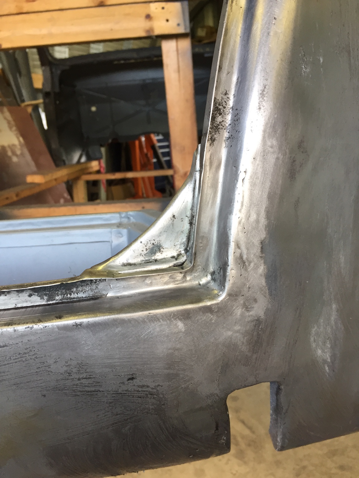

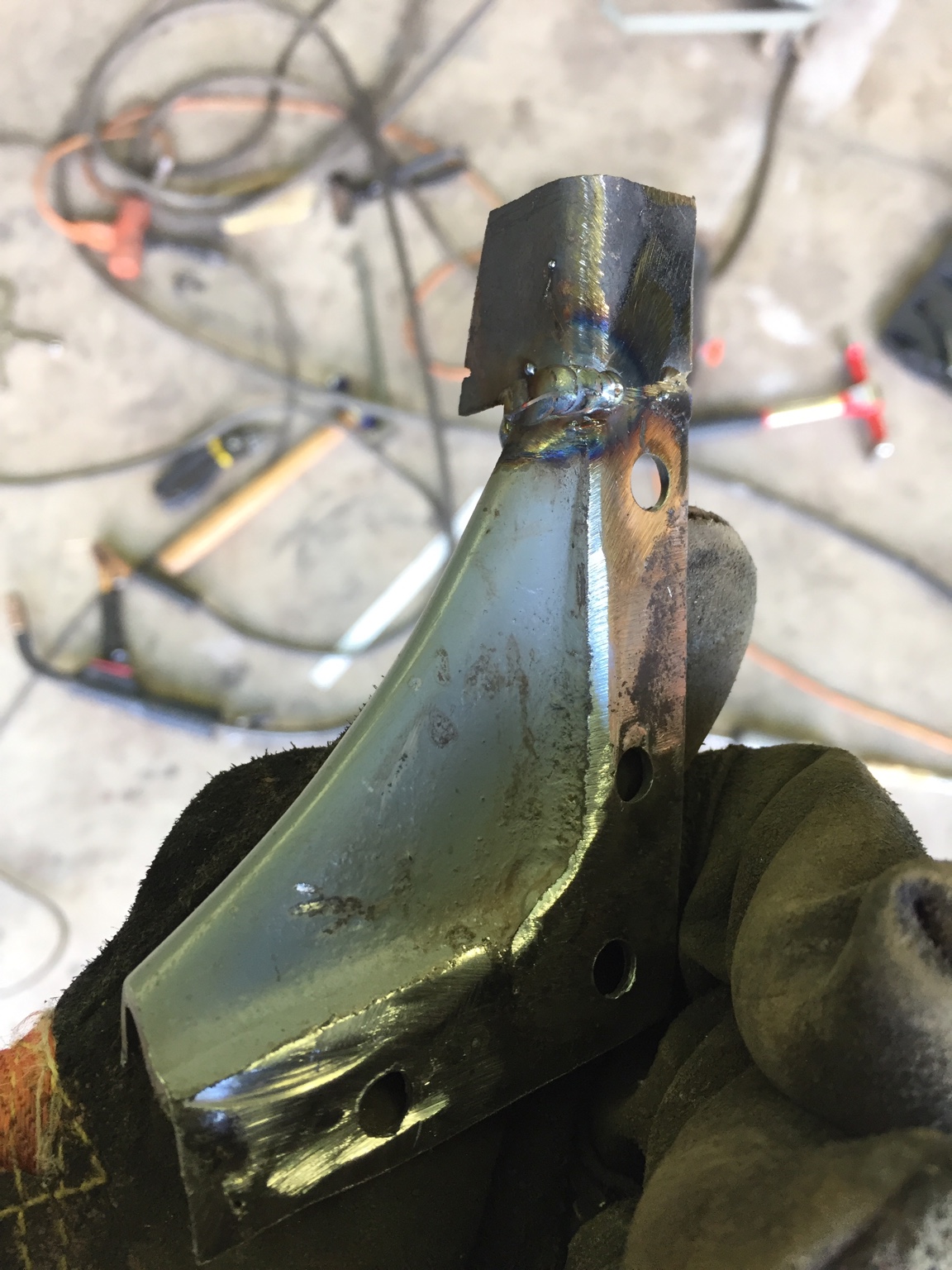

    The lower right corner looked a little crusty and I decided to cut the whole thing out, which in the end was not really necessary because the rust was limited to the outer skin where the spot welds are.
    The inner structure was reused but needed a corner replaced from cutting out.
    I had replaced the lower corner of the body earlier, but it still needs some final tweaking. The reverse curve is somewhat tricky to figure out..

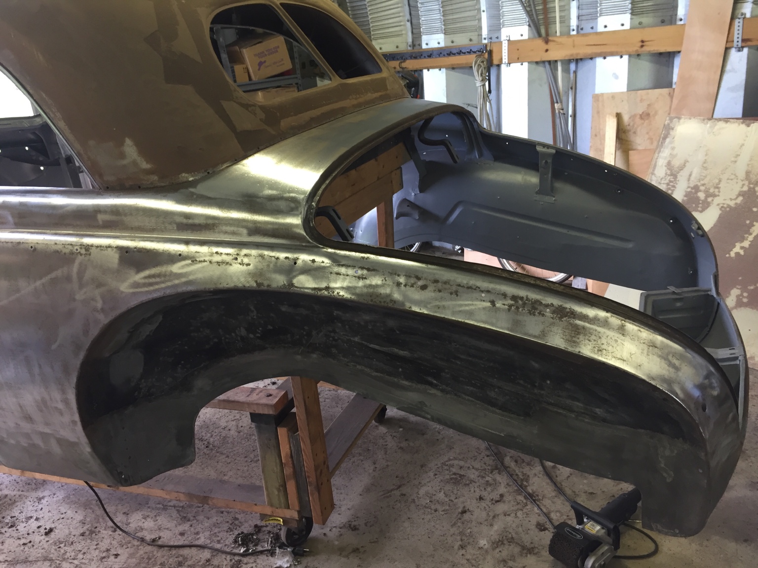

    Anyway, I had a couple of days to get the body stripped back to bare after leaving it in Ospho. I really should have wiped it off immediately after applying. Would have saved me some work. I used the wire wheel, Eastwood surface conditioner, DA and hand sanding. I also spent a couple of hours sandblasting the rust pits.
    The wheel wells were kind of porous in the surface after bead blasting and I decided to apply POR 15 surface prep (similar to Ospho) and and the rust encapsulator to seal the surface. Before POR15...
    Ready for DTM primer.
