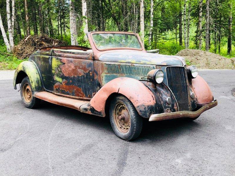

    Is that a 5 window Coupe, with the roof whacked off???
    Not for the faint of heart.

    It’s a 1936 Club cabriolet

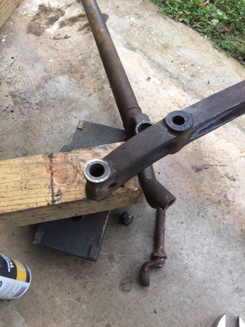

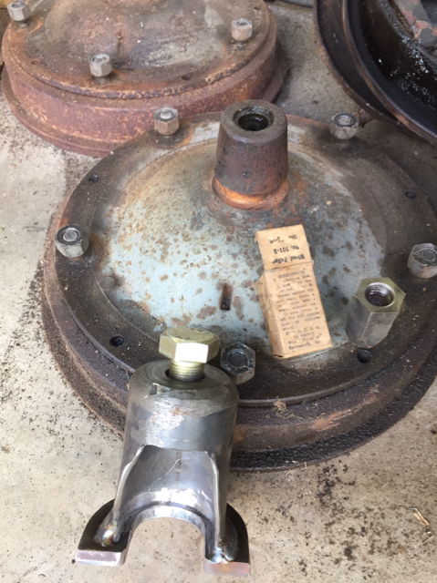

    I decided to strip the frame and suspension parts. I made an axle puller for the rear drums but the first iteration deformed like taffy due to the insufficient thickness of the bottom flange (had suspected as much but gave it a try). Had success after making a 3/8” flange which was welded from both the inside and outside.
    I also bought a NOS axle knocker, basically an oversized Acorn nut which bottoms out on the axle and can then be hit with a sledge to break the bond between axle and hub.
    After a couple of whacks the puller made short work of it.
    The axle bolts / perches were extremely stubborn and repeated heating, penetrating oil,etc. only let me remove one nut with the impact wrench. The second ended up rounded and mangled beyond hope. I ended up chiseling out little pieces and cutting the perch flush. More heating and banging finally drove the perch out. With the first perch out I could rotate the axle to break the bond in the radius rod. But it took a come along - no chance by hand. Now the perch still held to the axle, but some creative hammer work finally got it out.

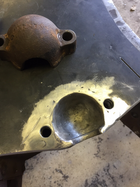

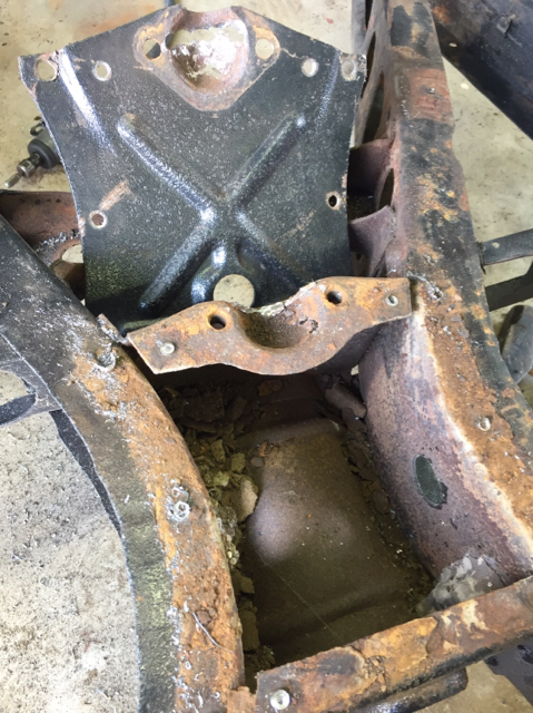

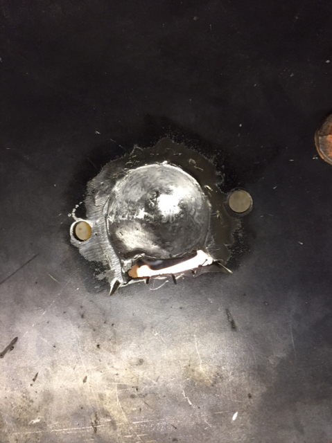

    Removed the spacer from the rear crossmember.
    Interesting to see that Ford used their own version of pop rivets.
    The problem area is the socket of the wishbone, where water ac***ulated between the rubber ball and the metal and rusted out the metal.
    I removed the crossmember plate to fix the rust through an d found the underlying socket to be rusted as well. I got a model A stamped cap, but it uses a larger 2.2” rubber ball, compared to the 39/40 Merc with two diameters.
    I decided to try to use the model A cap inside the frame, and make a new thicker crossmember plate to take up the space. The problem is obviously how to make a socket to reduce the diameter from 2.17” to 1.8” of the Merc rubber ball.
    I had a 3/16” plate which is the right thickness, but without a BIG press or forge there is no easy way to shape the cup.
    [​IMG][​IMG][​IMG]
    I pie cut the area to be able to hammer small section against the stamped piece. I made a separate piece for the center and started tracking everything in place. Now I wouldn’t have done this if it were not just a spacer. The overall thickness of the cup will be 3/8”, about double the stock thickness, once the model A cup is welded in place. There will be a lot of welding and grinding. But I’ll give it a try. It’s only metal...

    So maybe heating it up with a torch... and getting a ball from a trailer hitch/reciever in the right size and hammer that down on the plate would save the grinding time. Just a thought.
    swissmike likes this.
  19. 59Tele
    Joined: Feb 5, 2016
    Posts: 129
    59Tele
    What about using a piece of a trailer hitch that fits over the ball?
  20. swissmike
    Joined: Oct 22, 2003
    Posts: 1,297
    swissmike
    Good ideas, but I don’t have a hitch laying around. I found metal places which make half spheres, but only in .120“ thickness.

    Grinding and welding inside and outside...
    [​IMG][​IMG][​IMG][​IMG]
    After cutting out the stock inner socket, fabricating the new piece using the model a cap.

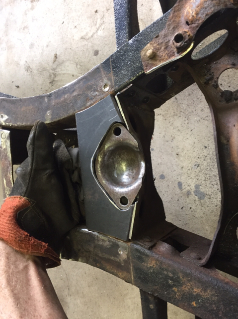

    The bolt pattern of the Merc cap is smaller so the holes had to be filled and redrilled. I temporarily tacked the inner and outer pieces together to make sure everything is lined up.
    Welding in the nuts and using weld through primer before welding the inner plate in place.
    I added slots in the top plate to bend the sides down so they contact the crossmember. The two vertical pieces are about 1/8” taller than the crossmember. I suspect this was done to register the stock plate side to side during ***embly. Anyway, I wanted to keep the socket at the same height so I will bend the ends down before welding the plate in place. I will use JB weld to fill any irregularities and gaps between inner and outer socket and to keep rust from forming.

    Final fitment; applying some jB weld to fill any remaining voids between the spheres and clamping in place. I will weld the plate solid after cure.

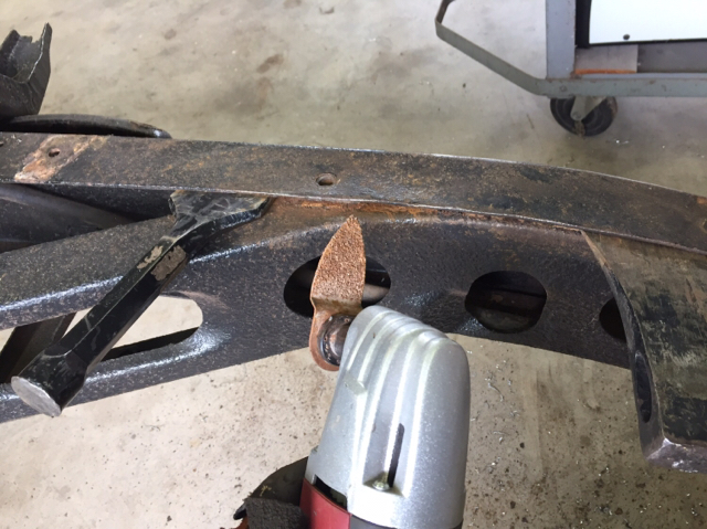

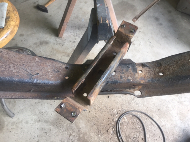

    Moving on to popping some frame rivets where rust developed between x member and frame rail at low spots on the lower rail.
    I drilled out the rivets and use an HF oscillating tool with flat carbide burr while keeping a gap open using a chisel and whatever I had laying around, working on small increments.
    After getting all loose rust out I used metal prep to neutralize the remaining rust and prepare for Por15 application next week.
    Letting everything dry out now...
    Starting to straighten the frame rails and crossmember using whatever fits in addition to the trusty BFH and dolly.
    I will use 3/8” carriage bolts with the heads slightly ground down to mimic the stock rivets. Thought about welding the frame and x member along the seam but decided against. Don’t want to trap water in the seam and also don’t want to locally change the springiness of the frame. There are cracks in the frame where the rear lever arm shocks were mounted. Work hardening of the frame eventually led to material failure. Will be easy to fix, but don’t want to provoke a similar result by welding in boxing plate/ x member.
