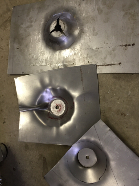

    The plan is to use the wooden buck and an aluminum puck and shape the cup shape using the hydraulic shop press.
    I sprayed the bottom of the panel and the buck with spray adhesive to increase the friction, the clamp the top wood pieces down to keep the panel flat during the process.
    First try with the aluminum puck cut the panel around the puck. I only had a small chamfer on it and didn't expect it to cut the panel.
    I cleaned up one of the original cupped washers and used it to more evenly spread the force. I used grease between the washer and panel.
    Kage and chryslerfan55 like this.
  7. swissmike
    Joined: Oct 22, 2003
    Posts: 1,297
    swissmike
    This seemed to work better, but the panel really stiffened up before I got to the desired depth. Maybe it needs just some extra pressure... there, now it starts moving again... Oops...Mercedes hubcap anyone?
    The bitter taste of failure...
    Let's try again and stop when the panel starts to stiffen, then mark the depth on the press and repeat with the second panel.
    Success! About 1/4" short of the stock height, but will fabricate a washer to take up the space.
    Now I have two pieces to shape the missing corner pieces. Not the most productive afternoon...

    You mentioned using spray adhesive to increase the friction of the sheet and bottom form. Did you try one without the adhesive? I'm wondering if the slightly lower resistance may allow the puck to full from farther out and get you that last 1/4". Just curious, as I have only limited experience with forming. Looking forward to seeing the finished floor.
  12. swissmike
    Posts: 1,297
    swissmike
    I tried that and it resulted in the failed sample with the fold in the material (middle sample in the picture). The problem is that the the force causes less material stretching around the outer periphery than in the middle at the edge of the puck, because the same force is spread over a longer distance. The material wants to fold rather than stretch at the outer edge.
