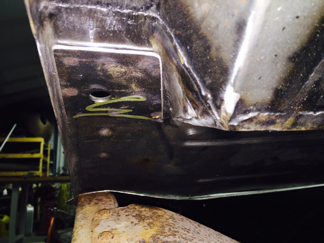

    Tiny update: added the mounting holes on the trunk panel and cut and fabricated a cover for the rear spring shackles. The mounting holes have a reinforcement piece spot welded on the underside.
    And here is the cover. The bead came out crooked but it's not easy doing it with a manual bead roller and only using one hand to control the panel. Let good enough be good enough...
    I used PEM nuts in the trunk floor so I don't have to worry about removing and replacing the cover.

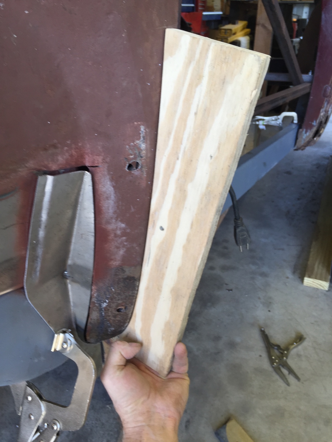

    Got the seat riser panel blasted. It's pretty rough and needs several patches. I started with the two curved pieces on the outside. I cut a piece of wood for shaping the slightly curved shape of the bent edge, the used the shrinker to put the bend in the panel.

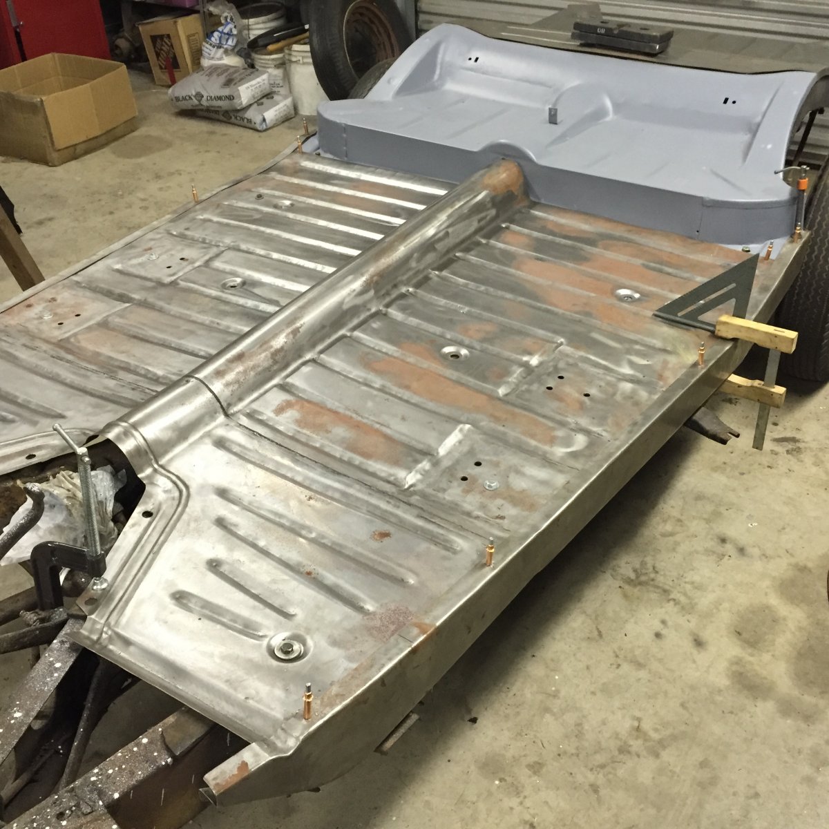

    Took a hiatus but I'm back at it. Rust obviously didn't sleep in the meantime. Anyway I took measurements of the body at both door post to get the du rail position correct in relation to the floor. The square helps me measure over the driveshaft tunnel. Clekos come in handy and will serve as reference when it comes time to weld the floor into the body after welding in the sub rails.

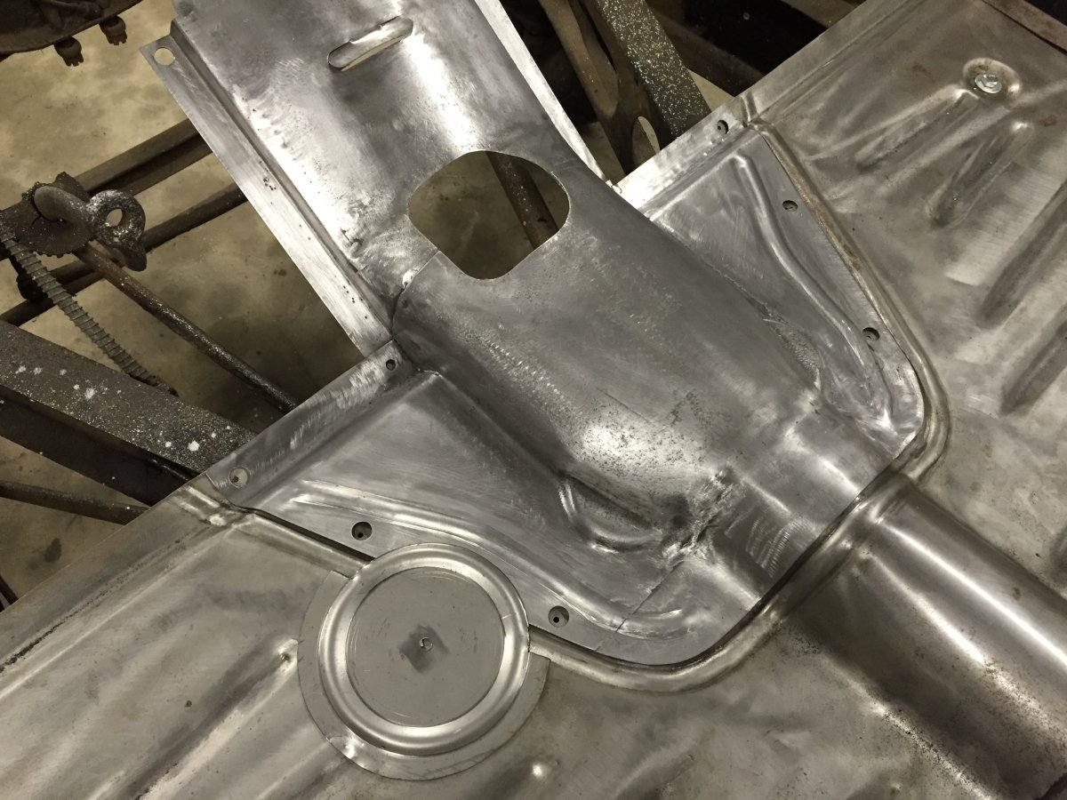

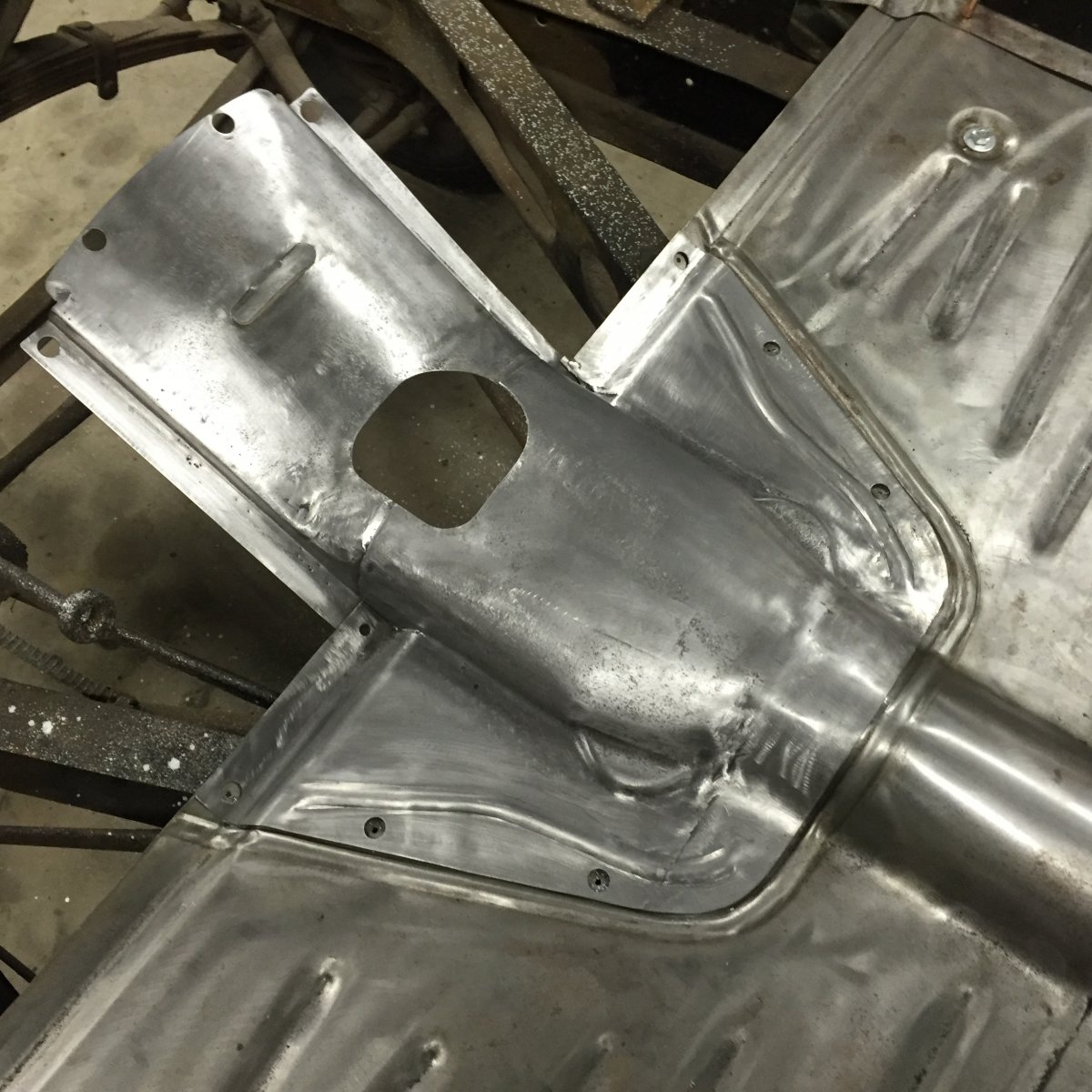

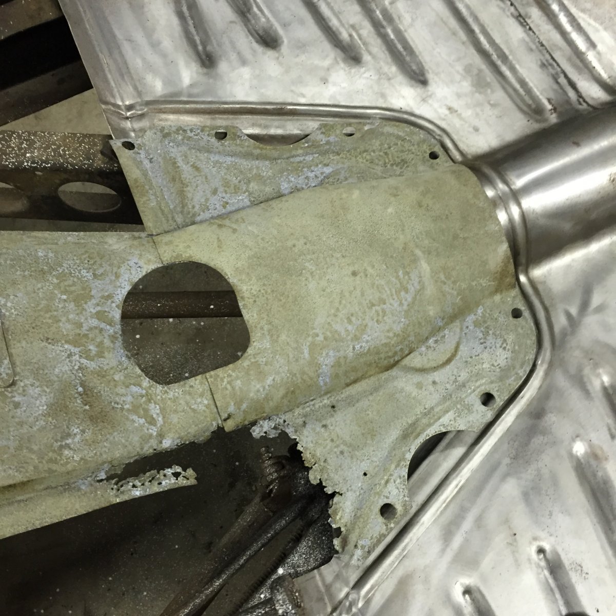

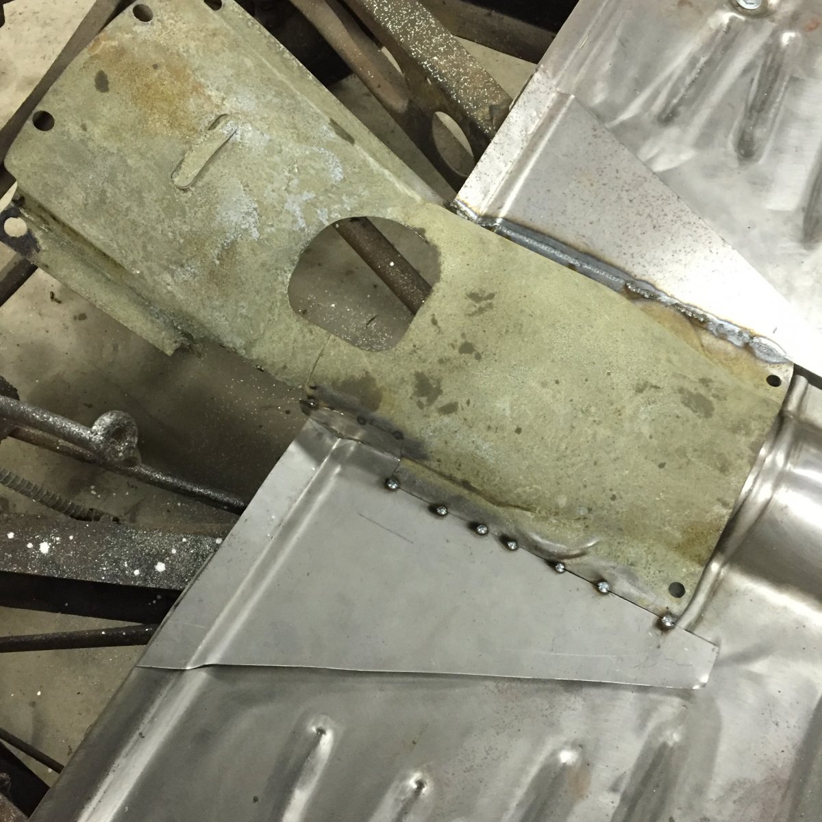

    The trains cover was rather reached out and after all the tweaking of the floor didn't fit anymore. Time to cut and weld some new metal.
    The driveshaft tunnel was a bad fit and needed some help
    Kage, tomkelly88 and jakespeed63 like this.

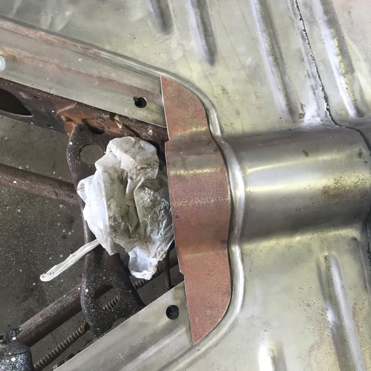

    Getting there...

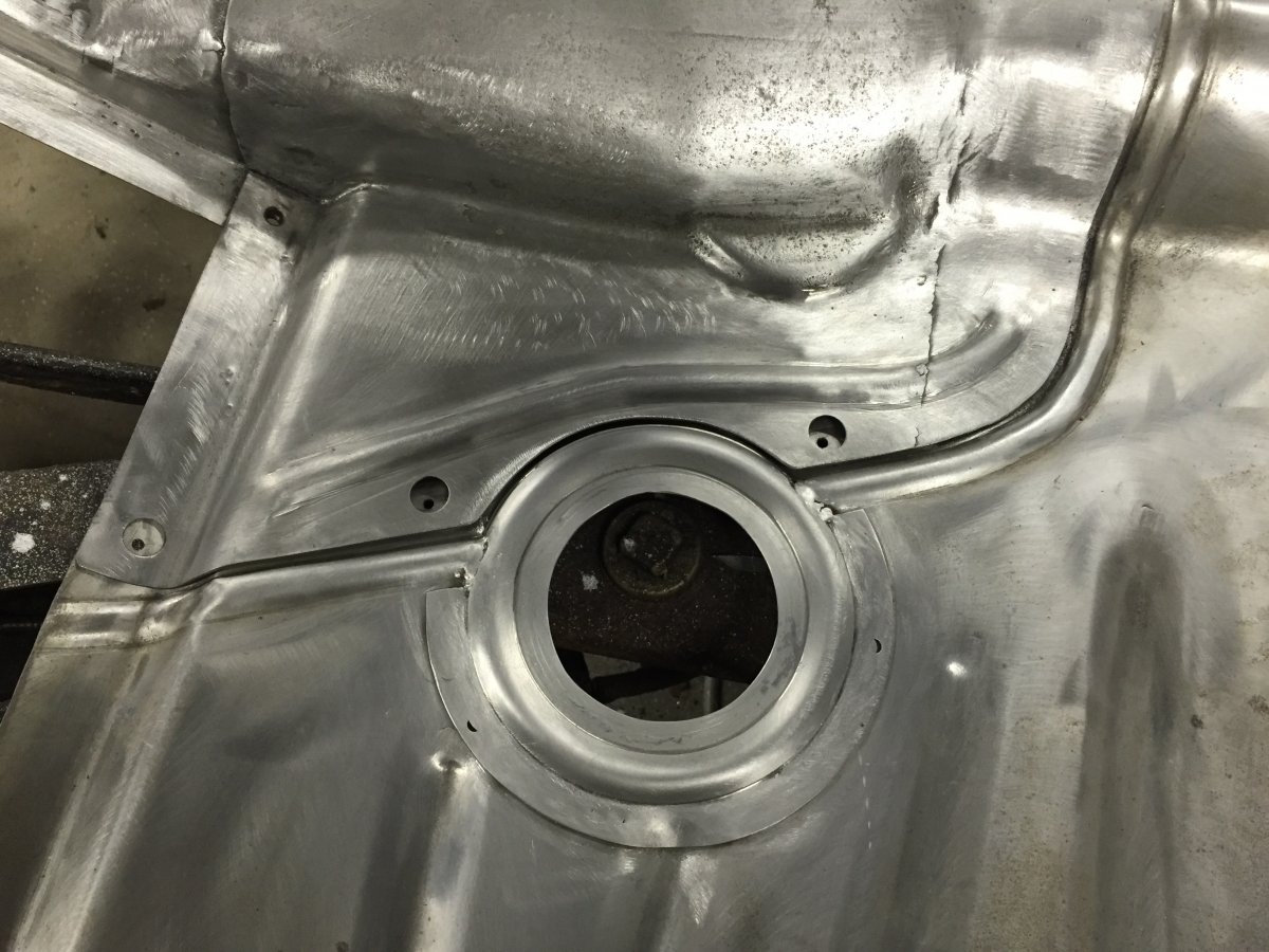

    What is missing is the acces opening for the master cylinder which was hard to roll when I made the floor edge. But sometimes it helps to break down a problem into smaller parts.

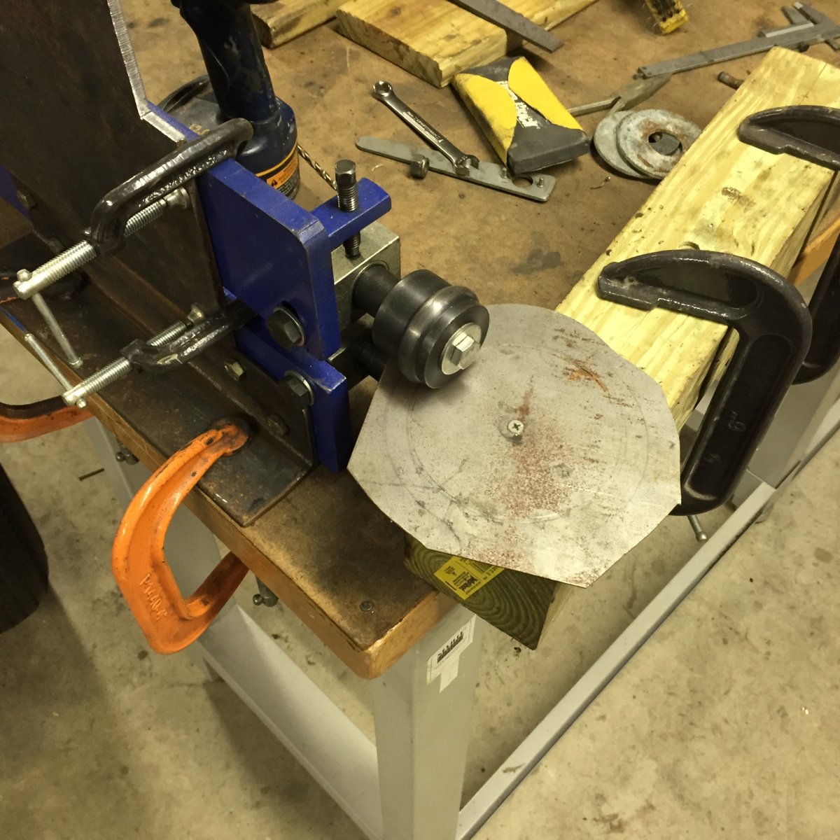

    Using the bead roller to make the round lip of the opening. The piece is screwed down on the 4"x4" and lets the metal rotate freely. Worked like a charm.
    Test fit the new piece. Then cutting the hole and spot welding in place pretty much finished the floor.
    Sprayed some epoxy primer on the bare metal to keep the rust at bay.

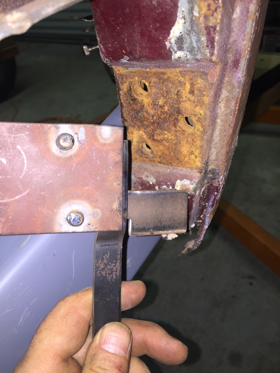

    In the meantime, I made some brackets to help me locate the sub rails in the body, while I cut out the rotted bottoms of the door post. Of course here I am shooting for the width measurements I took when the subrails were test fitted on the frame.
    I leveled the body on the dolly and then used an magnetic angle finder to make sure the subrails were vertical before tacking the brackets.
    This is the bracket in place. There are two dowels which engage two of the bolt holes for the door hinges. I will probably add a third hole so I can use a bolt to hold it in place.

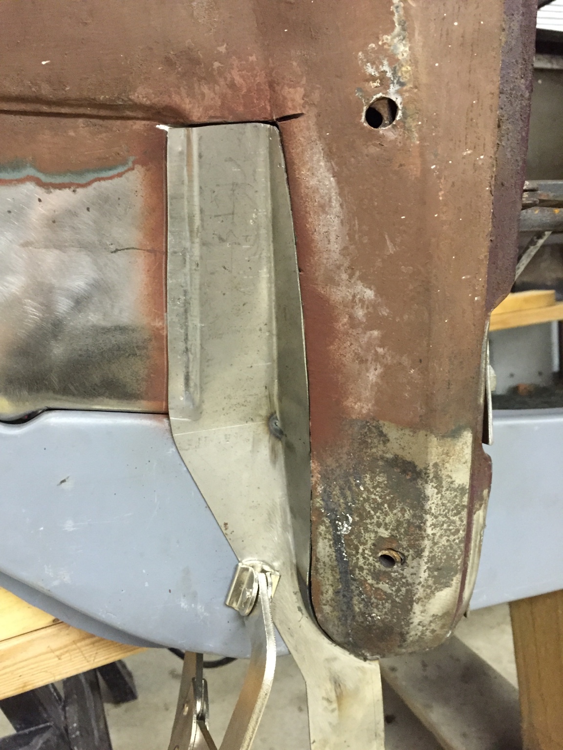

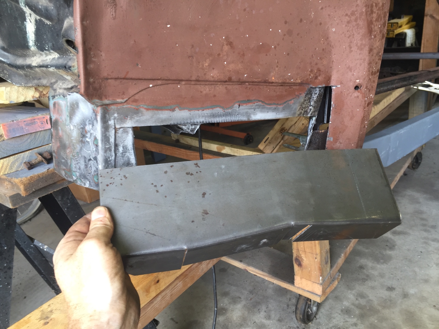

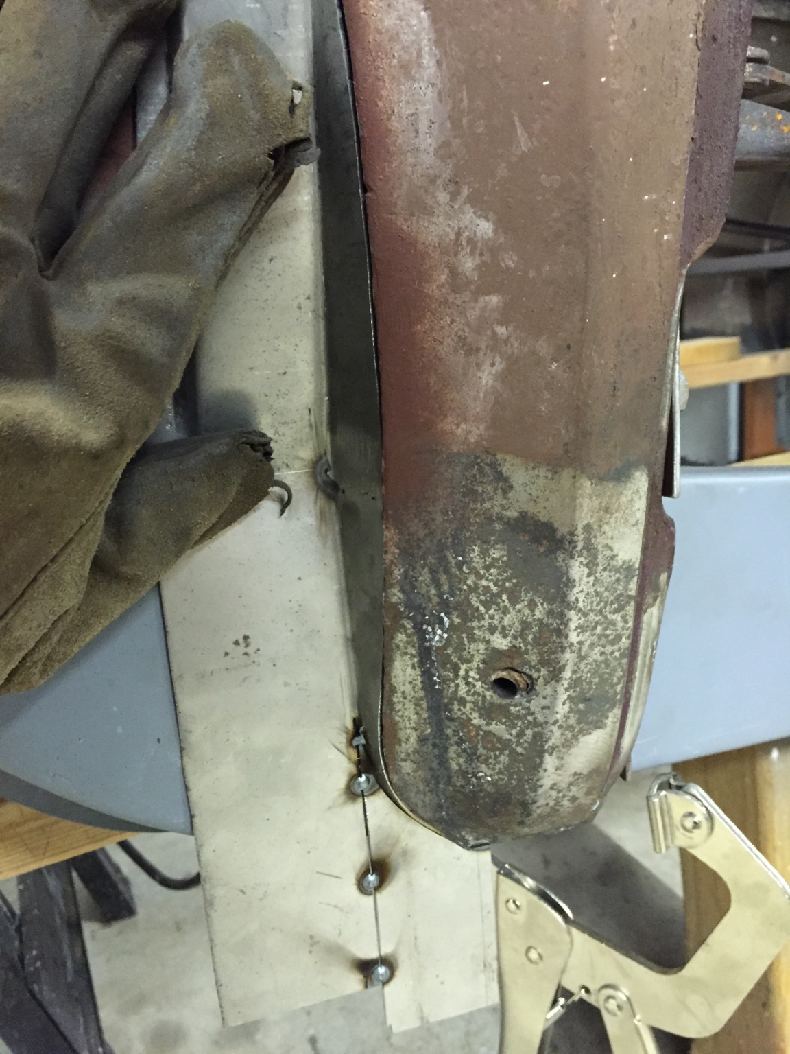

    Starting on replacing the bottom of the door post by first replacing the piece I cut off earlier. I am flying partially blind here as neither side was complete.
    Starting with a simple shape, the gradually adding features and curves...
    Hope to make more progress tomorrow. I will have to form each facet of the post individually and weld them together.

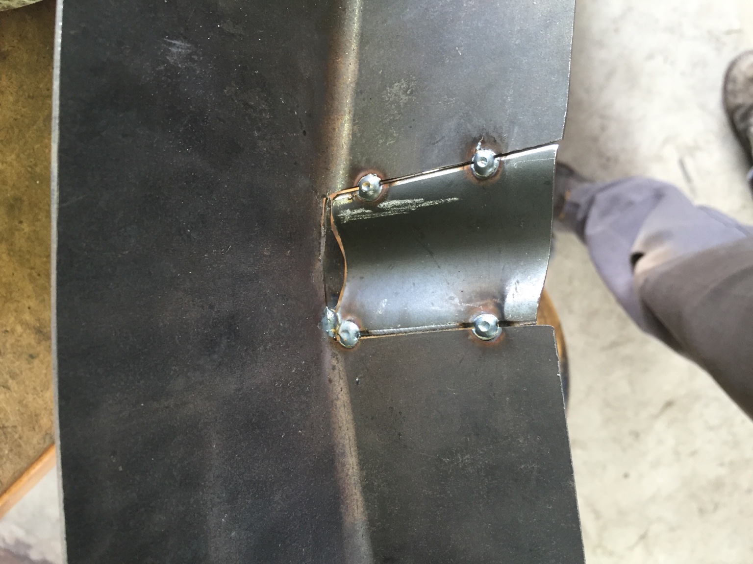

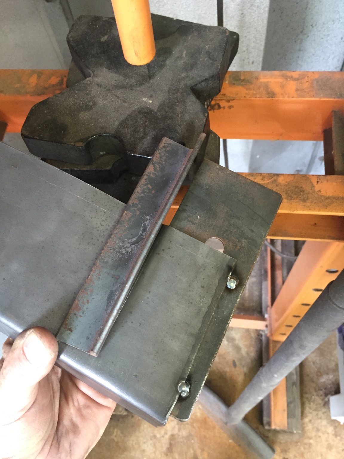

    Tackling the middle piece. Picked up this nifty tracing thing from Eastwood the other day and it came in handy.
    Made male and female bucks for forming the patches.
    Using masking tape to get the shape of the patch transferred onto cardboard.
    Kage and jakespeed63 like this.
