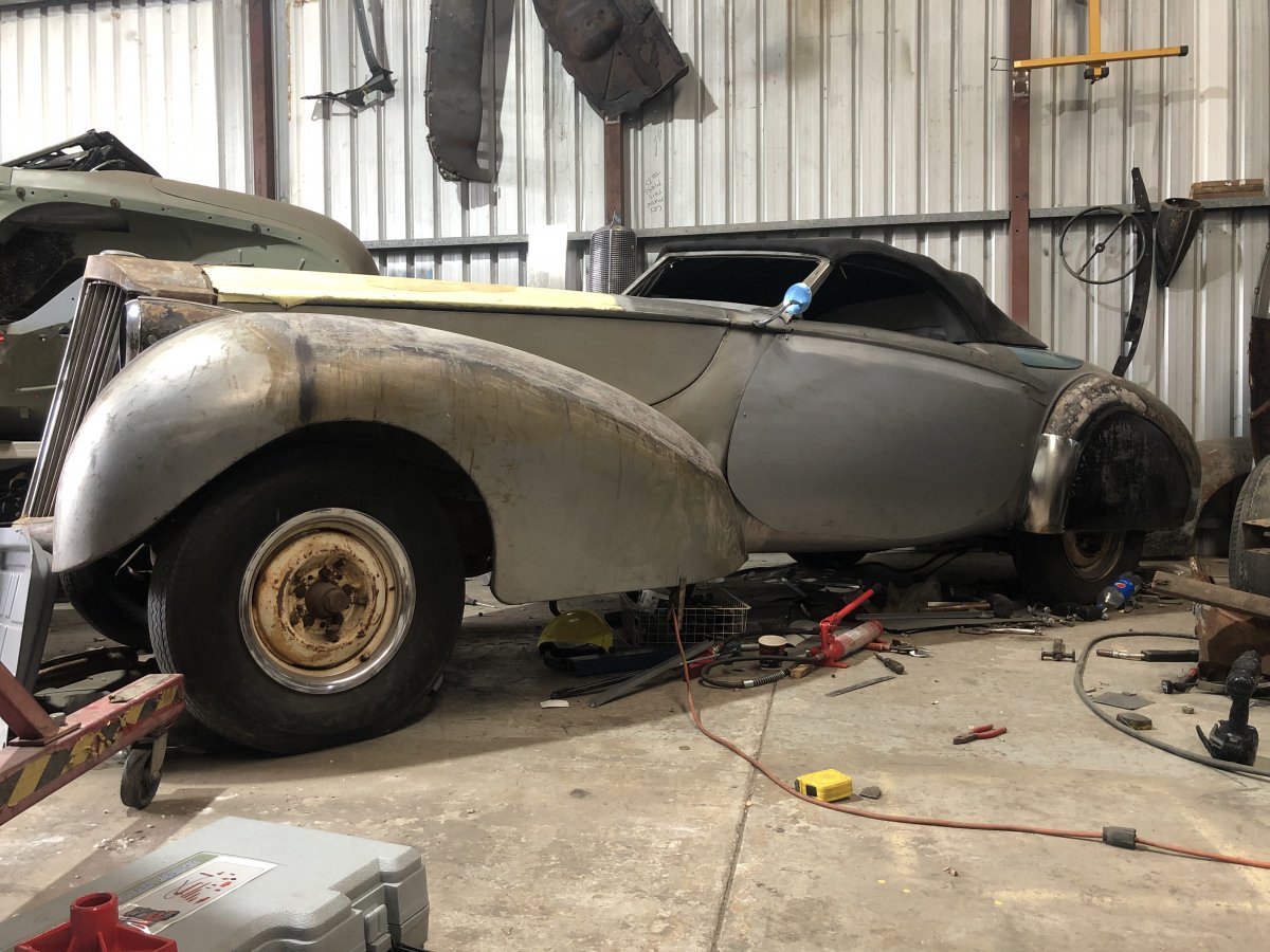

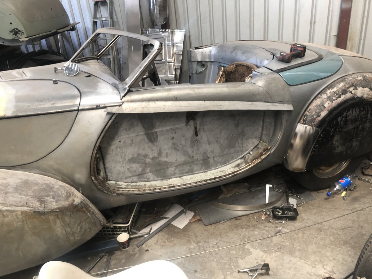

    25086D12-A348-4E3B-8D62-C83A226039CC.jpeg 89321C1F-3B82-476F-BA34-3767F6B242D3.jpeg 8FEE8353-BB59-4105-B275-6502CACB0ACA.jpeg I actually have some one interested in doing a 40s Bentley custom...
    but it will have to wait till I get some of these Cadillacs ( my paying job) undercontrol.
    This arvo I folded a double step and spot welded it to the inner door to accept the door skin.

    Every post brings this closer to a total package. And a stunning one at that.

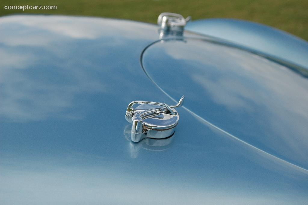

    Interesting seeing the Peugeot Darl Mat pop up in this thread. They have the coolest filler caps, and that crazy disappearing windshield that winds down into the cowl.

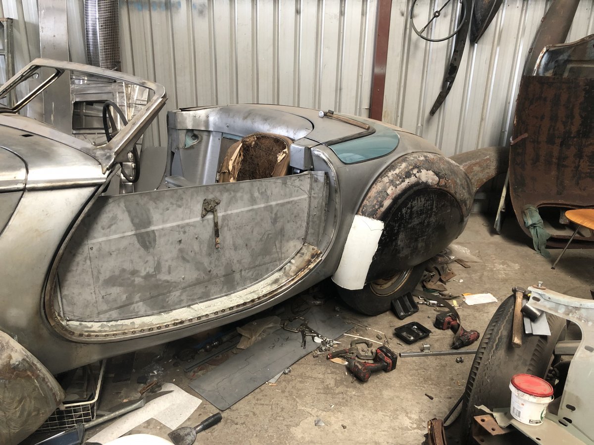

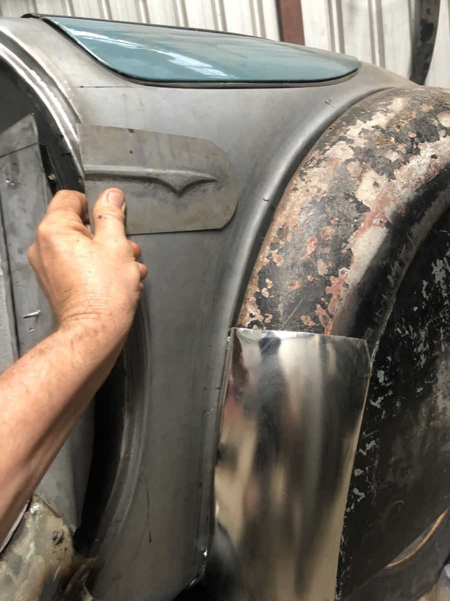

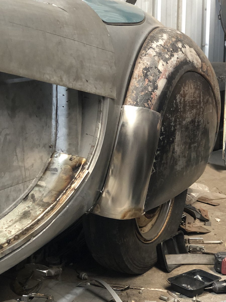

    31F5D2BB-99C5-4346-B40D-C6BB84AFD42F.jpeg BA9308DB-9EA2-487D-B8A6-76603B80C9A4.jpeg 1082286B-20DD-44DA-8BD1-844CB82E99D4.jpeg 8C960594-1E11-4D5B-99B3-76DBFAE86896.jpeg Been wanting to make a stone shield for a long time. Wheeled it up out of mirror ss with the plastic still on and it worked.
    Will leave the top edge long till I get the door swage sorted and then emulate the same flow.

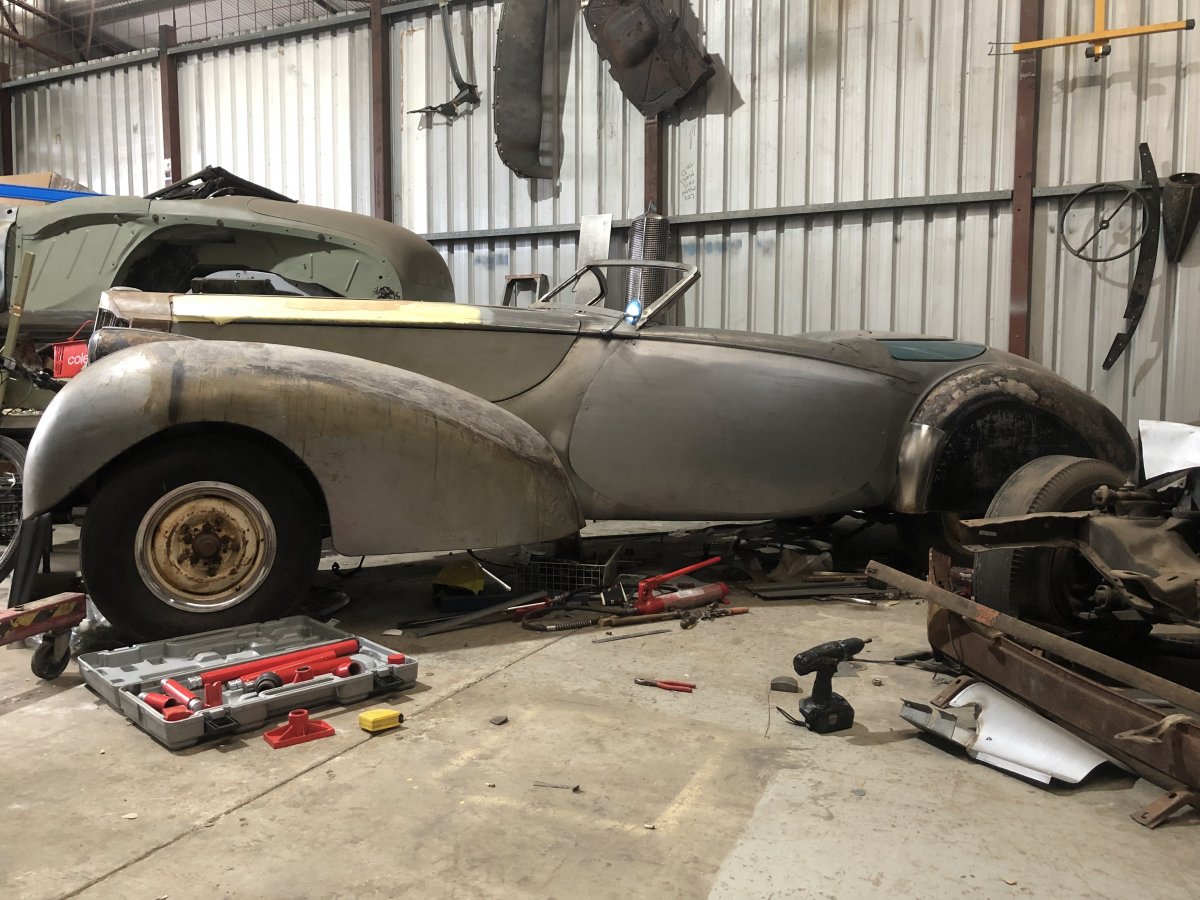

  7. CadMad
    Joined: Oct 20, 2012
    Posts: 886
    CadMad

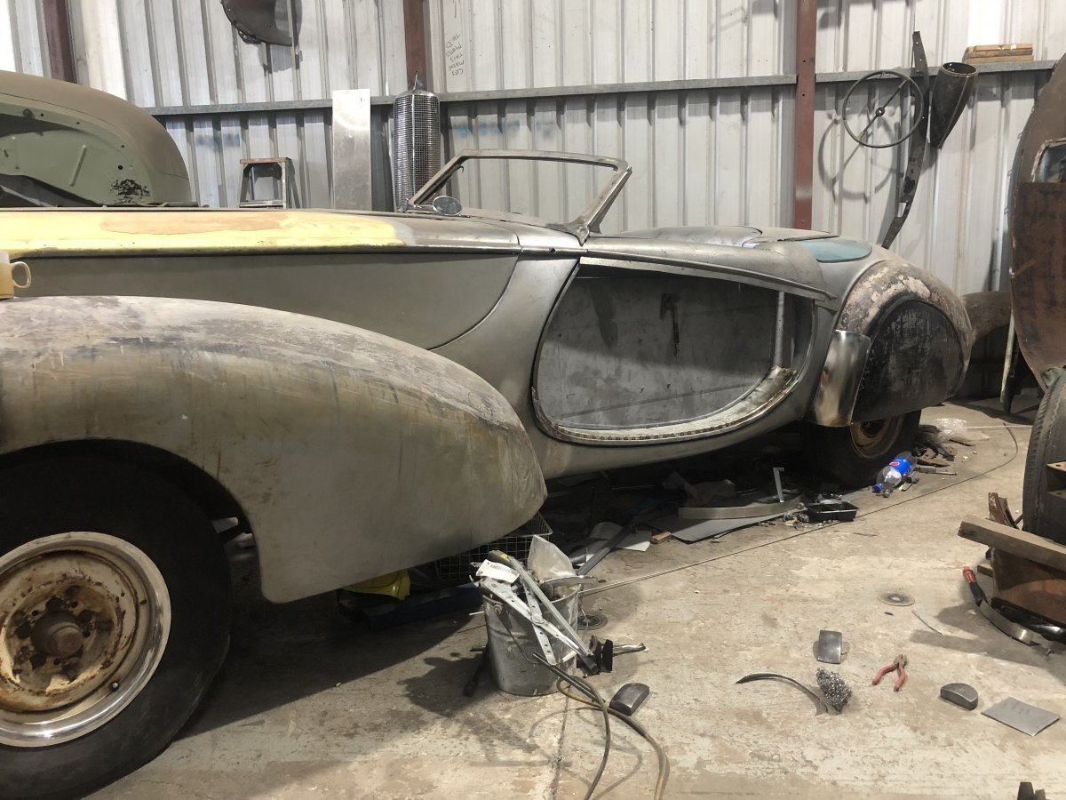

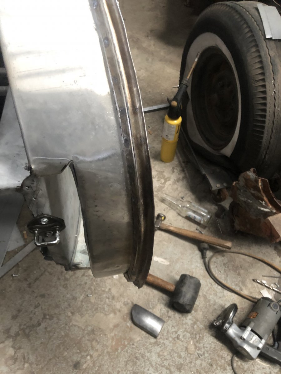

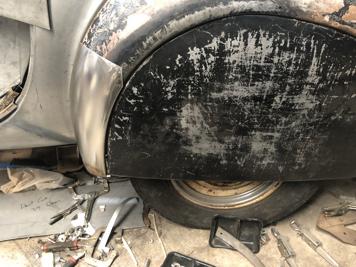

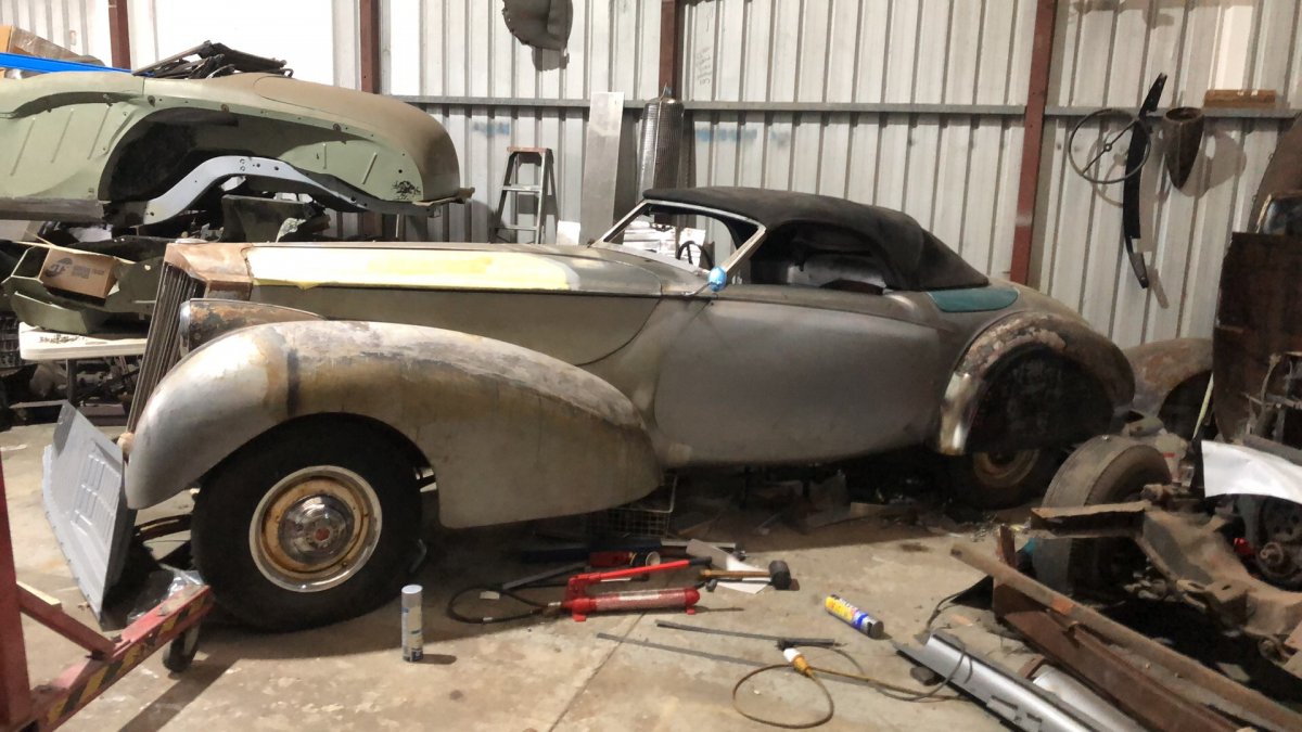

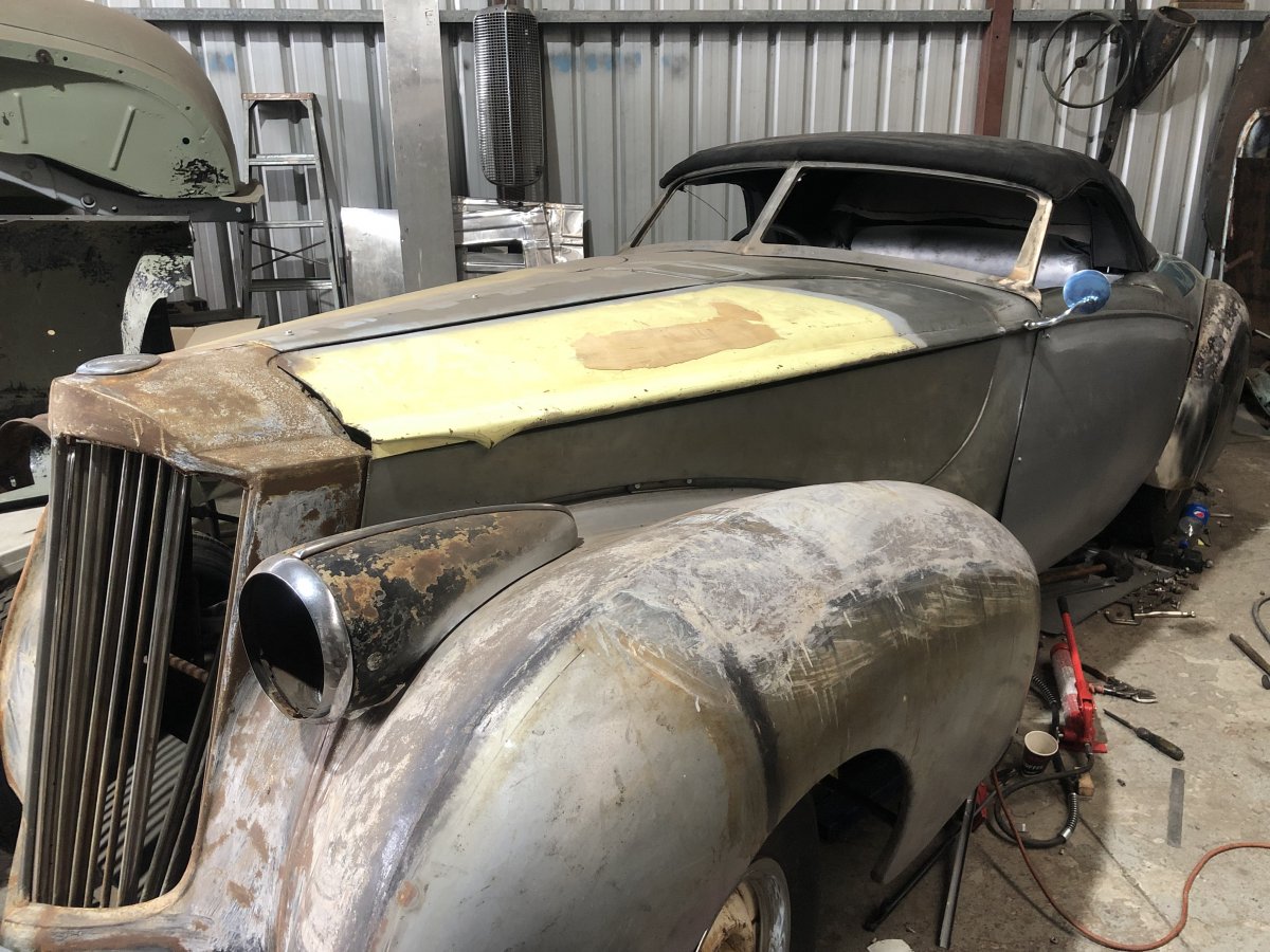

    DD144090-7165-4F8B-91C3-3F6C159EB5E2.jpeg Beltline swage in door.... check. Just a little bit of tweaking to do . 4D7A1F39-91D3-4A2B-9A68-0D2E0F0D1698.jpeg B9EA5D6B-FA86-4279-9E88-A82228DA0162.jpeg F2199D8C-5845-4232-B193-FC65A6E3A12E.jpeg 11D2BD31-9DBF-4334-A1B9-10E0812F9292.jpeg F9AAE4A7-FB43-4234-BEF7-E1E01C7AB07F.jpeg

  11. X38
    Joined: Feb 27, 2005
    Posts: 17,498
    X38
    The second last pic has a sweet line that runs from the top of the rear fender, swooping down and along the bottom of the door and up towards the cowl.:)

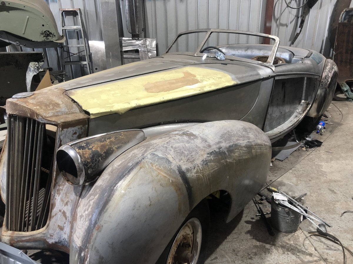

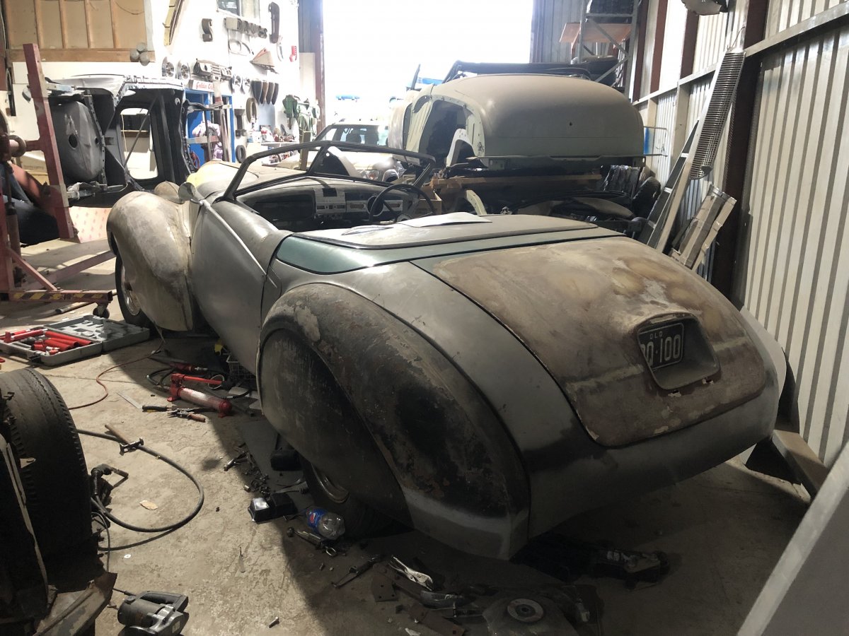

  14. CadMad
    Posts: 886
    CadMad

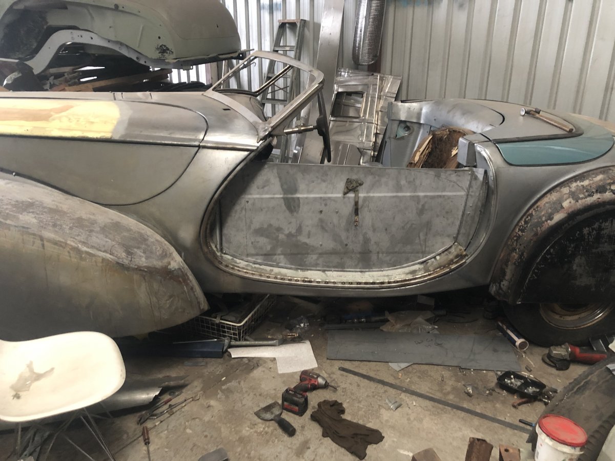

    ABF2C44C-6DEC-47B2-820A-A78C96089A4F.jpeg 7B5881A9-DCC3-43AA-8C79-4AC0DA25D225.jpeg 67900C43-A3D2-424B-B47F-1981F47E03D3.jpeg Door skin wheeled up . It’s oversize presently and will shrink down once the edges are rolled. Great to finally see it as a full form and seeing all the separate forms reside harmoniously together.
  15. kidcampbell71
    Joined: Sep 17, 2012
    Posts: 4,756
    kidcampbell71
    Friggin' beautiful, it shall be.

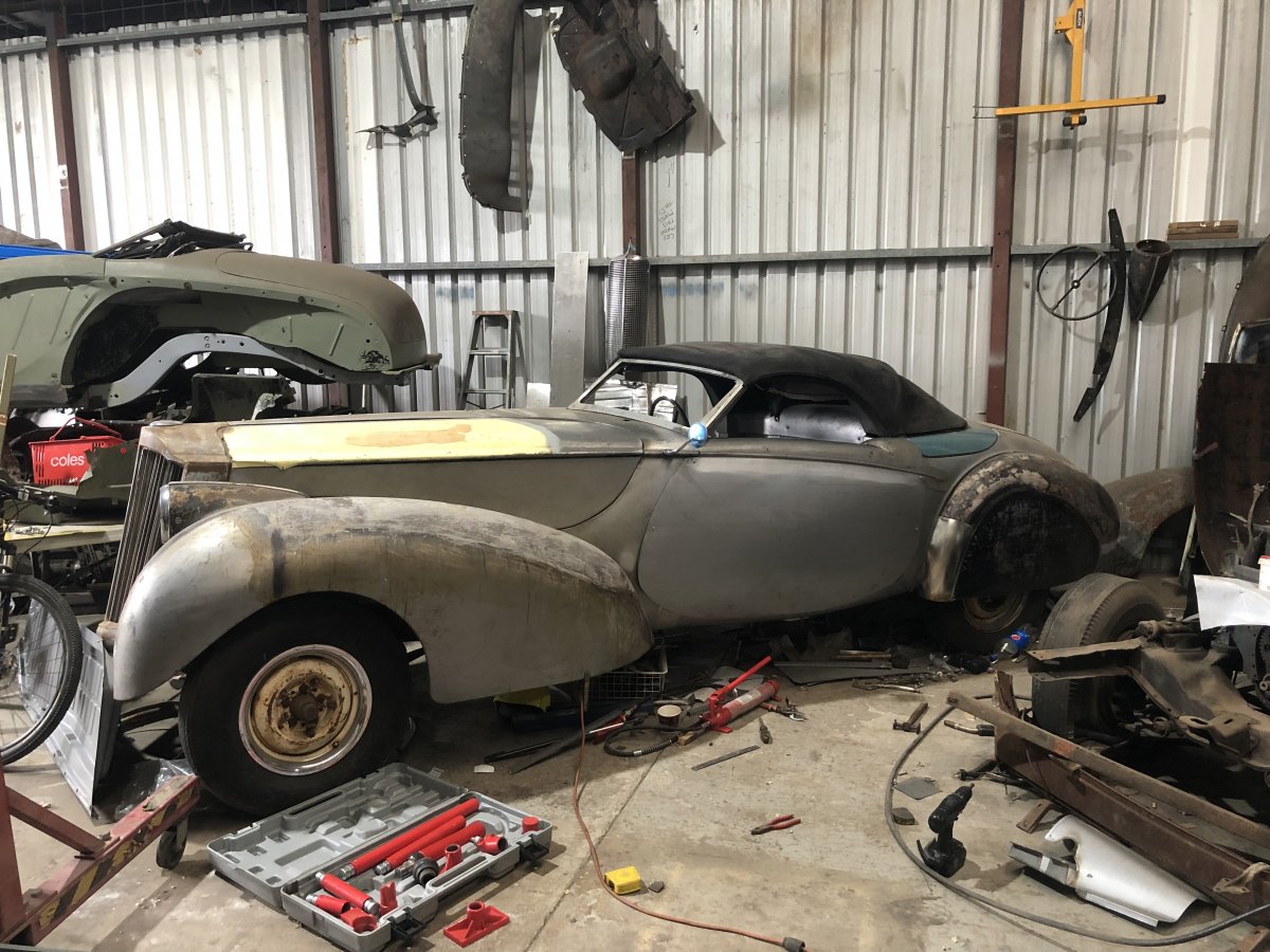

    CadMad

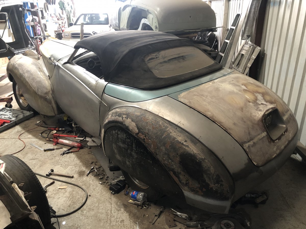

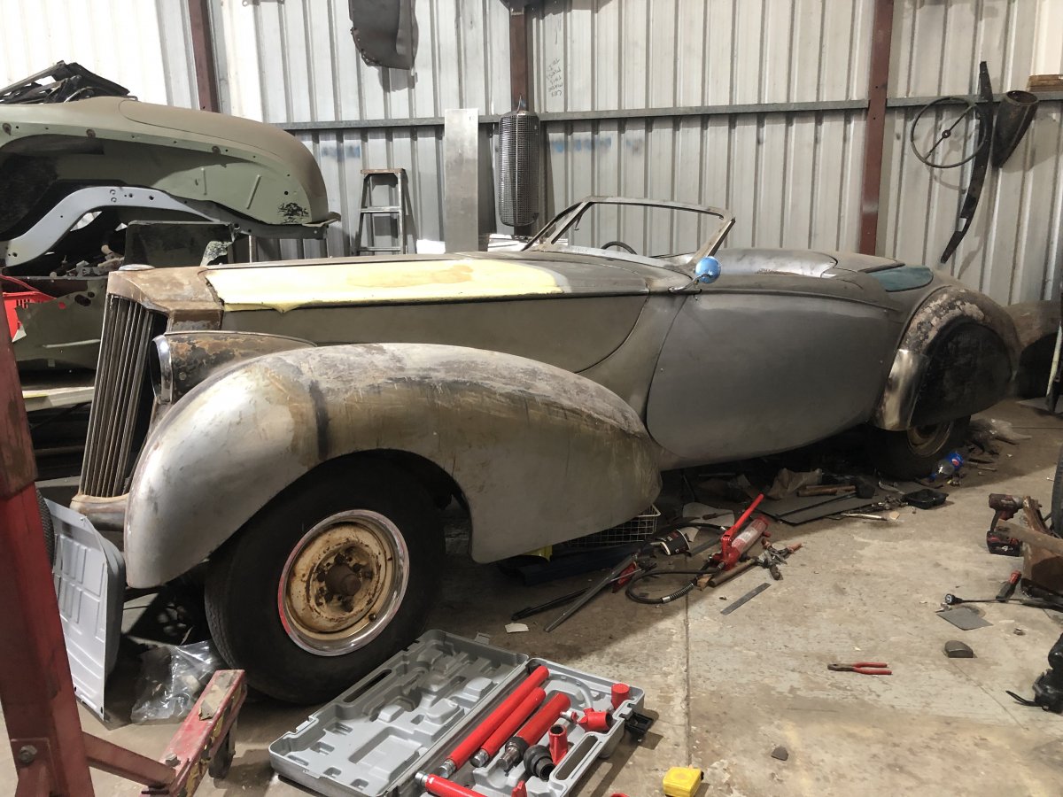

    5C024E49-7BFD-4B58-AB74-567985AD3AD3.jpeg A7D8DD59-3704-4A7D-845E-F78DCDFC192F.jpeg FDA4FD79-4F9C-452F-97FD-5FCDF536B1D5.jpeg A3603B37-34FD-4186-A60F-06A9B1D0963A.jpeg Can’t decide if I like top down or top up better?
    gsnort, VANDENPLAS, 40two and 17 others like this.
  17. James D
    Joined: Feb 8, 2007
    Posts: 5,132
    James D
    Top up looks super sinister.
    VANDENPLAS, stanlow69, CadMad and 3 others like this.
  18. GordonC
    Joined: Mar 6, 2006
    Posts: 3,504
    GordonC
    You know you did it right when the car looks as good with top up as it does with it down! Just curious is it the angle of the pics or is the front end going to come down a bit?
    VANDENPLAS and CadMad like this.
  19. CadMad
    Posts: 886
    CadMad
    Yeah the engine and box are out so it’s at the top of its travel. It will come down 3 or 4 inches. Then it will need a full tank of gas in the back as well to level it out.
  20. Squablow
    Joined: Apr 26, 2005
    Posts: 19,043
    Squablow
    I know I've mentioned it like 10 times but that roof is just so right, even though really it should be so wrong. I never would have believed that would work, but it does, and it's just right. Looks great with the top up.

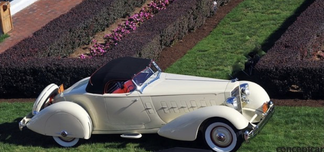

  22. GirchyGirchy
    Joined: Mar 17, 2011
    Posts: 283
    GirchyGirchy
    from Central IN
    I like these door handles...on a 1939 Bentley:
    VANDENPLAS, chrisp, CadMad and 3 others like this.

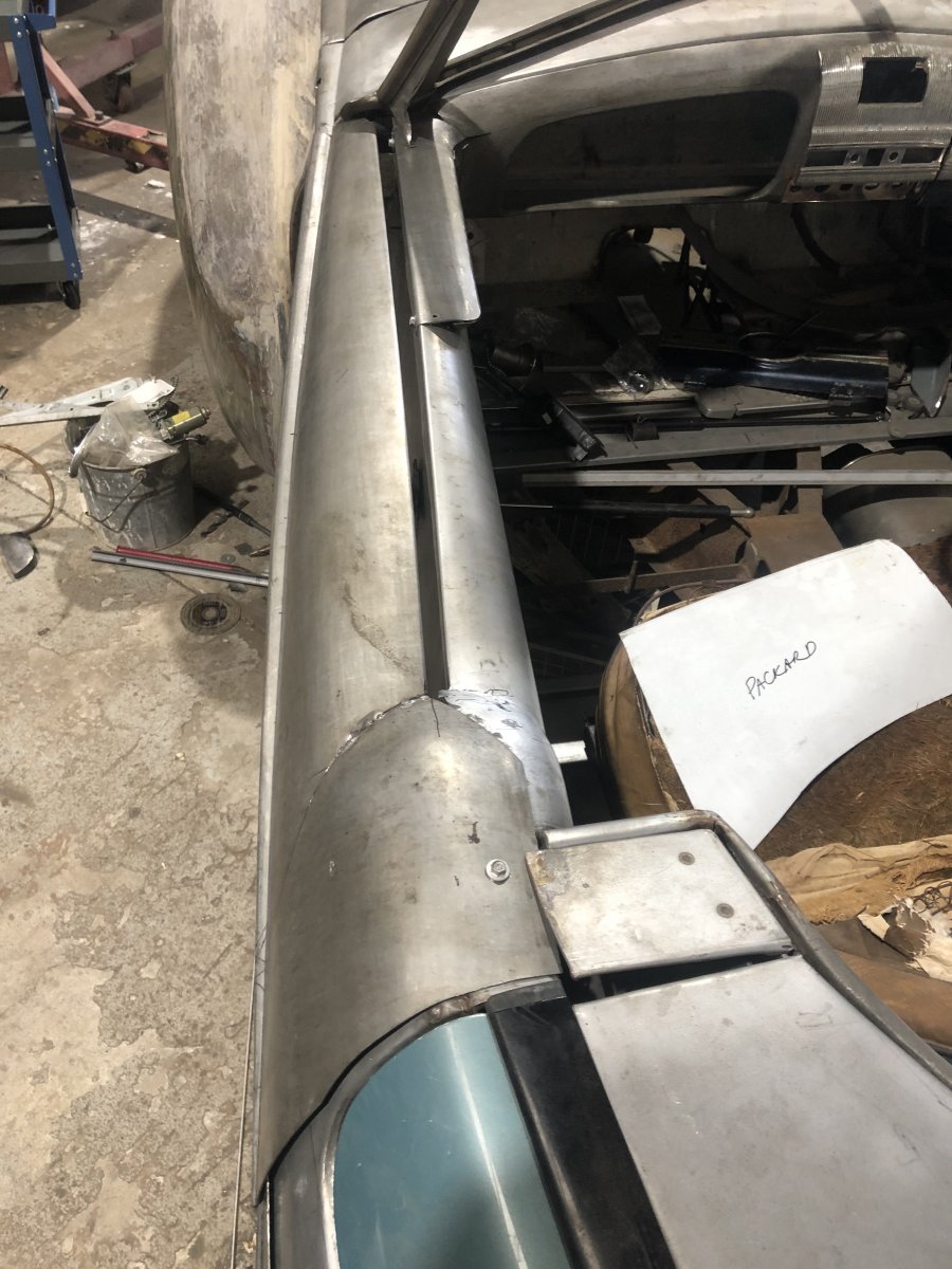

  29. CadMad
    Posts: 886
    CadMad

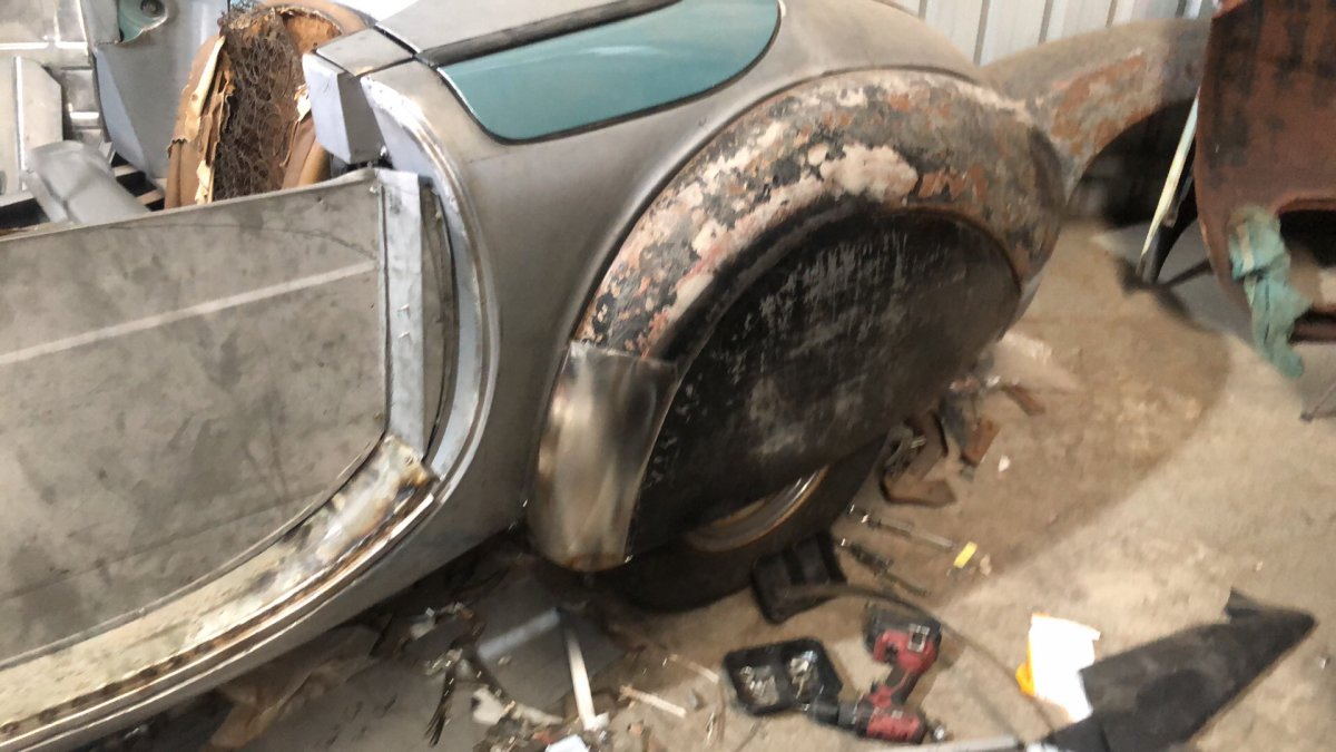

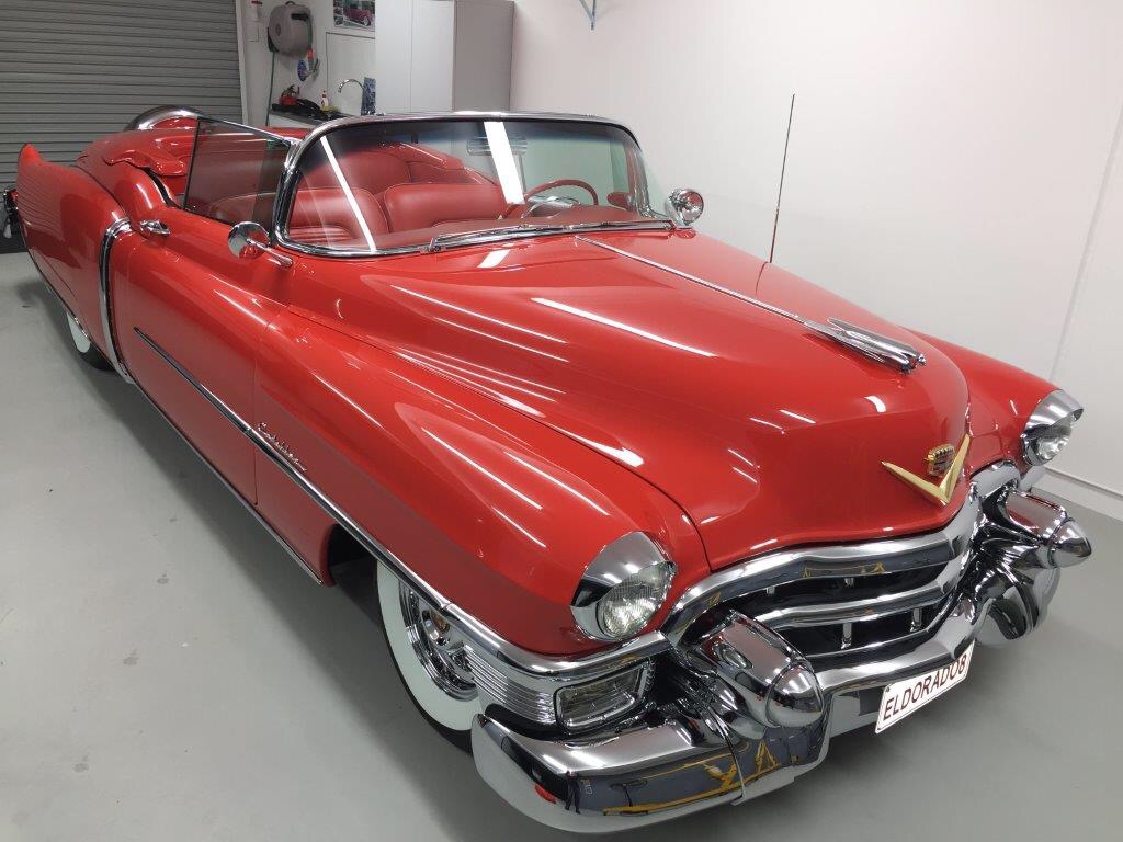

    F8040E9B-571B-4814-BDC1-7B909AA382F0.jpeg 5CFF2D58-44DA-4554-A0B8-8744F115EF4C.jpeg 7754B9EB-E04C-40B7-BD48-6AA0853DFE37.jpeg ABCE72FE-9C44-47F3-A196-BEF6533A9ED8.jpeg Thanks GirchyGirchy , just about all of those were studied very carefully . The Bentley Embiricos designed by Georges Paulin and the time frame of it’s build , and Paulin’s death at the hands of the Nazis in 1942, played a significant roll in the streamlined design I wanted. Look at my rolled sills.
    Good timing as well cos yesterday I pulled my bumper collection out and had a look and I’m tossing and turning on the direction.
    My mate in Perth has a 1934 Cadillac Aerodynamic coupe with Biplane bumpers. Which I love.
    He also has a Horch roadster similar to the one pictured and both share the telescopic bumpers. As does that Lancia Astura.
    I’ve been thinking of using a Macpherson struts or heavy duty shock absorbers.
    I found some oval SS handrail tube at the s**** yard. I need to get the car a bit further along and then play with those. I have some nice Packard overriders which need some aerodynamic reshaping.
    As far as stance. I am governed by the 4 inches of suspension travel I currently have in the rear due to the convertible top well above the rear tire. So I think stance will be close to factory ride height. That also avoids registration dramas keeping the ch***is basically stock. That way it’s a Custom bodied Packard on a stock factory ch***is.
    It’s already a sleek low height. I have a 53 Eldo beside it which was a very low big car and the Packard roof line is lower. I abhor the sill s****ing Zephyrs and Cadillacs which just lose the essence of driving these cars, not parking them for show.
    Last thing I did yesterday was trim the door panel to 12 mm larger than the opening leaving enough meat to swage the lip. But it already harmonises the shape of the body a lot more.
