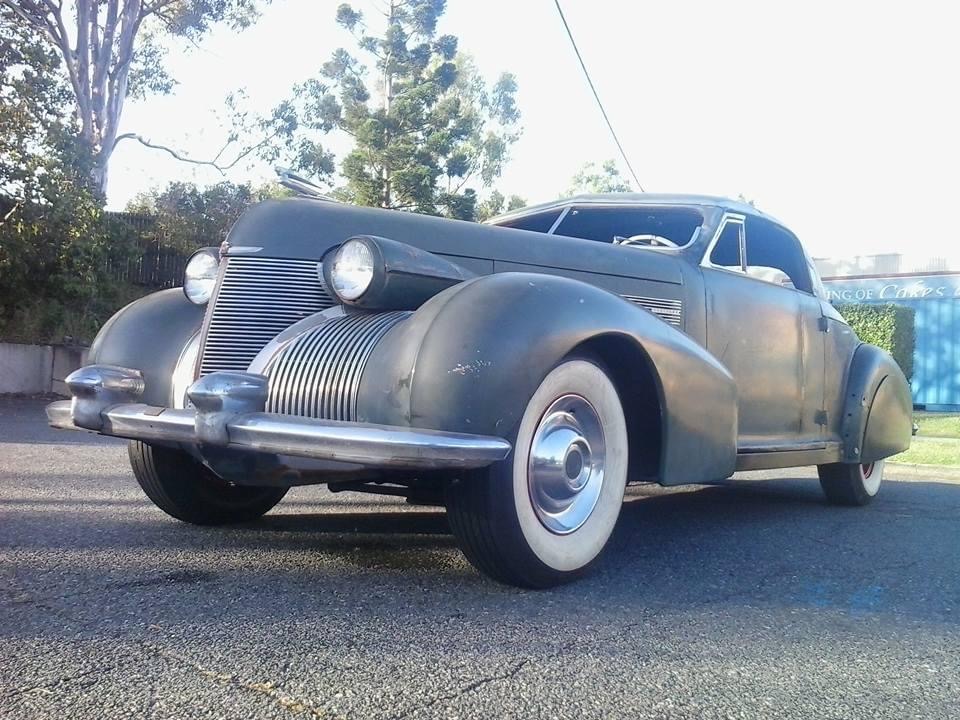

    5C444CC5-8FDB-45DA-ADA4-D5FF7B1C5BAC.jpeg Here is Rik’s photoshop again, for comparison, that was my guide. The sills changed, as did top of doors. But this is the colour it will be. Havana Beige... the original colour of the car.

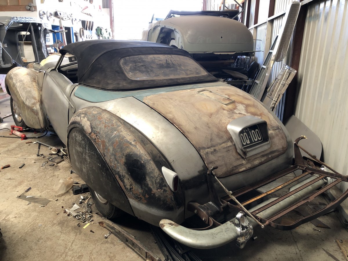

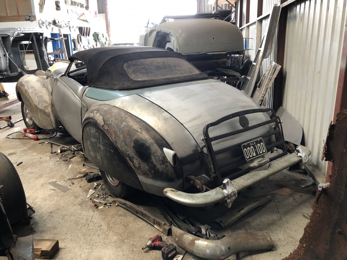

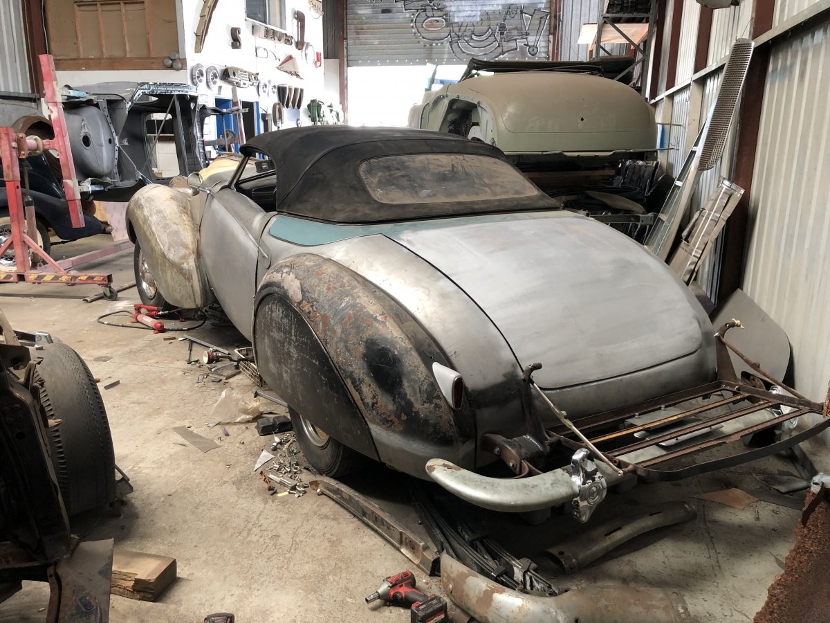

    DCB9E5F2-39D8-418C-B536-34E313C9058C.jpeg 8361AD02-610E-4E25-A619-CEA74C824198.jpeg A3446250-D559-4ABC-929D-741A87D42234.jpeg E5A6FFAD-98B6-4A3B-AFA4-6A5205E0B20B.jpeg I have bits lying everywhere so just for my sanity I am putting bits on to get a feel. Now it’s not to the traditional custom look, more a Coachbuilt custom look, but I scored a Super 8 trunkrack locally for $200. Rare as hen’s teeth especially locally.
    The Jag bumper doesn’t work without the rack cos it’s too straight in the middle. But with the rack installed it fits perfectly. Holes in bumper nearly lined up with Packard irons.
    Anyhow they are both off the floor and gives me an opportunity to decide if I like it or loathe it. To reshape the rear bumper will require a 300 tonne press ( which my mate has... but that can wait for now.)

    I like the rack, it's cl***y, but does it interfere with the license plate? Because the recessed plate in the trunk is another feature I really like. Would the rack get modified to keep the plate visible, or how would that work?
    Sandgroper and kidcampbell71 like this.

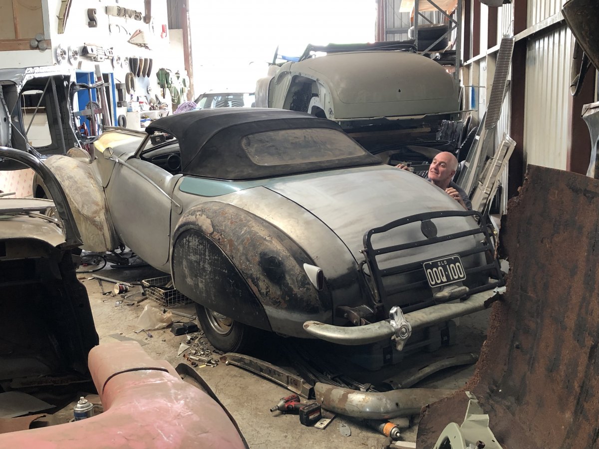

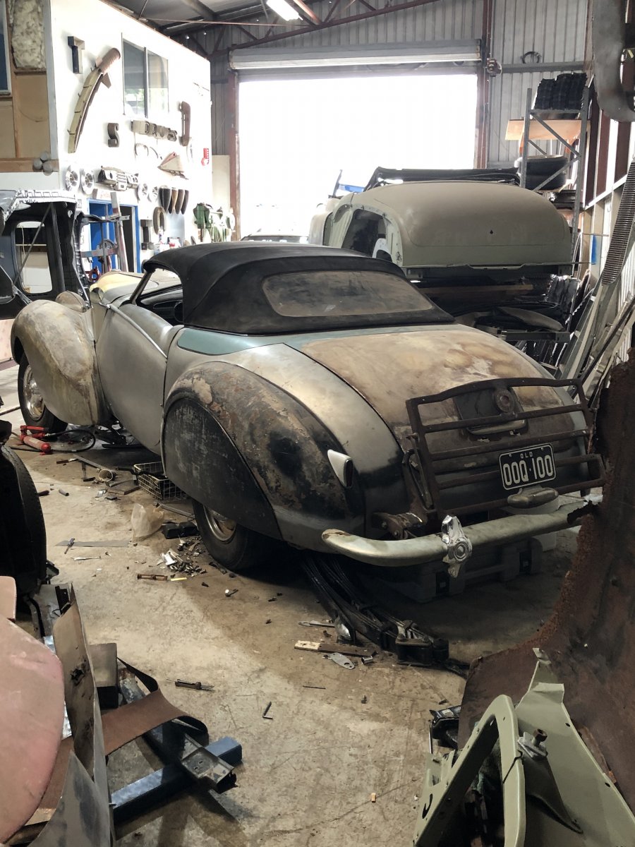

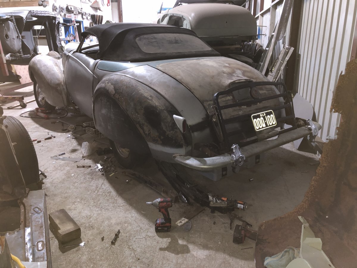

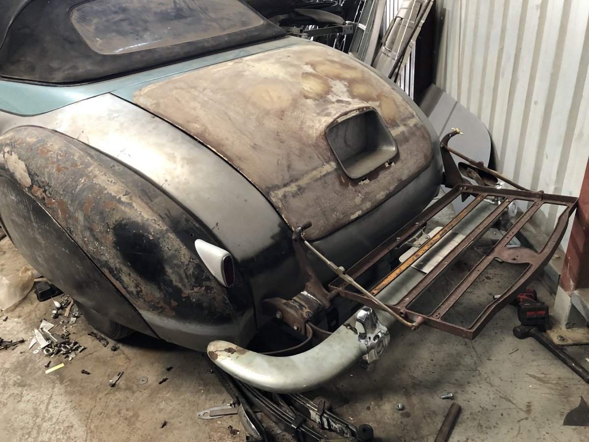

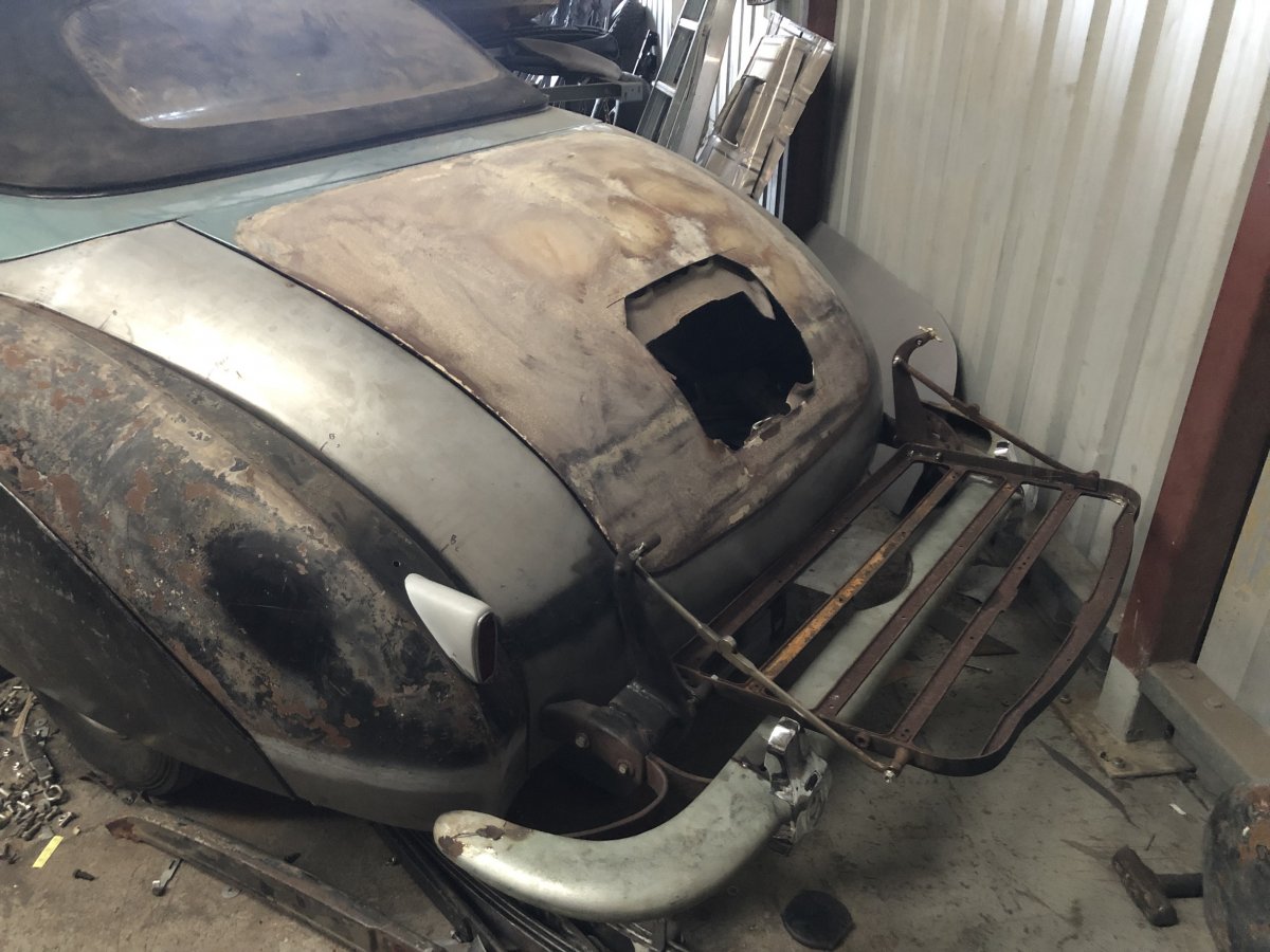

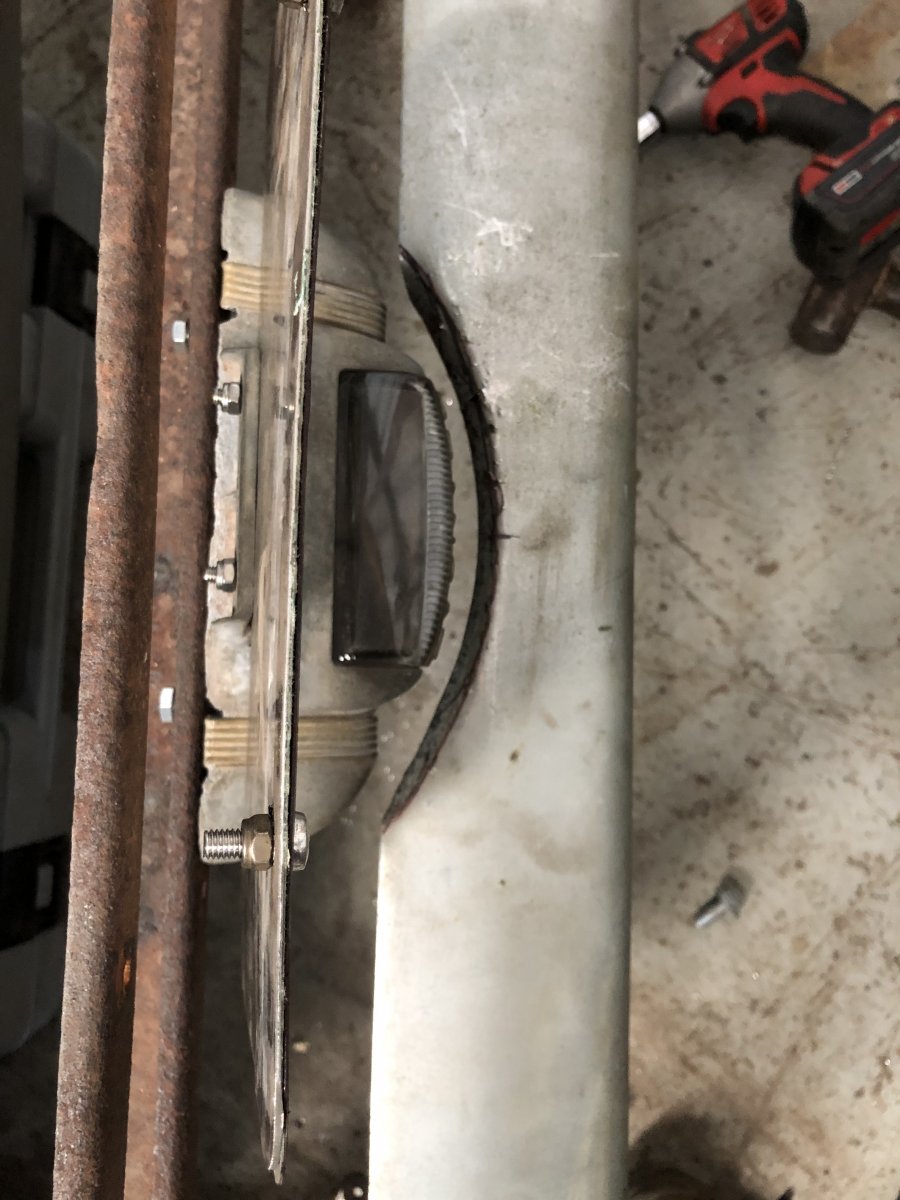

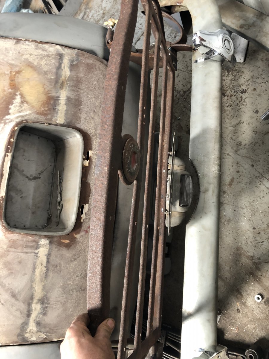

    2E3C5AD4-B986-4CC1-9E73-9B15B0EB4BE0.jpeg 96E38493-A014-40E3-82A4-D8FC0877ABA5.jpeg D02EC514-399C-4E6E-9D89-AD9CD3EBDDD1.jpeg That’s my next challenge. I found the original number plate light in the dirt in the shed where I originally found the car.
    Placed on the rack it also corresponded with a crescent shape already cut out in the Jag bumper. So I just enlarged it a bit with a nice seamed edge and when the rack folds it clears the bumper. I think I will round the square corners on the rack and make a nice low streamlined rounded corner trunk. ( just cos I can ) .... trunk installed, the original recessed plate can be used . It’s early days ... I’m still inventing.

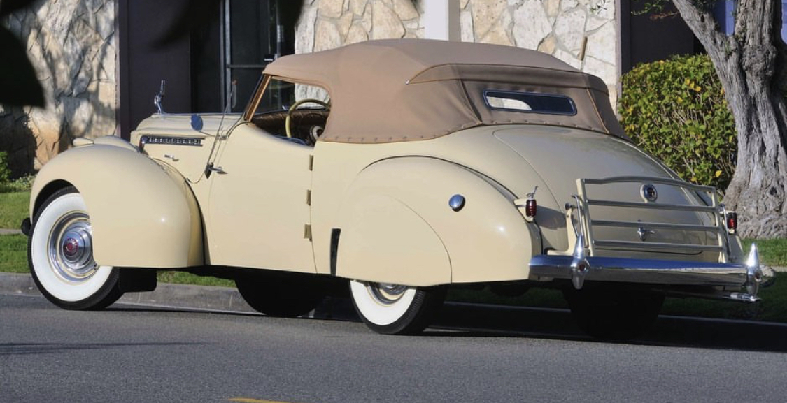

    5D6B674F-B0BA-4F57-A0AF-A5A5D1154C4B.jpeg Some inspiration. See how the trunk is a beautiful form and not just a box.

    587C032F-0BC9-4113-AAA5-B0CA7EA03294.jpeg 03FF6EF1-BC89-4871-BDF5-5B936B9AE015.jpeg 078A52F0-05C8-4DD0-ACF4-36B7C6B2DB86.jpeg 26B7F169-369C-4E68-9150-0F309B041AC5.jpeg Thanks Brian. Yes I do tend to get in a bit of a creative zone and don’t see the mess around me.
    Think of me as the “Alexander Calder of customisation.”
    I tried urgently to converse with Rik yesterday arvo to get some creative input on the number plate frame which I tried to morph into a more sculpted shape ... but it soon became obvious that it was looking more and more like a Jag trunklid again.... alas ....Netherland’s time was bed o’clock.... so I texted back and forth with Tony (X38) and then called him and he (in his very blunt and forthright manner.... ie “ it looks like a B/W TV on the back of your trunk!”), finally made me realise that the sunk plate and rack ( if I indeed end up using it were fighting each other).
    So at the end of the day I bit the bullet and cut the sunk plate out and rolled up a smooth trunk piece. Which I will weld in this morning.
