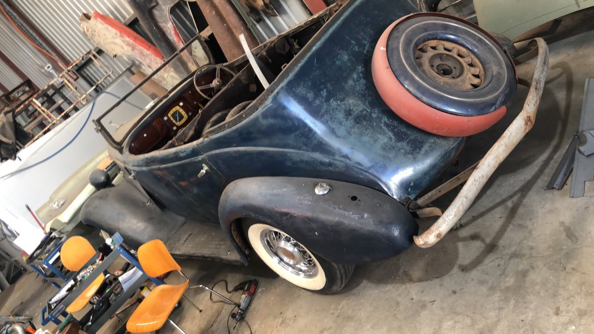

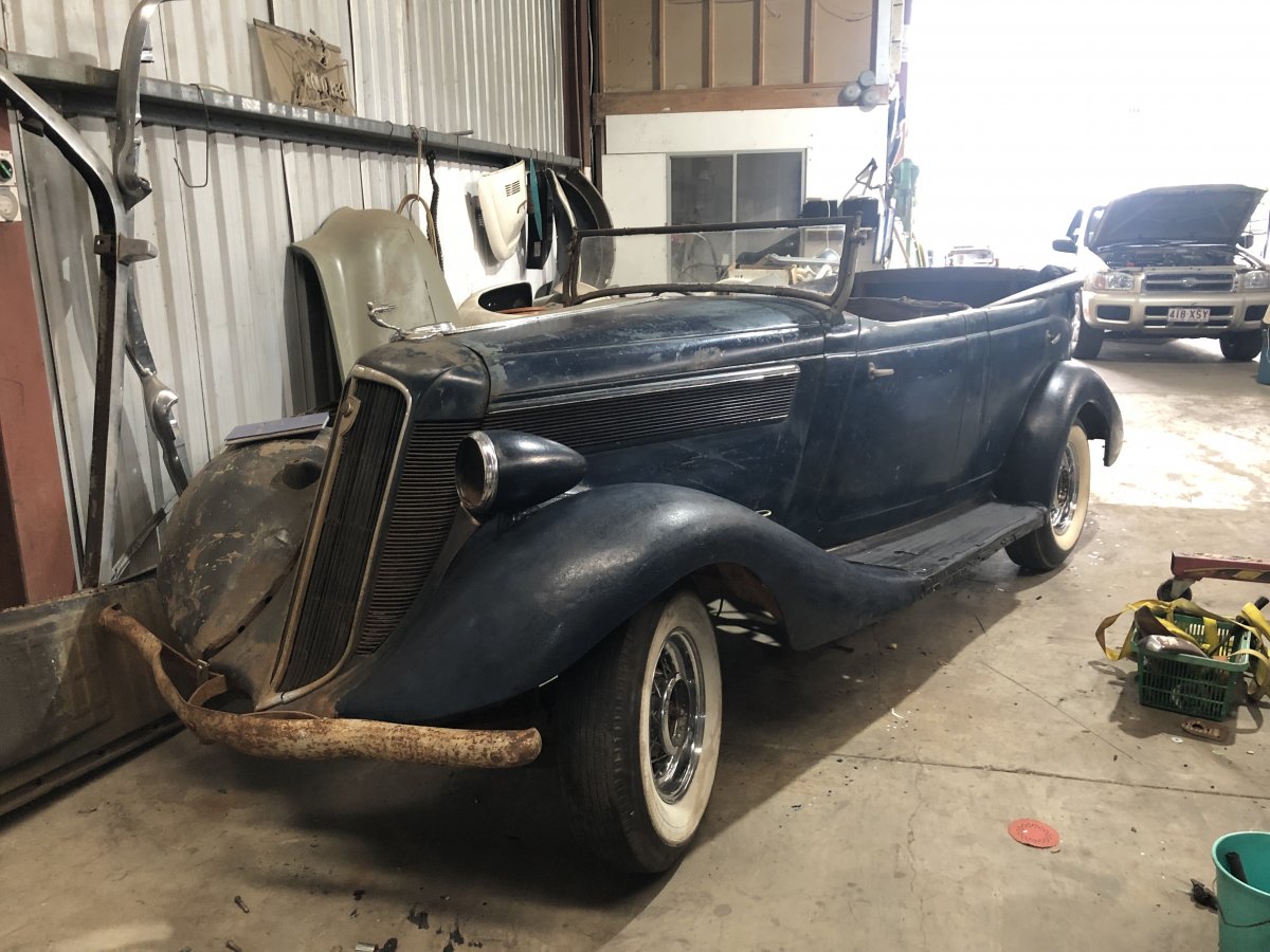

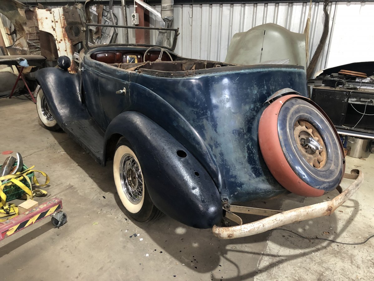

    E4366B66-4CA7-43D4-AEA6-0387DD751867.jpeg 83FB90CA-E8D8-4464-9825-0A64CA87E019.jpeg 6E22C37D-2F54-46AD-BF68-062FA37AF0CC.jpeg Good spotting on the Stude. It’s a 35 Dictator. Tourer. One of six built by TJRichards Adelaide. Only one other survivor known that was sent back to Studebaker in the US and is restored. It’s my brothers and he’s the 4th owner.

    TJRichards also built Packard looking Studebaker using the Packard front end styling. They were attractive cars.
    Stogy and chryslerfan55 like this.
