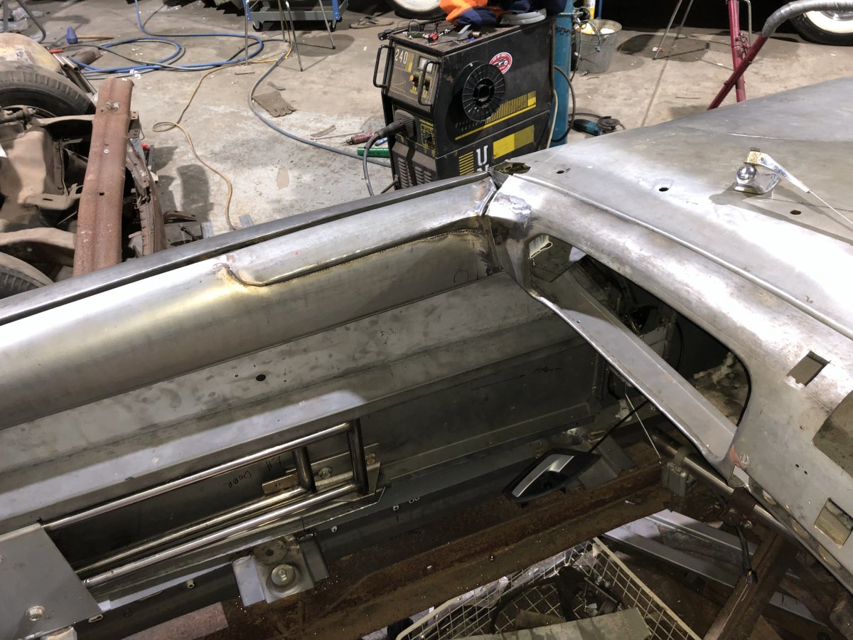

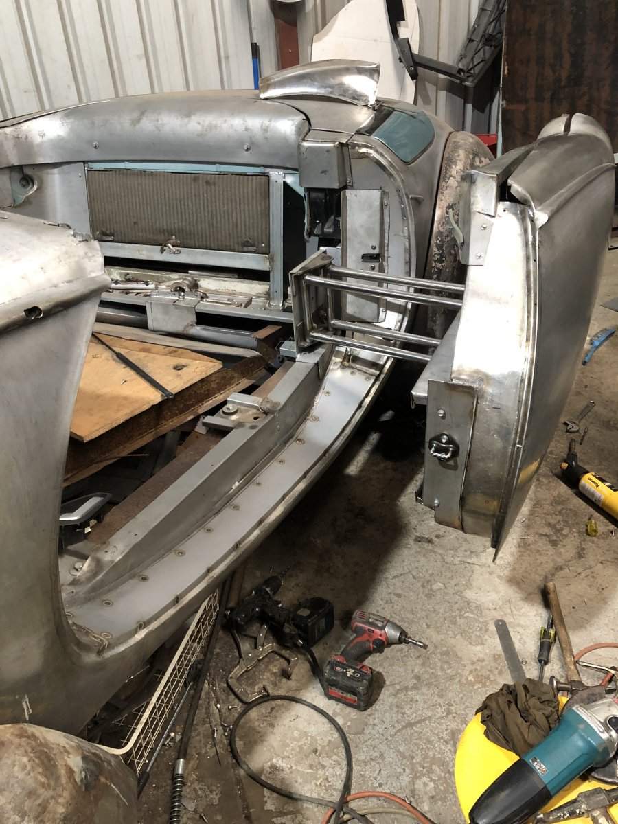

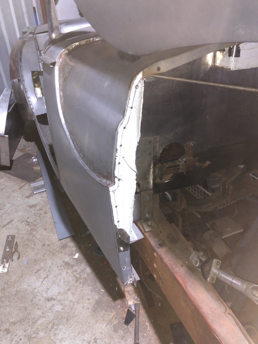

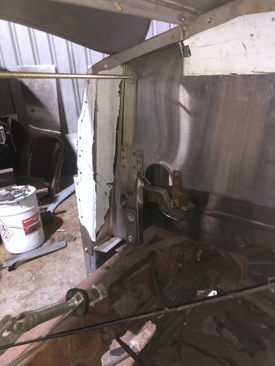

    2374065E-2A8C-4B17-BE58-A055507069C4.jpeg CA50DC5A-250D-44C0-B285-7196DDC23F4D.jpeg B41168BD-E4BA-4F5D-8041-9E963539567D.jpeg 3AC00D19-D105-4698-B86E-3675C943270E.jpeg 6DDB21FD-BCE1-4A45-9FE0-ECBC7DC497BA.jpeg Put in a full day yesterday. Focussed on door gaps and alignment of door. Welded in inner lower sill and it had the added bonus of pulling it all into alignment. Door closes like a bank vault now. I also added a little more sweep to the dash/armrest corner . Just about ready to turn her round and start on other door.

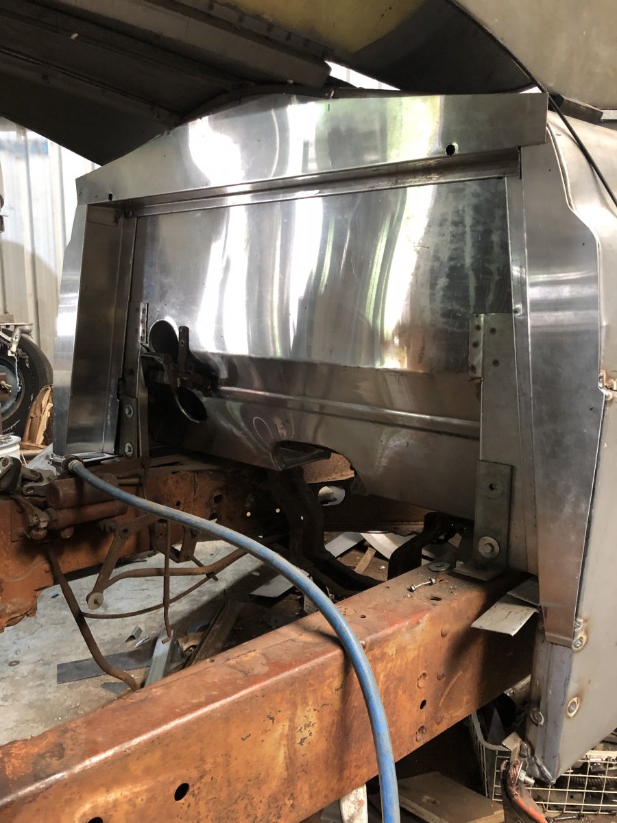

    It really is “one piece at a time”. Made a stainless transition from firewall to cowl side. This will be bolted in place , not welded. Other side is mirror image. CD62D604-65B6-4701-875D-0B32B5A63CC8.jpeg 53E00B73-D374-4DE5-B96F-098A4E175ABC.jpeg

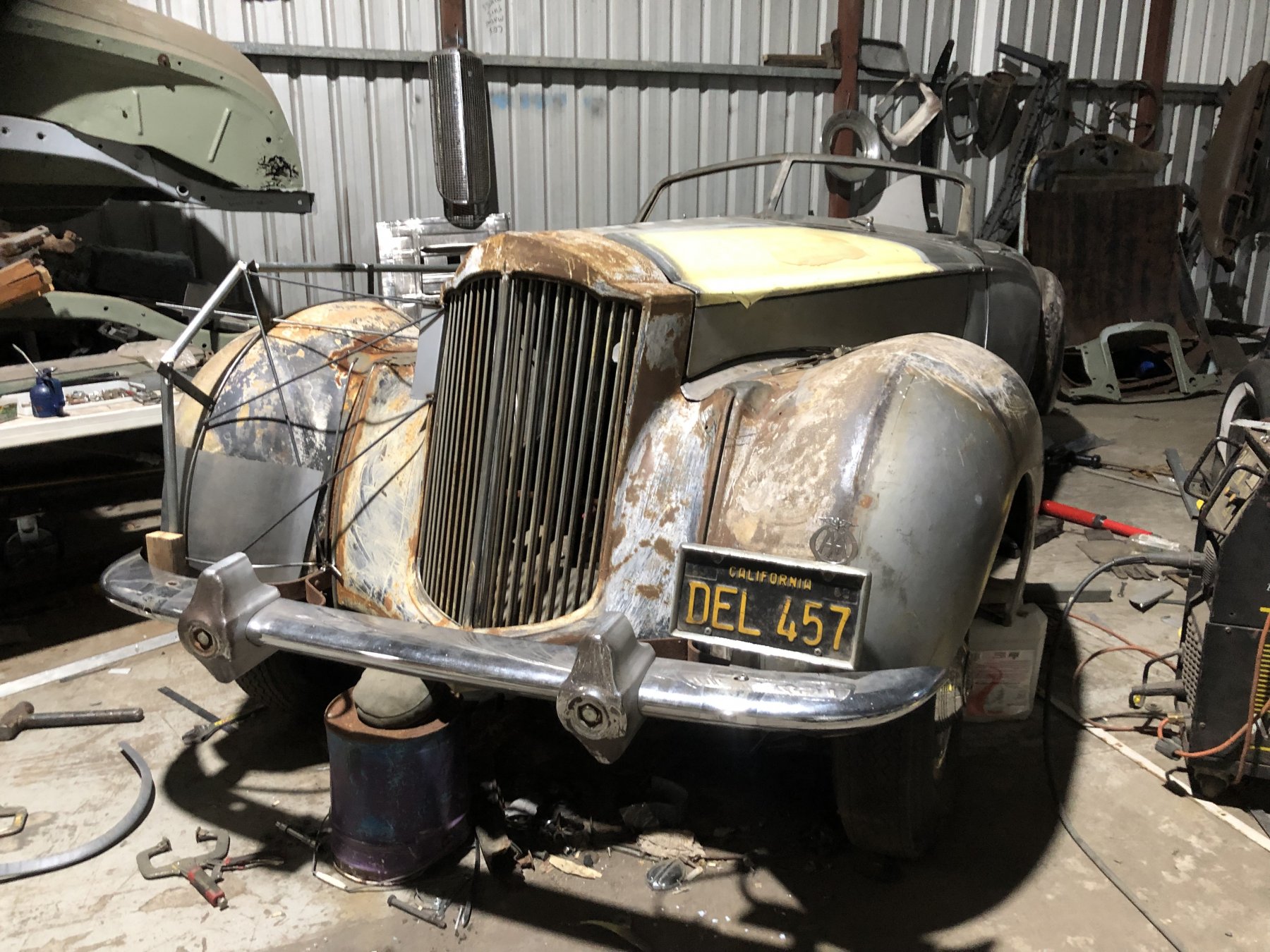

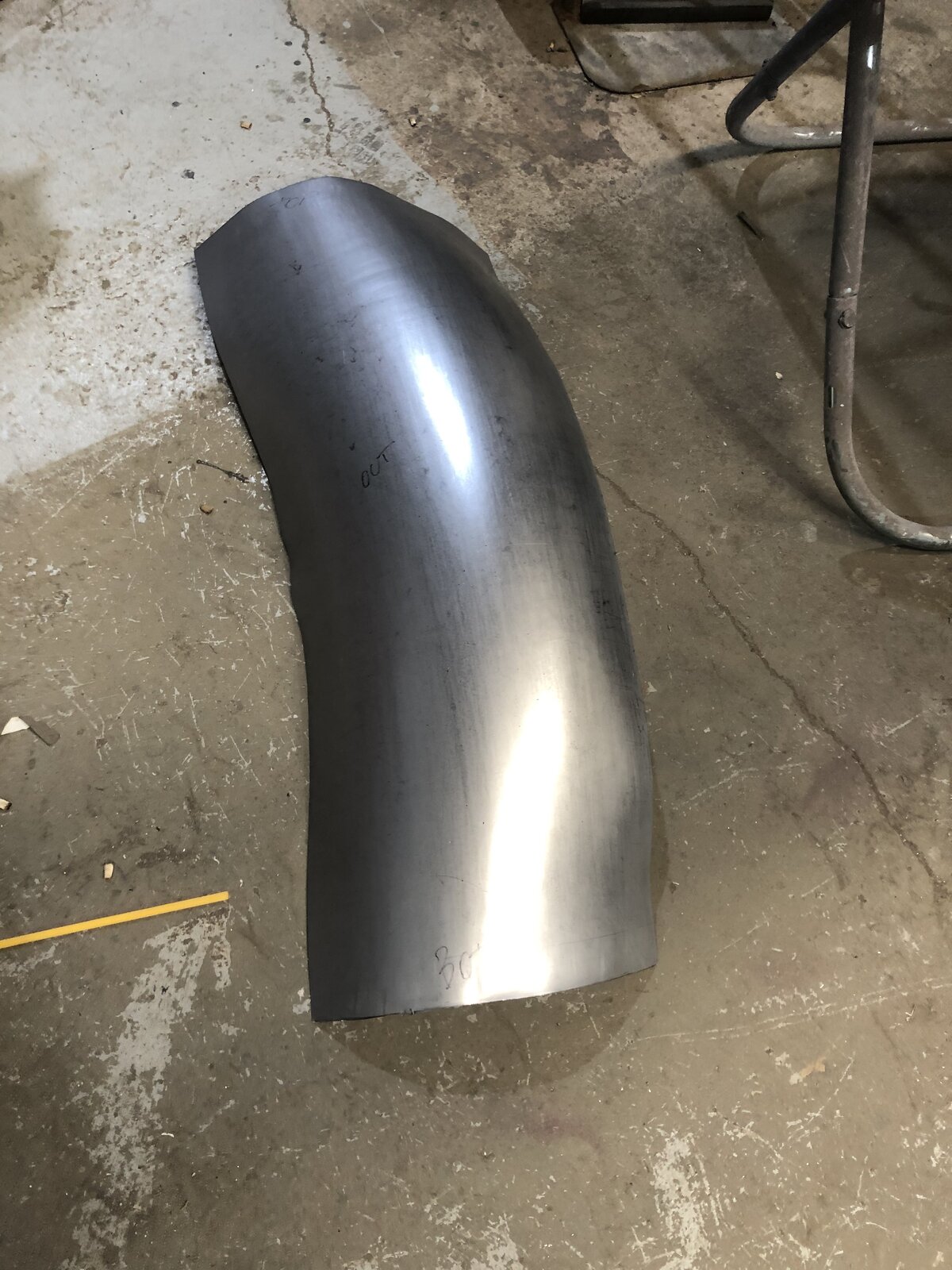

    49E27ACF-00C0-4395-982E-7D93924DF42B.jpeg E2522630-CDF1-4118-91D1-41ECB5B9A2FD.jpeg Ok. Been busy on other stuff... but it’s time to build the other front fender. This was the good one. The other was twice as bad .
    I made a wire form template jig off the other side and then flipped it all over. First job is to add the 4 inch extension at the cut. Then the tapered rear. Then fill in the missing gaps. Easy!!! Very little of the original fender will be used.

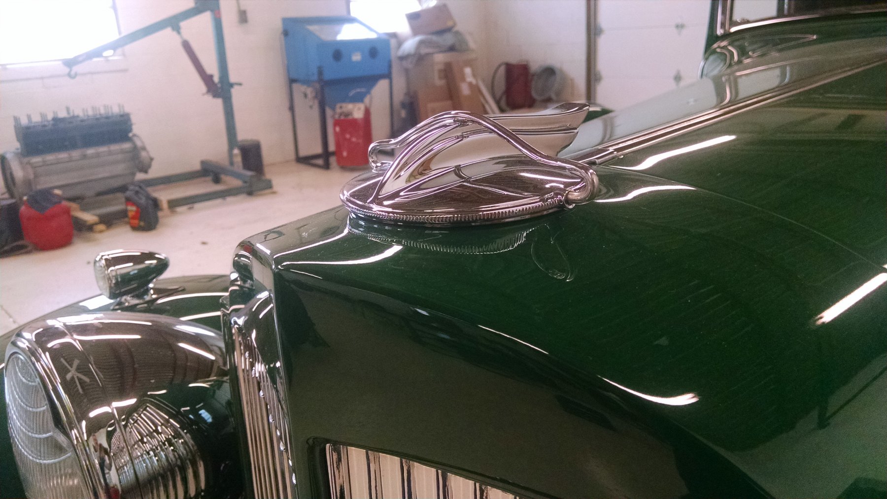

    That's a Packard "Feathered Bail" radiator cap that heralds the early days. The variant before that one (still a feathered bail) was similar with a more rounded base. The early caps through about 28-29 operated by flipping the bail and tilting the cap open. The coachbuilders at LeBaron thought enough of it to use it on the iconic LeBaron Speesters of 1934. Quite elgant and less obtrusive than others, the bail adding another dimension of style to it. My personal favorite. Here's one on a 34:
    The spear on the side, nice touch adding the "hook" to the rear of that molding. A little trivia there too, in 1929 one of the coachbuilders (Brewster I think) noted a special town car by Hibbard and Darrin. May have been a Rolls Royce. They asked to borrow the spear design for a hood element on a Packard, but inverted, pointing down vs up on the Hibbard and Darrin car. It was a hit and became a design element for almost all Packard models through 1952 or 53. Seeing those design cues used without excess is the very essense of work like this. Good stuff mate.
