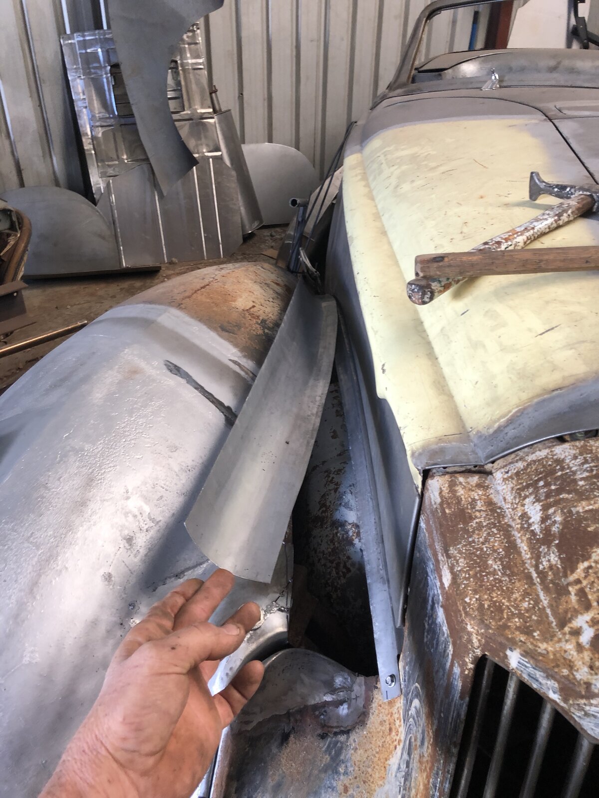

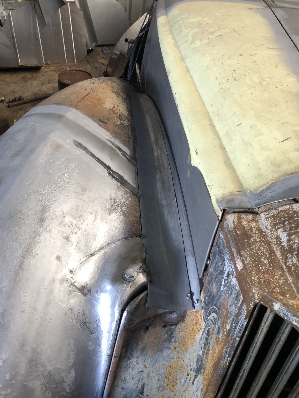

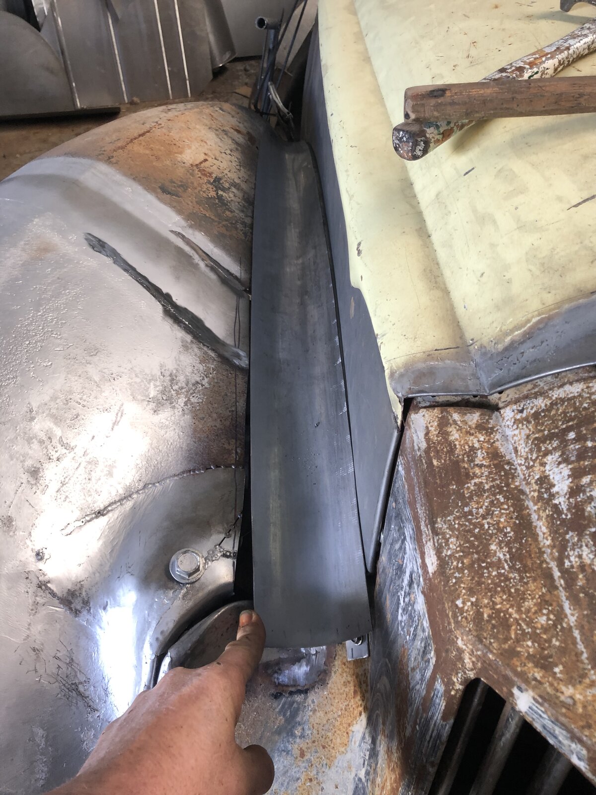

    B7940AA6-BD4A-4904-8F5D-C84F79E6542E.jpeg 5A882F34-8731-4192-97C0-48C922F20340.jpeg Here’s a good little Saturday morning project. Extending the guards and cowl changed the shape of the inner fenders. So I rolled up a reverse curve and step. Tried to make it in one piece but it wouldn’t cooperate. Just means a bit more welding but now 1490B855-EF3A-41C3-A61D-BAC17891D9FB.jpeg 00C47178-CCC0-4B63-81D0-8A3385556806.jpeg 934AC3AB-5DC7-44A1-BAF9-020114033F4F.jpeg the guard sits nice and rigid .

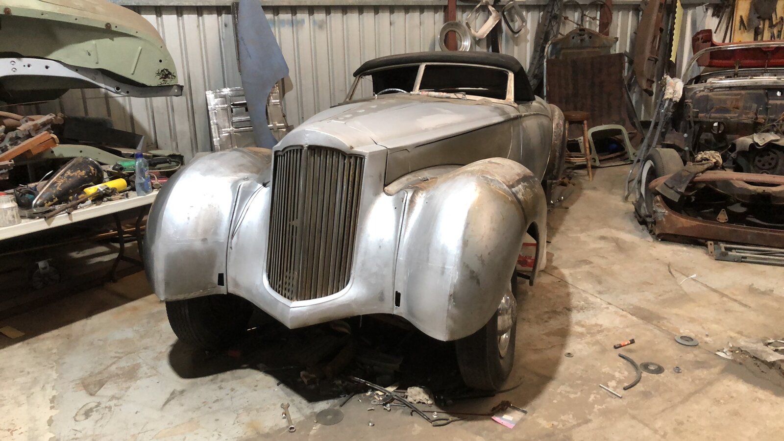

    CadMad
    BE229BA7-7B62-405C-AF5D-F670E9A74F7E.jpeg EA4C6390-E14B-44F0-81E8-4CC604661200.jpeg 6719E995-0B31-4F8C-91C4-41CBB668A283.jpeg End of financial year cleanup. I can see the floor. Life is good. B1FF41E9-F5B8-4B08-B106-D69345AD68AB.jpeg

    Ah it looks amazing.

    Great Build!

    Gorgeous!

    It really does look great. And the pantograph doors are so perfect for this build. I don't know how else they could be hinged, and even if they were hinged, the swing would be m***ive, but the door length and shape is perfect for it's proportions, so those hinges are just the ticket.

    Wow, that has some great lines! The doors really make the car.

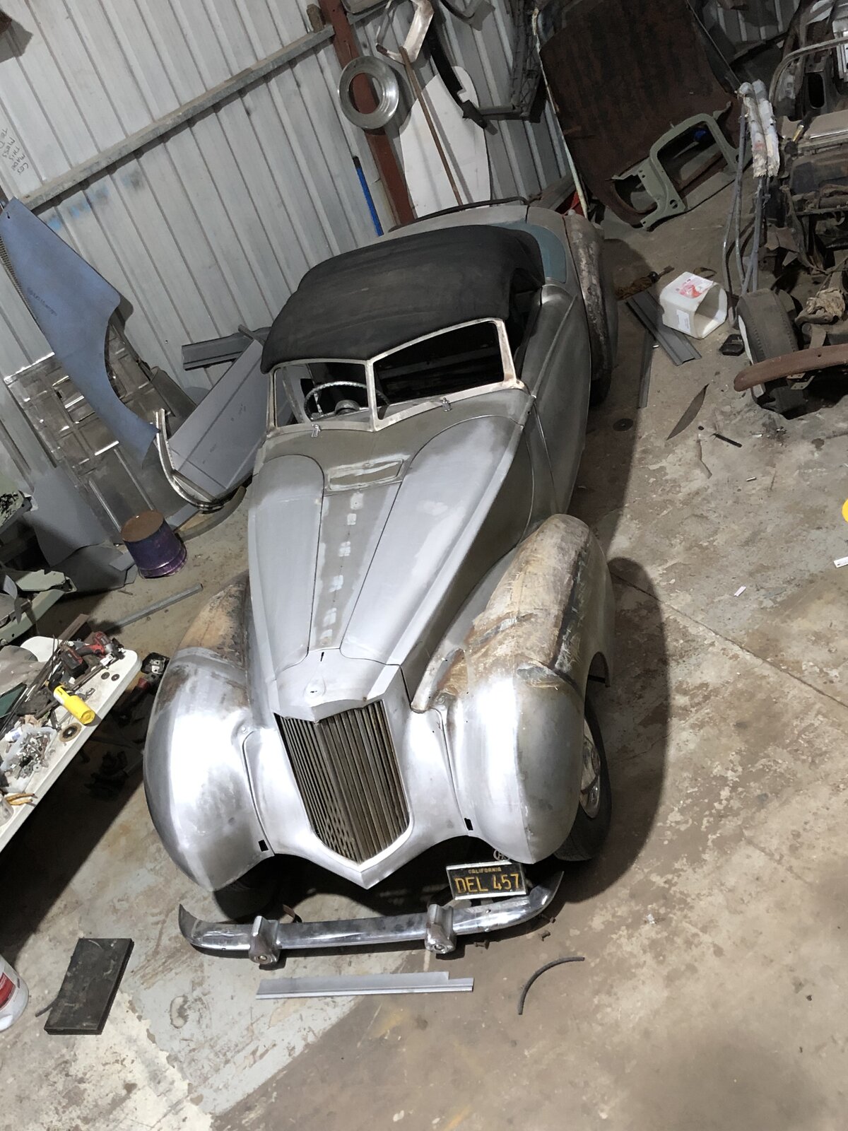

    Been building a mezzanine the last few days to get a bit more storage space. Laid down the last floor sheet and from my new vantage point was a great view of the Packard from a new angle. AB74EDCF-B0FF-4737-8573-1A5B1AA51DAF.jpeg 39C9B463-C5D2-4FF3-806B-830C4A78EB8A.jpeg

    After going thru a few “names” that befit it I have settled on the “Packard Aero”. Something that I really love about it is the chiseled nose that is sharp and defined and then it falls away to the smooth rounded flowing form of the rear. Which brings me to the paint…. Which for the record is still a long way away… but it is always nice to have a plan.
    Yes it certainly looks good in Silver and does indeed carry the “aero theme”… EF0920AC-2C9E-4D1E-9193-E434929B6178.jpeg . Quandary is that I have a very nice unrestored 57 Eldorado Biarritz in factory Starlight Silver with red interior waiting in the wings.
    I still like the fact that the photoshop of the only 1939 “Havana Beige” Darrin that Rik Hoving used as the basis of our collaboration of initial ideas turns out to be the original colour of the car. I thought it was originally black until I found perfectly preserved “Havana Beige” in the b pillar.
    I’ll be addressing the ch***is and driveline next so for the time being paint colours will be put to one side.

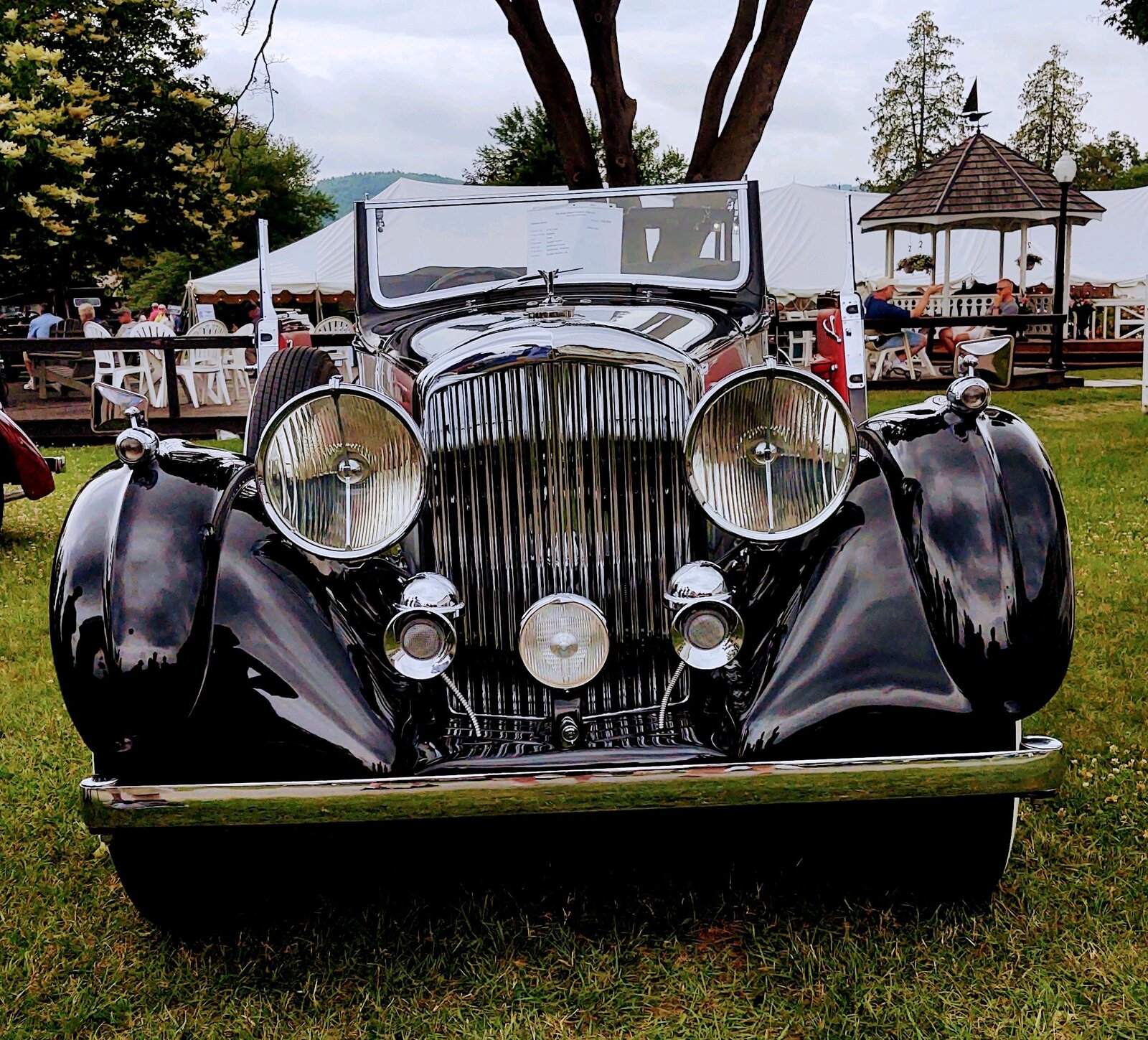

    Saw this Bentley at a show near my house this past weekend, had to share with you.
  30. CadMad
    Joined: Oct 20, 2012
    Posts: 886
    CadMad
    Thanks Mark. Haven’t seen that Bentley before. I know the patent was owned by James Young Coachbuilders England and used under licence by Saoutchik. It would be interesting to know who was the Coachbuilder.
