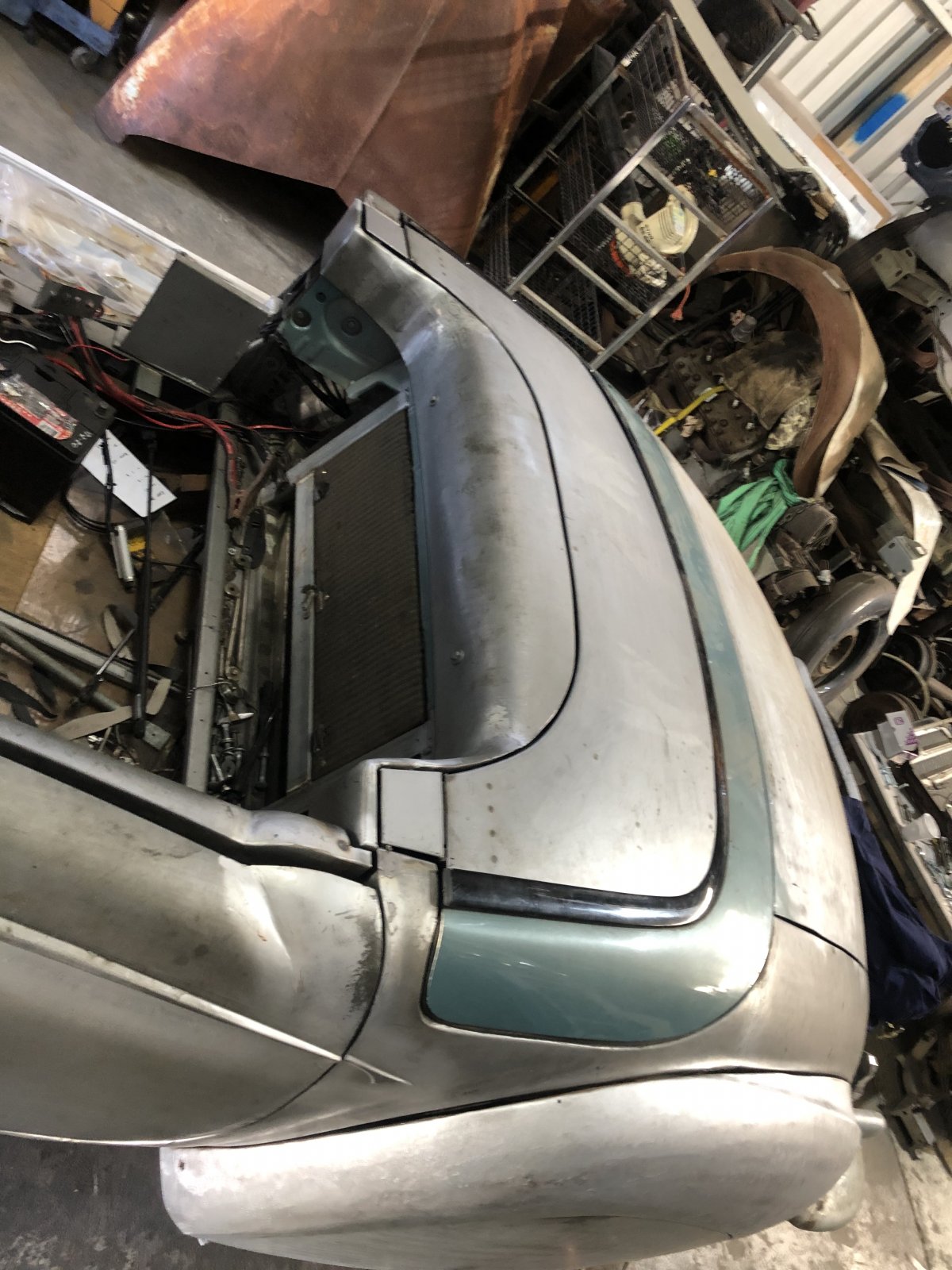

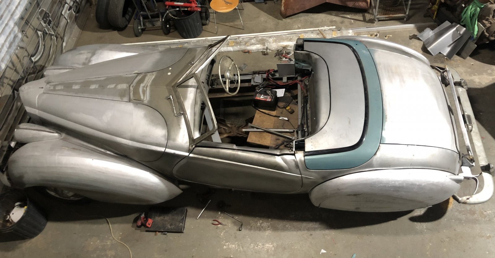

    So my next project is the two flaps that cover the void where the top mechanism resides. These are tricky. The original Saab flaps pushed forward into the rear armrest but as I’ve now got the b pillar there they won’t work.
    I originally had the flaps opening sideways but I’ve decided to change them to hinge them 6171E3E3-96D4-454D-9407-7D75A121932F.jpeg 078B803E-6D76-45EA-B750-9DC012685365.jpeg off the hard boot.
    My daughter has a Merc clk 230 convert and the flaps are on the hard boot operated by cables that pull the flaps open when the top is raised and release them when the top is lowered.

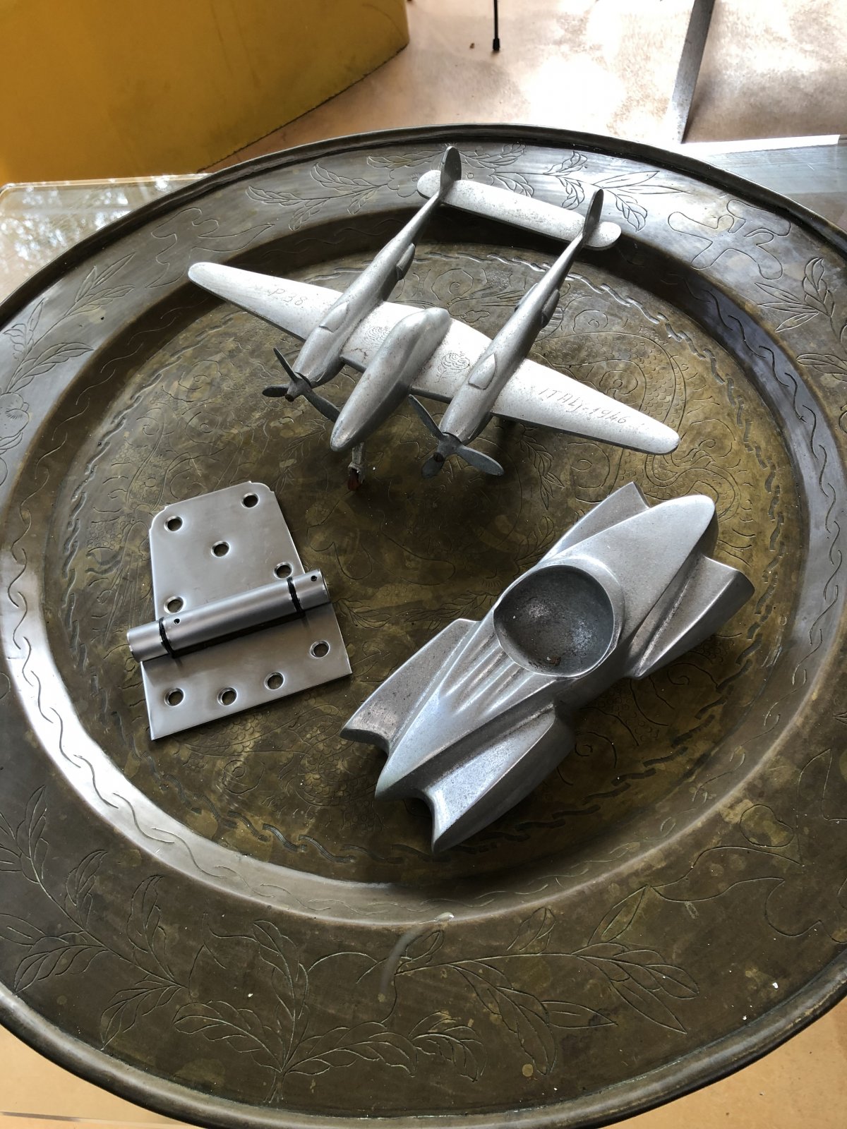

    I went to the hardware yesterday and found some nice SS spring loaded gate hinges.
    Can’t wait to have a play over the weekend.

    Overhead view of this car is spectacular. Pretty neat someone already figured out how to make that top operate without a computer ***ist, that's definitely a time-saver.

    The overhead shot confirms the right-on proportions!

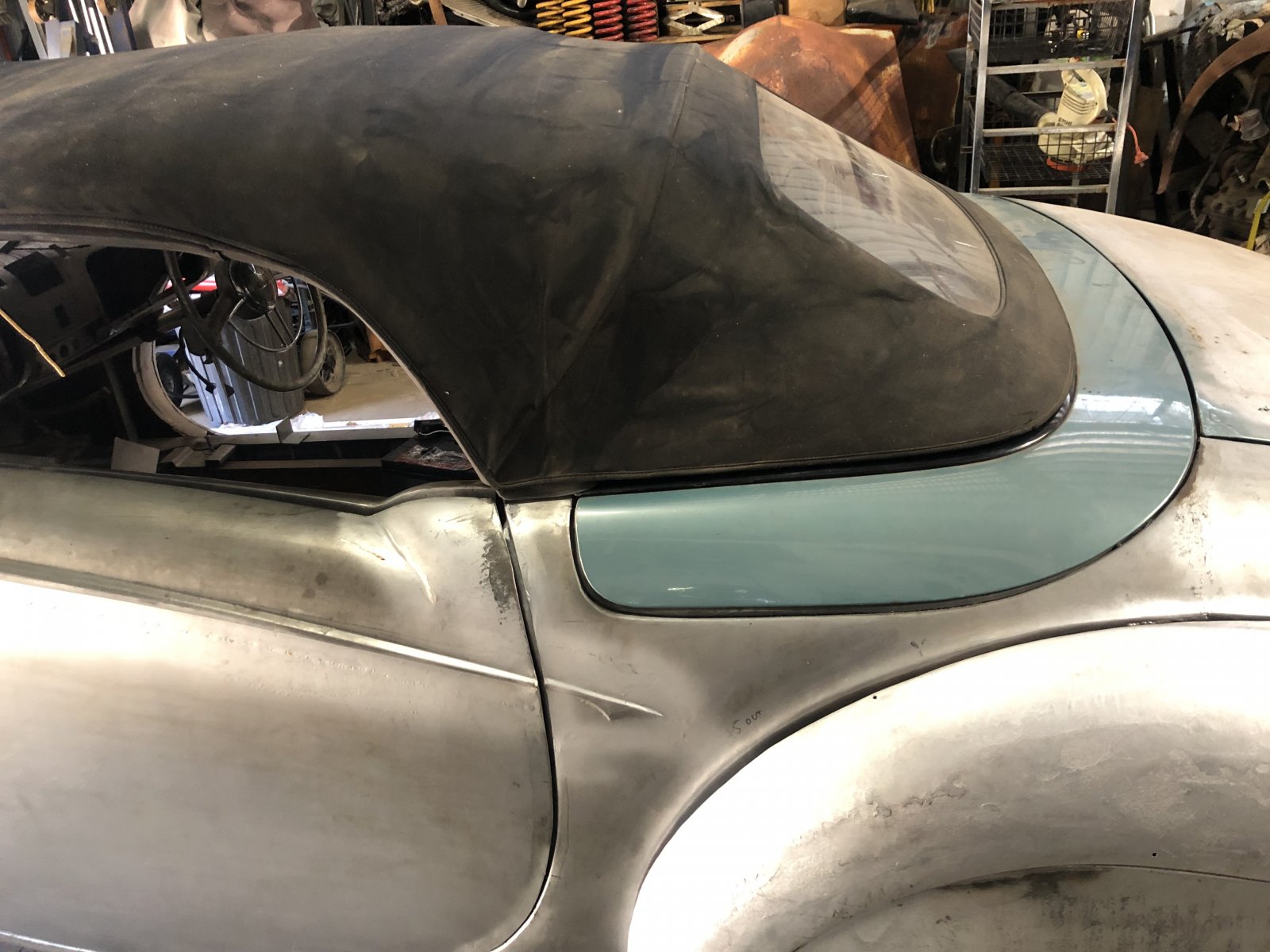

    Did a late night shift again and finally I have a fully operational hardboot.
    I decided to make the flaps manual like the 53 Eldo. Down the track I may still make it fully automatic operating off cables… however each flap will require two separate cables so for now I think I will defer to simple manual operation. Everything works as it should and nothing fouls. Very happy.
