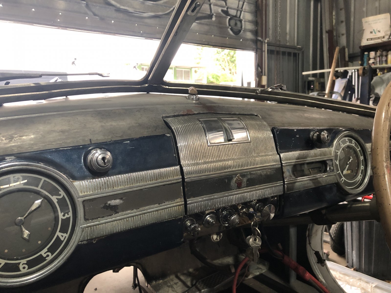

    Dash pieces put back in for a bit of Friday night fun. Still a little bit of tweaking on the centre piece which required rebating into the upper section cos the dash is a completely different shape to the original. Looking for an original headlight switch. Still yet to convert the lhd speedo and clock placement to Rhd. 6DB09E45-6460-4DA4-B71B-0937C8A1A149.jpeg 8F38126A-CD01-4A27-B1E2-D052CB290271.jpeg
  6. patsurf
    Joined: Jan 18, 2018
    Posts: 3,401
    patsurf
    prob the only time i've seen the word rebate (rabbet) ever used correctly--almost as many points for that as the incredible work so far..
    Stogy, CadMad and loudbang like this.

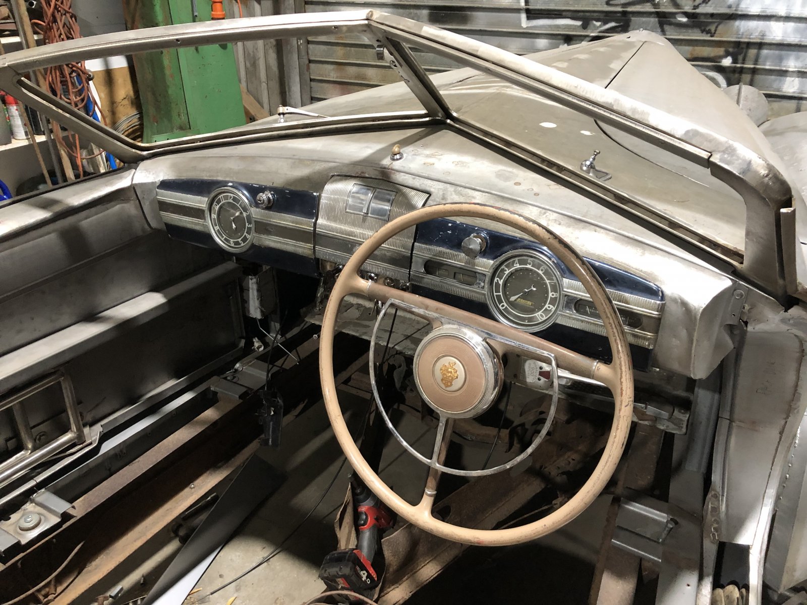

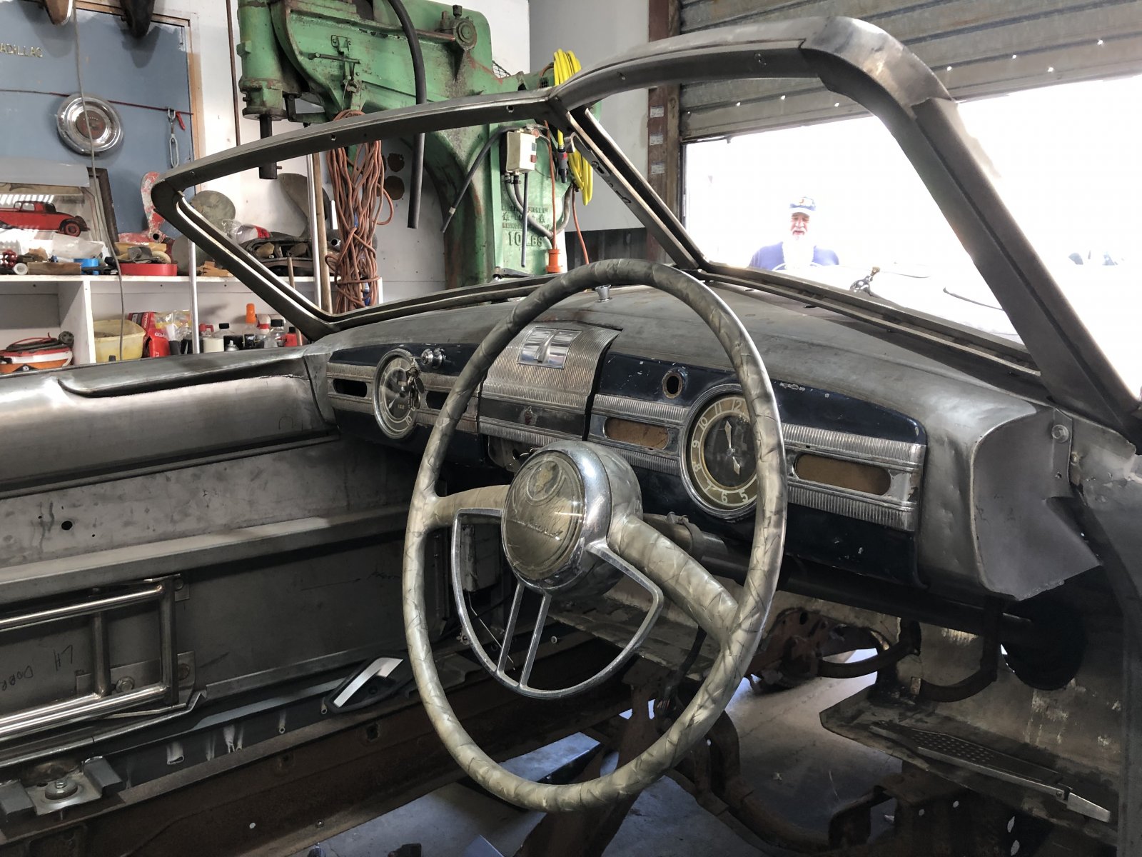

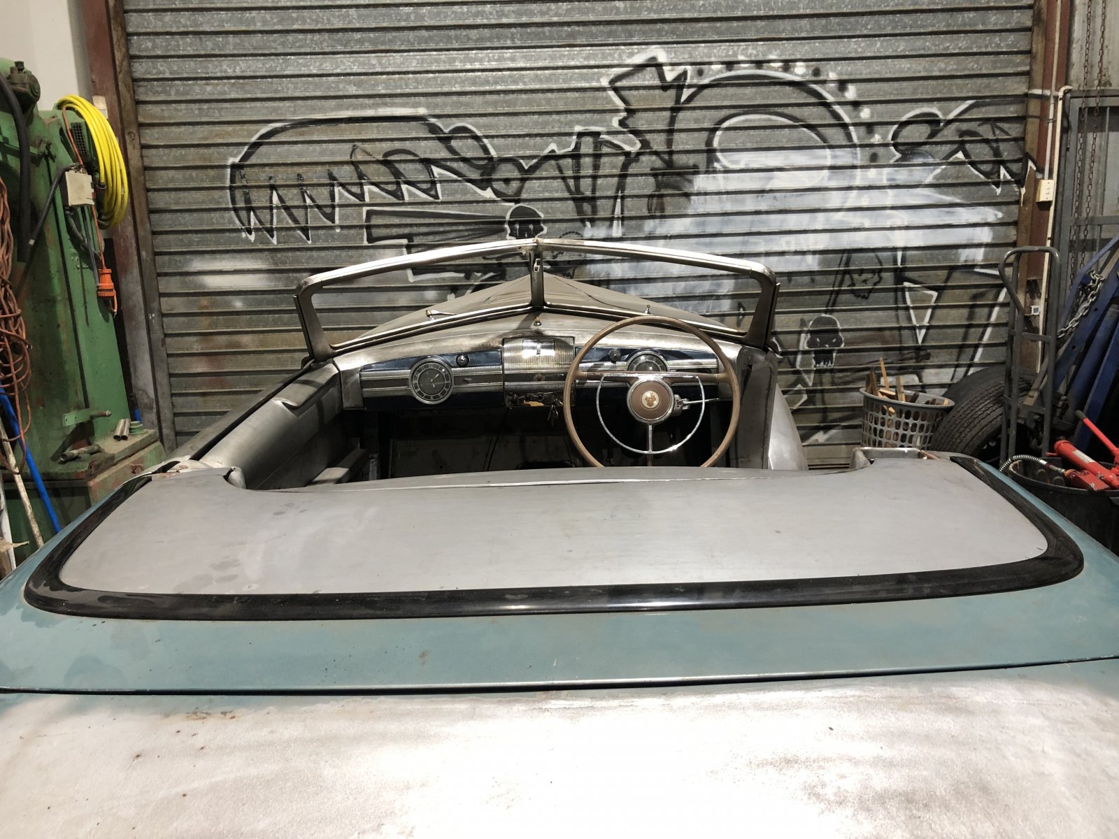

    Tidied up a few more details. Swapped over the clock and speedo and got everything to fit a little better. Glove box is operational so that’s a good little job to make a insert. …. After the wiper mechanism is sorted.
    Swapped over my 41 steering wheel to get a feel. Not sure which I like better now.
    Steering column linkage is soon to be on the C557DDDD-9BFC-4453-9D4E-37F068FB24A0.jpeg 5F785755-51F2-4DB7-ABE7-CC0A396E313A.jpeg 4BD90121-08EF-4EF7-9A32-D9A9D0C636A7.jpeg 81D1BB29-473C-4CE0-A131-6ADF88CC1AFD.jpeg agenda.
  9. GirchyGirchy
    Joined: Mar 17, 2011
    Posts: 283
    GirchyGirchy
    from Central IN
    I vote for the other wheel, the sloping spokes match the feel of the car better than the T-shaped '41.
  10. Squablow
    Joined: Apr 26, 2005
    Posts: 19,041
    Squablow
    I agree, the flowing shape of the car and the rounded spokes of that grey pearlescent wheel really work well together. The '41 wheel is pretty on it's own but kinda angular in the ****pit of this car.
    oneratfink57, Sandgroper and WalkerMD like this.

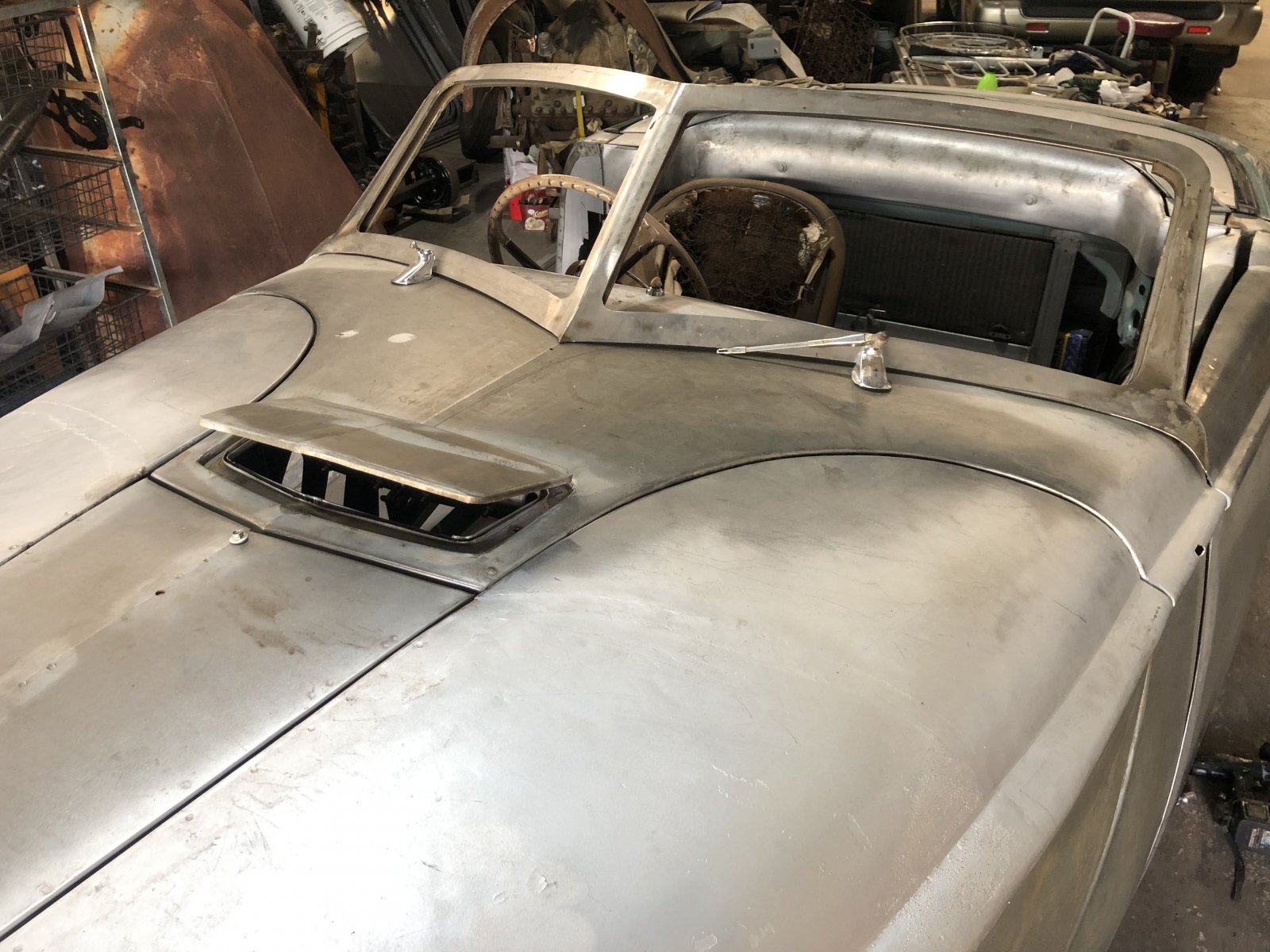

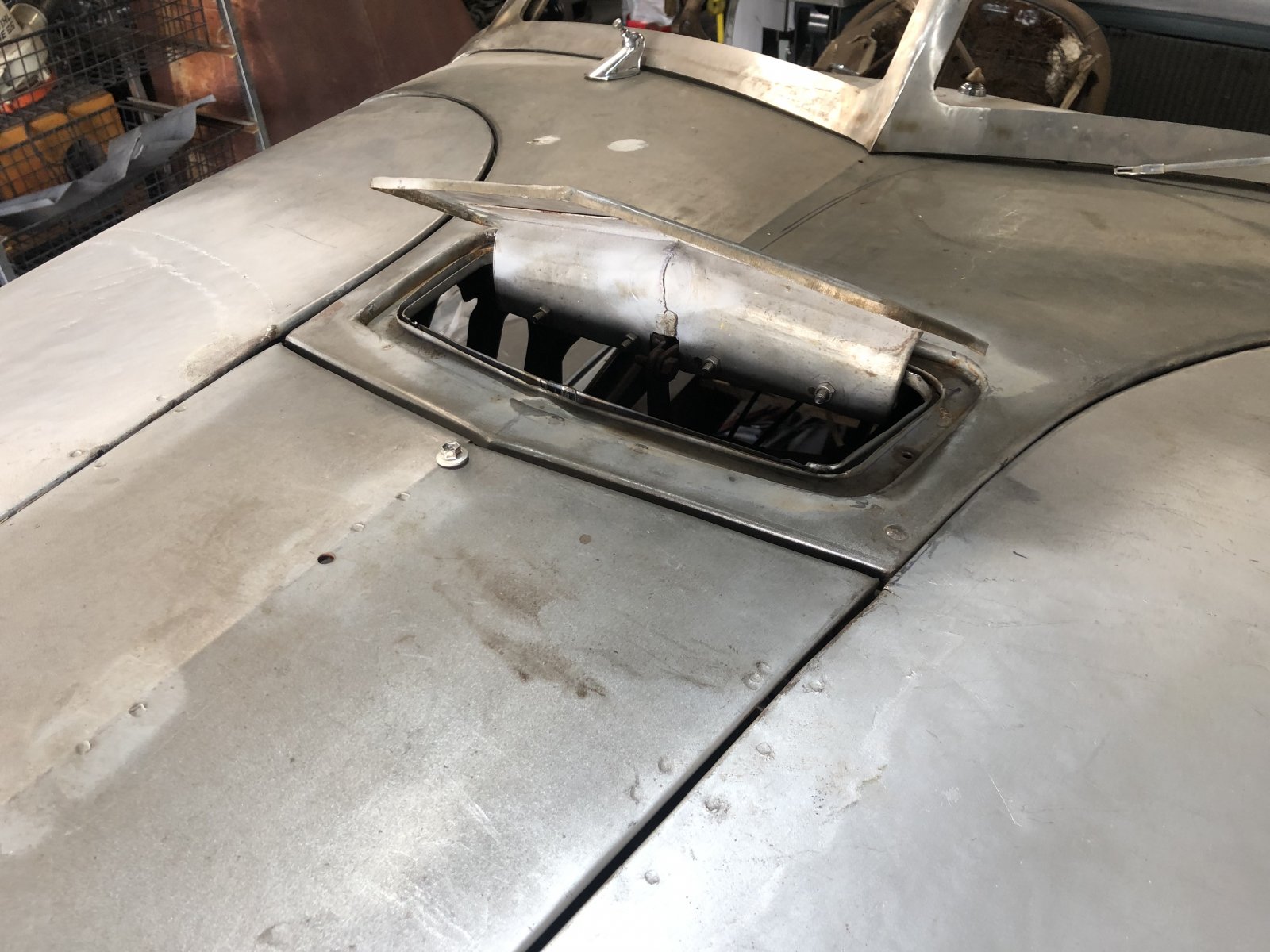

    Got the vent flap operating off a 30s Cadillac vent handle. Had to extend the mechanism to suit the stretched cowl. Working in the wipers now. Should be operational by the weekend. EA49D65C-93C5-487F-A08A-AE6CA2A4E25D.jpeg 35CA6568-751C-4B05-A716-0AB5DA813C01.jpeg Works like factory.

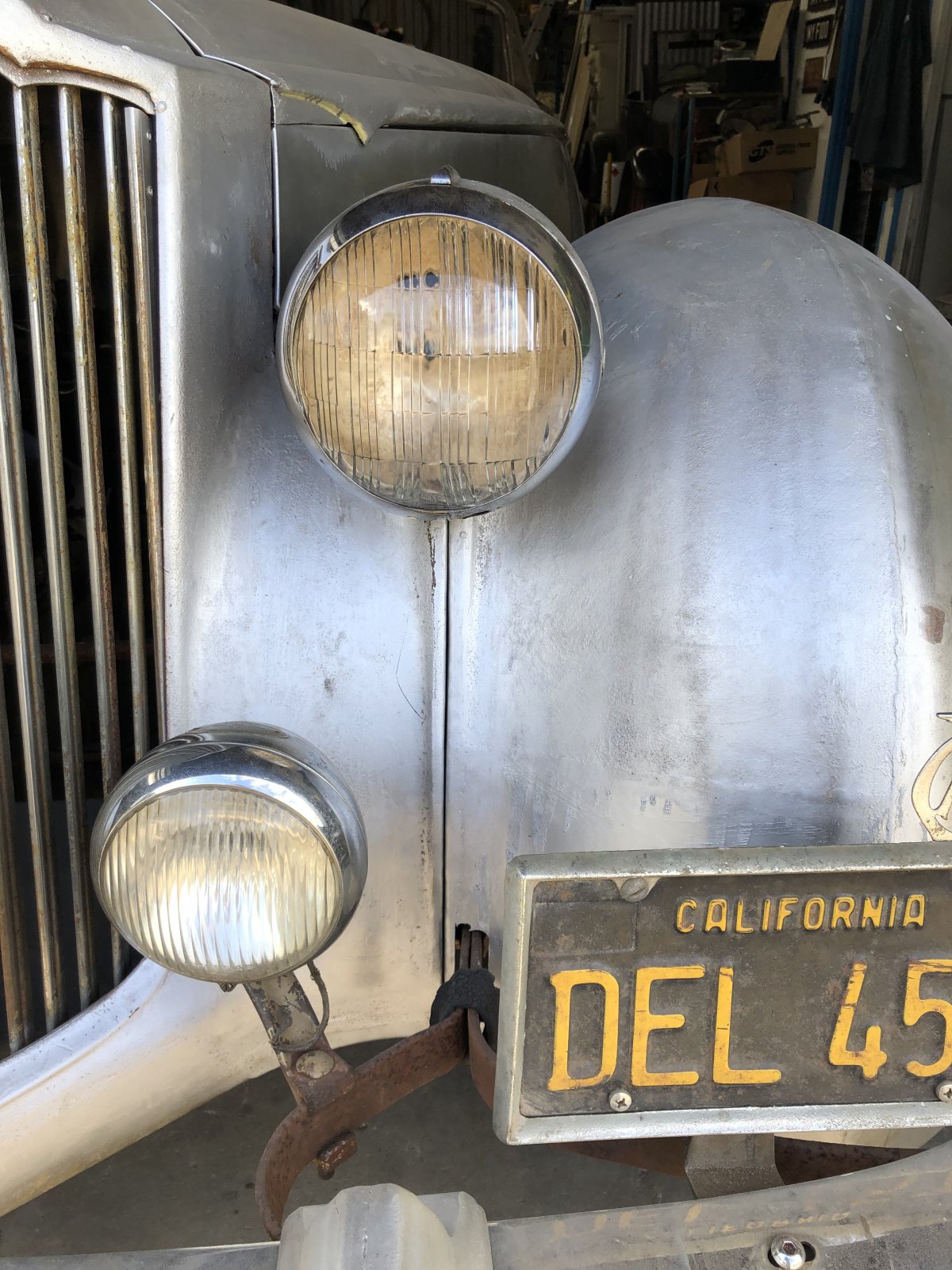

    3B667C49-5AFD-4376-9BF5-7DB4ADEC7374.jpeg 39387CB8-5768-48E2-A046-1DA2D5298E82.jpeg AE5AC290-0F11-473E-9E2A-EB9010F3D8A9.jpeg 0719CF4B-7578-464B-8003-A499D46D04E6.jpeg Sunday job was to finally mate the 39 Buick buckets to 39 Packard rings and 37 Olds lenses and reflectors. Perfect fit.

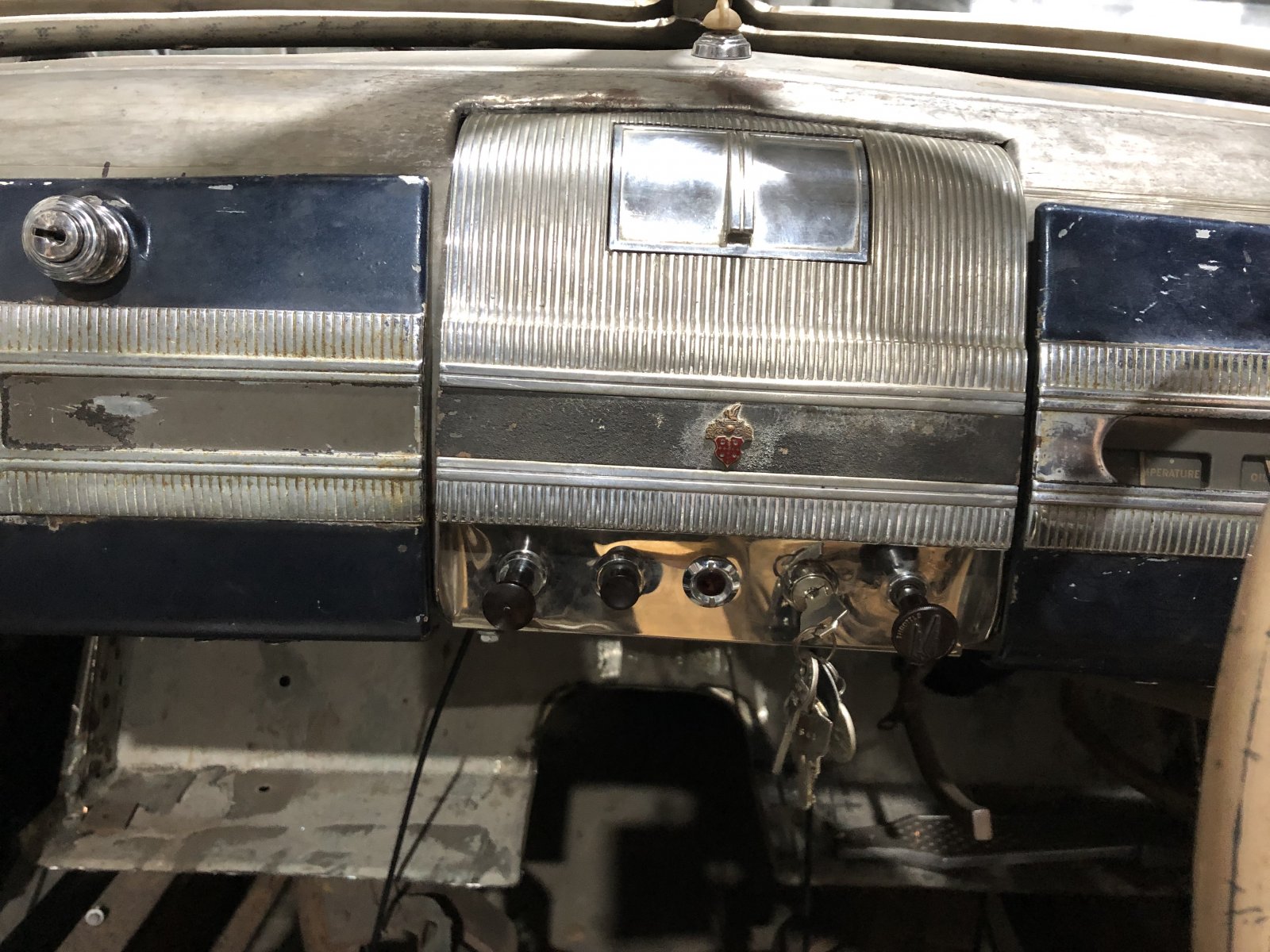

    I haven’t done much as I’m in the midst of hectic D7C73930-FA4B-4417-93E0-FEBA277036ED.jpeg work and organising the shipping the remains of a 1 off 53 Eldo from Detroit.
    But I did manage a bit of a reshuffle of the lower dash knobs. These are mid 40s Cadillac from my spare parts stash and are Choke, starter, lighter, ignition and lights in that order.

    The knobs look right at home there. Does the lock cylinder on the driver's side do anything? Or is that just a leftover from the RHD conversion? It kinda looks right there, for symmetry, but I can't imagine what it's function would be.
  27. CadMad
    Joined: Oct 20, 2012
    Posts: 886
    CadMad

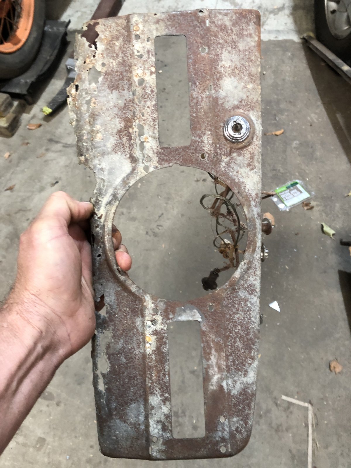

    The knob on the instrument cluster is the dash light dimmer rheostat . I was missing the original knob but I found a nos glove box lock and used the old glovebox lock knob in lieu of the original knob. It’sa little worse for wear but I’ll hopefully find a better replacement shortly.
    This is what I found of the remains of the original dash…. So it was a bit of archaeology.
    I can’t believe a dash could rust away so badly and the switch could be still intact.
    The steering wheel debate will continue as I’m in a quandary. I agree the droopy wheel is more aesthetic but it is a post war wheel, and subsequently the 41 wheel is more in keeping with the period I’m aiming for. By no means is this a period perfect build, but I do like to have a guideline that I try to adhere to. In any event the steering wheel will be the last nut I tighten. So lots of other decisions between now and then. FF637AB8-78B0-4A3B-8889-D5504D661AEB.jpeg E7D05611-9AEC-4C2E-9AFE-355E314E097D.jpeg

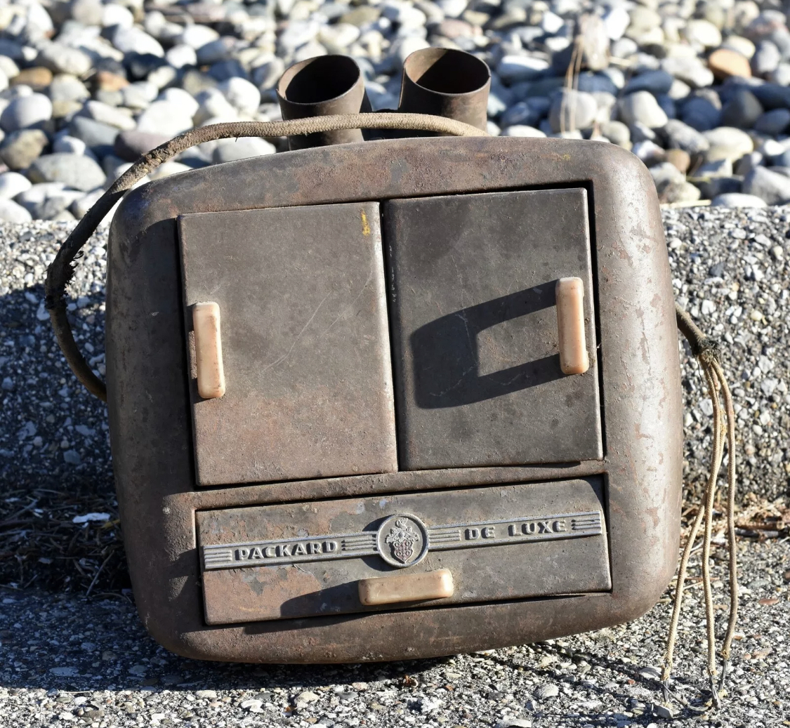

    Had an eBay win. Found a correct for 39 1F71BDA6-1902-4E3E-8047-2CD2EA2D36AF.jpeg heater for $60 that will fit right at home. Coming from a premier Duesenberg restorer in Michigan… can hitch a ride in my 53 Eldo project that is getting shipped out of NJ shortly.
