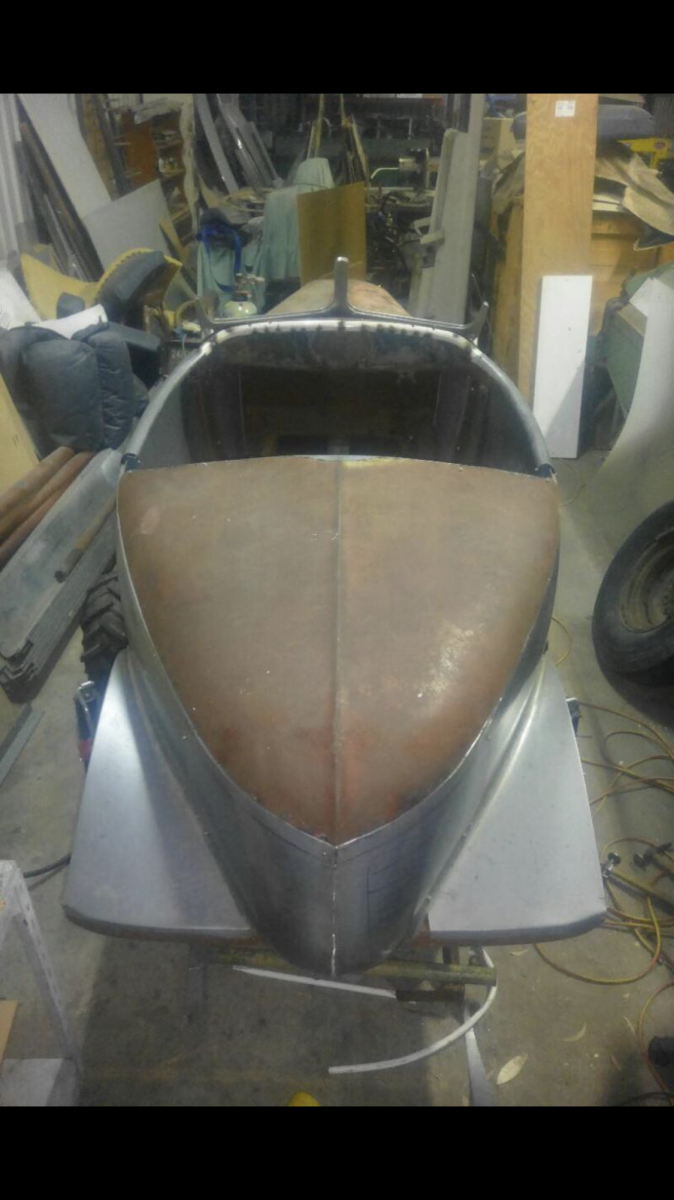

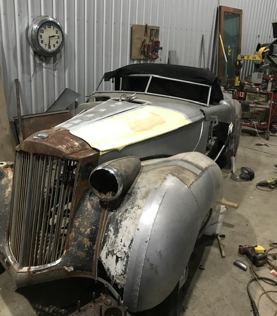

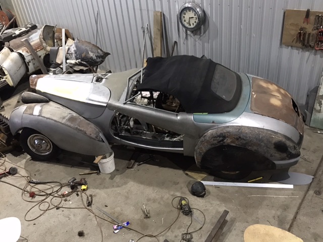

    I’ve come this far.... may as well go all the way.
    Gonna build whole inner cowl from stainless and maybe engine turn it once done.
    If it’s good enough for Tesla.... it’s good enough for me. 3BCB4B43-3A6B-4B04-B554-FD08E0613E49.jpeg 7EB115AA-9F5F-400F-80EE-54959FB35917.jpeg 0EC1A977-739C-42BE-AA0E-061168CFADA7.jpeg E9DA3363-459C-499B-BB30-779872632F2A.jpeg F505B4FA-10A2-4F4B-9D10-1DF20D4458EF.jpeg

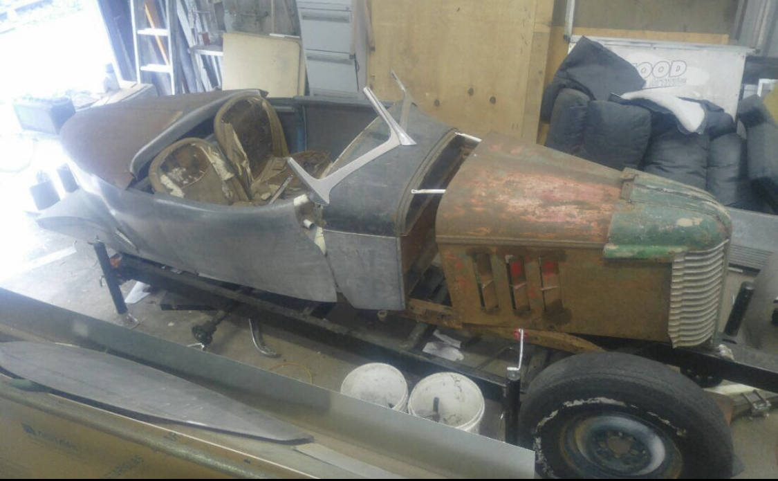

    More stainless than a Maytag washing machine.
    I talked to my mate Jason who does engine turned dashes and if I’m lucky he’ll make me a jig to engine turn the cowl. That can happen later. Got to put it all together again. 3F000DA6-7A1C-466F-B082-BCDD14CB147F.jpeg 4AF978CE-0993-4885-A285-60A36EA6D0F5.jpeg

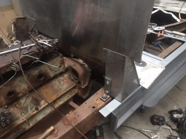

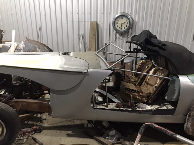

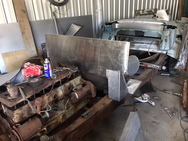

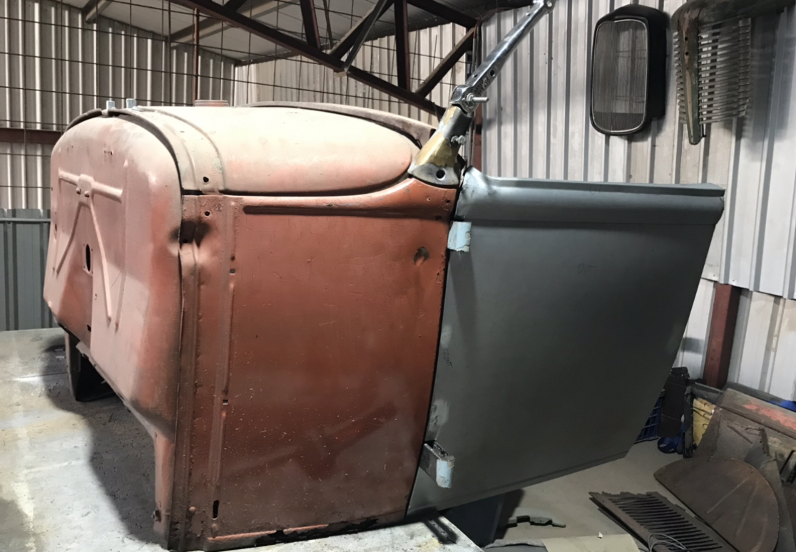

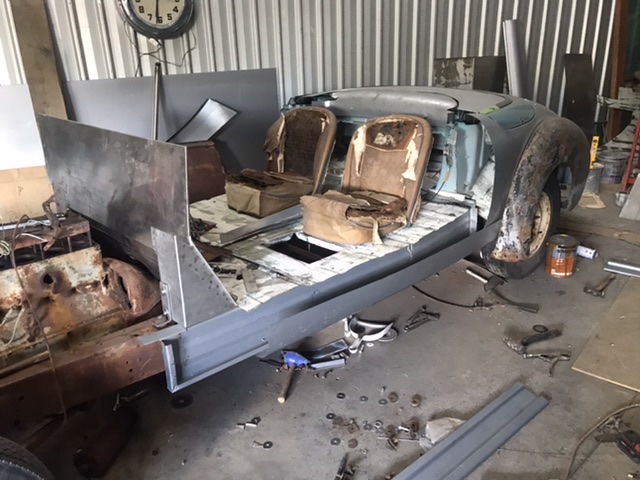

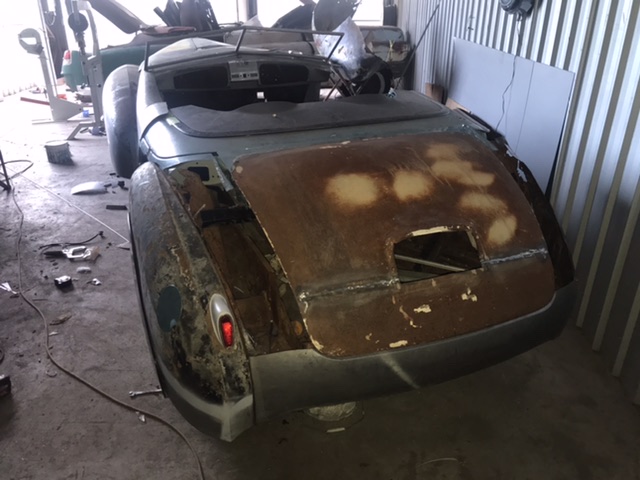

    Cowl is now bolted up and inner sill screwed up and square. Nice to finally have clean metal to work with. Cowl face is moved back 4 inches yet floor area remains the same. Toeboard is steeper. Nice and rigid. The rest should be like Meccano. 5B7345DC-037A-41FC-AF00-9E24C081171A.jpeg 6F0EE68B-C843-4E16-911A-B60DC9D406FC.jpeg

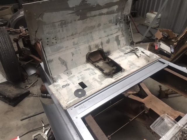

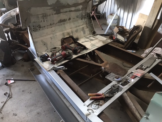

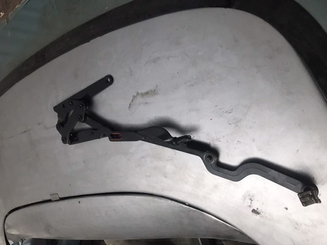

    3CD7CCCB-5CA5-4001-B934-B9EA36E475E2.jpeg 6DFA718D-E429-4B97-B72B-75B337F2B492.jpeg Long afternoons and the weekend to get the floors cut and folded up and screwed down. Work is back to normal so won’t be as many Packard play hours but the hardest work is now done.
    Found a replacement of the roof mech that I threw away. Happy Days.

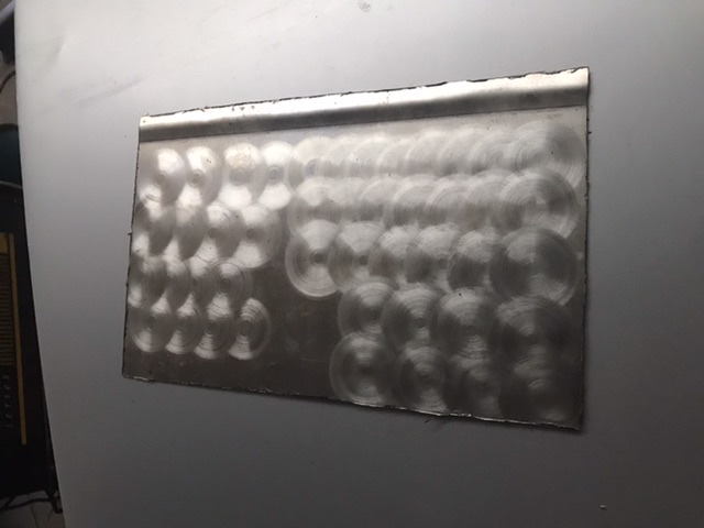

    Practiced doing some engine turning on my drill press, rough and quick but I’ll make a proper jig and give the cowl a go on the weekend. DFD5BC34-04A8-4BAD-BCA9-E36B2BDDDE6A.jpeg

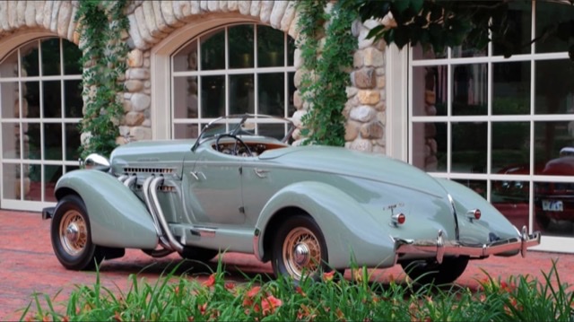

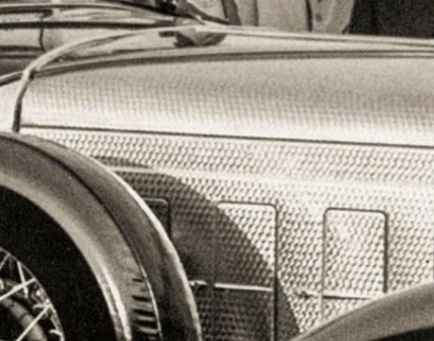

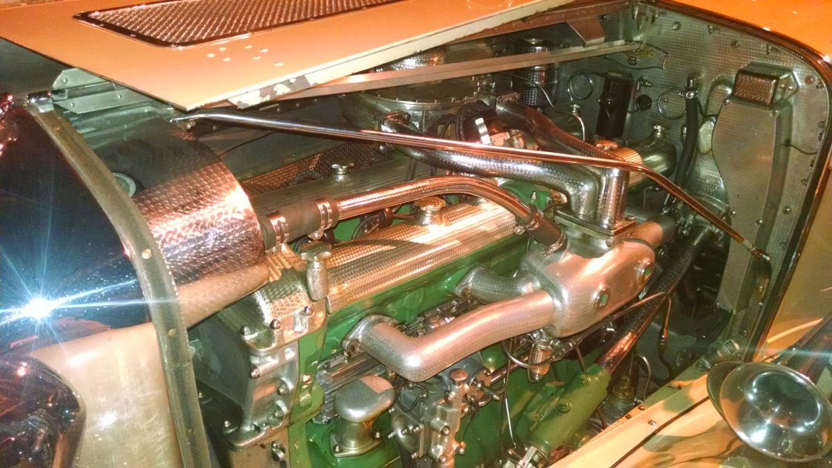

    You'll be in good company with the engine turned stainless. I'm sure you're aware of how Bugatti and Alfa used it, but this one is under the hood of a supercharged Duesy Model J with Brunn Riviera coachwork. Yeah, every bright surface. Rad, huh?

    Thanks Highlander, just the inspiration I have been looking for. I need to put a few dimples in the firewall and am tossing up to do the engine turning prior or after. I think prior.

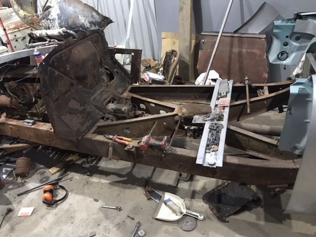

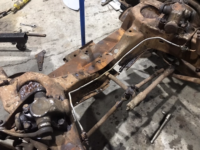

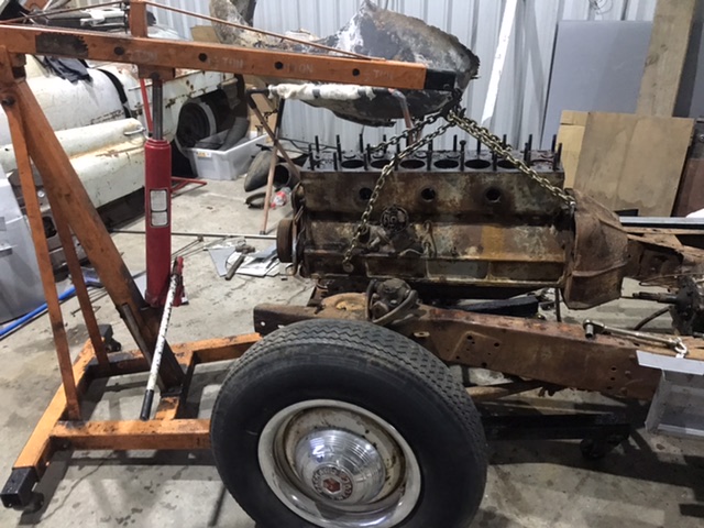

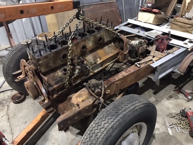

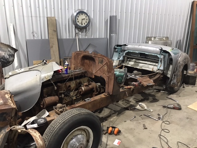

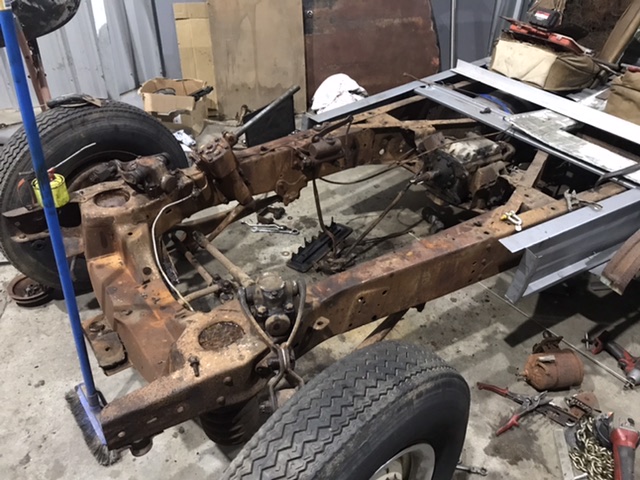

    Got the engine out last evening. I’ll drop in a running 39 Six initially, till I can afford to do the 8. But it’s definitely getting the 8. I’m onto a running Super 8 engine that was only a suburb away till recently. Got given away. Trying to negotiate now Got some rust repairs to do to the front crossmember and now I can get to it.
    I’ll get the gearbox out next and get it overhauled. 53C4B5DA-B288-4786-87B4-91F13BCE745C.jpeg 8E9D9FB9-7998-46C5-83EC-B198E97774B0.jpeg A5AAAC6E-B17C-4FDA-99D6-90867997885F.jpeg FEE01938-37A5-46D4-8EA2-D63D7BA3BBF0.jpeg

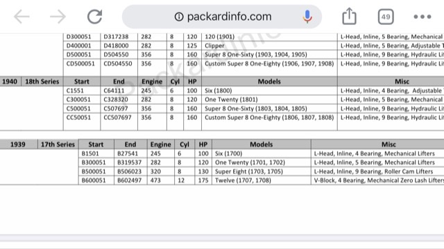

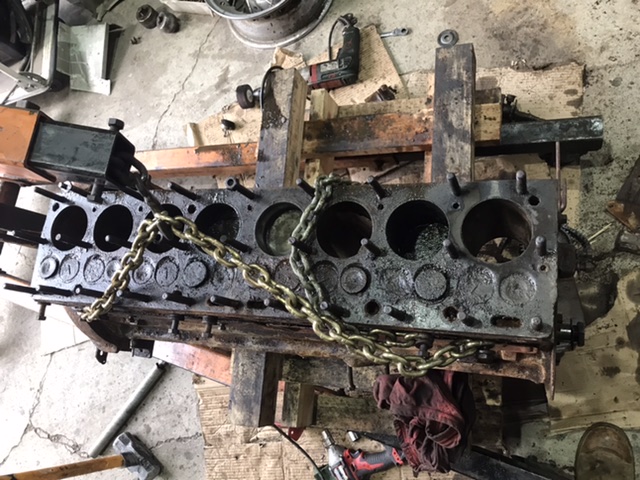

    44C04492-ED2A-402E-9D44-CF9578D2799E.jpg 72738D8E-699F-4DF7-B95D-96A934E6A7B3.jpeg Got the engine apart and Piston’s out. Bottom end is good even reusable Valves need doing and bore has been sleeved ( a few were badly pitted). Probably back in the day when oversized Pistons weren’t available. They just sleeved them and reused original pistons.
    I checked the vin against the Packard database and it’s the original 5 main 282 120 engine so regardless of the fact that another 9 main Super8 engine might show up, I think this deserves doing. I’ll clean it up and get it crack tested first and go from there.
    Will have to bore it out past the sleeves, and either find new pistons or resleeve worst bores.

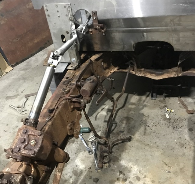

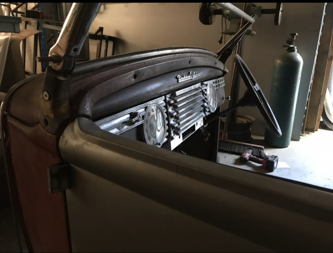

    Decided to do the fit up of steering prior to engine turning firewall. Fitted a nice alloy (which I’ll polish) Borgeson joint that came off the Saab Aero donor car that provided the convertible top. My mate turned up two steel adapters to fit the original steering shaft.
    Got a nice stainless tube from the s**** yard for the column. 57D5E7EF-01EF-4926-B49D-7B351A139AB7.jpeg

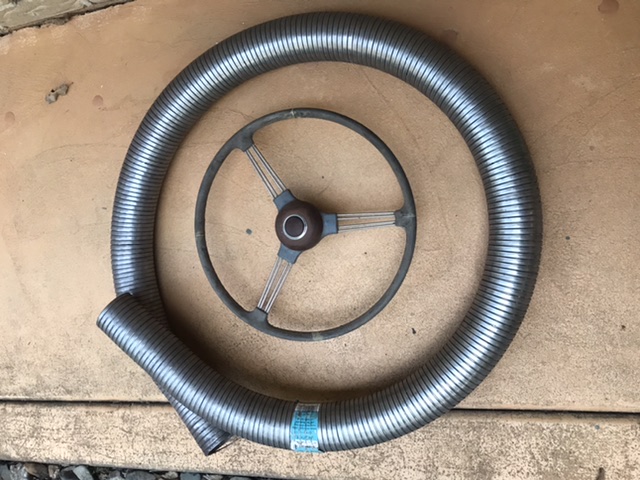

    Scored a roll of SS flex pipe yesterday. I lifted off the heavy cast iron exhaust manifold the other day and thought I need to make stainless extractors. Have some mandrel Bent pool handrails in 35mm stainless that are perfect to cut and shut. The manifold has 8 outlets so 4 pipes on the right side of the hood might be nice. 9BA5D513-1E64-4302-A628-A3613D93CC3B.jpeg E7F4F4B2-0B0B-4A11-83CC-311630FB0A7E.jpg 3CA4F2B9-D728-420C-A9BE-54B344BC741C.jpeg 52E974CE-A114-4956-BF7E-E75C72BDF8EE.jpeg

    I used pool hand rails on my A to fabricate exhaust. You can weld it with 309 L stainless filler, I back purged mine when I TIG it up. Also 309 L works great on cast iron repairs, but, its really hard to drill (Carbide Drill) and you can only tap it a 1/4 turn at a time. I tool a carbon rod and threaded it and threaded it into the broke off boss on my motor and built it up then all you have to do is clean the threads out. The first time I did that I didn’t use a carbon rod bolt thats when i found out just how hard it’s to drill and tap. It welds just like spreading ****er. Hope this helps. Frank

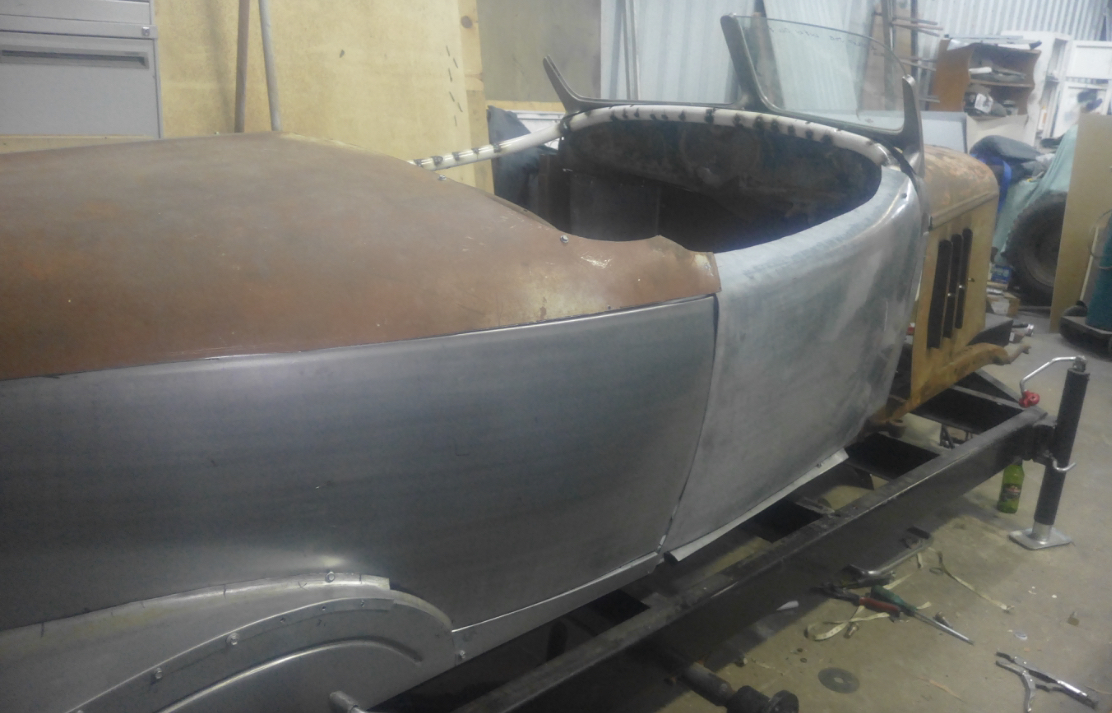

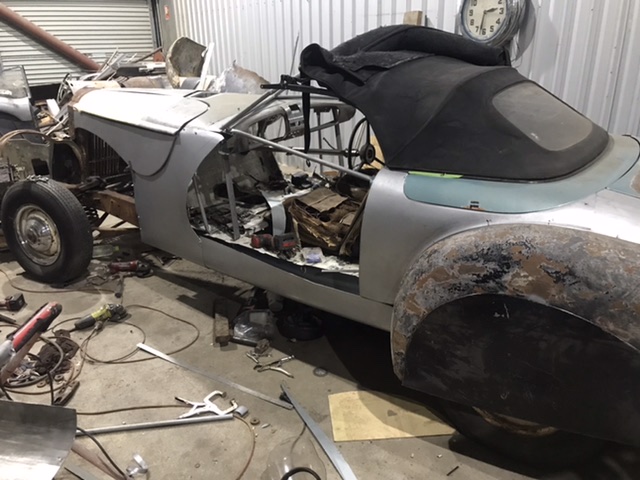

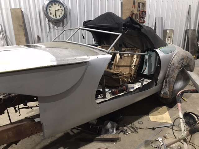

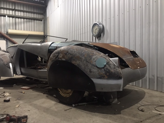

    I finally got a chance to remake the cowl sides today as I stretched the cowl another 4 inches back and laid the screen a further 5 degrees from my first iteration. It’s much better balanced now. The transition into the rolled sills was a little tricky but I’m very happy with the look. Tomorrow arvo I can roll the edges.
    Getting close to door time. 3F98C32F-CD61-4B56-A220-15D88F53523F.jpeg 1ECF7A16-A398-4BEE-B175-5F3191154EF7.jpeg CFE15B5F-F3A5-4B49-A64B-5FA26C0F3B4E.jpeg

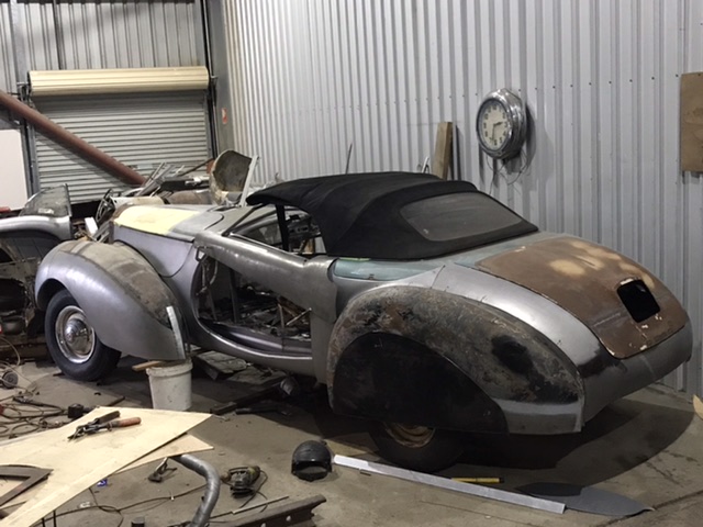

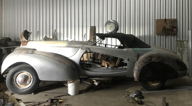

    Cowl edges stepped. I decided to roll the lower sill to give a little more drama. May need a little tweaking still. But very swoopy. 41B84305-3C44-4160-9F06-754105A3FBF1.jpeg DB836F95-20BA-4CAA-BD7A-0452580DCD9B.jpeg 26528EA2-1BA2-41D0-9C86-4380BFAC460E.jpeg 0F33D997-47D2-4654-828D-3538DDC92387.jpeg
