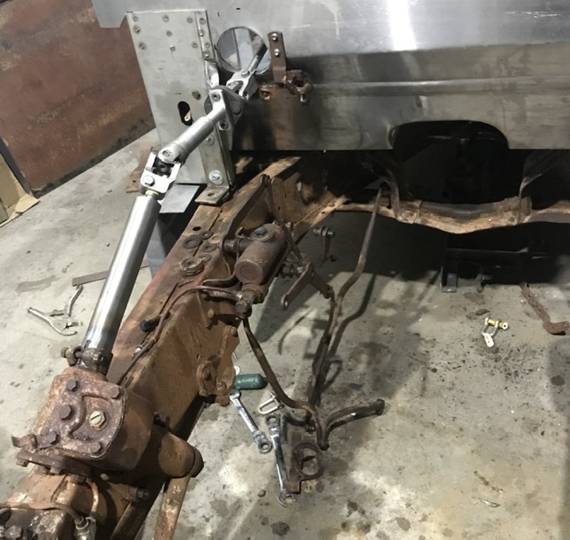

    Is there or will there be any support bearing for the steering column?

    Yes. Work in progress. Went to my bearing supplier and there is nothing off the shelf so I need to pull apart and gut a couple of other spare modern columns and turn the shaft to suit.

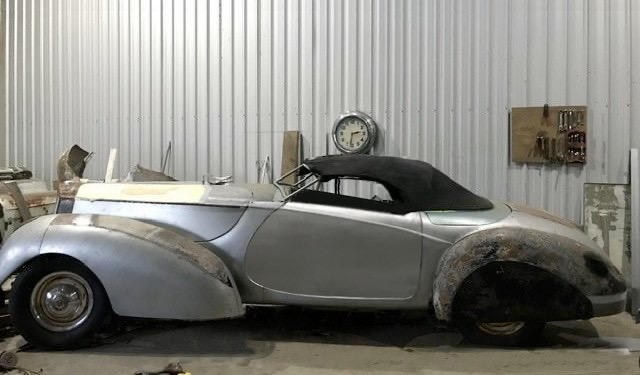

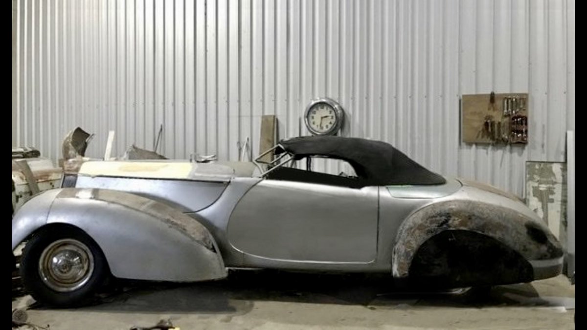

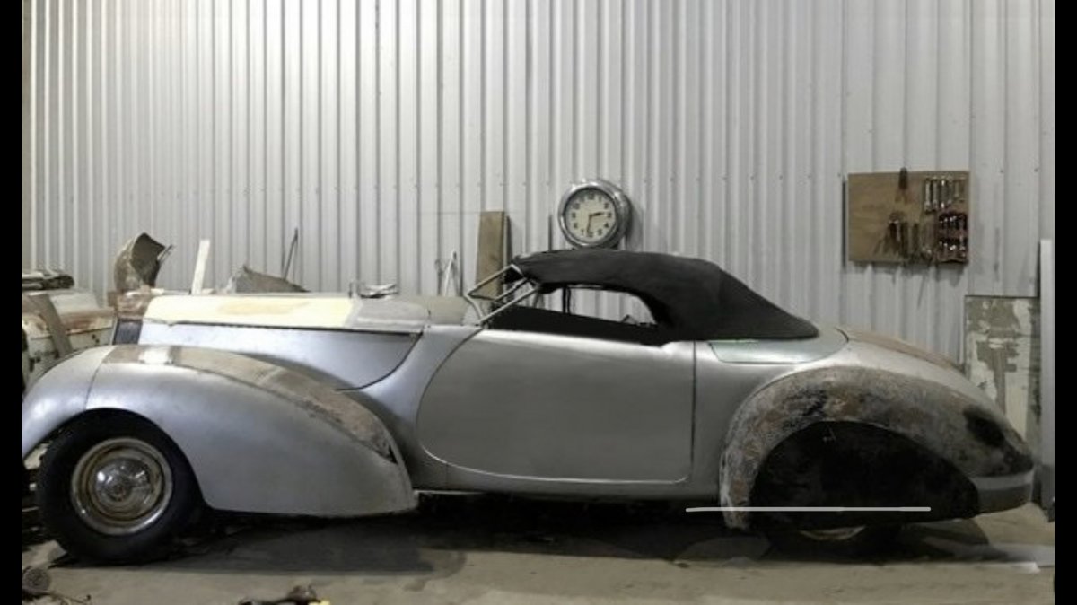

    It’s hard to believe that each morning I arrive at work I’m awaited by a such beautiful sight. It’s come together almost easily. That said it is only when you go back to the early germination of ideas you understand the enormity.
    The hulk I dragged home less than a year ago is a far cry from what sits here now.
    All along the way I’ve had input from many sources. Each line, each shape is carefully thought out and ideas debated.
    Rik Hoving , E603EA65-62BE-4DD1-9420-01260AC12B65.jpeg 5C19A307-690F-4A82-AAD7-D3DCC6E47282.jpeg 36BAEF51-3D04-4951-832B-E63152941AF9.jpeg DE66926D-AC7A-4A07-8B1C-31B420CA8052.jpeg E6EF982E-C48F-4335-B85F-0EC018EC2C51.jpeg as usual, has generously ***isted every step of the way.
    What you don’t see is the many exchanges between us.
    My messages back and forth with Rik is 500 plus exchanges.
    So here are a few Photoshop’s that we mulled over just yesterday, ideas and technical issues.
    I’d also like to thank James D and Wolf for taking me out of my comfort zone early on and taking it to another level. Those ideas have found there way onto the car.
    It has been a collaboration, is what I’m getting at.

    I'm having a hard time seeing the differences in most of the last photos. Can you describe the main variations?
  7. Weedburner 40
    Joined: Jan 26, 2006
    Posts: 1,225
    Weedburner 40
    I really like it with the detail line through the cowl and door. I also think I like it best with it going all the way to the fender. That is going to be gorgeous.

    Gday Peanut, All door variations. Swage , no swage, thick swage, thin swage, curved sill, flatter sill....
    chryslerfan55 and Peanut 1959 like this.

    CadMad
    Personally, I like the middle one best.

    gsnort
    Then, go for it. Fabulous work. You are to be congratulated.

    Dos Cincos
    Fourth picture. Body line all the way to the fender and flat bottom on door.

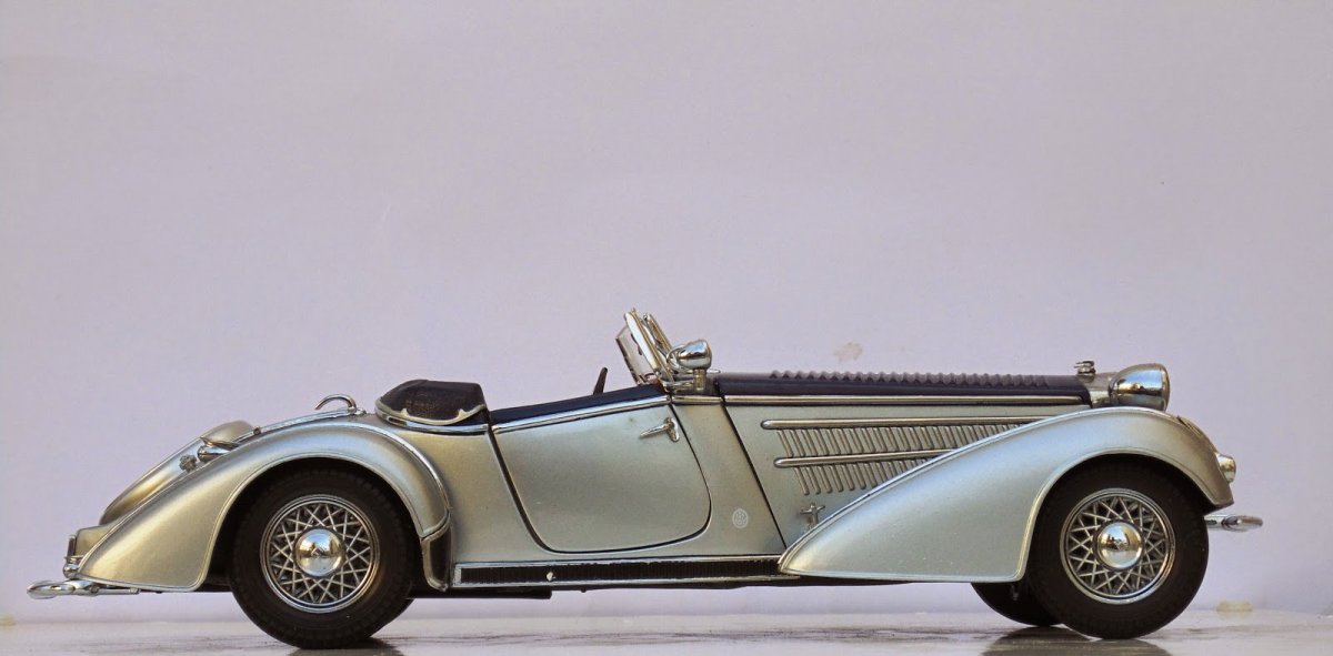

    from Denton
    This is the one I like the best. But its your party B52C13A3-79E1-4599-B0A5-6D90DC0A03D7.jpeg
    Reminds me of a 1939 Horch Cabriolet 1FA55866-656C-4E9A-8DCB-B5581343290F.jpeg

    from Denton
    Here is a side view of the 39 Horch You dont see any of these.my neighbor brought one back from Germany when he came from the Army in 55. It was OD Green E0634829-8756-4B5C-929D-61A009D4540F.jpeg
