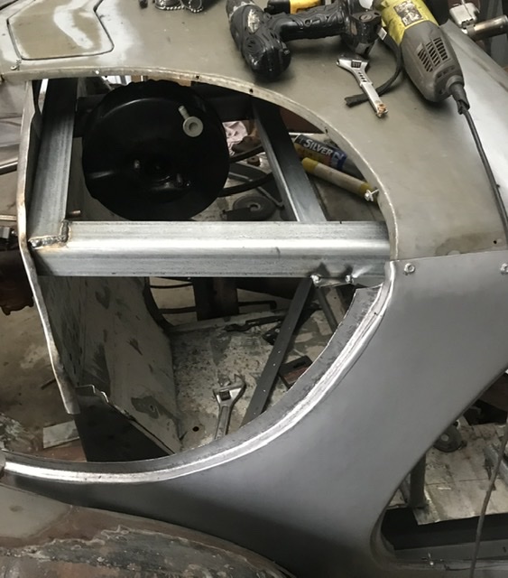

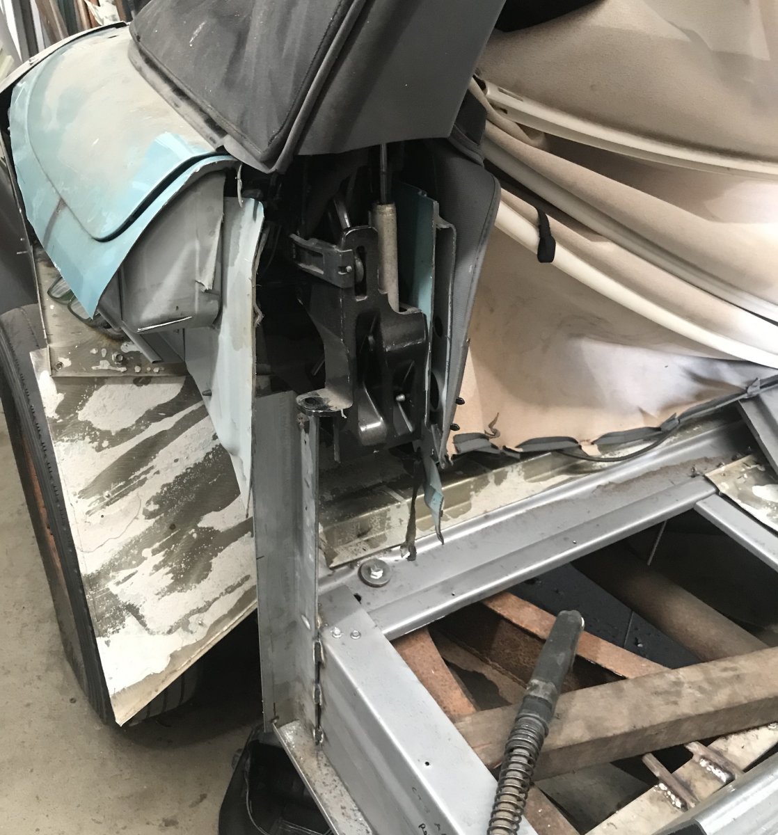

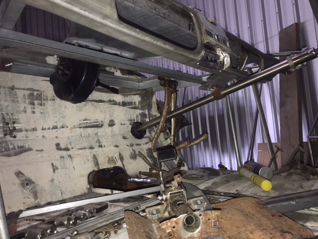

    Started bracing up the cowl which allowed me to flip the ,previously ch***is mounted pedals, upside down. Couldn’t go floor mounted because the X Member is in the way having moved the cowl back 11 inches but the pedals are right at home swinging.
    Mounted a booster far enough on the other side to allow access to the master reservoir under the hood.

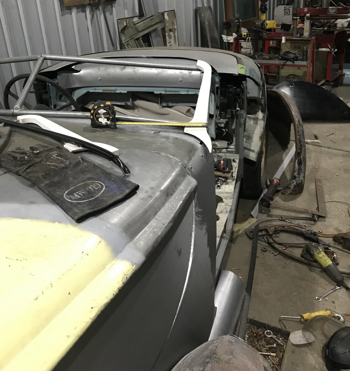

    I’ve started to brace the rear tub to the sills. An D8FB9F5F-0D5C-459C-8164-D053FA5B9E81.jpeg 0A95F023-EEBC-4354-96FC-DFD7AB19290E.jpeg 85B2D543-CC5A-46E1-A0C9-6FA2AE893B1B.jpeg issue with modern convertible roofs is that the side windows are heavily leaned. To get the cl***ic look I need to get the side gl*** more vertical which will mean modification to the folding B pillar. So I had to savagely cut away at the Saab tub structure to get some much needed room if I hope to make the gl*** more vertical.
    I was aware of it, but it was highlighted when I began mocking up my windshield and a inward leaning A pillar looks terrible.

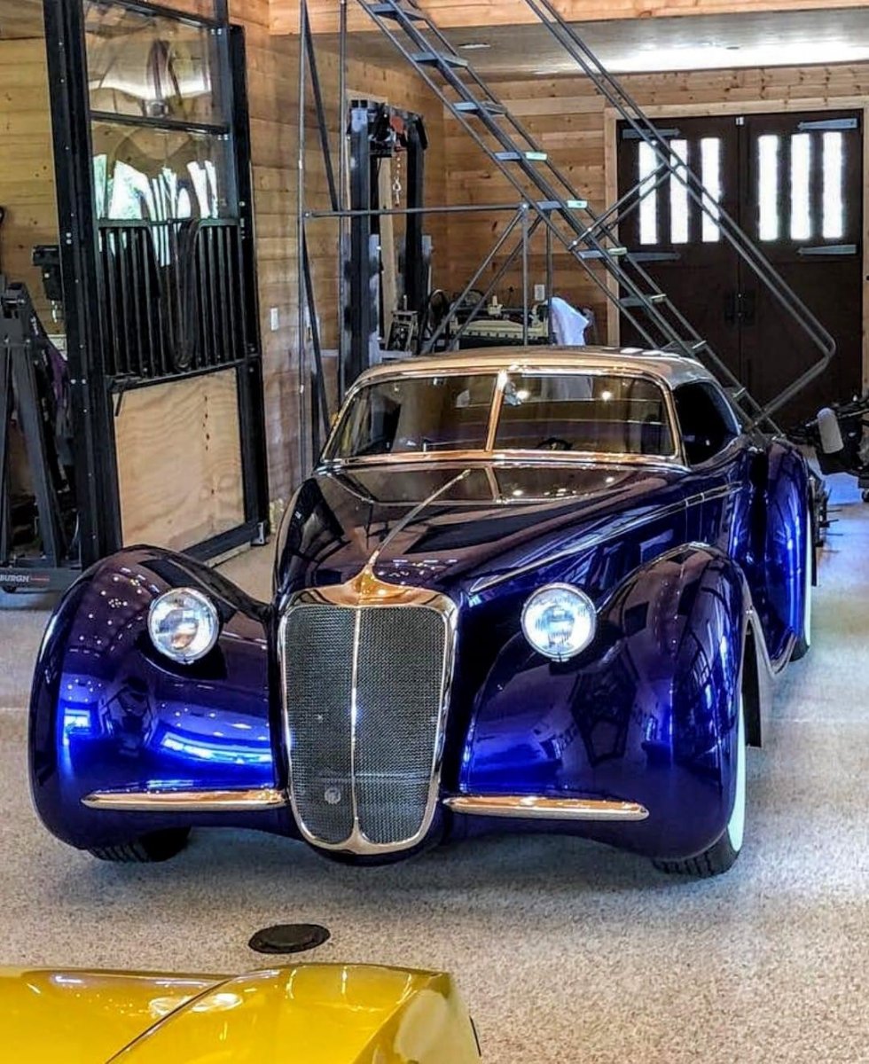

  12. 1-SHOT
    Joined: Sep 23, 2014
    Posts: 2,944
    1-SHOT
    from Denton
  13. CadMad
    Joined: Oct 20, 2012
    Posts: 886
    CadMad
    I think it is one of Luc DeLay’s builds for the Metallica frontman. Don’t get me wrong, it’s yet another stunning one off creation .... but not the look I want. I also suspect that the raked sides would preclude rolldown sidegl*** as there isn’t enough body shape in the door.

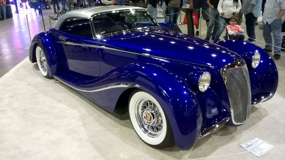

  16. Saw that blue car @ GNRS in 2018, that isn't James Hetfield's.
    A few more angles, I agree the top of the windscreen angles in too far. The rear and side profile looks good though.
    WP_20180126_14_53_43_Pro.jpg WP_20180126_14_54_11_Pro.jpg WP_20180127_12_53_27_Pro.jpg
    This is James Hetfield's

    The windshield on the blue car reminds me of an MGB.

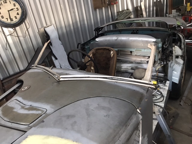

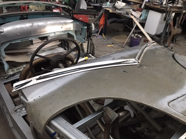

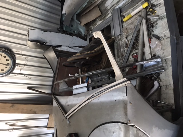

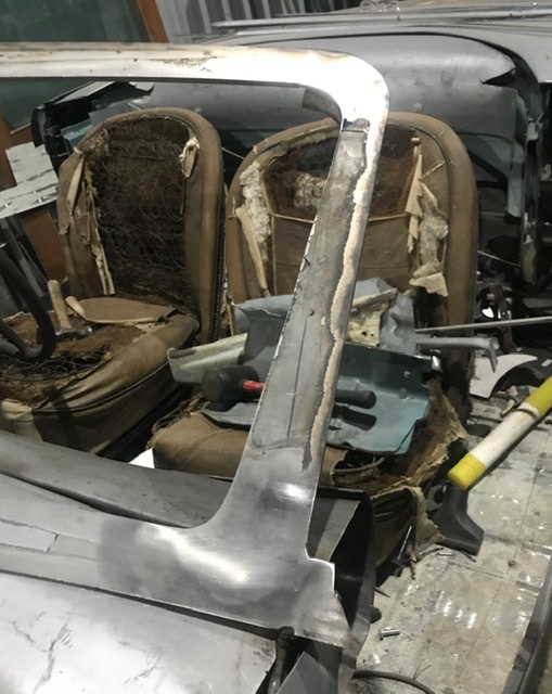

    Saturday is play day. So I started on the windscreen frame. Started with 65x65x6 mm stainless angle and several cutting disks later I’ve gotA pillars . I can’t believe the cowl pieces are from a laser cut piece of offcut I found at the s**** yard. Absolutely perfect radius for the cowl. Another day of cutting and I should have the central post made. D11189BA-4F5A-41E5-9FBF-D2129C3DC271.jpeg A998C3CC-CF95-40D7-A7DD-8CA37DCE6E0E.jpeg E6DD9C9D-41B3-4487-9765-BE84143CEEE9.jpeg B6A2F04C-E2DF-45B5-B066-FBB2426FC9DE.jpeg 94F40EDA-4A75-49D8-ADE2-D1582D74CBE4.jpeg
    mvee33, mgtstumpy, ClarkH and 9 others like this.

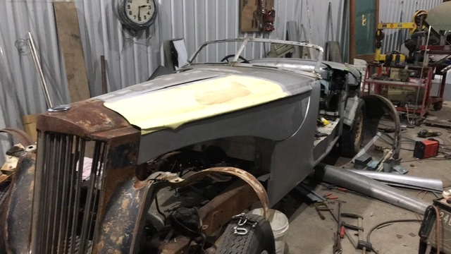

    Was at the house of Cad the other day and as on ground reporter, I can verify that it's all looking very good. Camera shots are a bit fish eyeish, but in the flesh it's very long and sleek. The roof will be a challenge, but hey, something has to be. Personally, I can't wait for the doors.

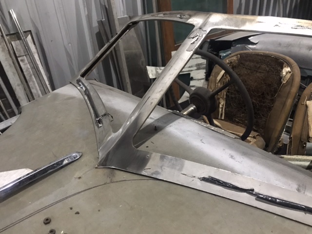

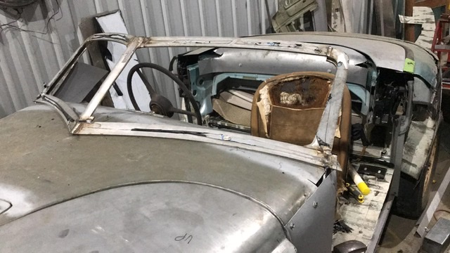

    Windscreen frame fabricated and half welded up. 2F9875B6-7038-4154-A080-D02E718D1090.jpeg 3E9A31E7-E163-4EA9-B5AA-E0BAA848A70E.jpeg E5C1EBED-ED03-4E78-BA9B-E5BEC0C62125.jpeg 2485AEC5-292A-414A-B366-16337171087D.jpeg 2368169F-445F-4395-95C3-C7559EC5079C.jpeg

    I'm really loving the windshield frame, I'd like to build one myself. I would be very interested in the details of how your gl*** will fit into it.

    I cut the A pillar out of angle stock 65x65x6 mm. The curved horizontal bits are 45x6 mm that I found Pre cut by laser at the s**** yard and by some kind of miracle they were the perfect radius.
    The outside frame will be fully welded but the inner centre pillar and inner top sections will get welded together like a T and get screwed in place. So I can get the gl*** in.
    The mirror stalk can be one of the fixing points as can the top latches. The frame is very rigid already. I will make a ss u channel to hold a weather strip for the A pillar to seal against the door gl***. .... but that’s another adventure ahead.
    The header bar will be one piece in a V shape.
    chryslerfan55, brEad, 40two and 3 others like this.

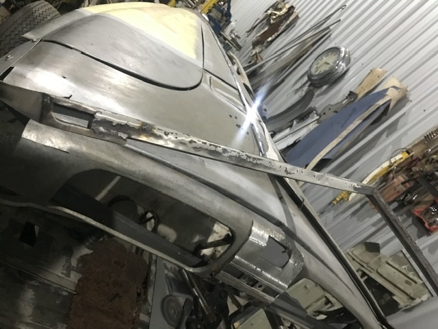

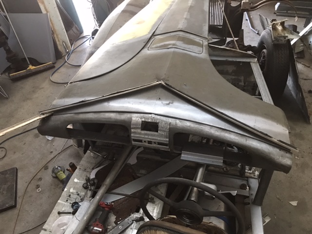

    3CAED2EA-47CC-490E-8277-8C15A5C5795F.jpeg 4F9FAF36-8F1E-4410-8D76-7CEF4FEA9CBE.jpeg 1576B1E7-D842-4CAB-BB28-38BB678093AD.jpeg My mate brought his tig over so this afternoon I dressed up the welds and refined the details. Welded in the header top rail and it is true and solid as a rock. Tomorrow I’ll do the lower channel and the inside face.
