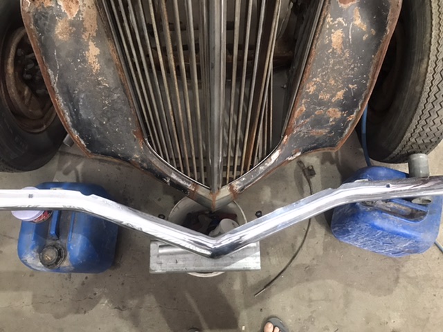

    CadMad

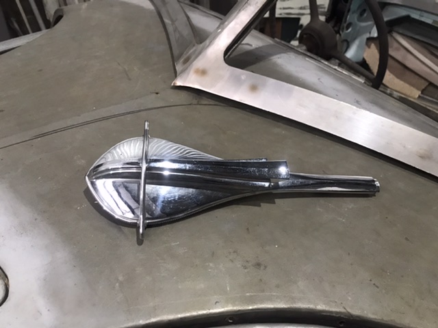

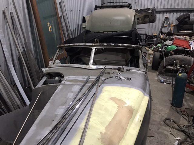

    Here’s the Jag Mk9 br*** hood trim I got E0EDF7F3-6263-4CC4-90C5-5FBBEA76EC6D.jpeg yesterday for free and the approximate position it will sit. It’s a nearly perfect match in profile for the NOS 39 Packard grill ornament that I scored on ebay.... but it’s yet to arrive after a month or more..... hopefully it will turn up this week.

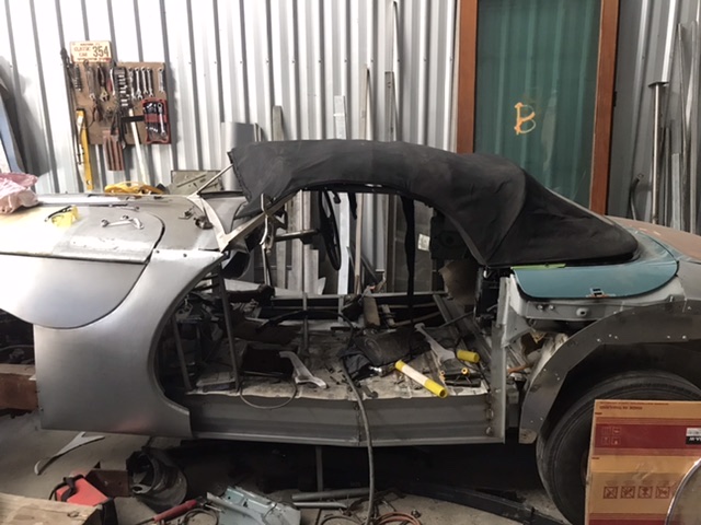

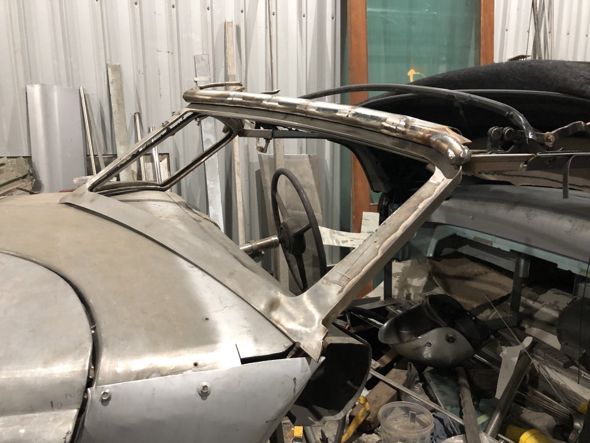

    CadMad

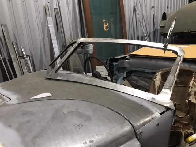

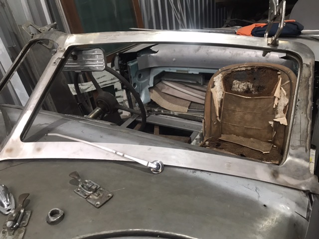

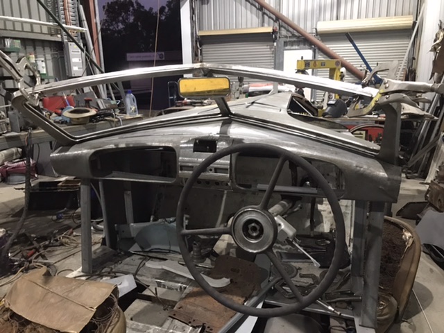

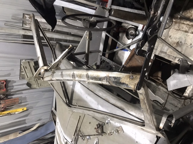

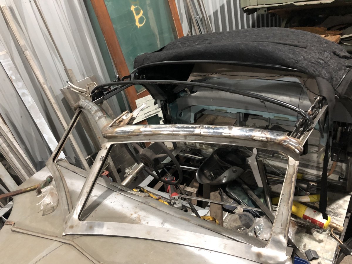

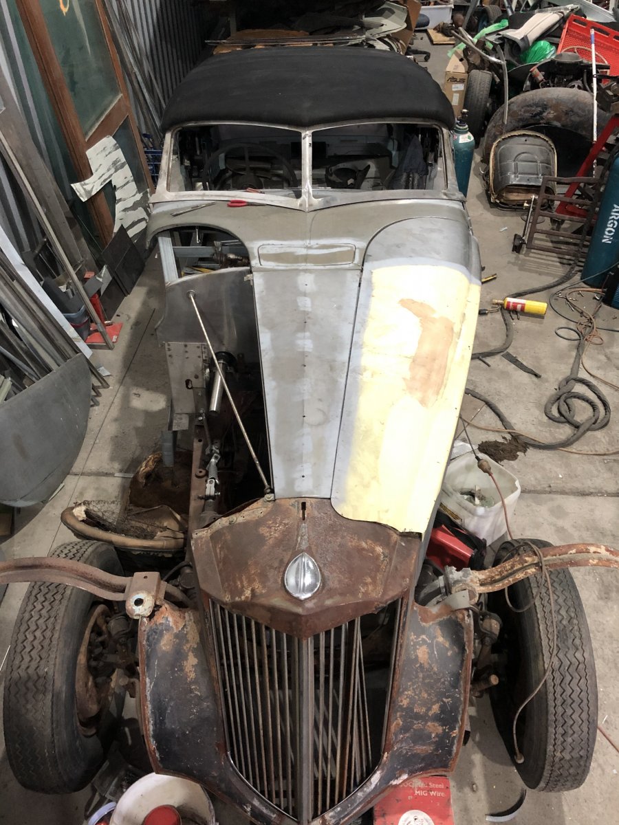

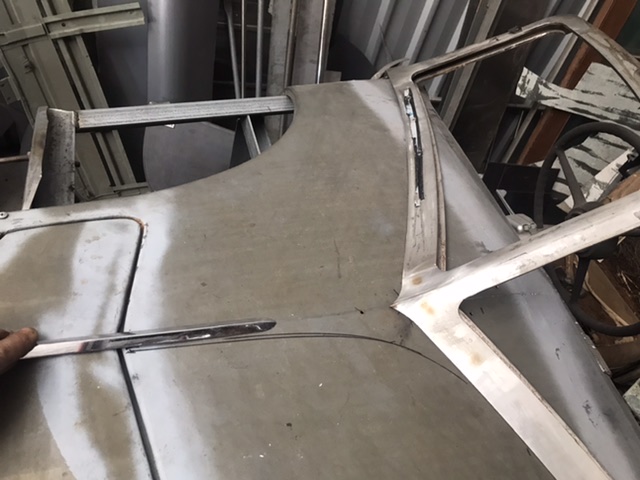

    Rolled up the inner TT section for the windscreen frame. Welded it up and it looks and feels right. I can’t finish the side lower corners till I get the exact body shape finalised. But I’m very happy with the result. I couldn’t resist tapping the mirror stall hole. I forgot how hard Stainless is, it took me half an hour of gently back and forth on the 5/16 tap. 1C91FFB5-53D4-4E70-B463-D6A629104EC6.jpeg F993252A-9048-4445-9E0F-99962BA6FECC.jpeg 351BE689-1055-4BB8-8615-8758E8A7EE99.jpeg 27C1AC64-AEA5-4D02-B35B-B5026FCDC487.jpeg 2C64F96D-5FF5-495A-BC0D-9B61EBE45DE0.jpeg

    from Denton
    TIG filler 309L filler for stainless is extremely hard to drill or tap. It works extremely well on cast iron repair but is extremely hard. If you try to drill it to fast you will burn up the drill bit the heat hardens it. I use a carbide tips drill and you can only turn a tap 1/4 turn at a time. Frank
  5. 296moon
    Joined: Oct 24, 2007
    Posts: 654
    296moon
    from england

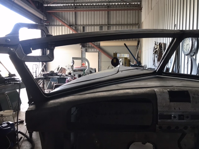

    Loveing that view through the screen

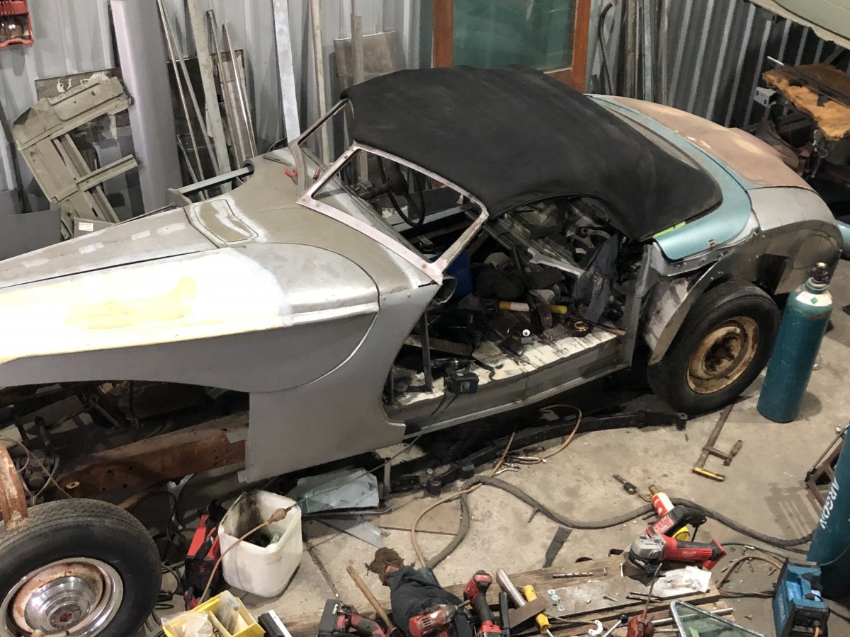

  6. CadMad
    Joined: Oct 20, 2012
    Posts: 886
    CadMad

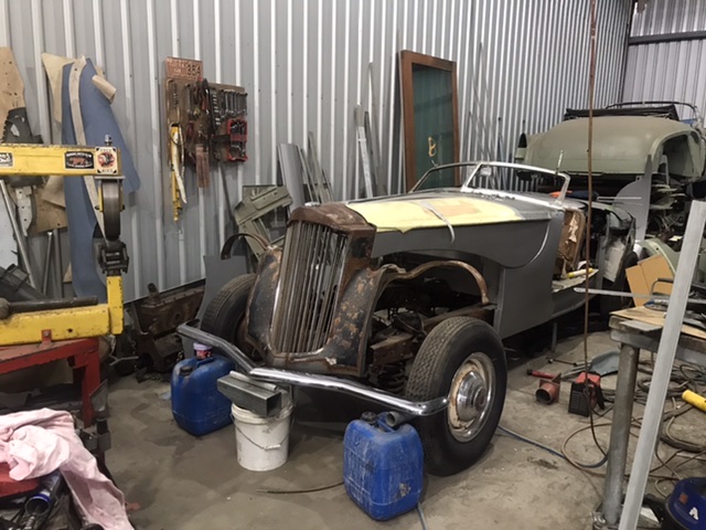

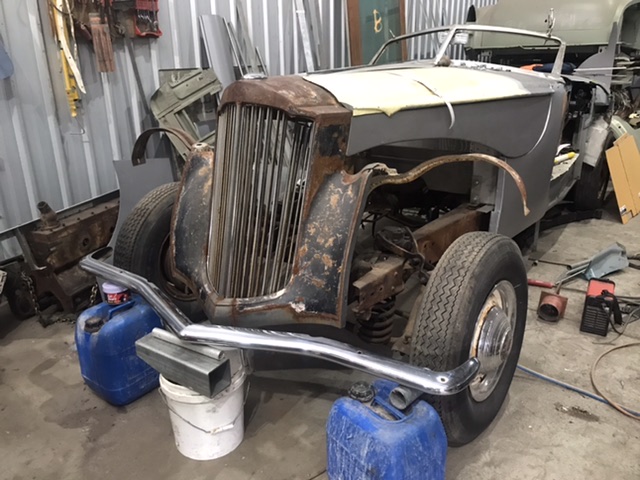

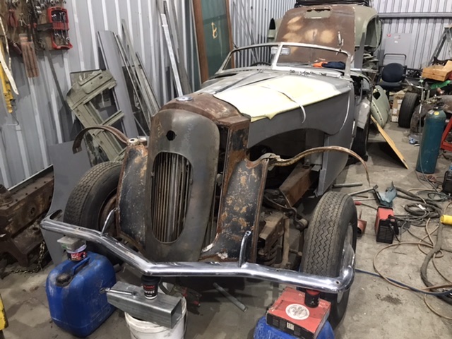

    1111F7CE-3AB1-49AE-930F-75491828BD46.jpeg 1111F7CE-3AB1-49AE-930F-75491828BD46.jpeg C22847E8-D25C-4DA6-B434-829DFC1DE881.jpeg A99991A7-14AB-4D1C-BD8B-8C49427E1D52.jpeg A031A6BC-14AD-4441-B125-DD32CBF80A00.jpeg 0919380C-62D3-48C6-9B55-90E327343A84.jpeg The key to making progress.... is to keep at it... everyday.... Sunday and I trial fitted a bumper I found on Marketplace. I haggled hard and got it cheap enough that it can sit on the wall if I change my mind. But I think I can make it work. End corners might have to go. You can try and guess what it is. But I like the minimalism compared to th 898A1791-9798-4F19-B023-CEAD6B5E8F38.jpeg e railroad cowplow original.

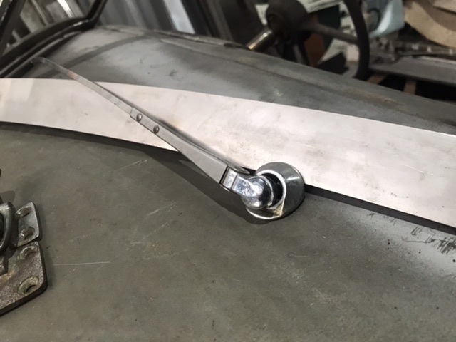

    Also my daughter discovered my NOS 39 hood ornament arrived two weeks prior but no one bothered to tell me.... so my worry was in vain. Found some 40s Packard wipers and Escutcheons in my parts box that should also work perfectly.

  7. junkers72
    Joined: Sep 21, 2014
    Posts: 51
    junkers72
    1965 Chevy full size car front bumper bar ?
  8. CadMad
    Posts: 886
    CadMad
    Wrong. But correct brand.
    kidcampbell71 likes this.
  9. Shadow Creek
    Joined: May 14, 2014
    Posts: 309
    Shadow Creek
    Bumper looks like 2nd gen Camaro.. it fits the Packard well, I like it
  10. brEad
    Joined: Dec 23, 2016
    Posts: 2,039
    brEad
    Early gen 2 camaro?
  11. X38
    Joined: Feb 27, 2005
    Posts: 17,498
    X38
    It is 2nd gen Camaro.
    Windshield turned out real good.
  12. CadMad
    Posts: 886
    CadMad

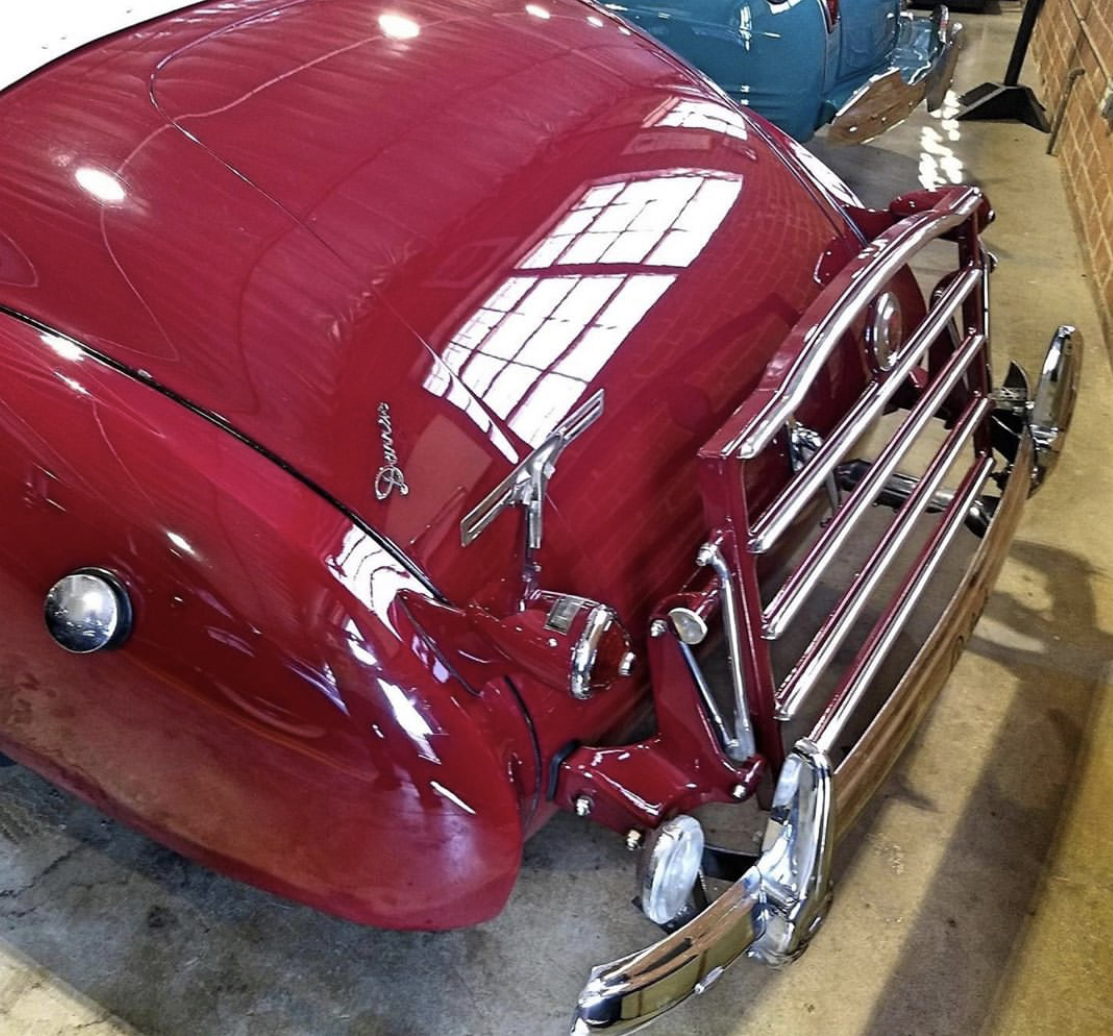

  17. CadMad
    Posts: 886
    CadMad
    It’s a Duesenberg!!!!

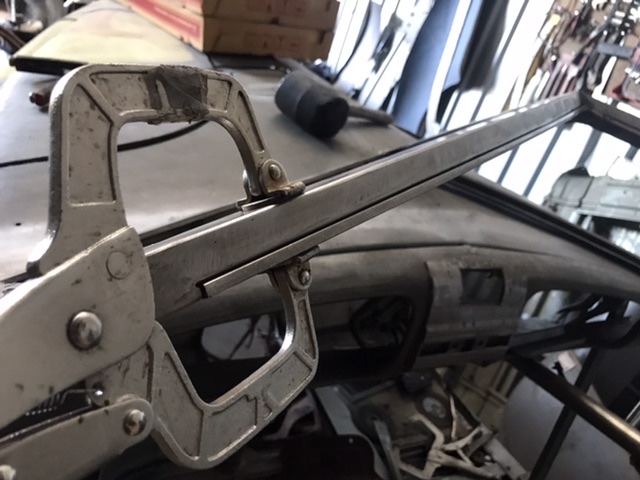

    B9870534-71AE-4D64-9DD7-1F080AE28C19.jpeg 196FF3B3-C7CE-4DD5-98BC-9CDD31718F41.jpeg C6718D06-D40C-409A-8E83-3C8B6DD6F47C.jpeg Made up a header out of stainless oval tube and some angle. Tig ed it up and can’t wait to have a play with the roof mech soon. The header emulates the front bumper with a little prow on the nose. Can’t wait to pull the roof fabric tight.

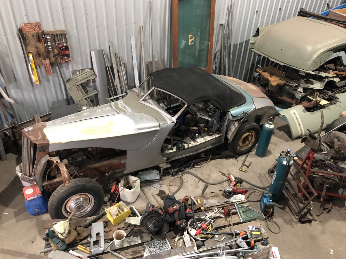

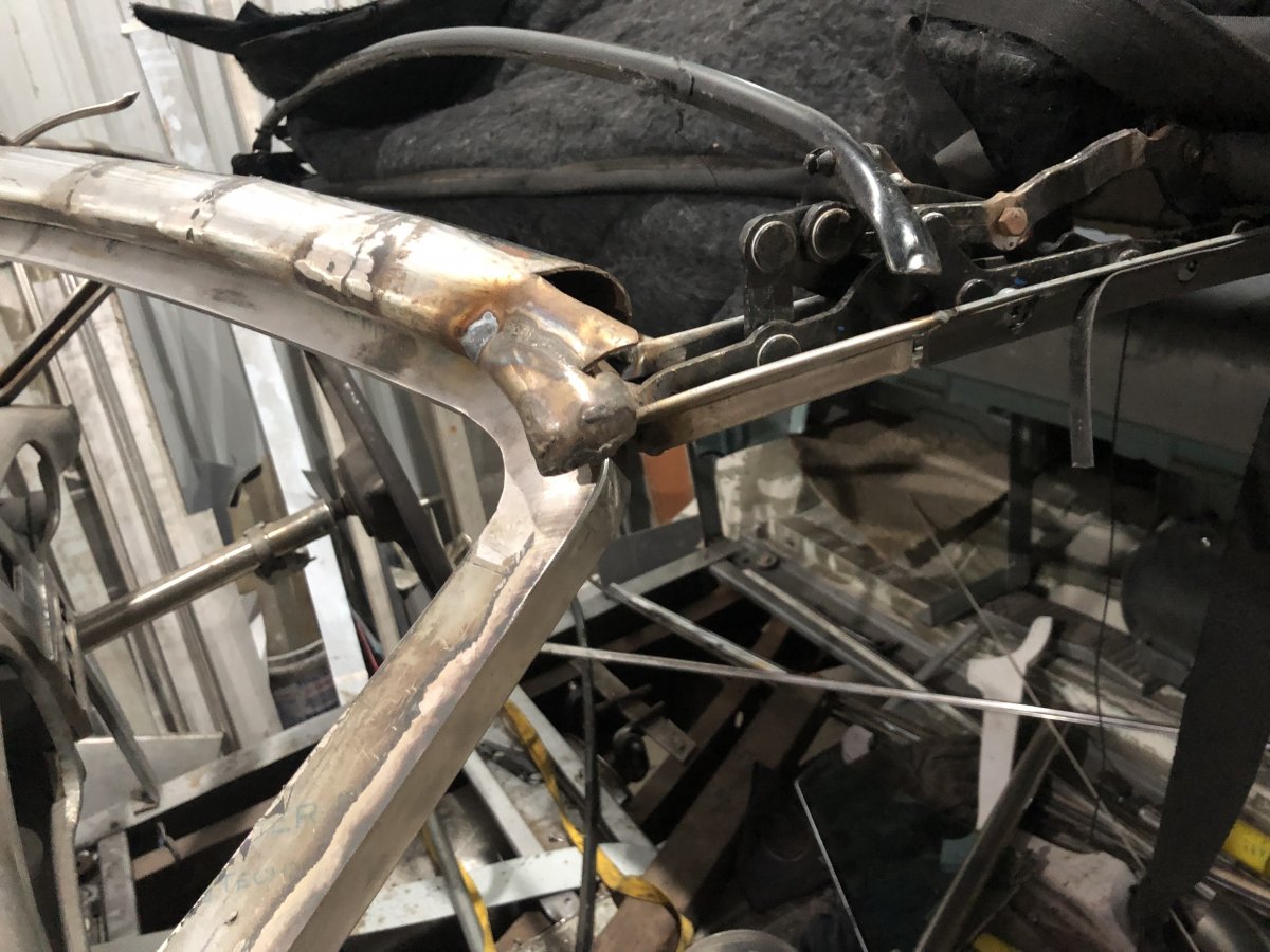

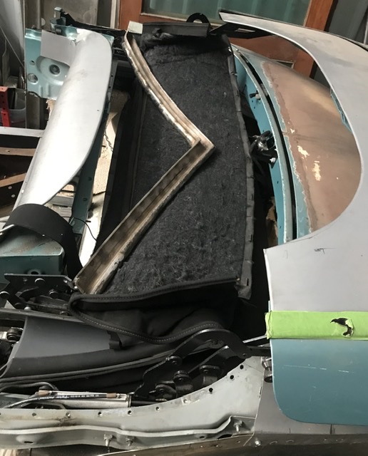

    I’ve been nervously anticipating mating the header to the top frame. In my head it worked but cutting and shutting the length down and changing the arm configuration and getting it to all fold away and not bunch up was the cause of many sleepless nights.
    But early this morning I finally tracked it all together and did a trial run. Perfection. 046A983D-2A3B-4550-B078-3474BF726536.jpeg 7EBF9300-DC94-4406-A002-8774D5AD2DD3.jpeg 45C8EE06-FC63-474B-A8AE-5E0C5C01C830.jpeg

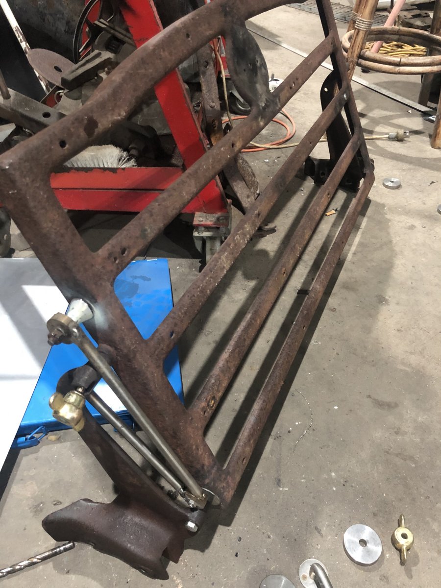

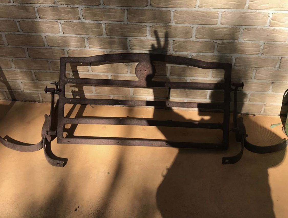

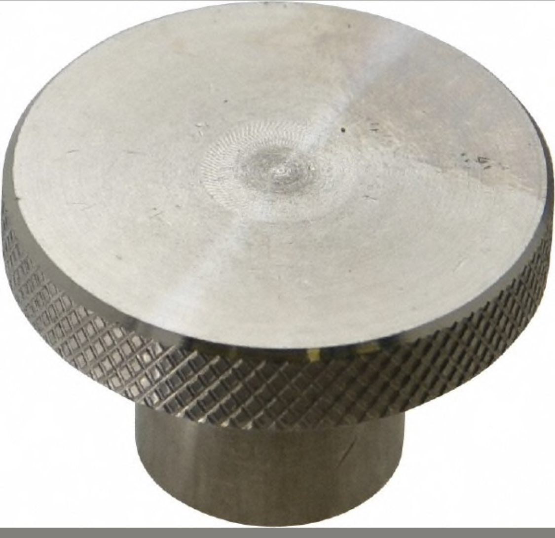

    E5937147-500A-4038-8A31-EBA05971AE91.jpeg 0A2C0C34-0ABA-4A94-AD92-A3AE094B83EF.jpeg Scored this a few months ago in Maryborough which is 3 hrs away. Hadn’t had an opportunity to collect it until my mate Dave said he was there on the weekend.
    Not sure if I’ll use it but C48BAA82-AB59-45B7-9DD2-6658E7D22619.jpeg may as well restore it.
    Missing the arms but I can fabricate them in stainless. Already found a replacement for the knurled knobs.

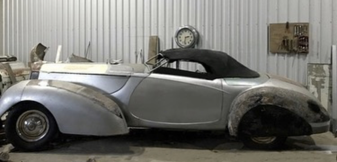

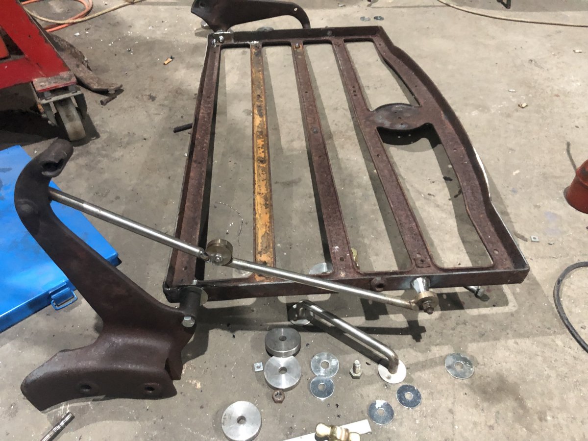

    Been busy working on my mates 53 Eldo. But last night I made up a pair of arms for the trunk rack out of stainless.
    The Figoni Falaschi roadster has round door sills. D3DAB051-BB19-4301-8A12-9559EBB237D5.jpeg 22D4136B-E0C1-4EAE-A015-DD2C98D86712.jpeg F7A267CB-89B8-4DFF-B59E-851360289C94.jpeg 65724179-1048-4B6A-BAC8-F2A71DC275E7.jpeg

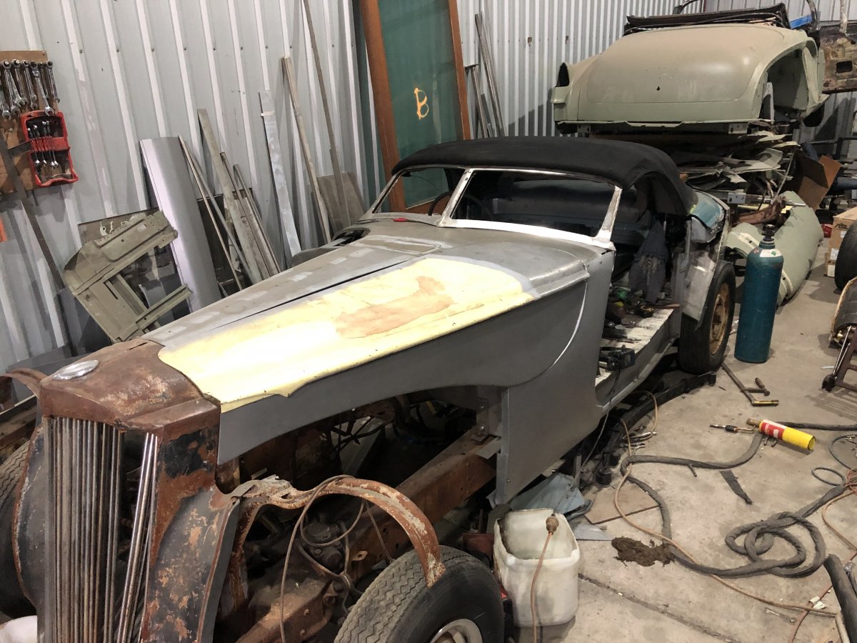

    3E587304-F03A-4660-8615-0A7CCC037B6D.jpeg 54493616-C077-4874-A874-C6504B2881B5.jpeg C55749F6-2A51-4F55-8910-27F54F4B3276.jpeg B322FF88-954F-4B47-8874-2CE47CA553FB.jpeg Finally the roof fabric got stretched over the header and I locked the roof down.
