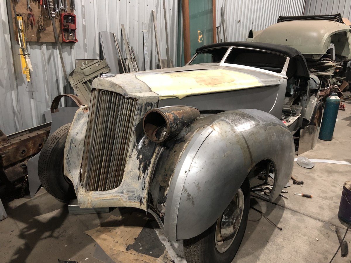

  2. CadMad
    Joined: Oct 20, 2012
    Posts: 886
    CadMad
  3. brEad
    Joined: Dec 23, 2016
    Posts: 2,039
    brEad
    Roofline looks great!

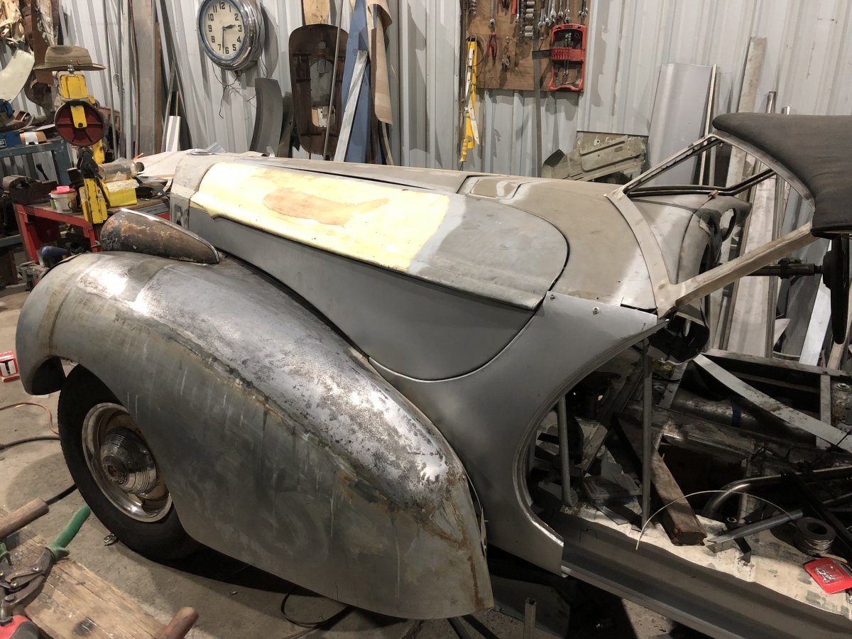

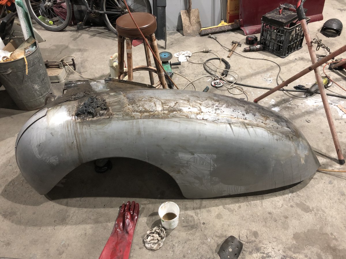

  7. CadMad
    Posts: 886
    CadMad

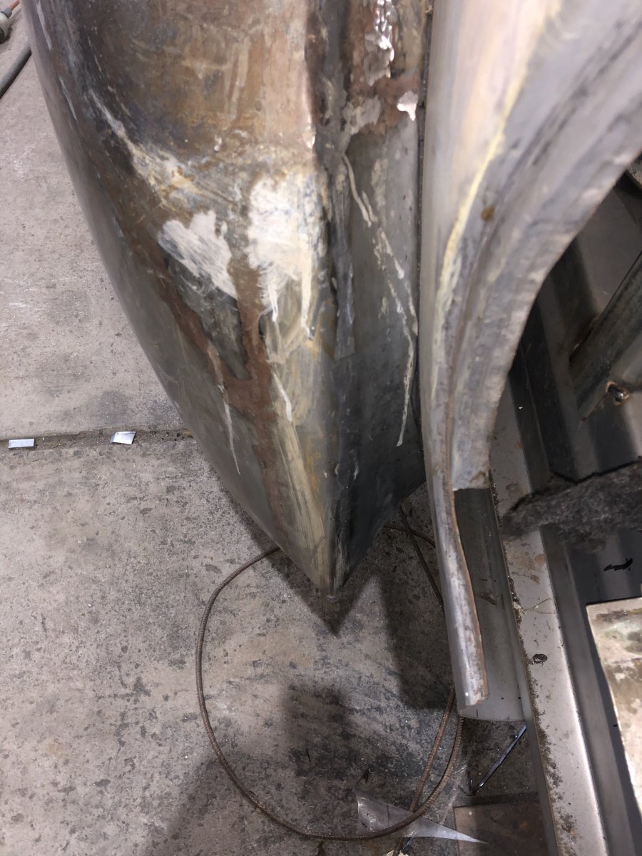

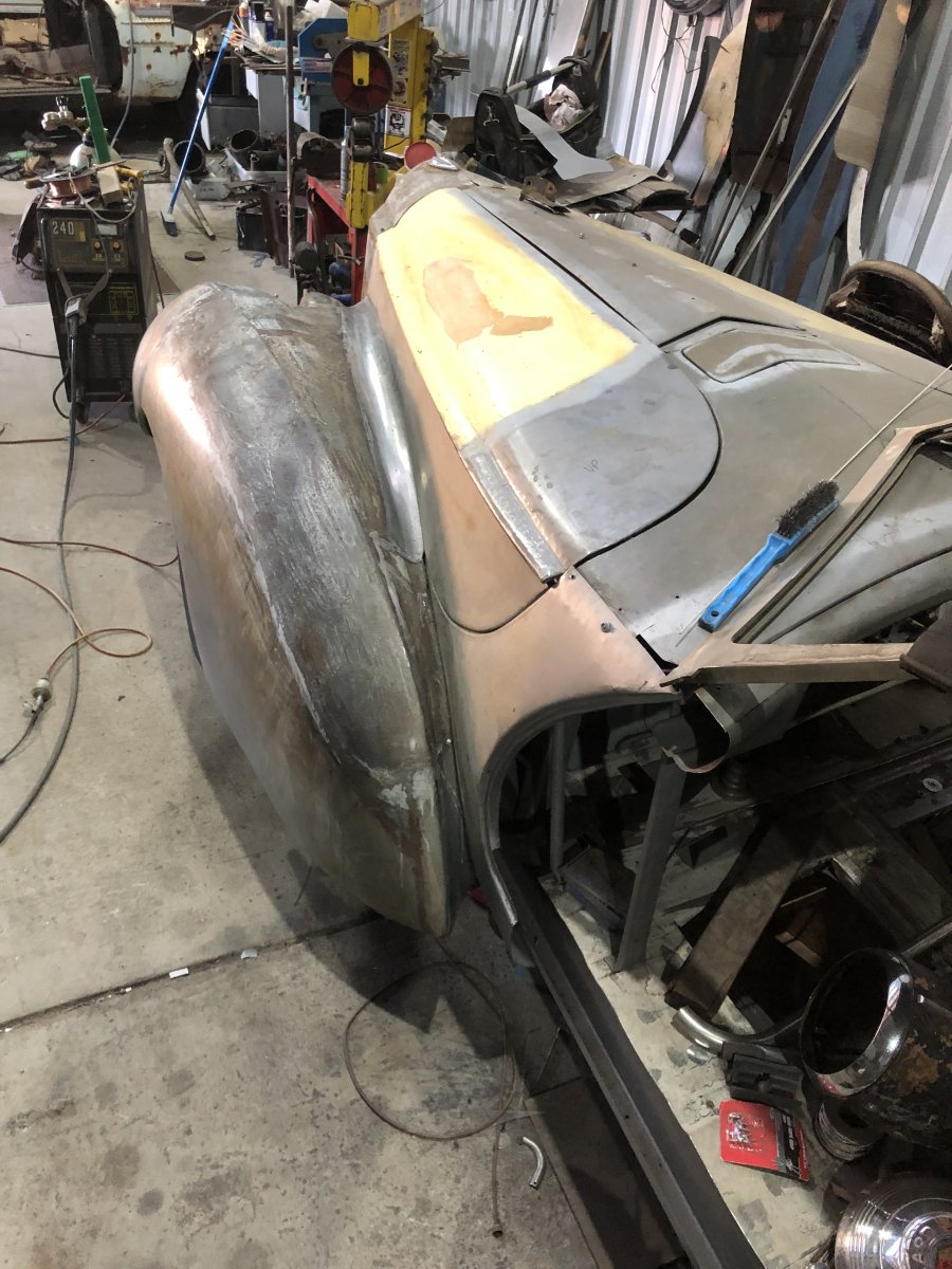

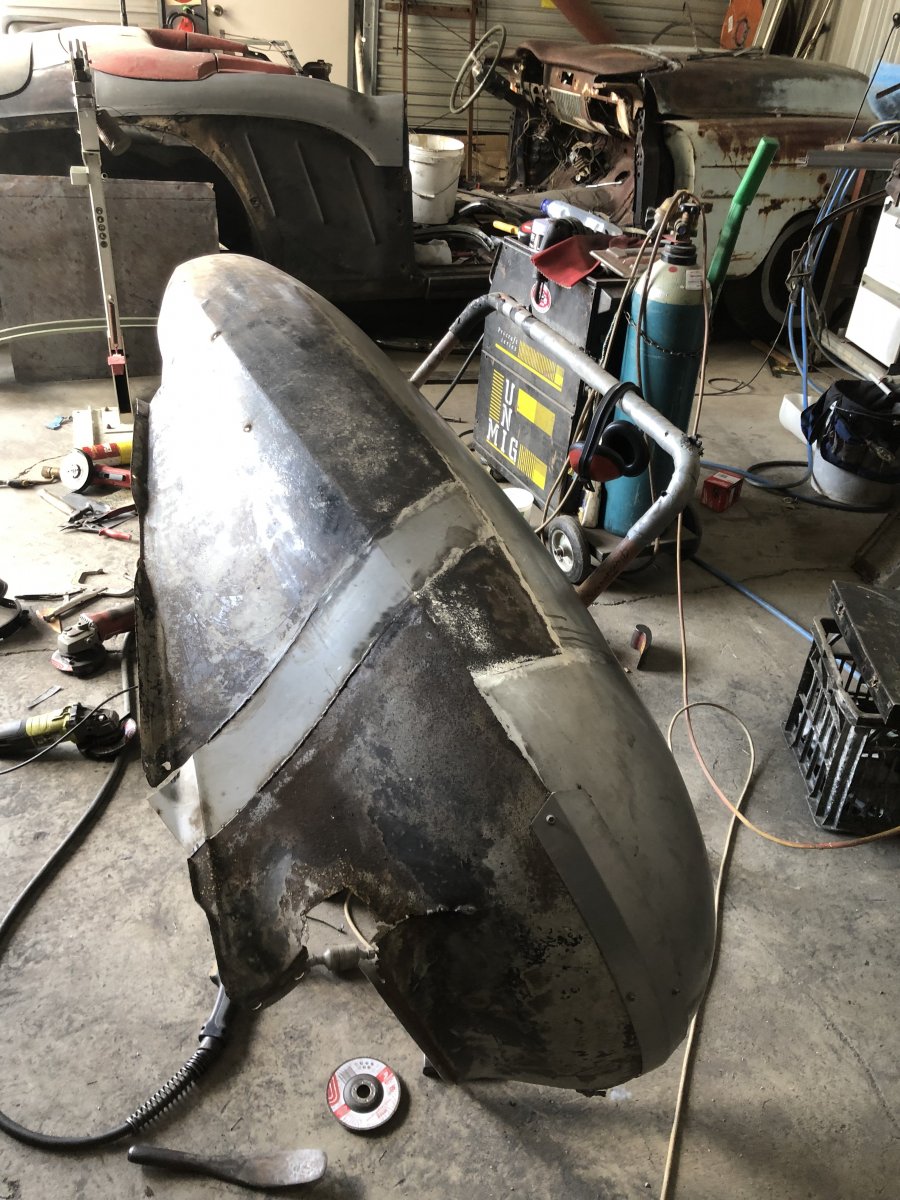

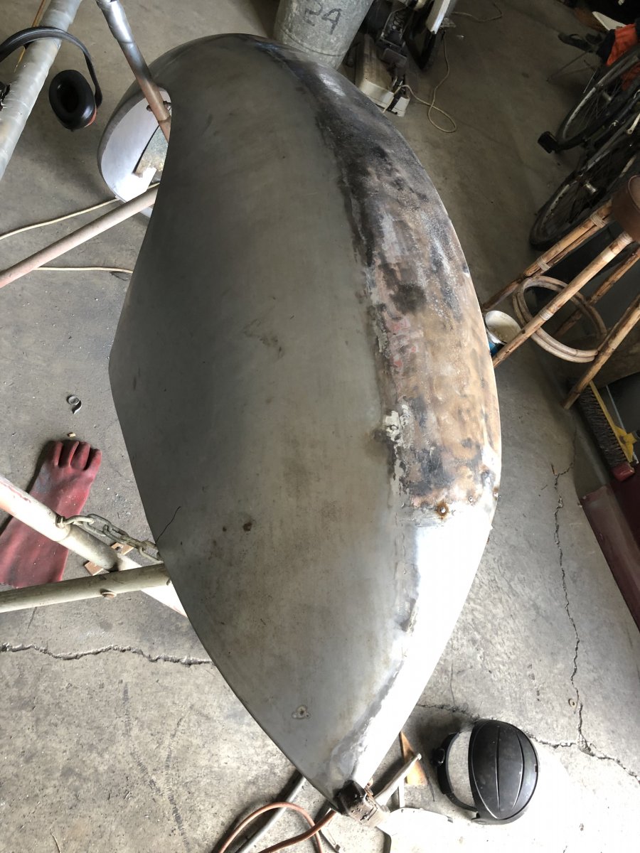

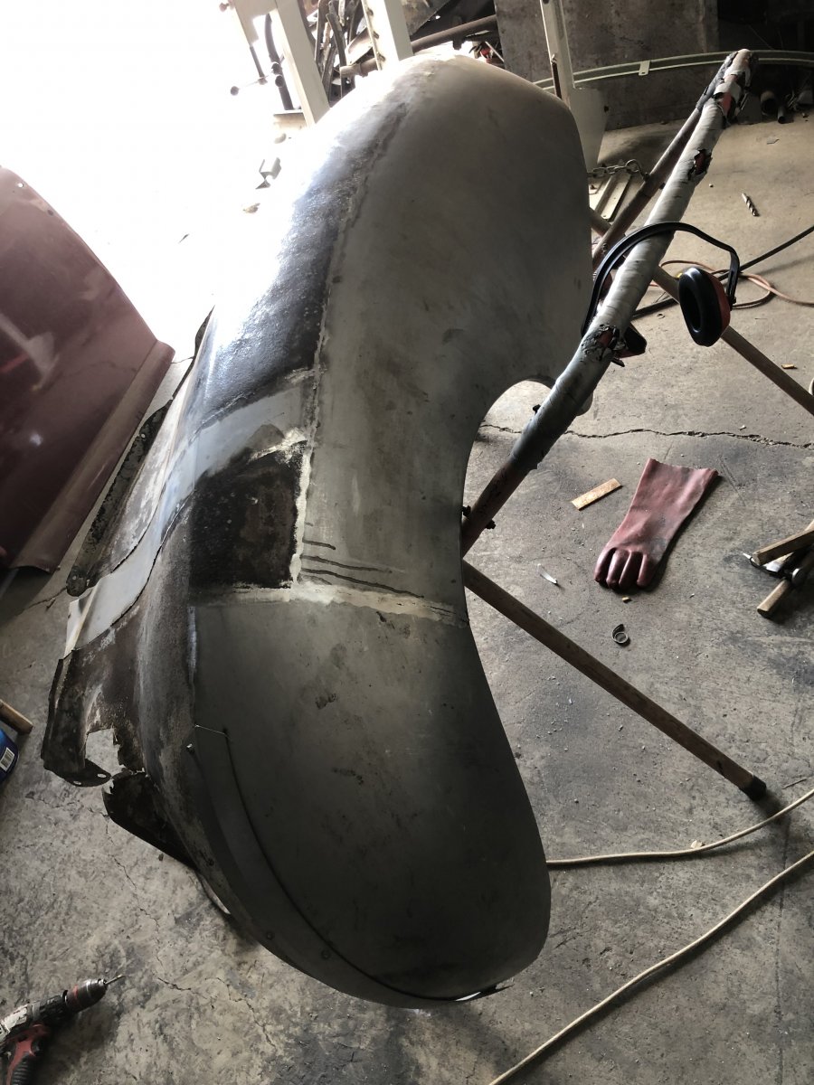

    253168D8-D327-4994-888E-A5E3245A4D2C.jpeg 89C45BEA-6238-4193-824D-14AF3E1F0F2C.jpeg 9C62C08B-9D3A-438A-8993-5F54FAF0E3E1.jpeg 069F0885-2897-422B-BA6C-EB28F44CAE08.jpeg Before locking in the sills I decided I need to finish off the front fender. I’ve stretched them 4 inches and changed the flow of the rear. But the original top section was still a rusty mess. I probably could have replaced the original metal but decided to spend a couple of hours welding the pits and then hit it with rust converter and was surprised at how nice it’s coming up. The surface rust was impenetrable with a wire wheel or grinder but a couple of hours of phosphoric and the shiny bare metal is starting to shine through.
    A couple of p***es through the English wheel this morning and I can put it back on the car and lock it all in.

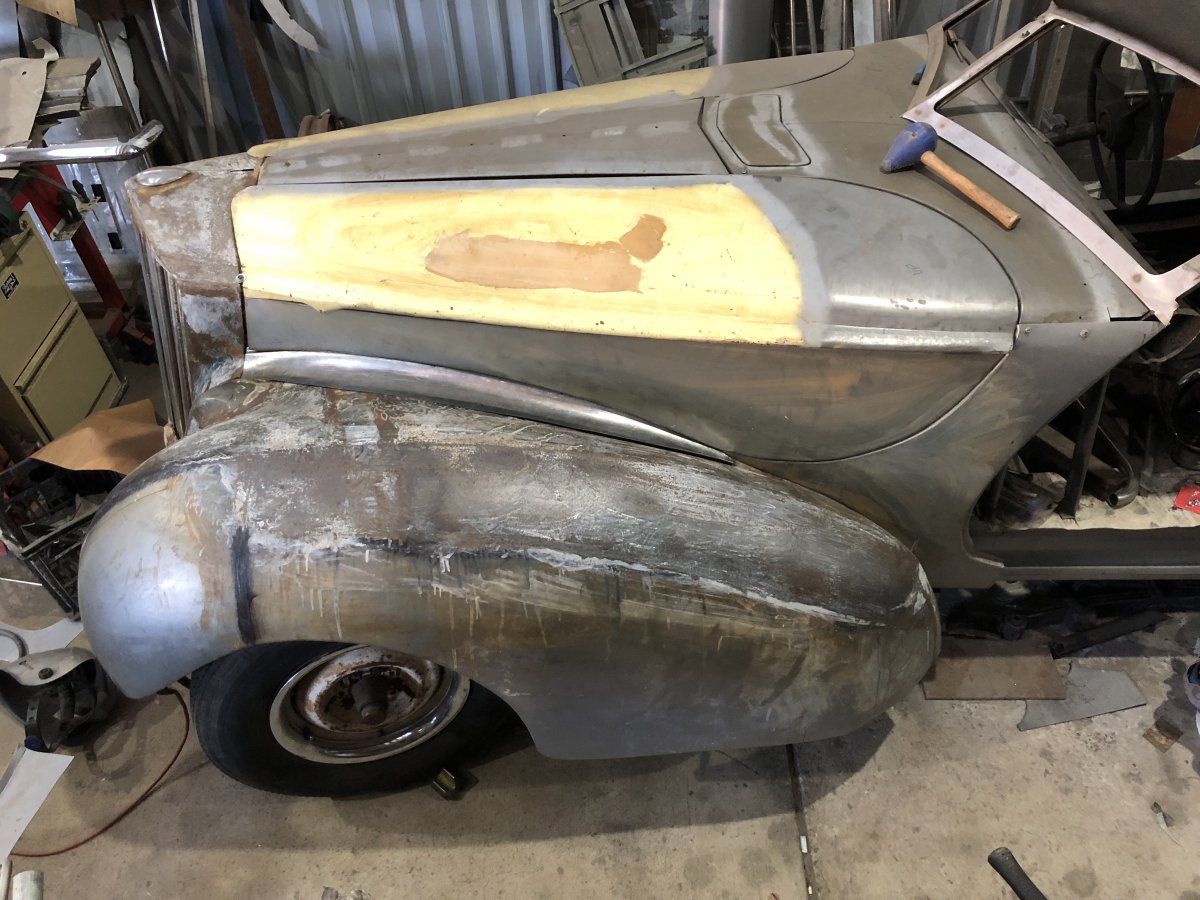

  8. CadMad
    Posts: 886
    CadMad

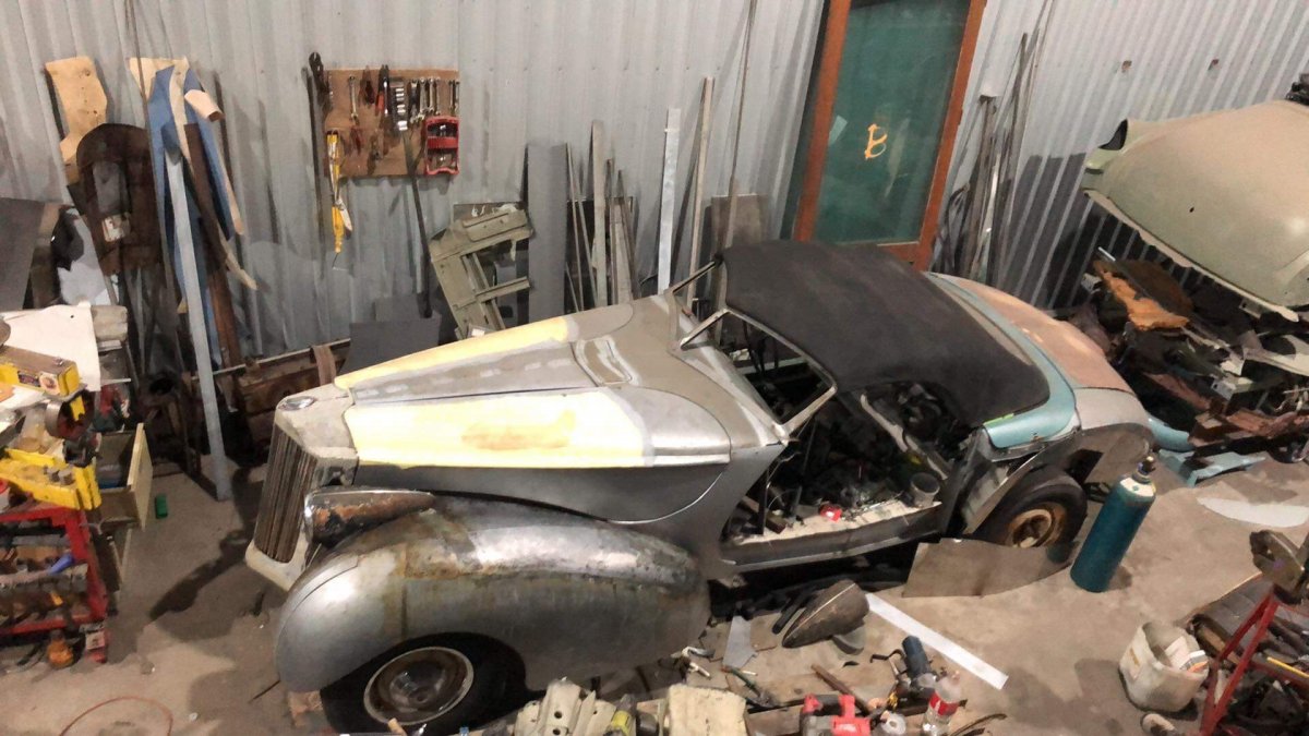

    47A94AA5-59F8-435F-BE2C-F5387101E209.jpeg 0332A6C1-B1C2-49E2-B58E-CE828E623350.jpeg 9FBF9203-B98B-44E1-B43E-84218AD69B9E.jpeg EC773393-B8D9-4FB4-80A0-418338C9CE22.jpeg BC1B5ADB-0651-430D-865E-47406DD406C9.jpeg What a difference a guard makes.

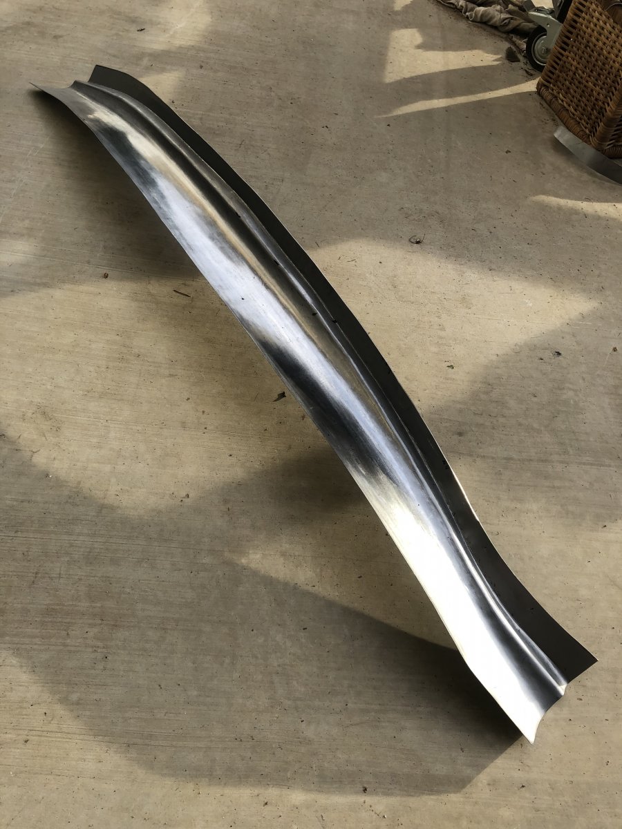

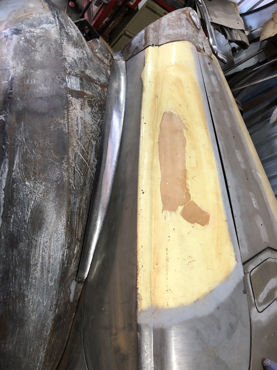

    FC20603C-FCD6-4208-B518-8D7153AF9025.jpeg 29C4D311-B574-4437-A043-68F702EDF69C.jpeg 59A6BC83-A81A-43EE-973B-DCF1650B9119.jpeg [​IMG]This little ******* nearly beat me. A compound reverse roll will a stepped edge to accomodate the hood side. 7 hrs solid!!!! To get the stepped edge I ran it thru the bead roller then I had to English wheel the little reverse curve . But it was a bear. The roll would go nice and then pull the gap for the hood. Back and forth, back and forth. I’m knackered. But it’s fitting perfectly. I won’t do any more till I decide on a locking mechanism.....

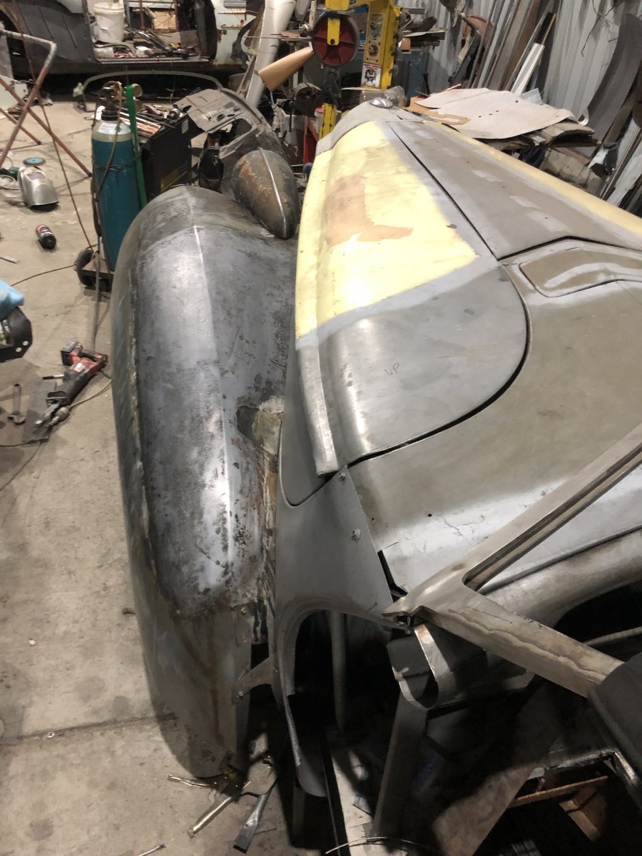

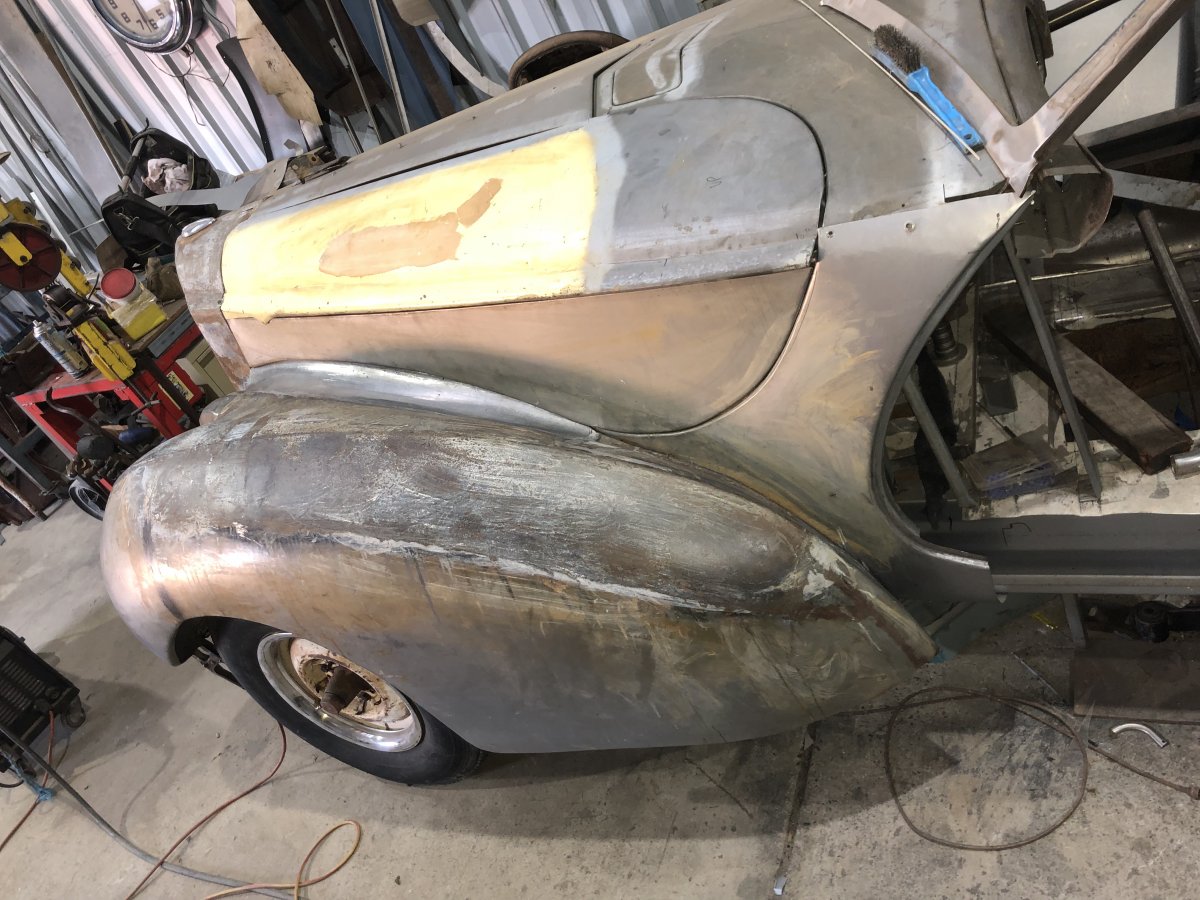

    824C1574-6819-4FC9-A21A-4DCF34DF5DDB.jpeg 99D8380C-9AD6-44F3-934E-266B2DF22242.jpeg 60BFFB47-C4DD-4BDB-8A22-ED76D986AA57.jpeg I kept looking at the rear of my front fender. It was nice but too full and puffy. I wanted it to be sharper and more like a Cord fender. So I bit the bullet and last night I took a pie cut out of the inner edge against the body. Then I squashed it further inwards and the result is astounding. It now looks sleek and tailored. All the tension came out and it sat down like it should. Welded in the hood infill and it pulled the fender crease straight and true.
    Now I can start on the doors.

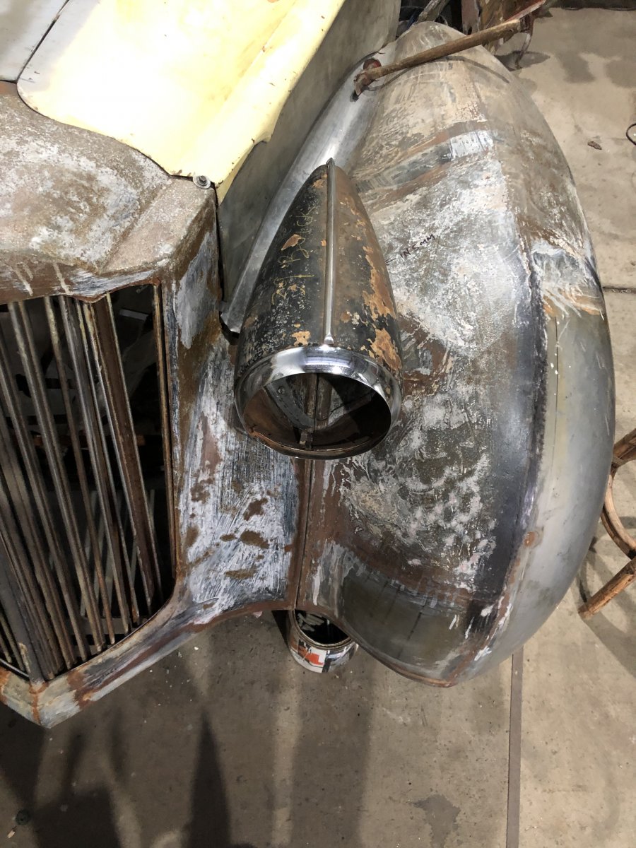

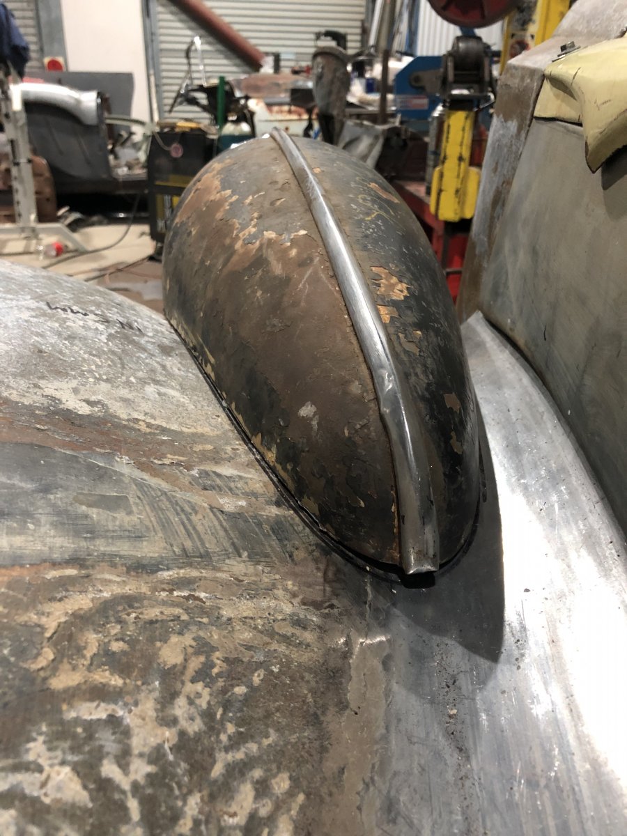

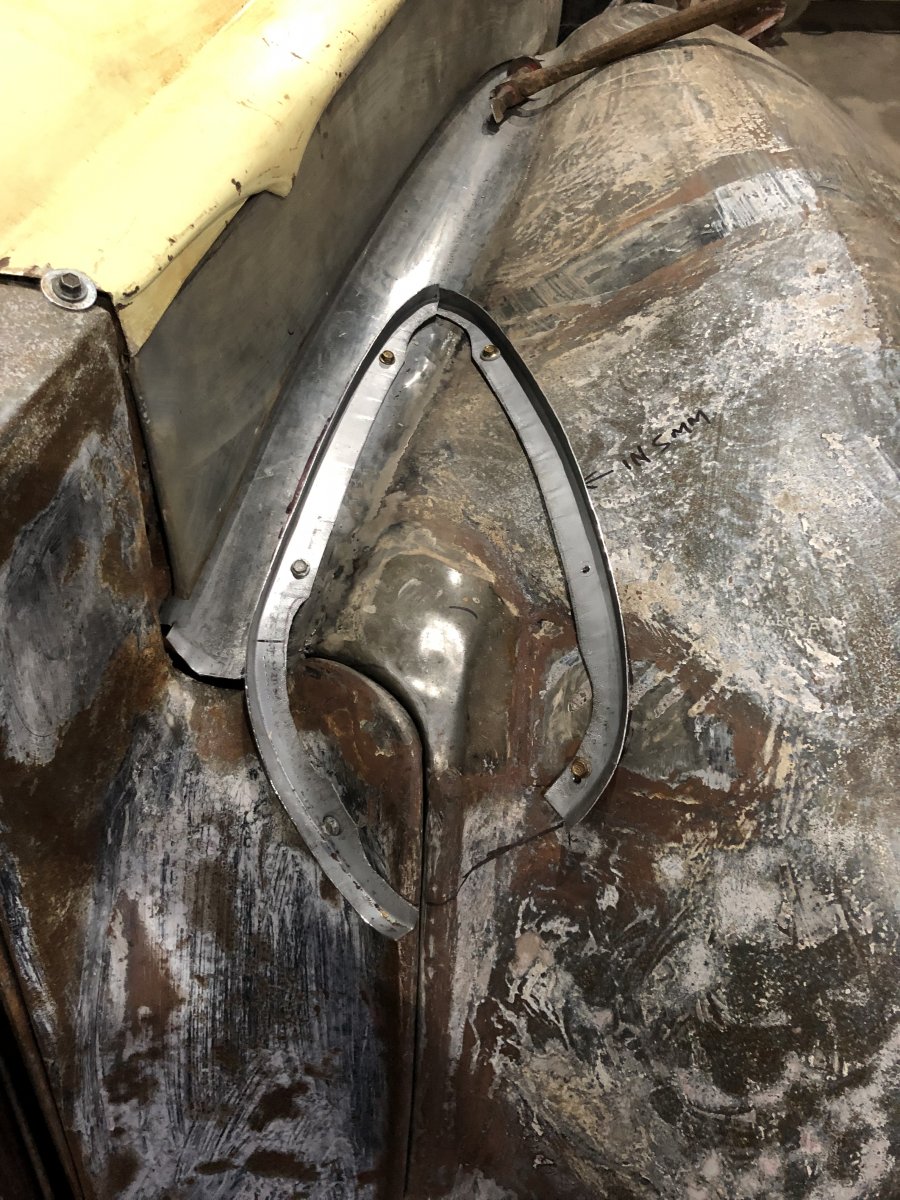

    E06D3A6E-9800-41E7-A8A5-4B9D1E181253.jpeg 522ADA1C-04DD-4BB0-A0D1-B96F1E2D9E6B.jpeg 9B7C7978-BD77-40EE-8290-5D00AA5DA951.jpeg 6E20A699-A957-4FE4-973E-90BBCFB76DDB.jpeg With the guard now under control I can start to lock in 39 Buick head lights. I made a new perimeter support and trimmed up the shell and will weld it up tonight. They will bolt onto the guard not welded to it.

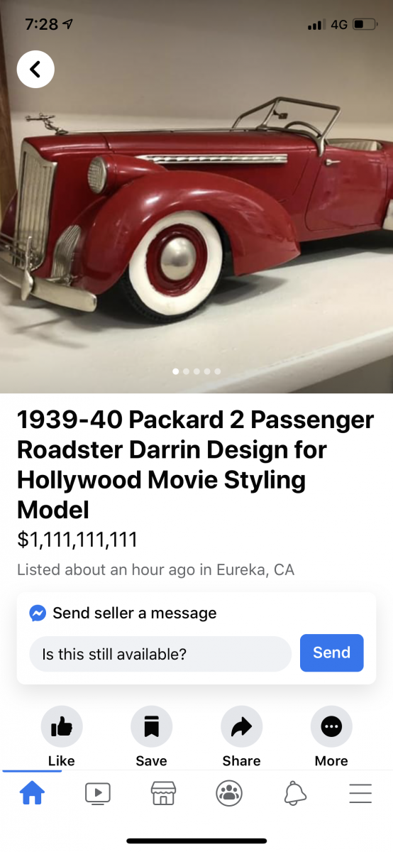

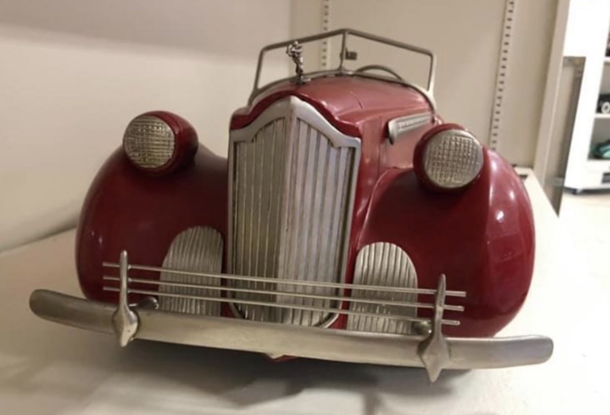

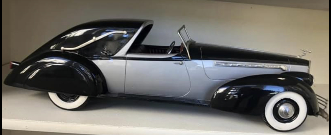

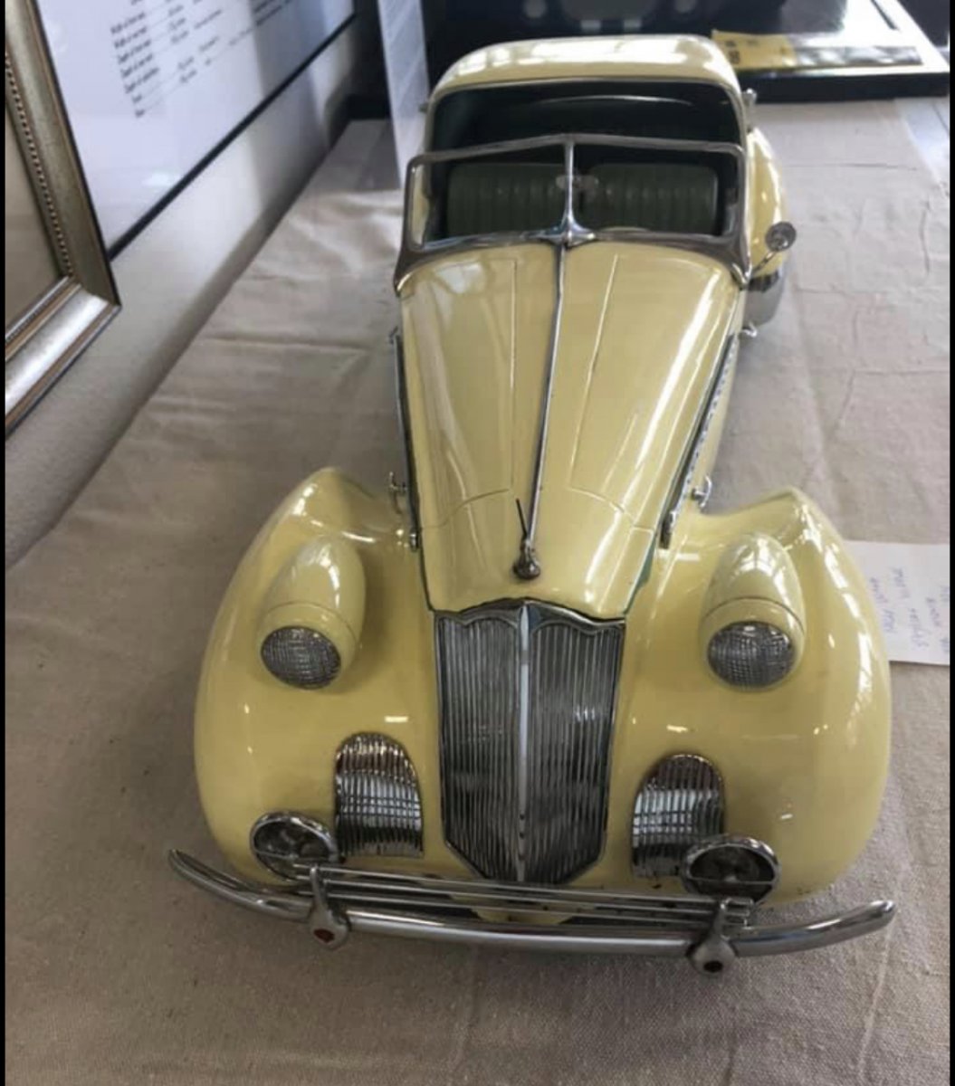

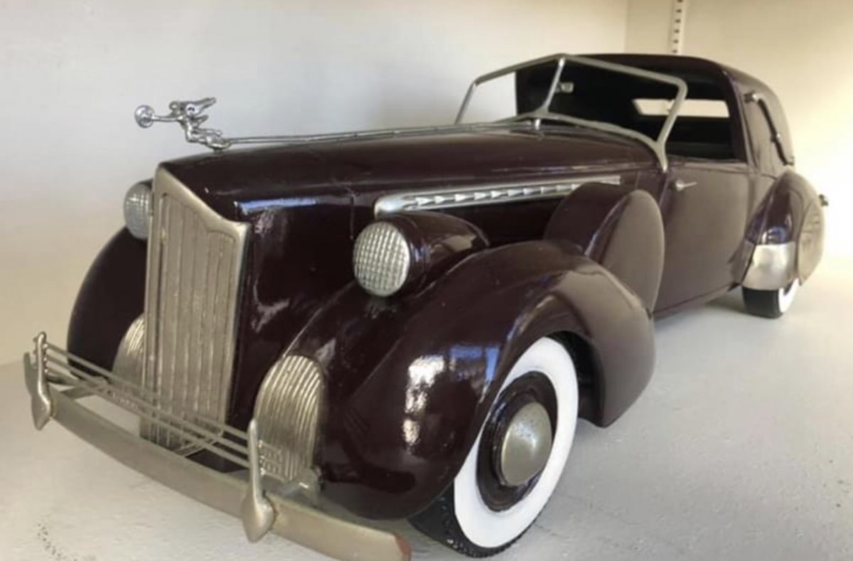

    FE7BBA8C-9722-4330-9848-C8215FB2EFD1.jpeg A8D73E54-4530-4070-8757-C213A247EA42.jpeg F9CEBA26-33A6-45AA-A481-20356D4547B1.jpeg 972B90C3-0337-44AE-ADB3-6BFD6A56F16A.jpeg D18B57E9-D645-43A8-818D-49D1287ECC34.png Look what just came up on Marketplace!! And it’s my birthday.
  26. gatz
    Joined: Jun 2, 2011
    Posts: 2,316
    gatz
    lol, what the ??
  27. Hnstray
    Joined: Aug 23, 2009
    Posts: 12,356
    Hnstray
    from Quincy, IL
    hahahahaha........Fake News! :D
    a lot of money for a model......:)
  28. X38
    Joined: Feb 27, 2005
    Posts: 17,498
    X38
    Maybe he stutters?
    Hnstray likes this.

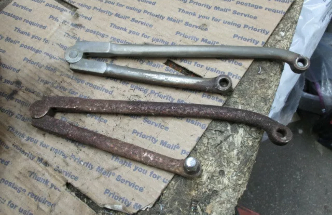

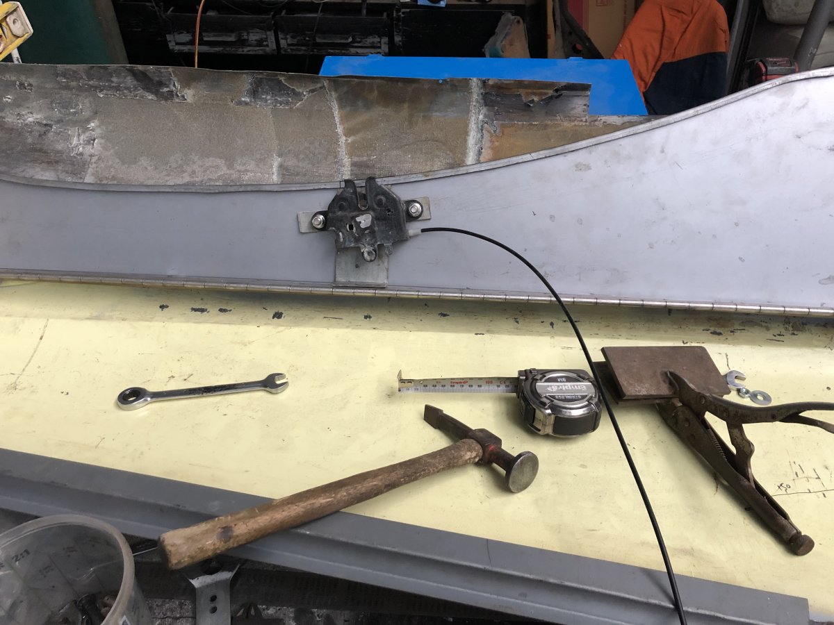

    A1DA88F2-9151-476D-AABF-92F0BD3A36E9.jpeg 99044F60-252F-4891-977B-589FF8D9966A.jpeg C3CF43A9-B307-4986-9E26-881EB5773114.jpeg 9ED7F3ED-5091-4FB1-8AB6-290F28137702.jpeg 09B6D12C-3F1E-41A3-8D46-0416A5EA7851.jpeg CB5AD9FD-0163-4FC3-9D52-831C91895E0C.jpeg 7CA09CD0-90EB-4D69-BEFF-636F446C3491.jpeg 5F916D22-50FD-4631-9C73-3732DE08FAA1.jpeg A couple of hours on Sunday morning and I have got my head around a remote cable operated hood lock and release. I like the smoothness of the hood sides. Should have the pin sorted on the inner fender tomorrow.

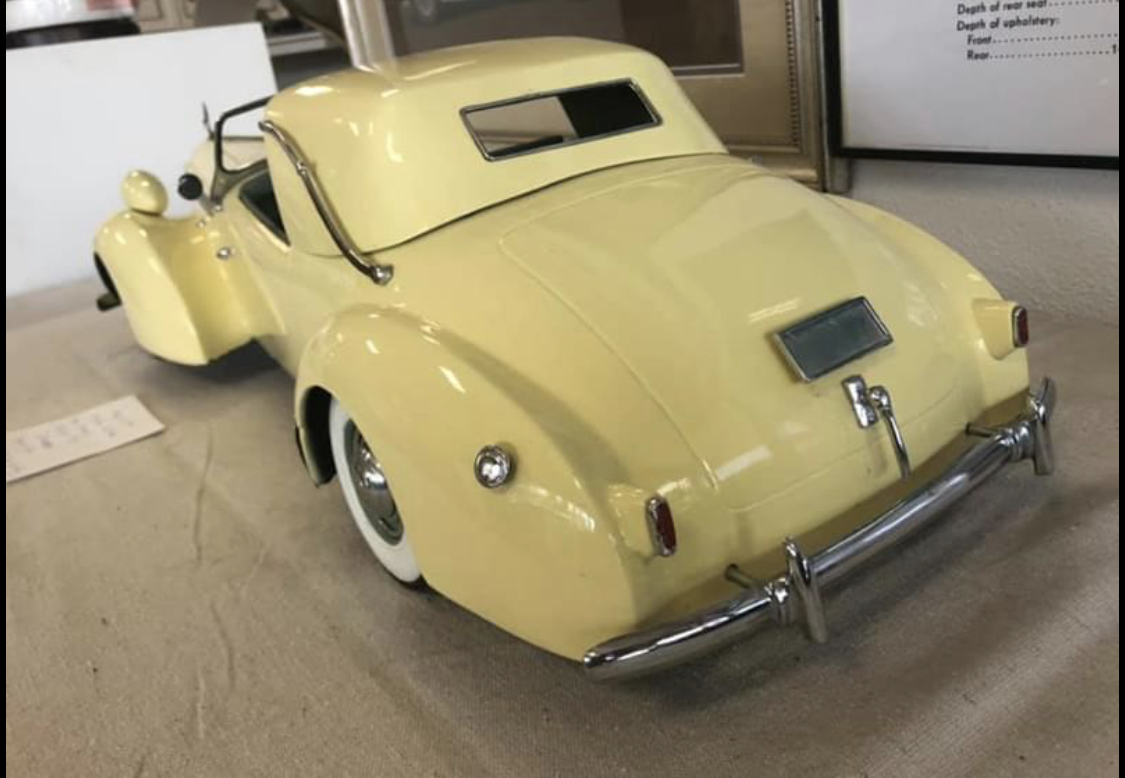

    Meanwhile more of the Darrin models are on marketplace. Might have to sell the house.
