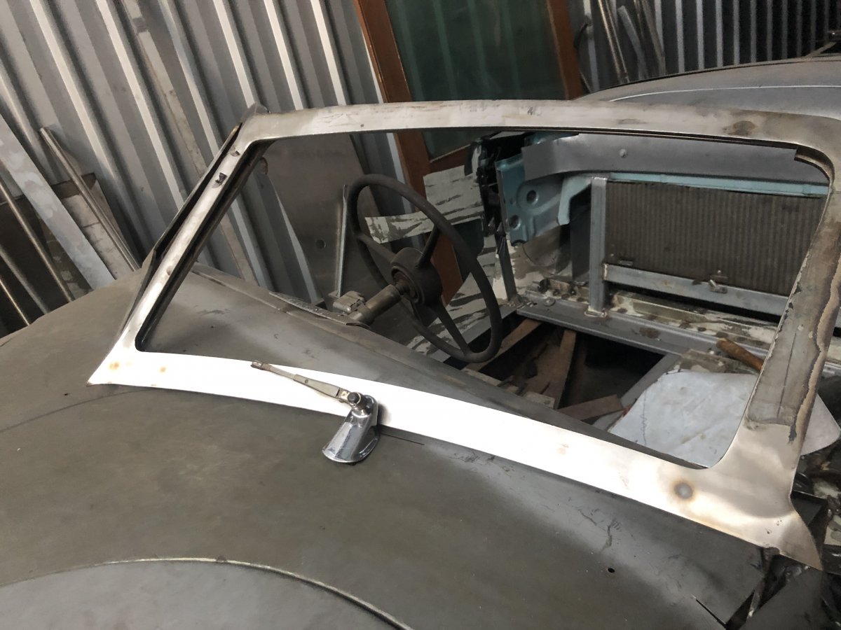

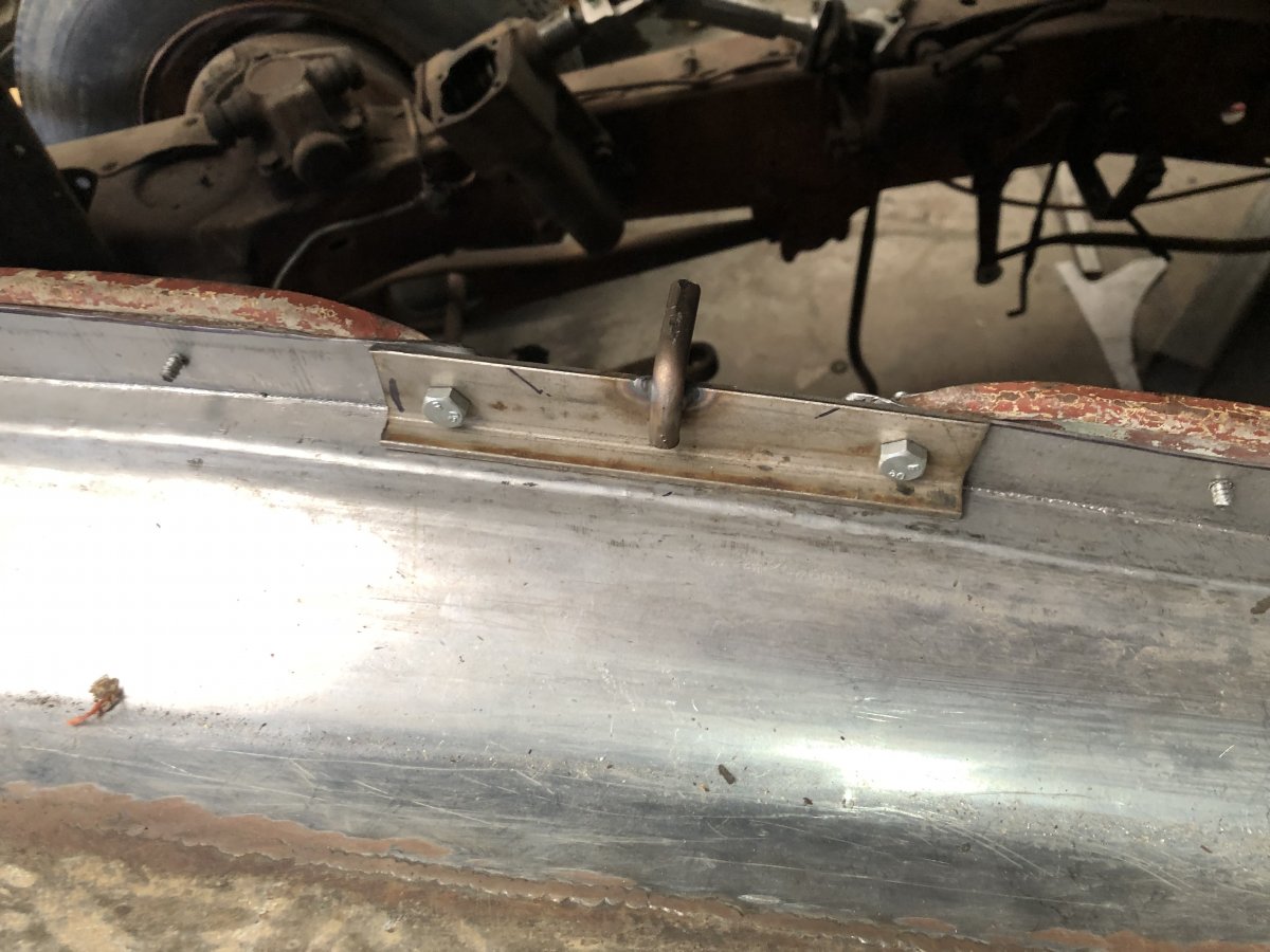

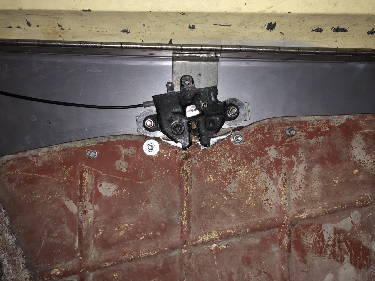

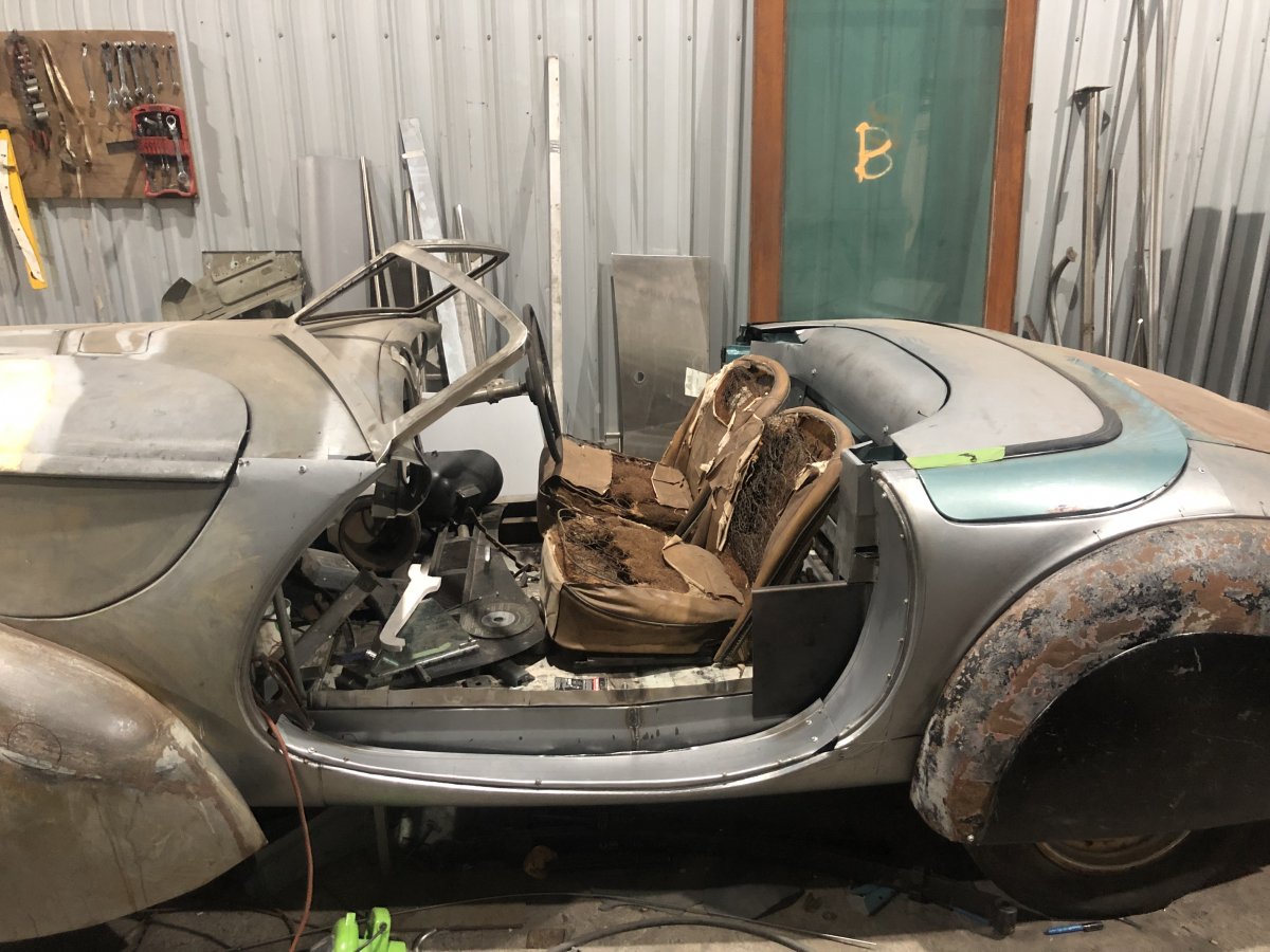

    I’m loving that each little milestone is nearly a daily event. Today’s is getting the hood lock operational . Didn’t want an outside handle spoiling the look. Remote cable will mount under dash once I find nice pull handles. 7D2CCD89-F0E9-427C-B77C-BDB250C3B939.jpeg 6B20E9FF-DB12-4A2B-A06C-C07EA090DC20.jpeg FA8C8517-A3D8-45B0-BB10-6B6017382926.jpeg

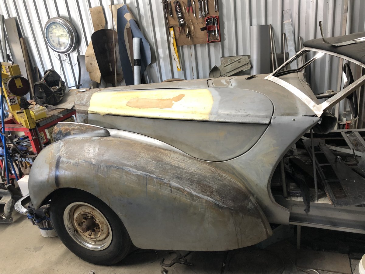

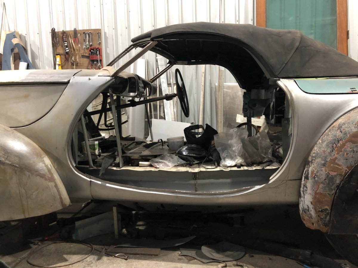

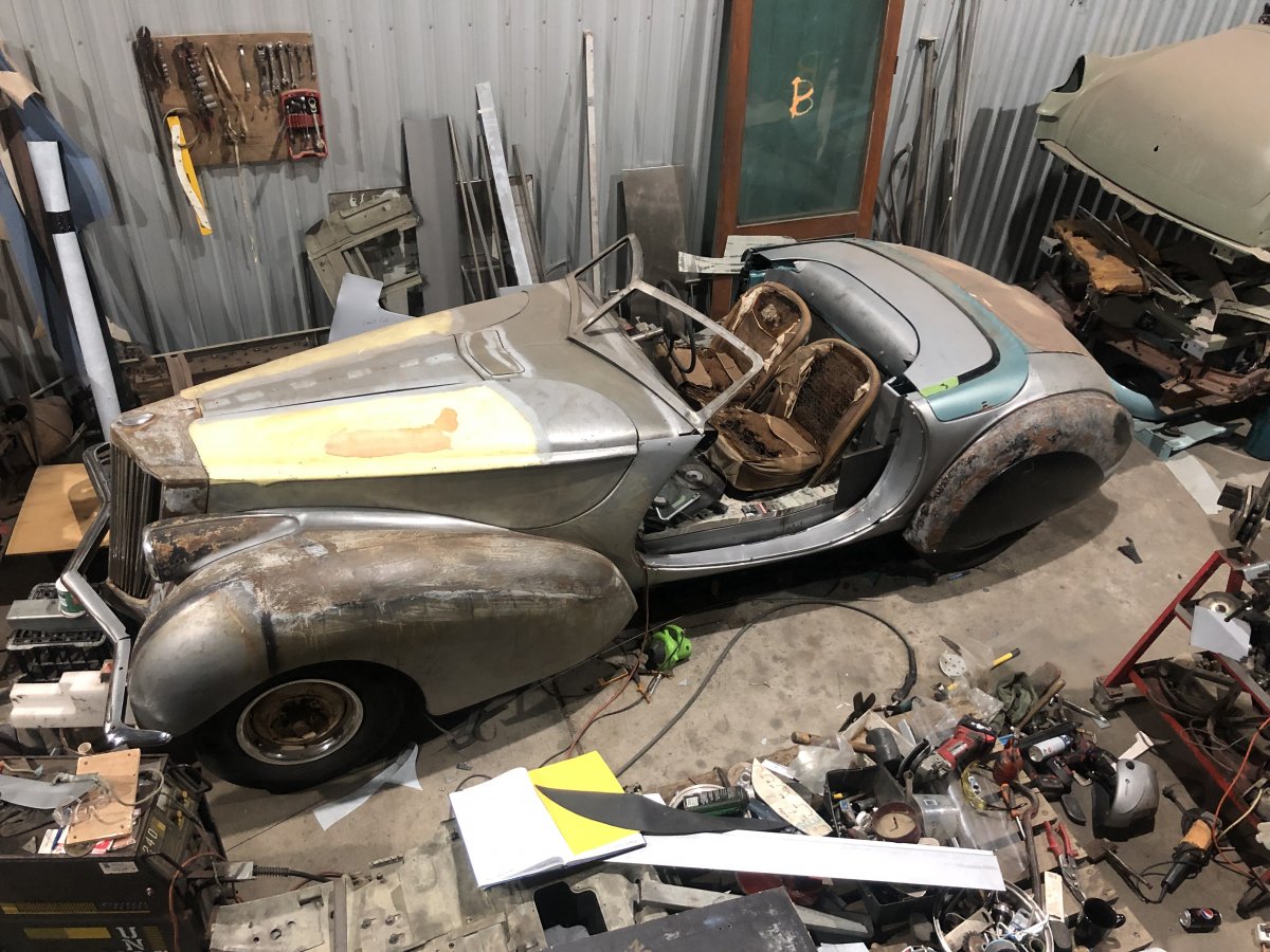

    A27DCE59-4A47-4091-BE78-14D4A0AC027E.jpeg D9EE78F3-64D9-4F96-A9B4-DE25FCD23552.jpeg 69F904F5-584C-44C4-968E-3991489E8EBF.jpeg 3744E1D8-5836-4226-BD1D-247DD29A55F7.jpeg 17CACE84-2615-4421-B687-57688304E46F.jpeg Finally got the Sill revised and rear quarter stepped for the door shape.

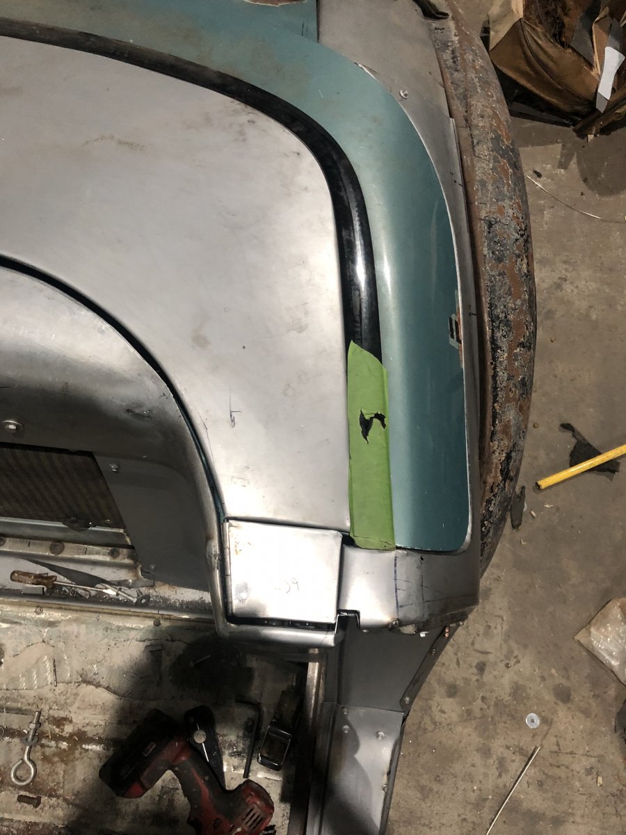

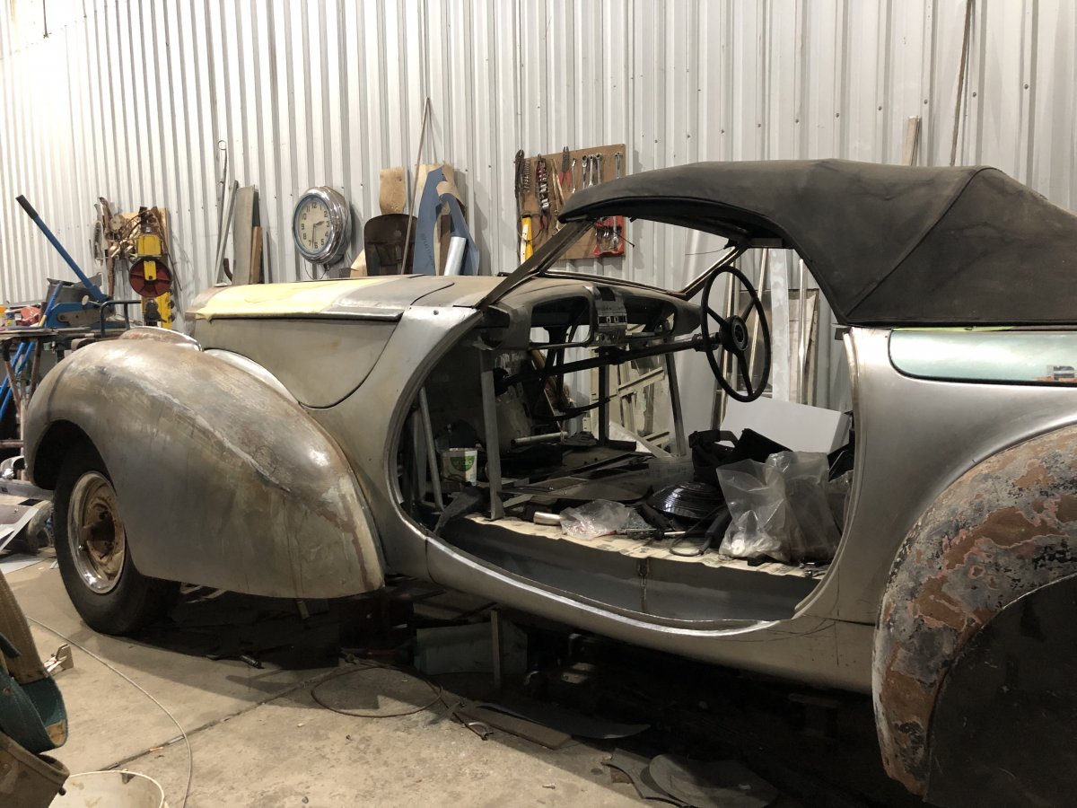

    CadMad

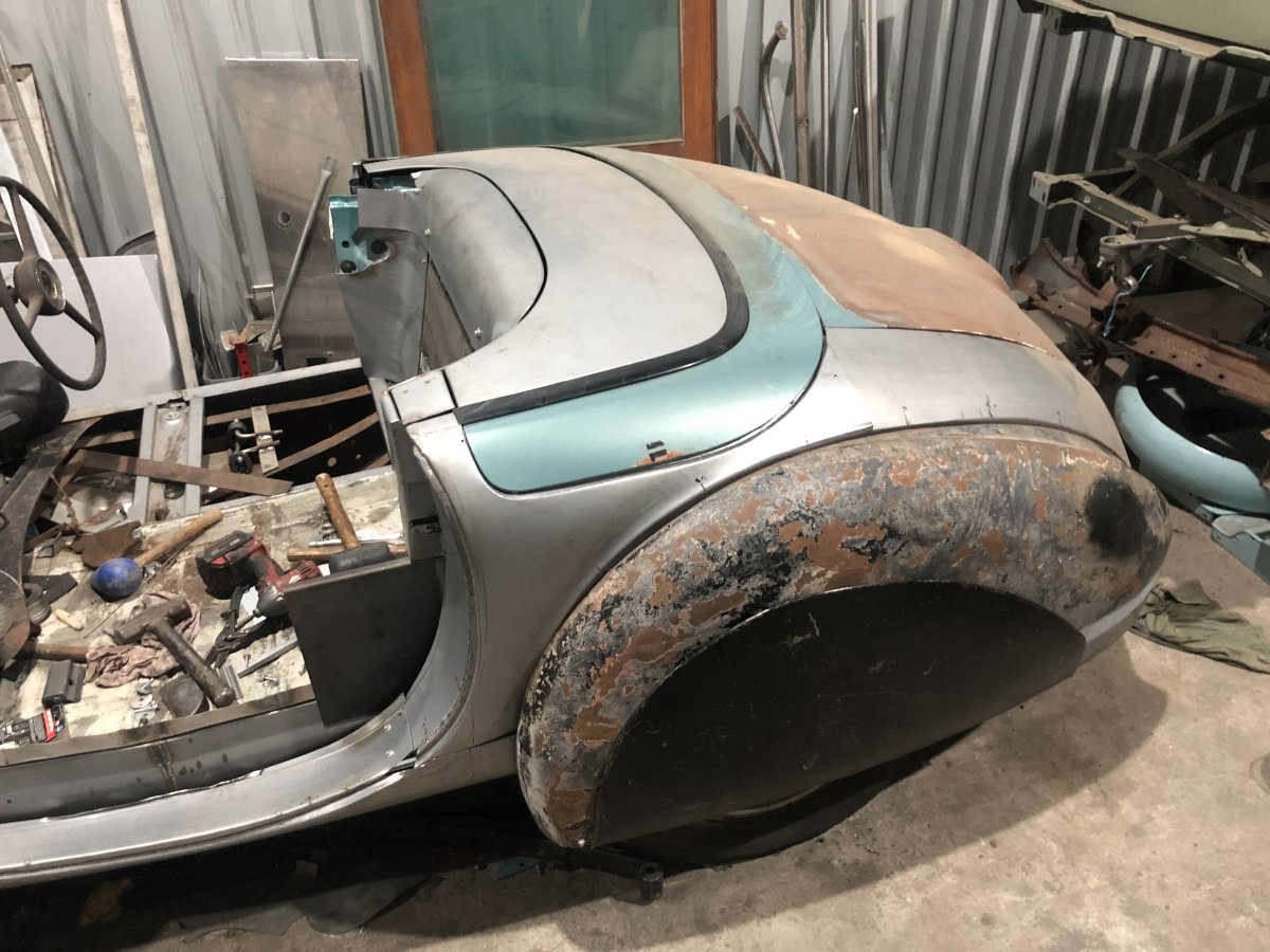

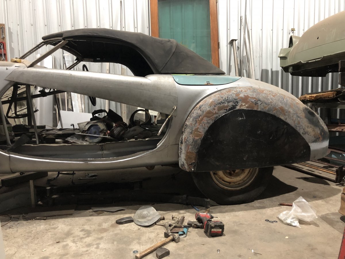

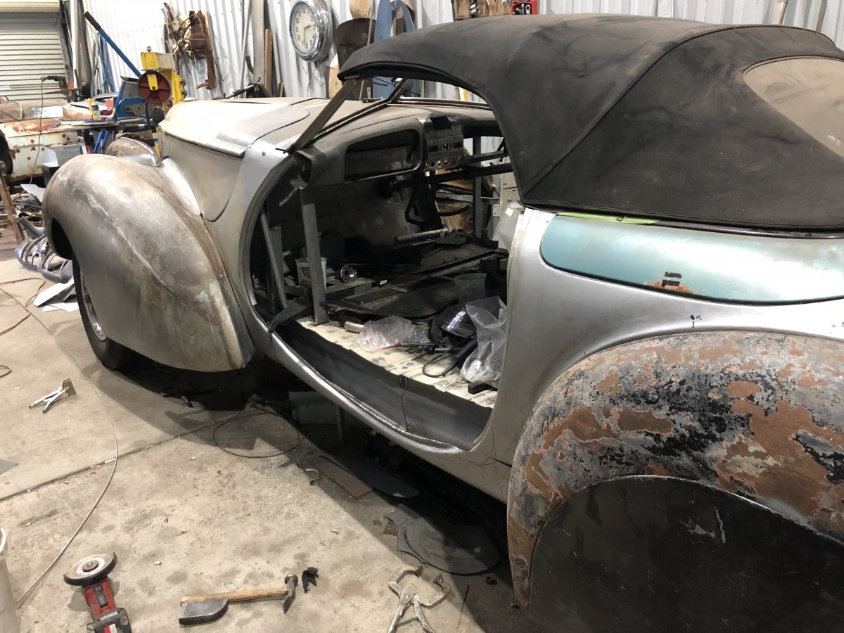

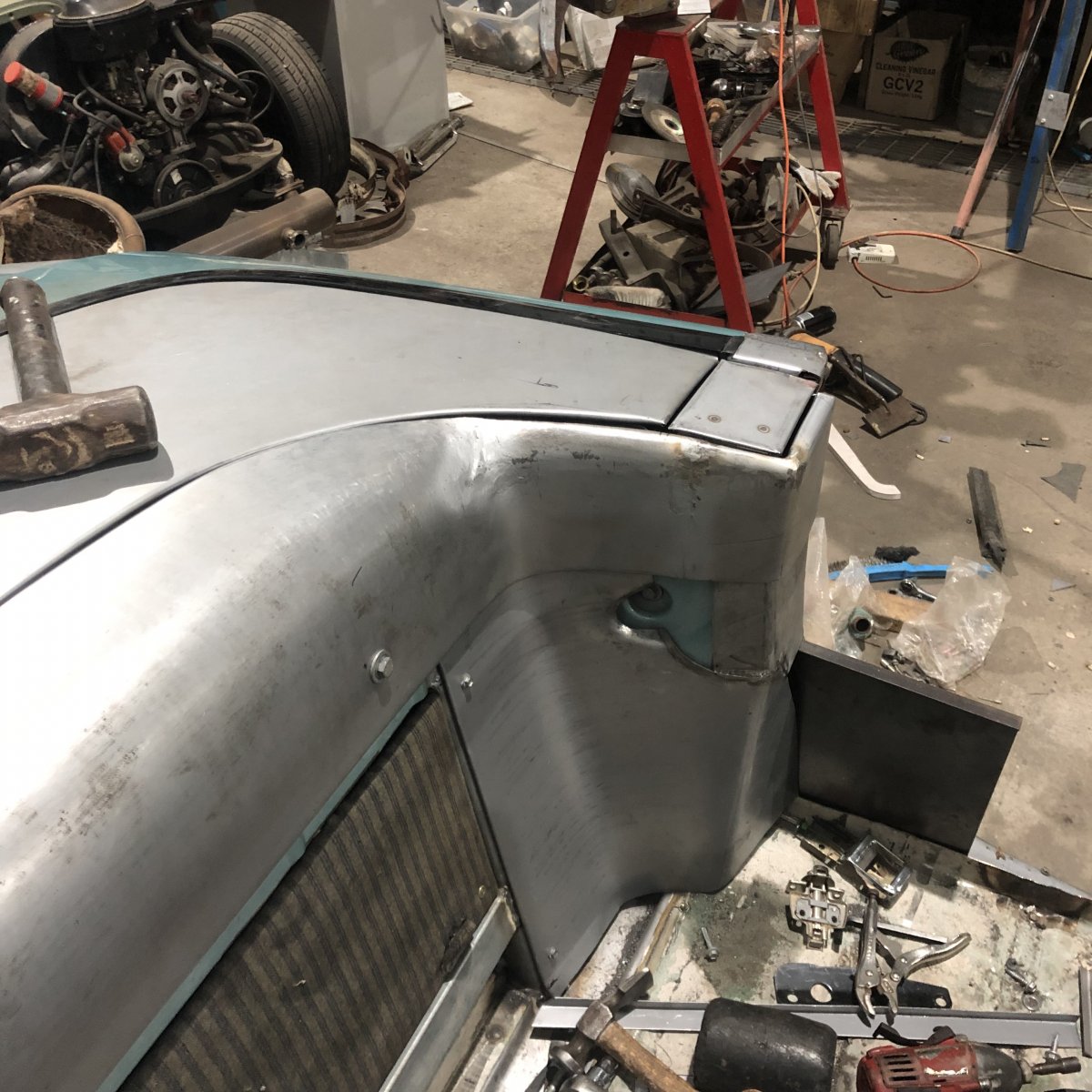

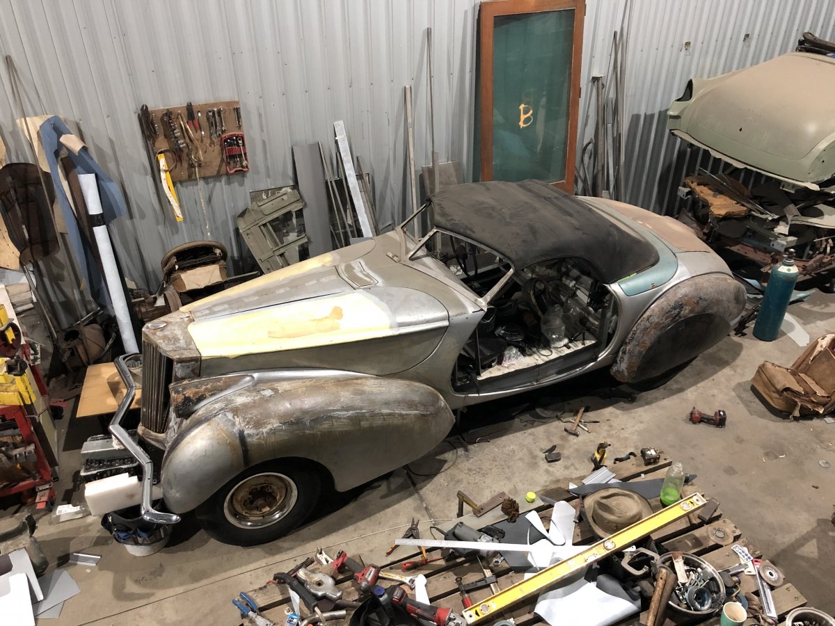

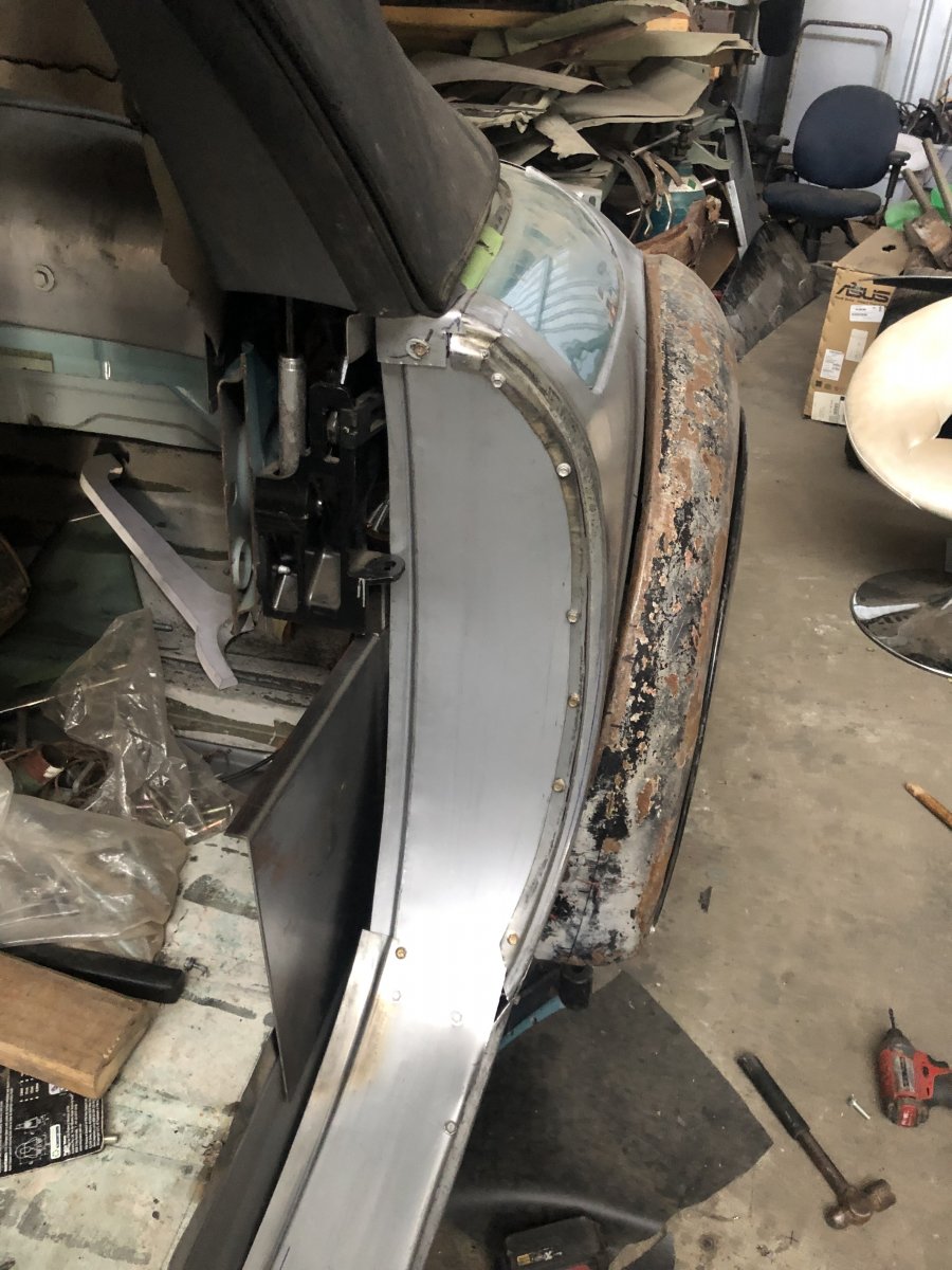

    Raised the rear fender line to get rid of the overhang where the running boards attached. It raised the skirt line which is counter productive, 29C756D6-D295-49B0-A0F2-ABA3A4310A14.jpeg but the new streamlined form is exquisite. This won’t be a traditional taildragger, cos I just don’t have enough suspension travel but it will come down two inches from where it sits once loaded up.

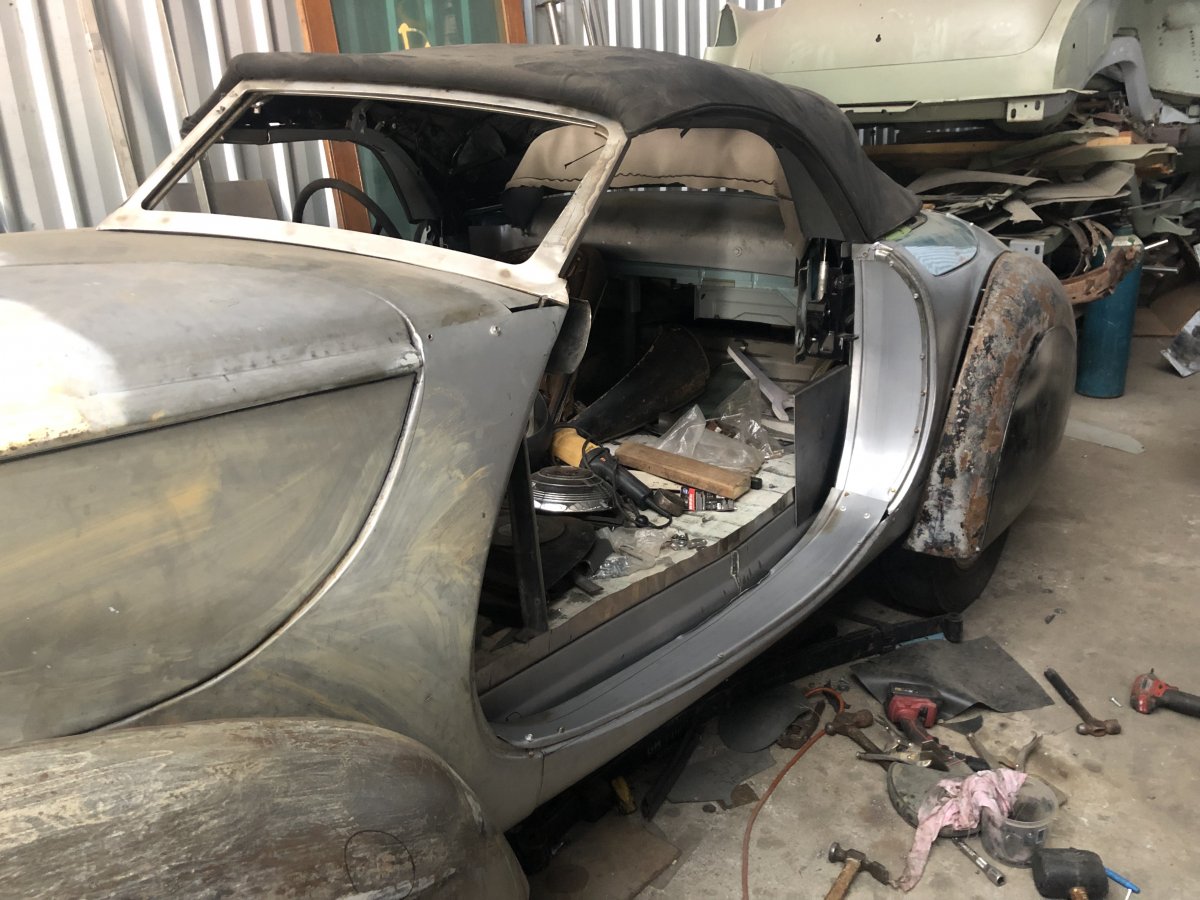

  11. CadMad
    Joined: Oct 20, 2012
    Posts: 886
    CadMad

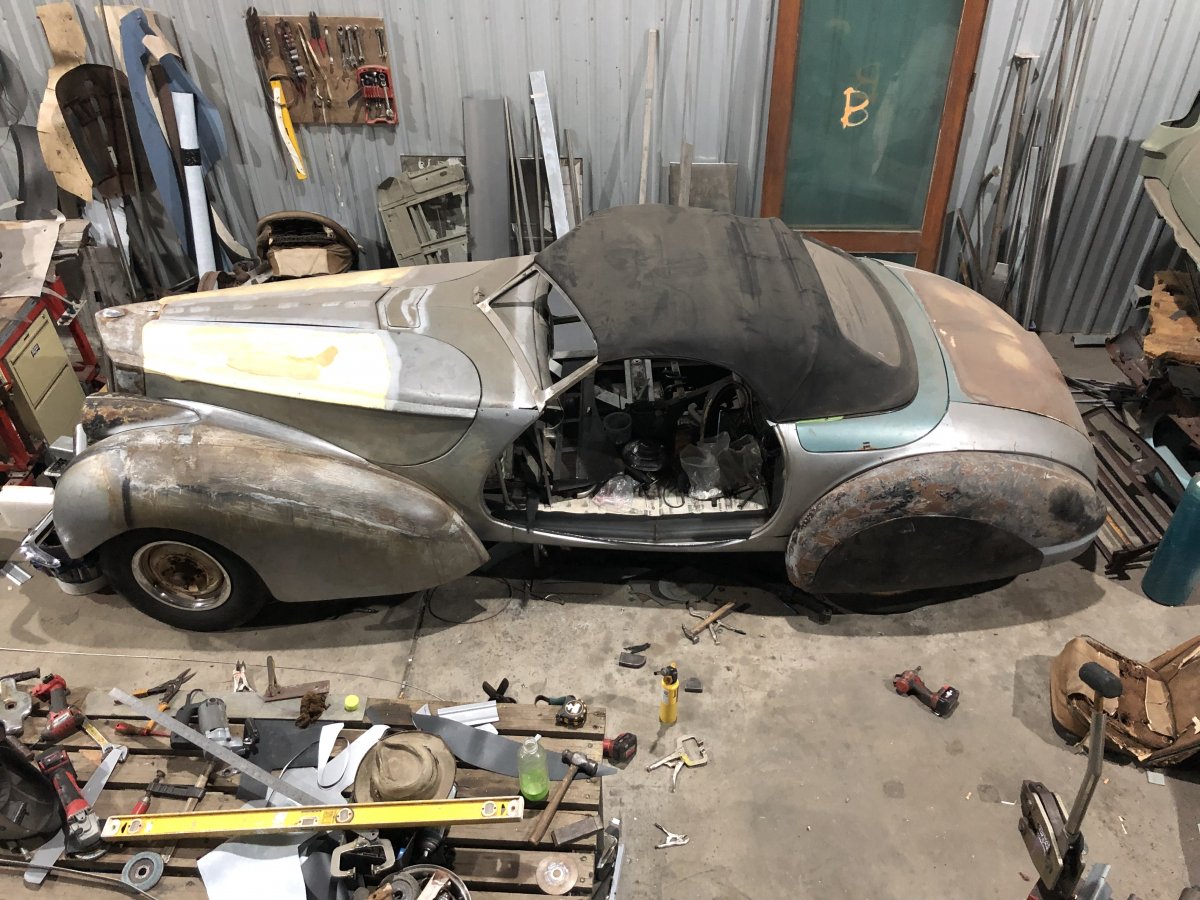

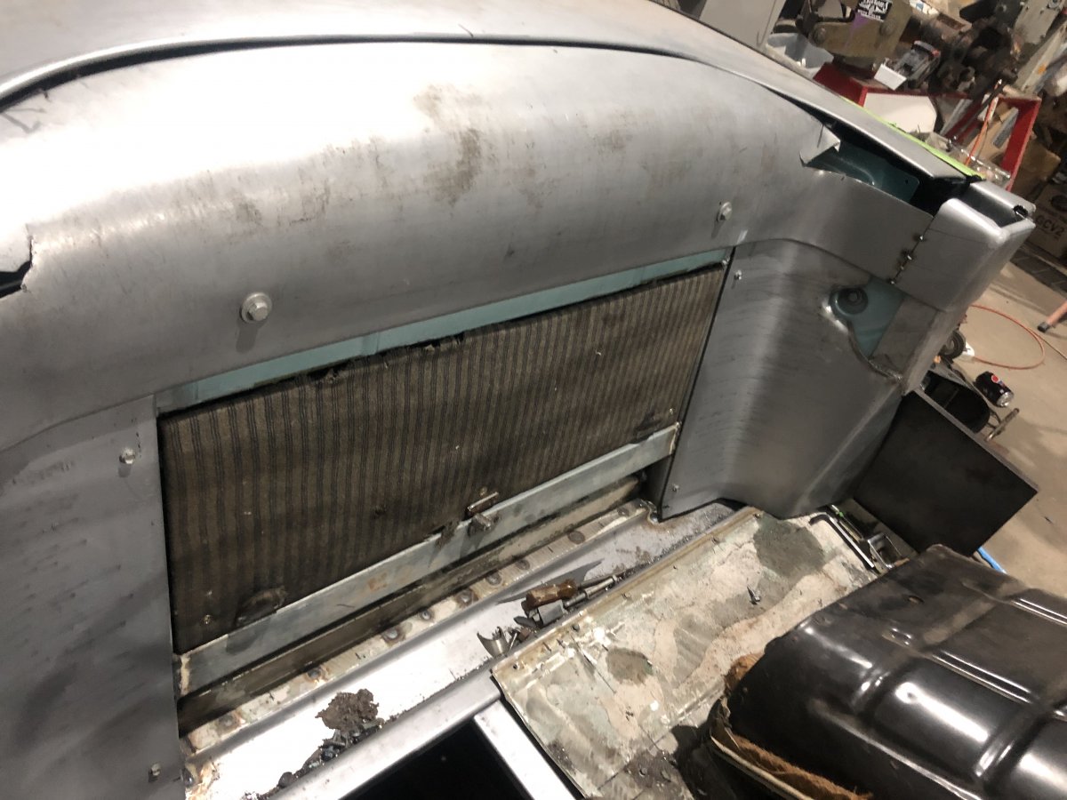

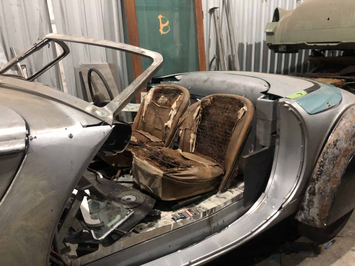

    9232976B-1595-4E22-B795-F3F478F65832.jpeg 711DF6C6-EB4A-437F-901D-B6285E72CBE9.jpeg 76D8F1D0-C625-41F5-934E-2317F48C0476.jpeg Productive Saturday morning with no distractions. Made up 2/3 of the inner sill for both sides. Made a start on the pantograph door hinge supports too.
    Sills just screwed in place for now until I decide on locks . It’s made a huge psychological boost. Doors will be easy now.

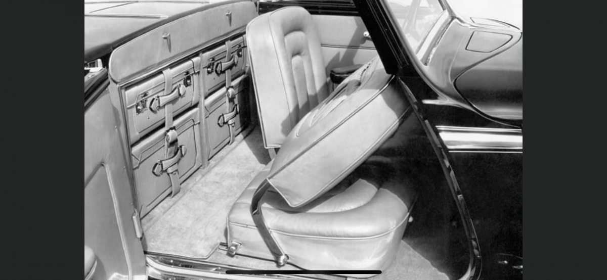

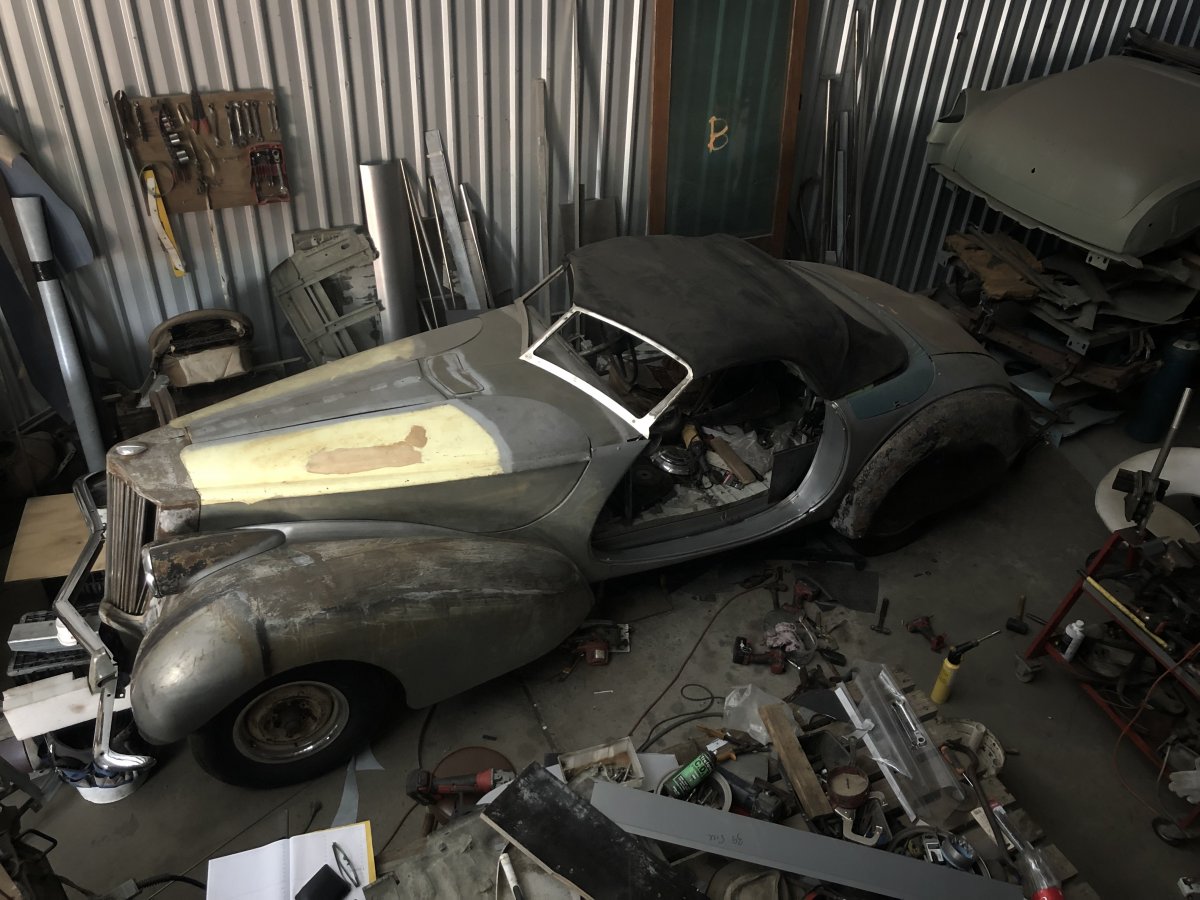

    DA7663B2-0A9A-467A-9705-FA4EA7CA6705.jpeg 85CC55B6-8579-4A29-B572-DD0F53883876.jpeg 1DA17A38-4B7F-40D9-B3F4-B7FC603FF0B1.png Tonight’s job was to sure up the top well. As a bonus I had kept the only salvageable part of the original front seat, which was a fold down tray that somehow survived when everything else was rusted and rotted away. I saw this 37 Maybach and it gave me the idea. Might put a mini ****tail cabinet or tool kit in there.

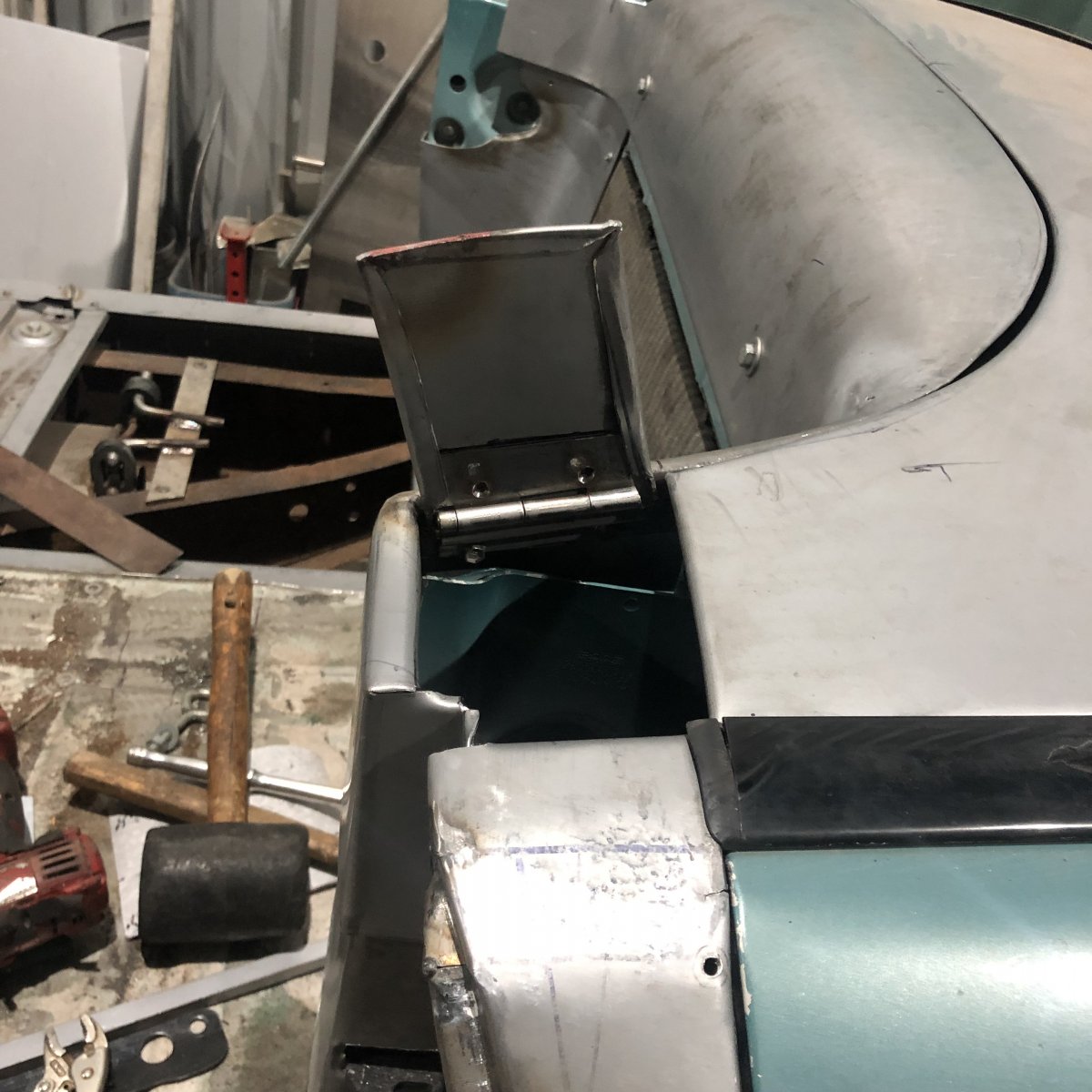

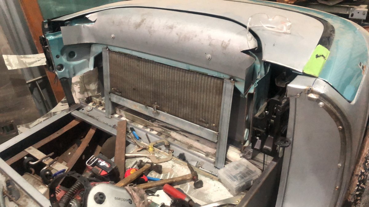

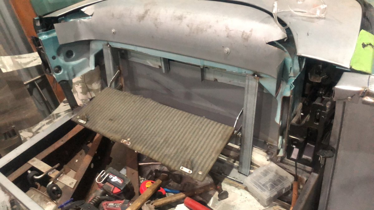

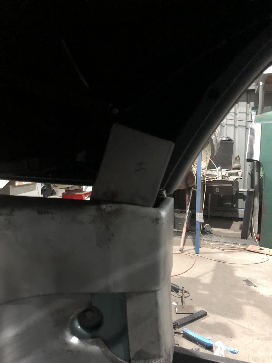

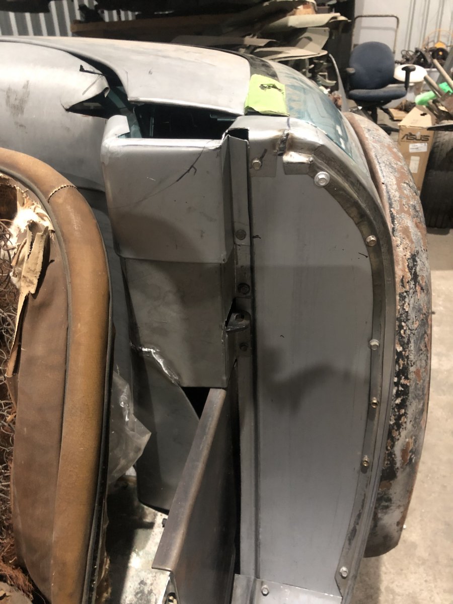

    I finished off the internal shoulder of the top well and couldn’t resist making the little hinge flap that tidies everything up. Copied a Bentley that I worked on. It works.
    But as soon as I got home and looked at pics I thought of a better way like a Mercedes conv, cable operated one. Got to get some cables and springs and do another version. F1660ED1-900D-4478-AD76-BA18E5005D5A.jpeg AB5619AD-D4F2-460A-A18B-EC758571E0C1.jpeg

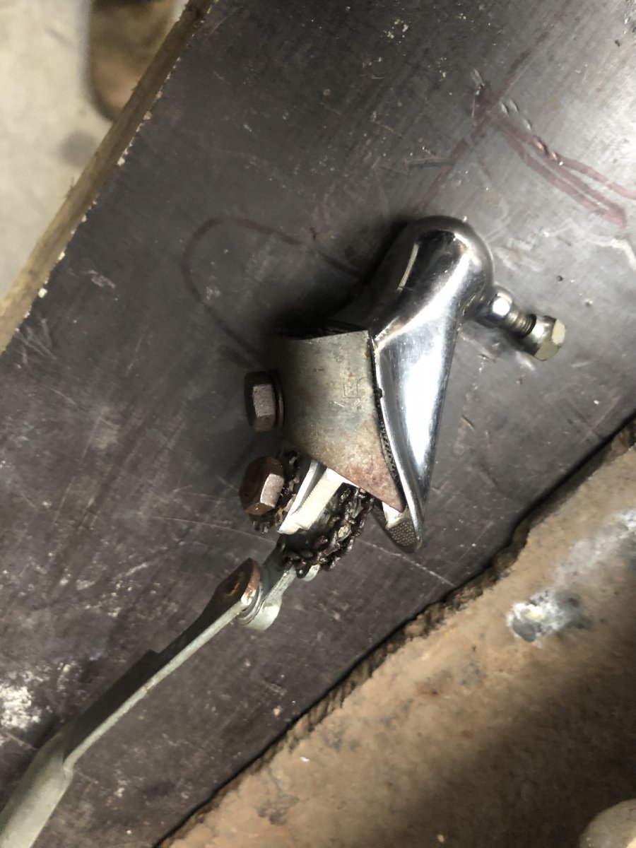

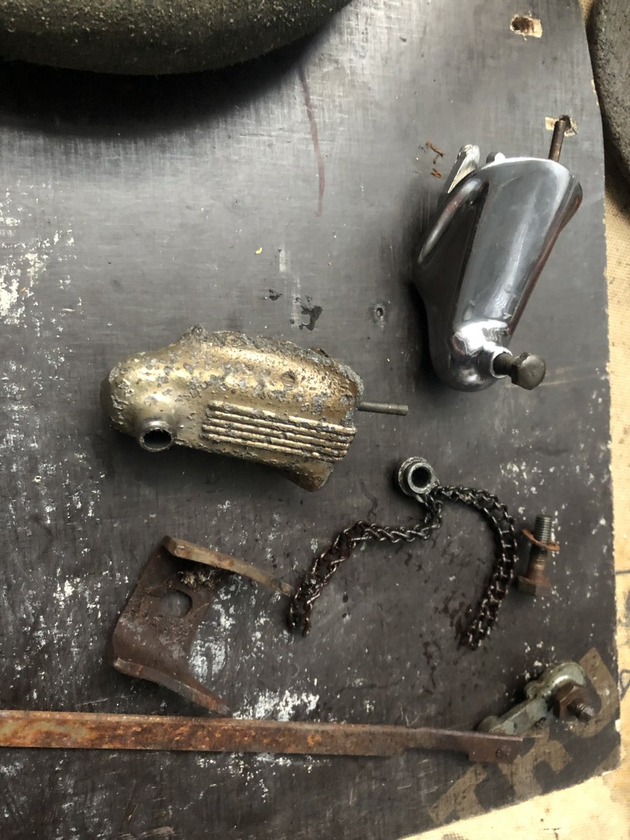

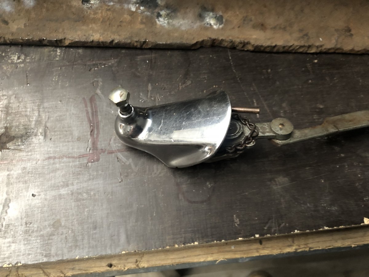

    My eBay purchase 31F0999B-1E82-41F5-8182-680E4E570AB5.jpeg A0CE3B7E-EF7F-4C83-9B08-E57653857B63.jpeg 9A4A52A1-C1E6-4FBC-960B-292F646E4FC1.jpeg A7A113F9-2F69-4703-B684-4FD18D78E1E3.jpeg Cadillac Sixty Special wiper bases arrived after two months today. They were just the housings so I transferred the guts of the crusty original Packard ones in and perfect!!
    Had to try one out.
