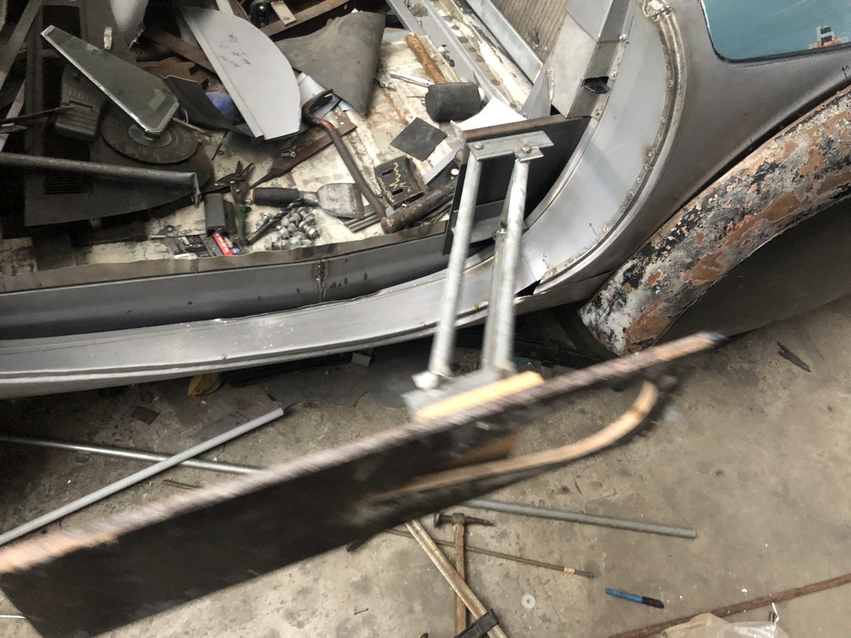

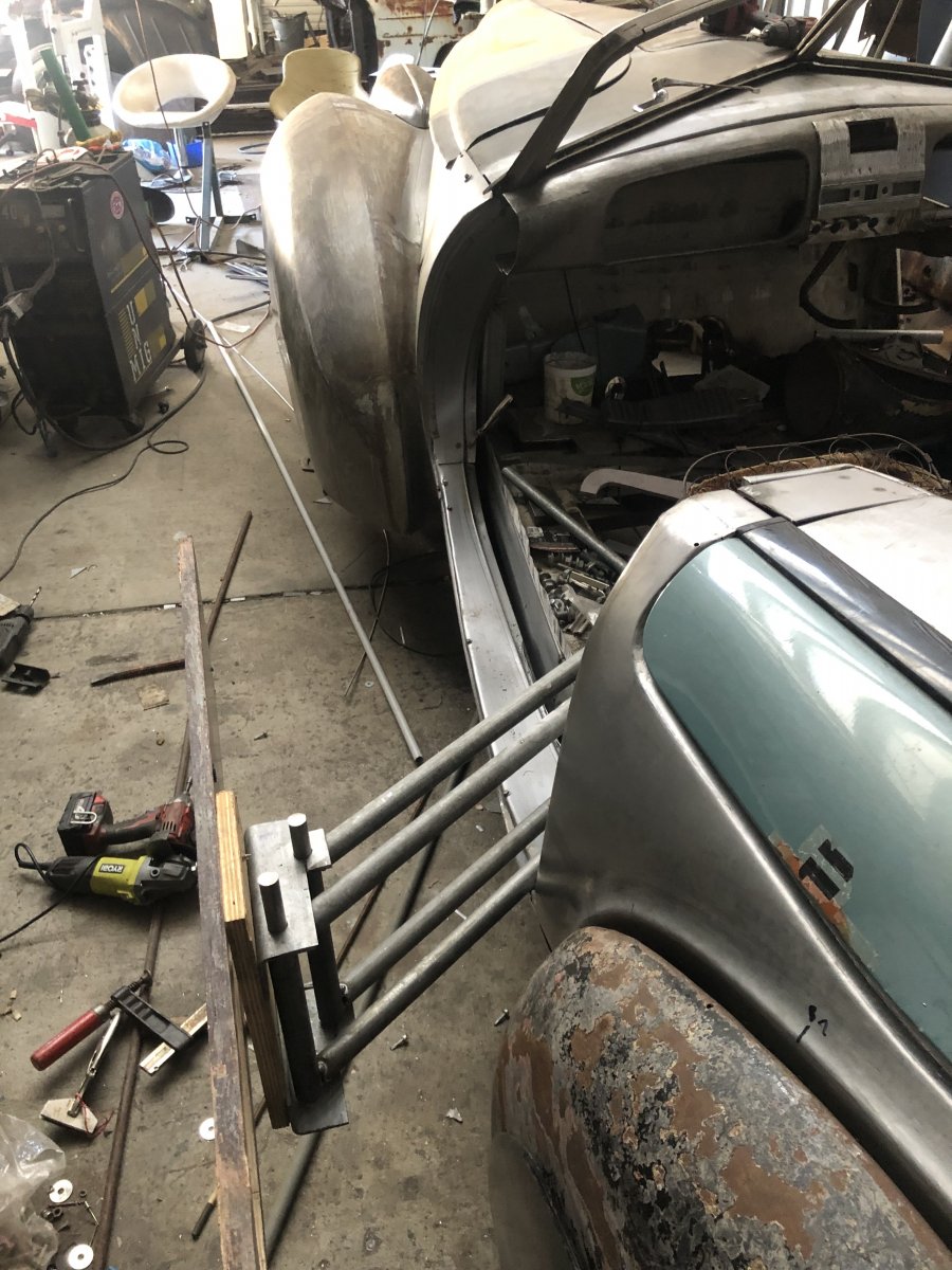

    99EF31EE-C41C-4399-82C5-5156E647DE81.jpeg D4815068-C587-4803-9235-E9AF0B4994A5.jpeg 60F8579B-A3BE-4ECB-B796-50EA413562B5.jpeg 5EC75544-2EFD-4C40-BF65-56D6E6FC3F14.jpeg 0C147A45-5308-4C08-9BB5-673B82B91F76.jpeg Prototype works perfectly. Now to remake it in SS tube.

  7. pwschuh
    Joined: Oct 27, 2008
    Posts: 2,987
    pwschuh
    So, I guess suicide doors are out of the question? ;)
  8. Hnstray
    Joined: Aug 23, 2009
    Posts: 12,357
    Hnstray
    from Quincy, IL
    Well, really they kinda are suicide style.....but maybe not quite. When one of these doors accidentally opens at speed it will be whisked rearward ala suicide door, but with a twist ......as you fall out trying to catch the door, the parallelogram arms scoop you up and bring you along for the short remainder of the ride......:D
    Putting all seriousness aside, clever solution and well done!
    Ray
  9. CadMad
    Joined: Oct 20, 2012
    Posts: 886
    CadMad

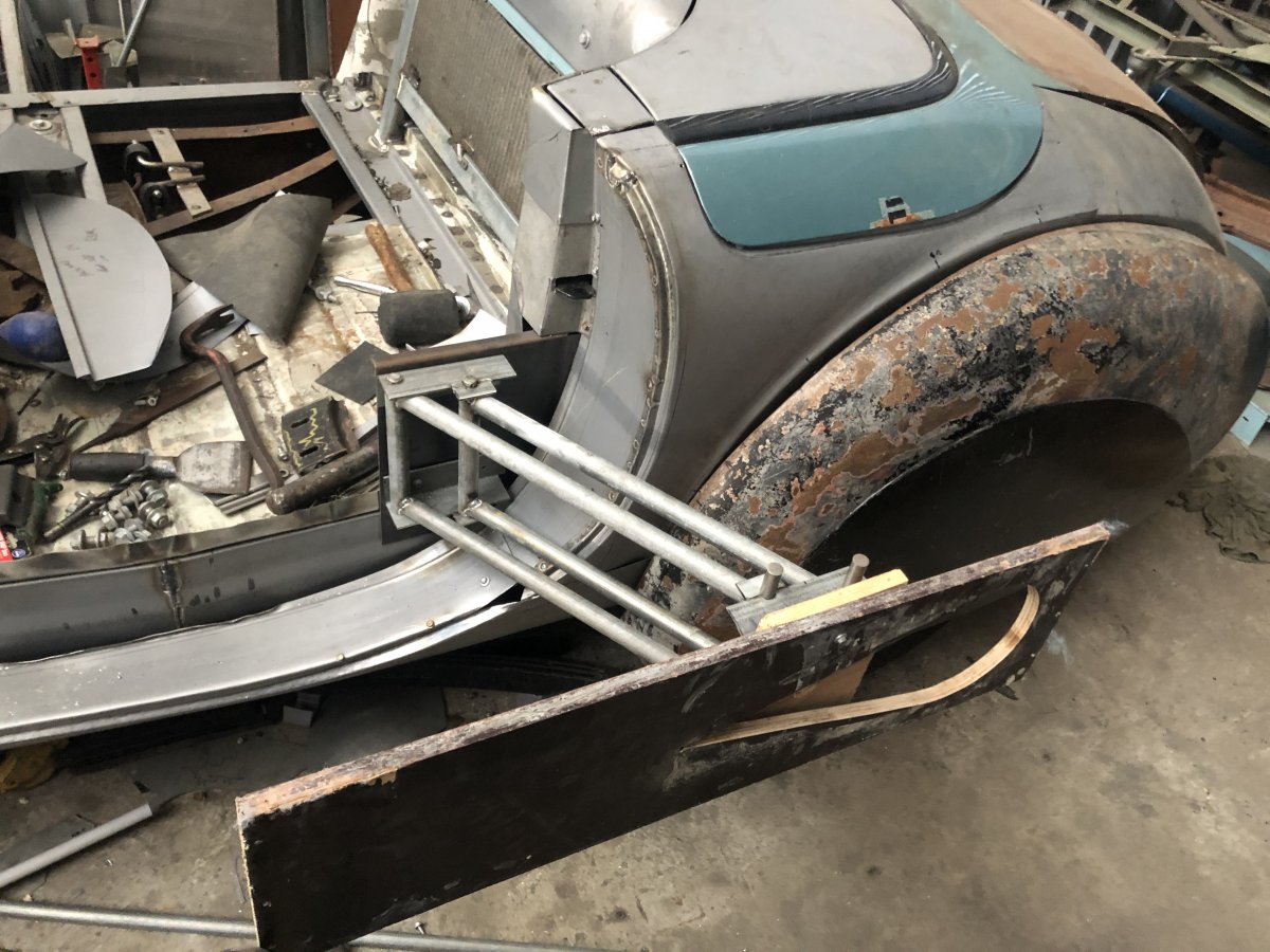

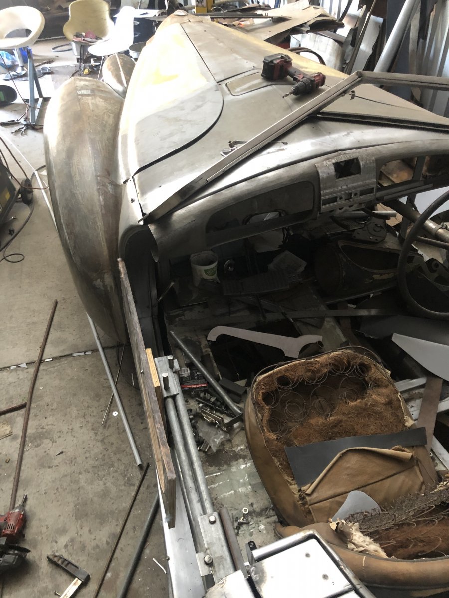

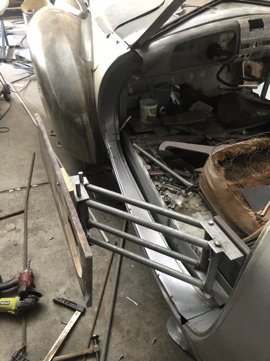

    With the the round shape of the doors, traditional pillar hinges were not applicable. The pantograph is the perfect solution and acts as an armrest when closed.
    Don’t worry, I will have secure lap belts holding me in. I’ll start on locks next . Fore and aft. Seeing how smoothly the mechanism operates I am confident that they will allow a secure latching operation. I’m using modern positive locking mechanisms ( not bear laws) so accidental opening won’t happen.

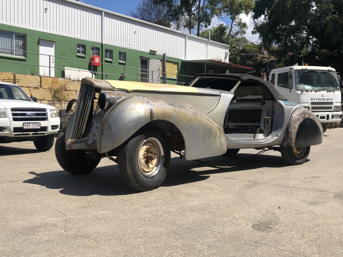

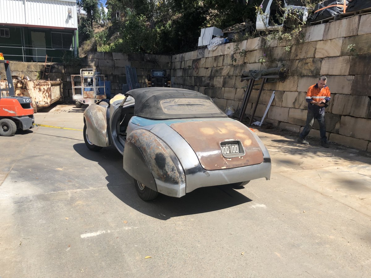

  10. CadMad
    Posts: 886
    CadMad

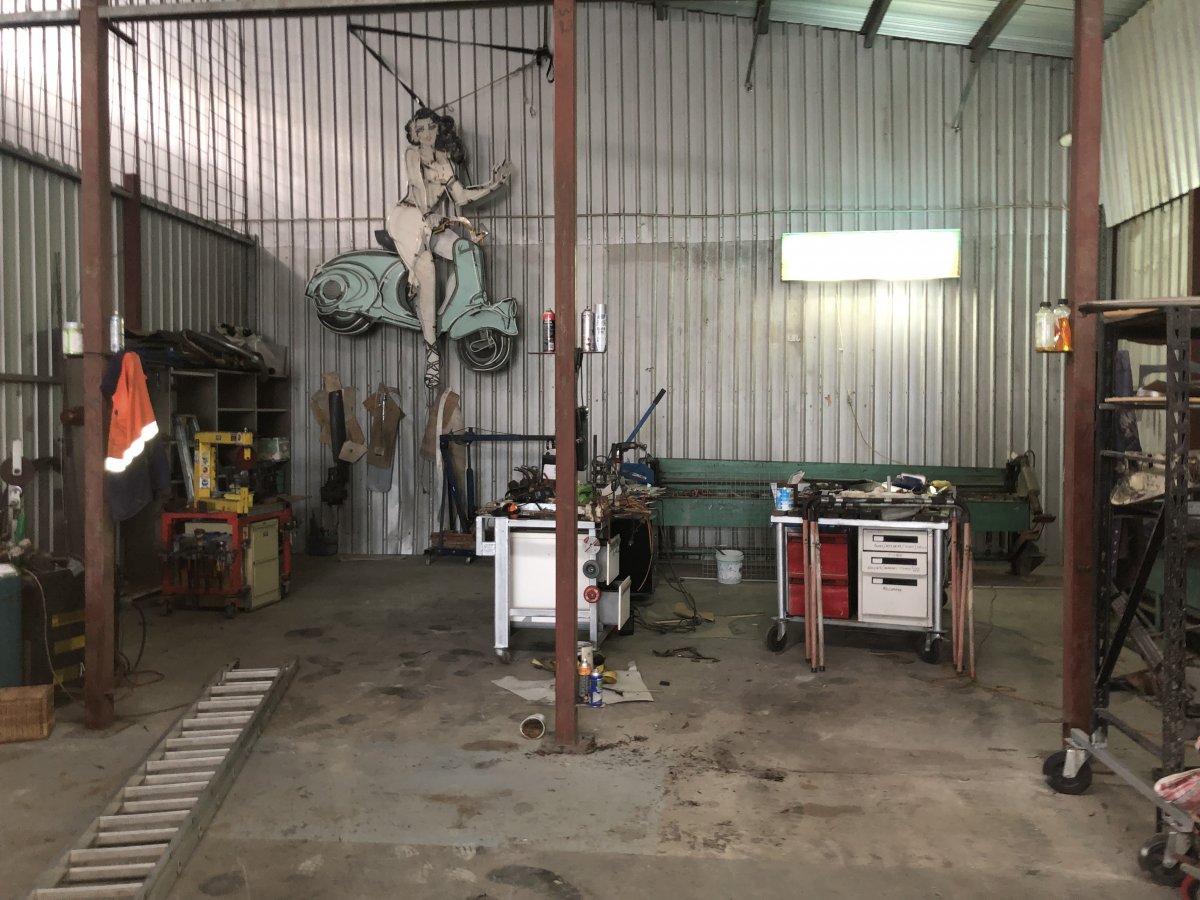

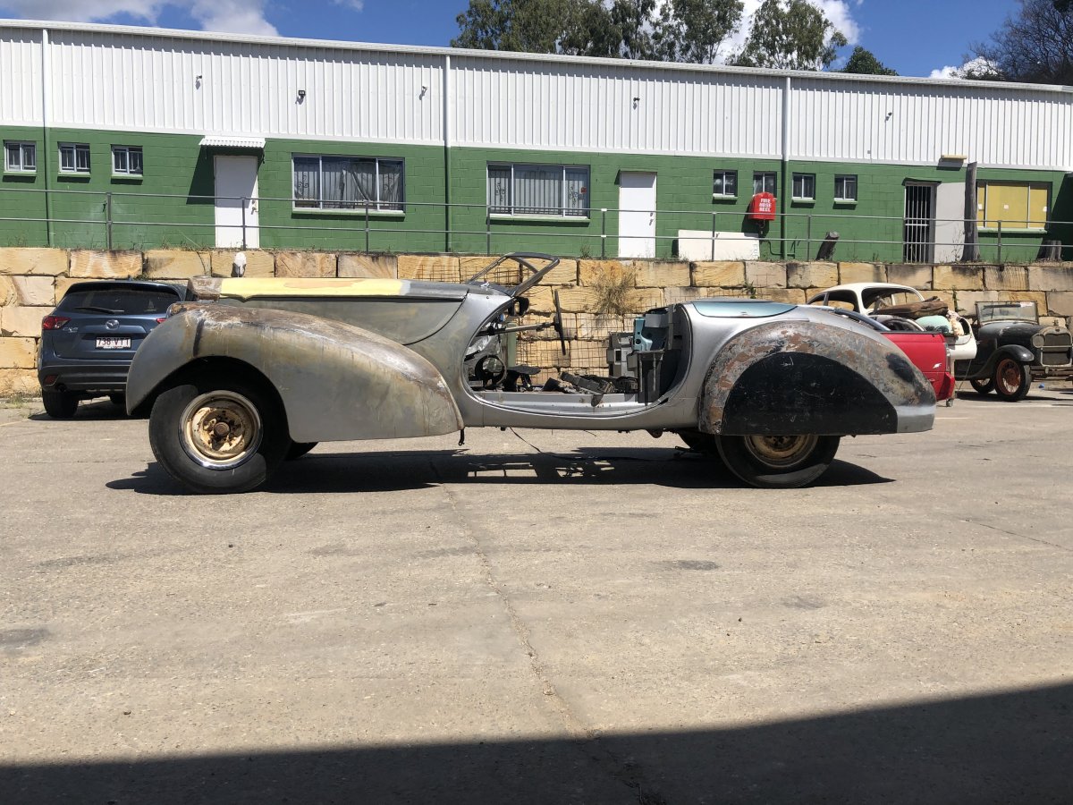

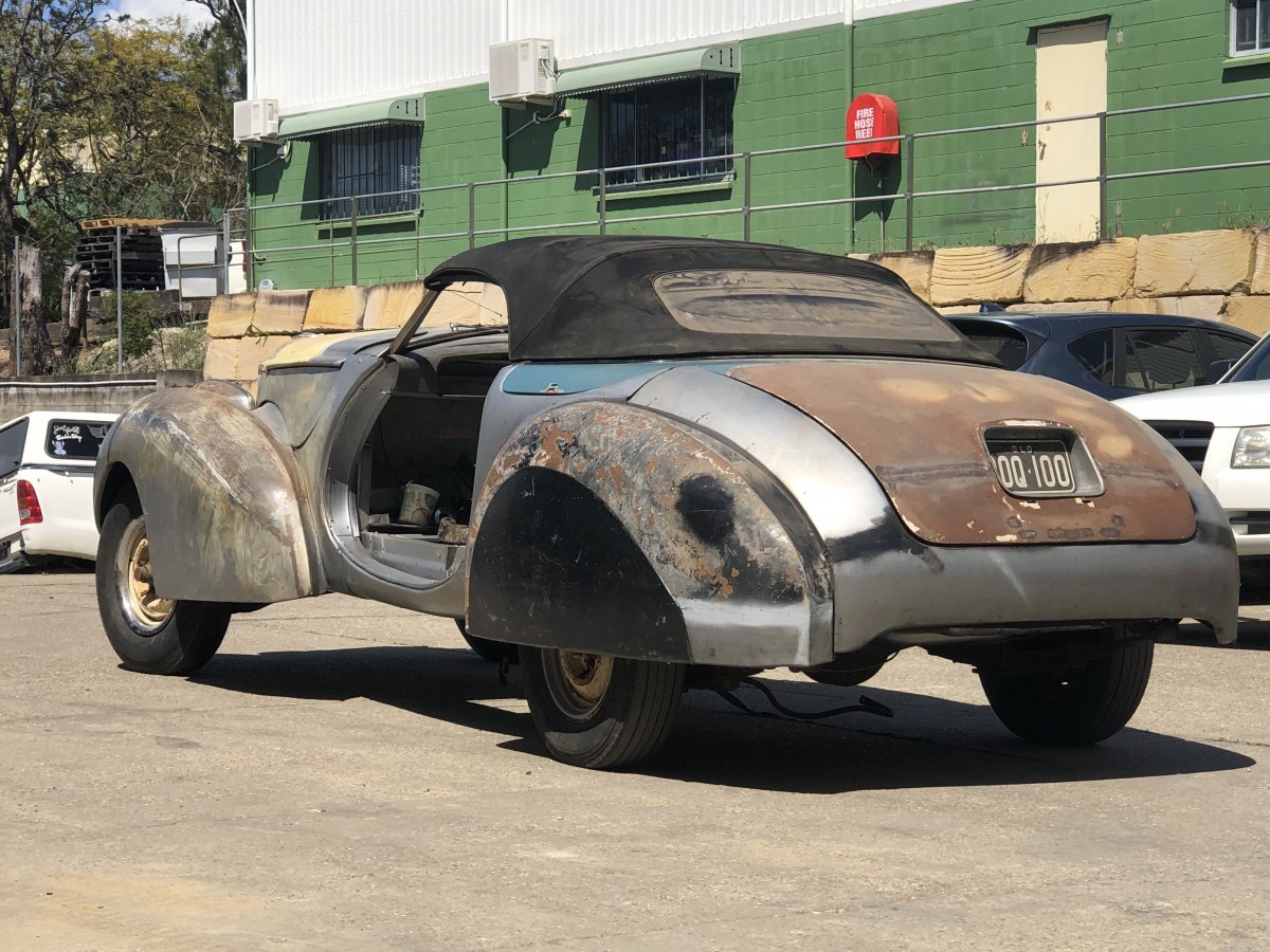

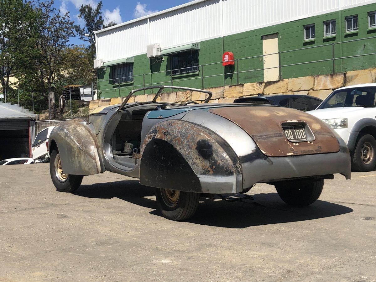

    AD2A0C98-D84B-408E-A3DE-A24D7E312014.jpeg 63180DA2-2D33-490A-9832-A5B79308705E.jpeg 2E554D1C-3EB4-4227-9151-57C5A98E6448.jpeg E232472C-86ED-4642-ADBA-40325093BD7C.jpeg 2D366A03-C2BA-47DE-84B8-444872EEA95A.jpeg 0F56CC8D-5664-4A26-B367-C4B74AEAE021.jpeg A09EC4A6-1A0A-4F09-B3FB-72E272D6F6FF.jpeg D899BDB0-583A-4227-A09A-6EF2025B6DB5.jpeg Pushed her out in the sunshine today.

    So good to see it outside. Were you towing around the building?
    It's incredible how well that roof works.

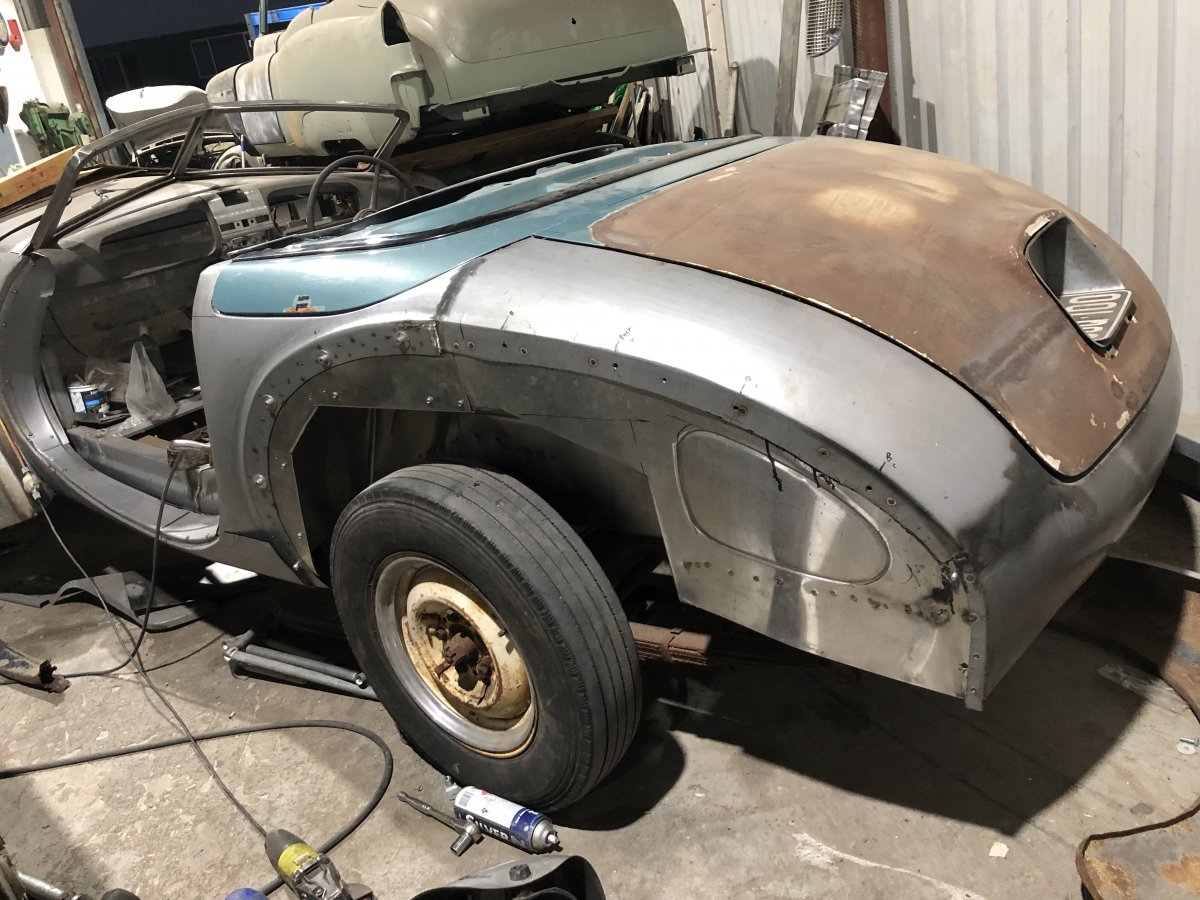

  14. CadMad
    Posts: 886
    CadMad

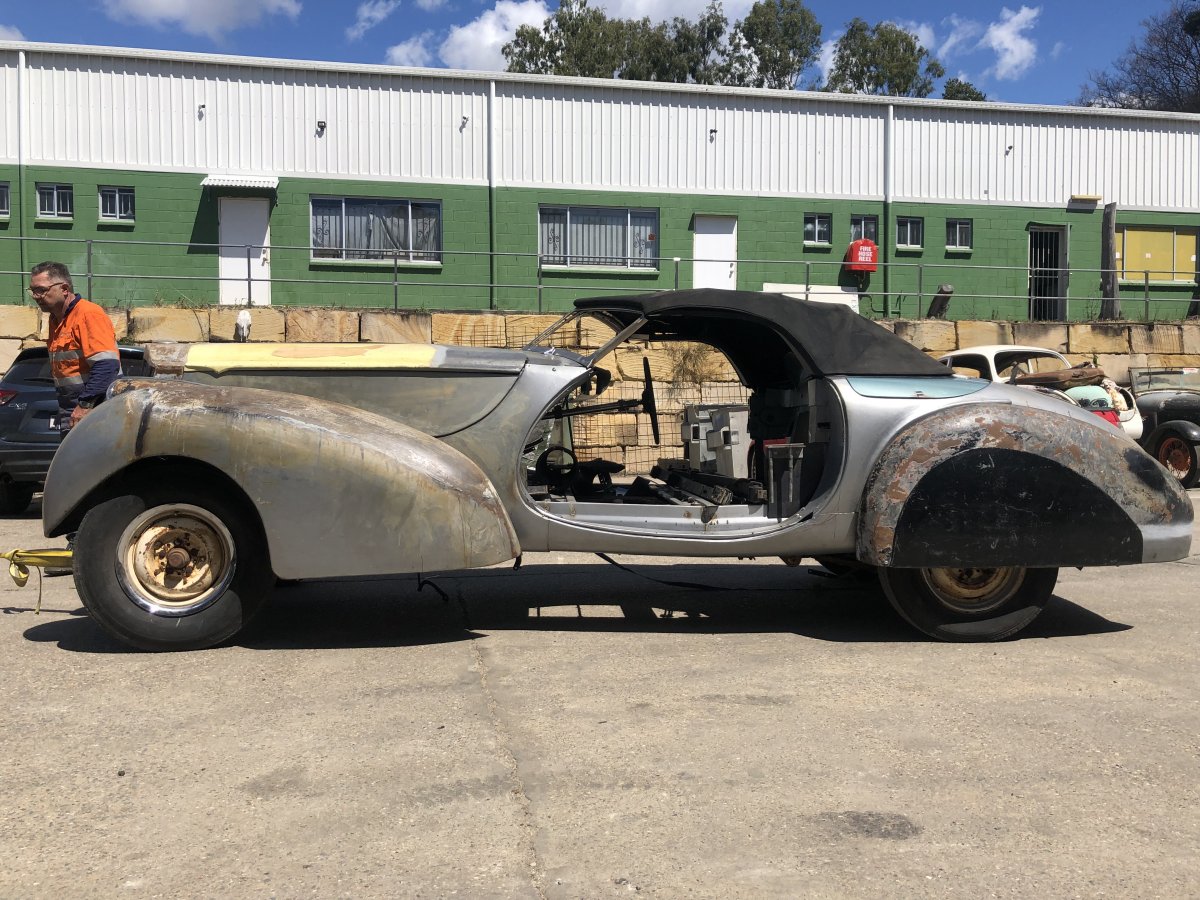

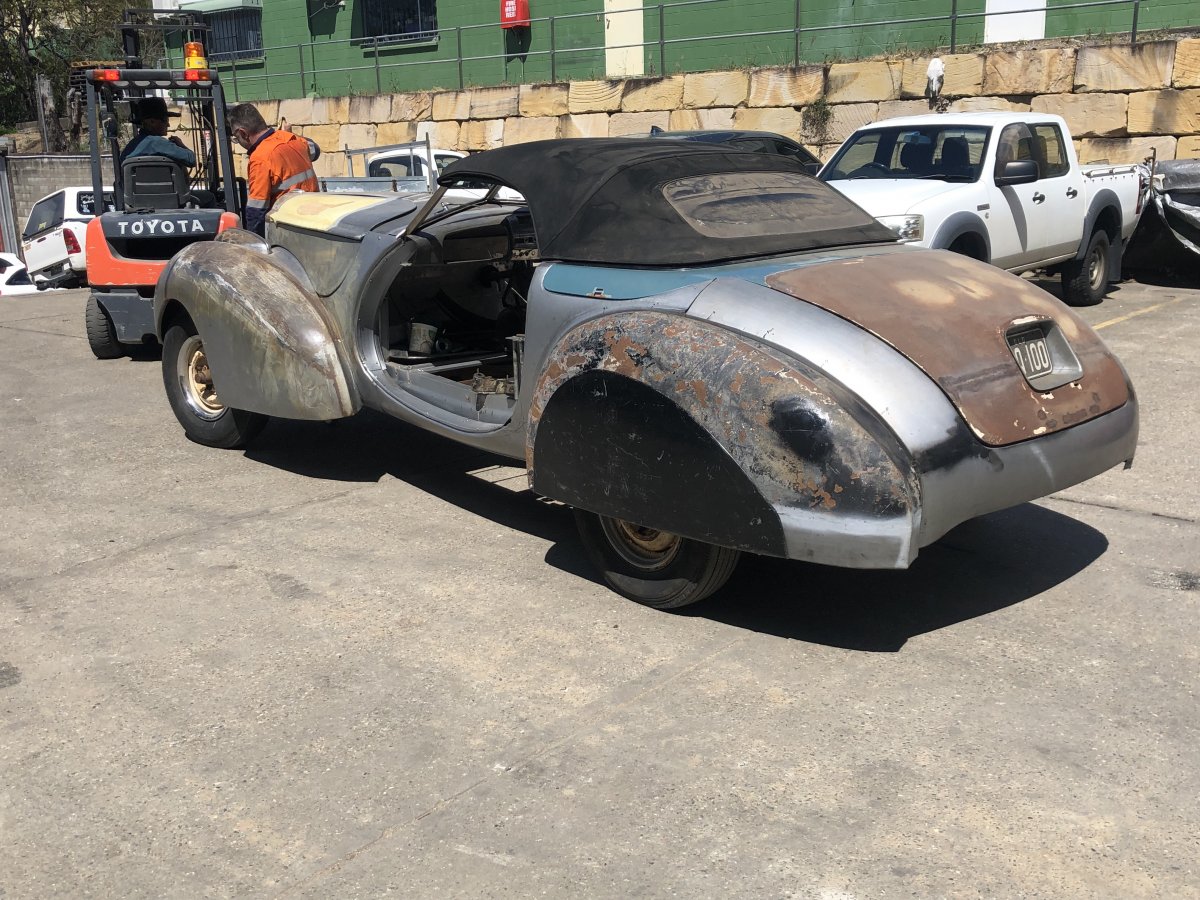

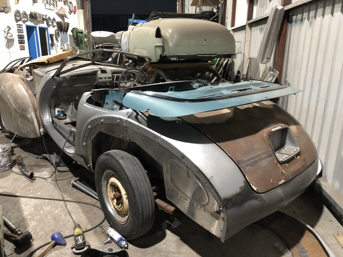

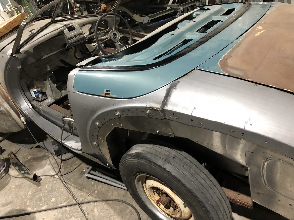

    BF461CBB-69A7-47D3-A100-AA438156CA60.jpeg 6AFA4CEA-2408-45F8-B9BB-60DDBA8AB83B.jpeg AA10BA12-D1F5-4B16-88A0-5890ED586132.jpeg Friday night and Saturday morning and the rh side quarter is taking shape.
    40two, 36 ROKIT, GordonC and 14 others like this.

    Thanks for the update. Your vision of each and every detail is bringing this hole package together. All works and looks like its meant to be. It's grate.

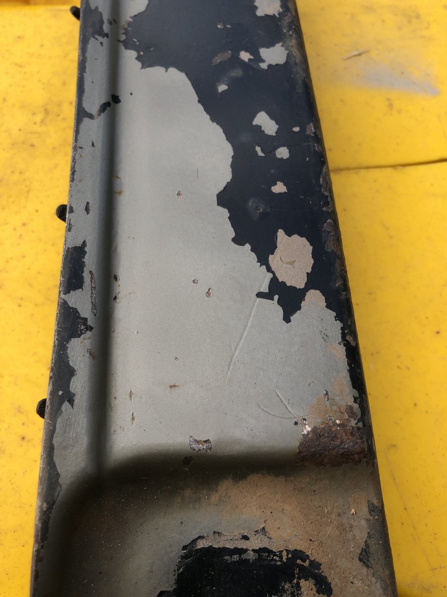

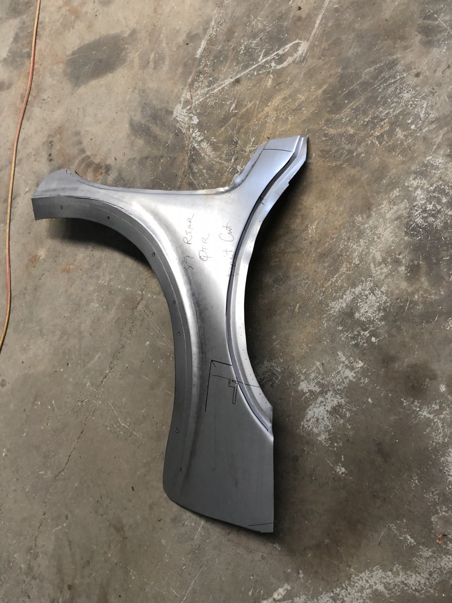

    4CBAC5C4-E8A2-4EF7-AA55-7AA8521AF868.png 0D0EBAED-B793-4129-BFA7-67280A122634.jpeg 50B8470A-4FA6-4AD3-B739-228A83630FB9.jpeg 282D1AD5-CFC2-4FF2-AEF9-5FE8C9F4479A.jpeg 374C2CC3-5941-44FC-8D42-AFC6605FCC36.jpeg EB00BDCD-1EDB-46DC-84DA-CE7B6B1FABC5.jpeg 2437B818-6A24-4D49-B6CD-95D74A614D99.jpeg 5C7A3262-1B2E-41D8-8636-BEDADF75F3CC.jpeg Been busy moving into a bigger shed. Got lots of wall space to put up some neon art. A 12ft neon woman should provide inspiration.
    My porcelain Eldorado Milk Bar sign is dated 1956.
    Yesterday I discovered the original colour of my Packard on the remains of the B pillar. Havana Beige. Perfect.

    That's some serious metal shaping on those quarter pieces!

    SR100
    Is that early Havana Beige or late Havana Beige, and more importantly, are you going to use it?
    I'm guessing that this is a Sherwin-Williams color chart whose colors have darkened.

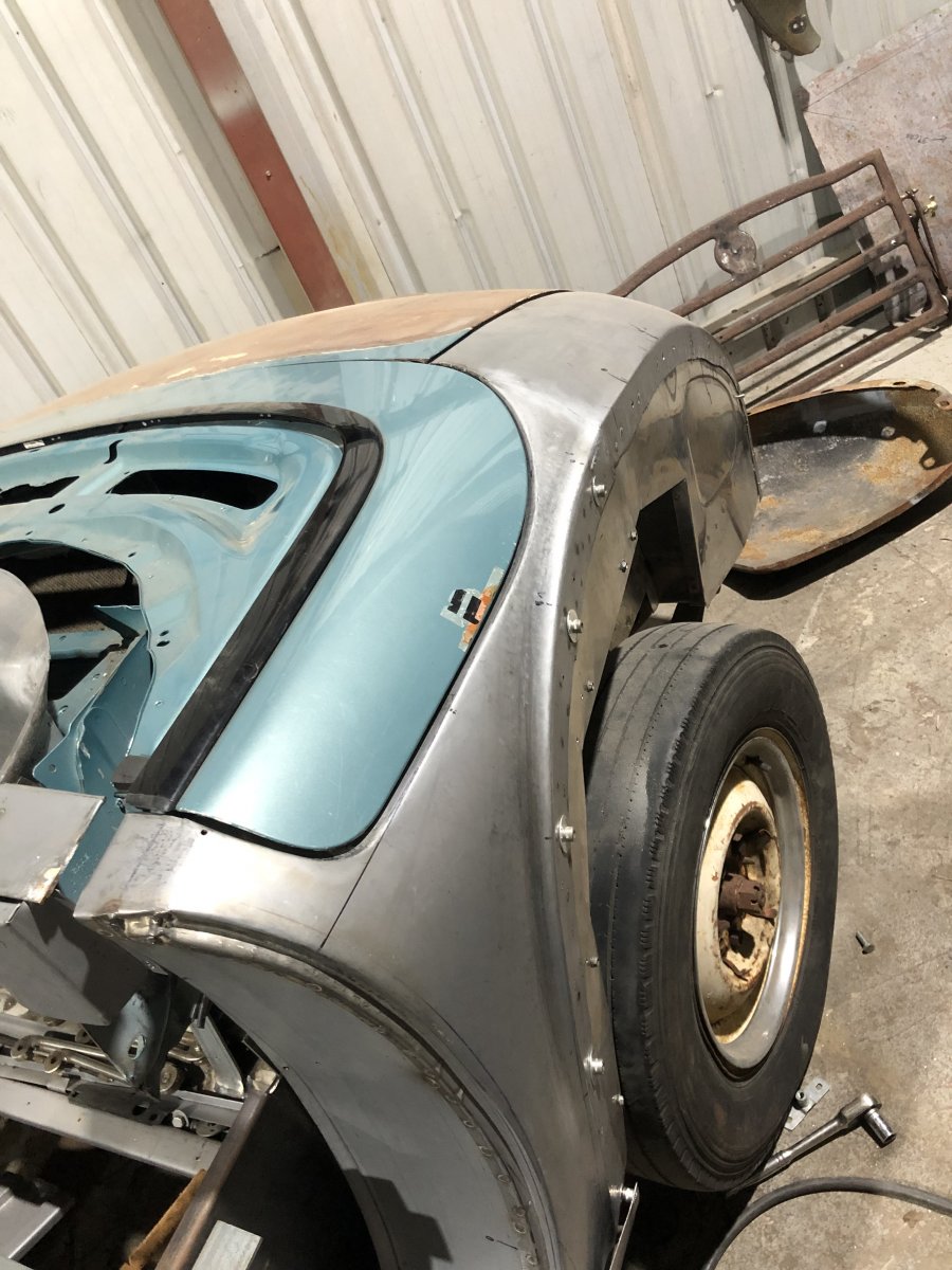

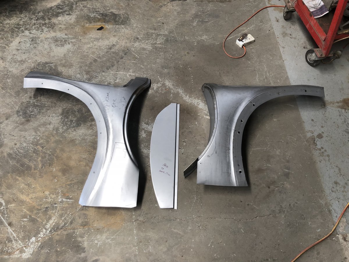

    24F299CE-5008-4DC9-A635-10A4D239DB37.jpeg D1AB1613-73BC-4368-92F9-6D75BFFBA073.jpeg 84D7E752-7924-418F-B9FB-35218DE78E9F.jpeg 93C930EB-35C4-4E52-9FC4-4B6E10AA2712.jpeg Forward rear quarters have just been screwed in place whilst I work out the details. But tonight I was finally able to weld the lh in. I might be lucky (or it could be skill), welding it in brought the gaps in perfect. Other side tomorrow night.

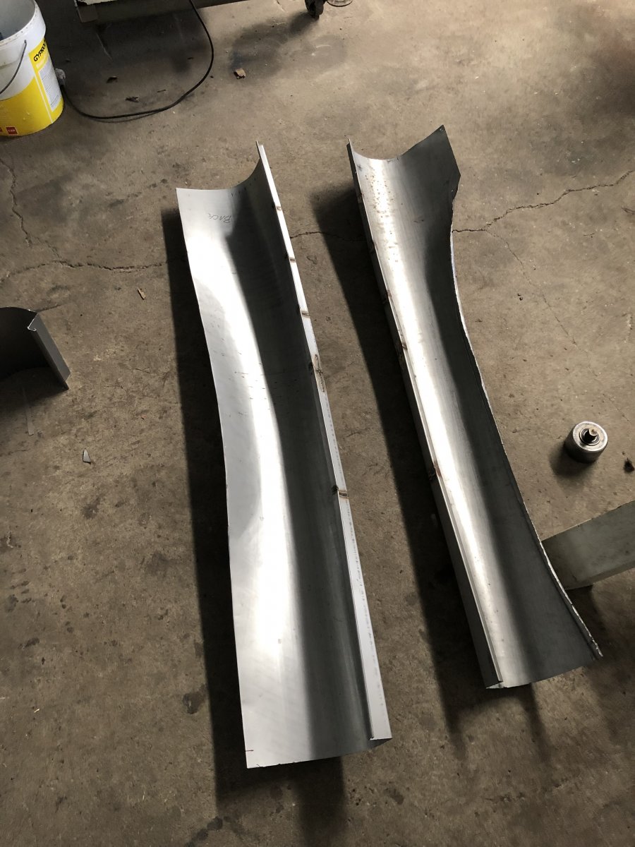

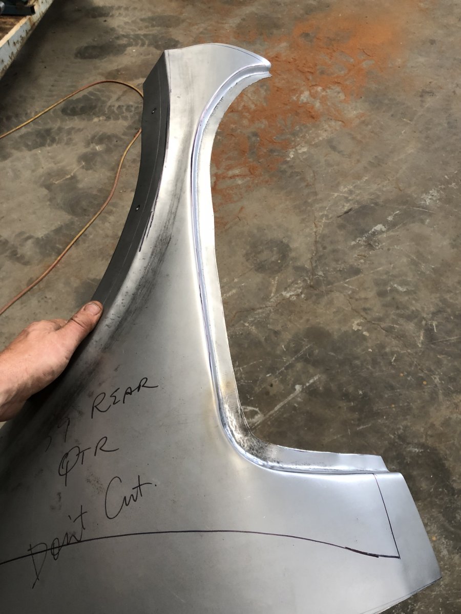

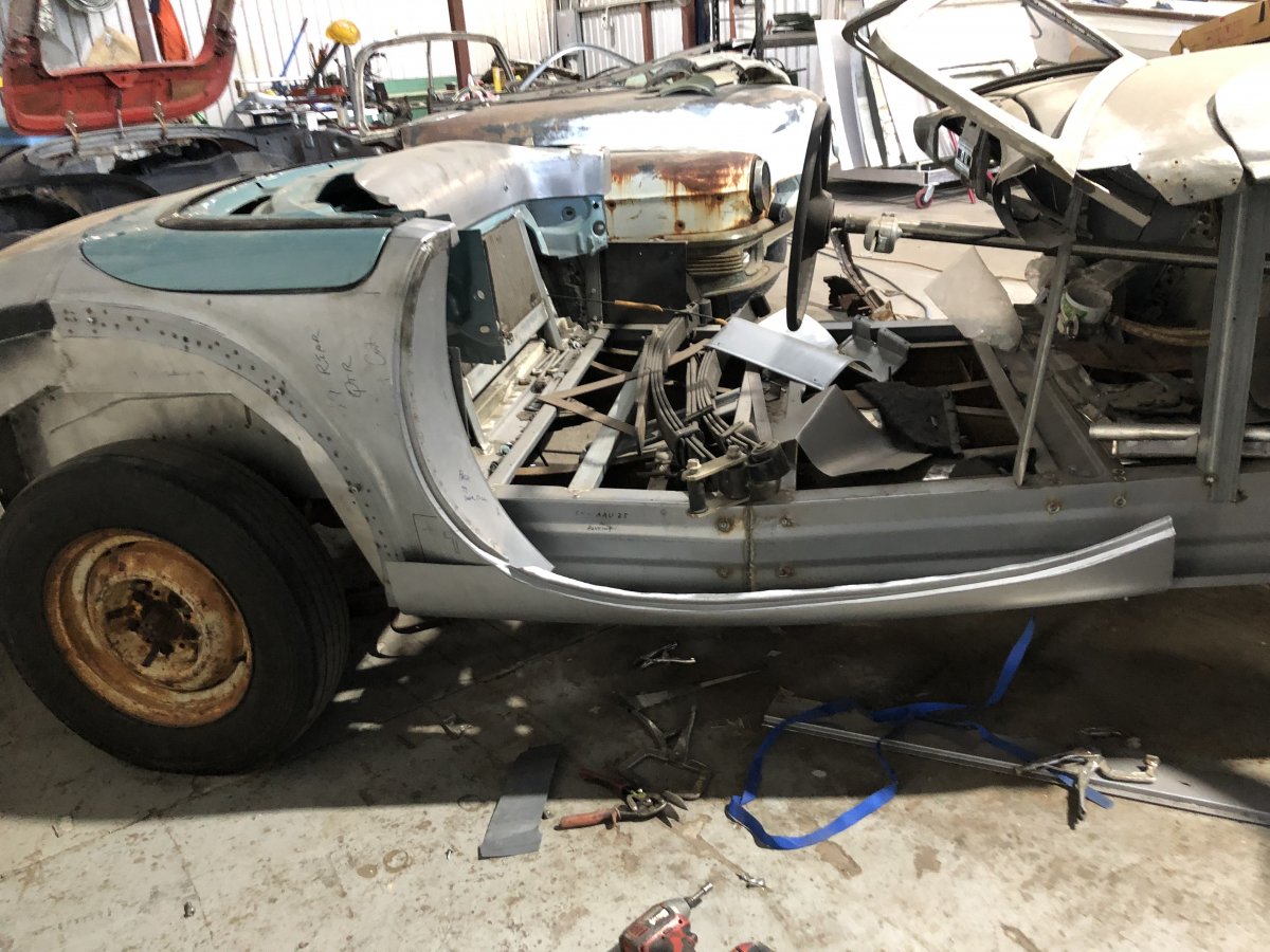

    204C0A50-FB8C-494F-B9B6-E82473784D9D.jpeg 6B74C0A7-1D1D-466E-A005-B5BC3BF00D0F.jpeg Rolled up the rh side sill. It came together easy. I took a limo template off the other side and then worried that the alignment might be an issue ... but my worry was in vain. Fits perfectly. Might get cowl side underway tomorrow.

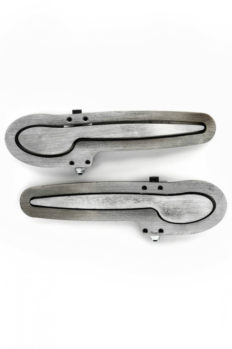

  30. CadMad
    Posts: 886
    CadMad

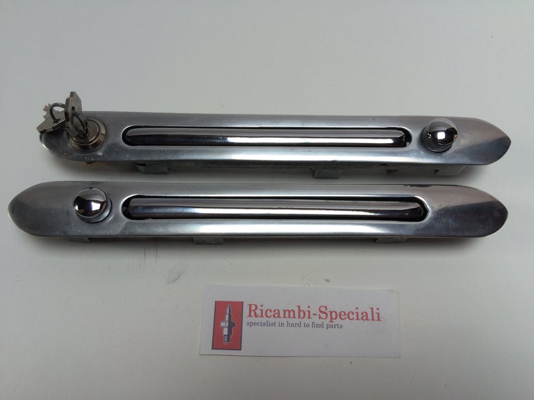

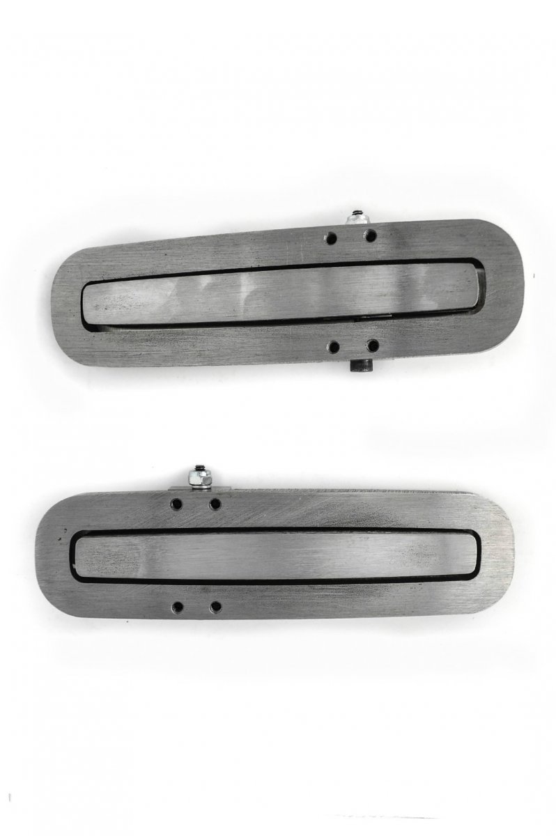

    64EA4743-37C3-4937-A3EA-BD635D10F881.jpeg 267965F7-7BBE-463F-B411-F67C8968C92D.png 50B91A9C-BA17-4F31-A73B-806AD0F51549.jpeg 4D82E5EA-0792-4255-B3F4-E2F19137FF45.jpeg After the handles discussion came up I googled Aston Martin handles and Tesla handles and these Zagatto Alfa, Fiat , Arbath , Aston handles came up. Which lead to the Kindig handles.
    I do like the idea of hiding a handle in the door swage. But I would make them follow the shape of the swage. ... or I just dig out my Lincoln ****ons. Delahaye sand Talbots used ****ons even Harley Earl changed the Yjob handles to ****ons.
