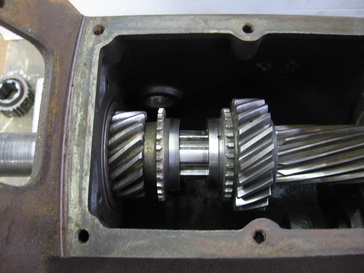

    Hi, I agree with your comments on the later type. I will double check tomorrow but the syncro sleeve I replaced was marked/polished on the front edge and this is what I think produces the noise - rubbing against the cluster. This is a 1939 trans that could have either early or late style syncro .

    Excuse my questions, as I’m still learning about these transmissions ;
    I’m curious as to what you mean by ‘small syncro’ ?
    From the way you describe it , and pictures, it appears that you have all ‘36 parts, or am I wrong ?

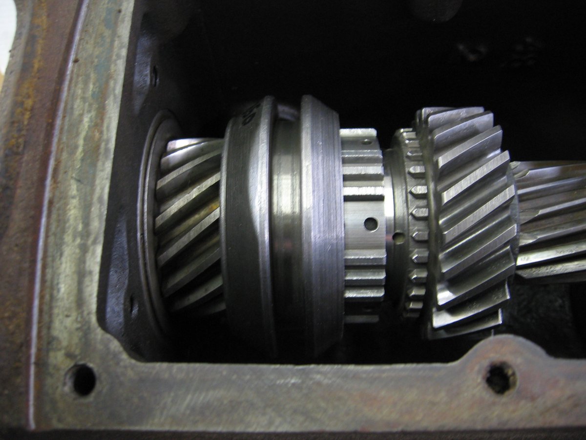

    I would ***ume that you’ve had this transmission apart since you mentioned replacing the synchro sleeve. The question I have is not answered by the pictures......was the synchro hub reinstalled correctly? They have a sort of snout on one side, which should face forward. And of course, there should be no snap ring fitted in front of the synchro ***embly.
    The shifter levers from 1936-39 have a straight vertical profile when viewed from the side. If the lever was bent slightly (below the pivot ball) it would position the synchro sleeve incorrectly.
    Just trying to help look at possibilities..... I do agree that the balls appear to be overexposed. In fact, with the small springs under them, I’m surprised they haven’t popped out already

    I dis***embled the top from a 36 in both 2nd and 3rd gear, trans was on the ground so not level. As mentioned previously the center hub of the syncro is supposed to move with ease back and forth. I had to move it fordward with a screwdriver to simulate how you should see it in mounted since gravity kept moving it toward 2nd gear. I believe Mac, above, has valid points to check 36 trans in 2nd gear.JPG 36 trans in 3rd gear 2.JPG 36 trans in 3rd gear.JPG

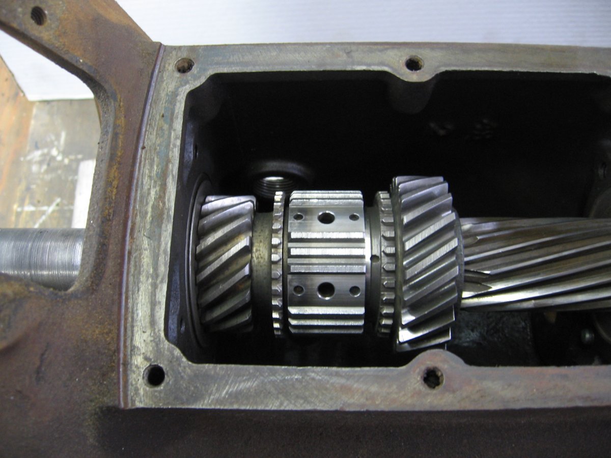

  7. Is it possible to have the Sincro Hub in Jukenut13s gear box installed on the late 39 shaft and have a snap ring installed also? This would keep it stationary and maybe be the problem.

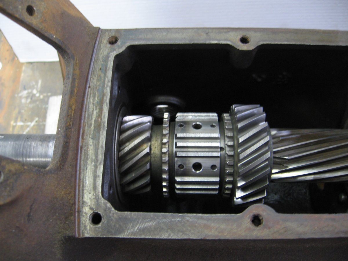

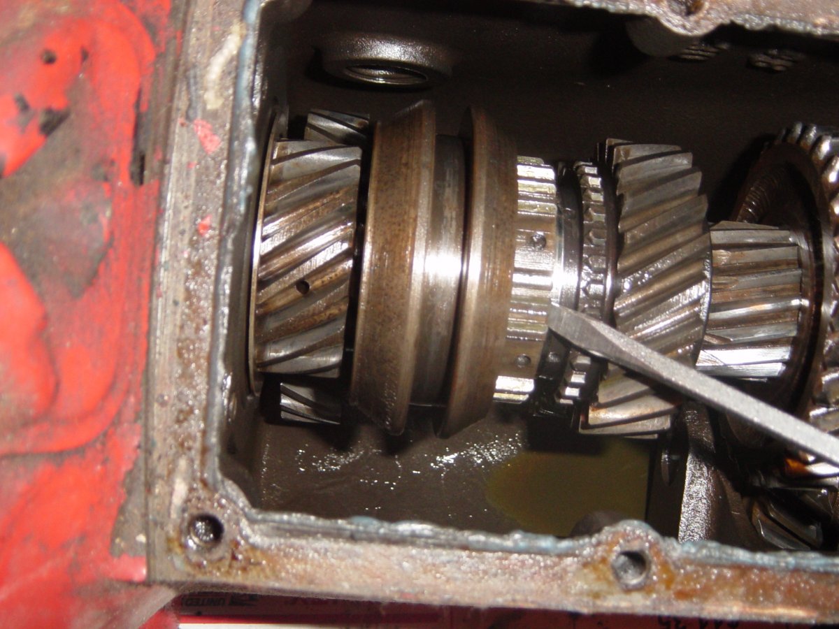

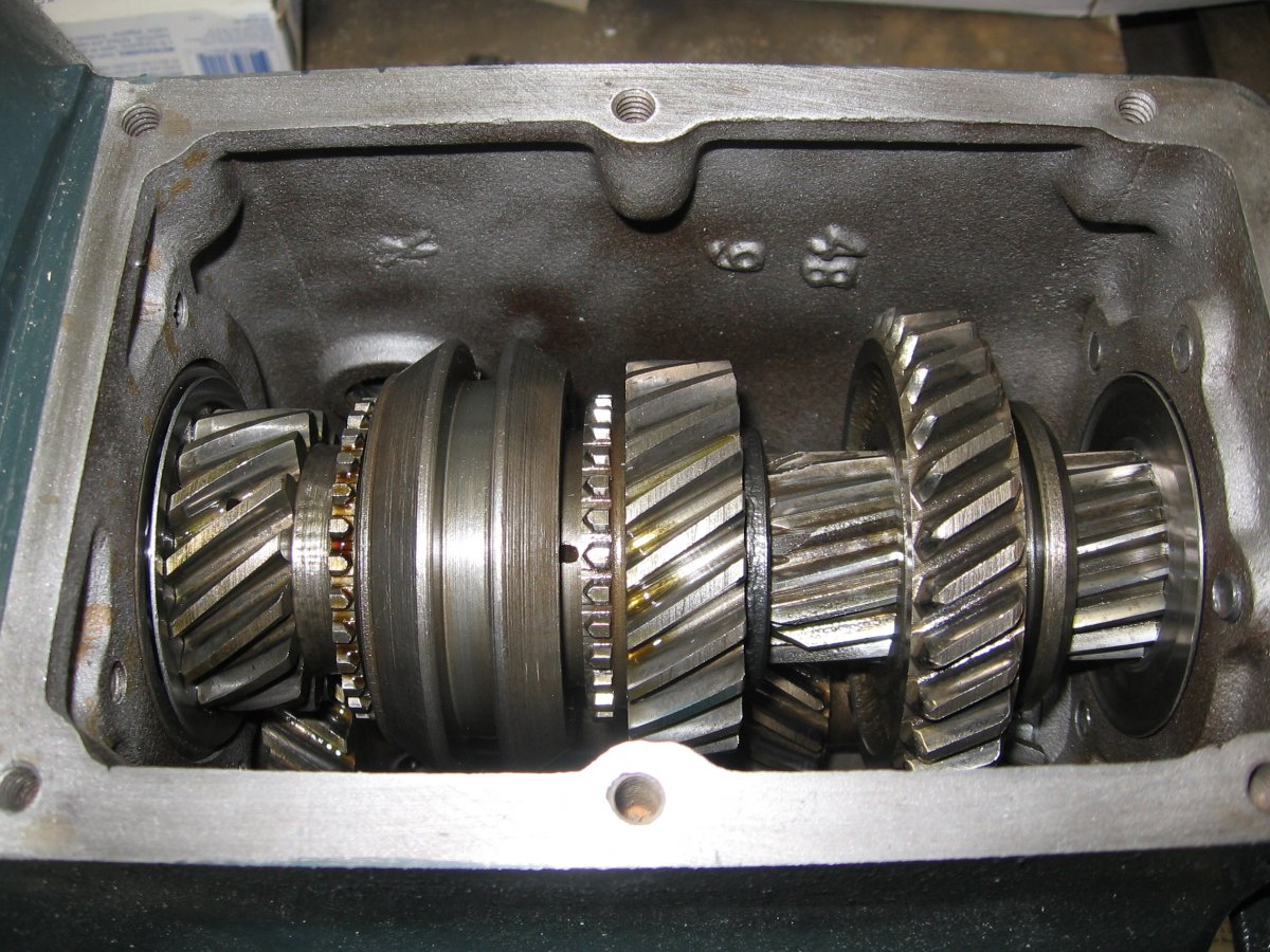

  8. 5280A2
    Joined: Sep 8, 2014
    Posts: 198
    5280A2
    He did say in his first post that he has the 68-7061B main shaft. That doesn't have the slot for the snap ring that appears with the later 81A-7061 main shaft for the late style synchro that does have a snap ring. As I mentioned in my last post I have a 38 transmission apart at the moment and took some photos that may help explain what is going on with the OP's transmission. The first two photos show the main drive and mainshaft in place without the synchro hub to illustrate the friction surfaces on the main drive gear and intermediate (second gear). The second photo shows the same thing with the hub installed and no sleeve. Based on my transmission, the hub must be able to move freely approximately 1/8-inch forward and backward to make contact with the friction surfaces on the main drive gear and intermediate gear. In the second photo the hub is engaged with the intermediate gear, note that part of the main drive (high) gear friction surface is visible with the hub in this position.

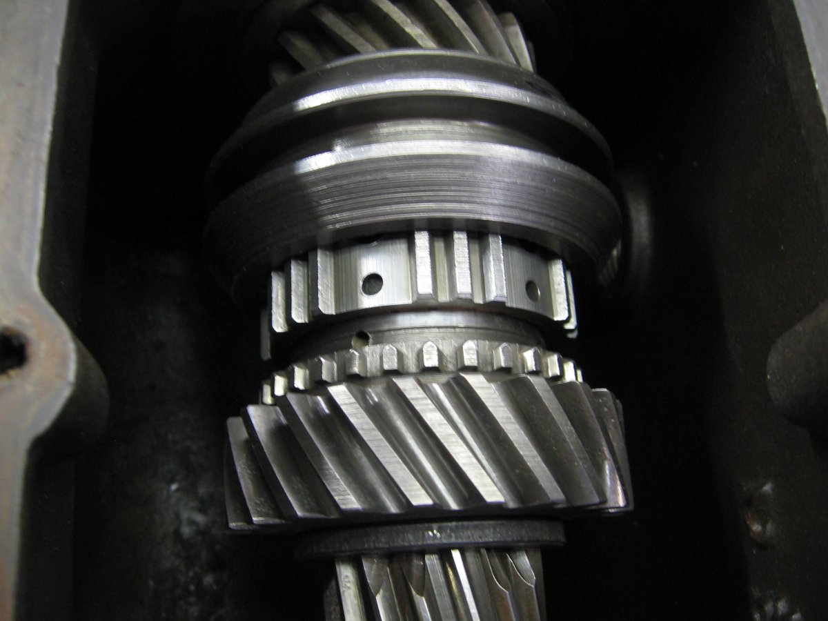

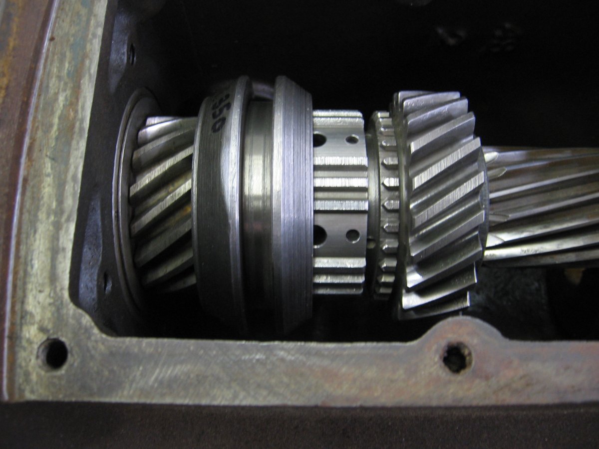

    The next photo shows the hub engaged with the main drive gear (high gear) and you can see how much the hub has moved forward by comparing the position relative to the intermediate gear, and you can see that part of the friction surface of that gear is now visible. As mentioned above, total travel of the hub on the main shaft is about 1/8 inch.
    The next two photos show the correct position of the hub and sleeve with the hub in contact with the main drive gear and the sleeve in the high gear position. Note that the synchro balls are still covered when the hub is in contact with the main drive (high) gear.
    The last two photos show the hub in its rearmost position, touching or nearly touching the intermediate gear friction surface with the sleeve engaged with the main drive (high) gear. Under these conditions the synchro balls would be nearly exposed as shown in the photos of the OP's transmission when the top is removed with the transmission in high gear.
    To me this is pretty clear evidence that the problem with the OP's transmission is that the synchro hub is not moving as it should when shifting into high gear. With the transmission in high gear the synchro hub and intermediate gear will be moving at different speeds, and that could be the source of the noise being heard. In my last post I suggested trying to pry the hub forward when the transmission is in high gear. I suppose it is possible that the hub is too bound up on the shaft to accomplish that. I have found that although the hub can be installed in six different positions (six splines on the shaft) some positions will be tight and some will be looser. I always try the hub in each of the six possible positions and mark it for the position where it moves most freely. The splines need to be checked carefully for any nicks or burrs that keep the hub from sliding back and forth on the shaft; it is only the tension provided by the six springs and balls between the hub and sleeve that allow the hub to slide along the shaft while shifting. Again, I would check to see if your hub is sliding on the main shaft as it should.

    Great picture posts above and good comments about the positioning of the gears. I’m not in the shop to take similar pictures re the synchro hub, but I did want the OP to check his hub for the correct orientation. My picture here of the early hub shows the back side (the side that faces the 7103 second gear). The front side, not pictured here, has more of a snout which faces forward.
    http://www.vanpeltsales.com/FH_web/FH_images/Trans parts pics/B-7108hub.jpg

    Great question! I have a lot more experience with the early parts so I'm not sure I can speak to the late style with much first hand authority. My driving experience with the late synchros is mostly a stock 1948 tudor with a side shift box and column shift; not too racy. My primary experience is with a 1936 gear set in a Model B gearbox behind a hopped up four banger in the roadster pickup in my avatar. Based on my experience with that I think the early style gear boxes are under-rated by most hot rodders. I have been using and abusing that gearbox since 2009 and it still shifts crisply and I can downshift into second gear at 35-40 miles per hour if I give the synchros a second or two to work before completing the shift. I have to say I have been very happy with the way it performs.
    I have built a few of the 39 style transmissions and ended up selling them without ever running one myself. The first one I sold was one of two I built for something to do over the winter here in lovely subarctic Minnesota. I did one 1936 transmission and one 1939 transmission and ended up keeping the early one for a future project. The other one sold quickly here on the HAMB and ultimately led to to other folks contacting me about building transmissions for their projects, which I did, and which used up all my late parts. So now I'm stuck with the "inferior" early transmissions and parts.
    I just put another B transmission with early gears behind a hopped up B motor in a 1930 coupe I bought last May. I expect that to be just as good as the one in my pickup. I've been lucky enough to find good early parts including a couple of NOS synchro hubs, so I think that has helped make the transmissions work as they are supposed to. The trick to both the early and late transmissions is to ***emble them with good parts, new bearings, and proper clearances so they work the way they were designed. Good detents in the synchros and shifters are very important and relatively cheap and easy to replace. So long story short, I'm satisfied with the early style 'cause I don't know any better and I'm too cheap to find out otherwise........

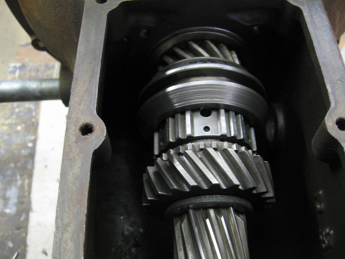

    If you take a look at Mac VP post above you can see the br*** syncro ring inside the early style small syncro hub. There is an identical ring on the other side of the hub. The br*** rings are swedged into the hub and should not rotate in the hub.

    Well, today I removed the trans. On the bench, checked the syncro hub and it slide back and forth nice and easy in all positions about 1/8'' . Put it in in gear using the lever, looked correct with no problem. I have not stripped it as yet as thoughts kept going back to previous owner saying there was no faults but I noticed these from the start. There is some play in the main drive gear, you can wobble the shaft somewhat. When doing this plus rotating and sliding the syncro by hand ,the hub sticks a little and dose'nt go all the way on the friction surface untill you relax any side pressure on the main drive gear.
    So , is this an alignment problem in the main drive gear, the hub sticking and getting left behind allowing the balls to be exposed and slowly forcing the sleeve forward - there appears to be shiney marks on the sleeve front lip from the cluster (hard to see). The noise can take a while to appear at times.
    It was awhile ago when I fitted the Clings kit - which are great, but think I have fitted their adapter and have a runout problem causing the maindrive gear to be out of alignment?
    I fitted a pointer on the flywheel and found about 45thou runout between top and bottom of the machined face - see photo.
    The trans. is doweled to the adapter but I will have to see if the adapter will move slightly in relation to the flywheel housing?
