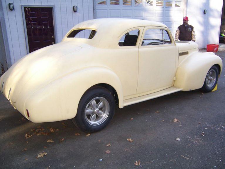

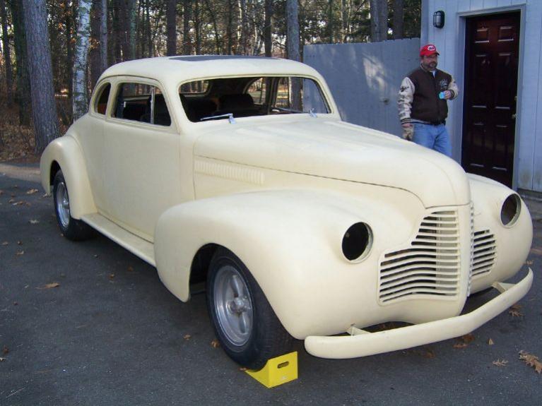

    Here's a few pic's of my 40 Buick Coupe. Chopped 2 3/4", 59 chevy dash, power windows,doorvents and cowl vent. Small block chev turbo 400.
