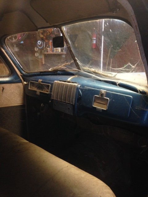

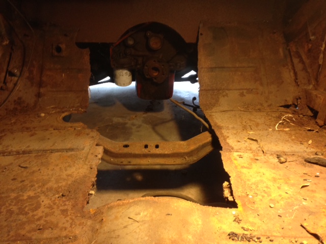

    A very generous friend just gave me one of his project cars, a pretty solid partially completed 1940 sedan. The previous owner welded a '69 nova subframe on. They hung. 454 2bolt motor in it as well. The car needs a new transmission tunnel welded in and some patches for the floor. My plan is to clean up the big block (hopefully just rings and seals) run a simple wiring harness and update the front brakes to discs. It's been re-painted at some point so I'm considering some traditional or original colors or maybe just leave it as is. One great surprise was a rebuilt TH400 in the trunk along with a tilt steering column out of a Chevy truck and a limited slip 10 bolt under the rear. All in all its a great place to start. The interior was partially re-done with strange velour but the front seat is all original white "leather" I think. I'll upload some photos as soon as I can, looking for any advice you have on a radiator and how to make the big block work in that tiny engine bay.

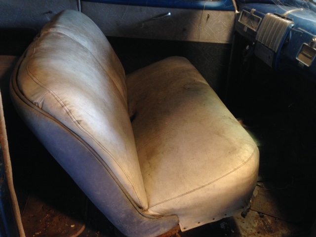

    make sure what the engine is. so you get the correct flexplate, etc. 454 has a weight, 396-402-427 don't.
    That seat has been reupholstered, it was most likely mohair originally.

    Thanks for the insight, in that case I feel better about re-apolstring it. To be honest it's pretty ugly.

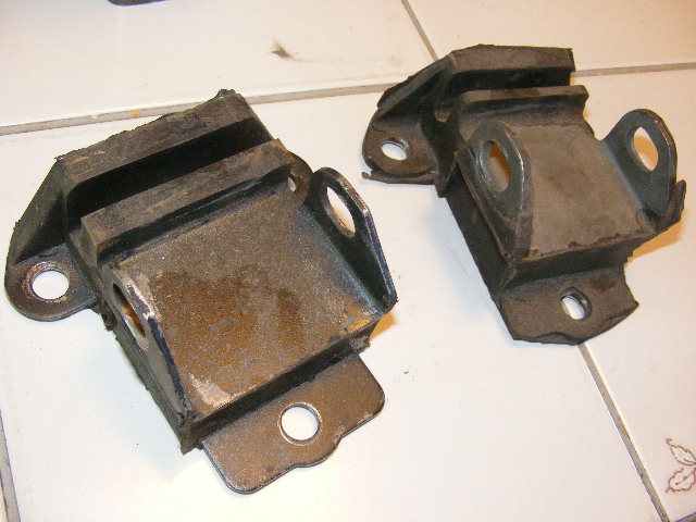

    See below for the drivers side motor mount situation. Looks non-OEM to me....Any thoughts? The Motor mounts on the block look like aftermarket solid mounts like those sold through JEGS etc. but the lower ones look like they were removed from either this or another vehicle and then re-located with that piece of plate.
  25. jp52
    Joined: Apr 17, 2011
    Posts: 120
    jp52
    here is the p***enger side.
  26. jp52
    Posts: 120
    jp52
    it almost looks like they were trying to push the motor back with those plates...
  27. Those are OEM mounts, just different eras. The ch***is mount is designed for insulated engine mount(60's) and the steel engine mount you have was from 70's and later, for a rubber insulated ch***is mount. You'll have to pick one style and go with it.

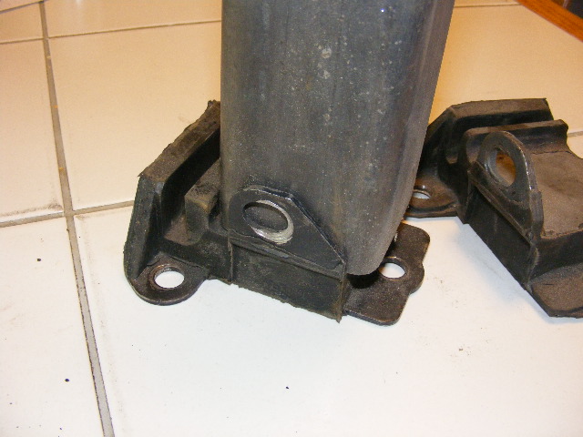

  28. brigrat
    Joined: Nov 9, 2007
    Posts: 6,108
    brigrat
    from Wa.St.

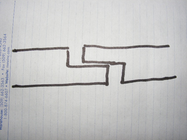

    DSCF7962.JPG I hate to keep harping on this but NOW is the time to fix that front suspension, not after you get your trans/motor established. You don't have to cut it off completely, here's very crude sketch of how I have done it. Looks to be about an inch or so off. I would look for a stock core/radiator support, that piece is the secret to getting your front sheet metal lined up. After that's installed modify as needed......................................
  29. squirrel

    heh...I've never seen anyone try to do that with Chevy motor mounts! it's pretty funny.
    I'd see about buying some mounts for a 1960s era Chevy. Like I said earlier, there are a couple different thicknesses. you can probably do some googling to figure out which ones you need, or buy some and see if they fit, then if they don't, try the other ones. My guess is if you get some that would fit what was originally in the subframe, it will work.

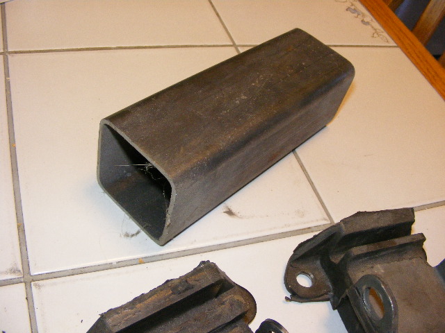

    Motor mounts; I buy this type for non racing. Can get the part number if your interested.
    Get some 2 1/2" sq. 1/8th" tubing or thicker. Bottom out to mount, mark holes, drill holes, cut to length AFTER LEVLING motor/trans.............................
