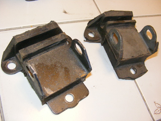

    I wanted to run this by the board. I've discovered that 68 and 69 motor mounts are different. 69 frame mounts are shorter and the motor mounts are taller. In pre 69 ones it's reversed. So looks like I have 69 frame mounts and later model (mid 70s based on the part number 0334605) motor mounts. And then that weird *** chunk of plate welded in between. I think I'm just going to cut this stuff out, clean up the crossmember and start from scratch with a pair of motor mounts and frame stands that are designed to work together.

    If you make your own motor mounts, you might want to wait on that until you get a lot of other things figured out. Putting a big engine in a smallish car means that everything has to fit just so. There are a lot of parts that want to occupy the same spots, such as exhaust/steering, fan/radiator, distributor/firewall, etc. If you get ALL the parts sitting where they belong, BEFORE you mount the engine, then you can jiggle the engine location around as needed, to make it all fit.
    just a little thing I've learned the hard way, and I continue to see others learning it the hard way here on the HAMB
