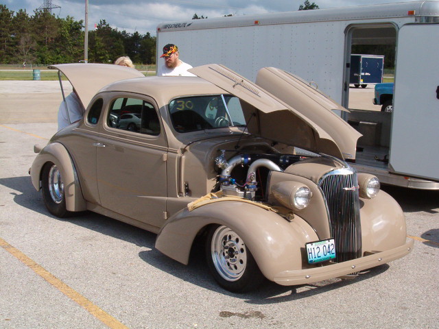

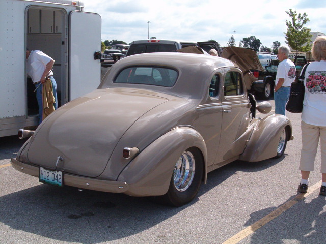

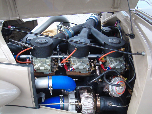

    ..that tan 37 is one of the coolest 37's ever, think Jack Stirneman (?) out of St. Louis area owns it...runs in the 10's,...he used to bring it to the Goodguy's Indy event at the last minute, unload it, blow everyone away in his hot rod drag cl***,...and then load up and leave.
    these are older pics...looks better with the new wheels, ...awesome Chevy...turbocharged 292 six.

    Awesome. Is that the chevy six with a turbo and three hollys?
  22. rusty1
    Joined: Nov 25, 2004
    Posts: 13,042
    rusty1
    ^^^Yup^^^...looks like a different carb set up now...
