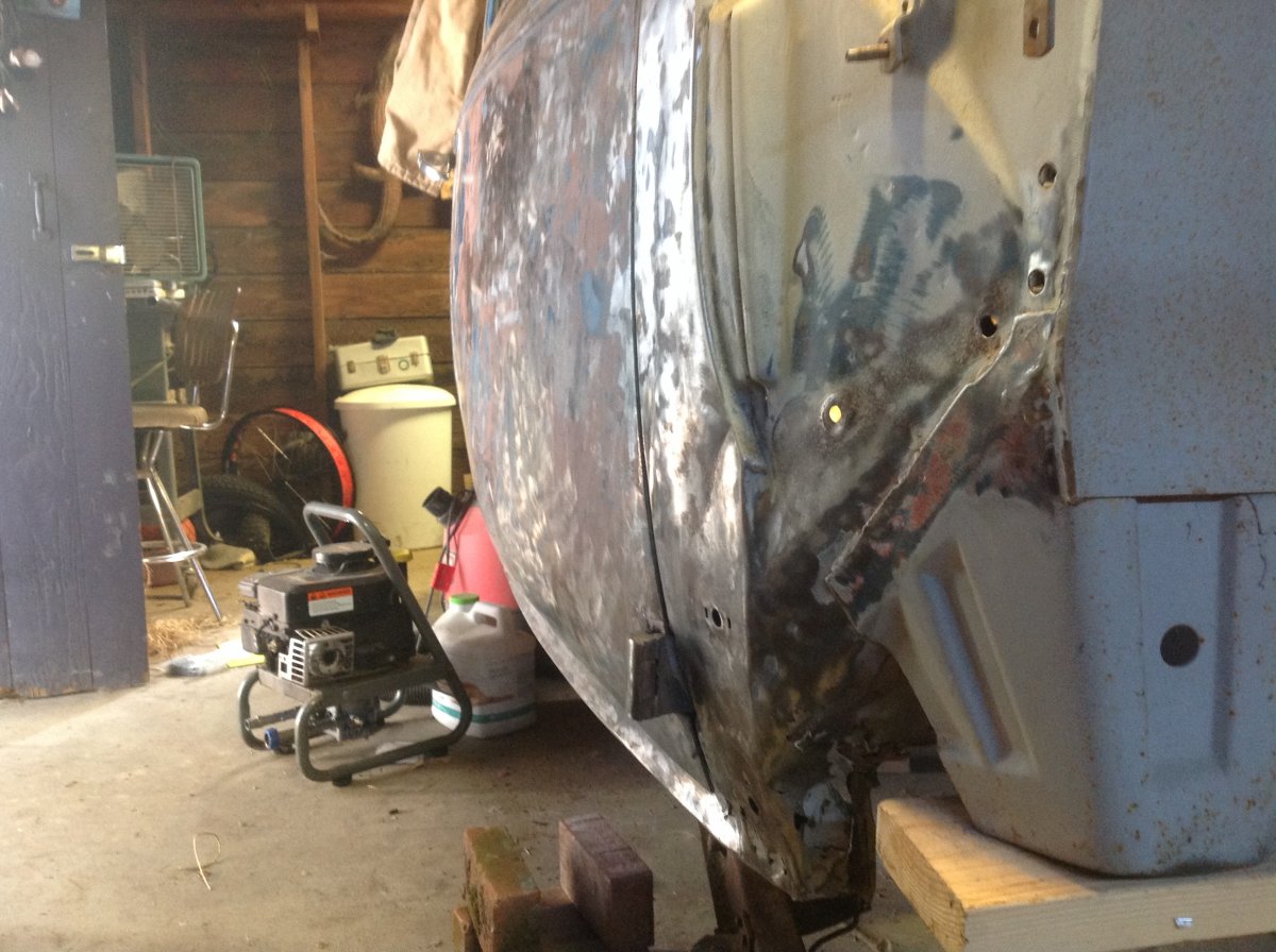

    Well I've been distracted lately but am preparing to tackle the body repair. However I've run into an issue. The profile of my doors is way off at the bottom from the rear quarters. [​IMG]
    The rest of the door looks reasonably close. I think there is some sag in the body that would account for gaps around the door but I'm flummoxed about the bottom of the door. It's the same on both sides.
  8. squirrel
    Joined: Sep 23, 2004
    Posts: 59,944
    squirrel
    take a few pics from further away...maybe show us the firewall again? If the firewall has been cut out, then the bottom of the door hinge pillars might have spread apart, causing this problem. Or if big chunks of floor are missing (or were replaced badly) that could cause it.

    With respect to the door alignment I think both doors are leaned in at the top and out at the bottom which seems easily fixable.
