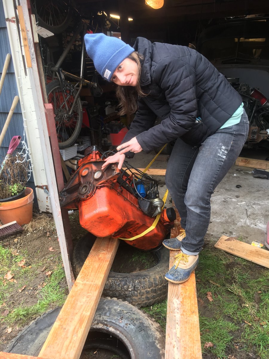

    Well it happened. I decided on a motor and bought one. Went to Lebanon yesterday with my buddy, his three year old and I took his truck out there to grab some inner rockers from The filling station and check out a straight six I found on Craigslist. The owner seemed like a nice guy, he’d pulled it for a 350 swap. It was pretty clean and he claimed ran well. Think it’s a 72. Anyway He had a hoist so we loaded it up and brought it home. However I don’t have a hoist and my neighbor who does was in the middle of an engine swap so my amazing wife and friend and I concocted a cunning plan to get the motor out. It involved 4x6s old tires and two comeallongs. It was sketchy but it worked. Now to figure out how to go from 4.3 mounts to 250
