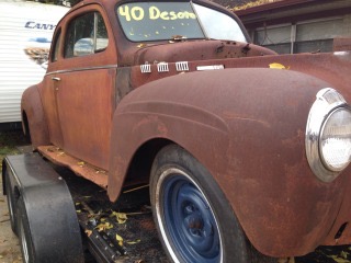

  3. txturbo
    Joined: Oct 23, 2009
    Posts: 1,771
    txturbo
    That’s the good side...lol. It has a rust spot at the bottom of the cowl and a dent in the roof from a tree. But it’s a pretty solid body. The floor and trunk pans aren’t rusted out.
  4. choptop40
    Joined: Dec 23, 2009
    Posts: 5,743
    choptop40
    I'm starting to be ok with defects...still...deep down there's the other side..always improve...Desotos rule.....

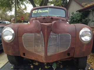

  5. gatz
    Joined: Jun 2, 2011
    Posts: 2,273
    gatz
    Great start, txturbo; 'will be watching.
    Amazing how a minimal chop can affect a car's look.
    BTW, is there a name for that "paint", moose?

  7. j hansen
    Joined: Dec 22, 2012
    Posts: 11,927
    j hansen
    ^^^^^^MoPar range is Imperial,Chrysler,De Soto ,Dodge,Plymouth.

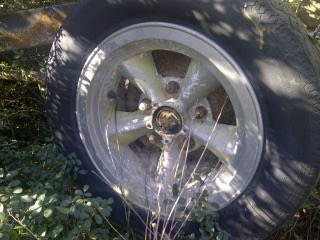

  9. txturbo
    Posts: 1,771
    txturbo
    I have two of these to put on the front. Just need to find two for the rear. These are on a 37 Ford frame I have.

  13. txturbo
    Posts: 1,771
    txturbo
    Thanks for the info.
  14. txturbo
    Posts: 1,771
    txturbo
    I have a ch***is that came from a 37 Ford Coupe that was hot rodded back in the 70s. I did a frame swap for the guy who drove the car in high school. He didn’t want the old hacked up frame and paid me to swap it out with a good all original ch***is. I saved it and just dug it out of the bushes when I moved to my new shop. I’m using the torque thrust wheels off of the front and just remembered it has a later model Ford rearend. I don’t know if it’s an 8” or 9”. I’ll have to check it when I get back home at the end of the month. So I will probably use that in the Desoto.
