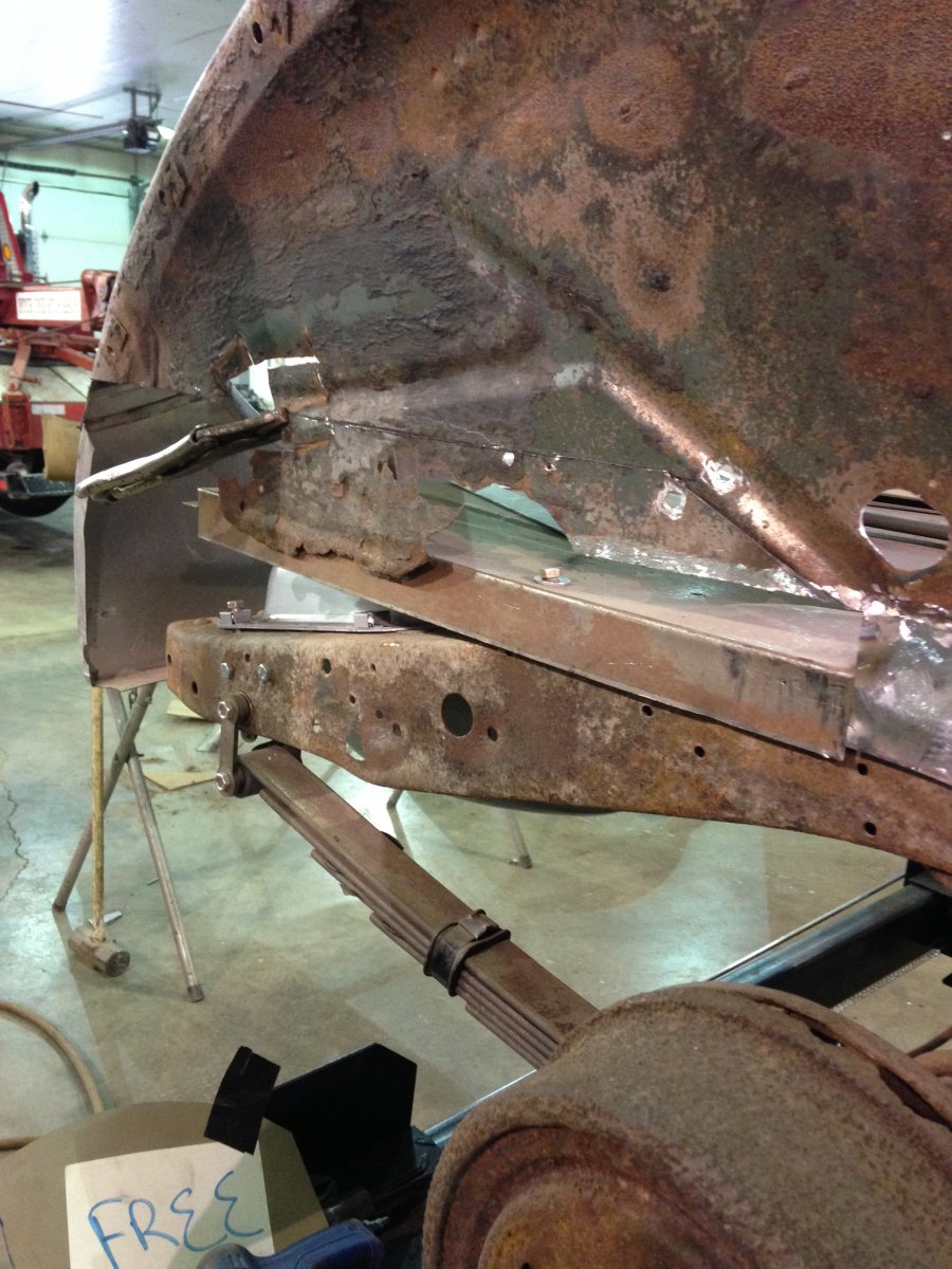

  10. newredporch
    Joined: Oct 8, 2010
    Posts: 216
    newredporch
    from pittsburgh
    I wanted to finish this today BUT ran out of welding wire. Should be able to get the tool tray started this coming week. Going to fab one up. I know it won’t look like the original but I should be able to make something look nice.

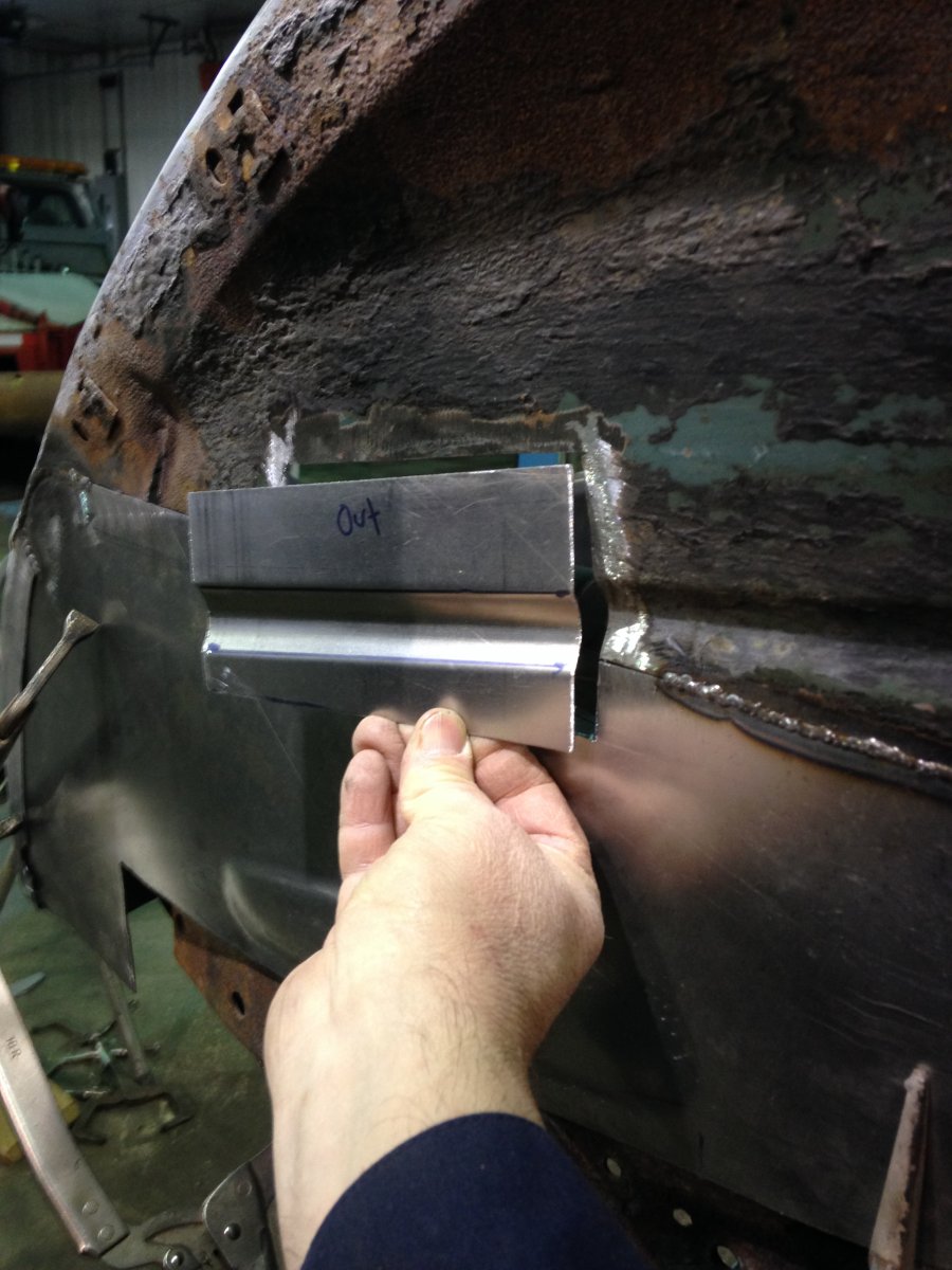

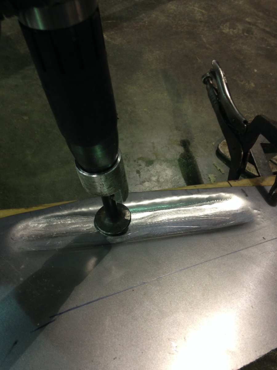

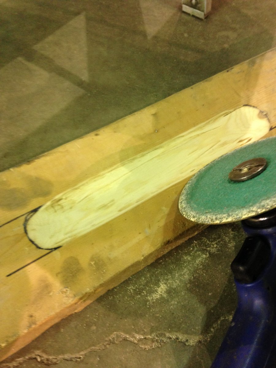

  11. newredporch
    Joined: Oct 8, 2010
    Posts: 216
    newredporch
    from pittsburgh
    41AA3FB7-2417-44F6-AD69-9C3721EB4074.jpeg ACA99F31-D749-4514-A181-2F962127BAF3.jpeg I had to make up a quick hammer form for the outward bead that provides room to get the fuel tank out. My bead roller was not big enough. This air hammer tip comes in handy for forming metal. It also works great for reforming and stretching prefabricated patch panels.

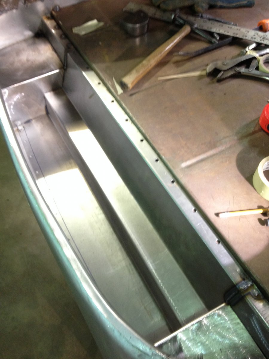

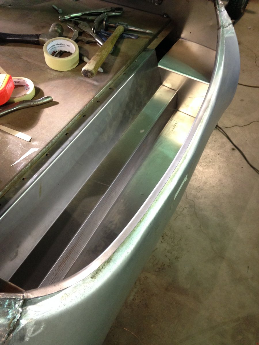

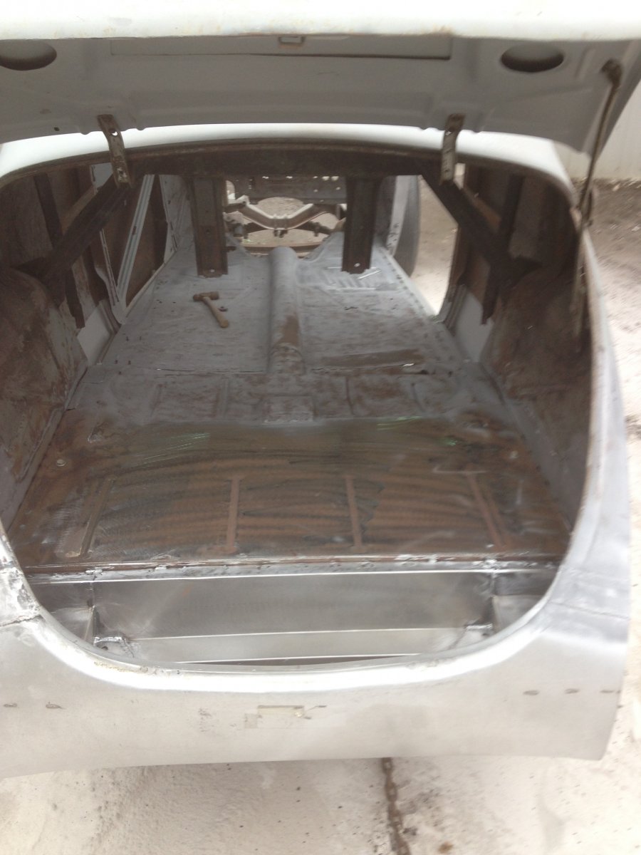

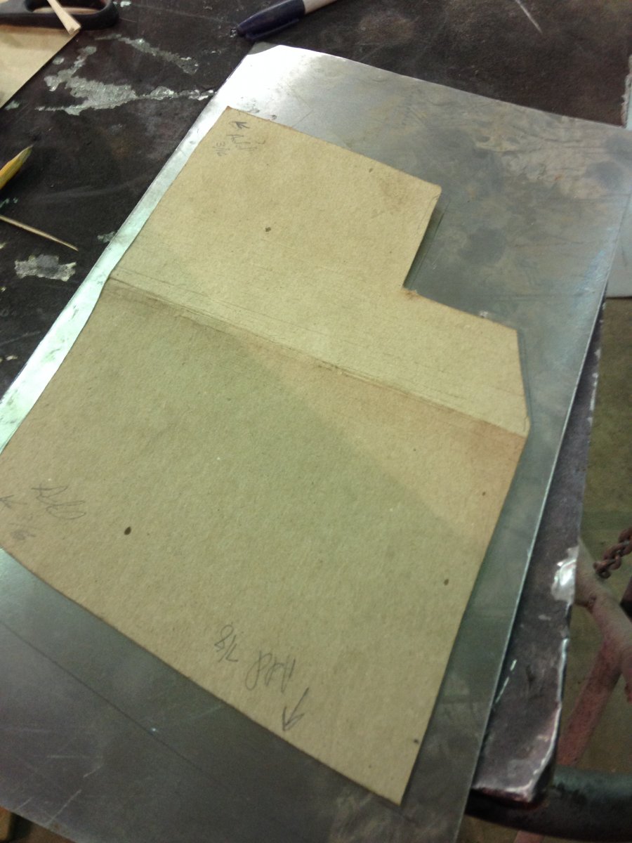

  13. newredporch
    Joined: Oct 8, 2010
    Posts: 216
    newredporch
    from pittsburgh

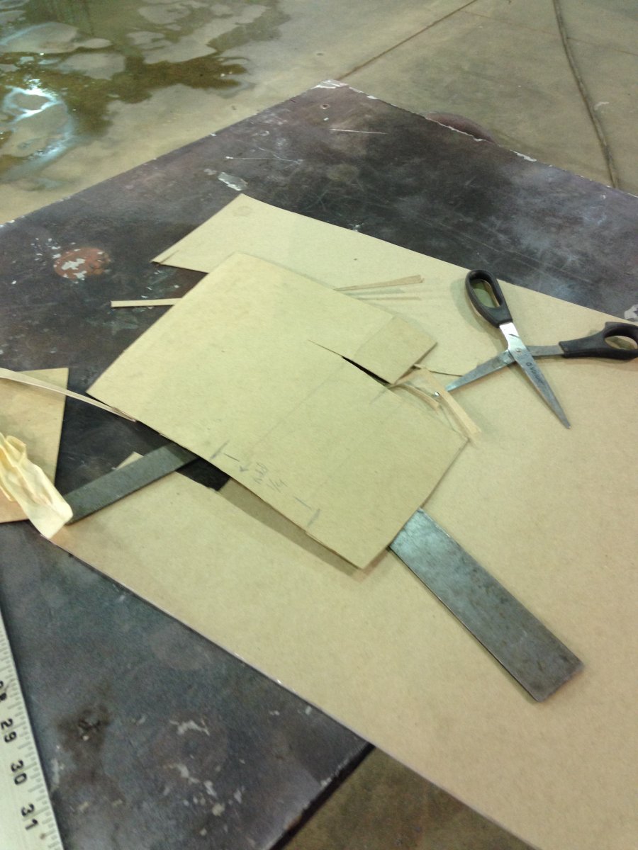

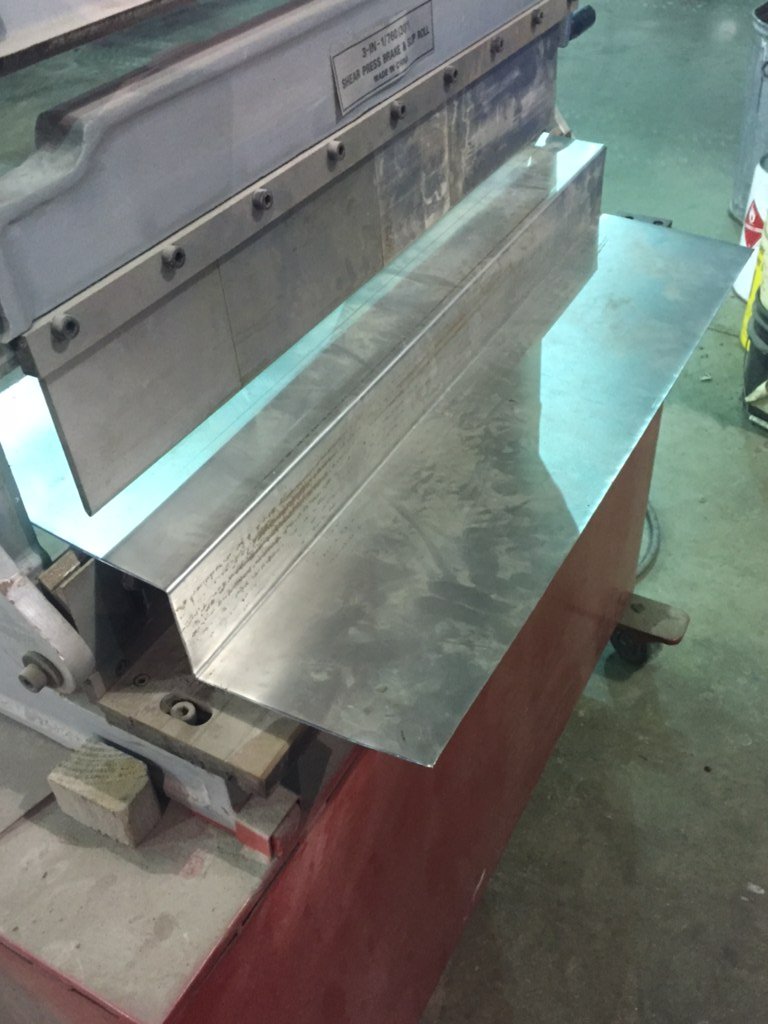

    Going to build my own tool tray. After work I hung out and started bending some metal.
  14. newredporch
    Joined: Oct 8, 2010
    Posts: 216
    newredporch
    from pittsburgh

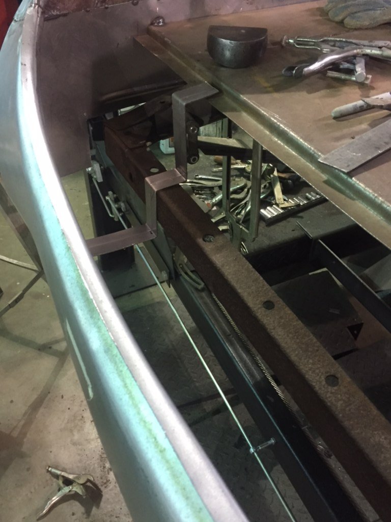

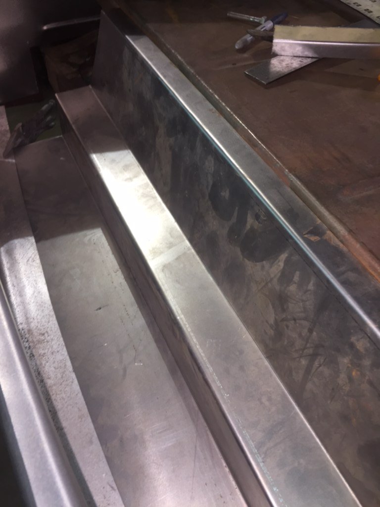

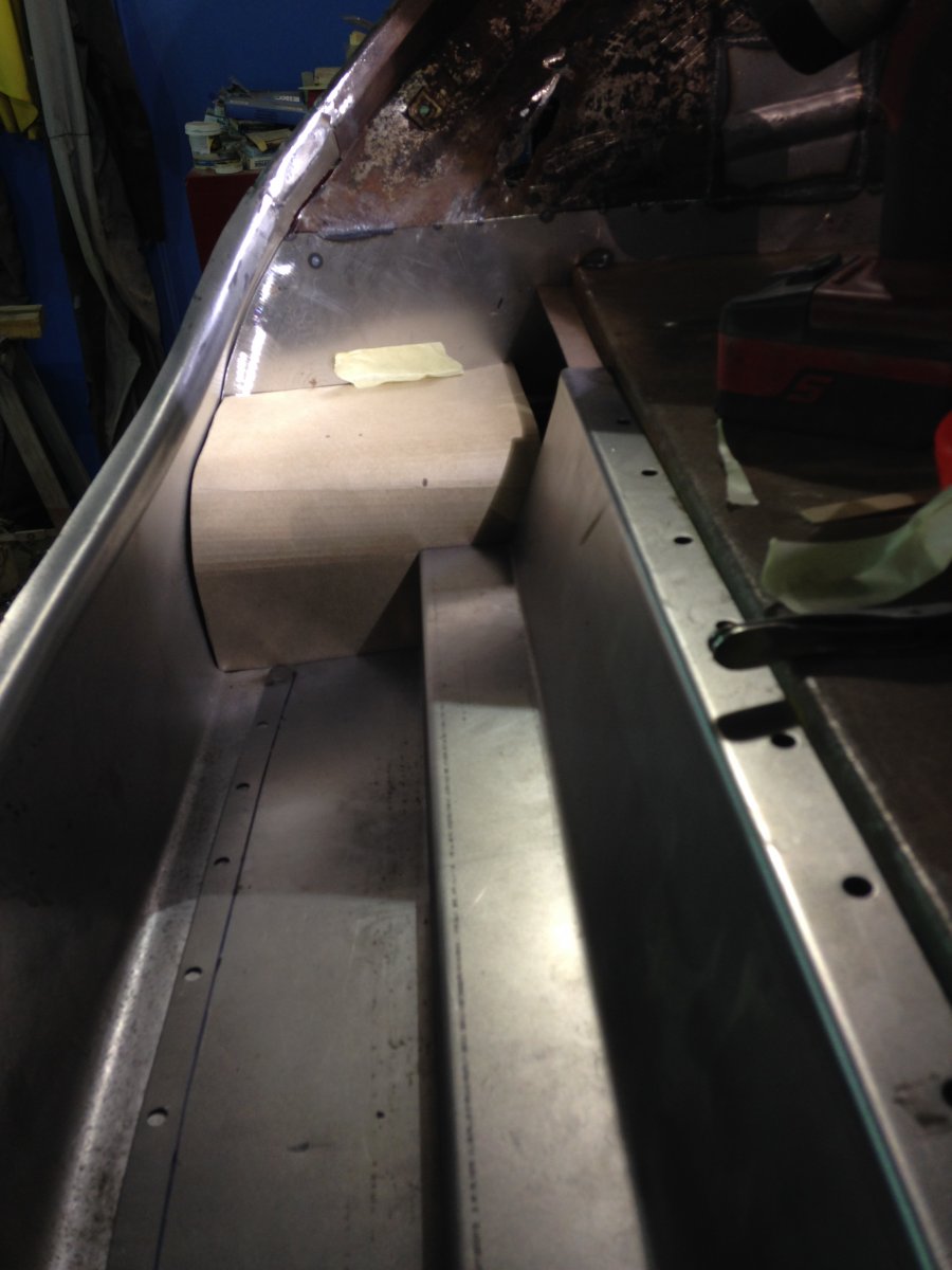

    Finished up the tin work on the tool box today and started welding. It’s nice to see the tail coming together. It was pretty ugly back there. This old thing is starting to look like a car again.

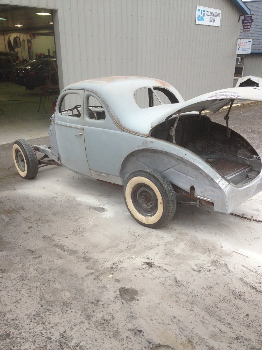

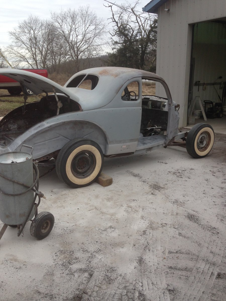

  18. newredporch
    Joined: Oct 8, 2010
    Posts: 216
    newredporch
    from pittsburgh
    I took her out for a round of sandblasting today. Things look better than I expected.
