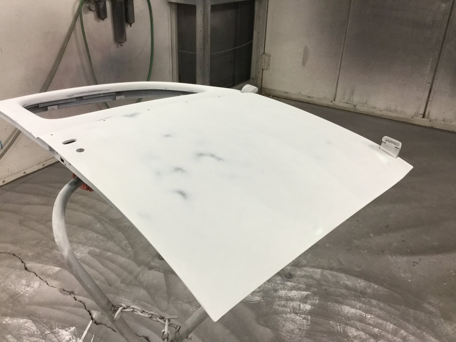

    I worked to get the reveal on the body to line up, at the door to quarter panel gap, with the shims. This probably helps with the getting the trim to line up.

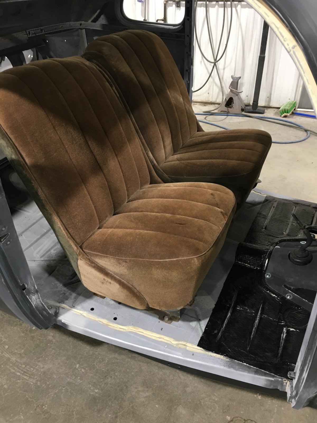

  5. newredporch
    Joined: Oct 8, 2010
    Posts: 216
    newredporch
    from pittsburgh

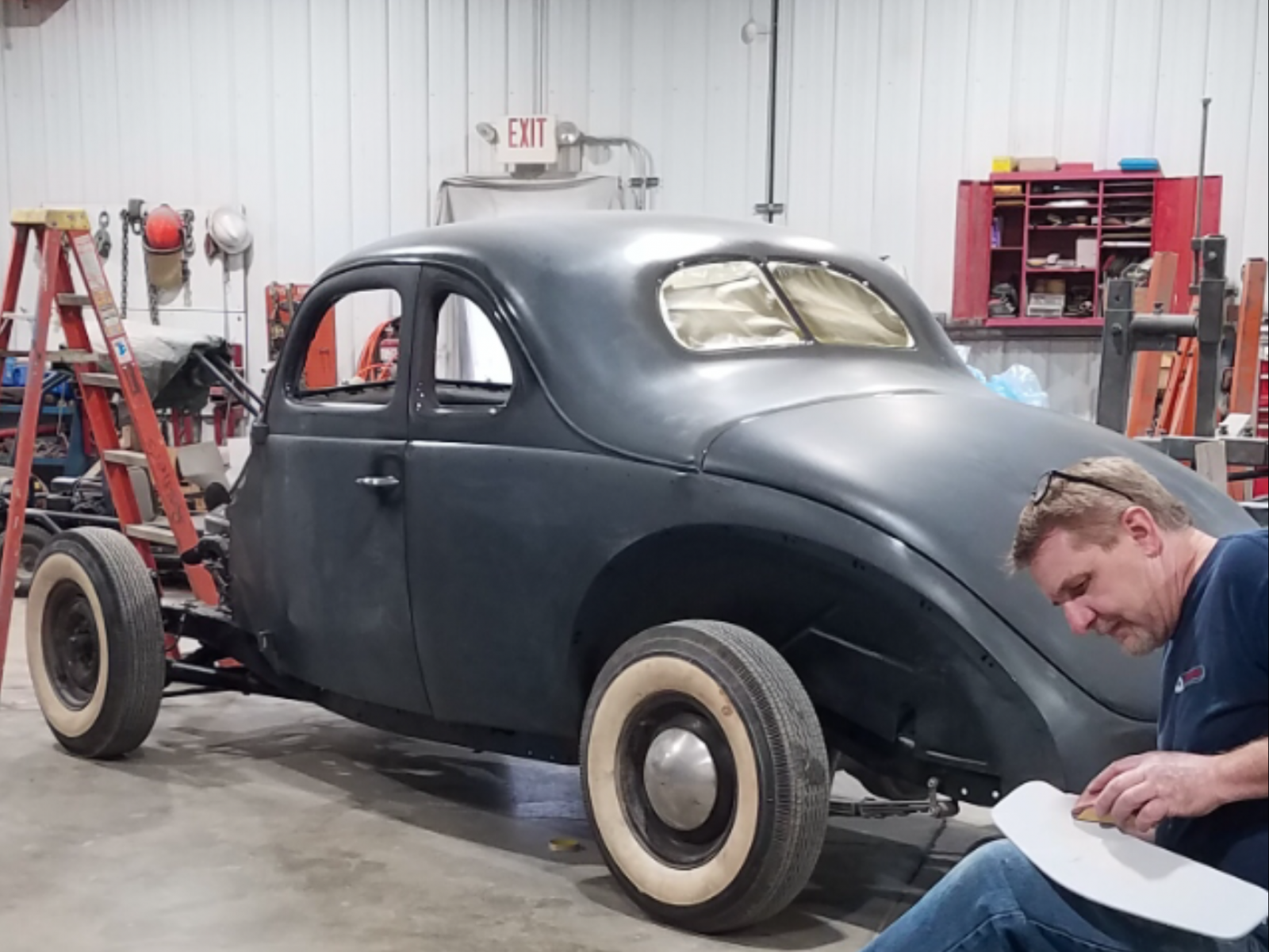

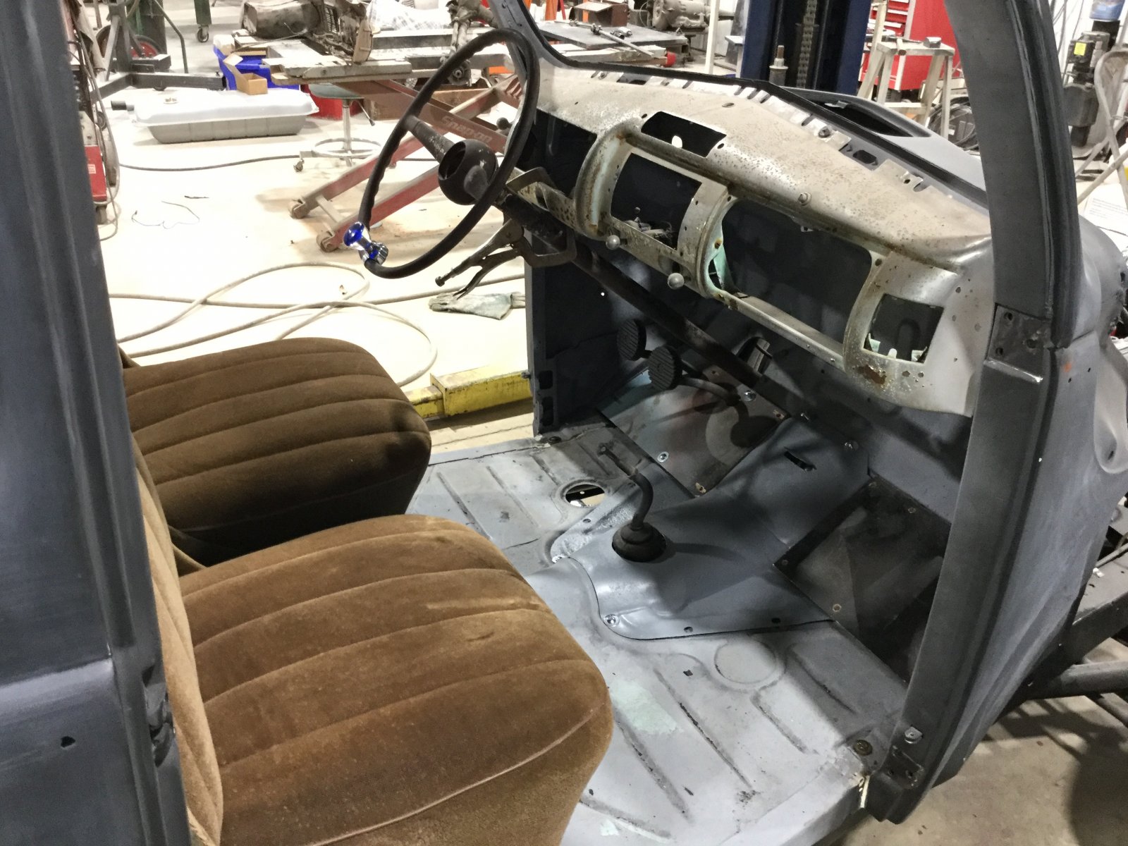

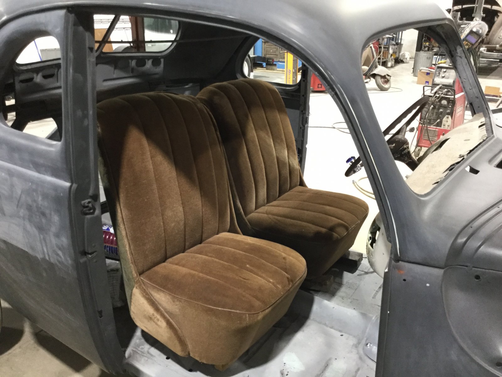

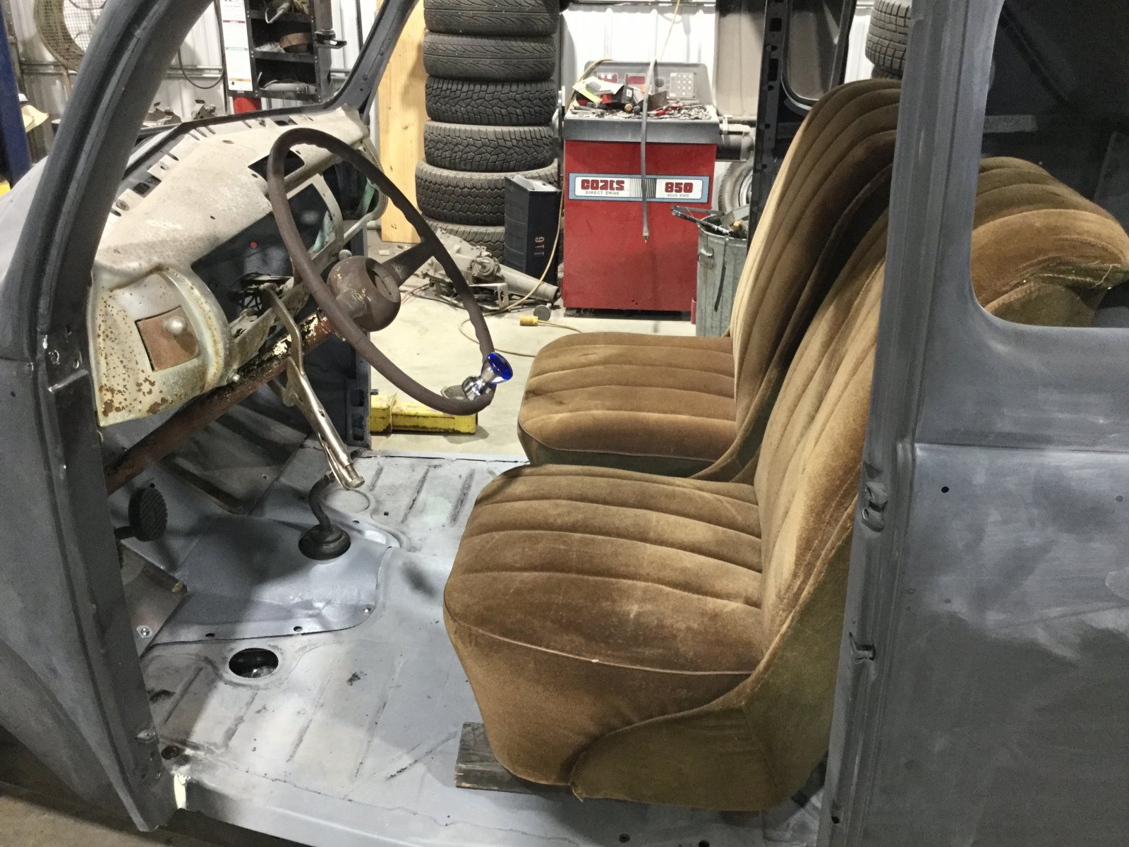

    A little mock up just to see if things are going to work. I was told the seats are from a Hudson Terraplane. Who knows? Also spent some time blocking the doors.

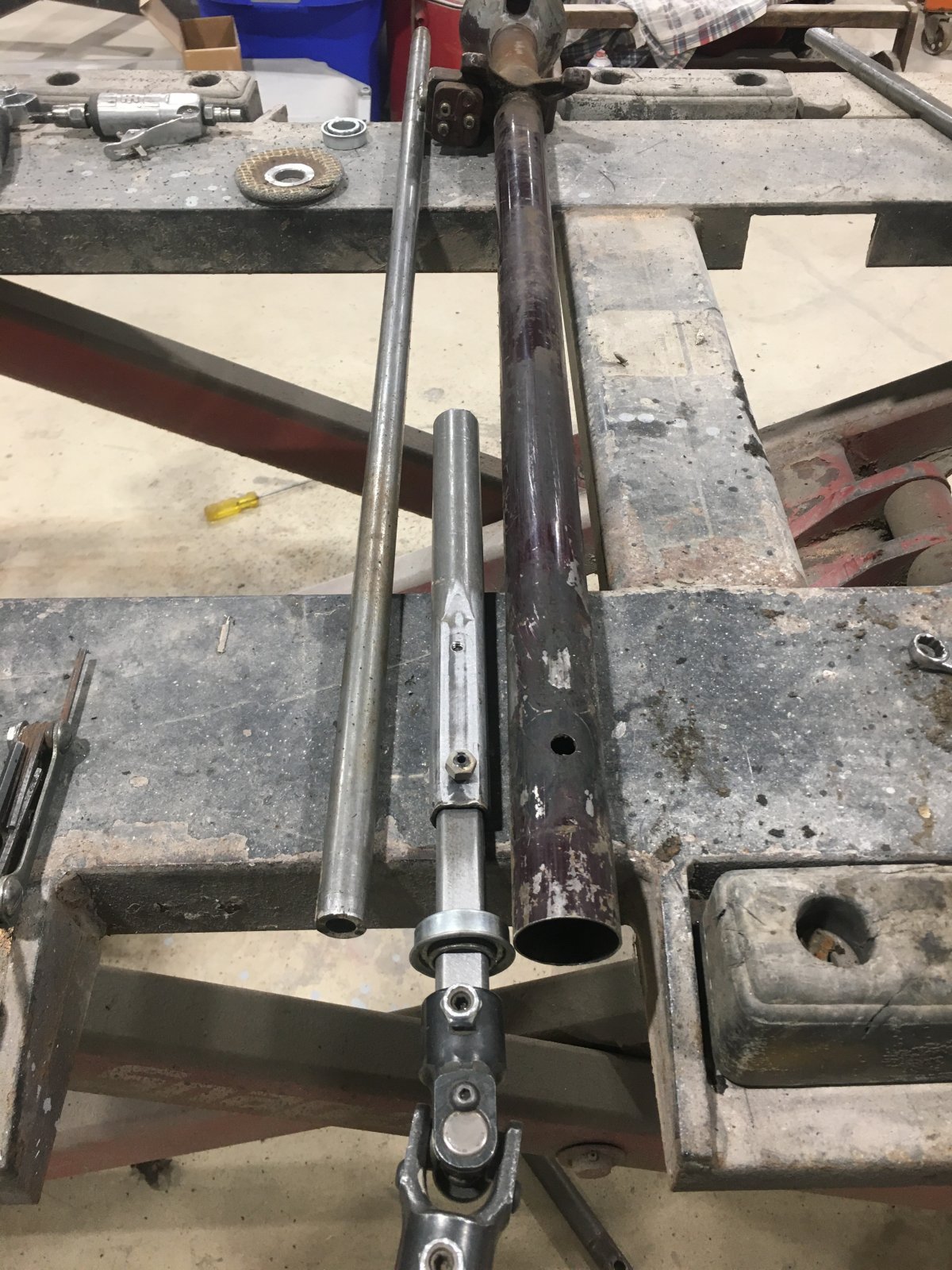

  6. newredporch
    Joined: Oct 8, 2010
    Posts: 216
    newredporch
    from pittsburgh
    Working on the steering today. Should have it finished and in place soon. E2B22342-1FB5-4519-9A6B-86FE3B427FDB.jpeg

    Blasted some parts the other day. Welded the radio and clock hole shut. Trying to get the dash painted and steering put back in the coupe on a cold winter day. 99307CAD-FA0C-4B42-BA5E-FA13F2C17E6B.jpeg

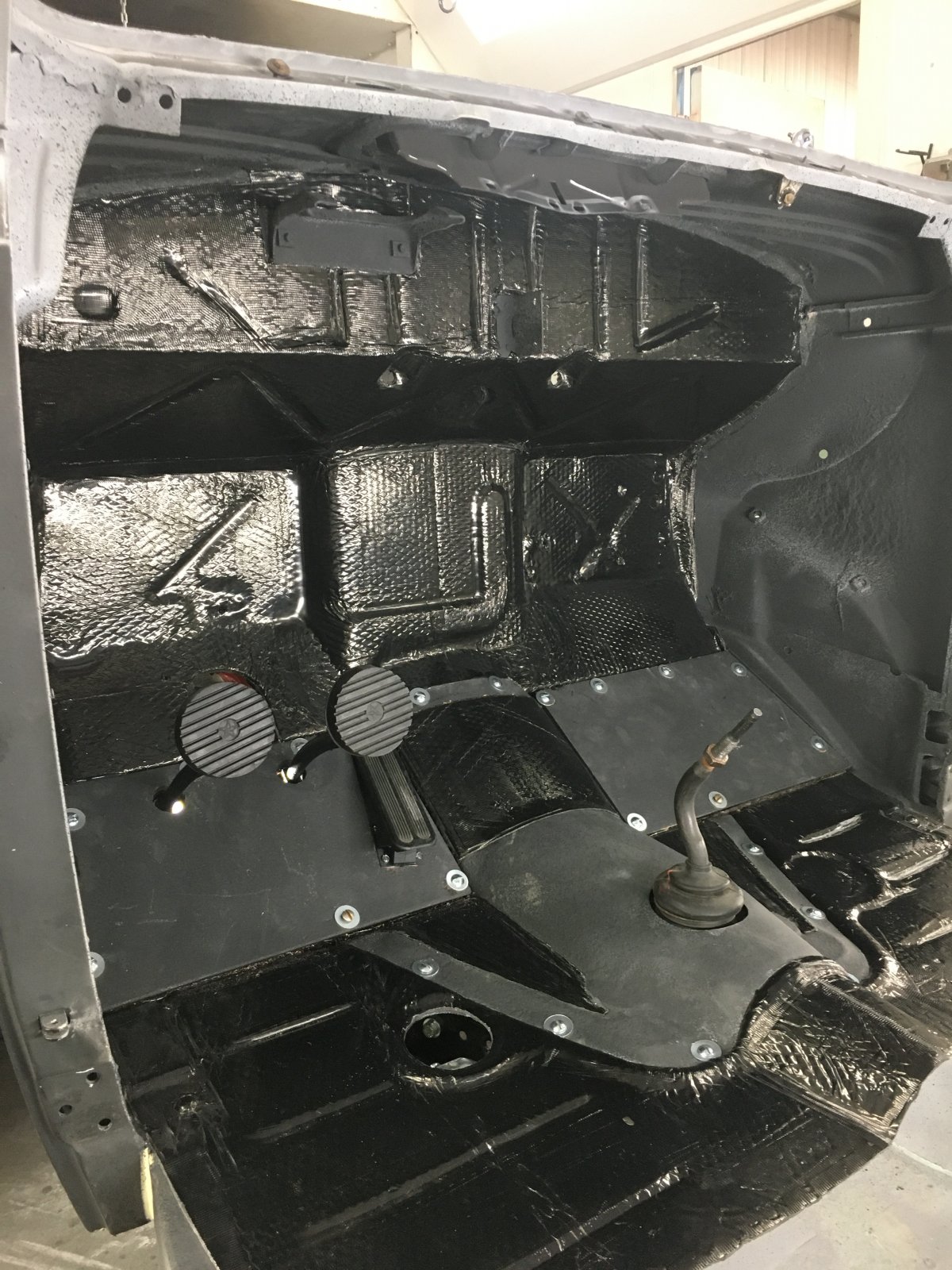

    Started putting the sound deadening material in. This stuff works nice, is cost efficient and actually looks good image.jpg image.jpg enough to show off up under the dash. I chose this brand because it is black.

  11. 1-SHOT
    Joined: Sep 23, 2014
    Posts: 2,903
    1-SHOT
    from Denton
    Where did you purchase it? Thanks Frank
  12. newredporch
    Joined: Oct 8, 2010
    Posts: 216
    newredporch
    from pittsburgh
    Amazon

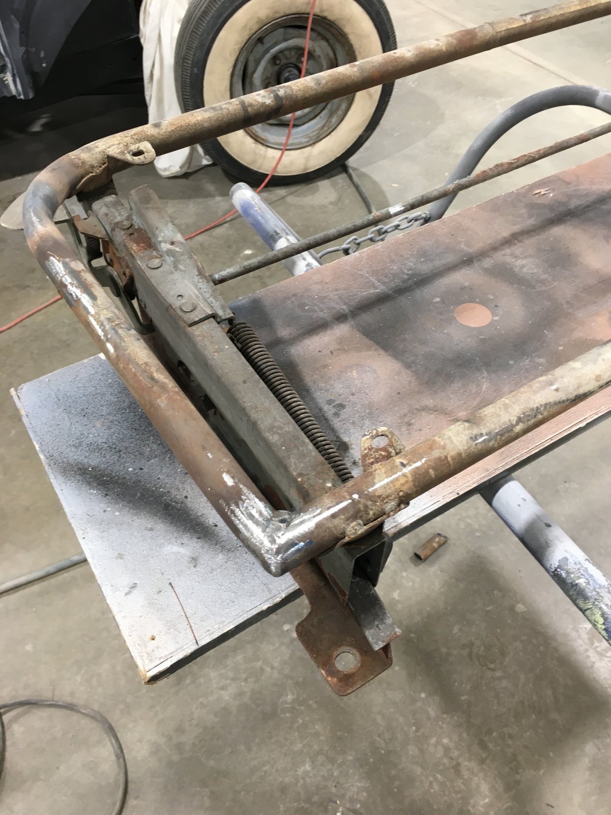

  15. newredporch
    Joined: Oct 8, 2010
    Posts: 216
    newredporch
    from pittsburgh

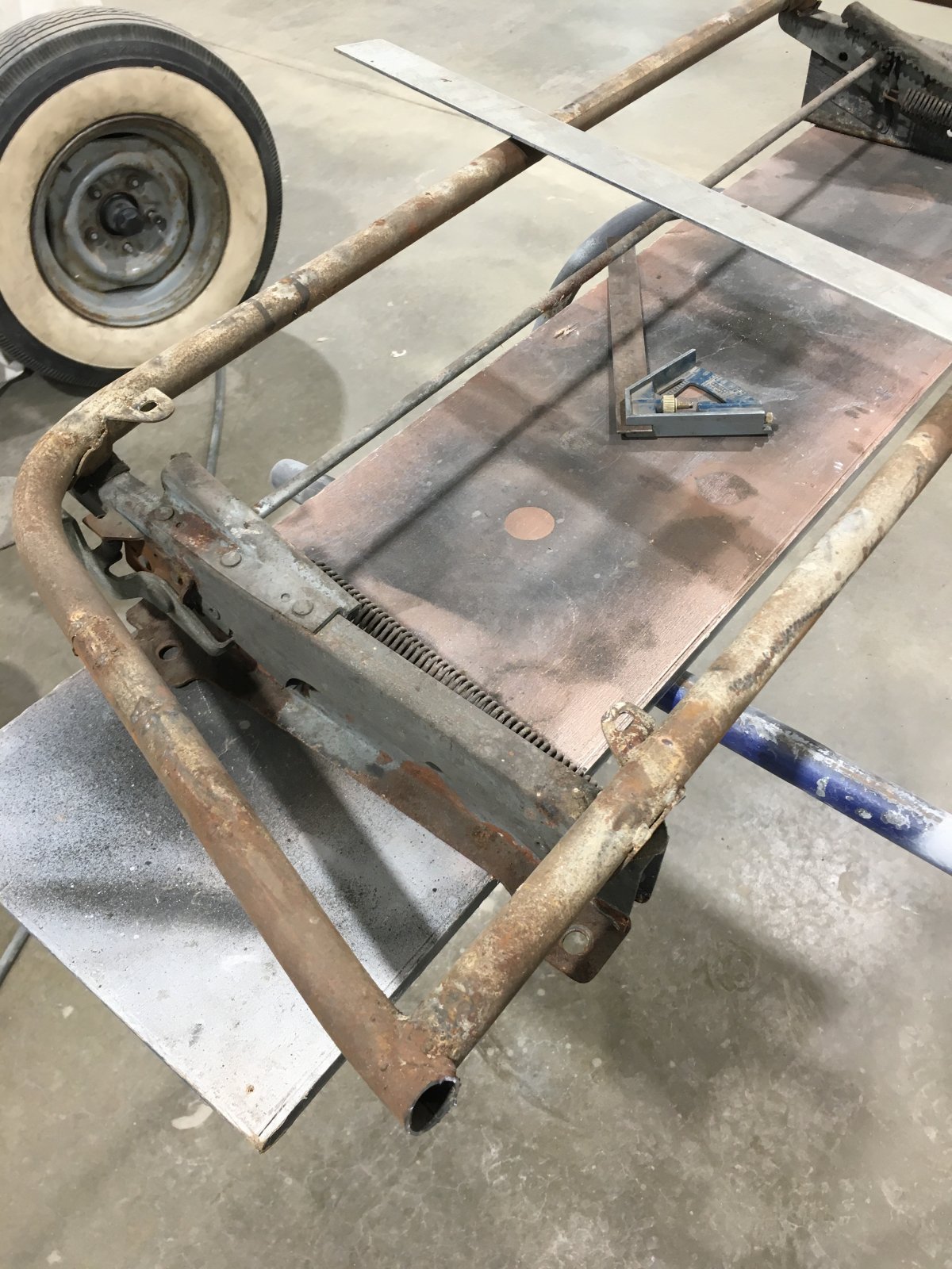

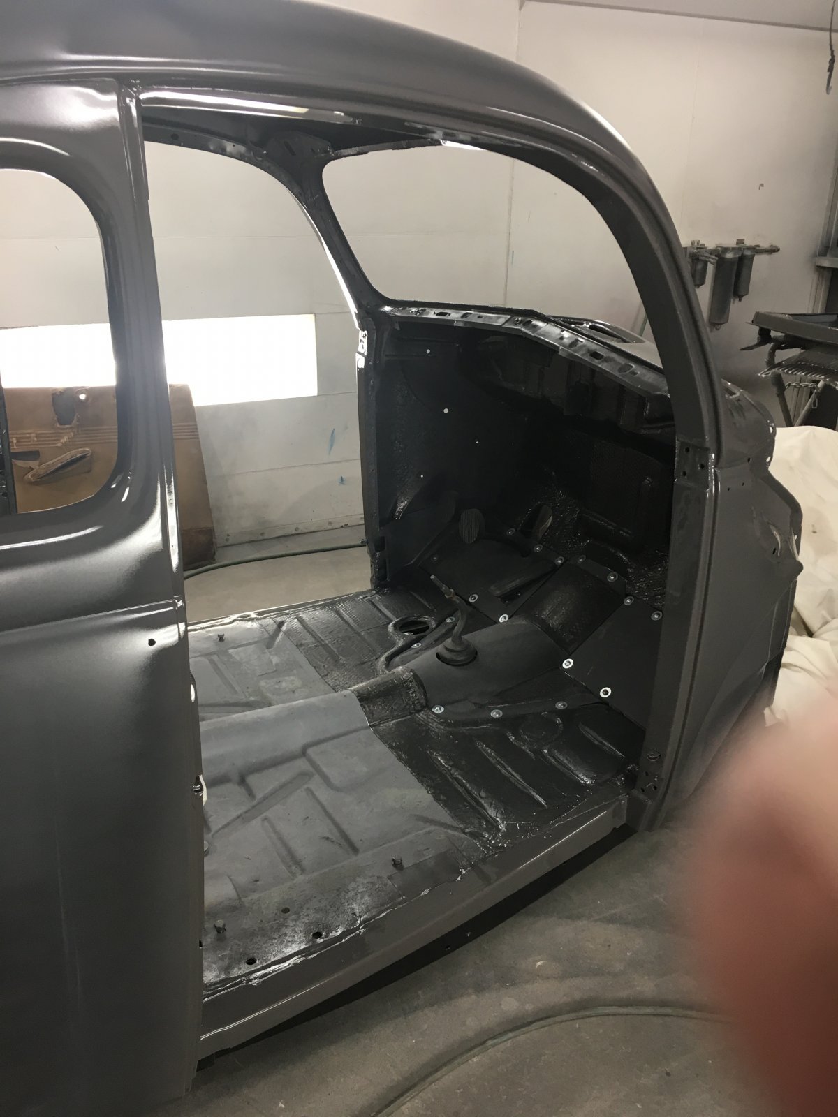

    Spent some time sealing seams and prep work on the door jams. I also cut the undercarriage out from a 4 door front seat and altered it to work as a mounting platform for the early Hudson Terraplane seats. (At least thats what the guy that sold them to me said they were from). They seem to fit nice and it gives the car a nice old school feel.

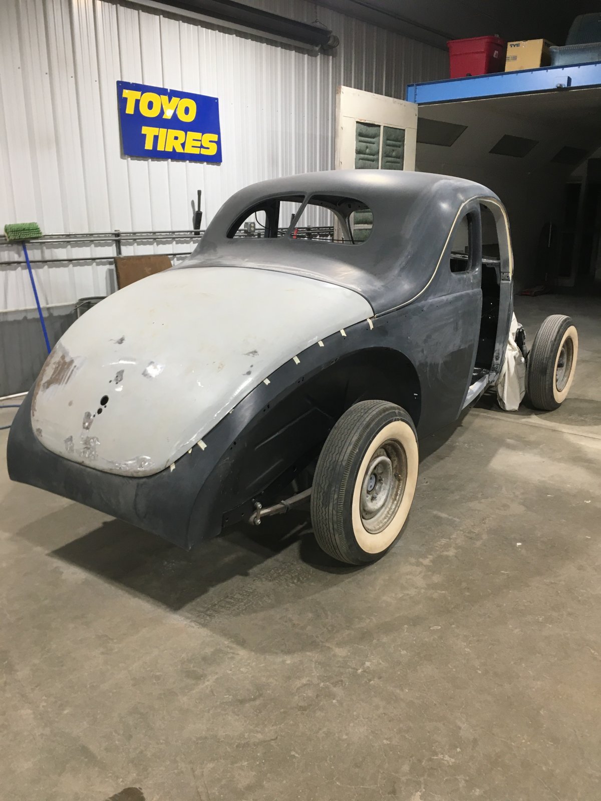

  16. newredporch
    Joined: Oct 8, 2010
    Posts: 216
    newredporch
    from pittsburgh

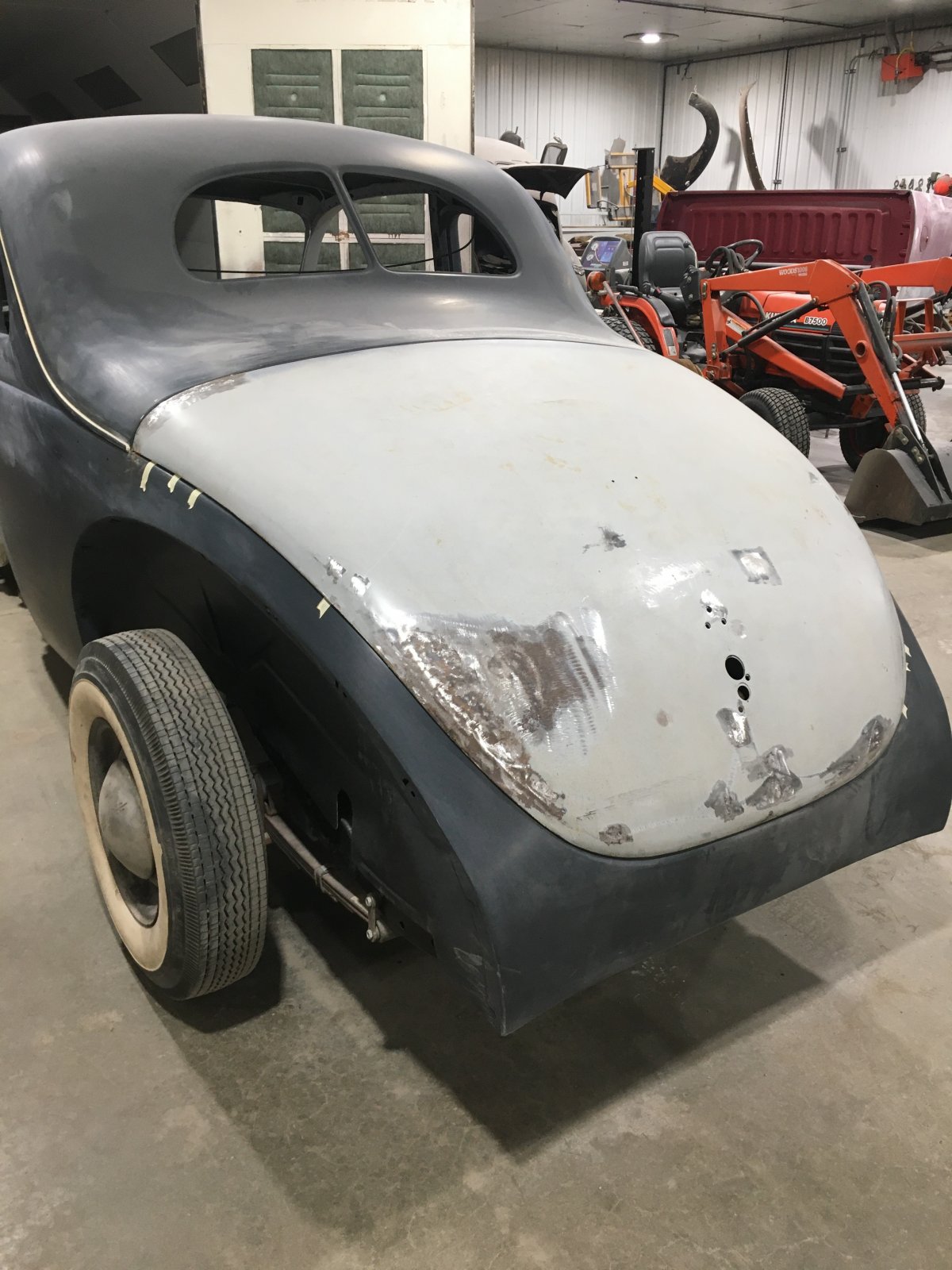

    6E6FF99A-E5D3-44F6-B5B9-DCA4C729A016.jpeg 673FF427-C811-404F-B266-9EC8A65D34CA.jpeg

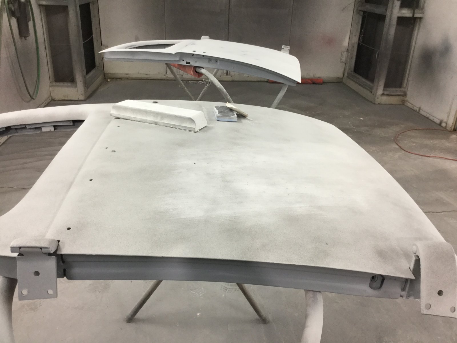

    Final fit on the trunk lid before blasting and straightening.
    Outback, Stogy, lazydog40 and 9 others like this.
  17. The 39 guy
    Joined: Nov 5, 2010
    Posts: 3,777
    The 39 guy
    Looks good! Did you try it with the trunk seal it can sometimes make a difference?
    olscrounger likes this.
  18. newredporch
    Joined: Oct 8, 2010
    Posts: 216
    newredporch
    from pittsburgh
    I did. The Picture is shown with the seal taped in place. Makes a big difference
  19. two couped up
    Joined: Feb 22, 2006
    Posts: 214
    two couped up
    from pa.
    Looks great, and those seats are a perfect fit and look right at home in the car.
    newredporch and tr_rodder like this.

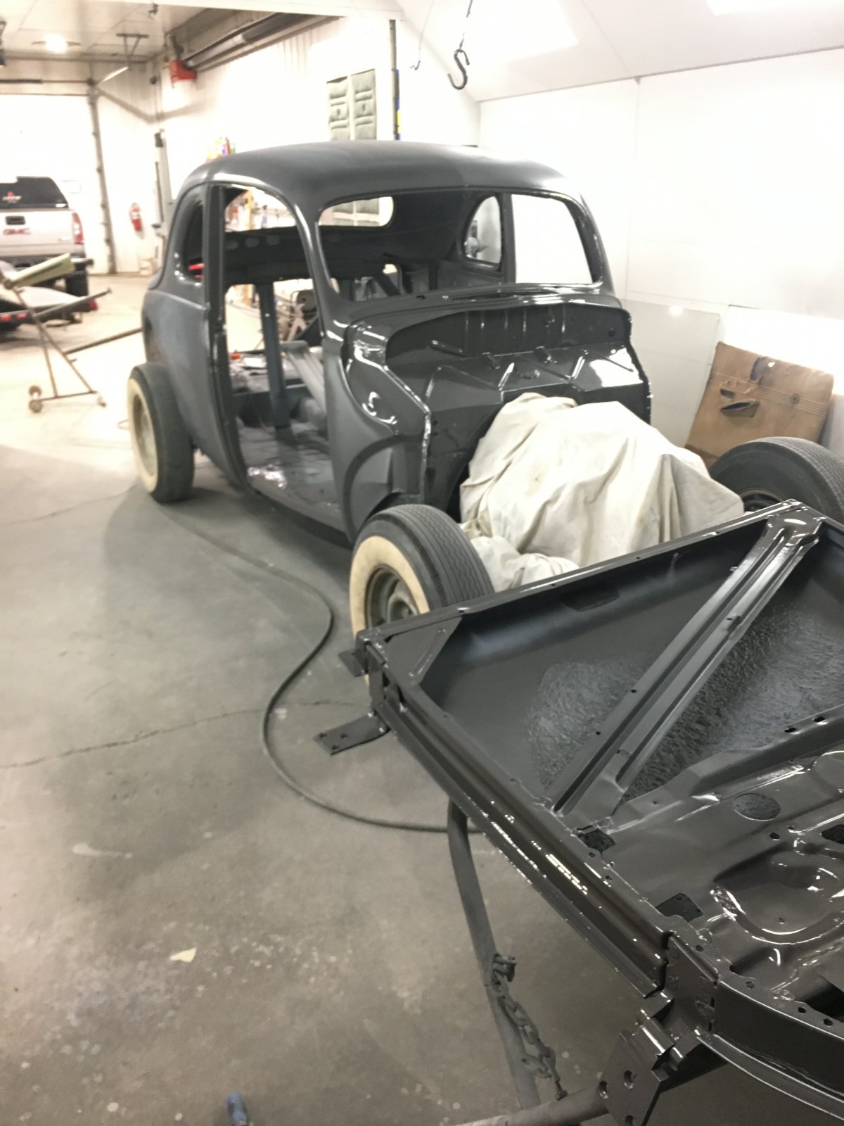

    D8E217DA-B22E-4BB8-9BC6-4198A06E2B39.jpeg F4910E66-F498-442A-AD7F-86A570E2197D.jpeg 423AA5C0-2E5F-428D-A786-DB1DA6086687.jpeg Painted the jams and edges today

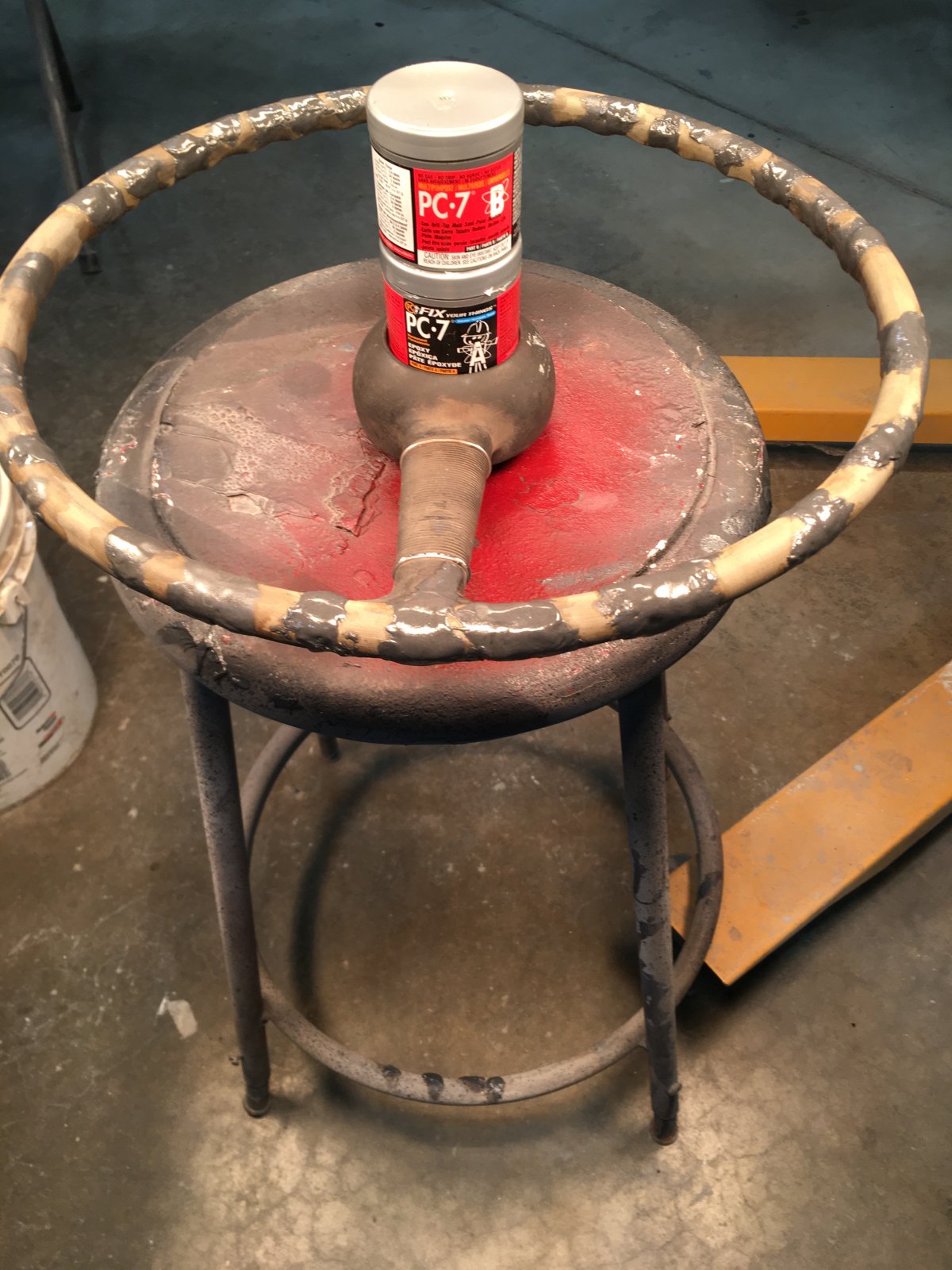

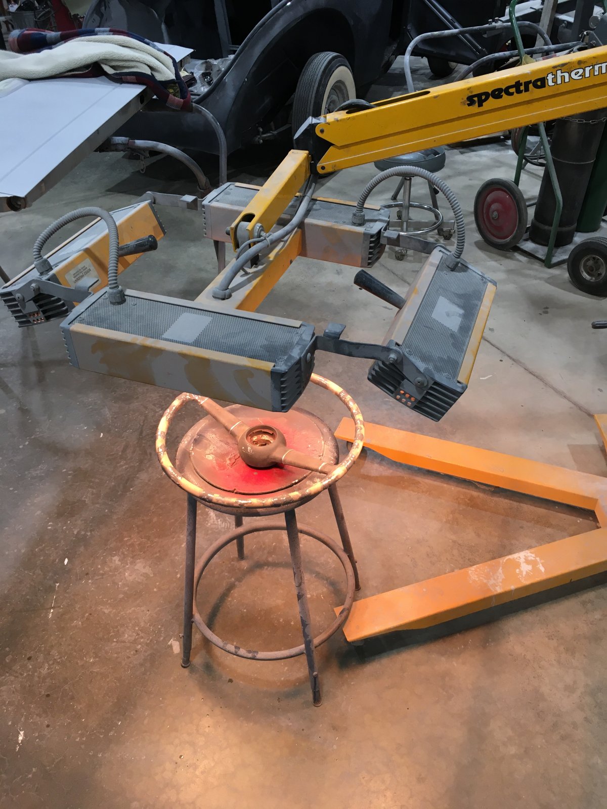

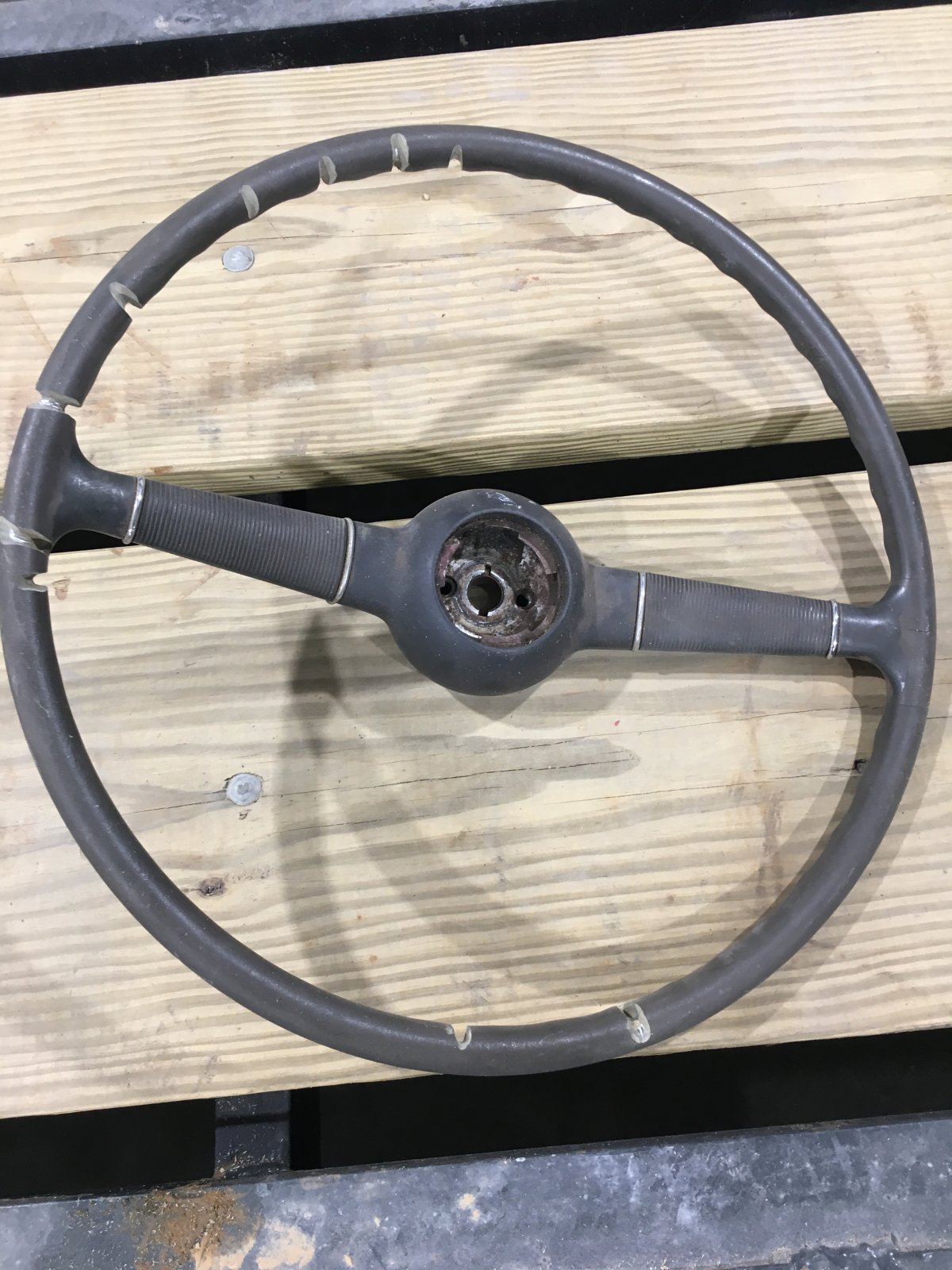

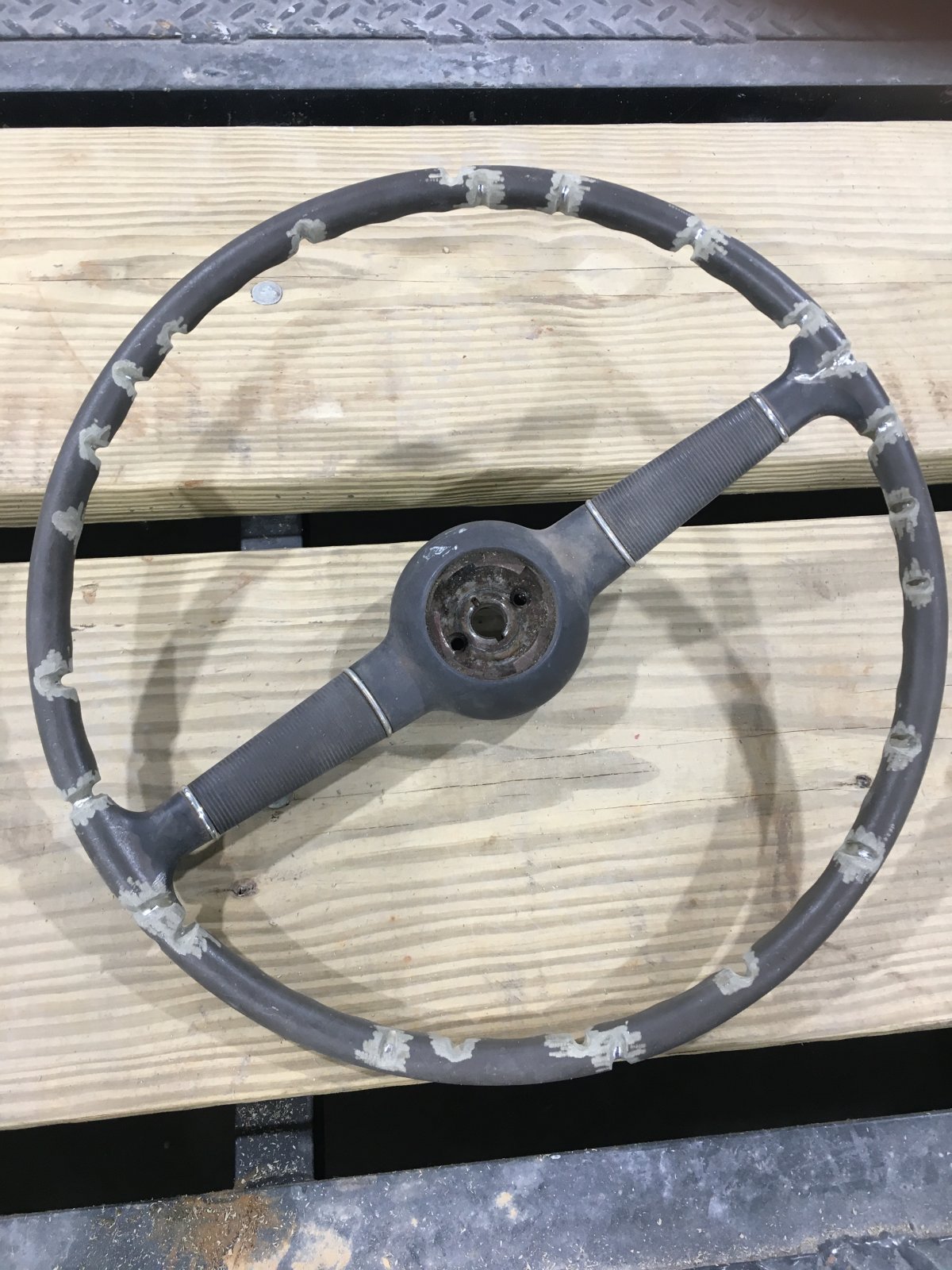

    Lacking ambition today and figured I’d dive into the steering wheel.
  22. newredporch
    Joined: Oct 8, 2010
    Posts: 216
    newredporch
    from pittsburgh

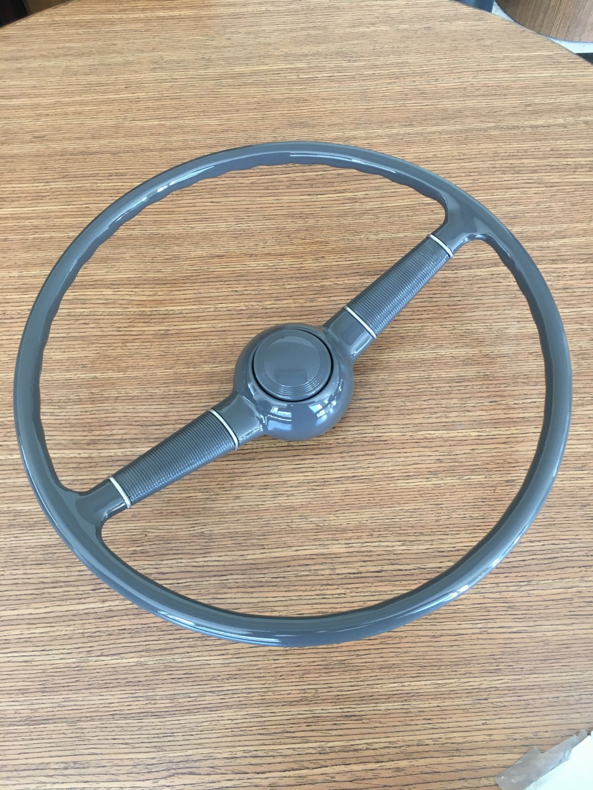

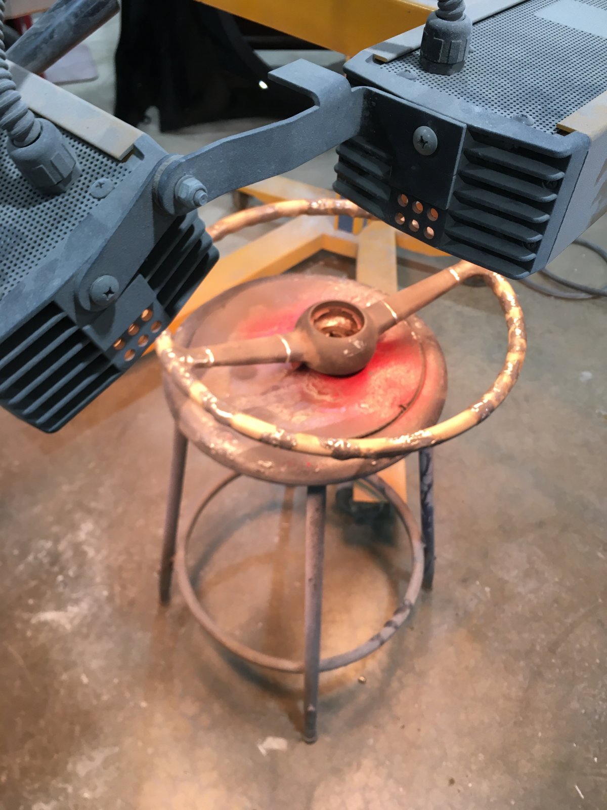

    finished the steering wheel. The center will get hand painted pinstripes 43D99992-EE07-4C86-B5D1-89594A4CBC78.jpeg

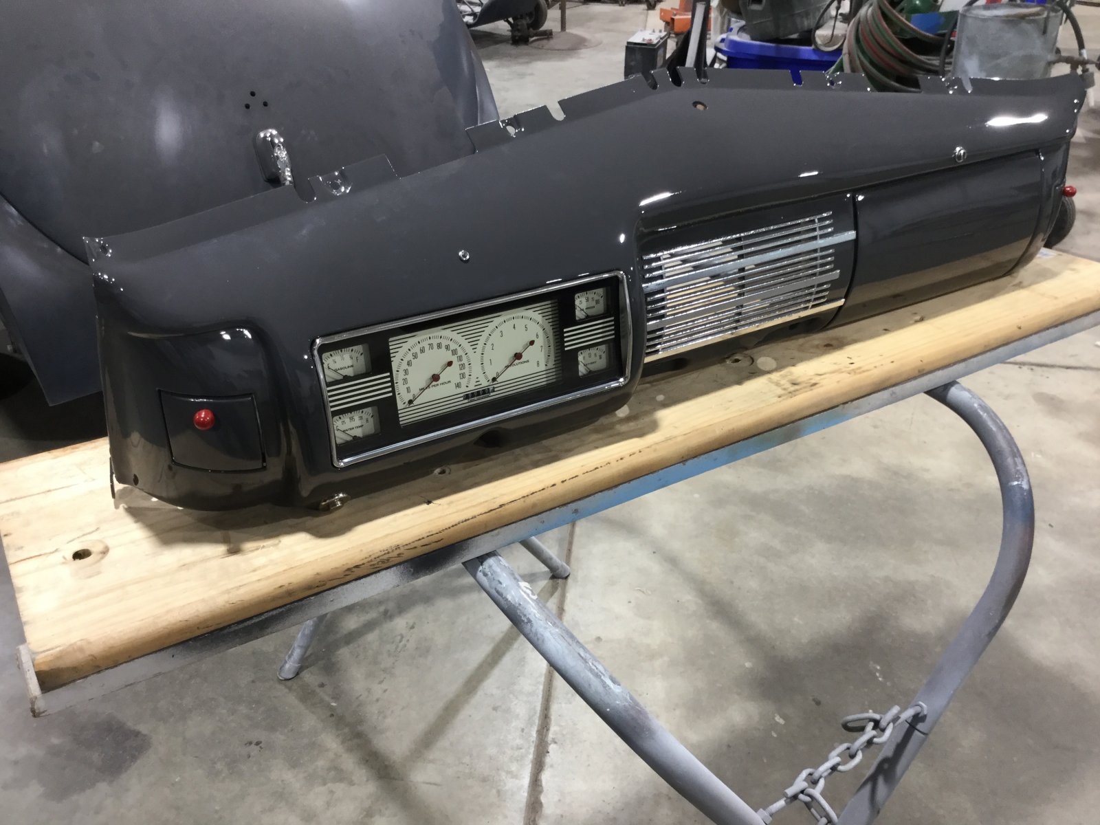

  25. newredporch
    Joined: Oct 8, 2010
    Posts: 216
    newredporch
    from pittsburgh

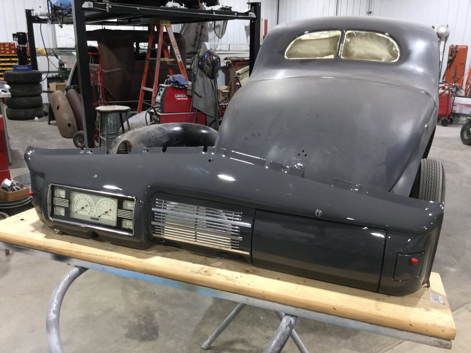

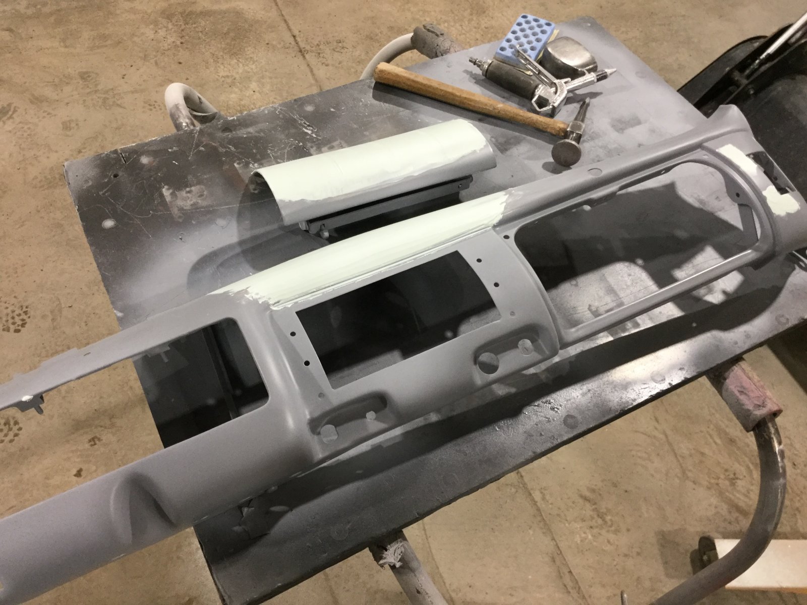

    My gl*** came from Bob’s Gl*** this week (best price) so I figured I would get the dash together and install it after I put the gl*** in. This will give a little more room to work the windshield into place B65091EF-6297-4788-8D0C-0C078A434E47.jpeg 28DE5F5D-BD03-41C5-96D3-5FC0180F8BA8.jpeg
  26. Bandit Billy
    Joined: Sep 16, 2014
    Posts: 16,141
    Bandit Billy
    That Cl***ic Instruments gauge panel looks excellent. I purchased the same unit for my PU, nice seeing one installed. Great work BTW.

    Just stumbled on to your project. Such great looking work. I've used JBWeld for steering wheel repair and wasn't all that pleased with its longevity.
    Have you used the PC-7 before and had good luck? I notice you ground out cracks all the way to the metal and that you put the epoxy back in layers. If I may, how thick can you put it in and have it solidly/cure properly. Was sanding all by hand?
