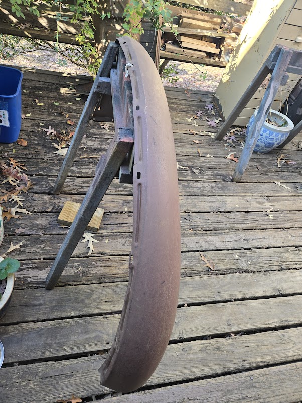

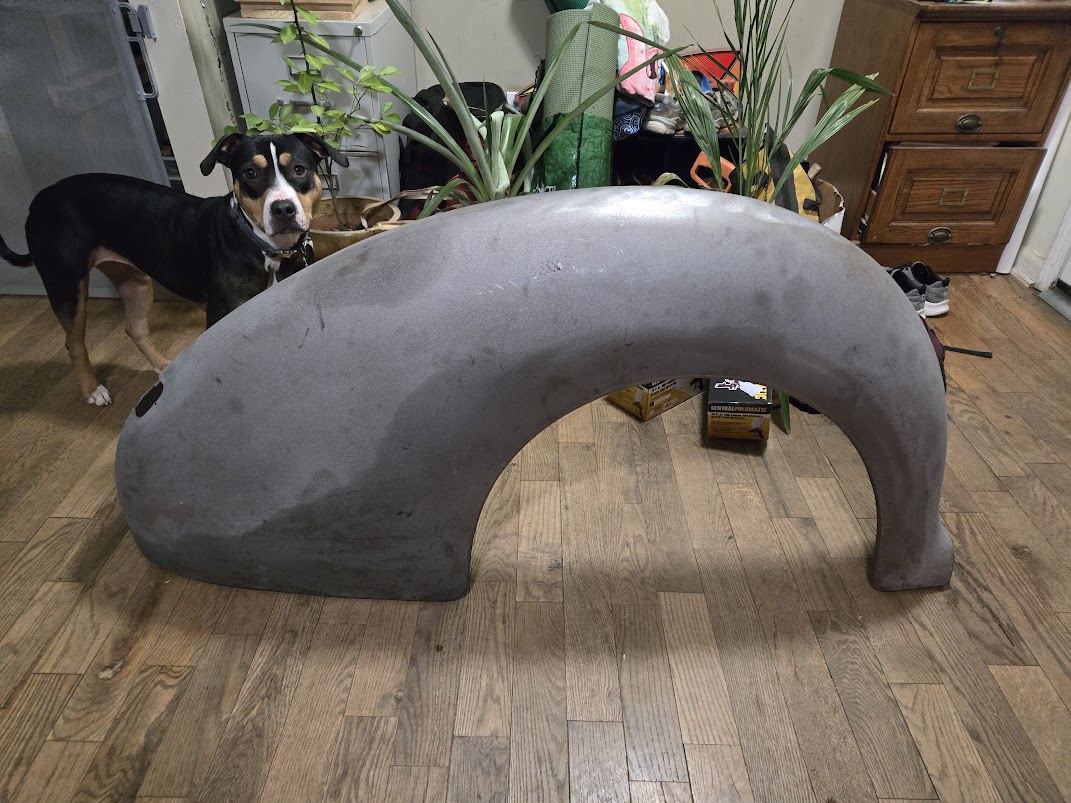

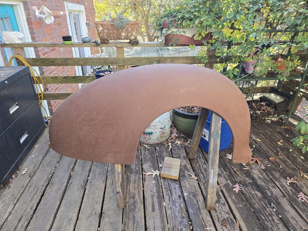

  6. Back on the struggle of the right rear fender.....I have been looking for nearly 10 years for a good one under $500 and no luck. I had a reparable standard with some wrinkled and poorly repaired wheel opening lip damage and denting at the running board end. I also had this NOS sedan delivery only fender and had resigned to cutting it up for patches for the passenger car. 20241220_112209.jpg
    They have a totally different flange area and are skinny where the tail light would mount on a car. I had it advertised here, V8 club classifieds and on FB for almost 3 years with no interest. I figure that was enough time so went ahead with my plan.
    I pulled it out of the basement and a few weeks went by before I could get to it and wouldn't you know I got a call from a well known '40 collector/parts man in North Carolina that wanted to know if I still had it. He was building a delivery and realized what he thought was a good right rear turned out to be a woodie fender witch also is unique and would not fit his delivery. He obviously wanted it bad enough to drive the 5 hours the next day and traded me for a good passenger car right rear. Its in bare metal, has had a small section each of the flange and area that the reinforcing attaches to on the lower edge replaced but is otherwise straight and ready to bolt on and go. I also got a new rescue pooch to keep my older rescue pooch company.
    The kids had two weeks off for the holidays so I stopped working as well and made space in the second bay by putting my garage car outside to get going on the long overdue process of uniting engine and transmission. First step was to replace the pilot bushing which had a noticeable wear pattern in it. After lightly grinding free the staked in retainer I did the Play-doh trick using a socket extension wrapped with making tape as a plunger and a hammer to force both the retainer and the bushing out.

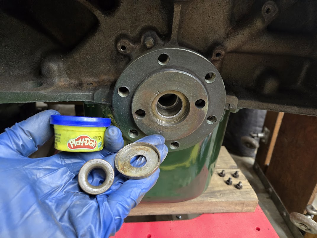

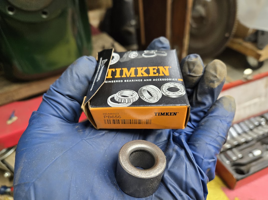

    New quality bushing.

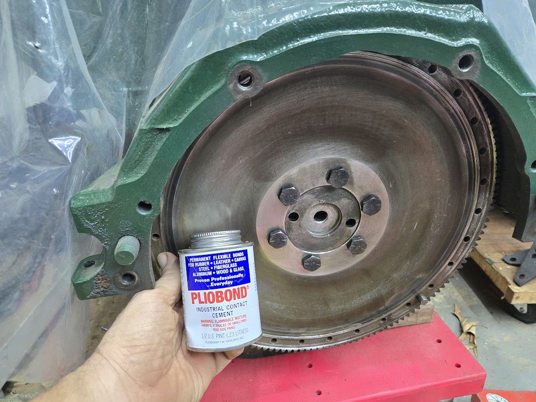

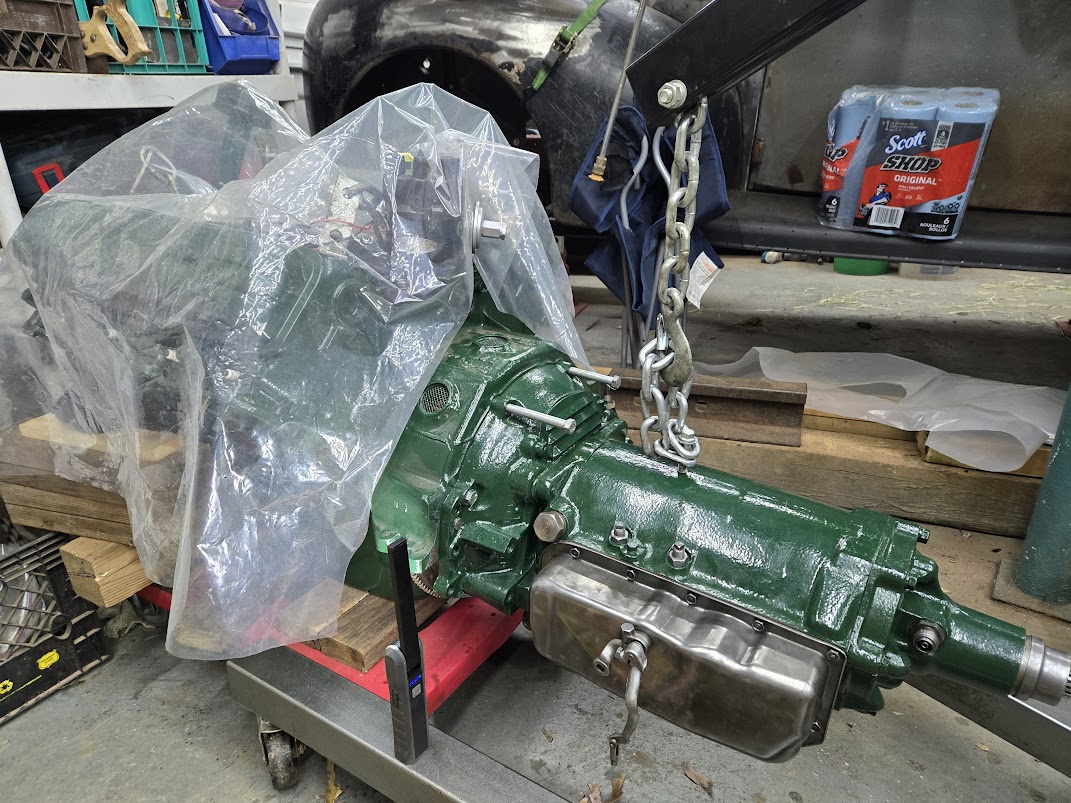

    I guess you'd call this a flywheel and not a flex plate. But either way it has to be fluid sealed and there is a gasket between the crank flange and the wheel. The adhesive is Pliobond 30, it is a bit like rubber cement, snot like coloration and texture, very stinky. It has a decent working time and as I had figure out the orientation of the irregularly spaced bolts beforehand all went smoothly.
    There is a big gasket that also gets Pliobond between the flywheel and the torus cover to seal in all the trans fluid that surrounds the torus. This is a big job getting it all aligned as you have to get the trans seated to the engine block and get the flywheel seated to the cover and 23 bolts in the cover/flywheel all before the gasket and pliobond dries out. I did a dry run first and then with the wife's help it was a snap. I pliobond-ed the flywheel and handed her the tub to do the torus cover while I put the gasket in place. We both pushed, poked and prodded the assembly together bolting engine to trans then each started putting bolts in place and rotating the engine to get all the bolts where they needed to be in the flywheel. She had done this before for her Pontriac so knew the drill and having two people made it so much smoother than it could have been with just one.
    I was just going to push it to the side and call it a victory but the dolly collapsed under the weight so I figured what the hell, lets stick it where it belongs. Still a lot of fiddling, grinding and clearanceing to do but its in.
    I put 2, 2x4's between the body and frame for extra space during install. With them removed there is just enough space but I need to make more to keep it from rubbing when in motion. The tail shaft is currently at 7* down and needs to come up about 2 inches. The rear is at 4* up (I set it at 3 but with the tail dragging stance it came up a bit). I had to take out the top of the CE X-member brace as it needs to come up more. I will modify it to be taller once the tail height is set. It will also need a taller tunnel than stock and a custom trans cover so good thing I have yet to do either.
    Next job is probably running brake lines, I fit the stock pedal and it clears just fine till at the bottom of the travel it just kisses the bell housing, so a little heat and bend and we are good. Fuel tank and lines, assemble engine top end, exhaust, shocks front and rear and a bunch of other things can fill up the dark days of winter.

    Interesting thing is in my olds manual there is no mention of applying sealant to the flywheel bolts but like you I did anyway.

    Amazing how close that delivery fender got to being patch panels after all that time, and was rescued at the last minute. I wouldn't have blamed you for cutting it up, but your traded replacement sounds like it's way less work, and kinda nice to think that rare bit is going to be used as intended again. New puppy doesn't look nearly as impressed.
  10. I totally agree. It looked HUGE on the floor and was like how is this going to fit, but it does.

  11. The AutoTrans guy david edwards said not to use a gasket between the flywheel and crank flange as the Pontiac manual specifically states not to do so, just the sealant only. The Olds manual said to use a gasket and the sealant there and my car had a gasket in place upon dissassembly so I put one back on and sealed everything back up . Biggest fear in all this is that it wont shift right or will leak everywhere at high pressure and I will have to take it all back out! Its a pretty simple thing and I double and triple checked everything so crossing fingers. This is my first build this deep, usually I just do body and paint, and there is a lot of moving bits in a car.

  12. I really did not want to cut it up and was stalling as best as I could but needing to make progress and BAM he called, crazy. I knew somebody would need it. It was just how are they going to find me and how to get it to them. Super stoked that it worked out for both of us. The new dog is a total snuggle pup with a bit of a wild side. She is a Foster Fail, my wife took her in as she was scheduled to be put down after 6 months at the pound. She was here 6 weeks and my daughter and I were telling my wife to stop trying to give our dog away. She is just starting to venture into the garage with me and will hang out for a bit before going back to someones lap on the couch.

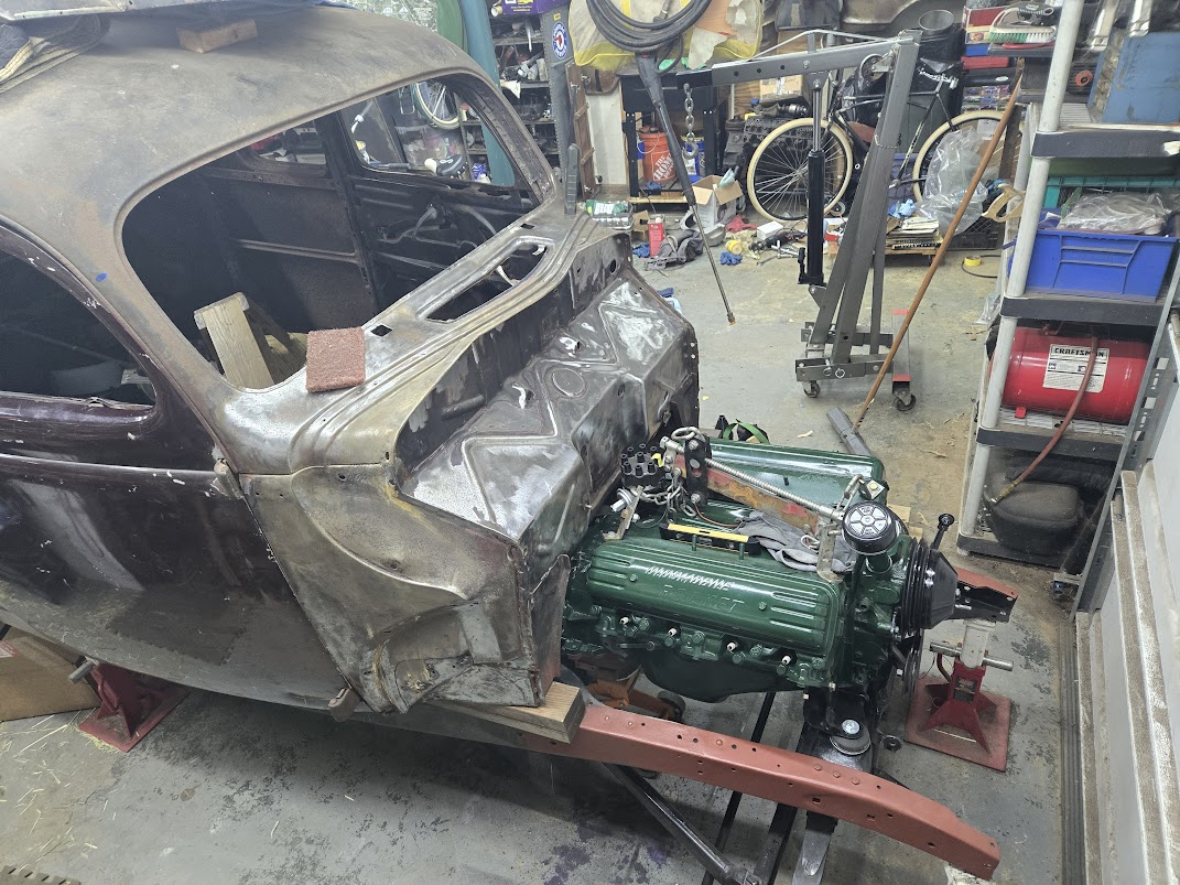

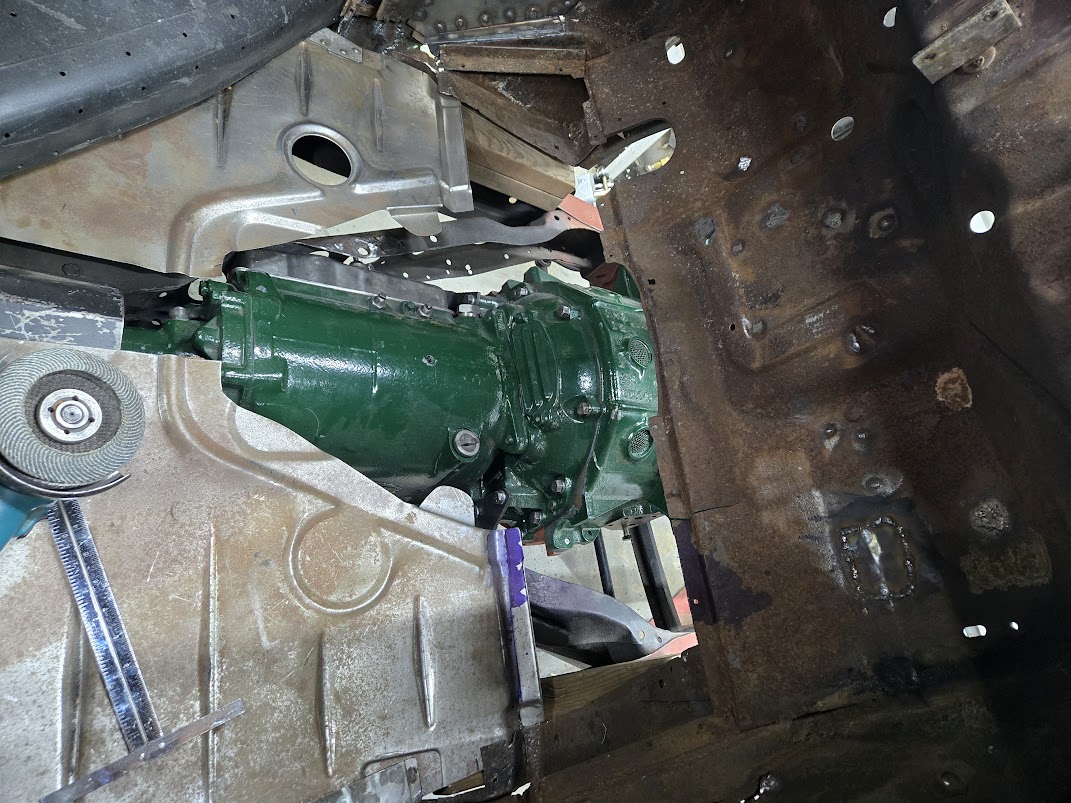

  13. Chugging along. When we last meet the engine was in but pointing at 7.5* down and needed to come up a lot to match the 4* up the rear end is currently set at. I had to remove the upper CE X-member bracing to get the tailshaft high enough. I also put in a crappy extra steering column/box to check clearances. This is where it needs to sit. If I went to the ideal 3* it would have to come up another inch as there is no way to lower the front of the engine without engineering all new brackets or cutting the crossmember to make recessed pockets for the biscuit mounts. Not going to happen now, its where its staying.
    I had to trim a lot more of the firewall than I thought I would have to to get it where it needed to be. It just barely clears the cast in vents on the bellhousing. There are no body mount pads in yet so it will add to the clearance.
    The frame was already modded when I got it but knowing what I see now it could have retained its original bracing and wishbone ball mount. I removed the bottom split wishbone plate and drilled holes to add two ball caps to make a new mount.
    The upper ball half will eventually get welded in and I'm contemplating where I can add some internal braceing for strength as teh factory piece had all sorts of webbing but it is 3/16" plate and seems strong. Axle caster angle seems to be 9* and at the upper end of the acceptable scale but hard to tell on jack stands. I will wait to weld the cups in until I see if it needs to be spaced down some or put in through the top to raise it after a road test.

    I test fit it and it clears the steering box with an inch to spare. I need to paint the bell housing now that I know it will be staying. All the steering linkage clears the oil pan as well as the wishbone clears the trans with how high it is.
    I need to work up a new trans mid-mount. I had new factory rubber mounts on the shelf (miss orders from my wife's Pontiac years ago) and the stock 51 olds trans crossmember that I hoped to modify to fit inside the X-member legs.
    That will not work as that space is occupied by the brake pedal/master on the left side. I have two options, attach it at the end of the tail shaft down to the EC X-member bottom plate or at the bottom of the bell cover. I'm leaning bell cover. It is centrally located like factory and as it has a small inspection cover there with 4 tapped holes I can use those for attachment. Think a Hurst sbc front mount looking sort of thing that goes up and catches the X-member legs bottom flange.
    I have resigned myself to no more than three hours at a time in the garage. I'd love mentally to do more but physically if I loose track of time I wind up being overly sore and having a hurt back for three days afterwords which seriously takes the fun out of it. I need to set up a chair and just chill sometimes but I am a constant fidget-er and it is hard to sit still.
